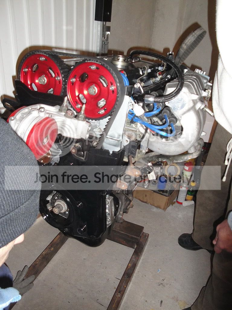

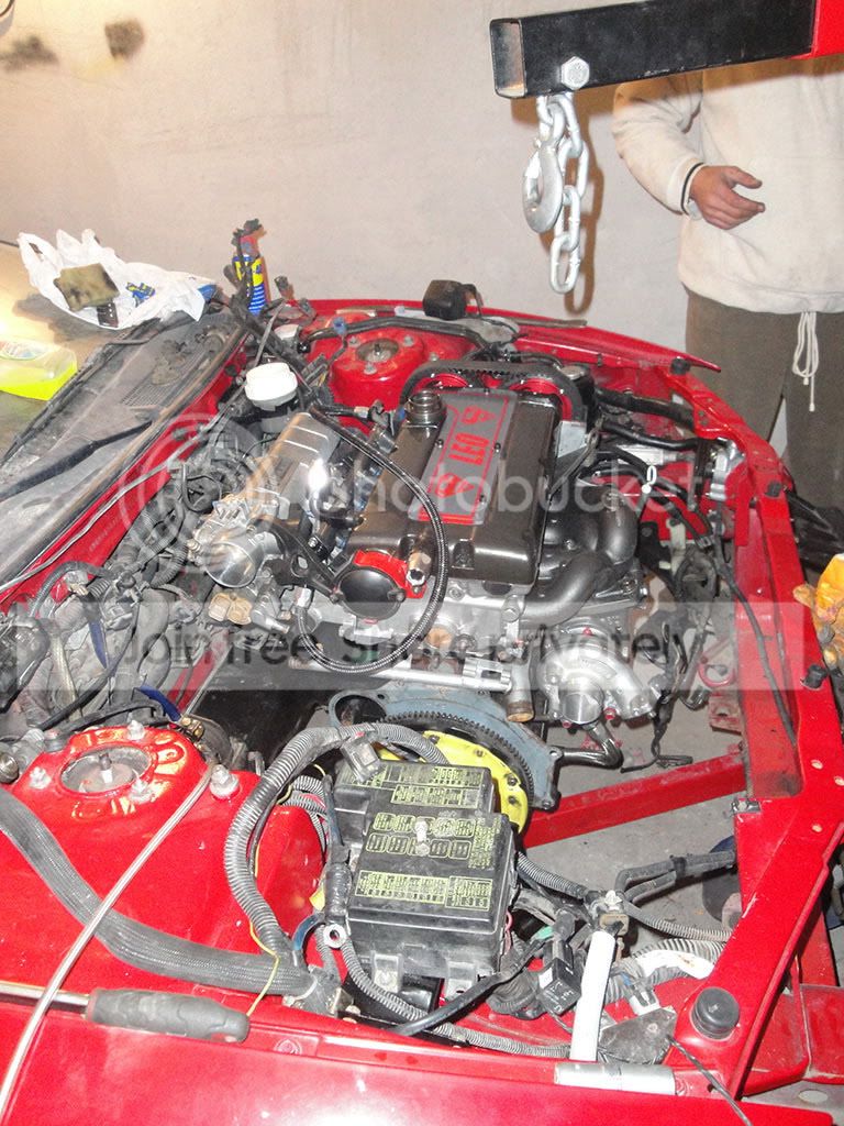

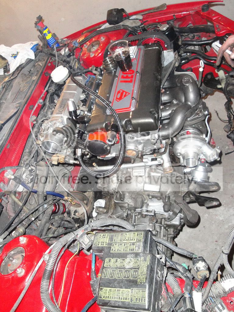

This sundey me and 3 of my buddies, armored with a heater, dry food and drinks went into the freezing garage to put the engine, tranny and transfer case back where they belong :)
A shot of the painted and polished timing covers
Finally the engine is back in
Tranny and transfer case now in place

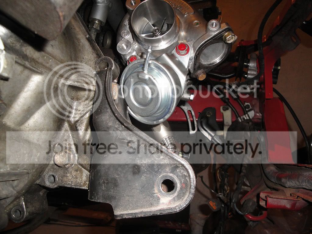

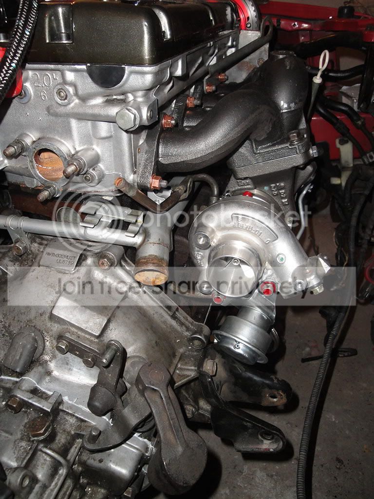

Downflow outlet of the 68HTA. I think it will clear from the radiator fan.
When installed the front mount we got a lot frustrated - will the wastegate actuator interfere with the mount? Luckily it was 1-2 mm away from it so they will not touch...whew...
It should be fine, I know when installing my 16g it was likeright there against the front mount however the only part thats gonna move is the actuator rod and the wastegate at the exhaust side. I'd recommend some slim fans if you weren't already planning on them
Yeah, I guess i sneak through the process of grinding the wasgegate actuator bolt housings and converting the actuator rod to a regulated one in order to move it further from the mount bracket.
I don't plan changing the fans unless they interfere with some of the hardware there which I doubt will happen. This week will try to mock up the IC piping
