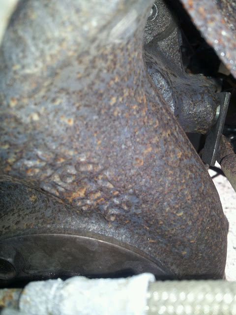

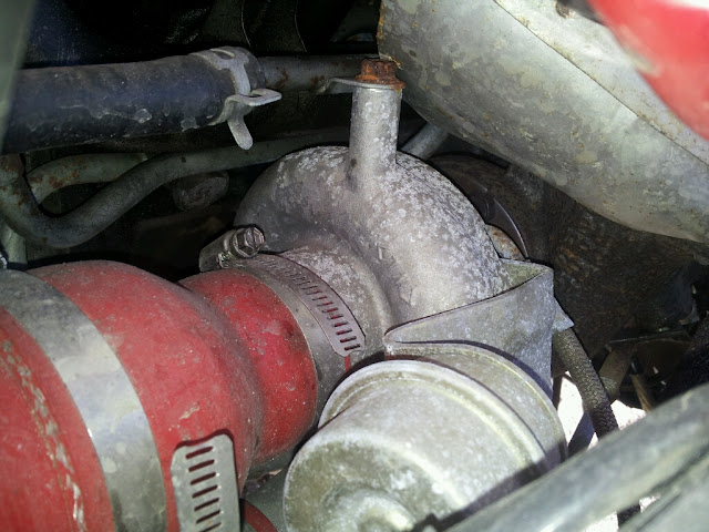

It looks like the stock t25 turbo, It could also be t28 but you can't really tell from the outside as they use the same housing.
It should be a T25 Garrett. There are not a whole lot of identifying markers. The Turbine housing hold down clamps are the only thing that I can see well enough.

I will take off the intake and get a picture of the compressor blade and repost. 16PSI is too high for a stock turbo for sure right? Unless my boost guage is inaccurate
Just so you know that bigger intake is actually hurting you so unless you upgrade to a turbo with the same size inlet your lossing power cause of added turbulence. Some people run 16 psi but I wouldn't run more then 14-15 without a wideband.
Is it really hurting my performance, By how much? I have a POS narrowband AKA a cool Light show. I am upgrading sooner or later.

Yeah get that pos narrowband out of there. As for numbers on how much your lossing it's hard to say but your loosing some for sure. Im sure there's a few thread on it on this site and if I get some time I'll post some
I dont think you can say your hurting your performance with a larger intake.
Ive read the thread your refering to and the horsepower gains and losses were so small it doesnt matter.

Large intake do hurt power on smaller turbos, there was a thread with supporting data around here somewhere, I was trying it find it. Expecially when it is a quick change in size due to the reducer to fit the inlet, they found otherwise if the pipe gradually got smaller as it got to the turbo.

So in real life use I wont really notice much? Ive heard about the intake suddenly getting smaller to fit inlet of turbo before with noticeable loss but there wasn't any supporting facts where I saw it from.
