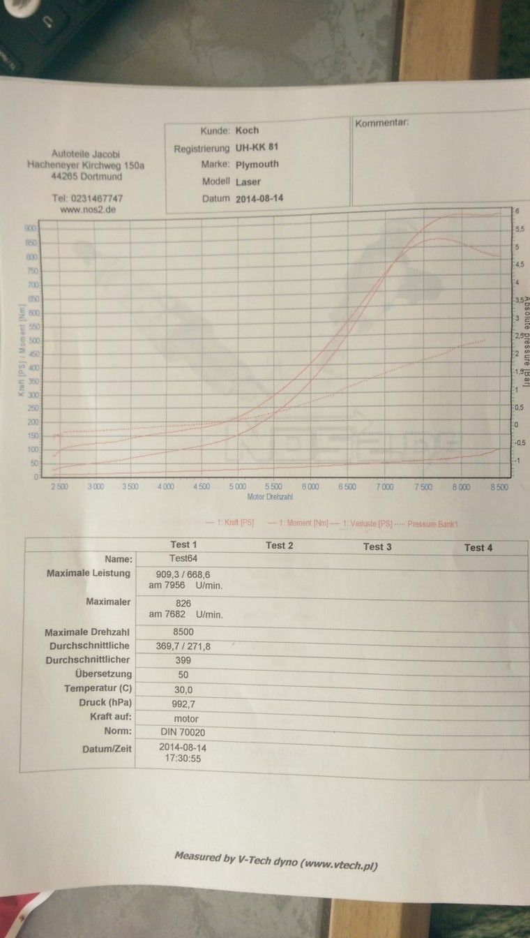

Yes the car was last year of the dyno with a AMS 850 Turbo. 604 HP 580 NM 32 PSI
At the moment is the car also of the dyno with my new setup.
But the sheet is bad max 850 hp and very slow spooling! This week i chance the the cams BC 280 now Kelford 280/276 i hope of a better result.
