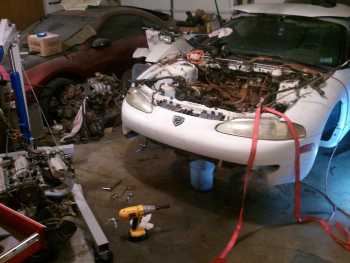

this poor car has seen some stuff in its short life. hasnt ran for about 10 year. had hundreds of mice living, dying, crapping, giving birth to baby mice in it. it's zombified rotting corpse SHALL live again. here it is today.
motor out, probably put the spare 7 bolt in the background in after giving a full tune up, replacing some wiring, most all the hoses, the interior is mostly gutted, partially cleaned. it will be my DD in a couple months.

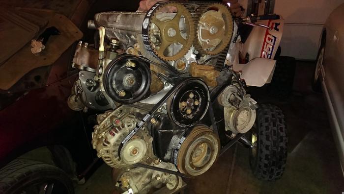

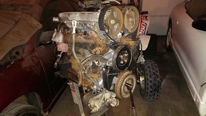

the pulled motor ended up being questionable so the spare will definatly be going in after a light tune up. it is mounted on my engine stand. motor mounts where in FAIR condition so i filled between the gaps with window weld, salvaging as much of the OEM rubber as possible.

moving forward i should have a good start on the timing job this weekend. also i need to swap over the A/C compressor. test the starters and decide rather i will reuse one or put a new one on for piece of mind. same with alternator. the A/C clutch needs replaced, the compressor seems to be fairly new, and they are expensive, so i will be re-using it and hoping for the best.

engine going back together. new timing components, new oil pump. need to fix a big dent in one of my oil pans and then mount the pan and turbo, and the rest of the accessories. goal of running installed engine by DEC 1.

i might actually try stuffing the motor back in this weekend.
provided it fires up i will work on getting tags and insurance and a new windshield. the windshield is cracked up enough that it would get me a ticket.

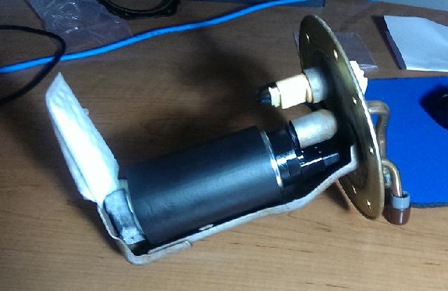

Don't forget that rubber seal going around the mounting bolt holes on the fuel pump hanger assembly.
Looks good Keep it up!
yeah it was actually in good shape. grimy but not rotten. i cleaned it up and it is installed on the hanger already.
