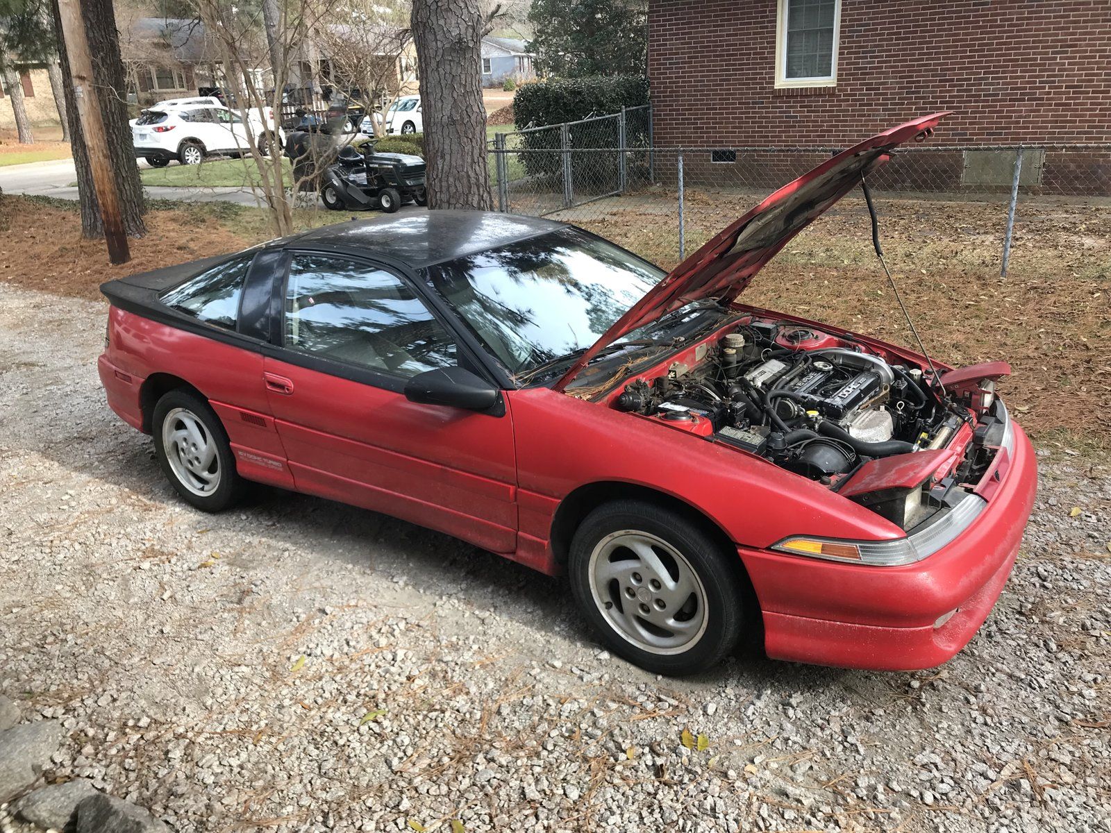

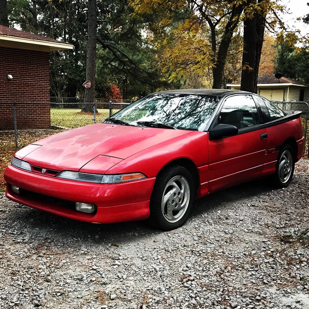

Picked this gem up about a month and a half ago from a guy up in Greensboro, NC. He was the second owner and had obtained it from the original owners estate sale. The car was a little rough around the edges but it ran good and I took a chance and picked it up. Since then I’ve just been focusing on the maintenance aspects of it. The car sat for 5 years before the guy I bought it from brought it back to life. He put a new fuel tank in it, had the computer redone by ecmlink and changed all the fluids in the car.
So I started where he lift off. I took the car around the block a couple of times trying to find anything I could wrong with it to begin making my list. These are the first things I have done to the car so far...

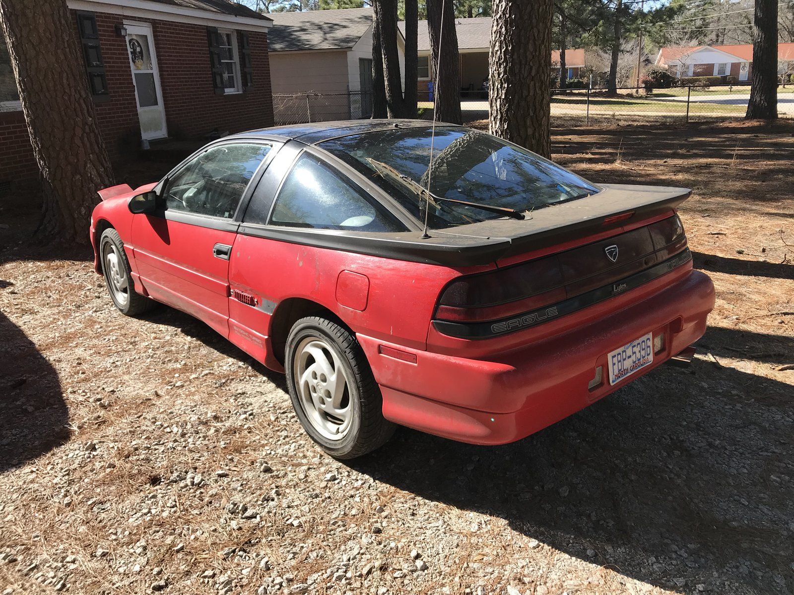

It’s now currently in the body shop getting a fresh coat of paint, while it’s in the shop I’m going to do a little bit of parts collecting so that when it gets out I will have some work to do. The plans for it when it gets out...

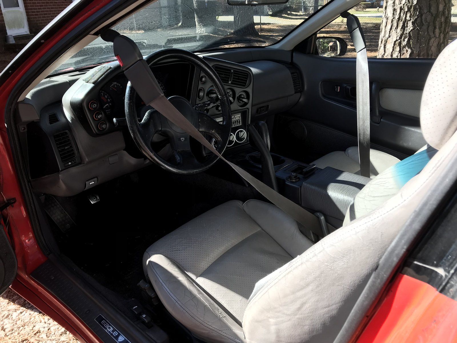

I’m excited to continue this build for sure, I’m anxious now that it’s not in my yard when I walk out in the morning, but I’m excited to get it back with that great coat of paint on it as well. The next plans after I do those things is to get the driver seat leather repaired. Gonna keep it close to stock looking as possible for now.
