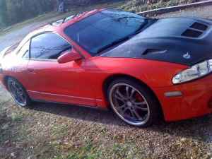

I've had the car since 2011 and picked it up for $2,500. Here's the craigslist add photos!

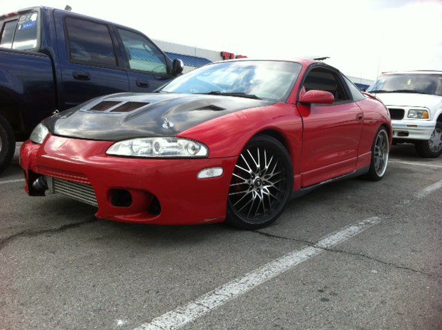

When i first bought it, it already had some decent mods.
-Walbro high pressure 255lph pump
-Safc2
-550cc injectors
-14b
-exhaust
-act 2600
-front mount

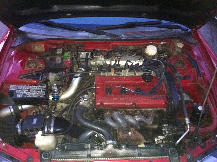

It needed some TLC but was fairly solid for the price.
Here's some pics of right after i got it!
Notice the god awful 19's? these were heavy as SHIT! and then there was the one mismatch rim:ohdamn: (was that way when i bought it)
WHAT A MESS!!
Shortly after getting it, i picked up some enkei 16' rims originally for an RSX and with a little modding, they fit like a charm!
Oh yeah, that dent in the door? lets just say my neighbors were idiots....:idontknow:

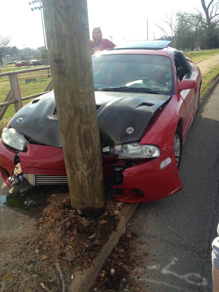

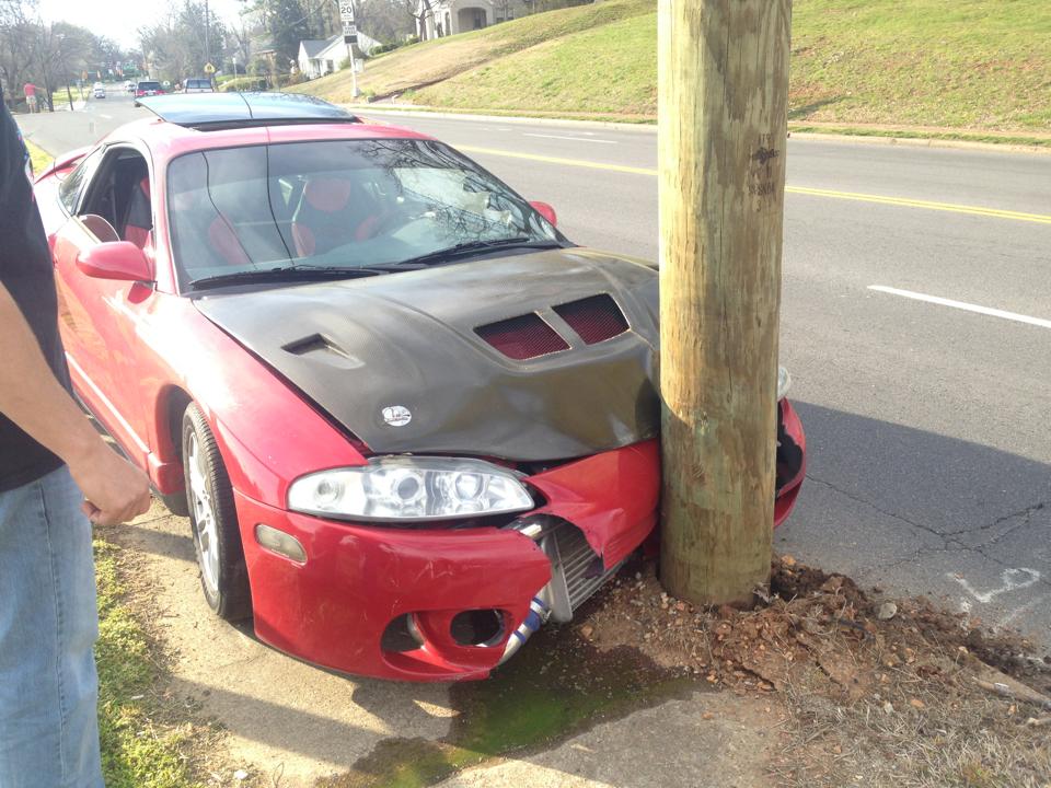

In April of 2013, while going through a divorce, The worst possible thing happened.
A lady who was too impatient to wait for someone turning in front of her, swerved into my lane. My brakes locked up and i slid right into this telephone pole. Luckily i was ok. a few bumps and bruises is all i got. Well... that and a ticket. The cop was a jerk and said it was my fault(even though there were several witnesses that told him the lady swerved in my lane). He said some crap about me not actually hitting the lady made it my fault:f-u:.
Luckily the frame wasn't bent and i was able to repair her after 9 months. While she was down i went ahead and did a few upgrades which is partly why it was down for so long. I went 16g turbo, cleaned up the engine bay, Deleted the a/c and power steering and all lines, aluminum radiator and slim fans, 2GB bumper/skirts conversion. below are some pics of after i got her back running. she wasn't exactly where i wanted her to be. but after 9 months of not having a car. i did what i could.

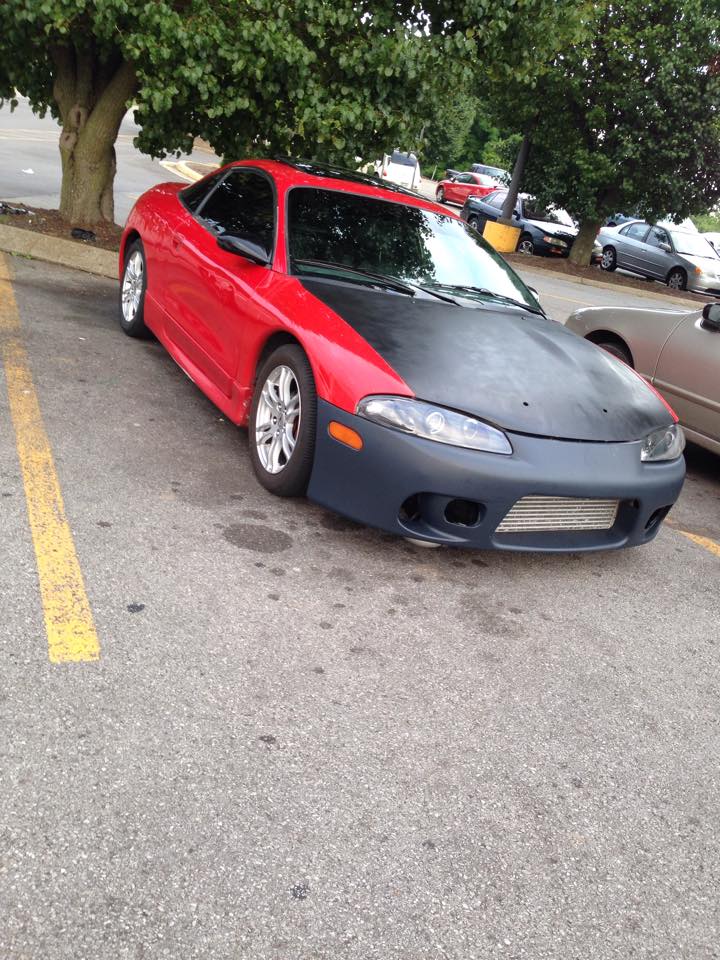

FINALLY got the stock 5 spokes and a new door to replace the dented up ones and a RED hood instead of the plastidipped black hood!

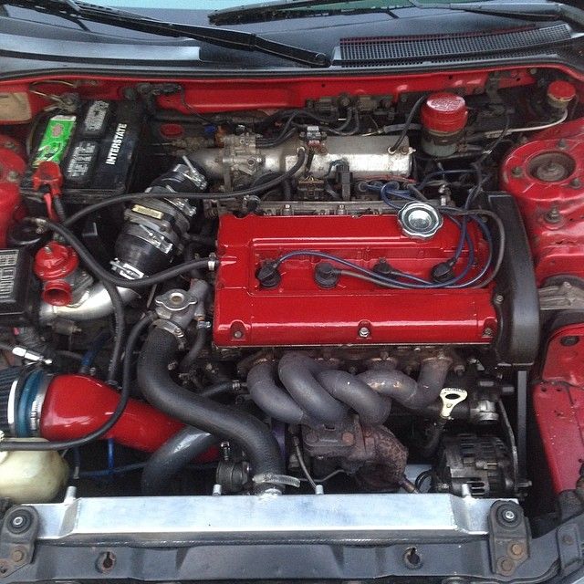

After my divorce i was able to start putting alot more money into the car. and bit by bit she was starting to come together nicely
After my rebuild i had gotten a Harness bar and some nice Sparco 4 point harnesses and some other odds and ends and was really impressed on how quick the car was for just a 16g! i was very proud and contect with how she was turning out!

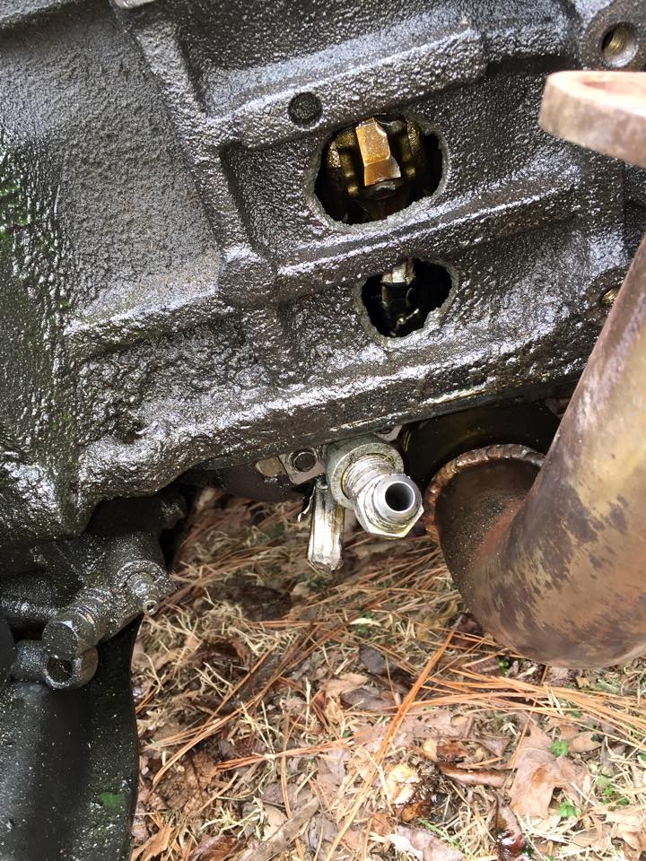

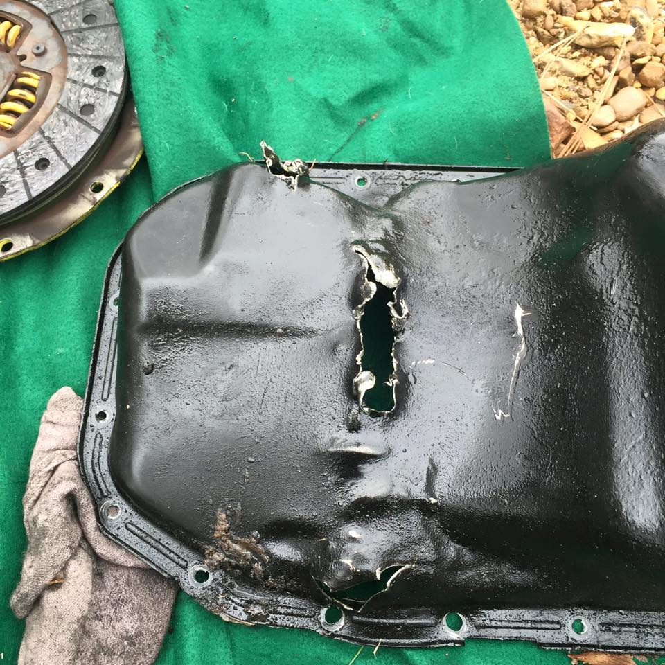

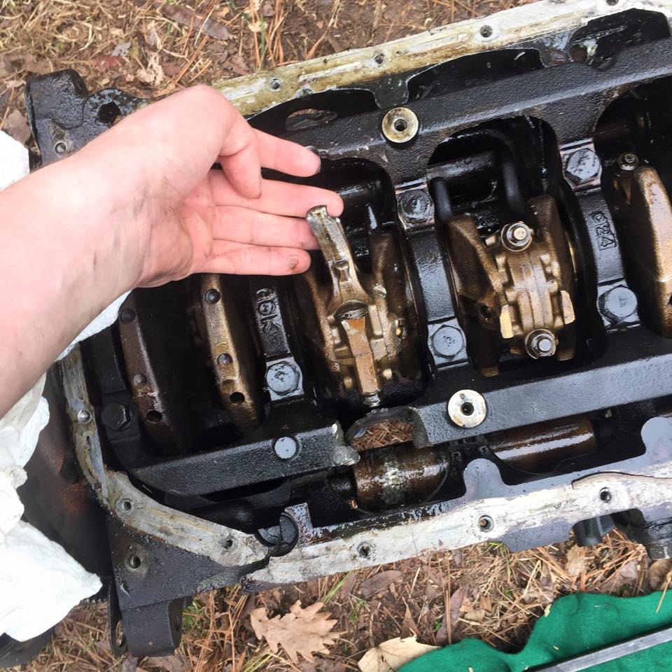

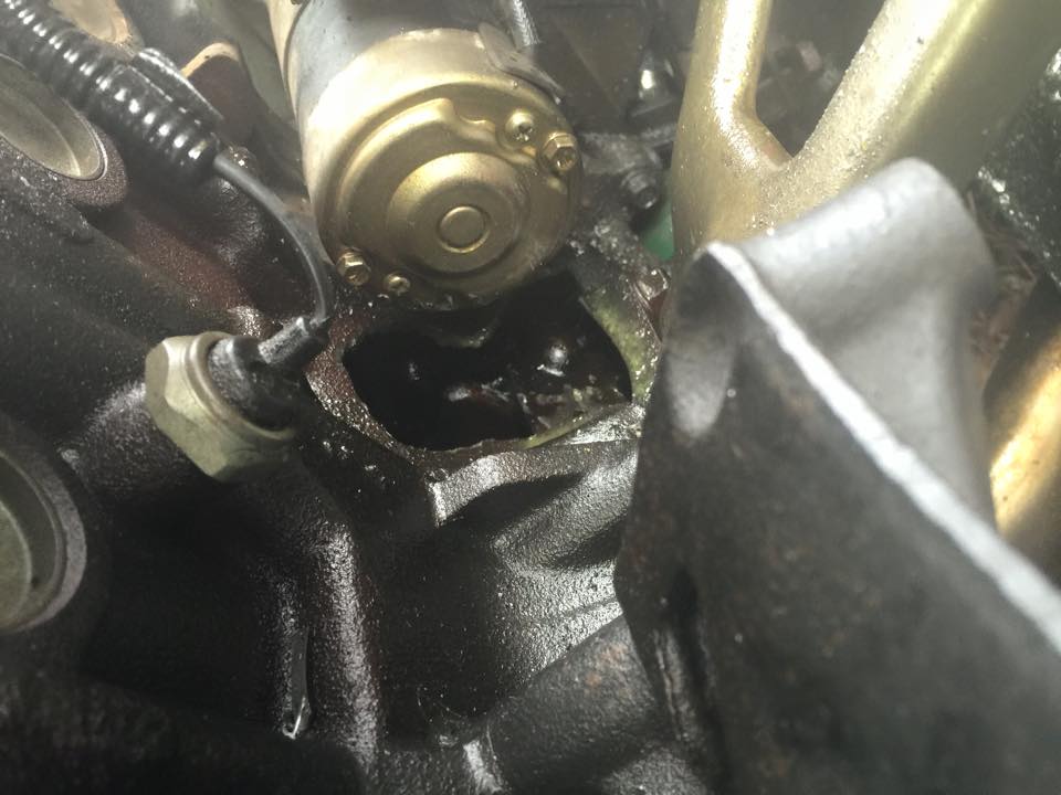

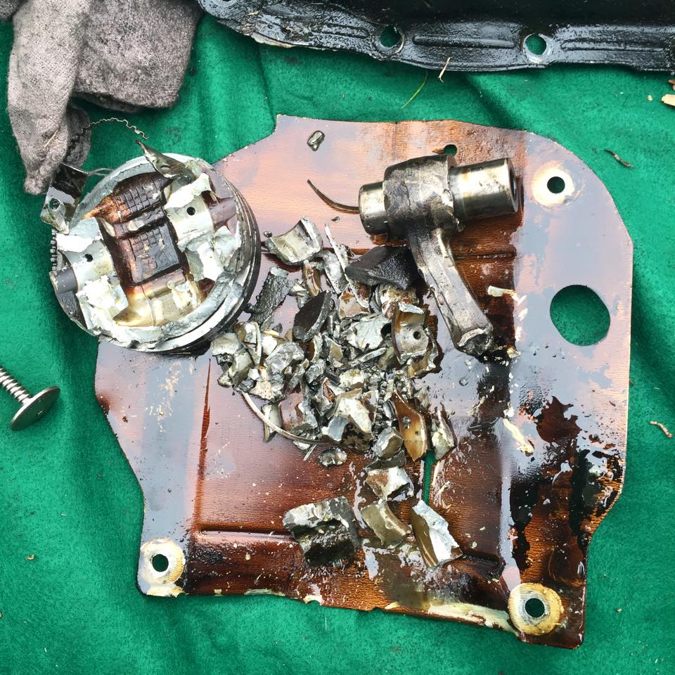

In the beginning of 2015 after 219k hard driven miles and seeing 20+lbs boost daily. the stock bottom end finally let go:D:applause:
I couldn't even really be mad. i knew it was gonna go eventually. When she did let go i was in 3rd gear and only starting to build boost when i heard a snap crackle and pop. i immediately put it in neutral and heard chunks bouncing off the car. here was the damage!
It was Gnarly! and i love it!

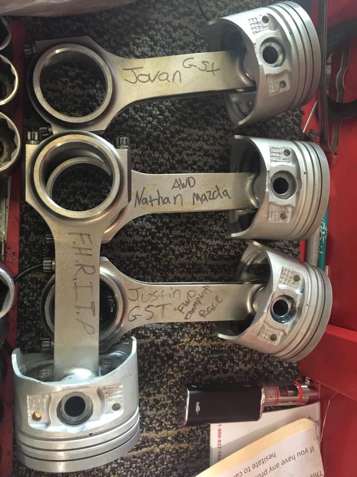

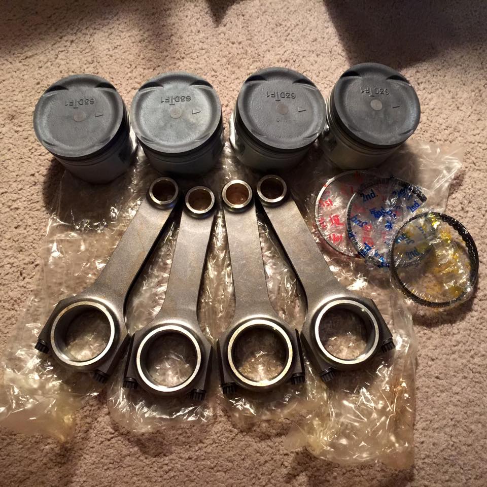

After i took out the stock block i decided if i was going to rebuild it, i would make a few changes instead of a stock rebuild. I dug my spare block out of my storage that i had pulled from the parts car. I decided to delete the balance shafts and go with some forged rods. I found a killer deal on some Cat rods rated for 800+HP. i went with .20 cast pistons(since they typically aren't the weak point) and ACL Race bearings. For the head i used a spare set of stock cams i had, which are the biggest stock cam they made, and some revised lifters.
and of course, there had to be a little friendly shit talk to a few of my buddies.
After a few months she was back and running and was now powered by a 20G turbo!

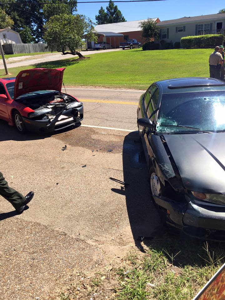

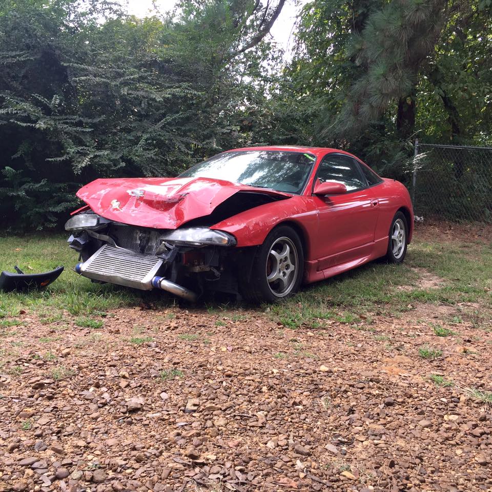

September 2015.... what a month... I was taking the son out for a cruise since the weather was great and i had just dialed in the tune on the 20G, and i wanted to relax and enjoy the car and the weather. I live out in the country so there's tons of back roads to just ride around on. I pulled out of my driveway and about 2 miles down the road this happened....
First and foremost. The son and I were ok. I had some bumps and bruises and Parker was a little sore from the seatbelt. The lady in the saturn turned in front of me trying to get into the gas station and i had little time to react.

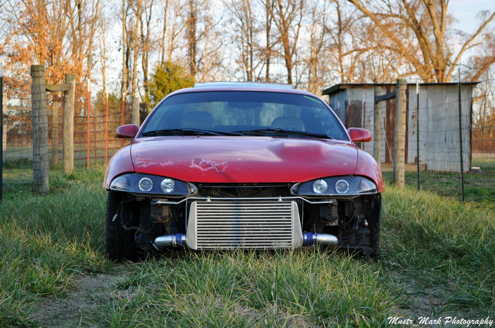

After the insurance did their thing i was finally able to start the teardown to see how bad the damage was. and it was alot
Things that needed replaced were
-Intercooler
-Radiator
-Core support
-Headlights
-Oil feed line for the turbo
-J-pipe

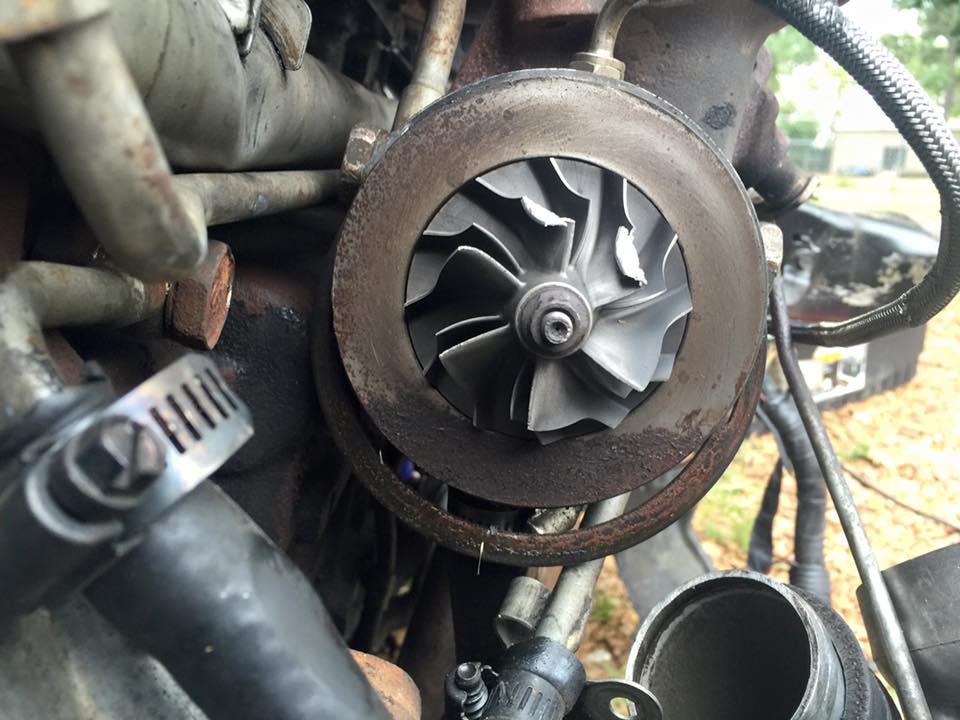

-and the turbo:banghead:
broke/bent the fins on the compressor wheel. and broke the lip on the CHRA for the clip that holds the compressor cover on.
Since then I've been gathering parts to get her back together and I'm going to go back to my old 16G until I can get the turbo i REALLY want, a HX35. I'm pretty close to getting it back together. I'm going to be making a few changes to her as well as a few other upgrades that i'll post about later. She wont be as pretty as she was before at first, but with anything, it just takes time. it sucks to have this kick in the face after getting the motor back together not long before this happened. Thats life i suppose. stay tuned for updates guy. And remember, Stay Classy America

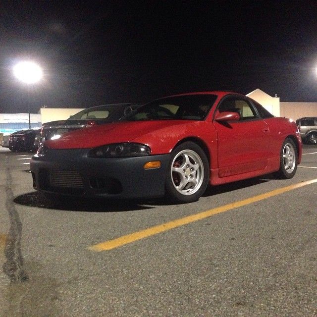

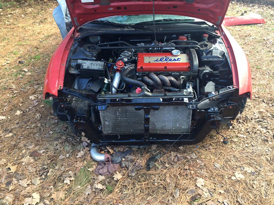

I was able to get around to knocking a few things out on the car this weekend. A good buddy of mine was parting out a car and hooked me up with a core support and radiator and a pair of 12" slim fans.
After i prepped the core support and slapped a fresh coat of paint on it i was able to get it on the car and set the radiator in it.
I also wired the fans up to be pusher fans that I will mount between the radiator and intercooler. I still have to mount those and clean up and paint the radiator brackets to complete the cooling system.
I went ahead and got another set of fenders on the car. my original ones were a little rough and after the wreck they were tweaked out of shape.

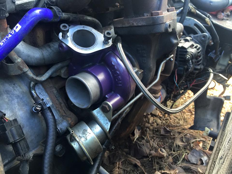

I also got my old 16G cleaned up and mounted back on the car. and also installed a spare oil feed line i had laying around since the one i originally had on the car caught on fire in the wreck when it got pinched between the the positive stud on the alternator and the core support itself.
the best part of this weekend is i was able to start the car and let it idle for a few minutes. And man did that feel good to hear!:hellyeah:

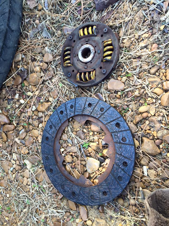

I get all that done and get to drive her for a whopping 2 days before this….

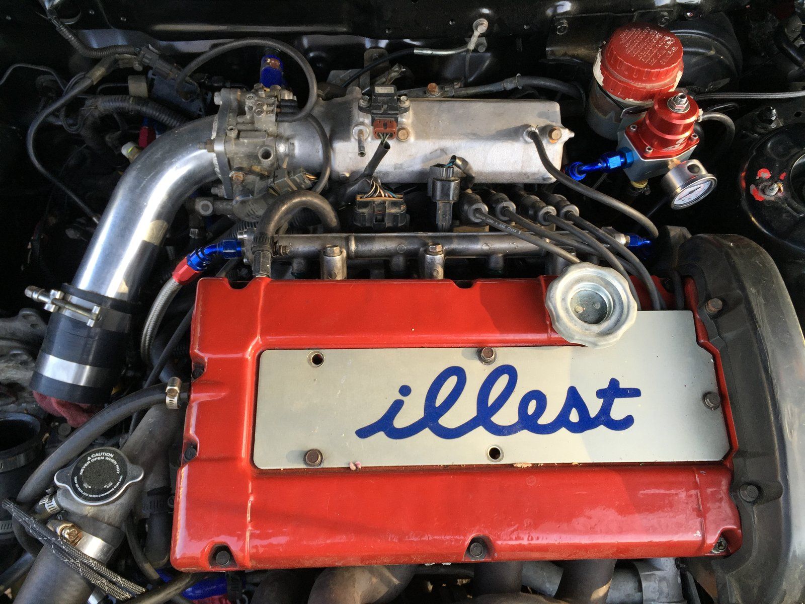

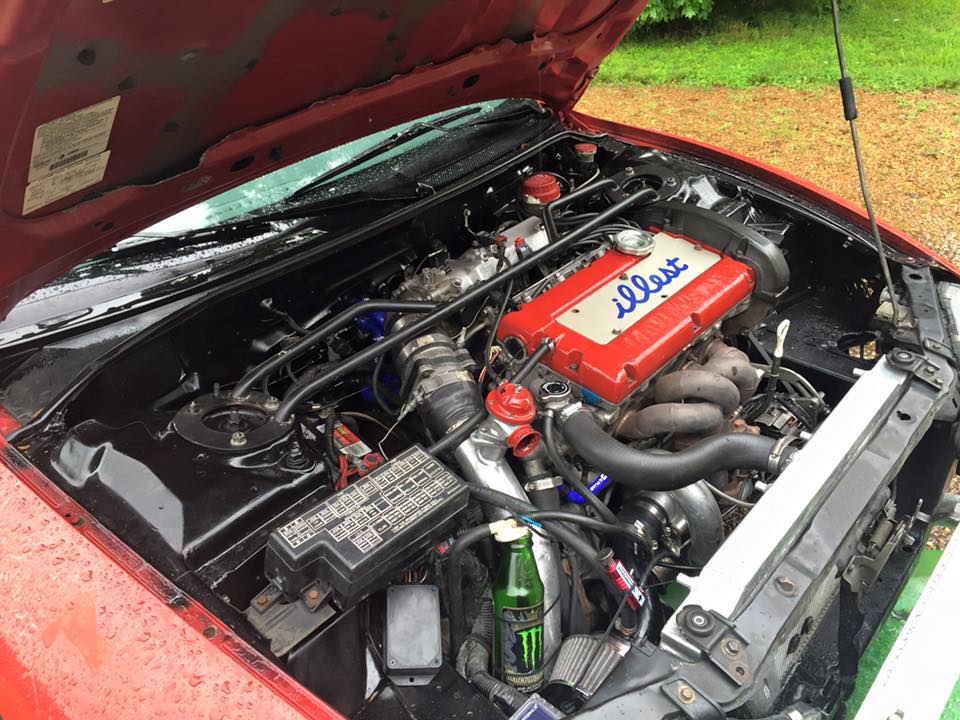

So I finally get that sorted out and go with an unsprung ACT 4 puck and HD pressure plate.

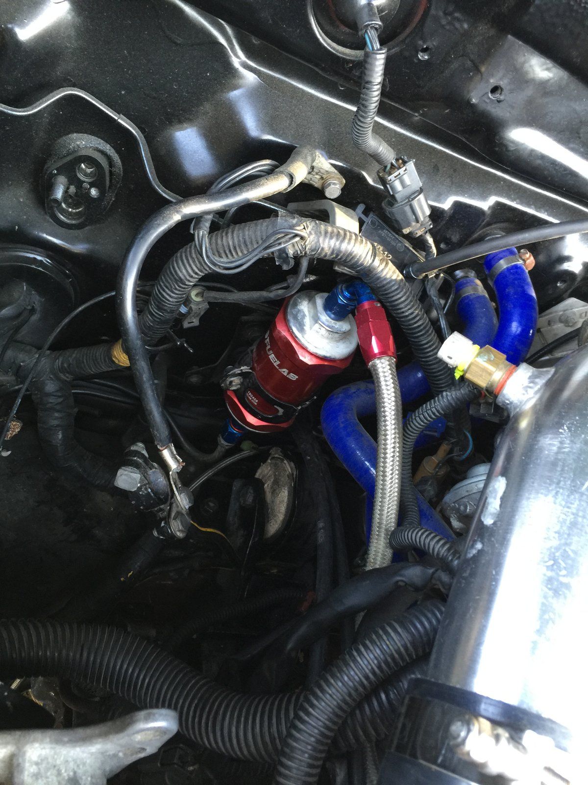

Heck, I even get a few more things knocked out:

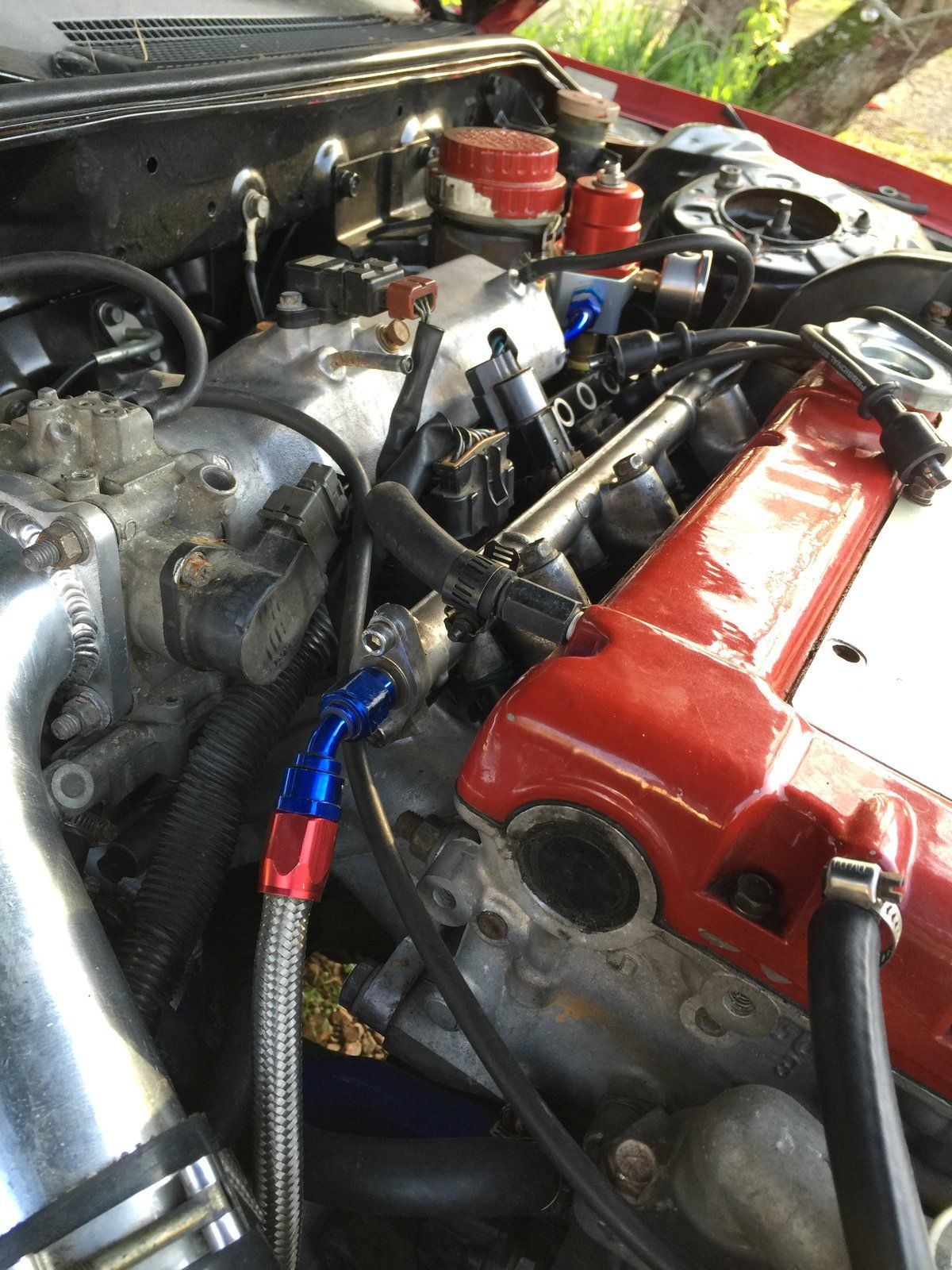

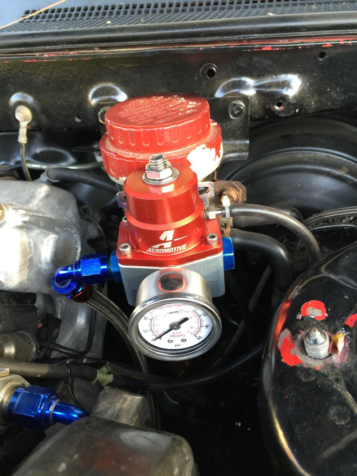

-Installed GM IAT and Omni 4 bar
-Installed 3 port boost solenoid
-Installed 1000cc Injectors
-Installed Fuelab fuel filter
-Installed Aeromotive AFPR with braided lines from filter to rail, rail to AFPR
I’ve been tuning her and about got it all sorted out. I can honestly say I’ve fallen in love with her all over again. Never has she pulled this hard, ESPECIALLY for only having a lil ol 16G. I’m honestly impressed with how she’s running. In fact, she’s running so good that one of my buddies with a 20G is racking his brain trying to figure out how the hell I’m flowing more LBS/MIN than he is. But that’s my little secret ;)
