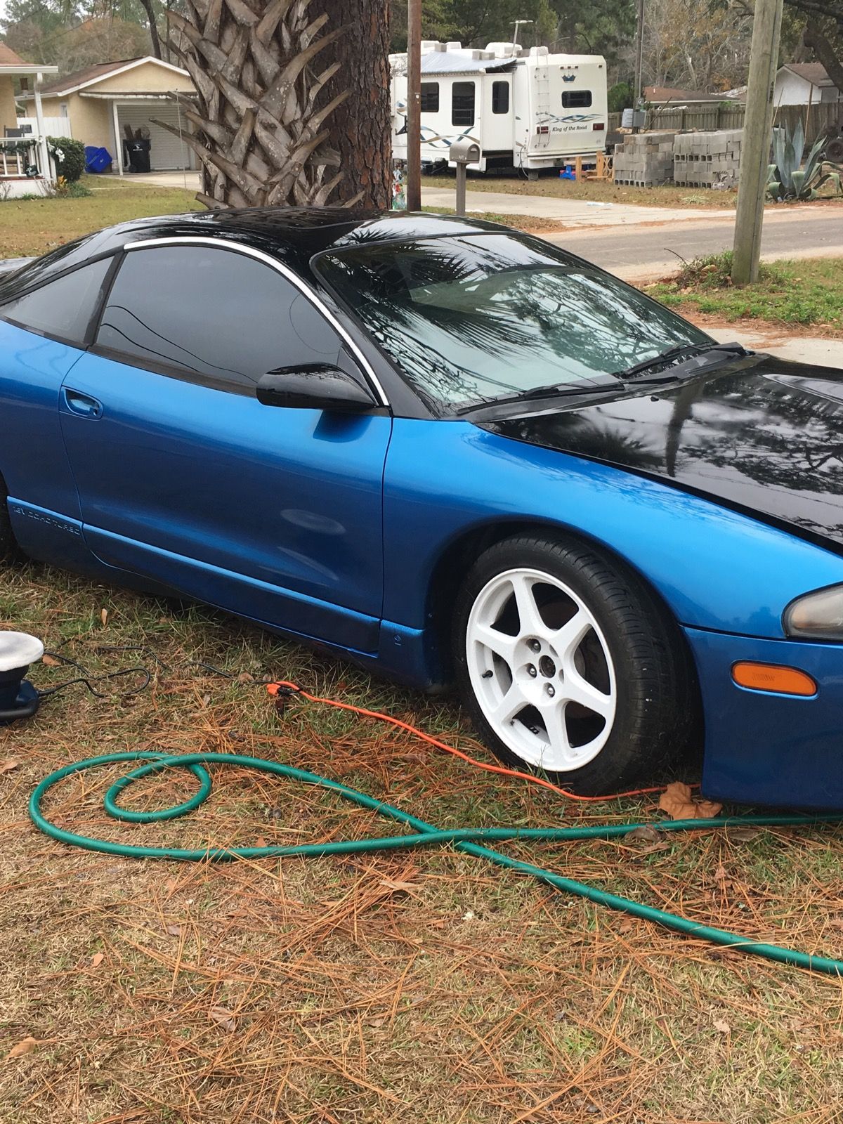

I spent all day Sunday December 18th, 2016 washing and waxing my car. It was a big job only because I had to remove a lot of sap from the pine tree in my front yard. Felt great after I was finished, and the car looks amazing now. Plan to remove all four wheels weekend after Christmas so I can clean them really well, and while I am at it clean the wheel wells. Should have her running the week after Christmas so I am super excited to finally be driving her after she has sat for the first six months I have owned her.

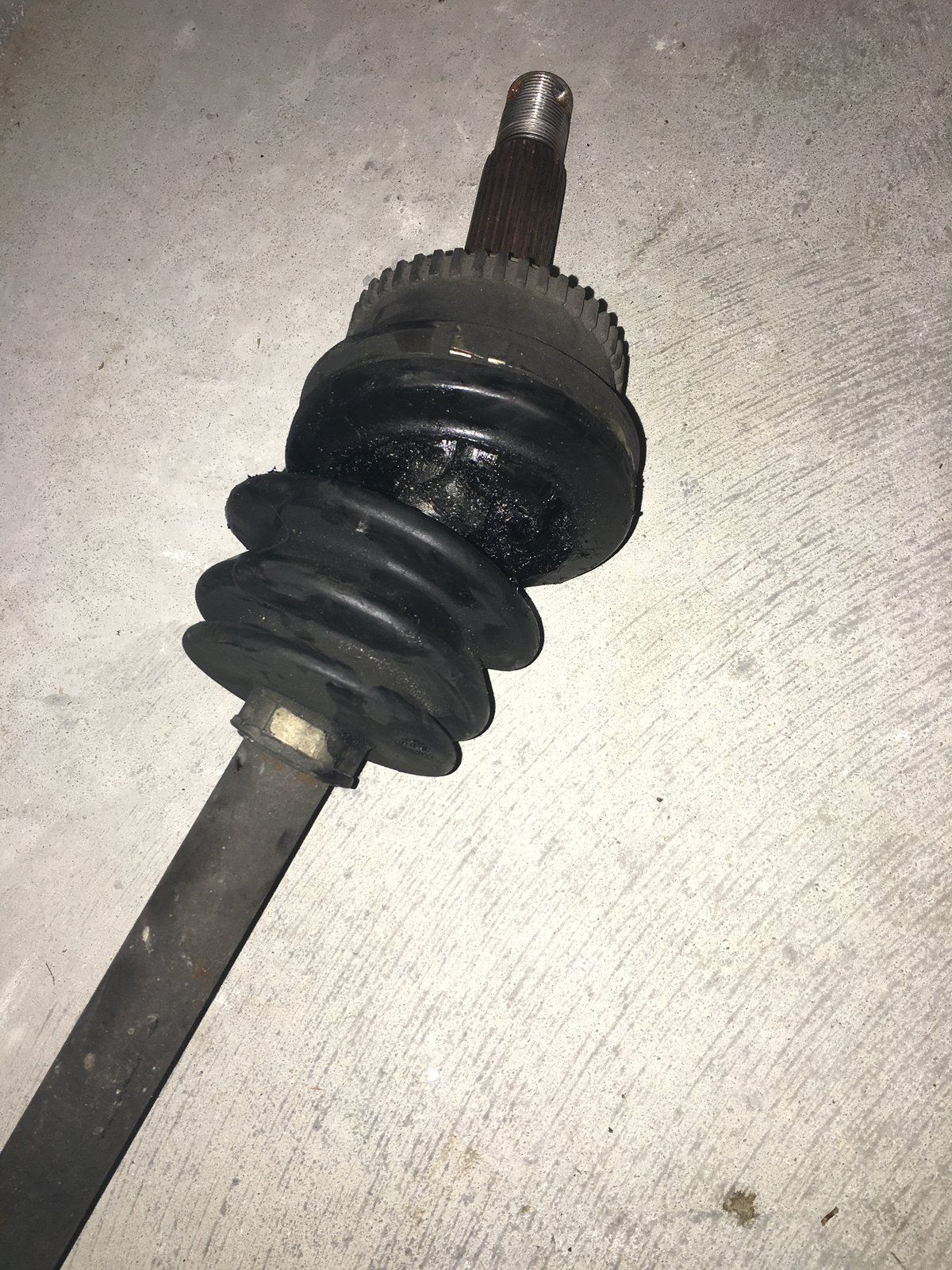

Finally getting to work on the car. Had to buy a shed so I could clear out my garage. Anyways on to the update, I got the transmission pulled Monday, and learned that the car has a Fidanza lightweight flywheel so now I gotta save to get a new insert for the flywheel before I put my stage 3 Comp clutch in. While pulling the transmission I found my drivers side rack and pinion boot obliterated, the drivers side CV Axle outer boot split into two pieces with no grease left in it, and found both passenger and drivers side ball joint all bad. Also, the Fidanza flywheel looks as if the previous clutch exploded because it has scratches every where. So, I have some things that I need to fix before I get the car going again so kinda bummed that it won't be running this week. I will update with pictures here soon.

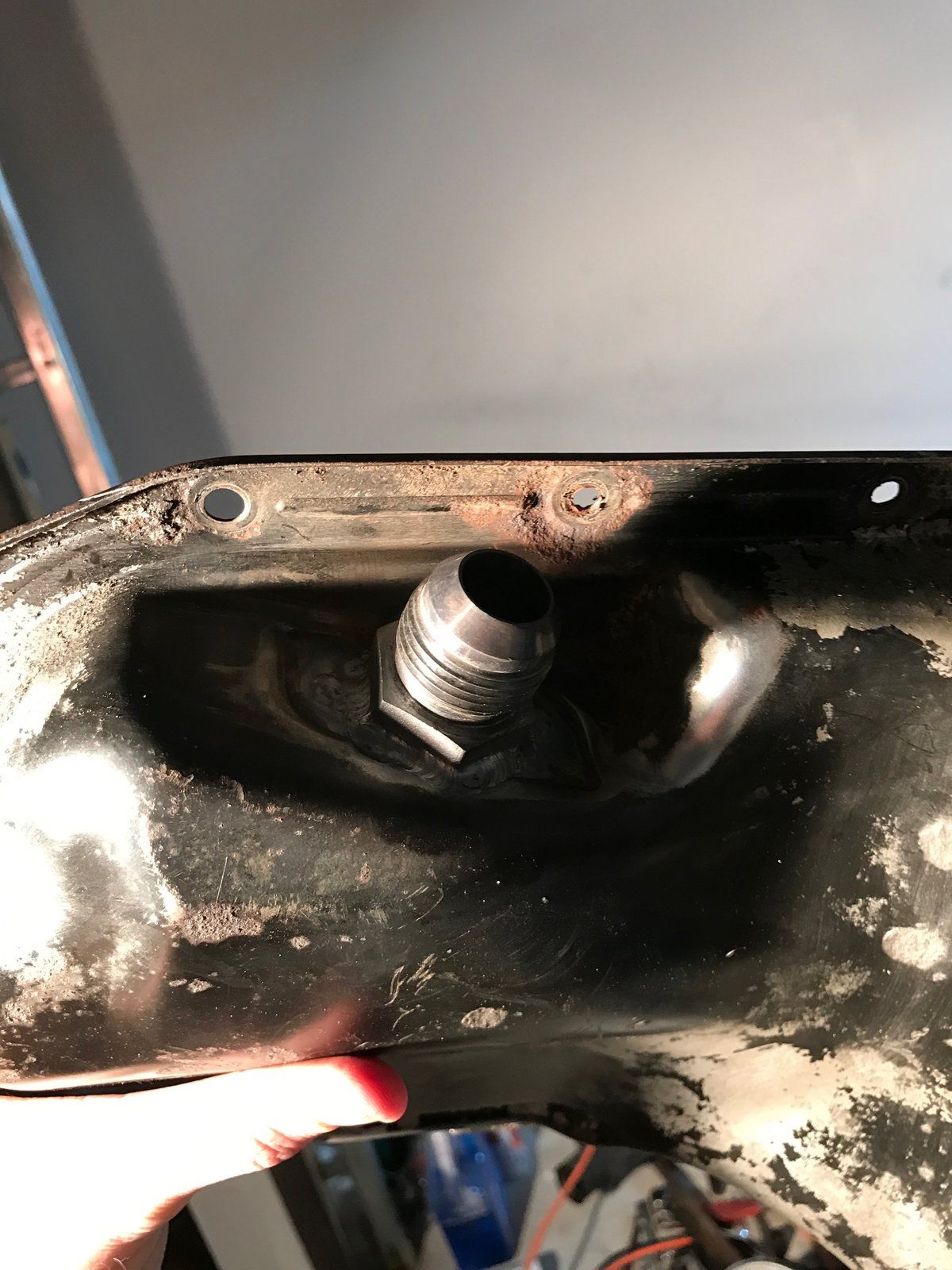

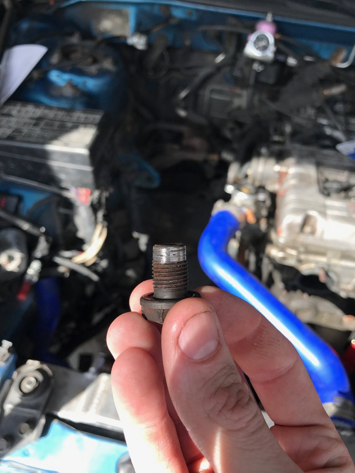

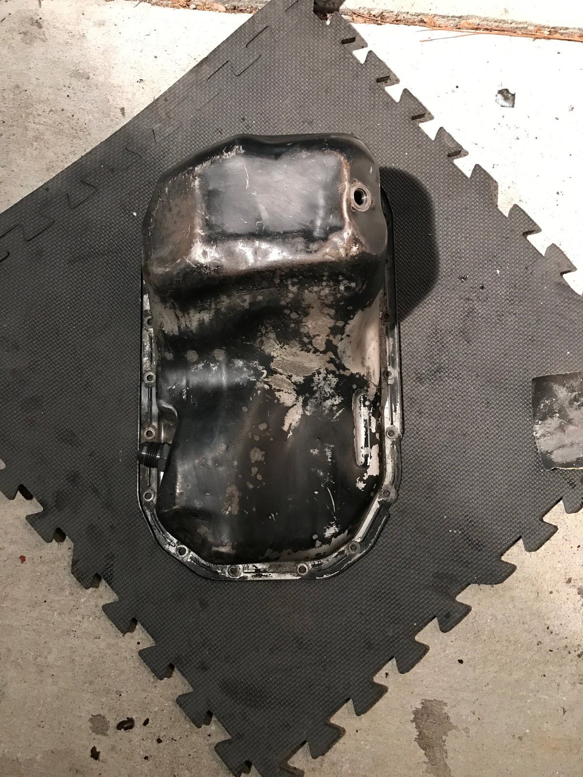

Okay have a small update for tonight. I got my M12-1.25 Tap in got all the flywheel bolt holes tapped, and installed new OEM 6-bolt flywheel bolts. Snapped a picture of the stripped bolt and I figured out why the bolt stripped. The previous owner used 7 Bolt(20mm) flywheel bolts instead of 6 bolt(22.5mm) flywheel bolts. So, finally got the transmission back in last night. Today I got the oil pan pulled and had a buddy of mine weld my -12an fitting on for the proper oil drain setup for a holset.
Here is the stripped flywheel bolt(20mm)

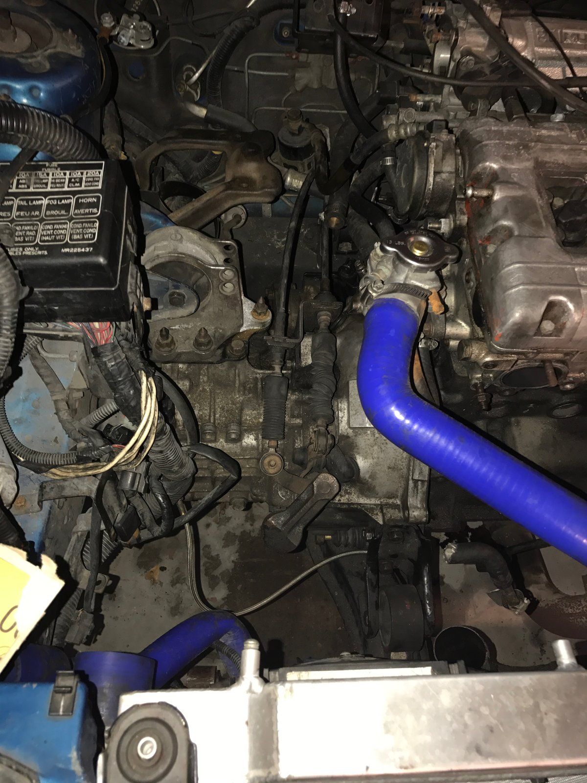

Next I snapped a picture of the transmission back in and torqued down.

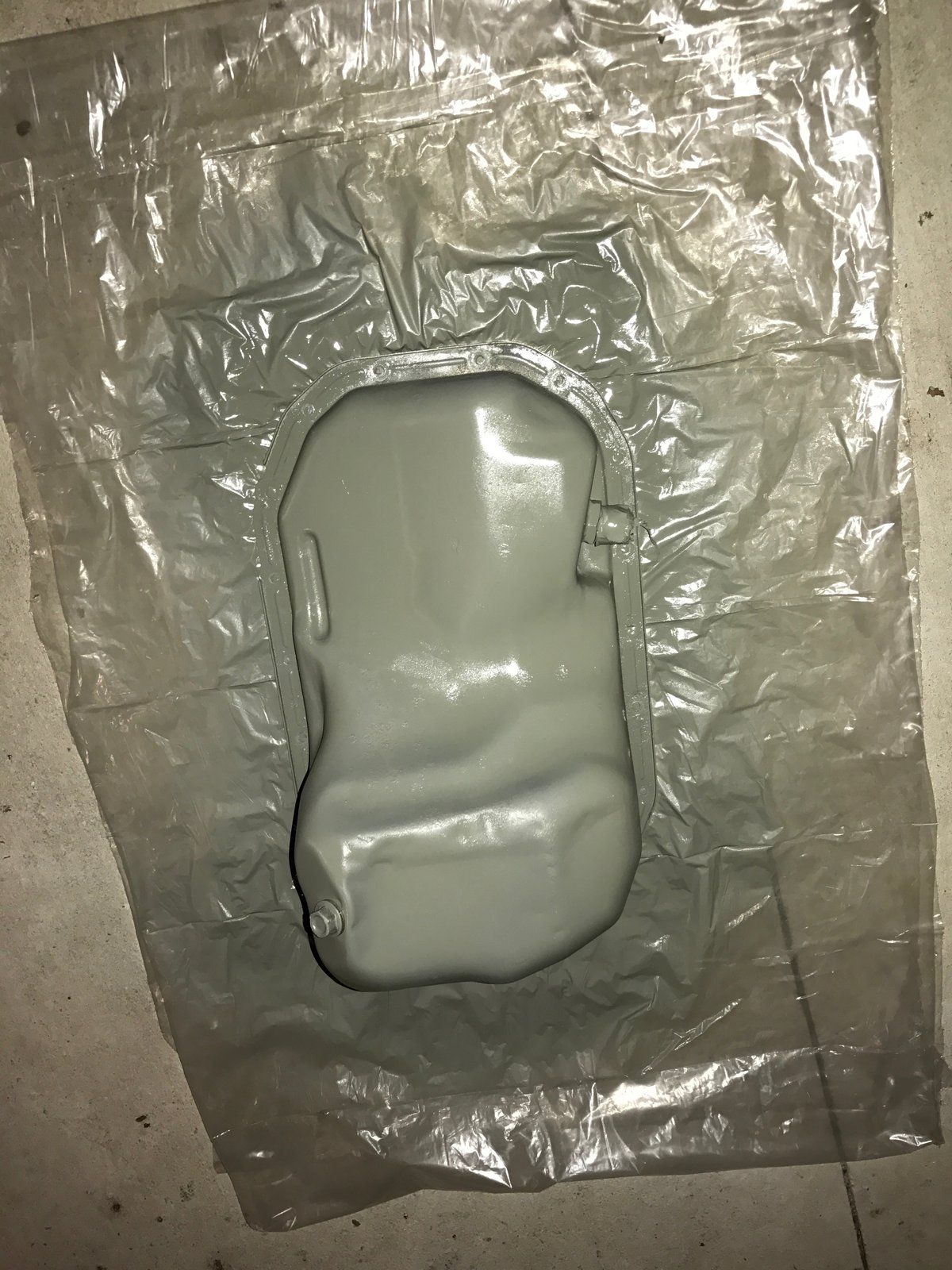

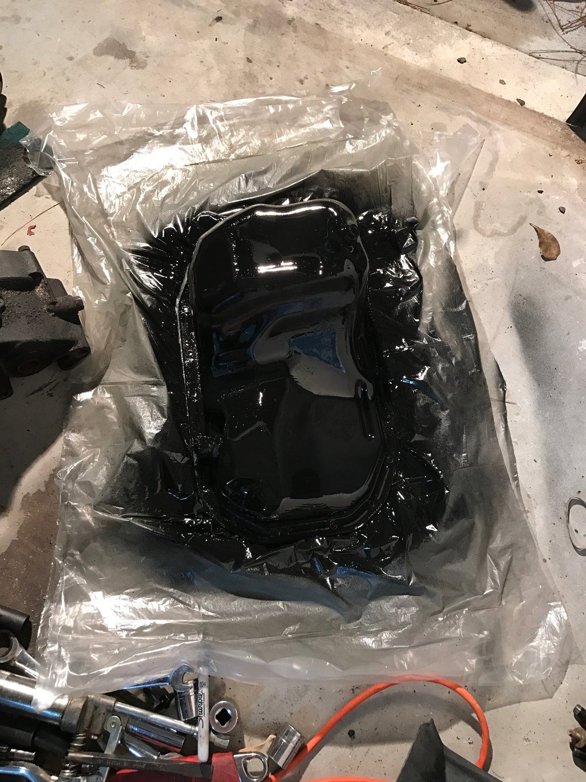

Next are Pictures of my oil pan which is in progress still which I will update with a final product tomorrow. I used Rust-Oleum Self Etching Primer and Rust-Oleum Black High Temp Paint.
More to come soon I will be installing the HX40 Pro and -12AN Oil Drain setup done right.
Okay my update for tonight doesn't have but one picture as I was working hard to get as much as I could done. Anyways the oil pan was dry and I was at the point where I could handle it so I got it installed. Then, I got the transfer case installed along with the drive shaft . After those were installed and torqued down I went on to install the axles after cleaning, greasing, and installing a new boot on the drivers side axle as it was torn. I got the axle nuts on and torqued down then moved onto getting the LCAs installed and tightened down since there is no way to get a torque wrench on it(I don't own any crows feet). Then, I pulled up on the whole assembly to put the bolt for the bottom of the strut on then torqued those down, and that was all the time I had tonight. I did happen to snap a picture of the oil pan before I threw it on.
