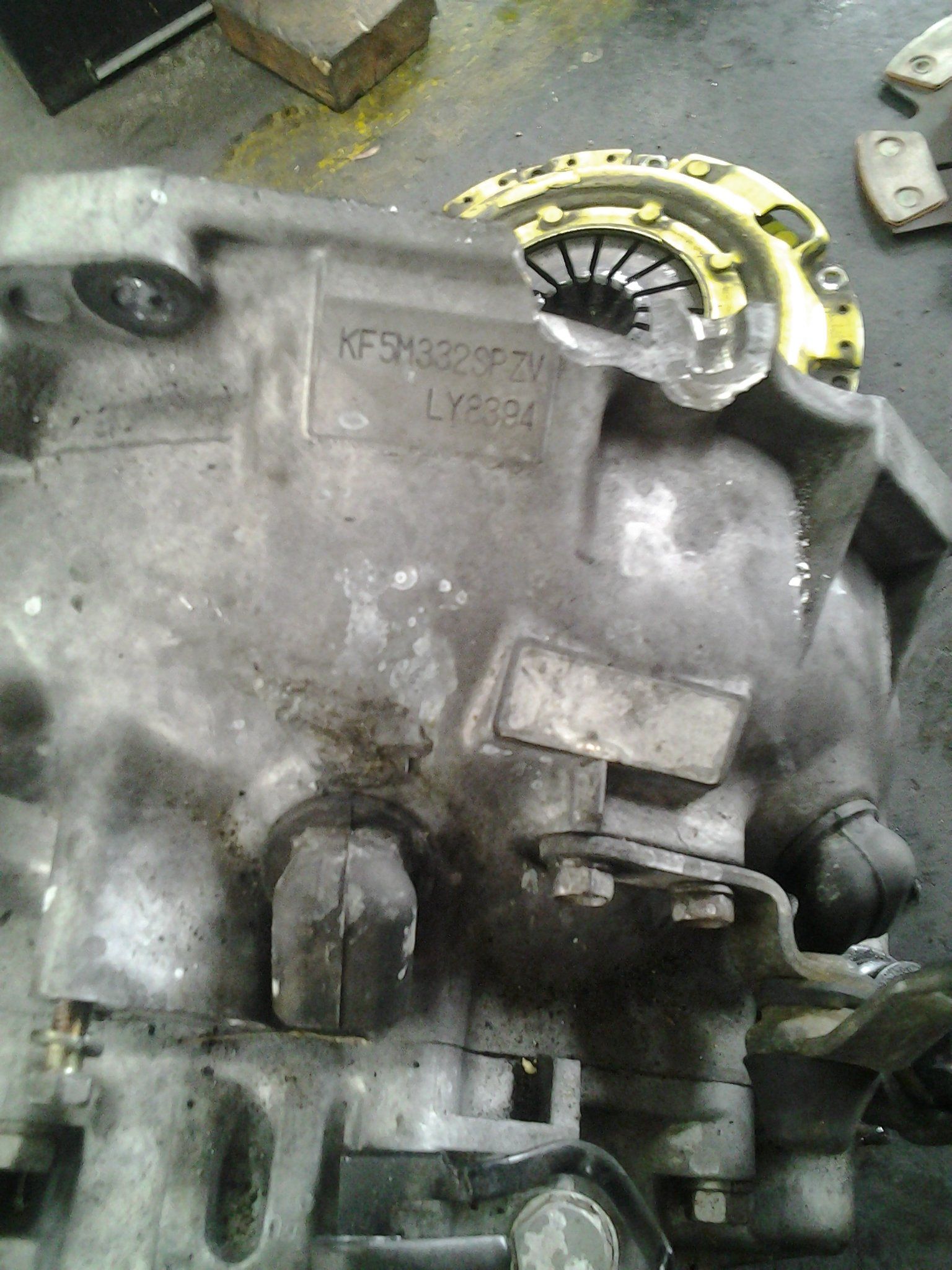

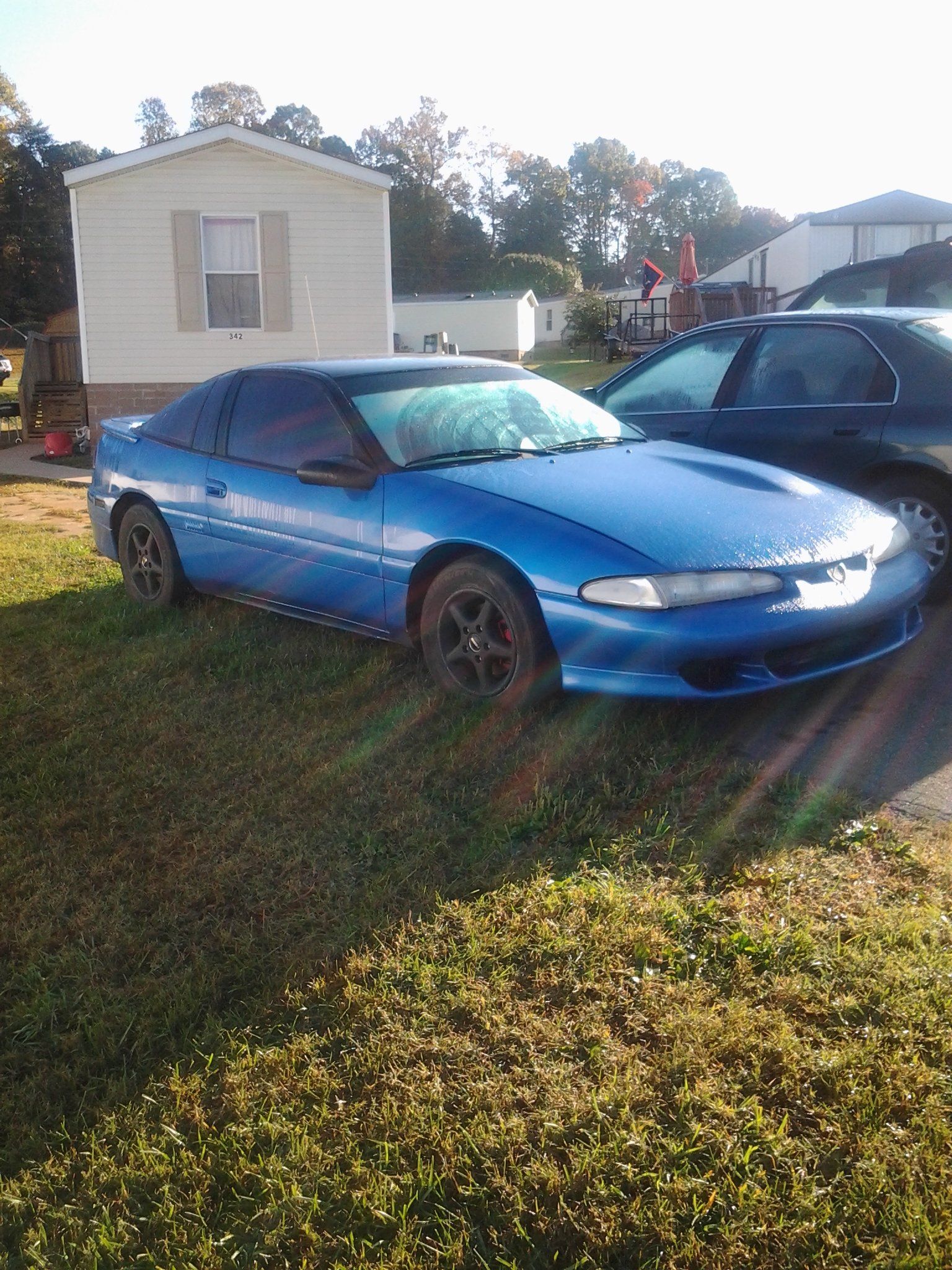

View updates to this DSM profile...[DOUBLEPOST=1414337104][/DOUBLEPOST]So this is kinda wht happened n a nut shell, had a notchback fox w/ a 5.0 tht had a ton o time and $ wrapped up n it, but ive always wanted A) a turbo car and B) a 1g. So i started searching and after months found this beauty on craigslist and traded even for it, previous owner had taken decent care of it so i started out w/ maintenance. Changed all the fluids, inspected it from top to bottom for any issues. I found the e brake cable on the pass side was froze, the struts r worn out, (even though it has new springs on it) and some other minor things like oil leaks. It drove for about a month after i got it but something n the clutch hydraulics let go started shaking violently so as soon as i get time and space n my shop ill b tearing it all apart to see wht kinda damage ive got going on. Hopefully it will b soon, i have several customers who havent picked up their completed vehicles and others waitin on parts, but as soon as i have a hole to put it in ITS ON!!!! So stay tuned!!

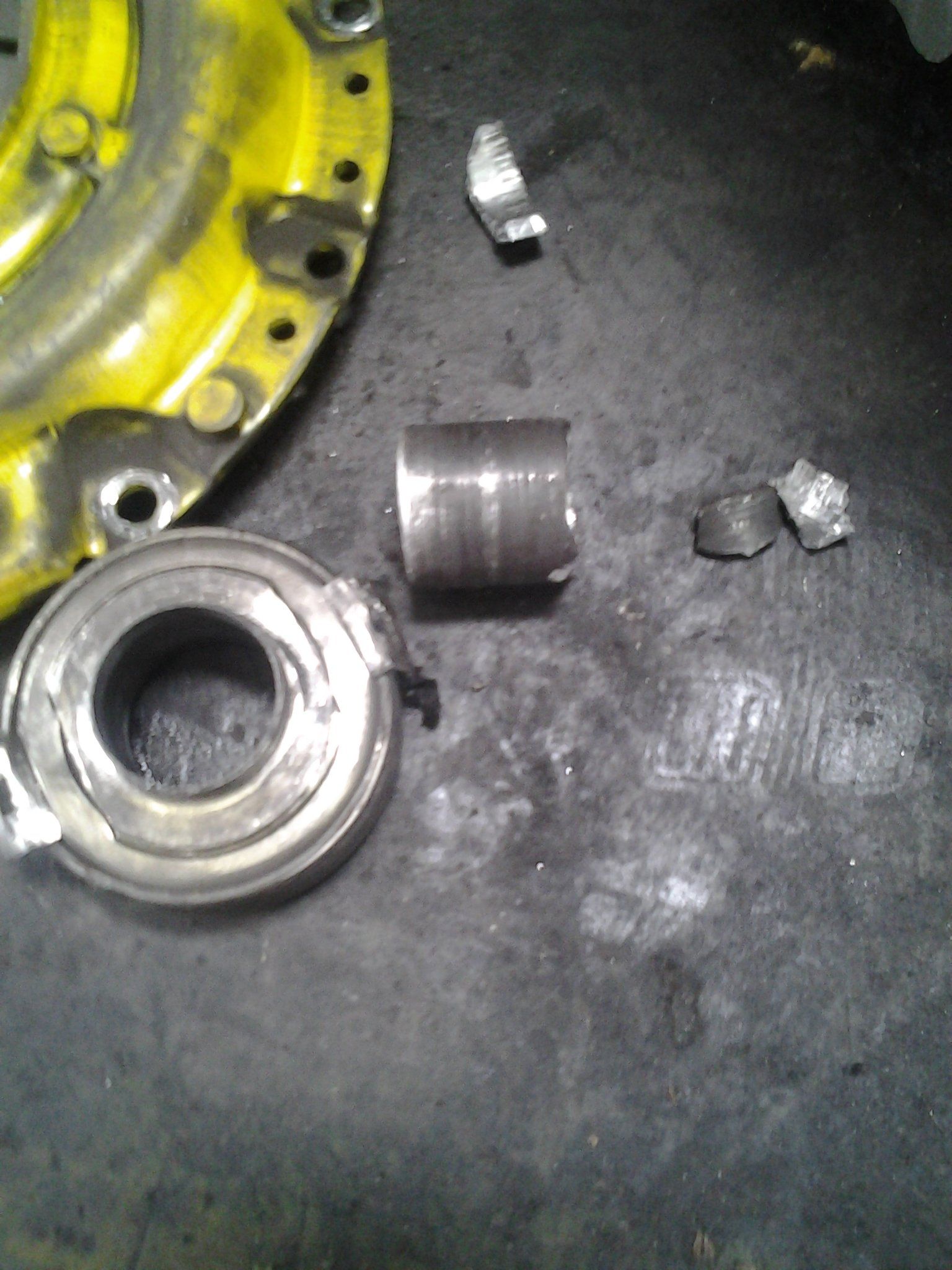

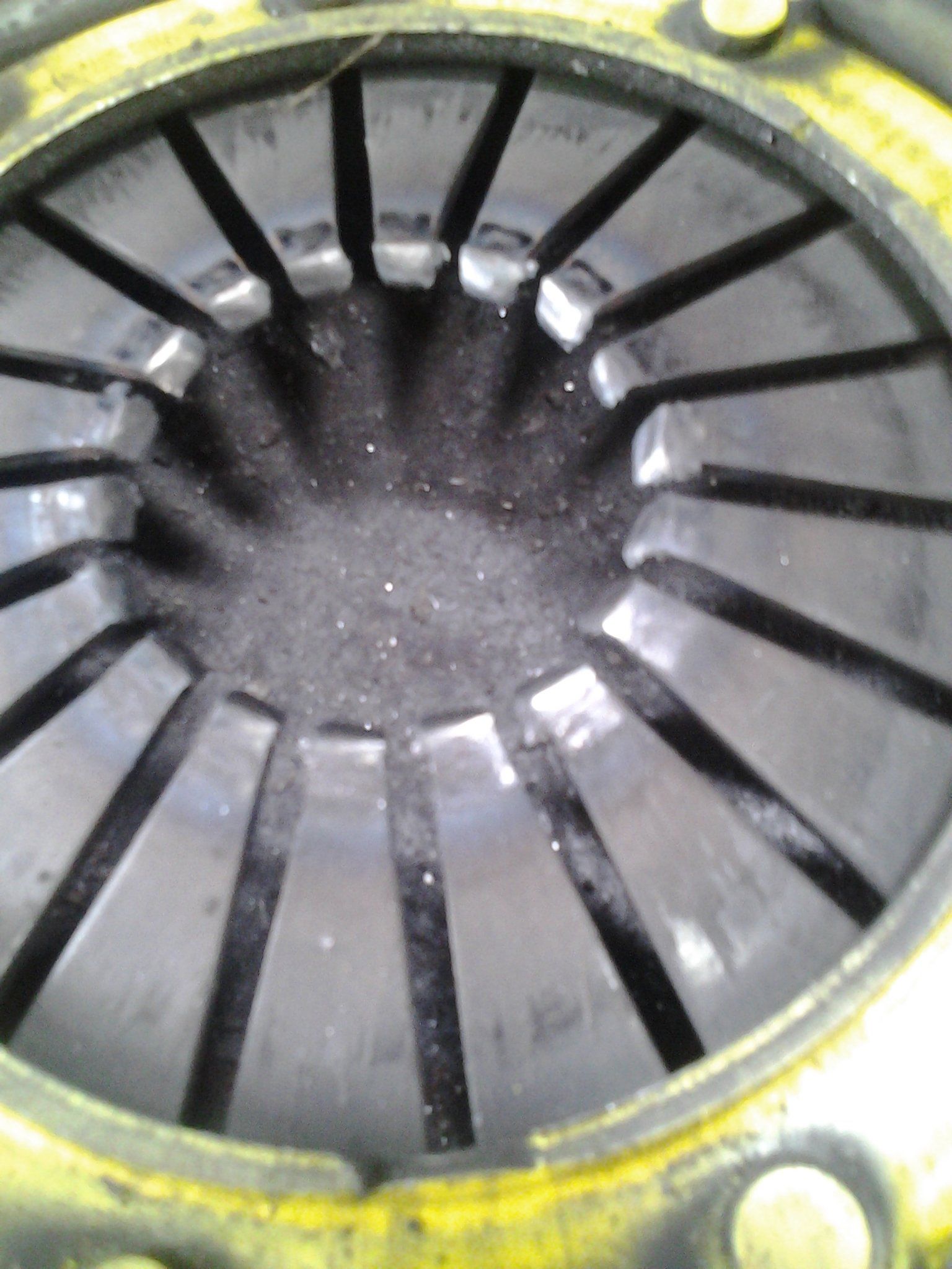

The 6 puck disc wasnt in straight, previous owner installed, i think that is what caused the throwout bearing sleave to shatter apart, thouse chunks were caught inbetween the pressure plate and the 6 puck disc, the ear broke was the result from how violently it was shaking[DOUBLEPOST=1414608375][/DOUBLEPOST]The outer tie rod end threads were aslo stripped out, so ill be having to replace that as well

Finally got the too small ugly 14 inch wheels off and got some 2g gs wheels. They had some scratches and gashes so i sanded them down, resurfaced, polished, and clear coated them. Ill post pics tomorro my computer is being dumb tonite
