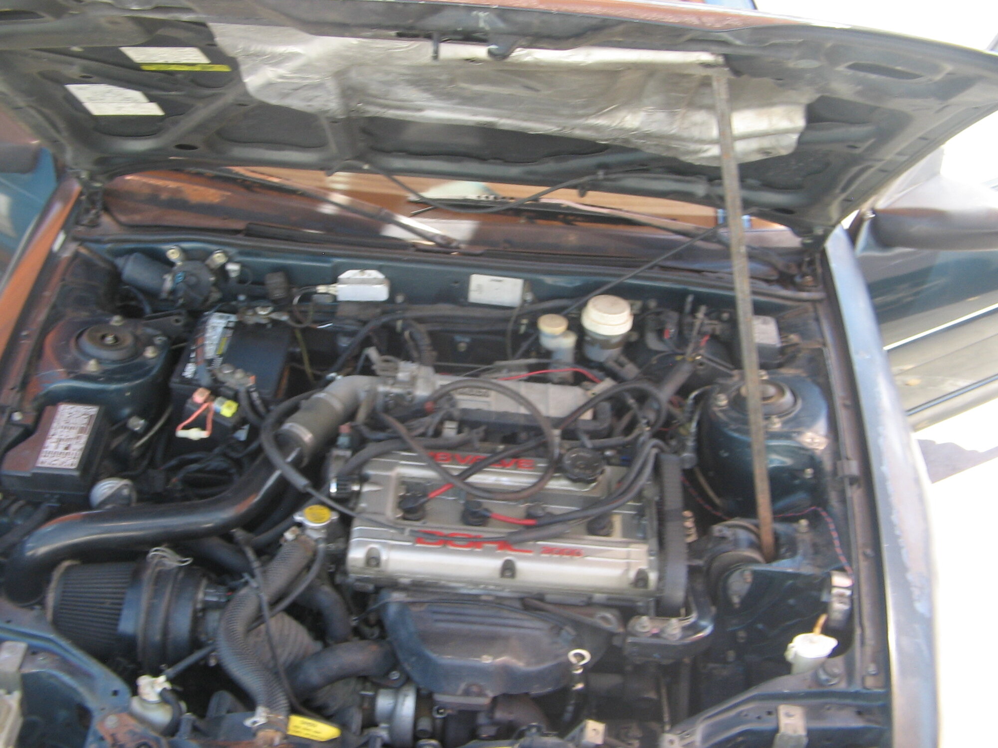

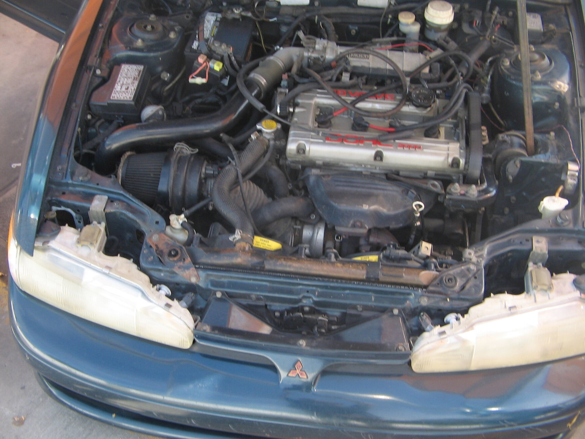

Just got my first DSM, finally made contact with the owner who did the engine mods on my car and he directed me here.
I'm reaching out for help on parts I can get to help make the car look nicer, everything seems very messy and honestly not very interesting underneath the hood to most people.
If there's anything you think I should know please share everything I'm here to learn and would enjoy the support from a community.
-Whey D
Nice! Welcome to hell😂 kidding, these cars are great IF you do all your maintenance before performance! I notice there is an open filter on the side of you valve cover, you'll want to eliminate that and route that back into the air inlet pre-turbo, after the MAS. That being an open filter like that is actually a vacuum leak, as the PCV side is sucking in air through that filter.
