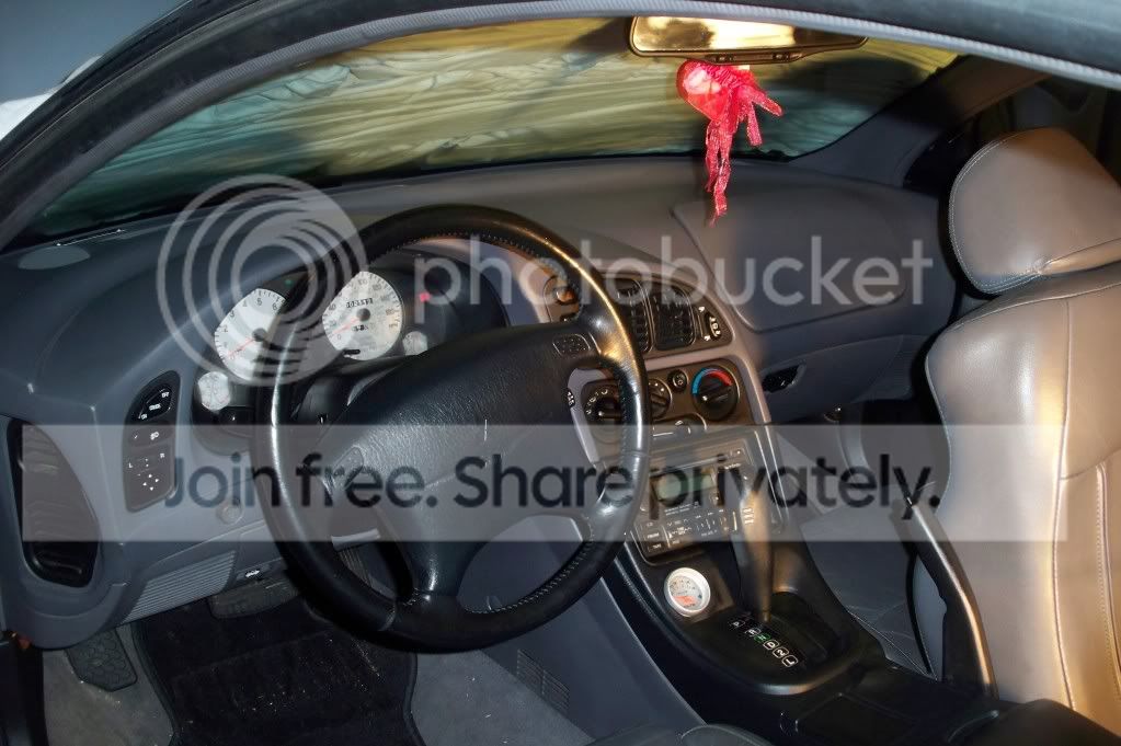

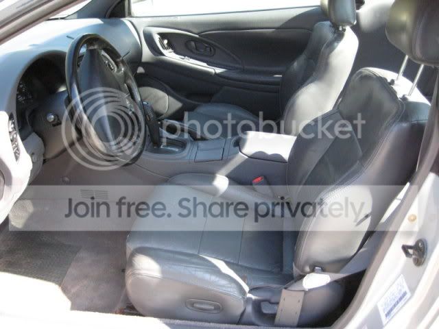

What it looked like before I bought it.

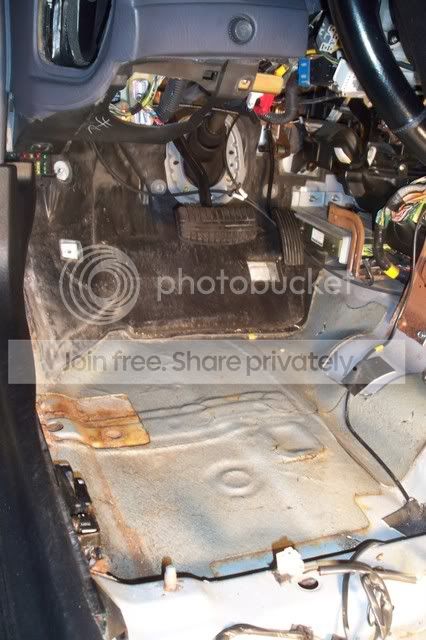

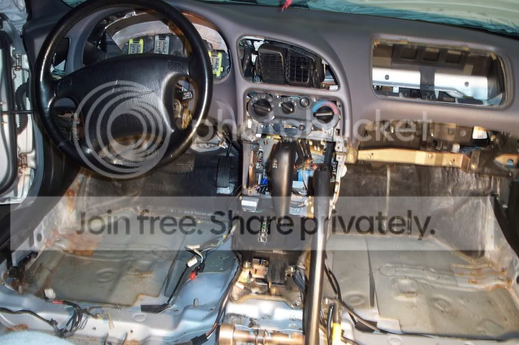

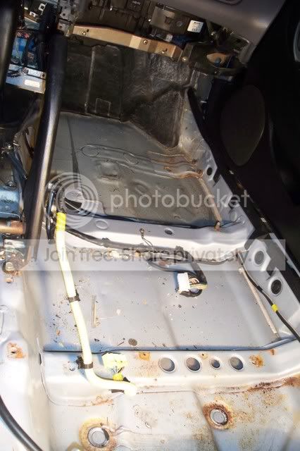

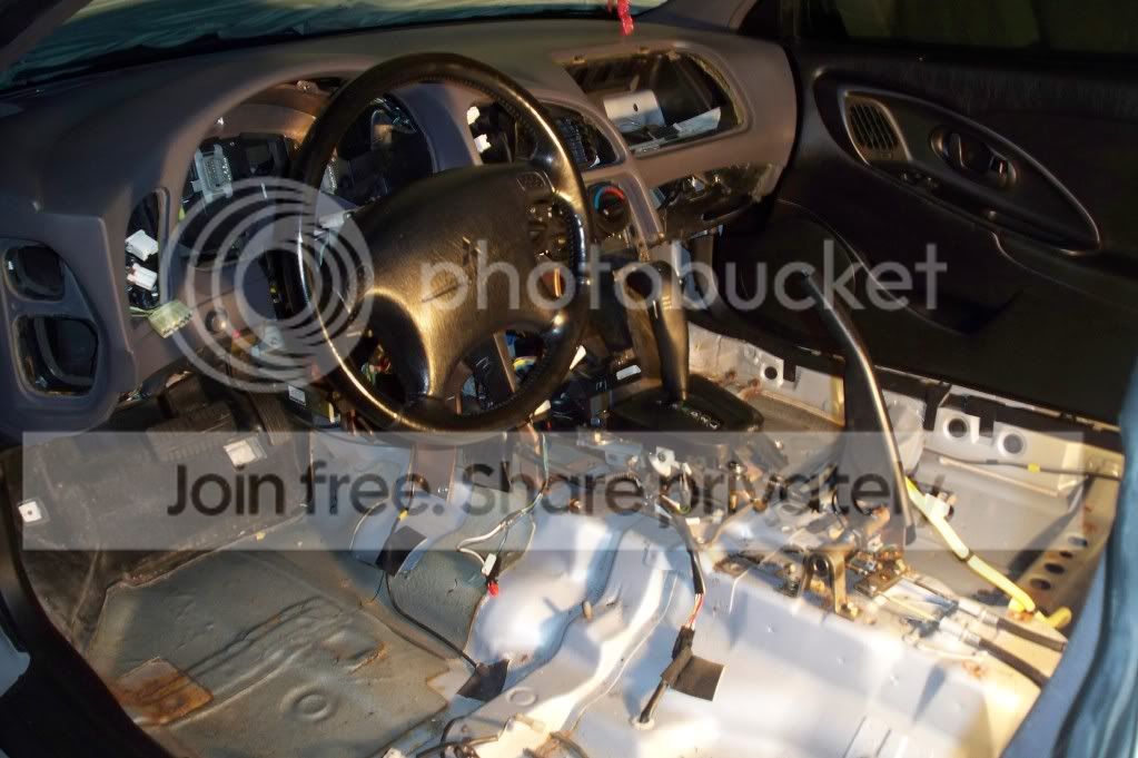

Current Status of the Interior

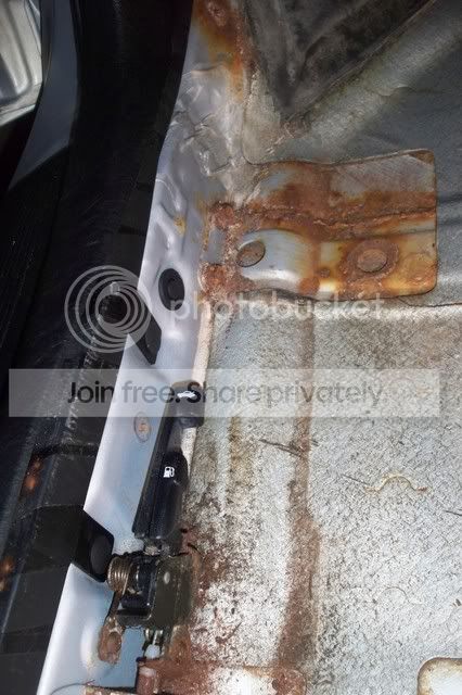

YUCKY RUST!

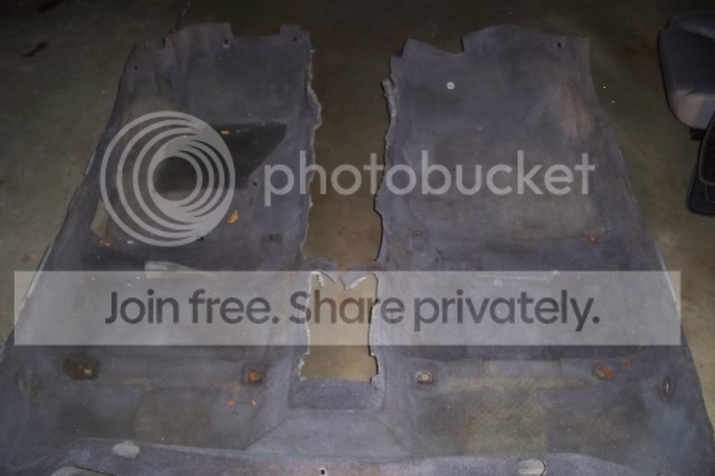

Dirty Carpet...
Should I remove the sound deadening? Should I remove both the black and silver deadening? What should I replace it with?
As far as the rust goes, of course the rust spots on the floor will be ground down to bare metal, and then resprayed silver. All of the rusty brackets will be removed, sanded down, and either cleared or repainted.

Good progress so far. I'd try to Fatmat some things while stuff is out.
Thats what Ill be doing at some point. Keep it up.
Nice, thanks jjrocks, I will look into "Fatmat". I will probably go with that. Unless someone else prefers something different. And yeah I chose to keep my car in the garage cause I'm only 17, so I can use my parents cars to go bomb around in.

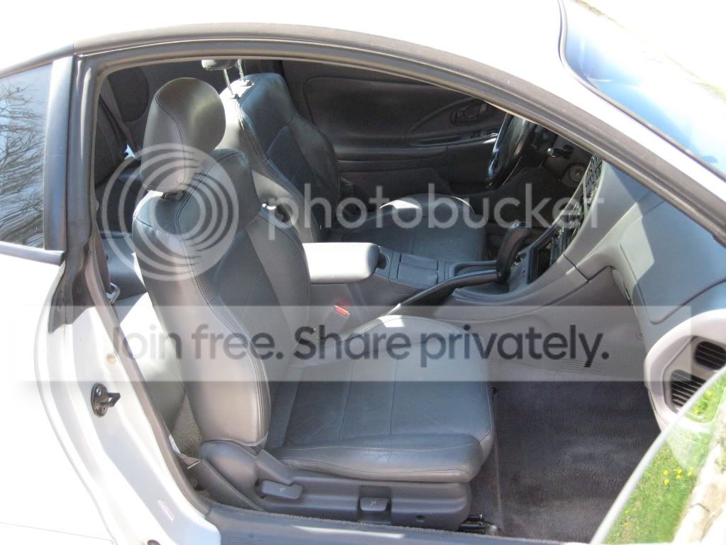

I am undergoing the same thing here in Michigan, tomorrow morning the oil gets changed, today was the cleaning day. But I am in search of some black parts as well... i had much more black then you had to start with though...but my car was carpet and not leather seat....
You have a super clean car from what I saw in the last picture!
I have OCD when it comes to cleaning cars.
What I always do with the carpet is power wash it..
Just depends of how dirty the sound deadening is would always be the deciding factor on if I pulled it off or not.
The sound deadening is what holds all the nasty crap that you spill.
If you choose to take the sticky sound deadening up you can use a hair dryer if you don't have a heat gun... way cheaper than dry ice but it leaves some little bits that you have to hit with goof off.

for the rust on the floor, once you clean it up.. just brush on some tremclad thats as close to match as you can get it for colour, afterall your not going to see it after anyways.

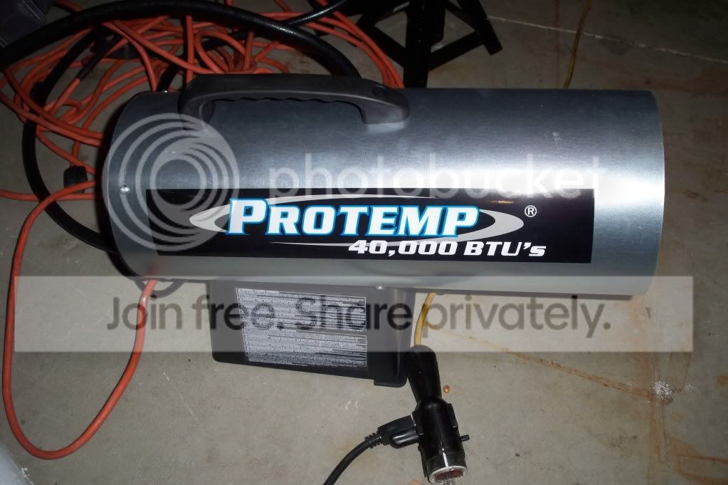

what type of heater are you using? How cold is it there?
Here is a picture of my heater. I have a 2 car garage. (attached) one wall is insulated. I have a back door (bad seal) and of course a 2 car garage door (bad seal also). I keep it full blast for about 15 min. Then I can go out in the garage with a sweatshirt and sweatpants. But with my 500 watt lamp inside the car. I can work inside the car in just shorts, and a t-shirt. Oh and I also keep the thing on full blast about 90% of the time im out there working...
yes POR15 turns any rust into metal if i remember correctly used it on my 1st gen when i first got it. Does wonders tho good luck with the interior swap/restoration. There is an excellent tech article on how to take old dull looking trim/dash/panel pieces into brand new looking parts. If you need help finding it or need pictures let me know cause i followed it exactly and my 95 looks like a 2005 and my 90tsi looks better than my 2nd gen just cause i was still learning when doing the 2g either way looks good and have fun in that garage im freezing my ass off in pittsburgh in my drafty garage. :ohdamn:
I took the sound deadener out for weight savings. 25 lbs total. FYI
