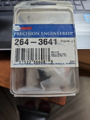

Have you tried a caster / camber kit..... I know they sell a special bolt for correcting the camber ?
I already confirmed this is the correct blot for your car.
