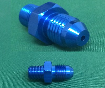

Maybe I’m wrong, one male end is beveled inwards if that makes sense. I got the stainless steel oil feed kit from extreme psi and I need a .075 restrictor but seems hard to get. I appreciate your response
What threads is the turbo side? Stock t25, This might work
