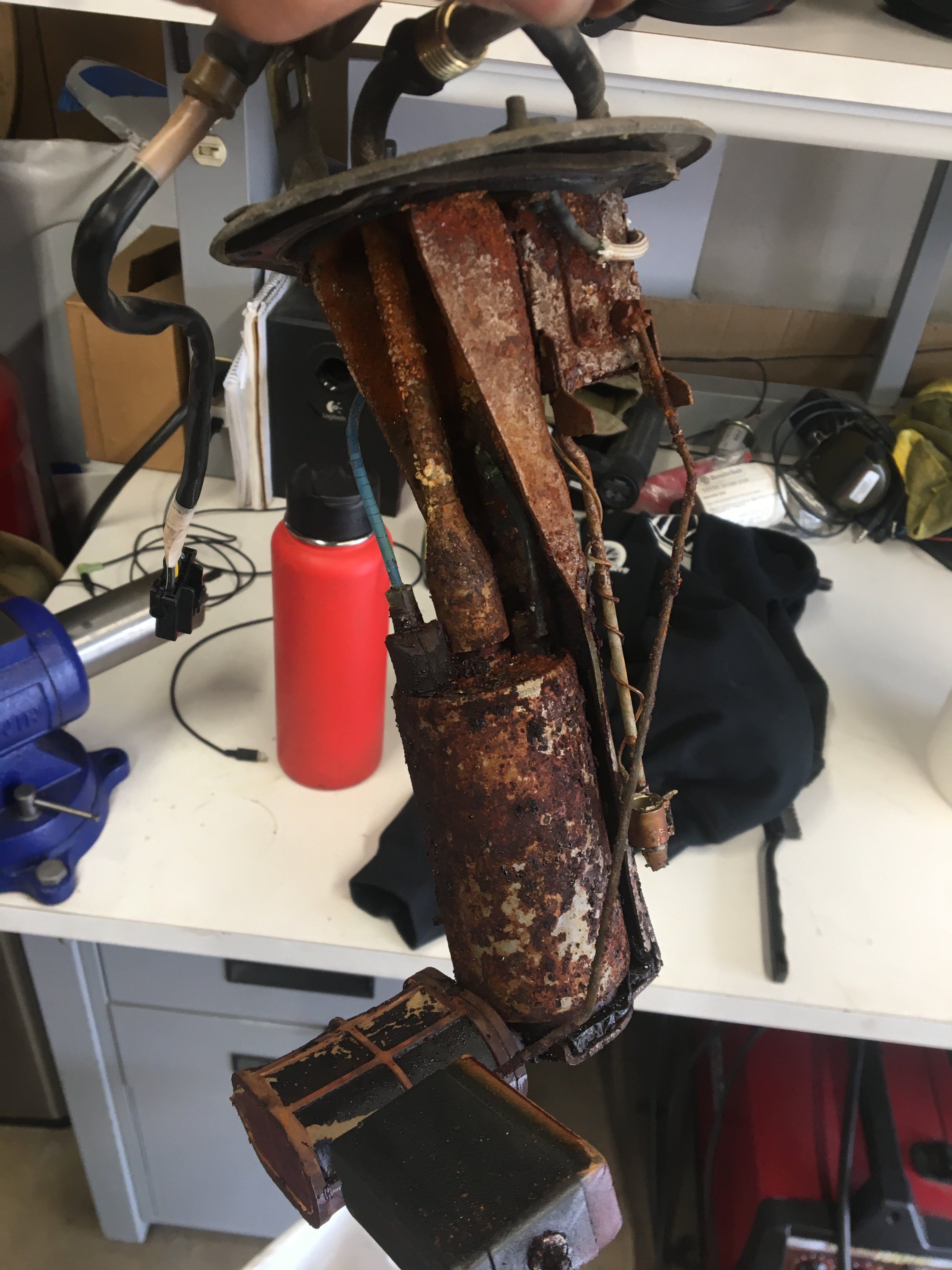

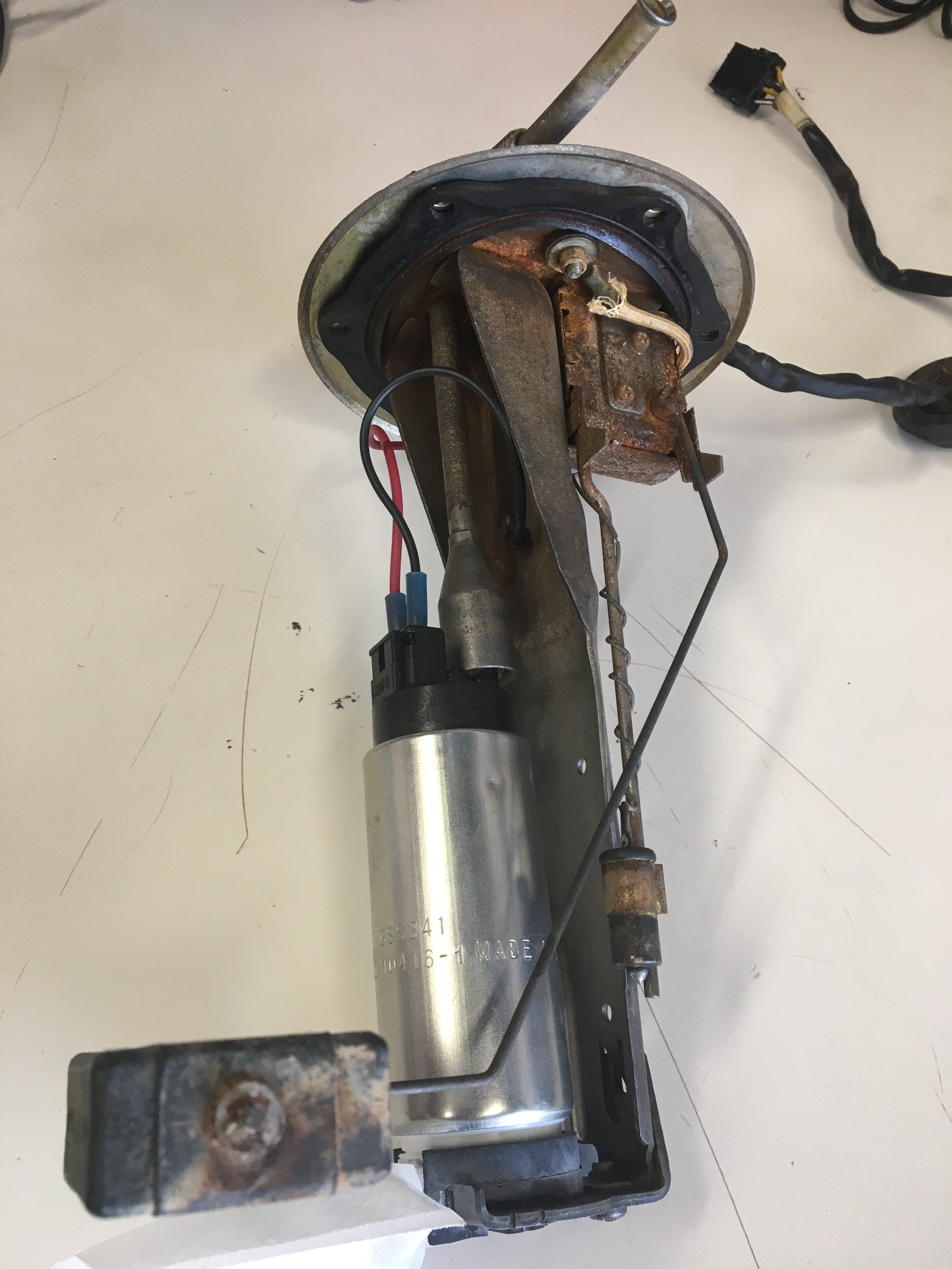

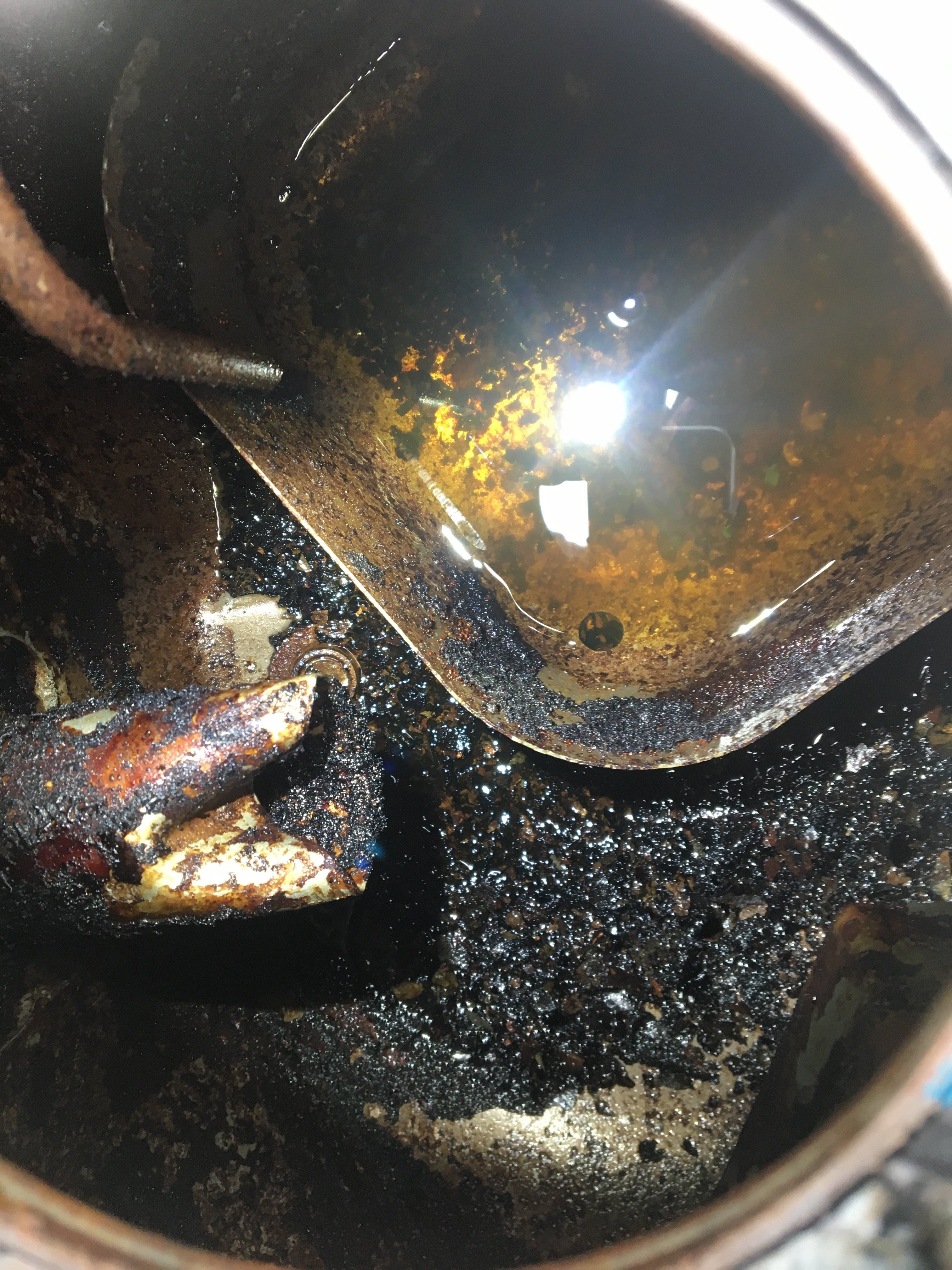

I can totally relate to your first challenge with this project, that being the fuel tank full of crap. Yours looked more like dirt than rust. I take it your fuel gauge still reading OK? I really appreciate all the interior photos; it's in great shape. I wish my car had started out that nice inside. After all, that's where you spend time while driving... might as well be nice. In fact, the interior is often overlooked for how right they got it on these 1Gs. Logical, direct, but really great style too. Keep up the great work!
The crud was a mixture of small granulated stuff and bigger flakes, definitely mostly metallic. Fuel gauge still reads fine, the low fuel light seems to come on around 1/4 tank, seems a little early.

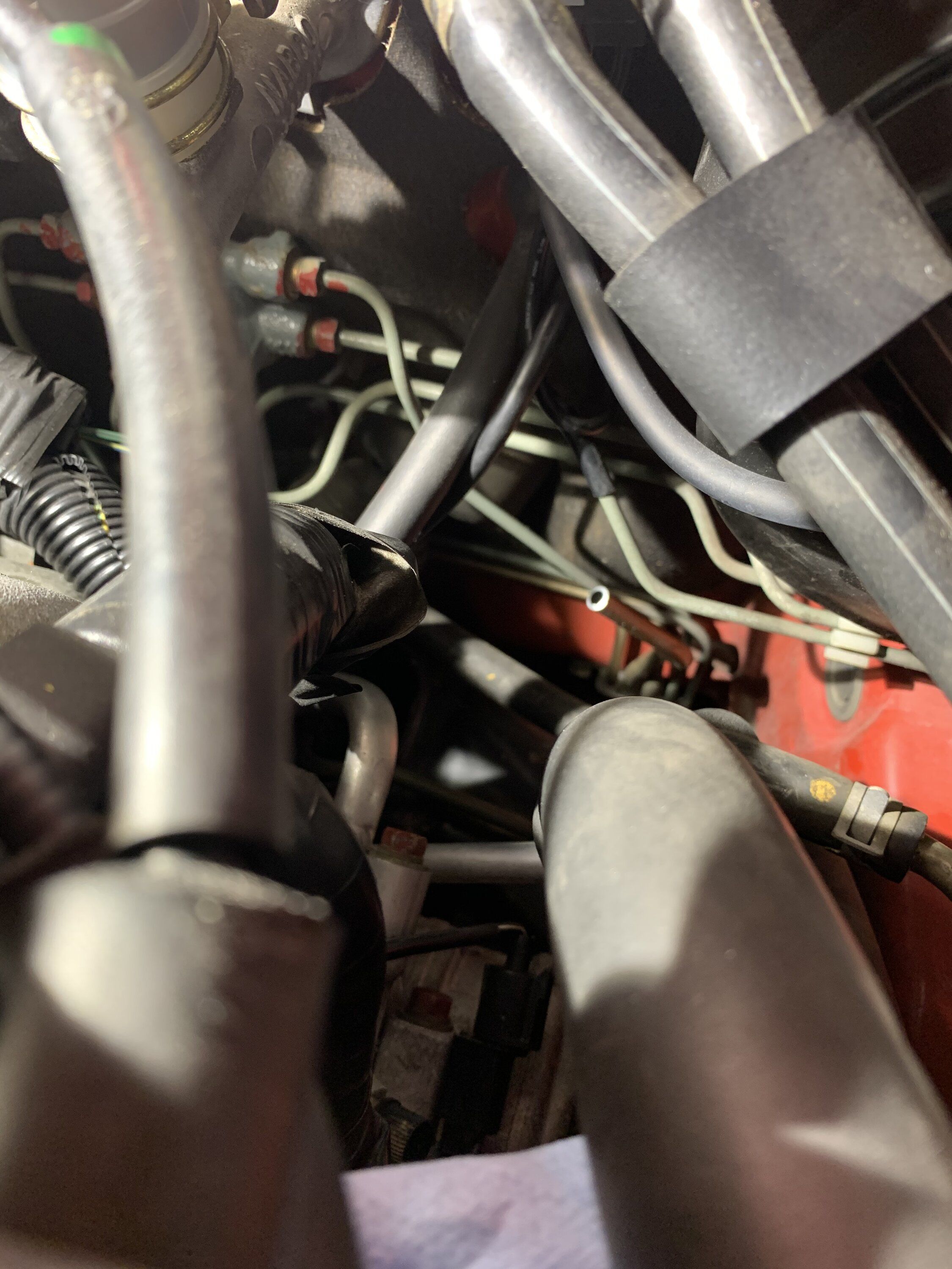

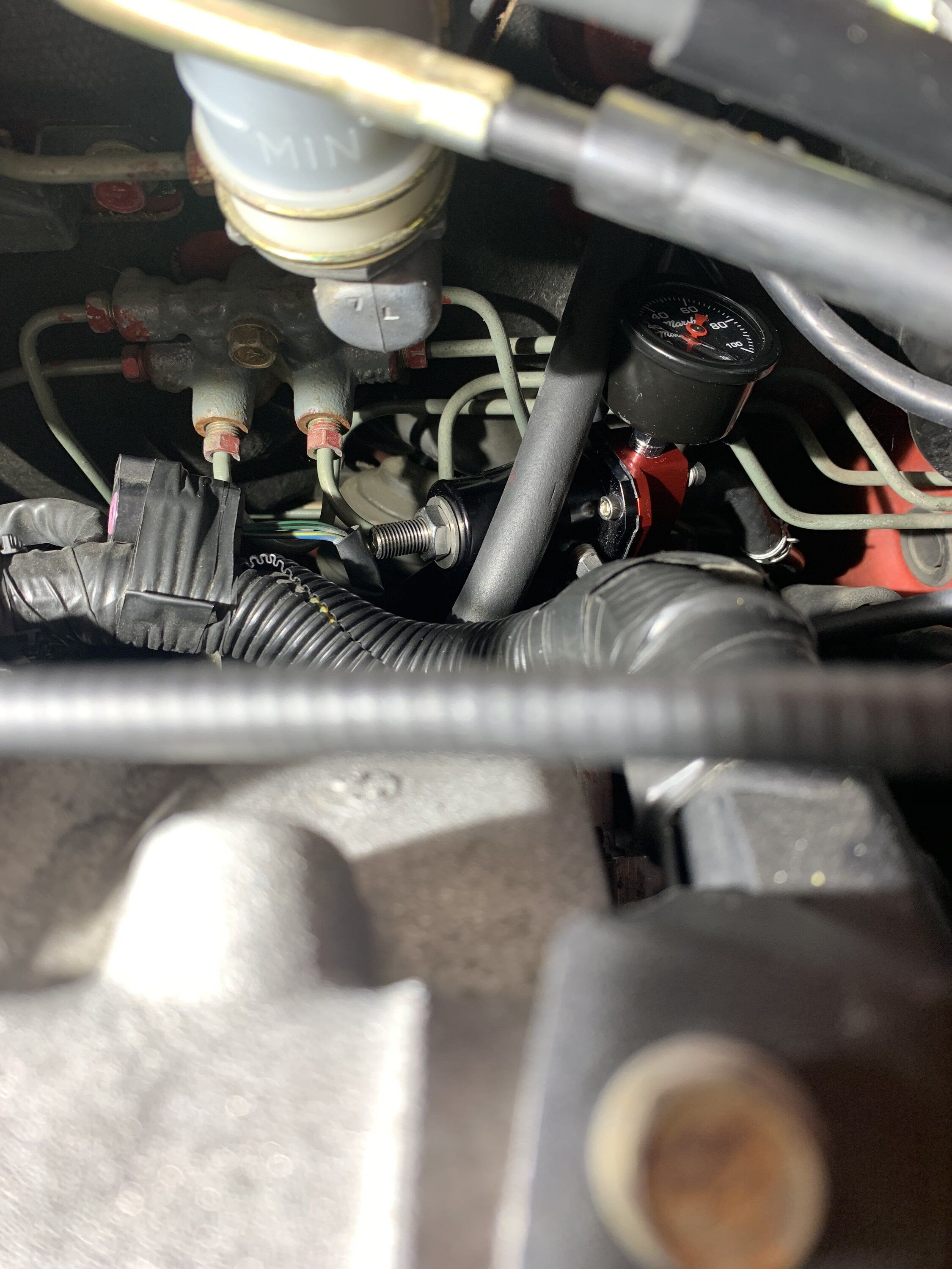

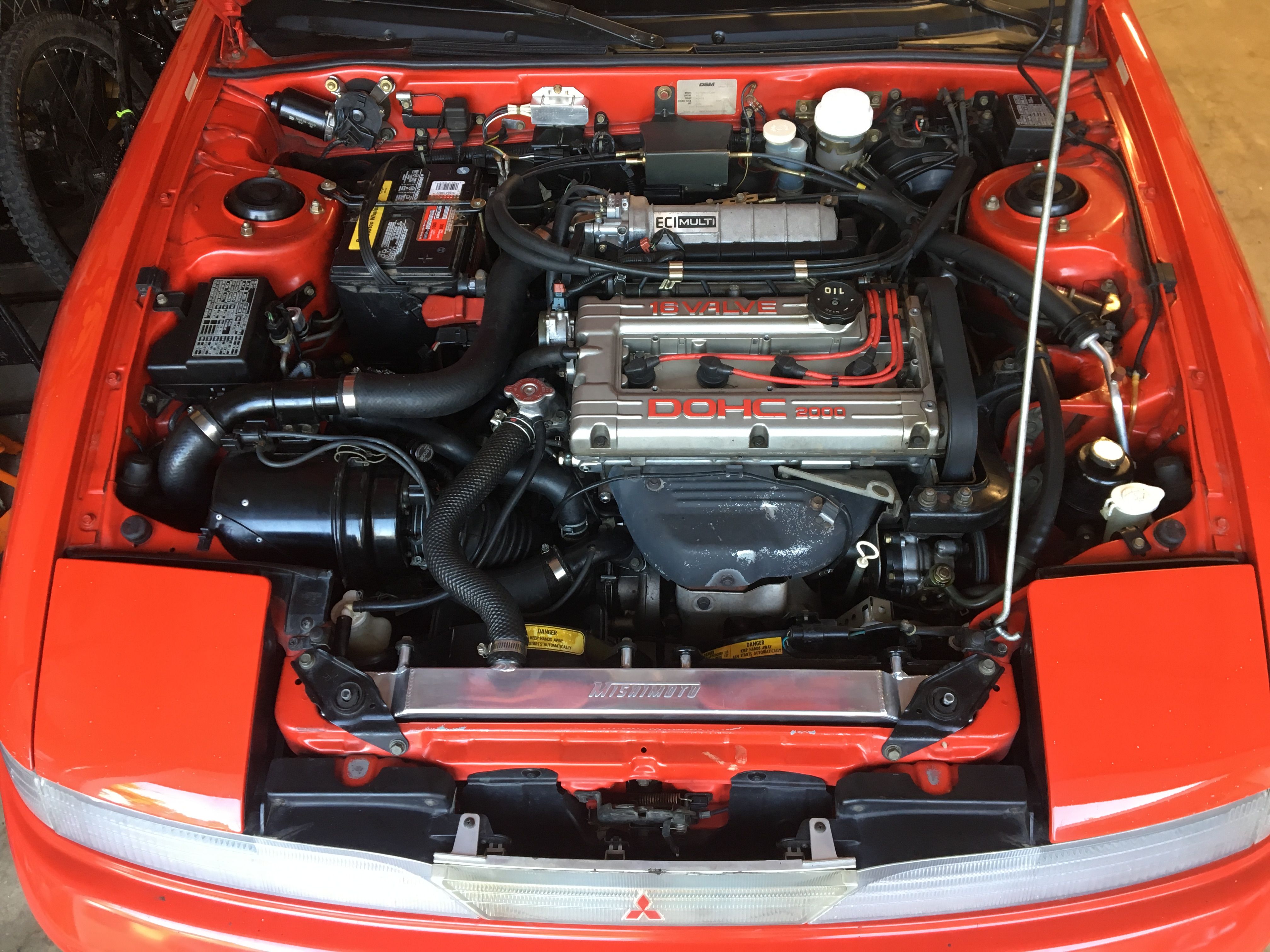

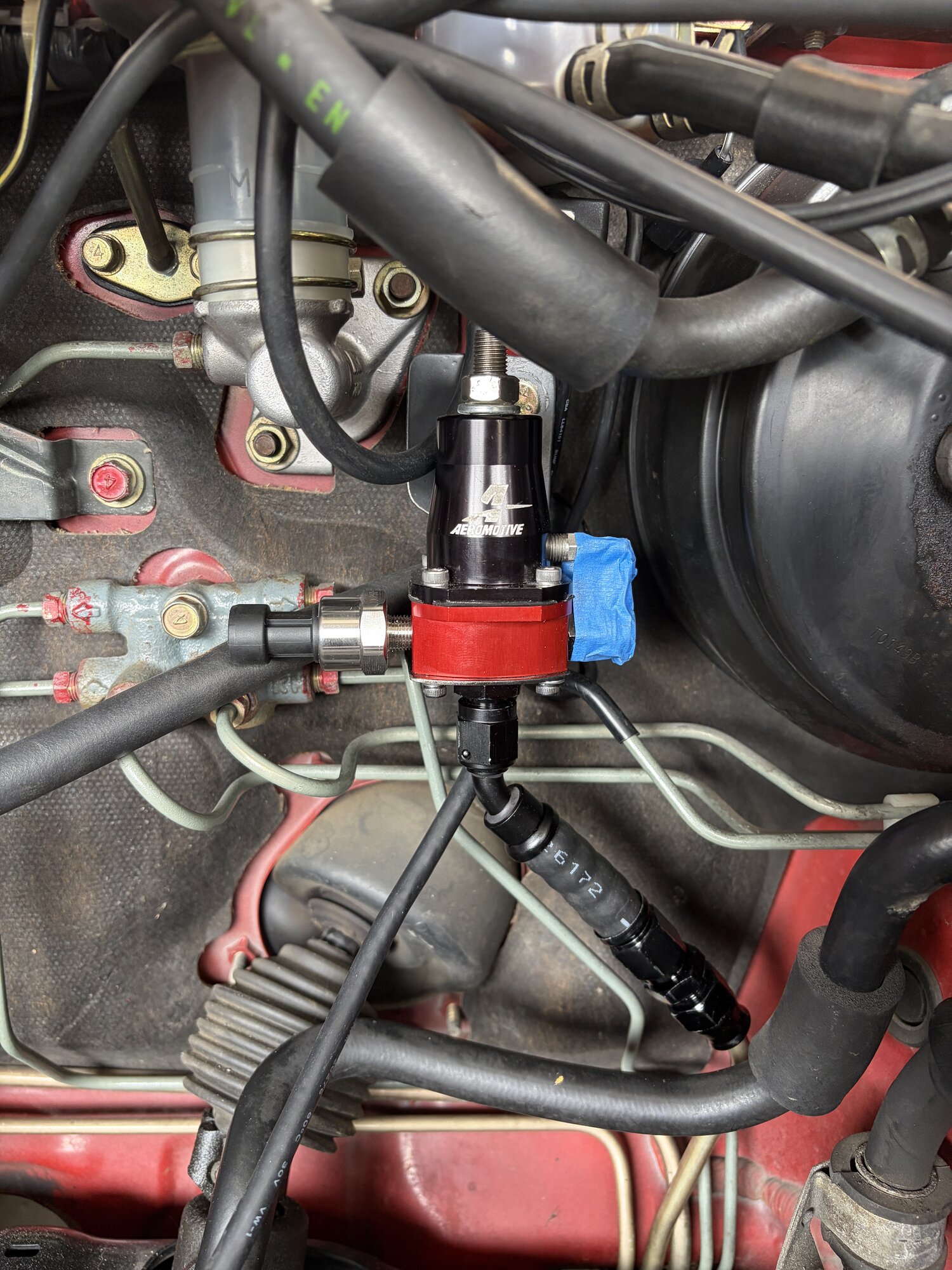

Started working the FPR install tonight, -6 push-lok line running down to the Aeromotive FPR that will be pretty well hidden under the brake lines and booster vac line. Once the pressure is set and stable, the gauge will be removed, and the FPR will be secured (somehow) underneath the brake line manifold.
Cut the stock return about halfway down. Fitted 1/4" fuel line (tight!) to the 5/16 AN fitting.
As seen without brake boost and cruise control vac lines, which provide more concealment. It will be tucked under the brake lines in the end.
You can still see the gauge/fpr propped up in the back, -6 fuel rail adapter is pretty low key but would still like more stock looking. Might look into making a plastic cover for it

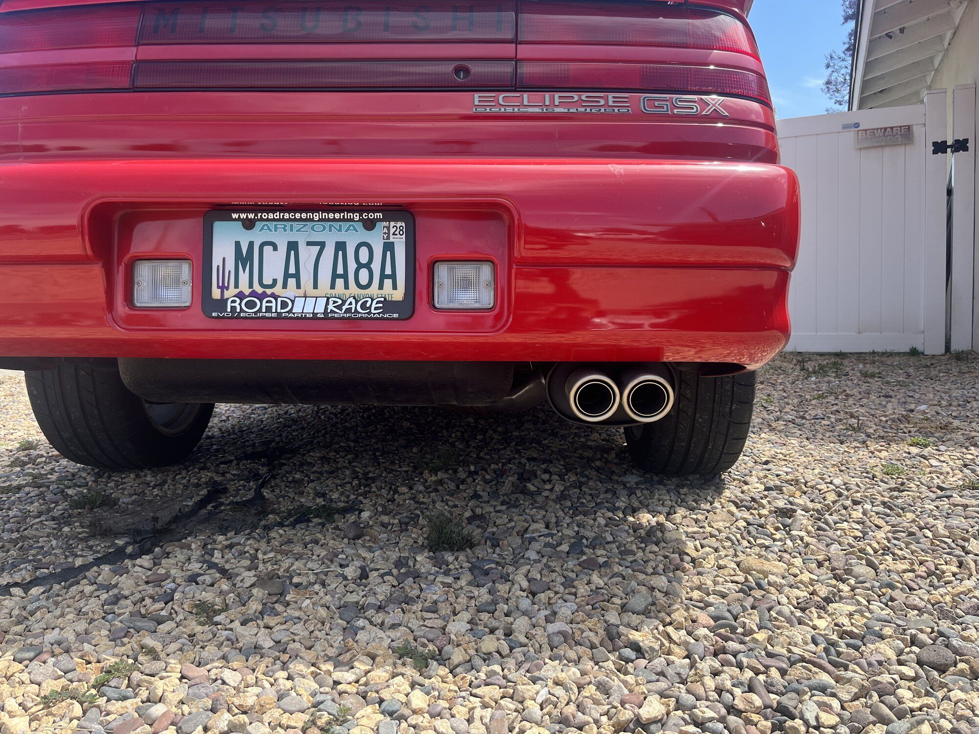

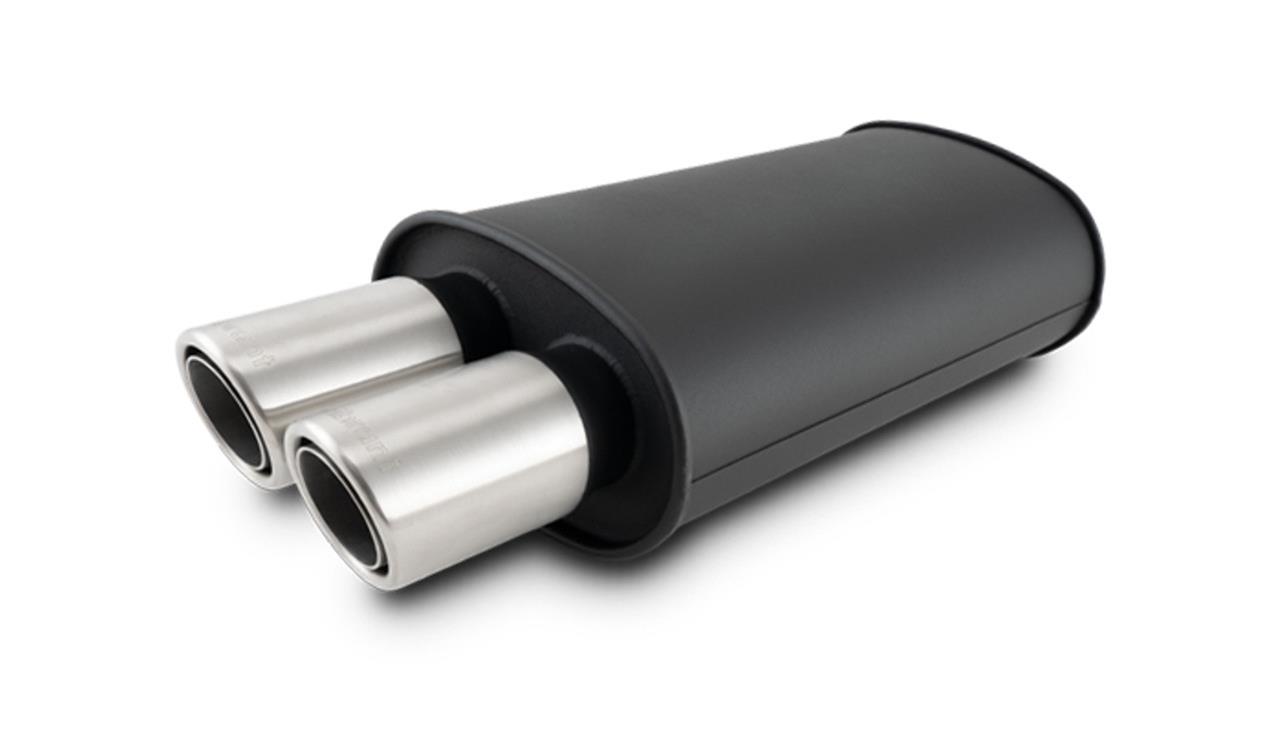

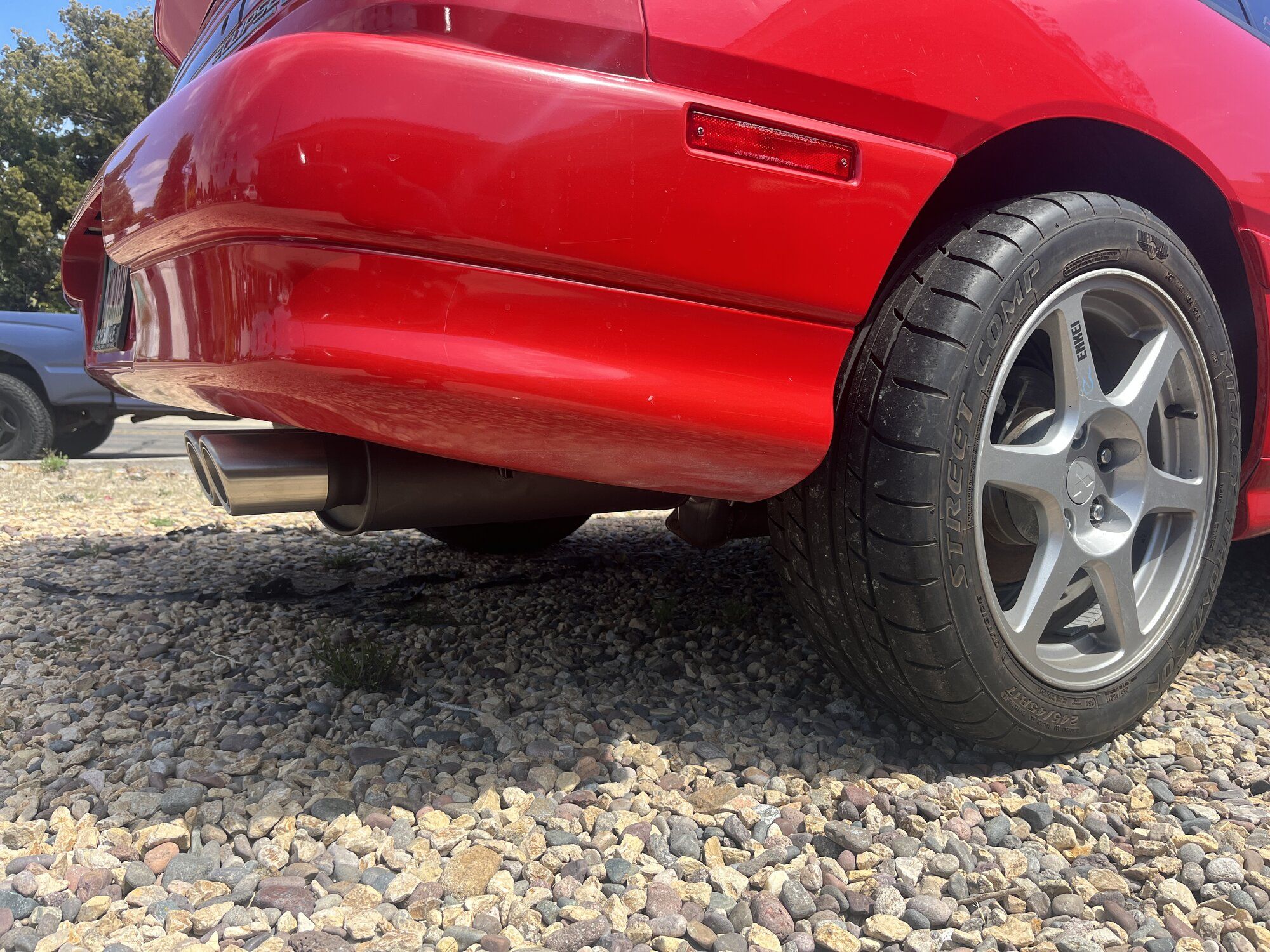

Vibrant muffler ordered, stock as could be for 3" yeah?

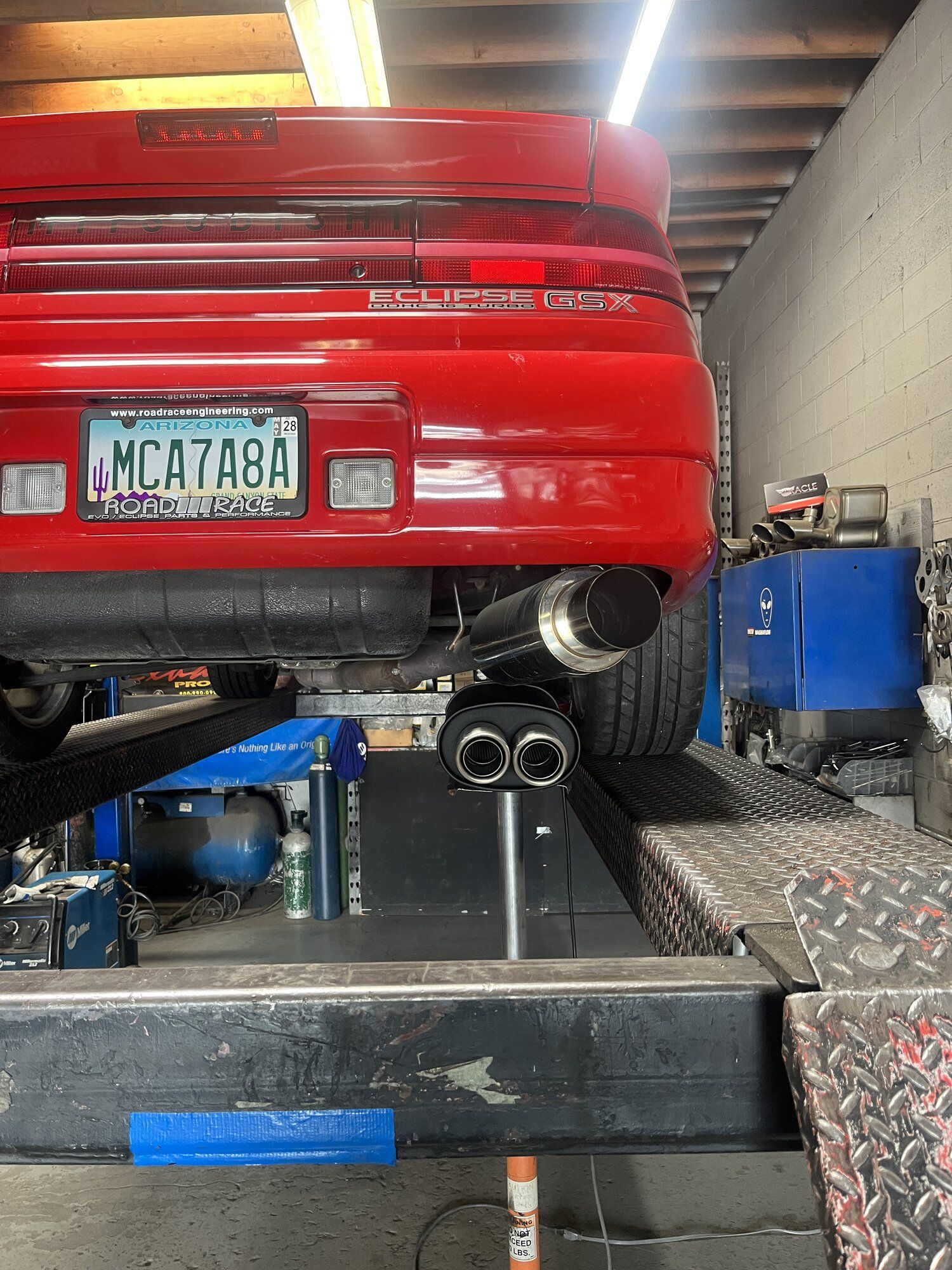

Alrighty, got the old Apexi can out of there and the new vibrant stealth muffler in. They did a decent job for the price, but press-bent aluminized tubing and not quite sitting exactly where I want looks-wise from the side. Sounds great, pretty much same tone as the Apexi minus the drone. Looks much more stock, while being 3" and good sound!

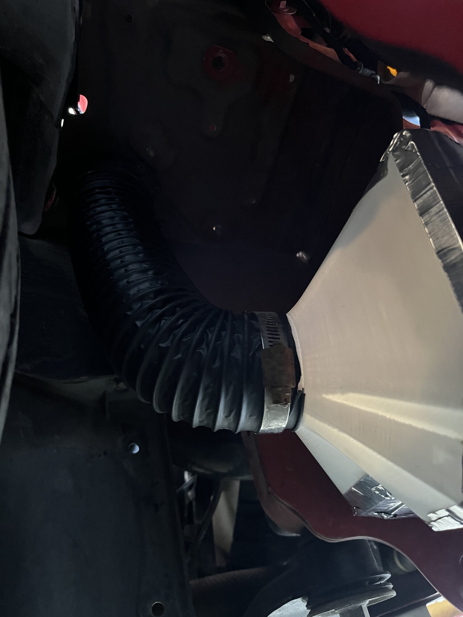

Also made two more "patches" to cover up the gaps in the FMIC ducting I made originally. Car tends to run hot during uphill cruising, most likely a tuning issue but figure this couldn't hurt.

Ducting Additions:
Muffler looks great to me. You’re wanting it slightly closer to the side? Since these bumpers never had any kind of indent for clearance, as some cars have, only other dsm fanatics can even detect the difference.

I think moving it over another inch or two to the right would "center" more between the bumper and the gas tank. But what I was talking about was from a side profile, the muffler inlet should be lower, as it looks like its actually tucked too high at the inlet currently. Very minor, but I'm fine with it currently.

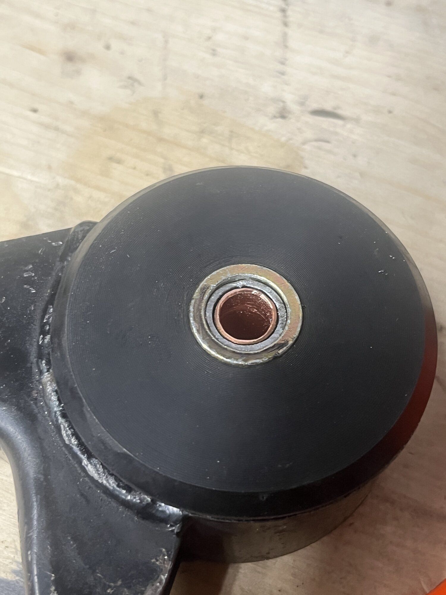

-Black Prothane motor mounts installed (except rear, not trying that without the head off)

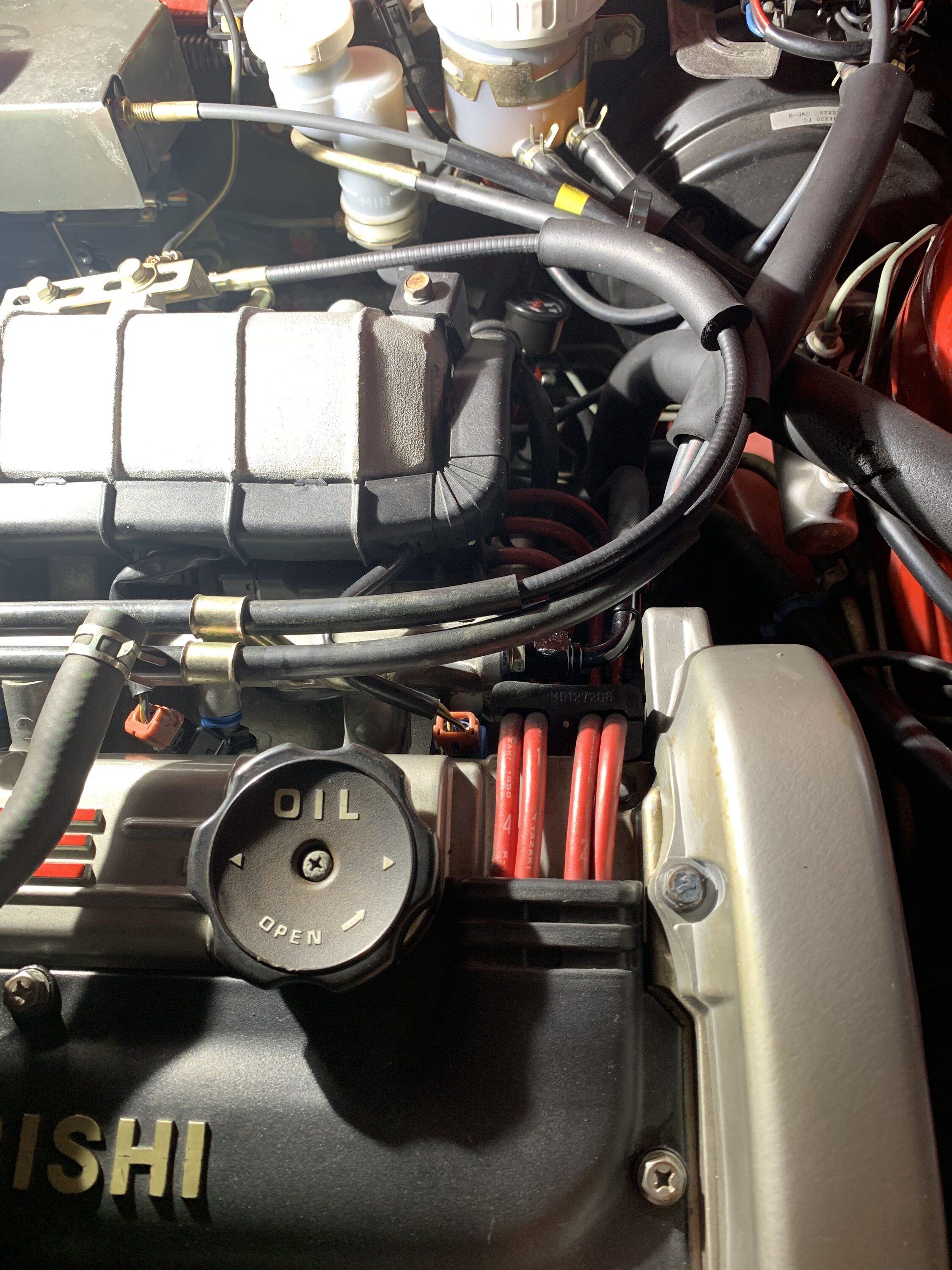

-Rerouted some EGR and TB vacuum lines, trying to figure out the stock purge hoses still
-Added .025 restrictor to try and get the ECU boost control to function (taps out at 14 psi no matter what duty cycle)
-Added a barbed fitting to the J-pipe to shorten up the WG lines

Oh! You can maybe test a theory that I have heard about how most of the unwanted vibrations from poly mounts come from the rear mount. Curious, how bad are the vibrations with a stock rear mount?

I don't feel like there was too much of a difference so far, but I'm also used to bumpy/vibe prone vehicles. I am interested to see if it changes once the rear mount is in.

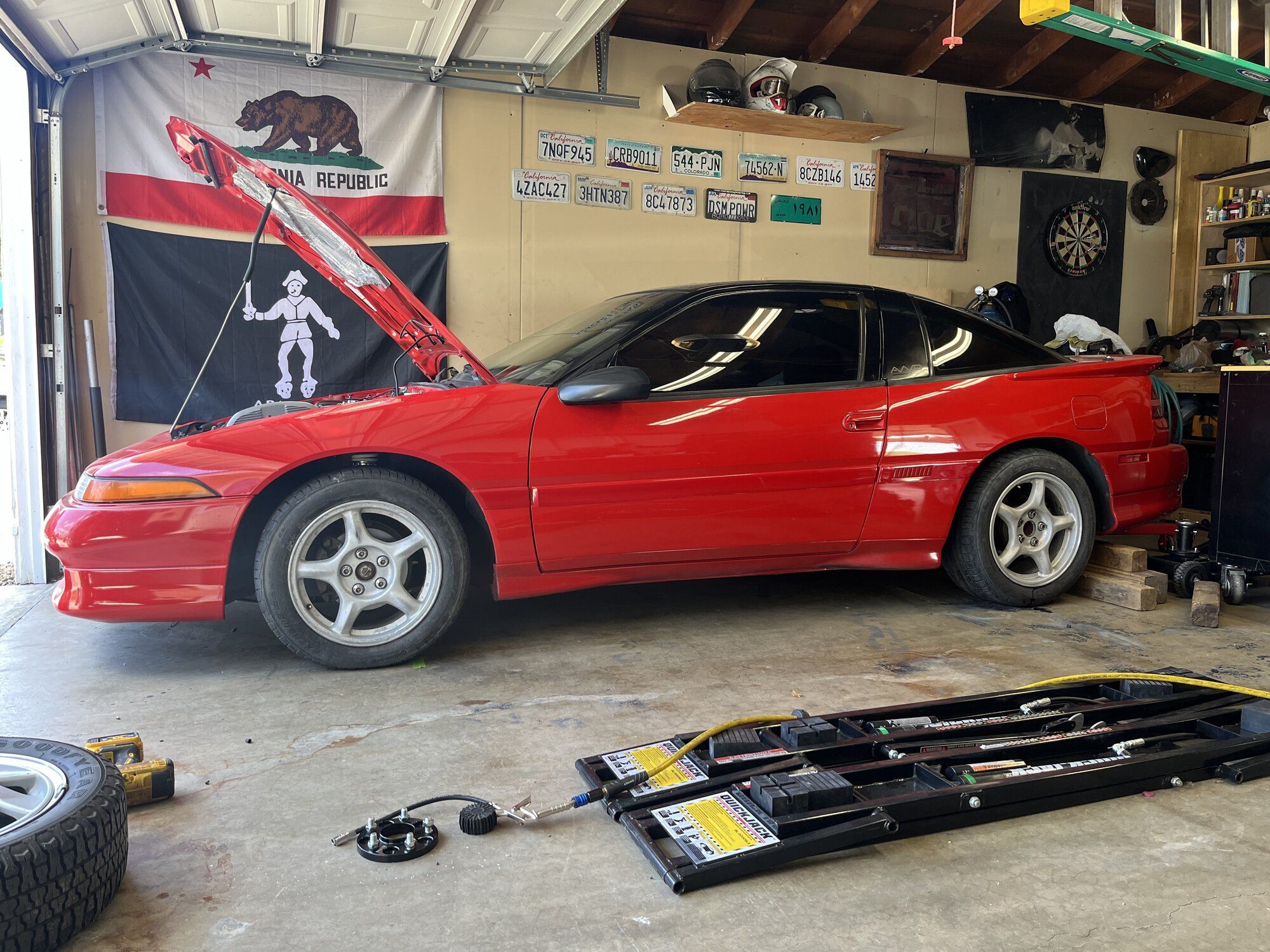

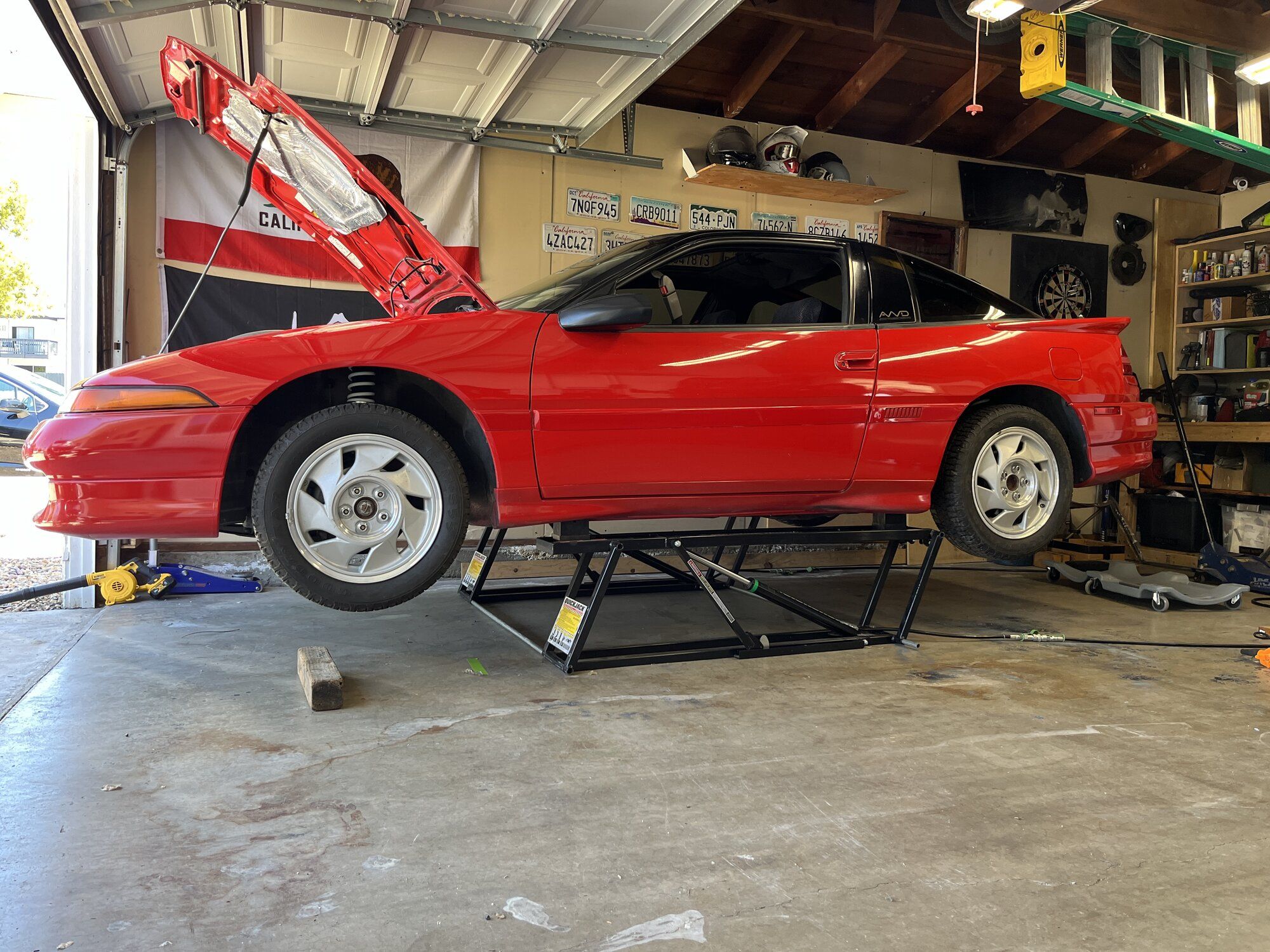

-Ordered a ST rear sway bar, and got that installed today. That was a great excuse to try out a Quick Jack I picked up for cheap a few weeks ago, made the job WAY easier! Also needs a new battery after 5+ years...

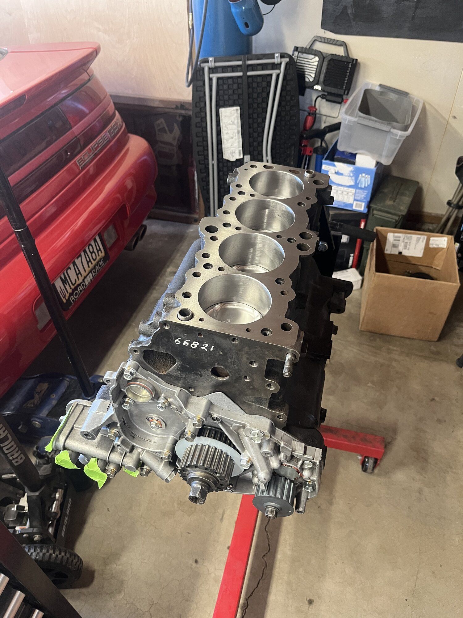

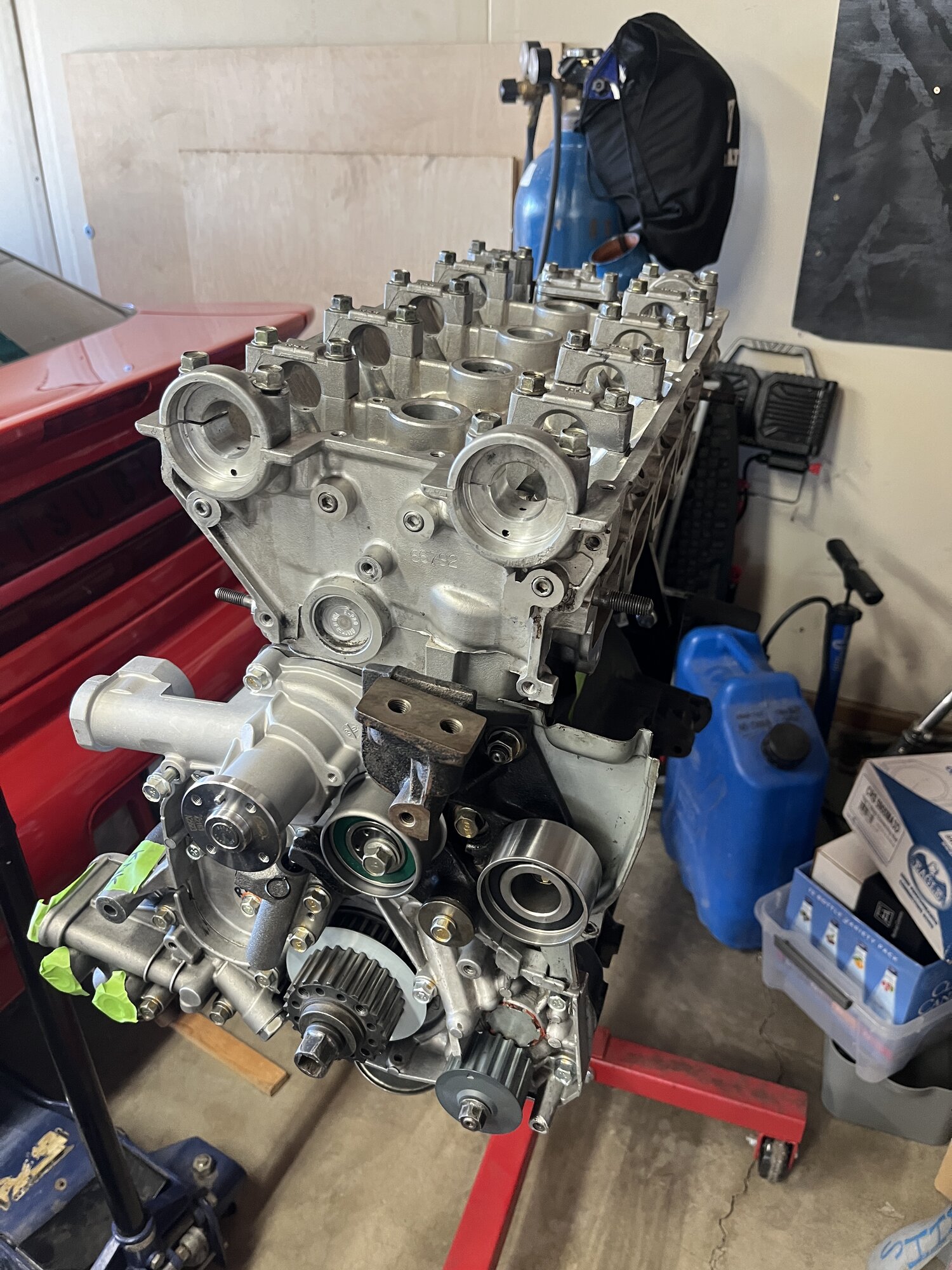

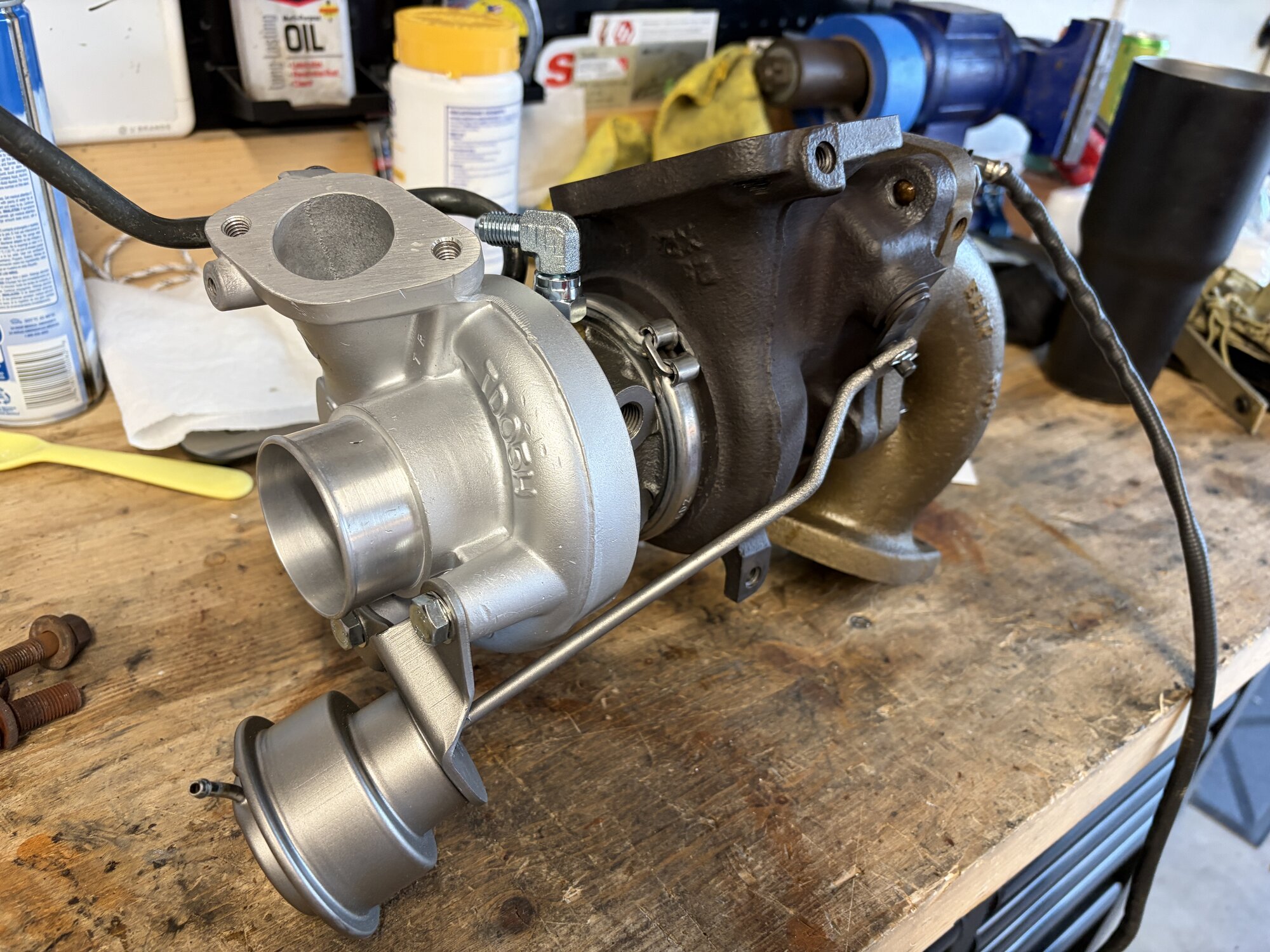

Finally made a decision on the shortblock thats been sitting in my garage for the last 3 years. Originally it was a big rod/2g piston combo but the machine shop accidentally pressed on NT pistons. Soo went with the same combo I had in my last 1G back in 2008ish, Wiseco 9.0:1 and Eagle rods. Should be more than enough for this cars goals, little better off boost too. I'll probably get some pics of that going in here as well.

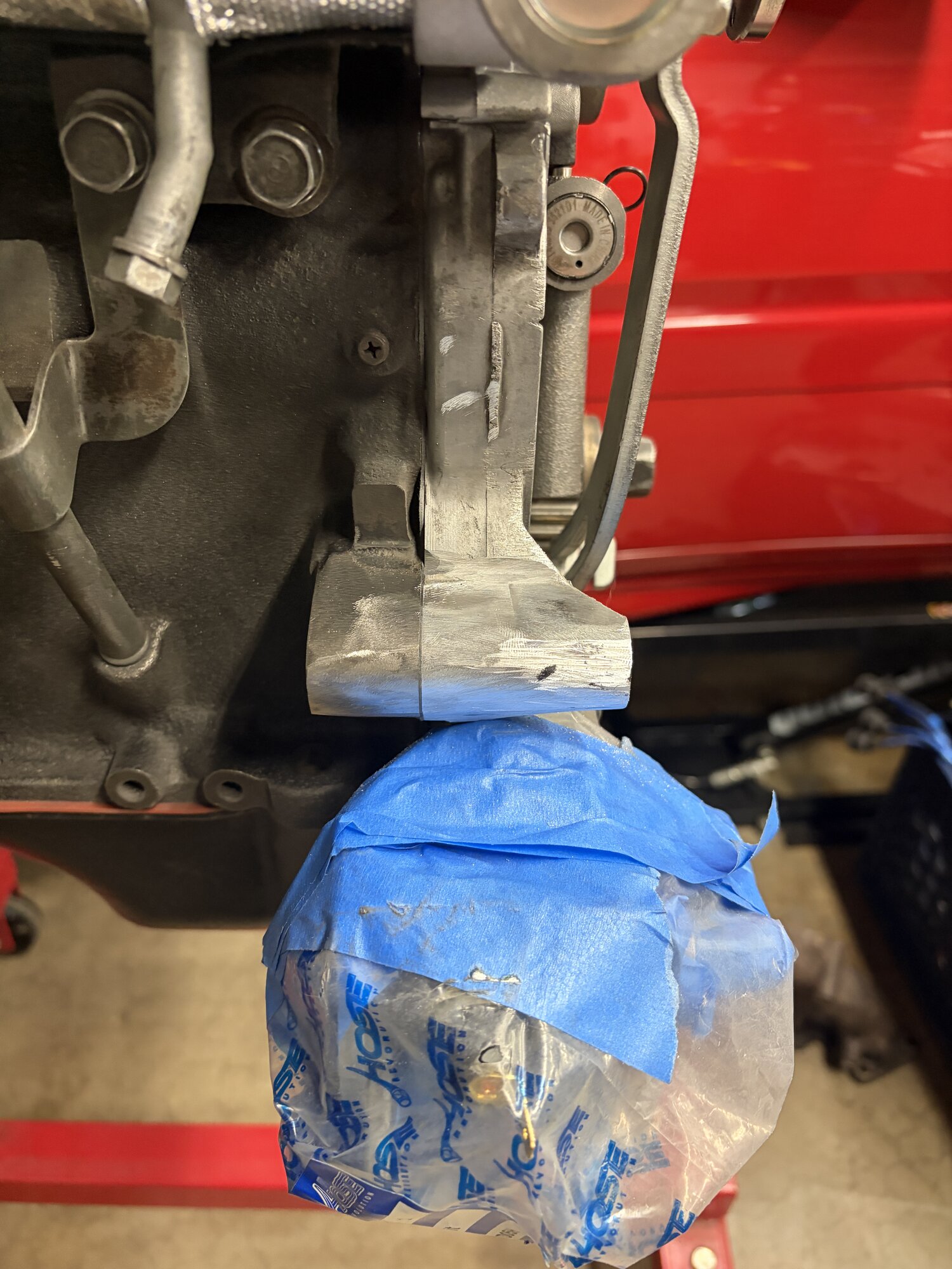

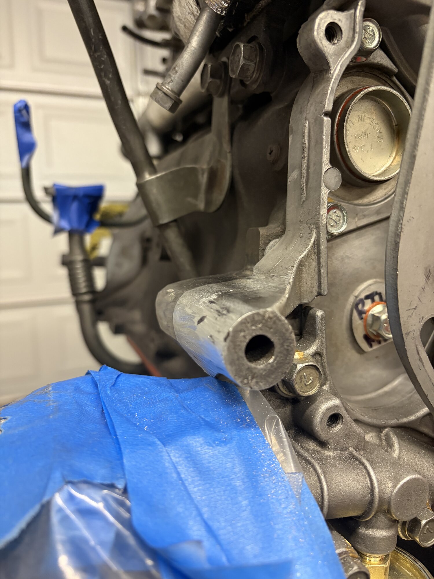

And been slowly plugging away at building the motor, ordered some new hardware, cleaned up some parts and got the fittings needed for the oil cooler. I do need to verify that the correct order or the crank sprockets are B-shaft sprocket > timing plate (angles toward motor) > main timing sprocket > washer > crank bolt.

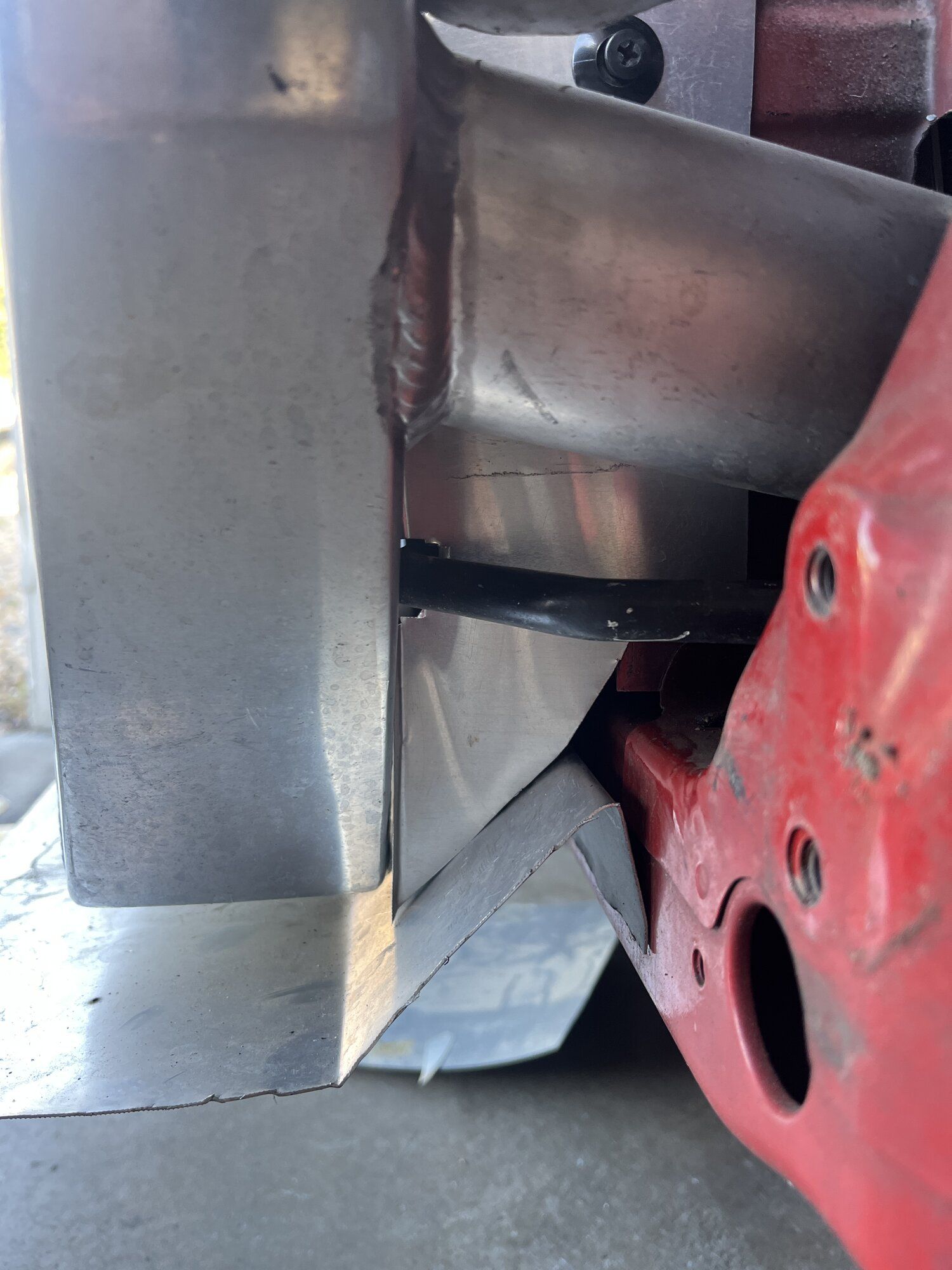

Not too much progress, I added a temporary air dam under the frame to see about helping with temps, but no such luck.
I also got the head on and rest of the front case set for the spare motor. Need to bleed lifters and t-belt and should be ready to drop in. Also will need to pick up a new clutch that will hold up to the new power.

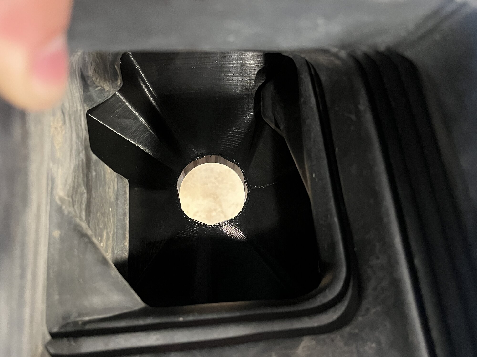

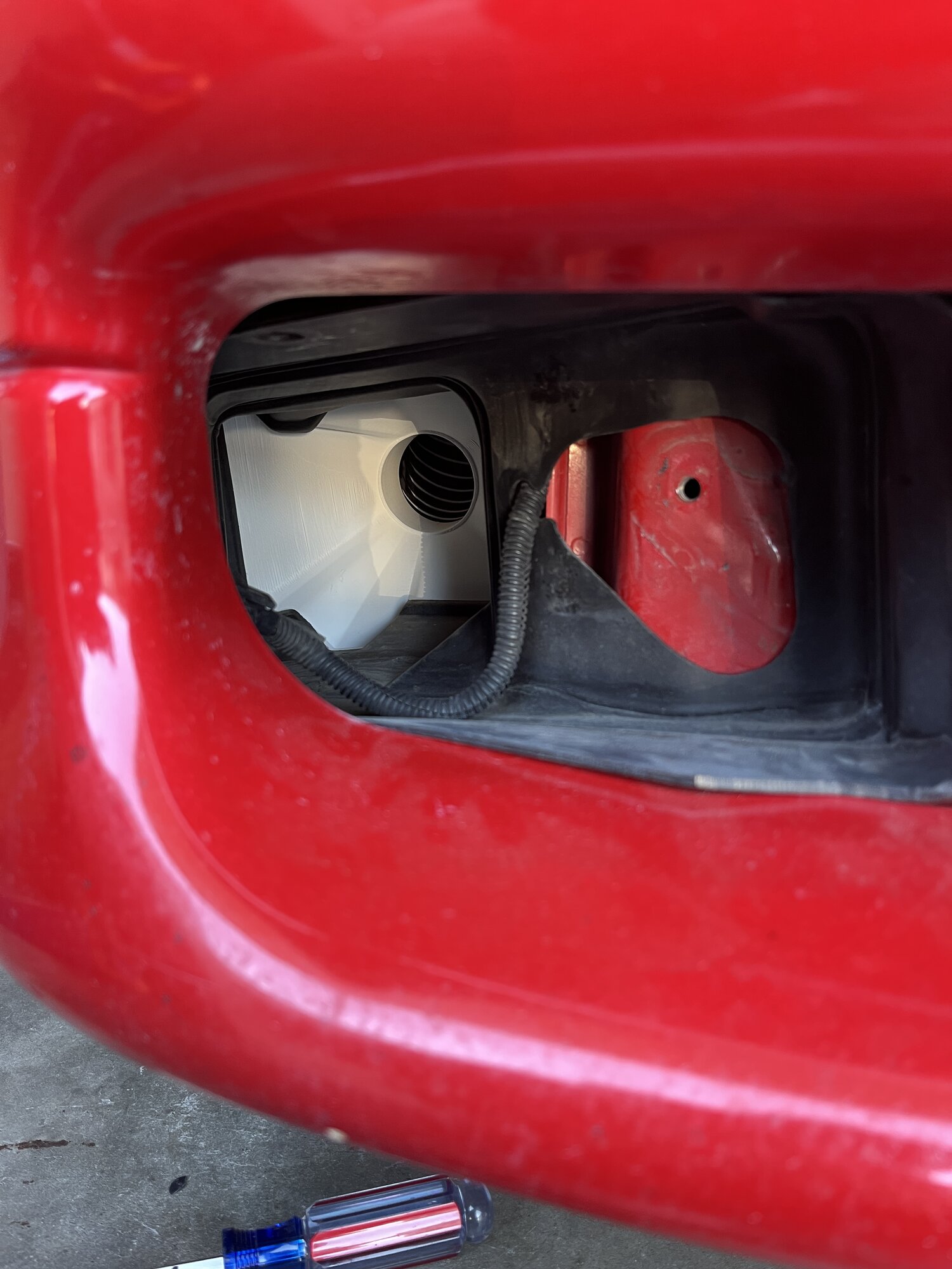

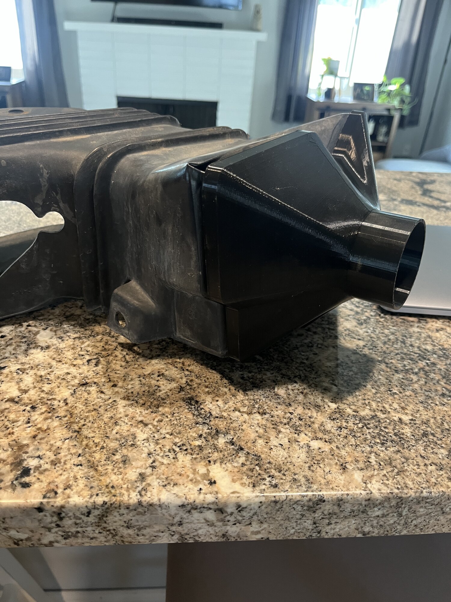

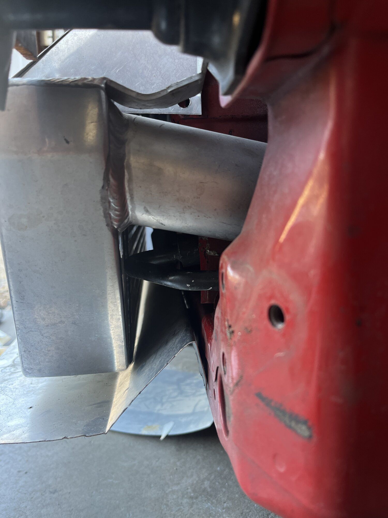

Been working on a 3d printed intake scoop/ducting for the front passenger fog light location. Stock plastic ducting > adapter to 2.5" flexible duct > adapter coming through original IC piping hole by the stock air can. Hoping it will provide some cooler outside air, especially at speed. Printed in PLA as my ABS roll was trash, it will probably melt but thats fine until I print another with mounting tabs.

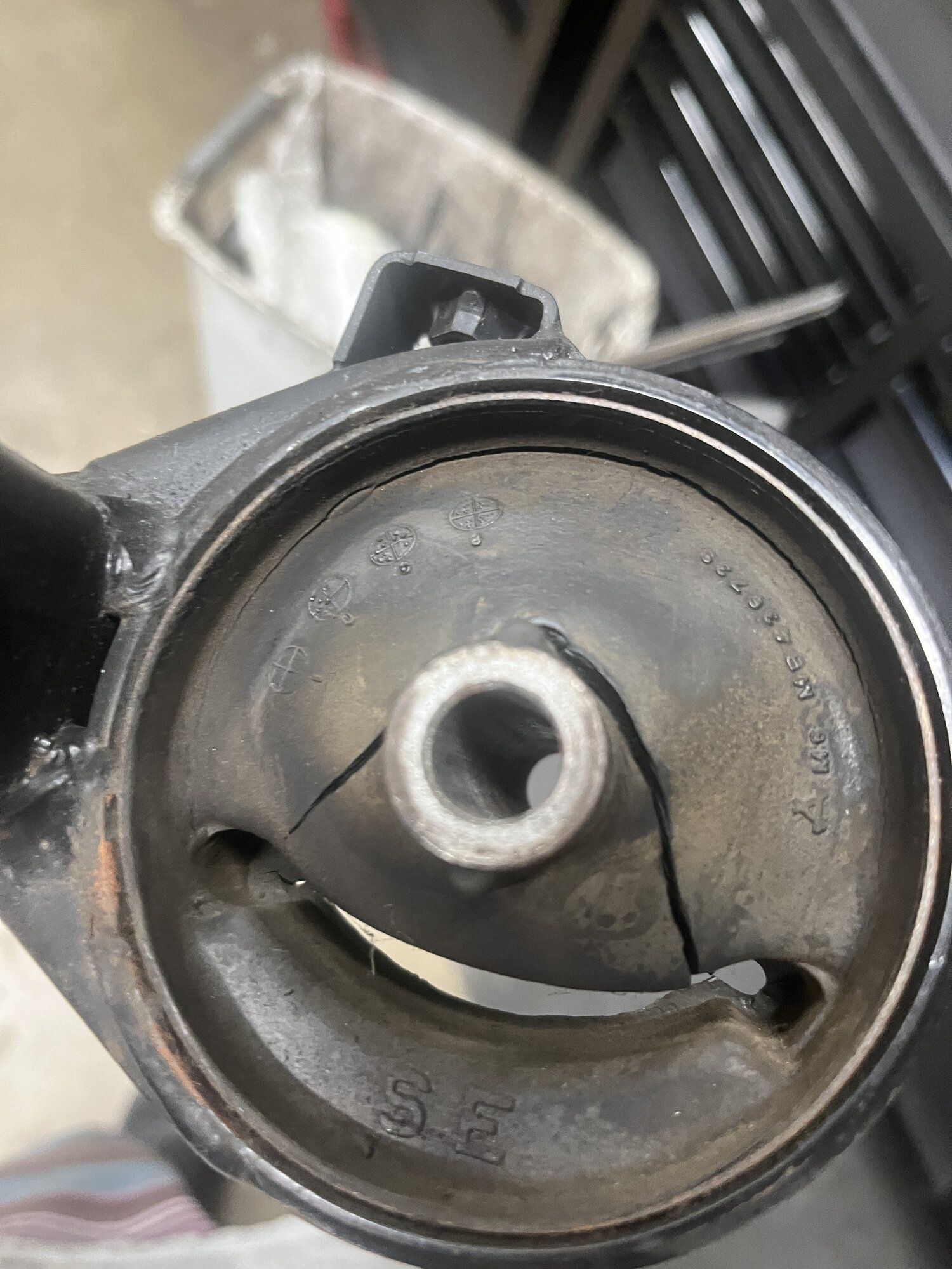

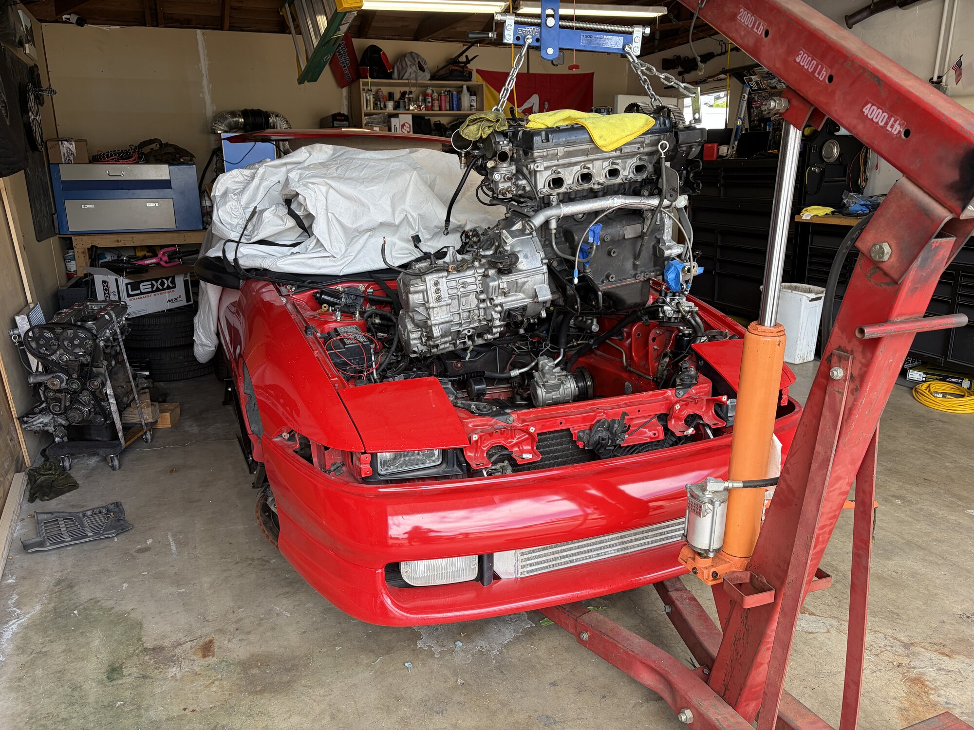

Well I finally had good chunk of time off to finish building the motor, and get it swapped over. I understand why things take so long now, with work, a baby and various other to-do's, but finally got it fired up today. There were a lot more upgrades and changes that happened along the way as well;

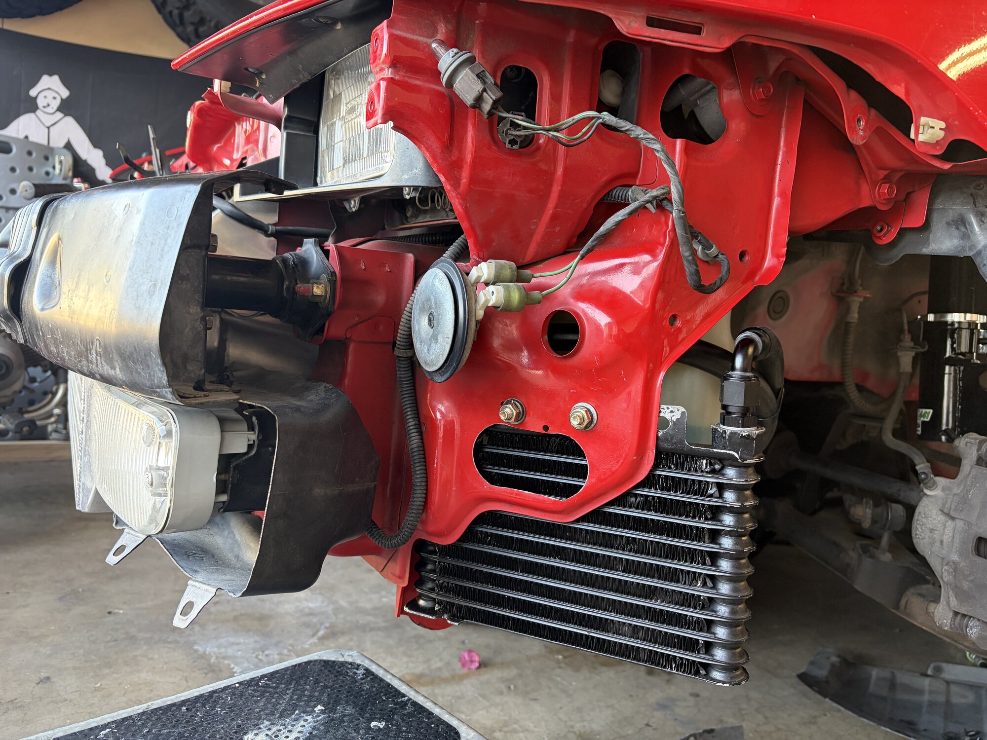

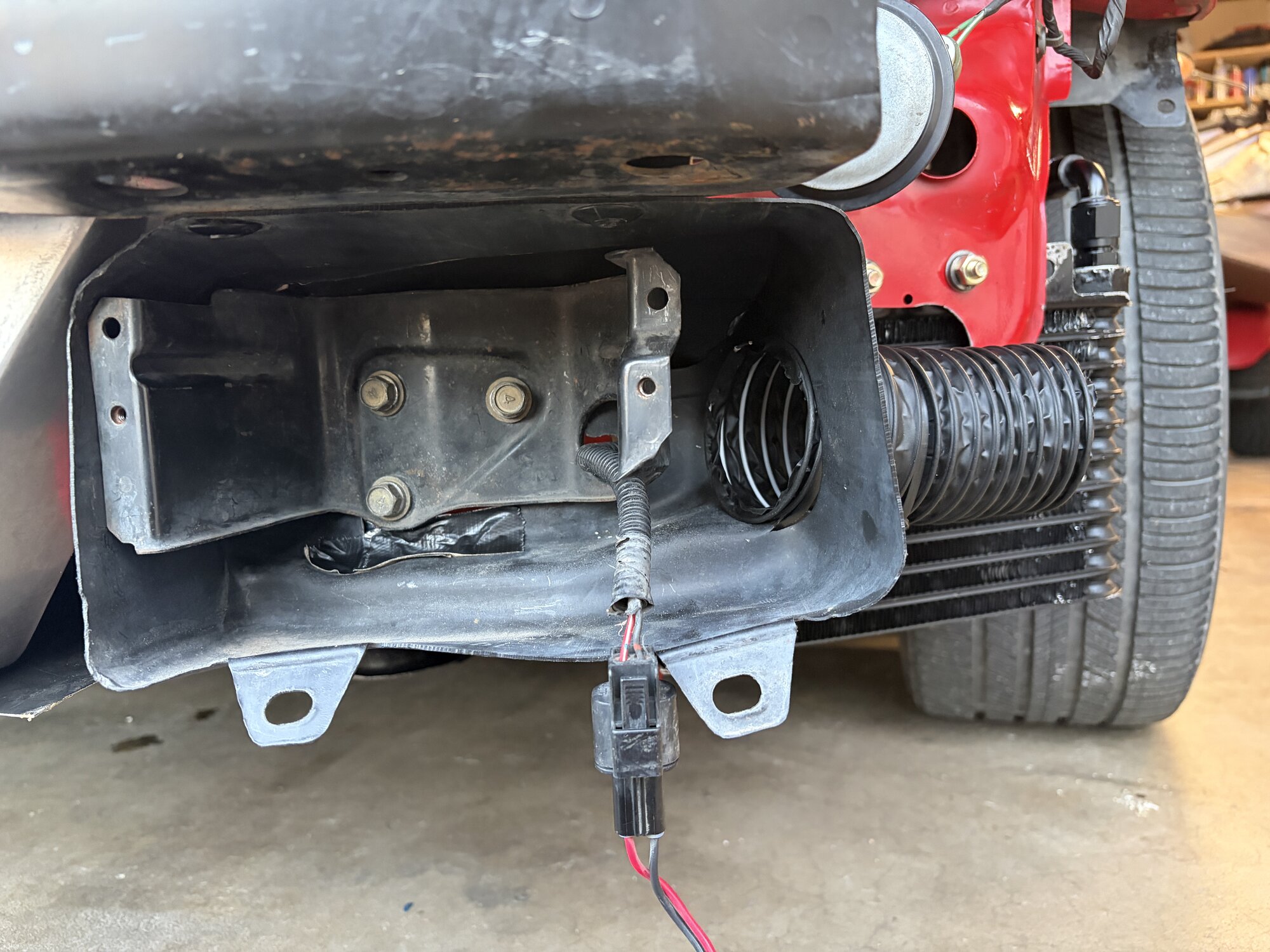

-Switched to air oil cooler mounted in driver bumper well

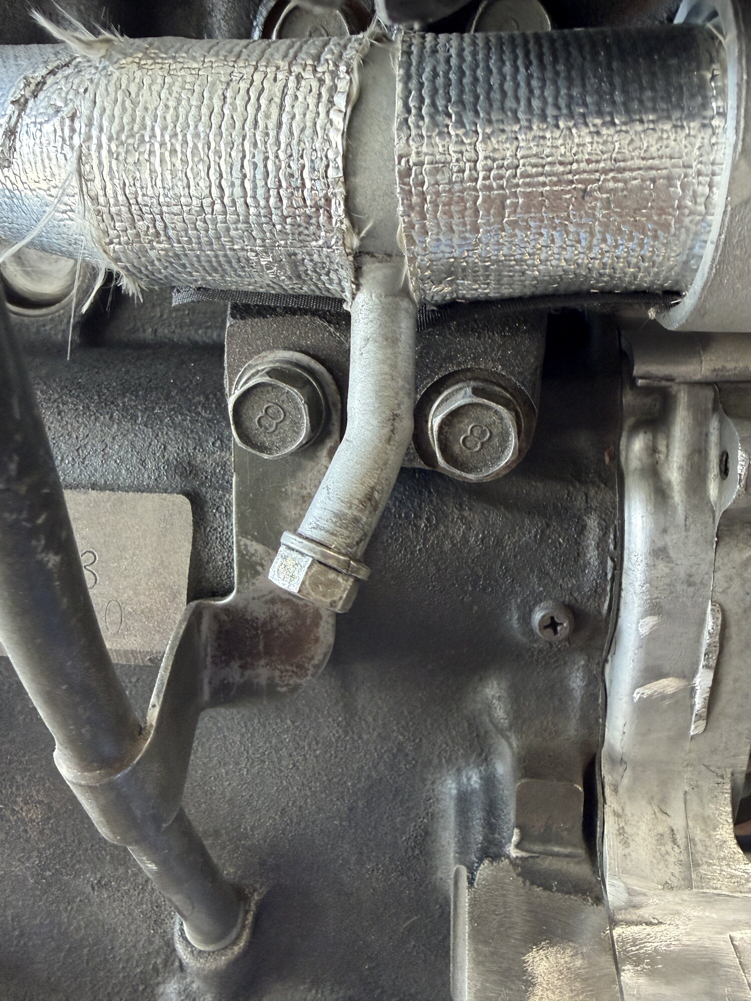

-Epoxy filled water pipe port that went to water oil cooler

-E3 16G to 20G rebuild/upgrade from Justin Whitesell

Evo 3 16g into 20g upgrade from Justin, and new me Evo 3 o2 housing.
Epoxied bolt into water pipe port, heat wrapped as well.

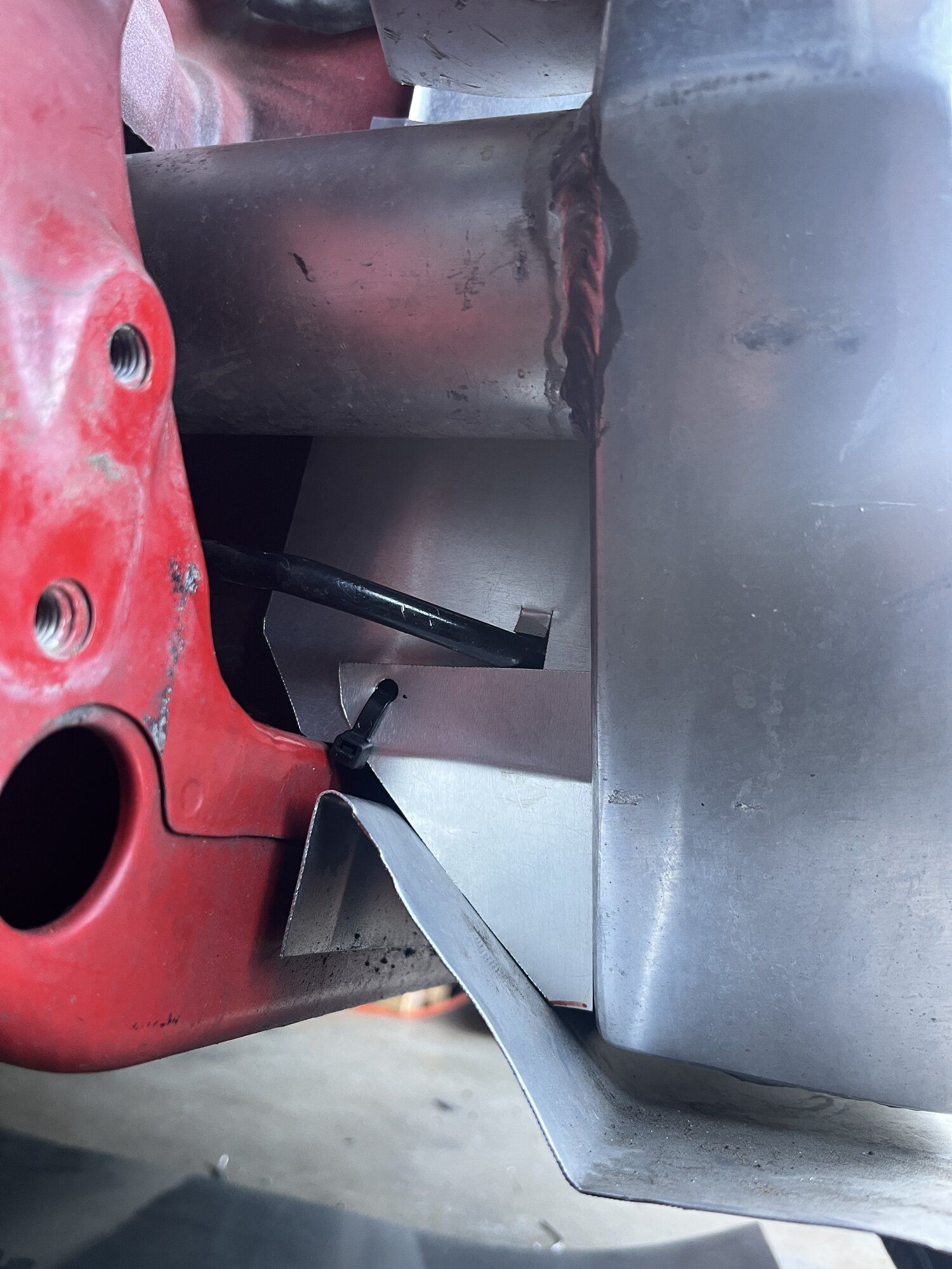

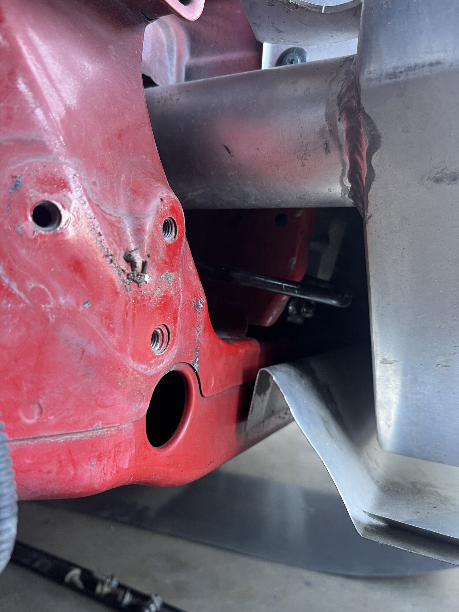

Oil cooler mount/holes drilled, didn't want to cut away the whole panel. Will add ducting as needed.
New motor going in.

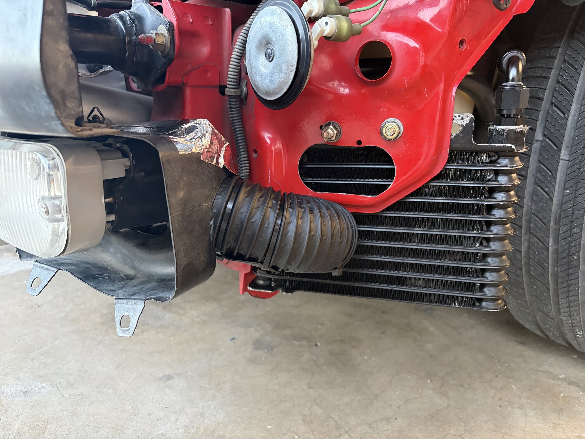

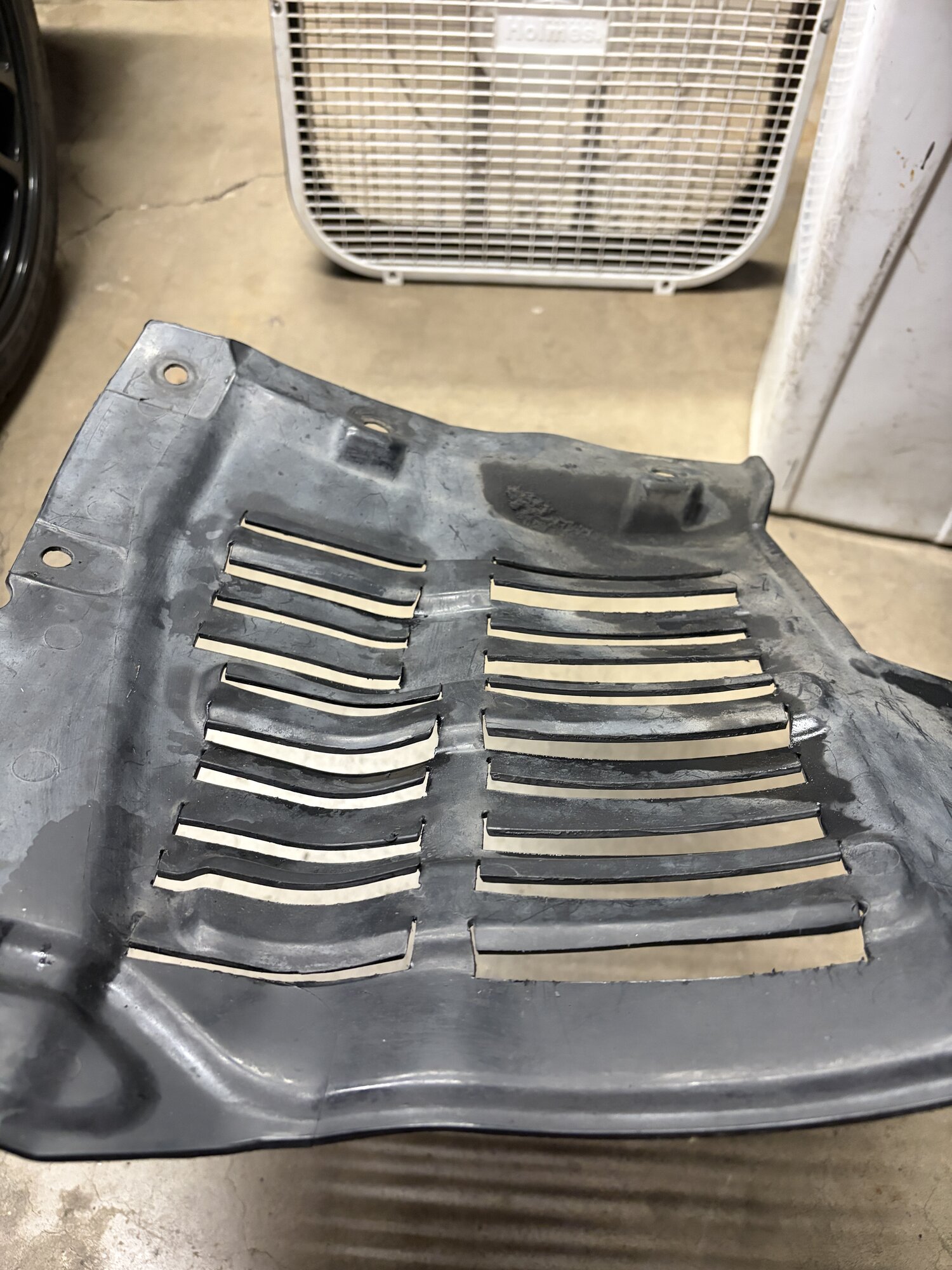

Some temporary ducting for the oil cooler. Laser cut a hole in the plastic, and enclosed the rest with cardstock/ducting tape for now. Added the 2.5" ducting, and had printed a "scoop" for the oil cooler, but not sure on aerodynamics behind the bumper yet so left it as shown for now. Was thinking of possibly deflecting backside down under OEM fender liner, or louvering it similar to passenger side by SMIC.

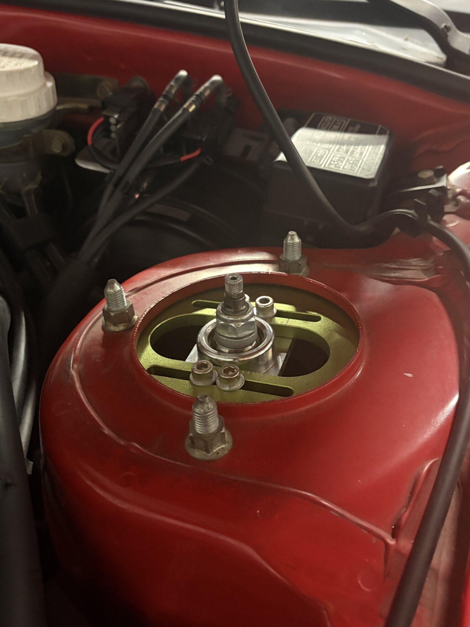

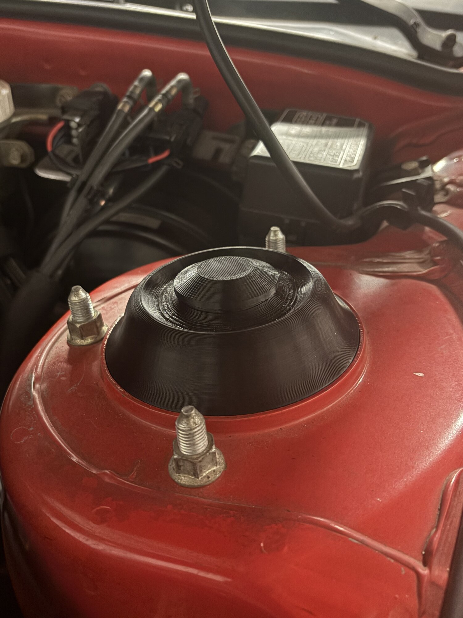

Finally got a semi-finished cover for the coilovers, the idea was to mimic the OEM ones to keep a more subtle OEM appearance where I can. Probably going to give it a coat of Plasti-dip or something to cover up layer lines and make it look better.
