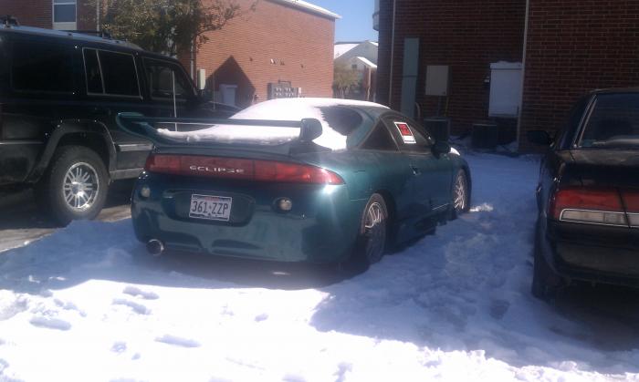

The pic with the snow is when I saw her for the first time.
My first thoughts were, wtf is that wing sticking out???? :barf:
Then my line of sight changed and I had a better look. To my surprise I actually liked the look and knew there had to be more. Also the for sale sign stuck out as well.

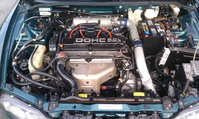

So the other day while detailing the engine bay I removed the head shield to better clean the block and discovered a hairline crack in the manifold. So I picked up an aftermarket 4-1 off craigslist yesterday and will be picking up a new manifold gasket and a couple of bolts in case a few break. Will be using some kind of blaster to penetrate the rust and seizure.
Also today I picked up Amsoil 5w30 signature series, and Amsoil Oil Filter. Going back tomorrow to pick up Amsoil Engine flush as well.
I have a shop back home with welders, drill press, shop compressor, just not lift. Plenty of jack stands though.
It's a nice 1 1/2 hour cruise each way and weather is supposed to be perfect.
Also I will be picking up non foulers to space my rear O2 sensor and get my CEL off as well.

1. Wash and wax, detail interior and engine bay.
2. Price check possible evap components that could leak and the end cost of replacing everything.
3. Have a muffler shop quote me on increasing exhaust tubing from header to cat.
4. Try to locate a larger muffler to have installed with 3.
5. Price check gsx brake upgrade parts and where I can do the install.
6. Purchase new coolent hoses for lower and rear of block.
7. Repeat step 1.
Due to recent time constraints with my gradfather having multiple surgeries this past mont, an uncle put on life support yesterday and not expected to pull through I have not been able to get to a shop. Instead I have ordered a few online goodies.
Such as 74-wwhp3 led bulbs, 10 to be exact from superbrightleds.com
Also purchased front and rear upper sway bars, and rear lower off of ebay ~$80 with 2 day shipping for all 3 pieces. :).
I'm expecting both packages either tomorrow or the day after.
I'm also parting ways with my g/f, so I will be moving in a few weeks. There goes about $1000 I wanted to slowly put into my car.
Oh well, slow and steady can win a race right??
Aside from ordered parts, nothimg much but waxing and detailing coming up.
More to come with pics.

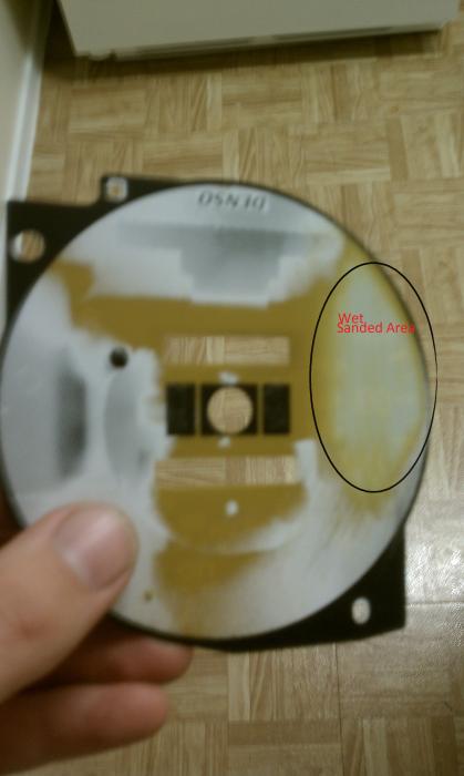

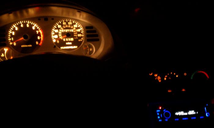

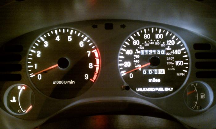

The past few days I have been working on my cluster lights doing the led conversion. I ended up pulling the faces off and wet sanding. It's actually not so bad to do. The only complication is getting the needles back on properly. I'm pretty sure my gas gause is off, when my light comes on I will be able to reset it to where it goes. I am please with the result. However I did notice with the clear plastic that supports the faces has a shroud molded to, what it appears to me, reflect and direct the light in the cluster. I'm debating on trimming/sanding that part away because during twilight and overcast days it is not evenly distributed. I also was no happy with the warm white results so I ordered cool white hoping they will be close to the same as my hid head lights. They should be here Tuesday. Also my ebay fron and rear upper strut bars and lower rear are waiting to be picked up monday morning.

First pic is the difference between sanded area and non sanded area. The last pic is leds installed but faces not sanded. You can see in that picture the difference between the gauges and hvac controls lighting. The second picture is where they are at now. Nice clear white light, but I went ahead and ordered the cool white instead of the current warm white. Once the new bulbs come in I will update with more pics. Also Tuesday is going to be a fun car day. I will be installing the strut bars, flushing the tranny, replacing evap valve on gas tank. Also I noticed the weld where the header meets the downpipe has a leak from some crappy welding from the person I bought it from. I thought I sall a small hole in the weld and it has increased in size. I plan to either have it rewelded or replace the down pipe with 2 1/2" and remedy it that way as well. Then after all that is complete I will most likely follow up with a full hand wash and wax. A nice deep cleaning of the interior and then it's time to pack for my move.

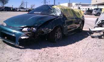

wow, it has been a long time since I have posted here. Well I totaled my car back in Feb., walked away somehow after flipped 7-8 times. I wasn't doing anything stupid, or driving fast.
If you haven't resolved your evap code problem, my end culprit was the evap vent on the top of the tank had a hairline crank, and the hose coming off of it was pretty dry rotted.
So sorry for the major delay as I do not have a DSM anymore, :ohdamn: :notgood: good luck.
