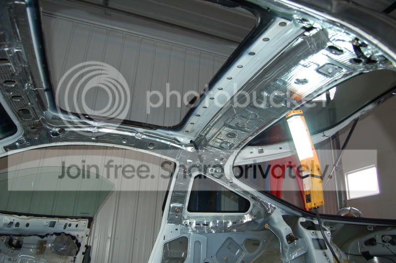

Yeah, Last winter I went a little over-board too. Ended up lining the entire interior of my project car. I also ended up buying 5 gallons of liquid sound deadening to cover what little I havnt on the interior and the underbody.
Ended up going with a product called FatMat because it seemed to be the most affordable. Havn't actually gotten a chance to test it out but it has been holding for almost a year now:

mnim how many square feet of mat did you use? and how many layers? and what plans do you have?
100 Sq Ft Sound deadener Fatmat no logo Dynamat Roller:
100 Sq Ft Sound deadener Fatmat no logo Dynamat Roller | eBay
Only used one layer. I have very little left and still need to do the hatch and doors. I had to cut a section out of the floor when i was putting the AWD gas tank in and it had the undercoating on the bottom and the fatmat on the top, it was super solid.
