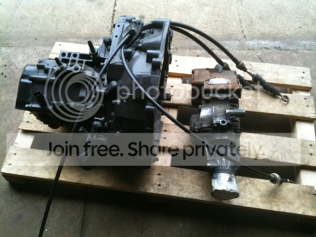

*Blown transmission.. ouch.
Wanted so badly to get my broken one built up, but just couldn't afford to ship it out since the car needed a lot of other w($)rk. Finally after craigslist stalking I found a used one and installed it. Looks clean, feels like it shifts well, we'll see how it plays out....

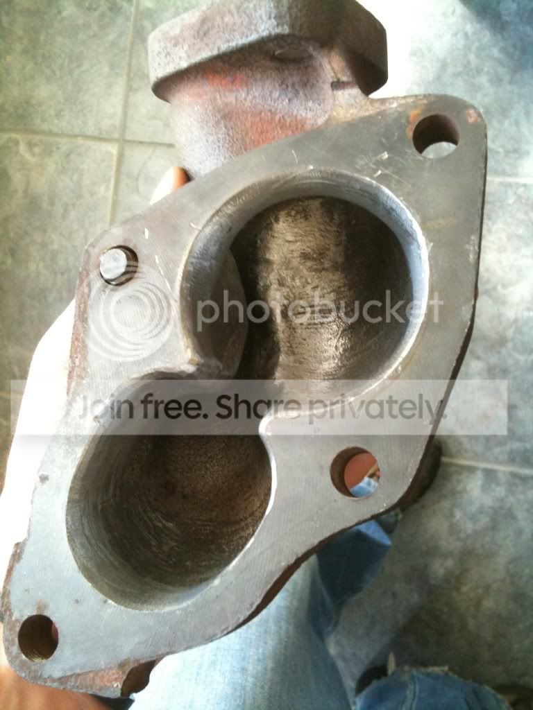

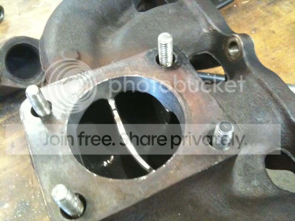

~~Exhaust Porting
I had never used a hand grinder but after talking to several people here(THANK YOU!!) I learned how the O2 housing, exhaust manifold, and turbo hot side should be hacked away at:
This picture below is not the final product, i rounded the inside out for the runners with the hand grinder as well. I CNC machined it to get it to look like this:

~~Shifter Cables
Mine were horrible, all chewed up and disconnected at the bracket on the trans itself. Probable reason the trans went out.. My craigslist transmission seller included a set of 1g cables... thanks a lot man. I installed them because i had no idea and had to rip them out after much swearing. Bought a set of new ones and installed them

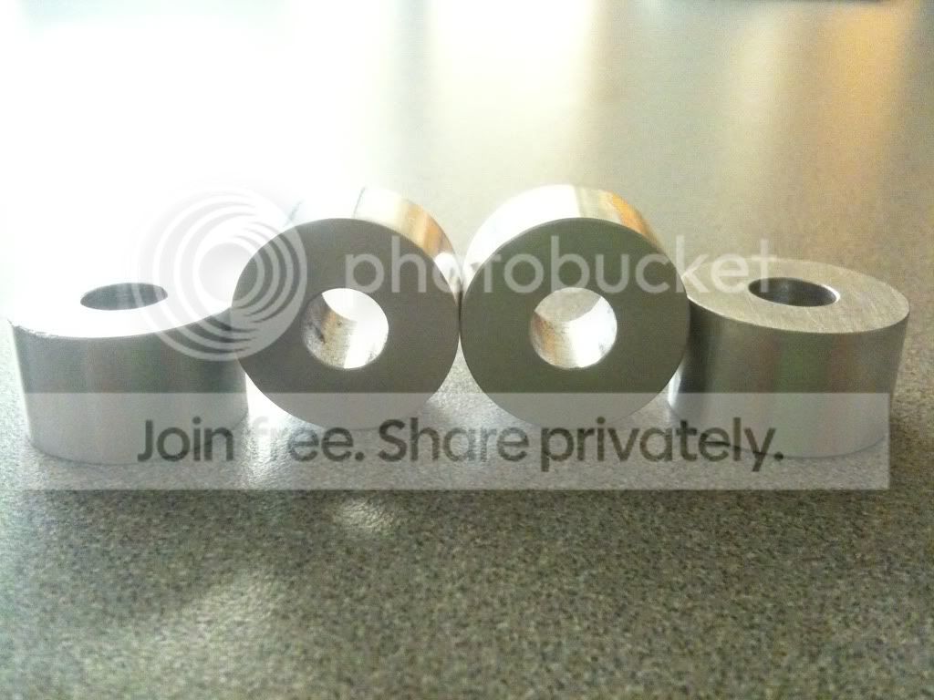

~~Shifter bushings
Why not?#
One of the amigos at the shop i work at cut them out for me :) press fit and designed to include a washer before the pin.#

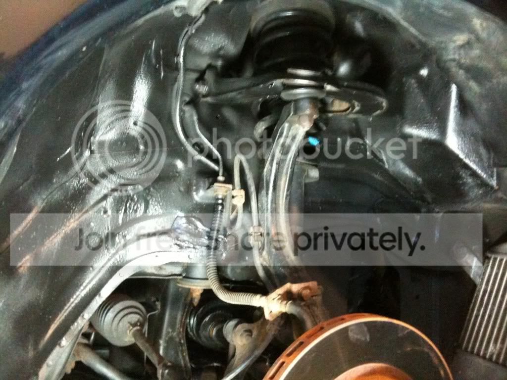

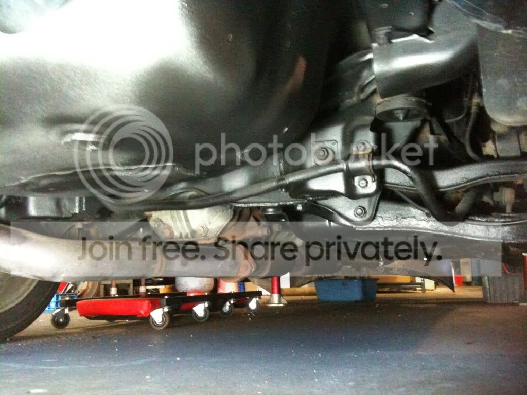

~~Undercoating
Rustoleum undercoating... 2 thumbs up. I sanded and wire brushed off most of the harder rust. Under the car and all wheel wells.

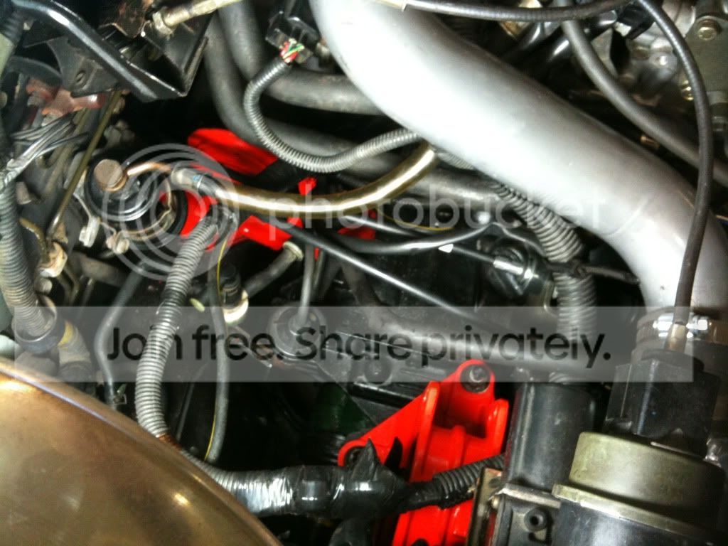

Re-routed some vacuum lines + some wire tucking
Removed the AC belt, pump, core and lines(pump wasnt working, lines all leaked, plus i plan to relocate the alt. There In the future)
Bead blasted several miscellaneous rusty brackets, and repainted them#
Replaced several cr@ppy hose clamps
Replaced several missing bolts(transfercase, trans, o2 housing)

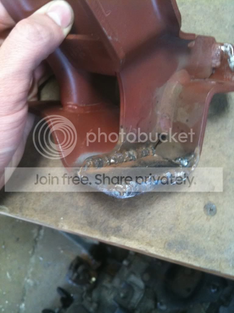

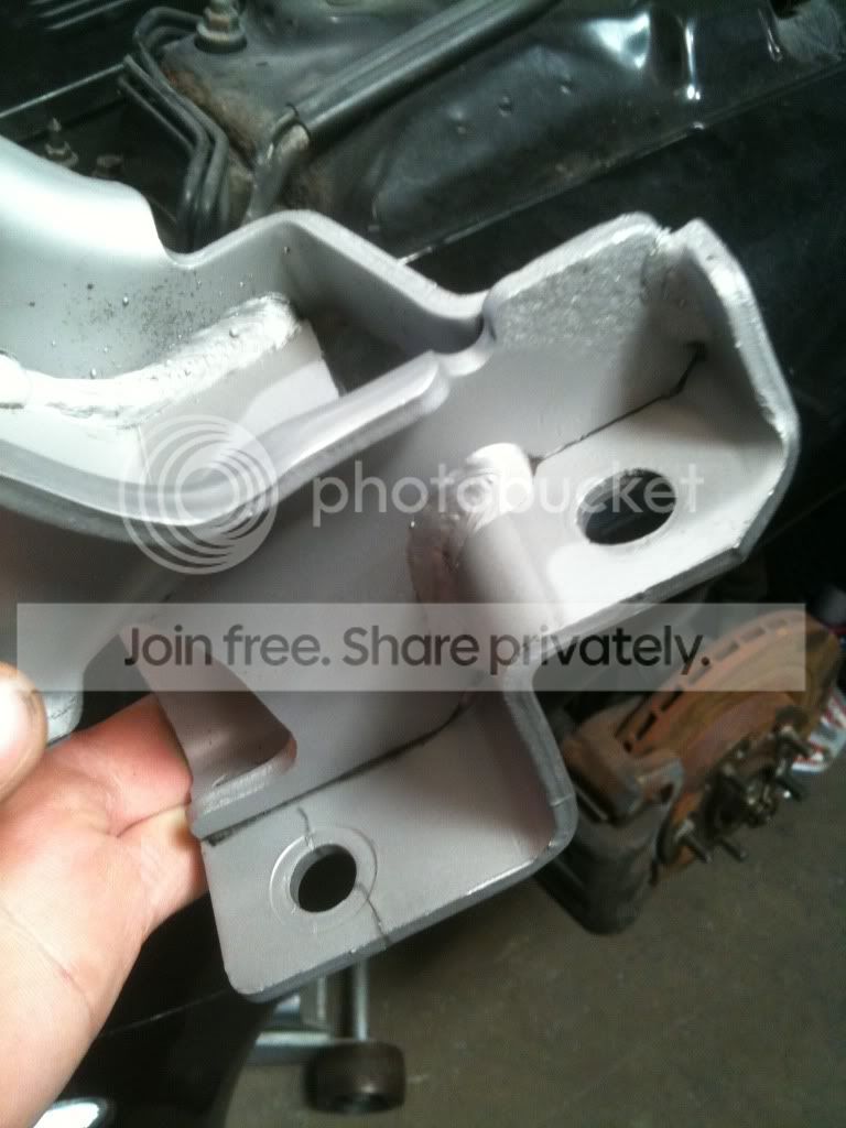

~~Motor mount repair:
I had a crack forming so we welded it closed, then welded another thick plate there for extra support. (yes i did drill press a hole in that plate after the picture was taken)
Picked up some obnoxious orange engine paint and jazzed up the ugly mounts while they were out.
