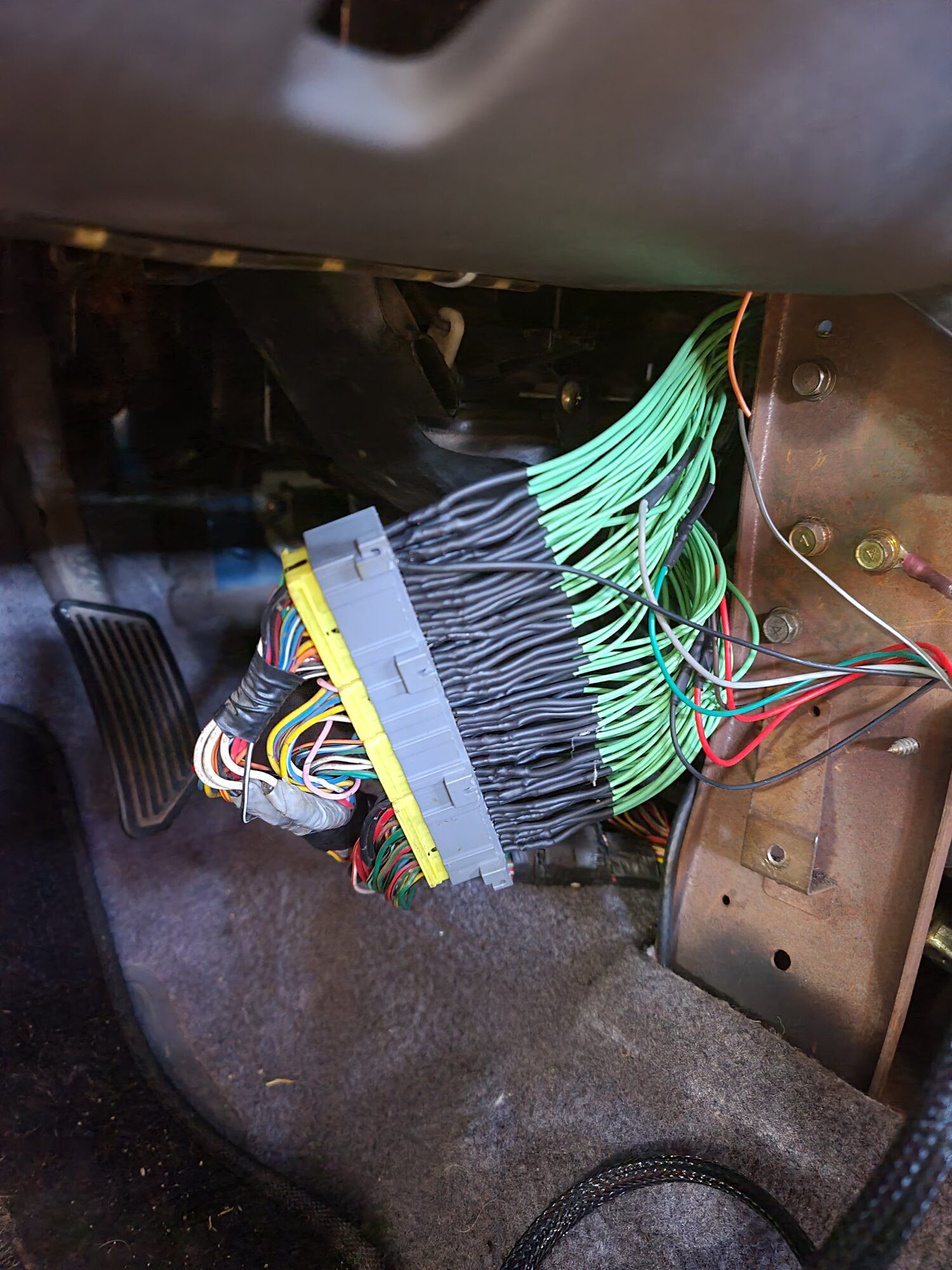

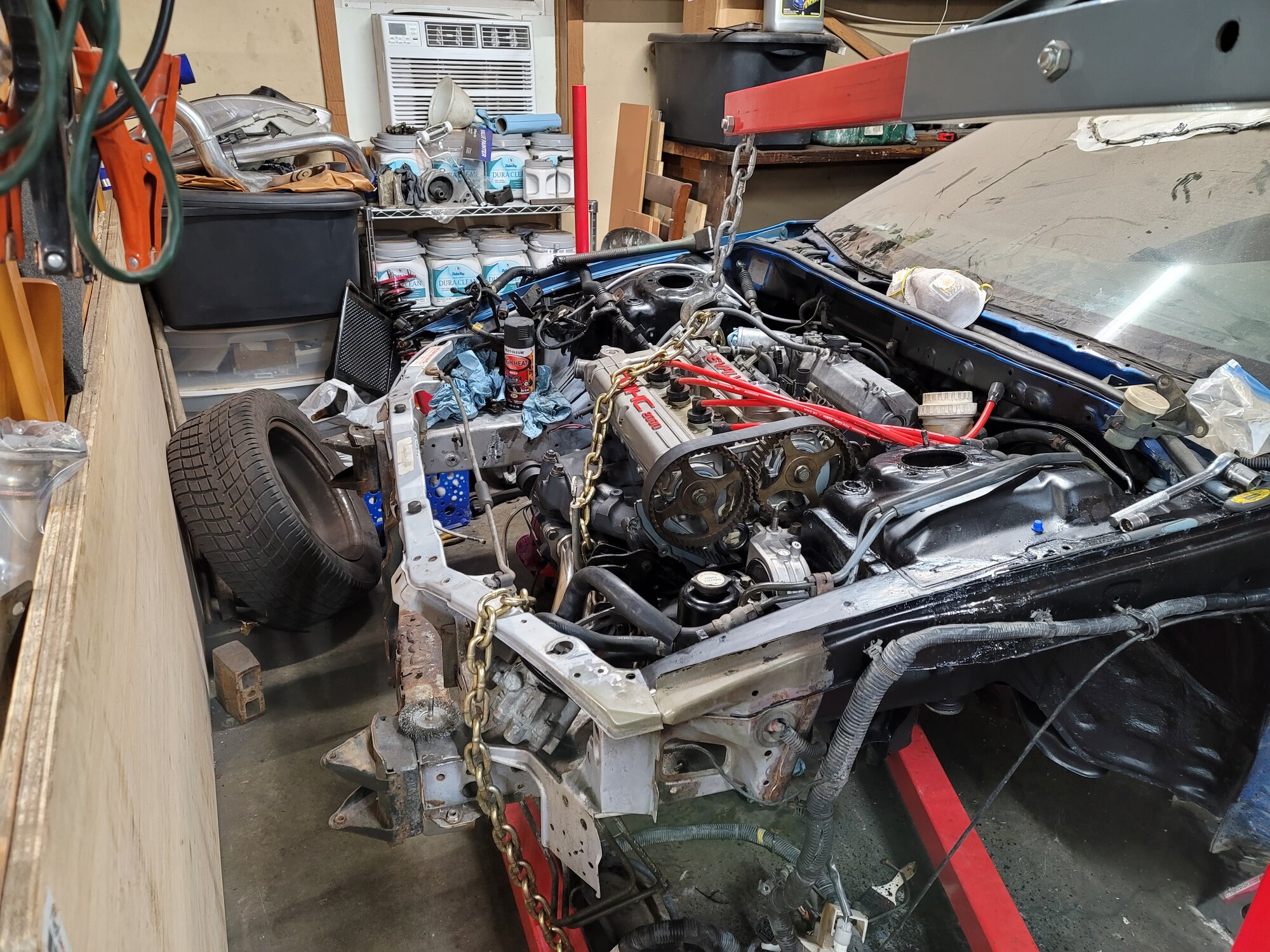

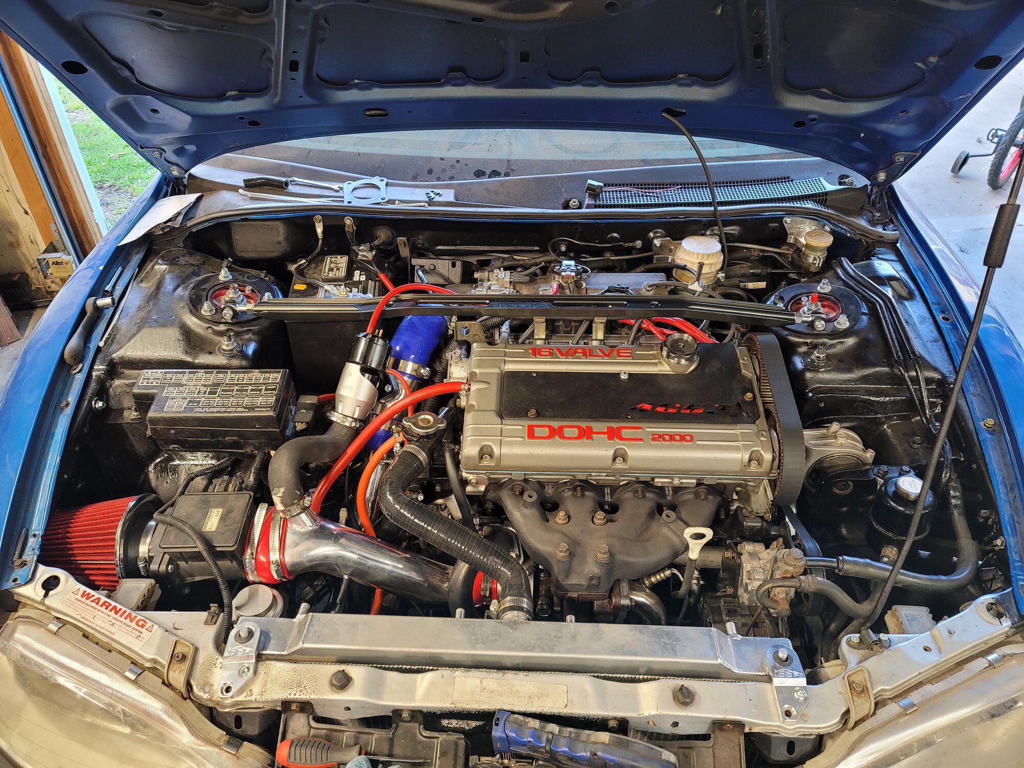

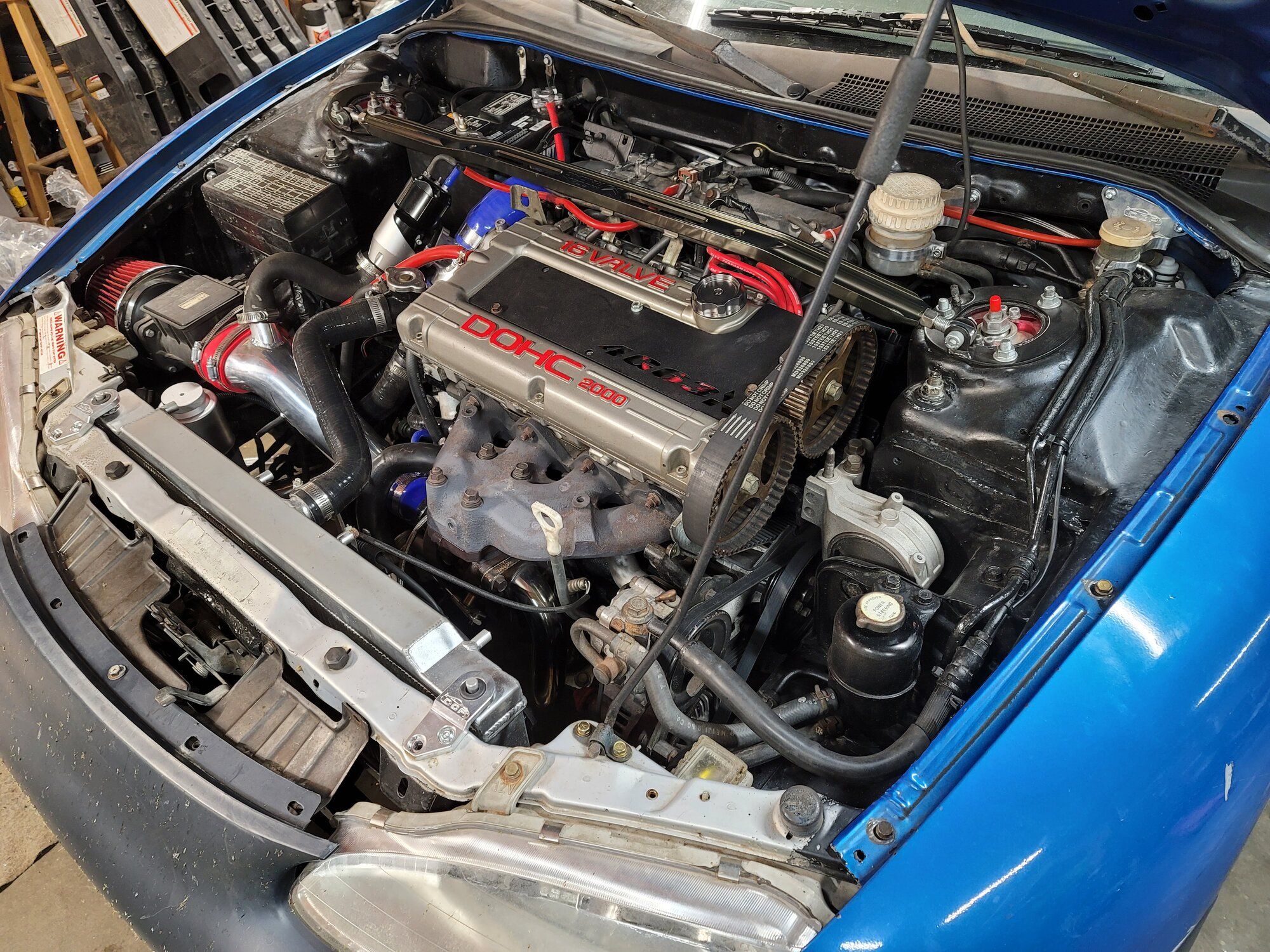

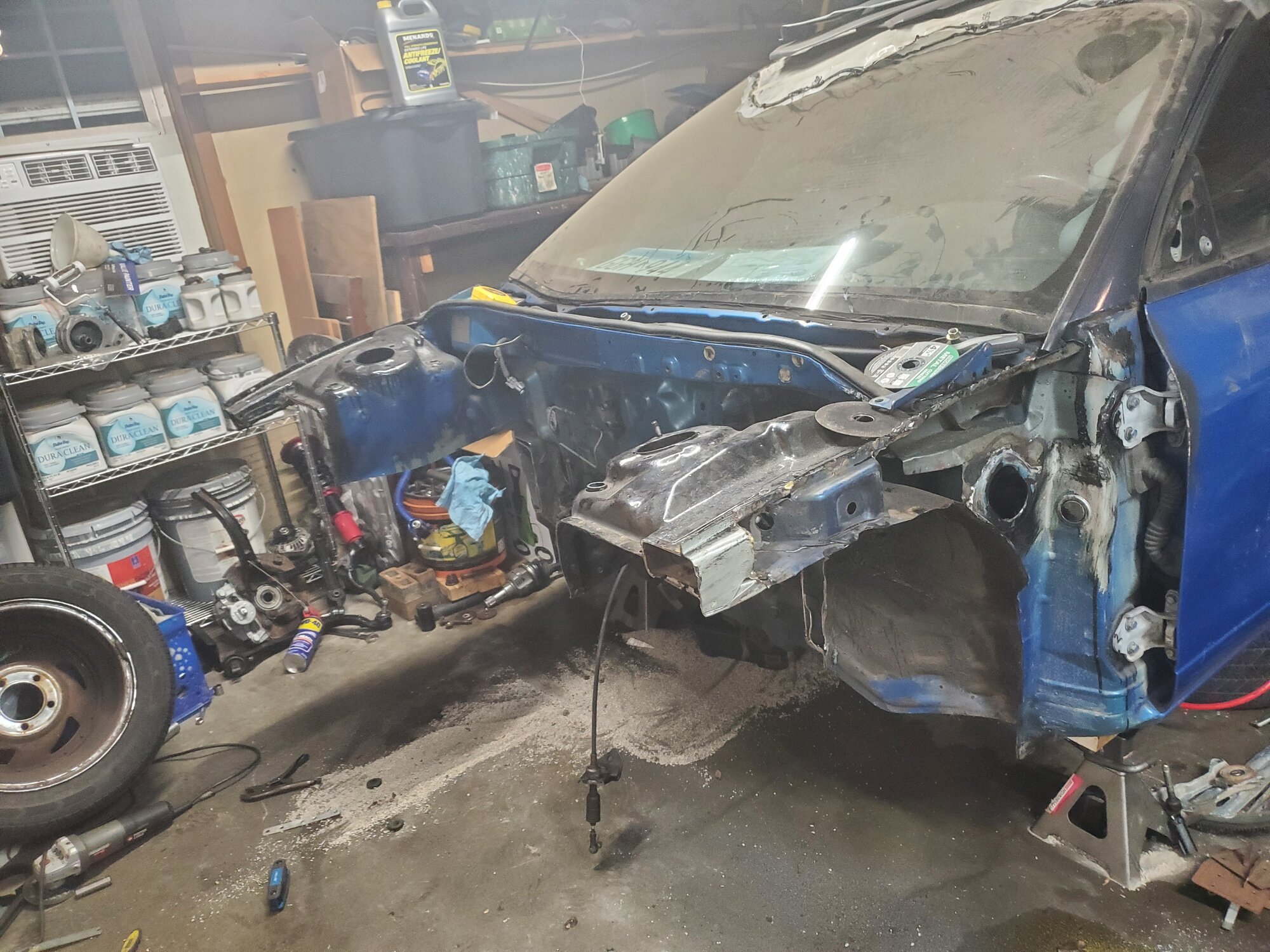

420a to 4g63 swapped eclipse rs. I also swapped it from an auto to a manual. I bought this car from a junkyard with no engine. It's currently a doner for my 95 eclipse rs.
Thank you very much. Everyone's kind words mean alot to me. Without the motivation I never would have finished it. If anyone ever wants to do the job here's proof on how much work it really is. I'm no professional either I do not do body work or weld for a living. I just love to learn new things and challenge myself.
I am deciding not to do alot of body work this summer just so I can enjoy the car. Once winter hits that's when the magic will begin. I'll just do upgrades and stay on maintenance. I'm at 270 miles and zero problems so far.

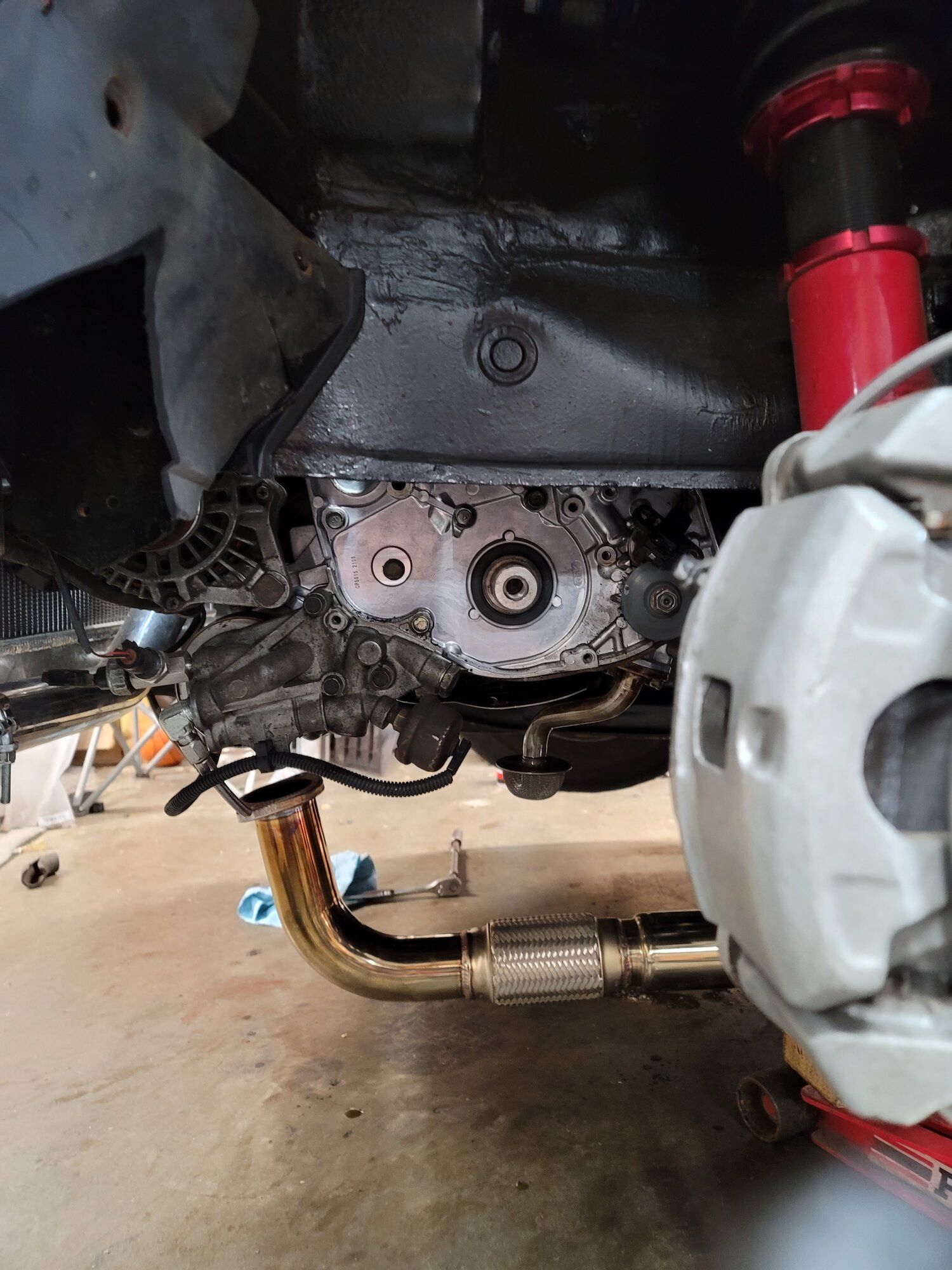

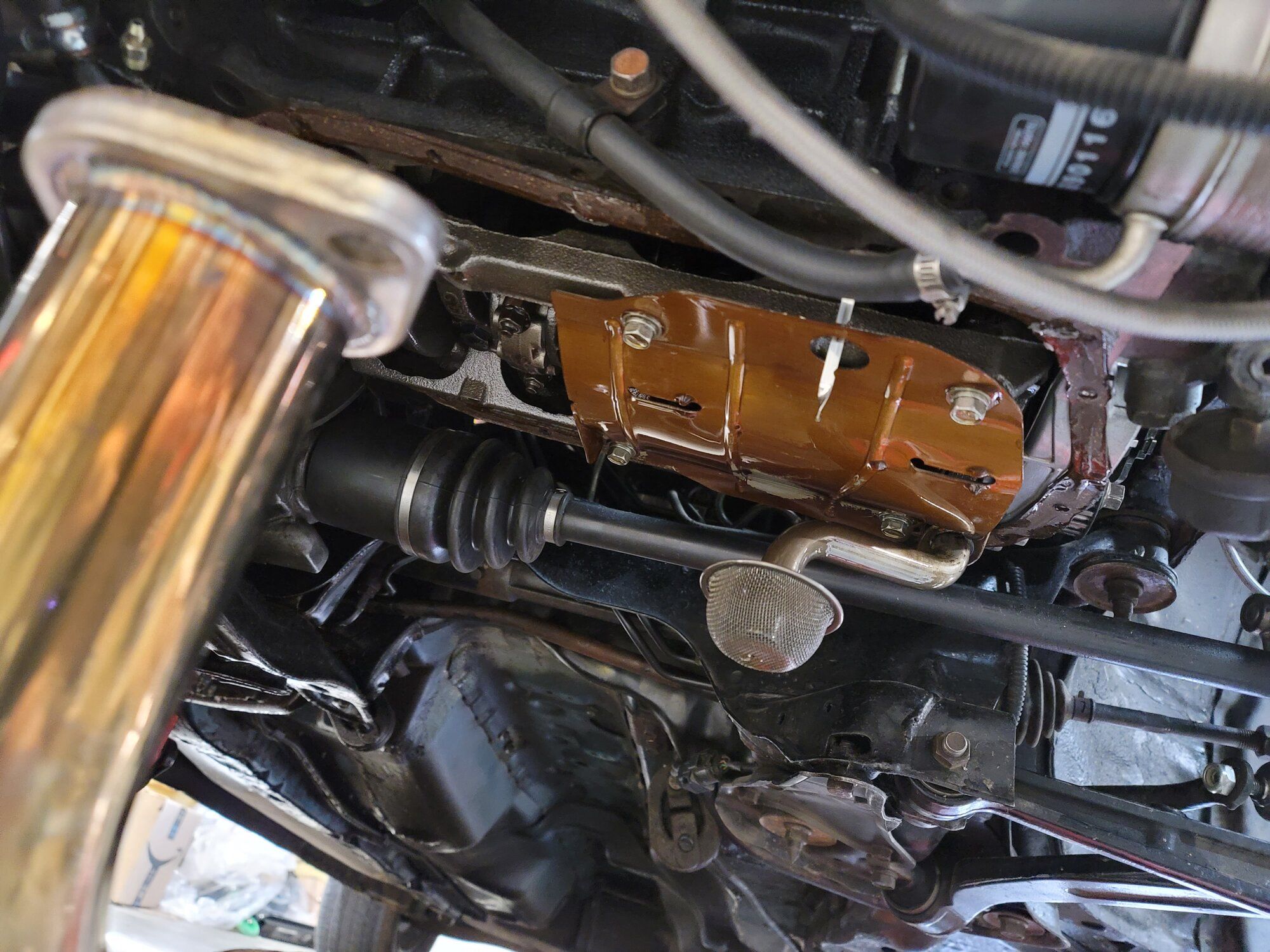

So where do I begin on this one. I'm definitely not perfect and I've made plenty of mistakes. Last night I was reading up on eliminating the balance shafts since that's what I've already done. I've never heard or seen different stub shafts for the kits. Well of course mine was the ebay one without the oiling groove go figure. Luckily I had a brand new oil pump laying around, and I'm hoping since I put assembly lube on that thing it didn't hurt the engine to bad. I saw zero metal shavings in the pan so let's just pray its good to go. I spent all last night tearing it apart and fixing it. The little stub didn't look to bad, if the engine chunks I know why.
I just drove it another 100 miles and everything is fine so far, that's not to say the bearings aren't trashed yet.
I’d say you probably caught it quick enough, great job continuing research even after completion. I’m impressed!
Thanks man, if it wasn't for me researching constantly, alot of things would be broke. I hope I caught it in time. I'm going to start building another engine and use all the knowledge I've gained from the forums to do so.

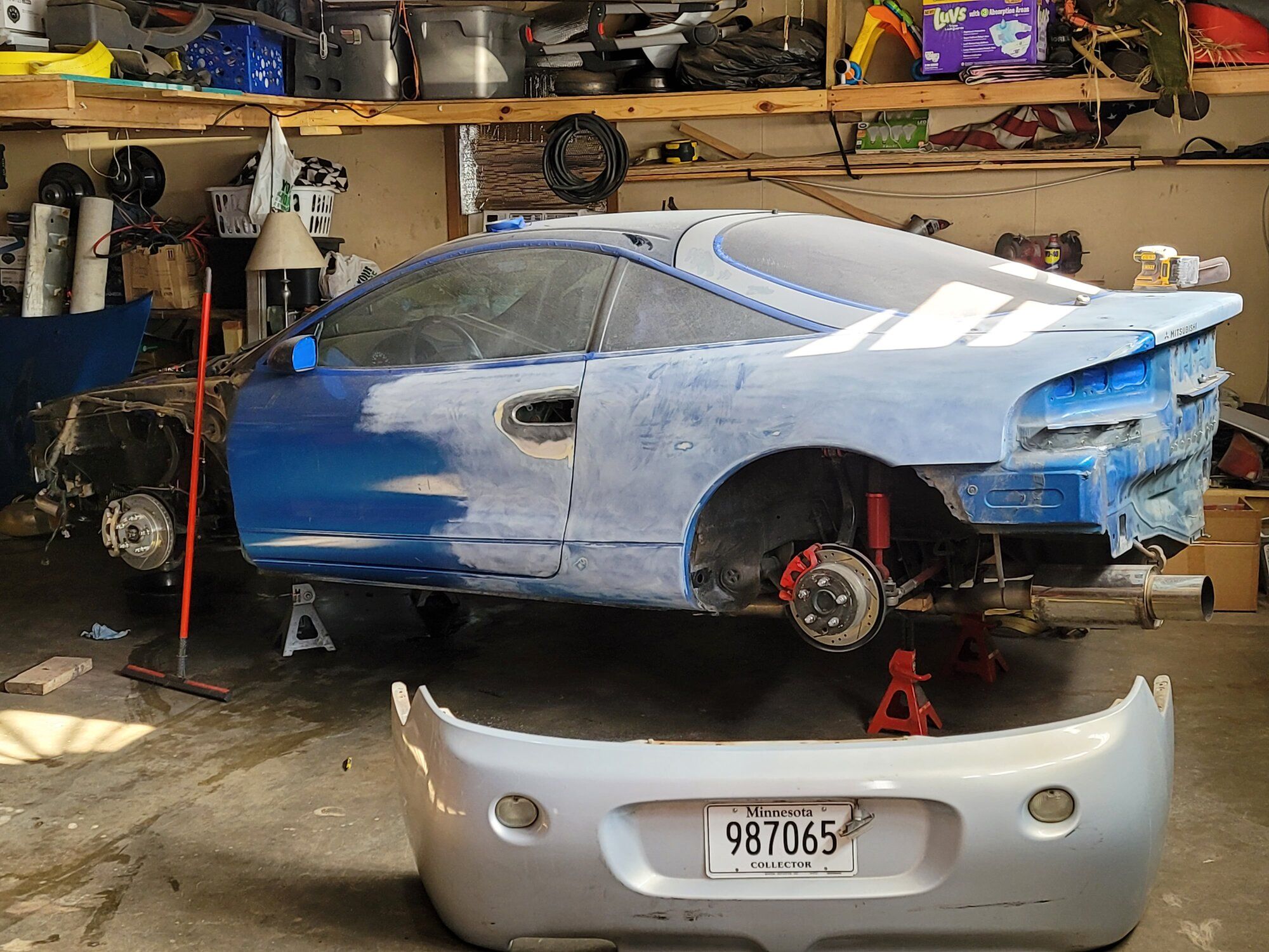

Thanks for all the kind words I'm going to wait until winter. I just dont like the look of the different colors and what not.
Some call it patina🥸 up here in the Tri state, as long as the fitted(baseball cap) matches the kicks (air force ones) your good.

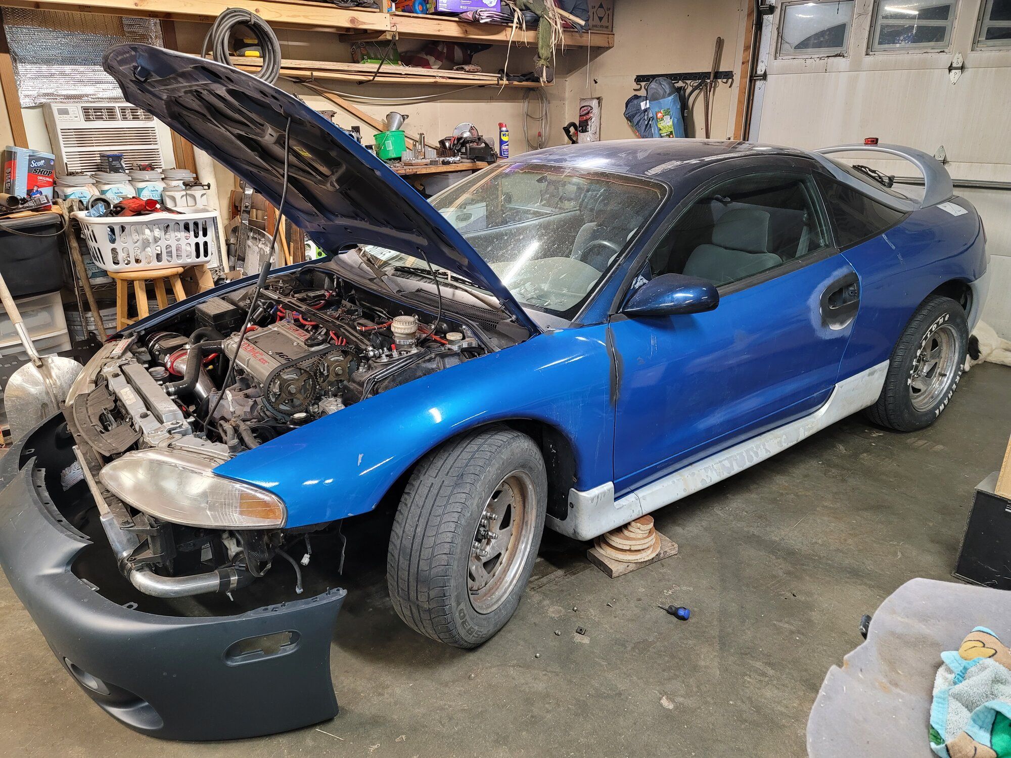

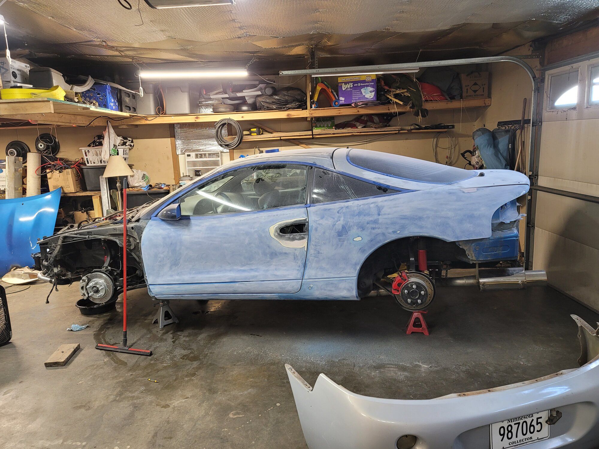

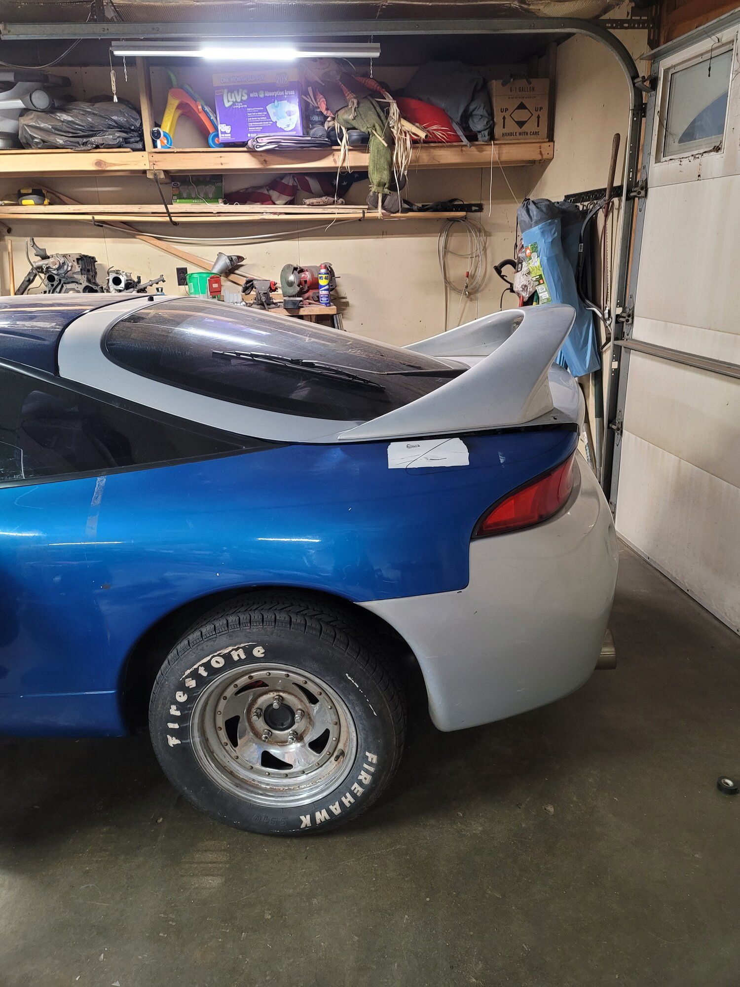

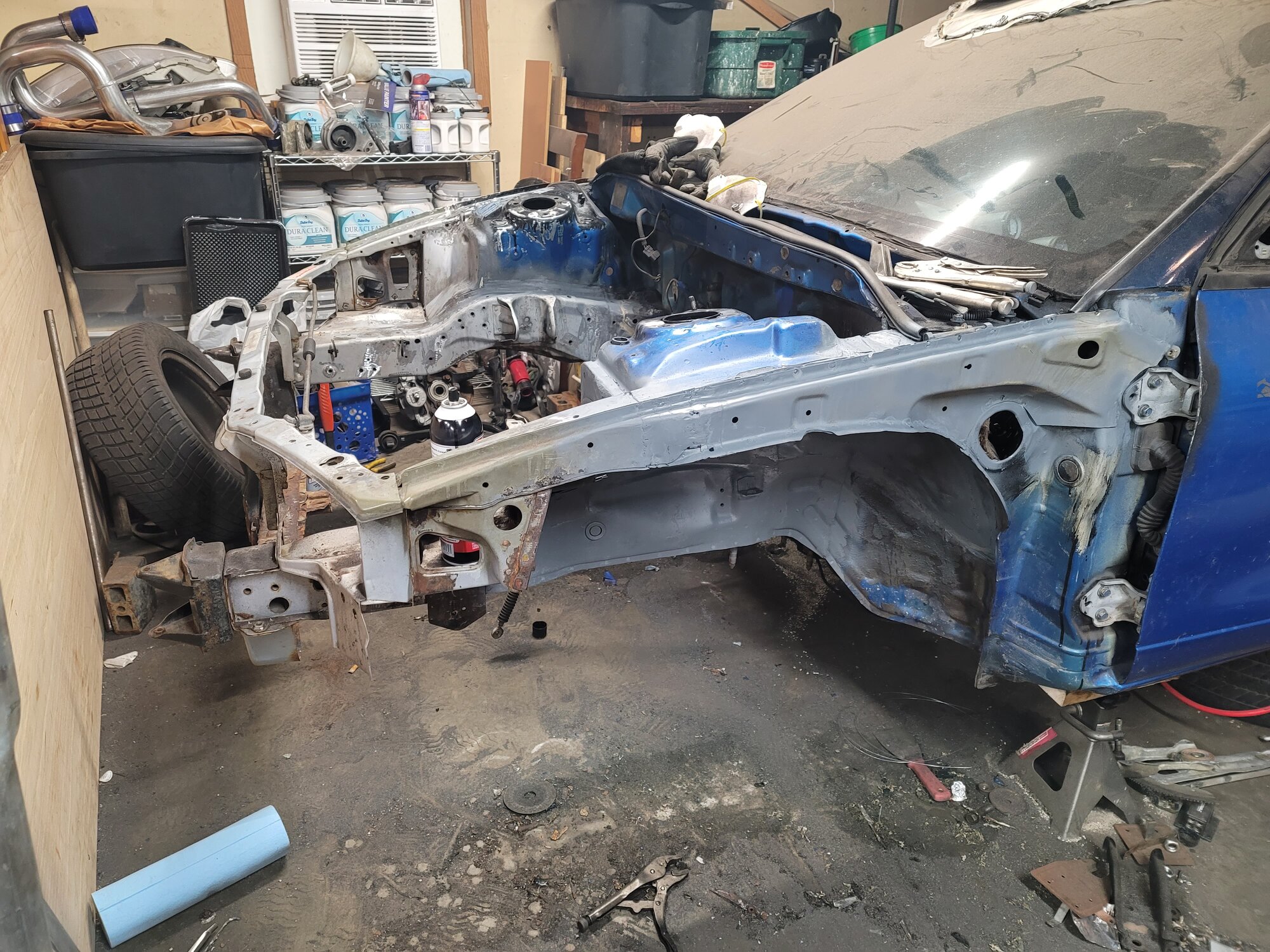

It's been at least a month since I've driven this poor thing but I can't stand the different colors. I'm test fitting for the 2gb conversion since I have all the parts, the wing is already mounted. It needs tires pretty bad too so why not do body work while I save up.
Sorry if I missed it, what color you going with?
I wasn't sure on color until the nostalgia kicked in. Im going with white, which was the color of my 96 eclipse I had in high-school.
