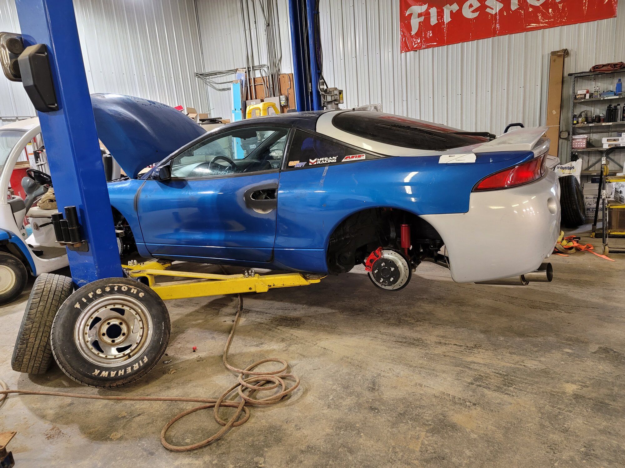

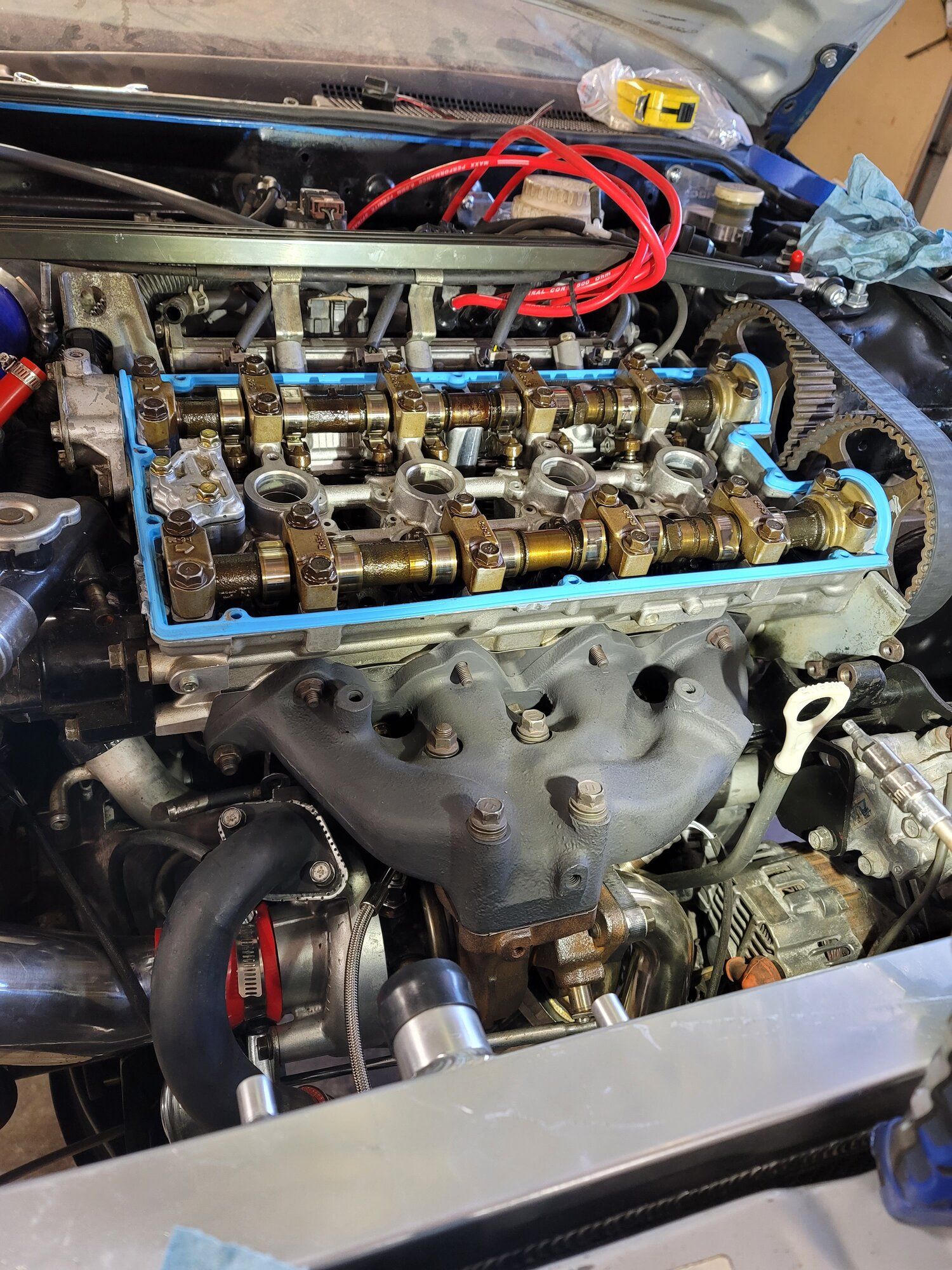

420a to 4g63 swapped eclipse rs. I also swapped it from an auto to a manual. I bought this car from a junkyard with no engine. It's currently a doner for my 95 eclipse rs.

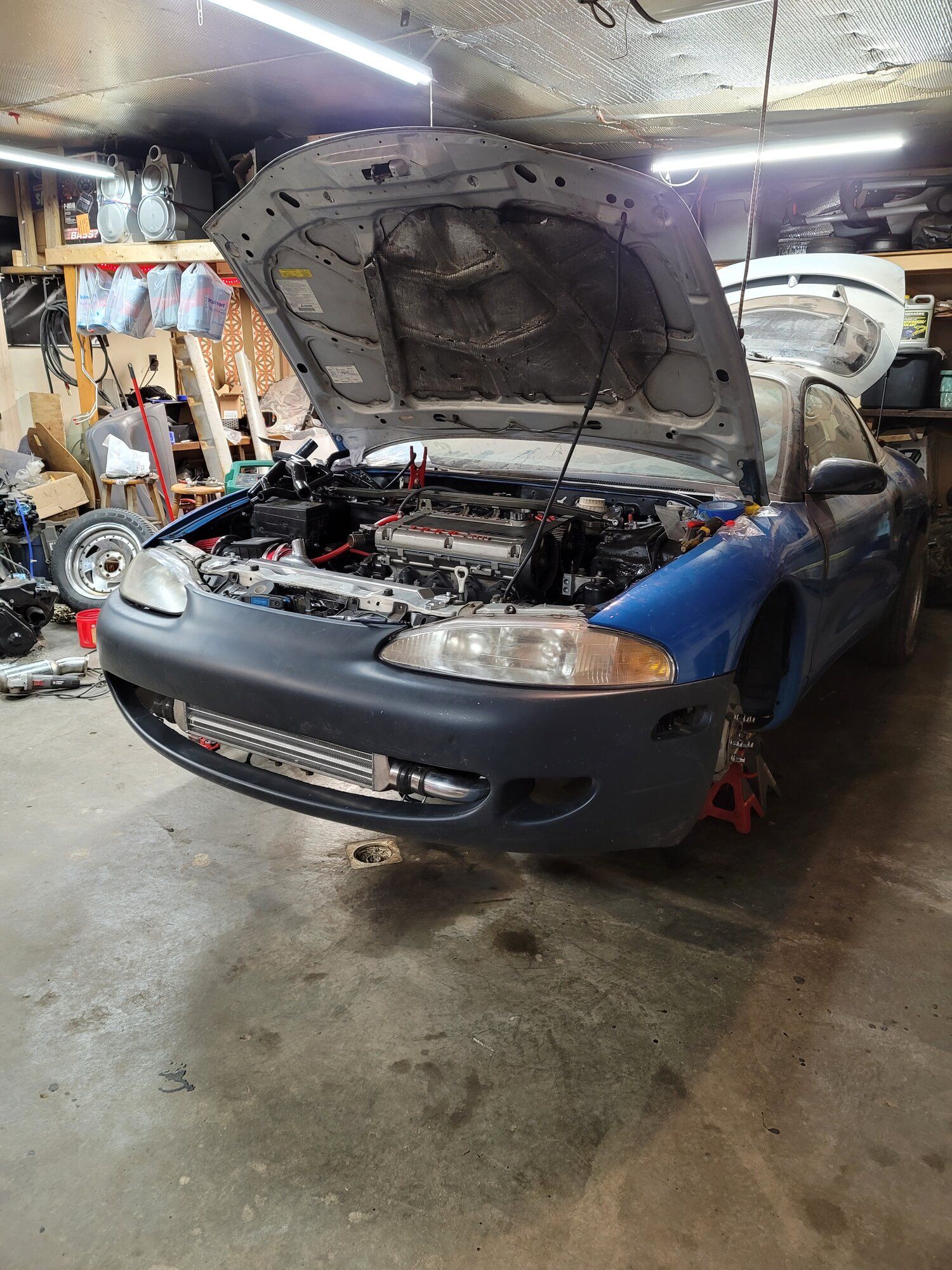

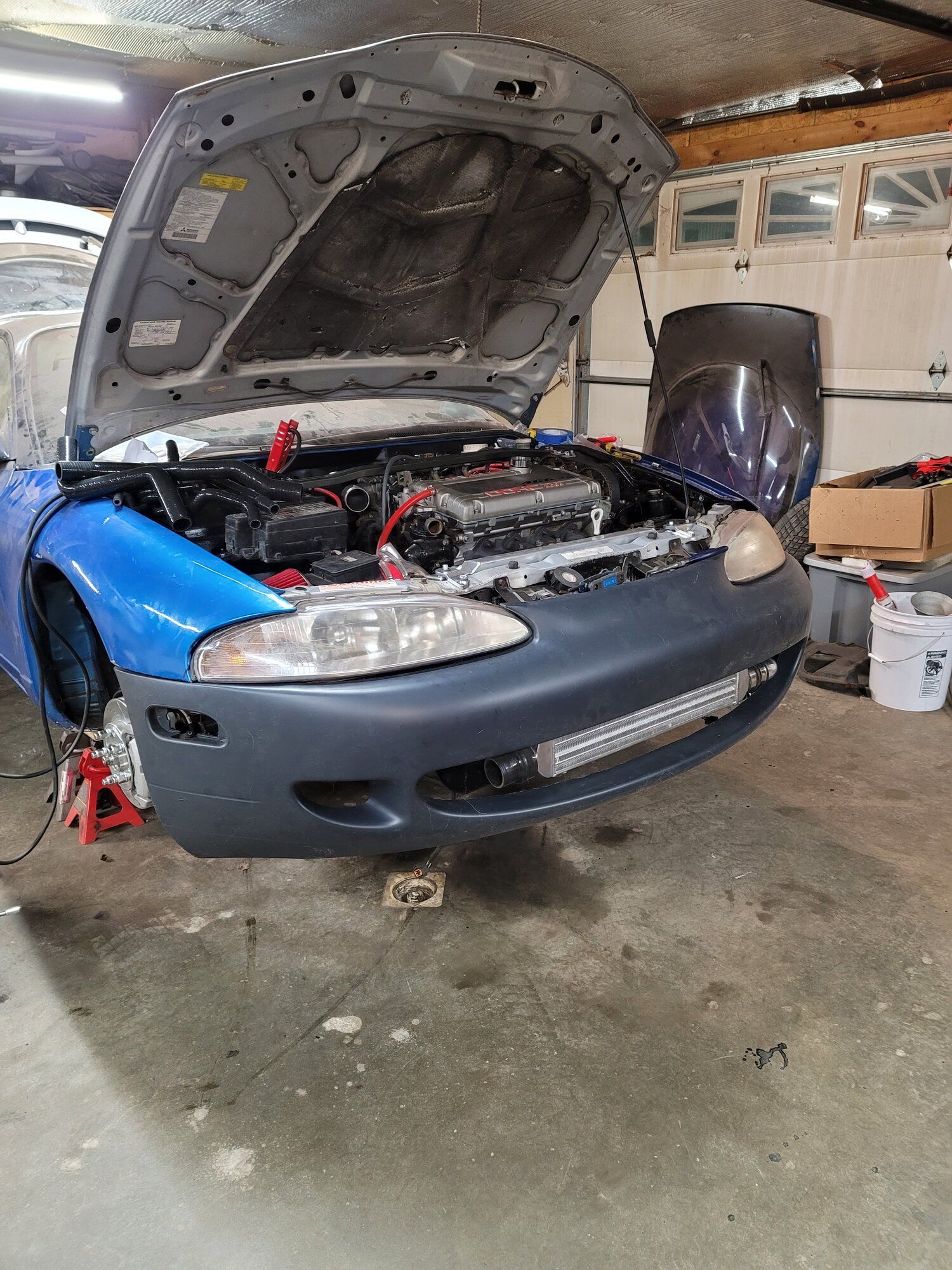

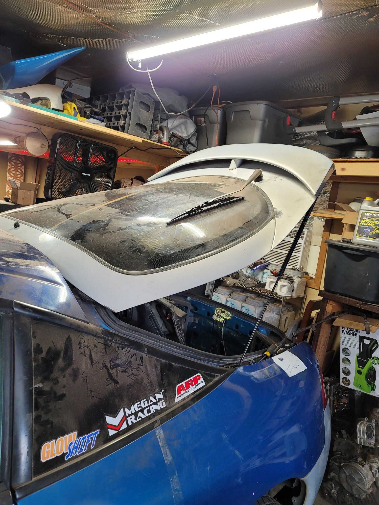

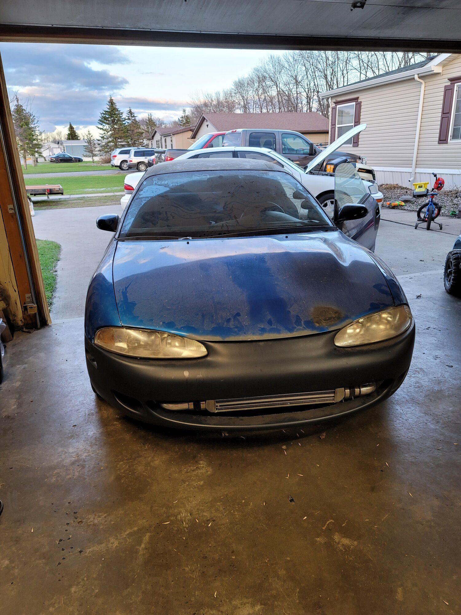

Took a couple pictures test fitting my bumper. The passenger side is all tweaked so the headlight sits funky. I'm kind of all over the place with this build. I start messing with the exhaust and end up fiddling around with the hatch or interior. I still have way to much to do, it's tough to focus on one thing.
Incredible progress and awesome build. Major props. It’ll be well worth the effort when all is said and done! Keep plodding on!
Thank you! Everyone's support means alot. Progress on the car has really slowed down. I'm just trying to make it as legit as I can.

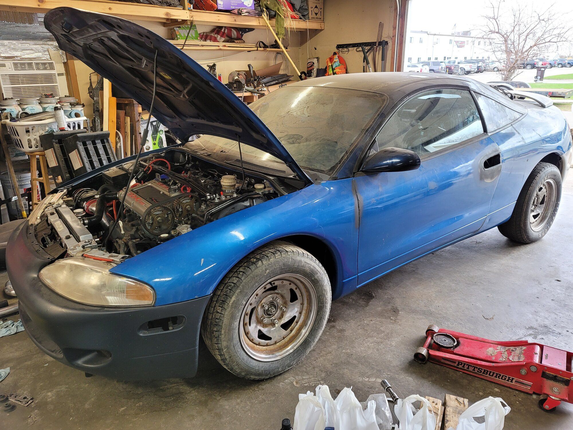

I finally have a video of it running. The idle is a little high. I don't have the alternator or my gauges hooked up yet. That's next on the list. The tps also has to be dialed in I forgot to mention that thing was replaced.

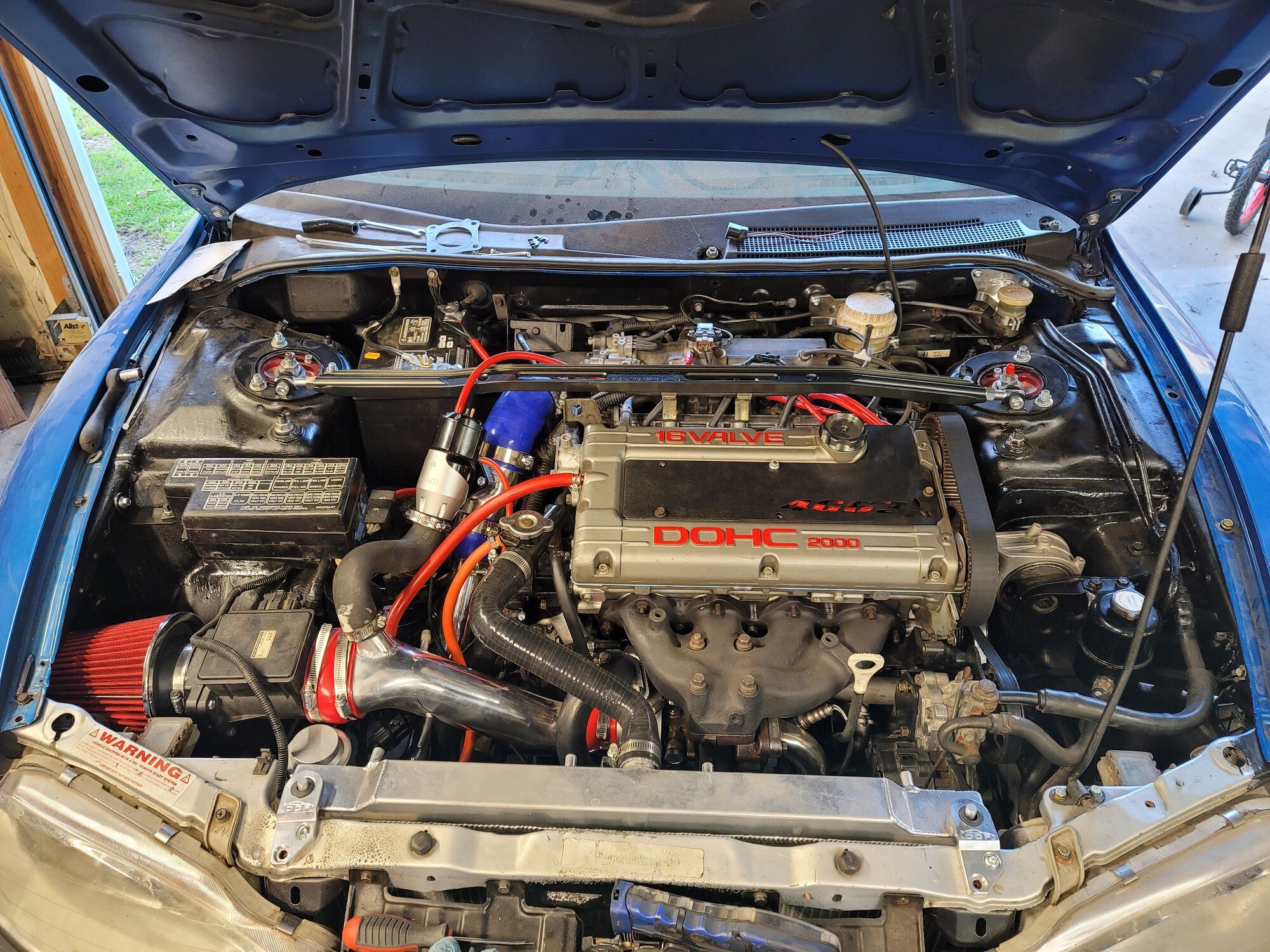

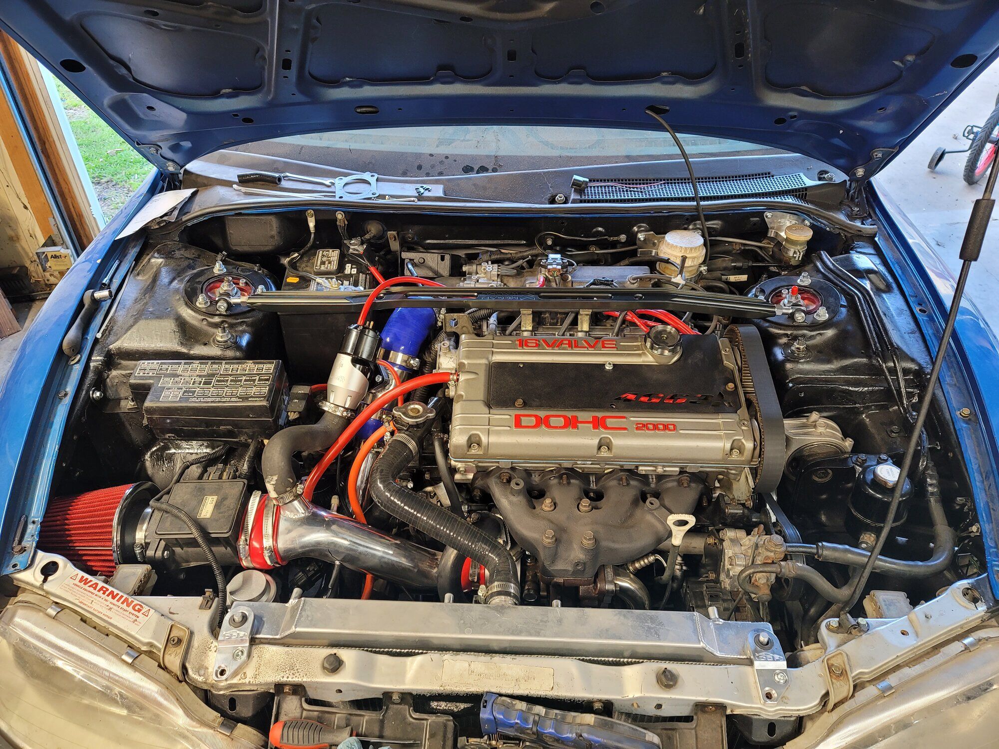

It's been awhile but the swap is 100 percent complete. It runs but I'll have to sort out the idle surge it currently has. It has no leaks and everything is factory setup so it shouldn't be to hard to diagnose.

Well the shake down runs were successful tonight. I will now have to figure out my weird boost situation. I also have a weird 1st gear grind and the transmission developed a nice leak. I think before I dive into the trans I'll get it running and driving perfect first.

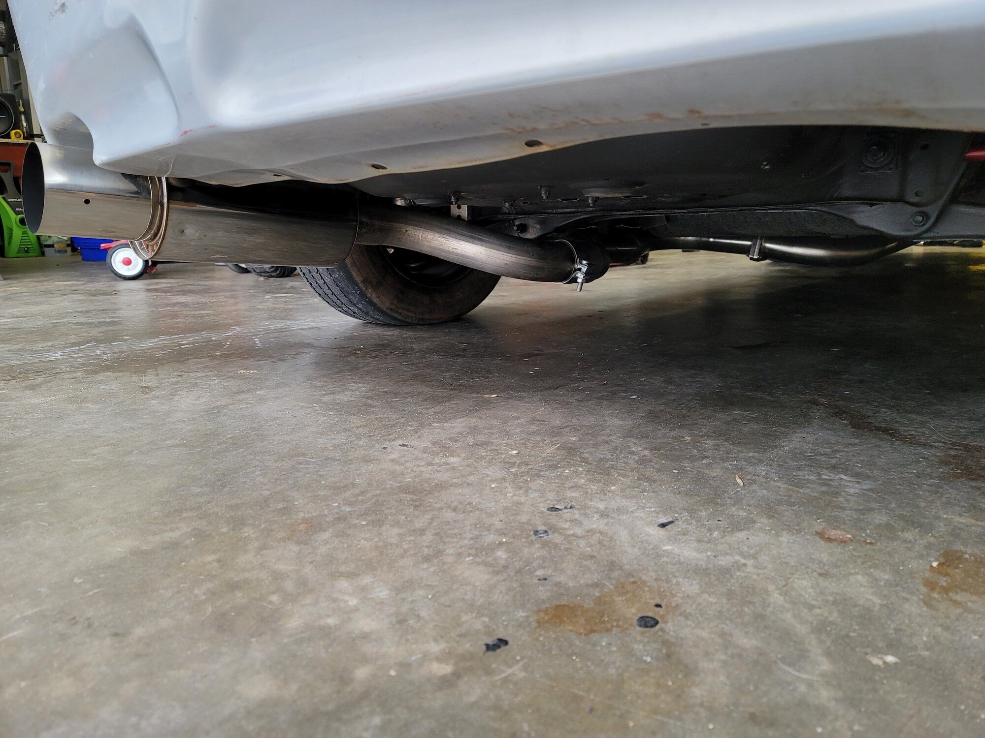

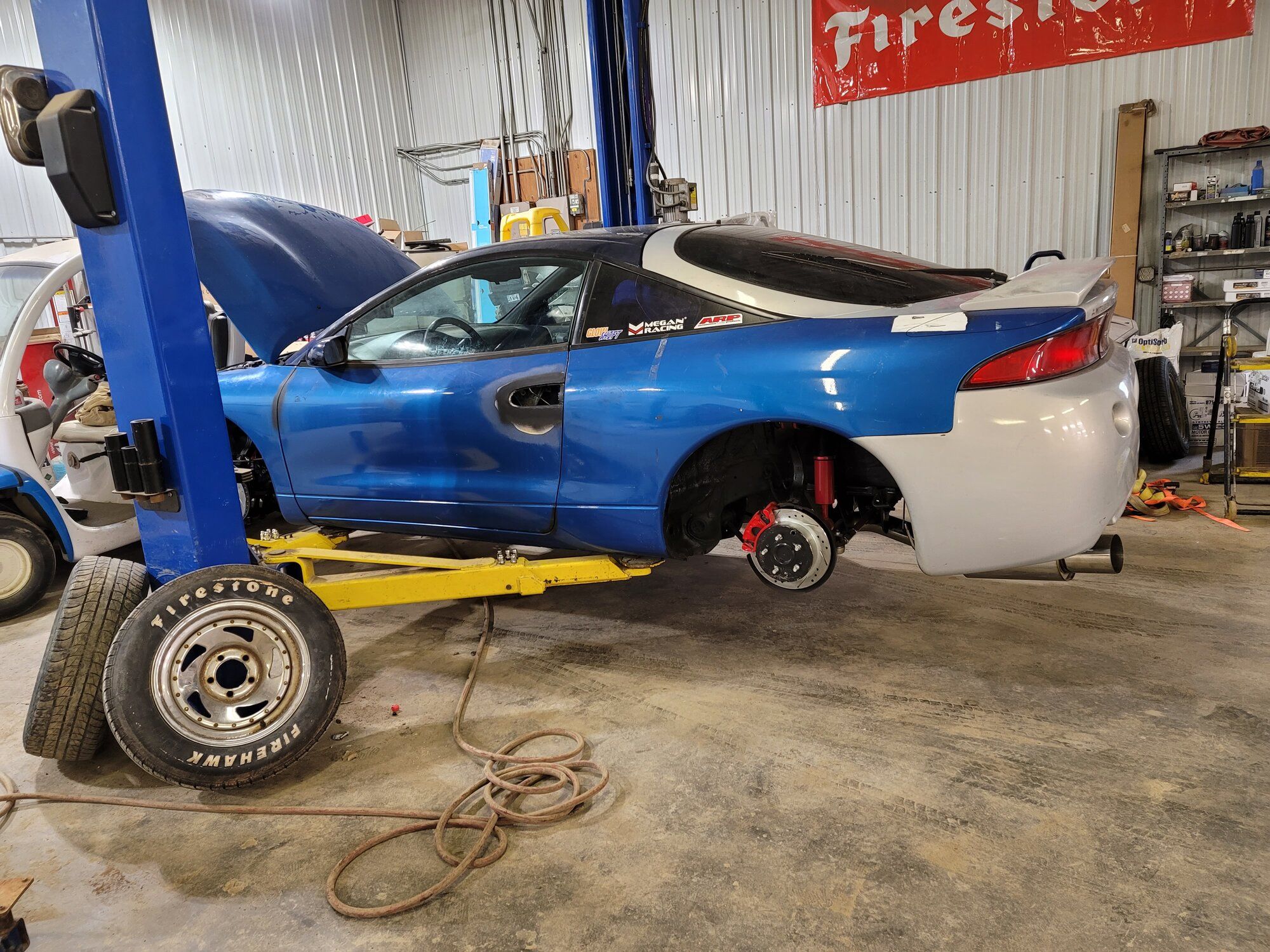

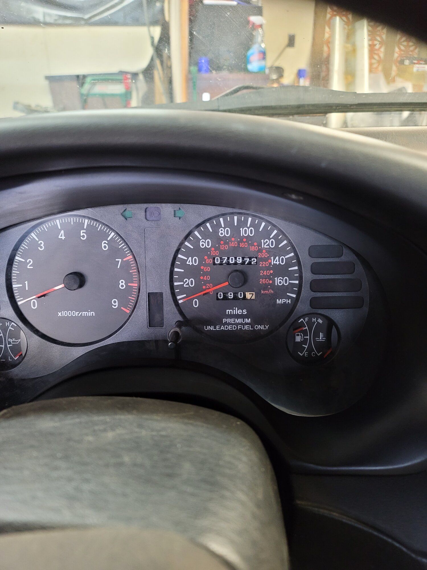

I've been taking it easy on the car but I finally have over 100 miles on the build. The more I drive it the better things seem to get. I also got my exhaust all hooked up and it sounds great. Next up is body work and paint.

A little update I installed a new knock sensor and my boost issues went away. I now have 176 miles on the build and I couldn't be happier. I have a huge smile everytime I make a pull. I put the 14b turbo back on and it feels great.
