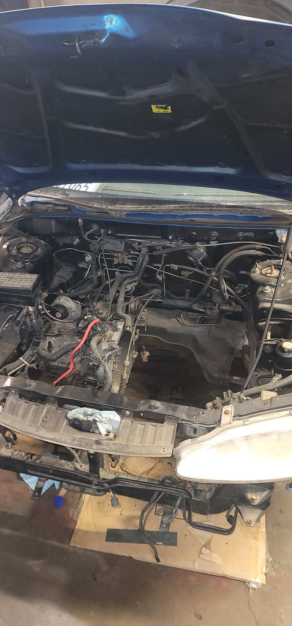

Had a little free time this evening, so I yanked the engine. I'm going to be sanding the engine bay and getting it ready for paint. Its still fully spunked from last summer. Hopefully this will be the last time I pull the thing.

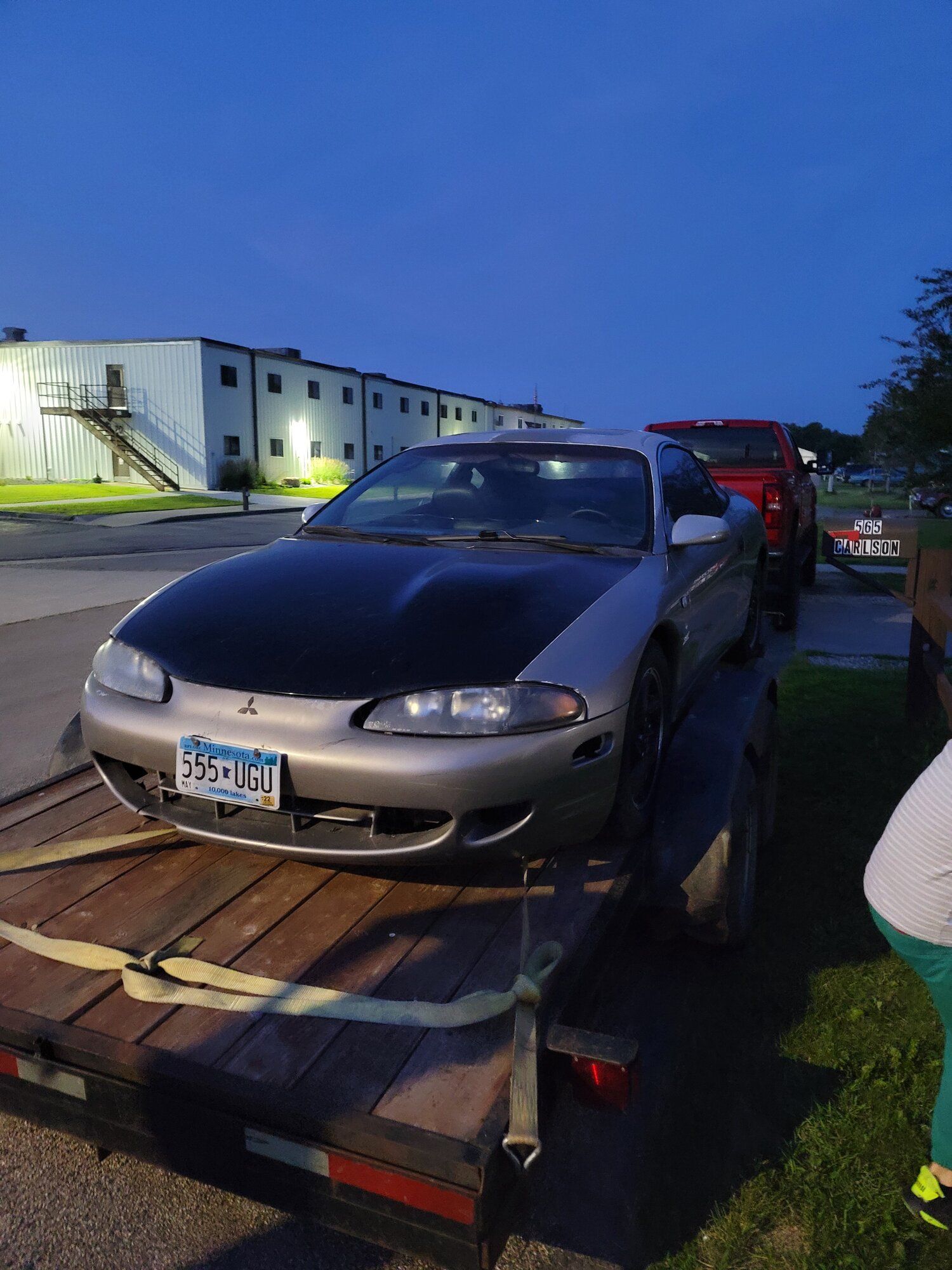

So I'm going to grab the Talon/Eclipse in a couple weeks from storage. I'm on the fence if I should complete it or use it as parts. The only reason I'm even suggesting the partout for the other builds idea is because it still needs a GST dash wiring or whole dash. It also needs an engine.
It's a clean shell so I was either going to finish it or cut out parts for my other eclipse that's pretty rusty. I just can't decide at the moment. But I am itching to do something with it.

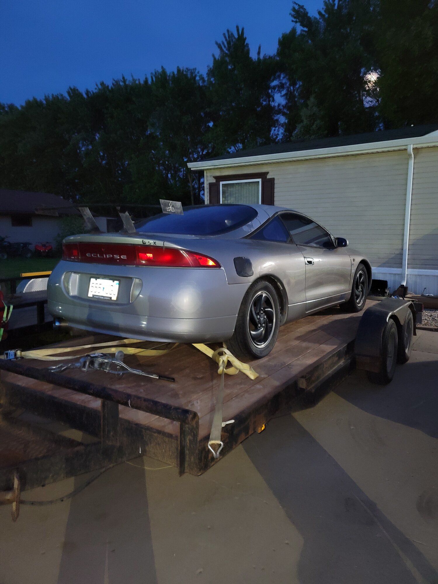

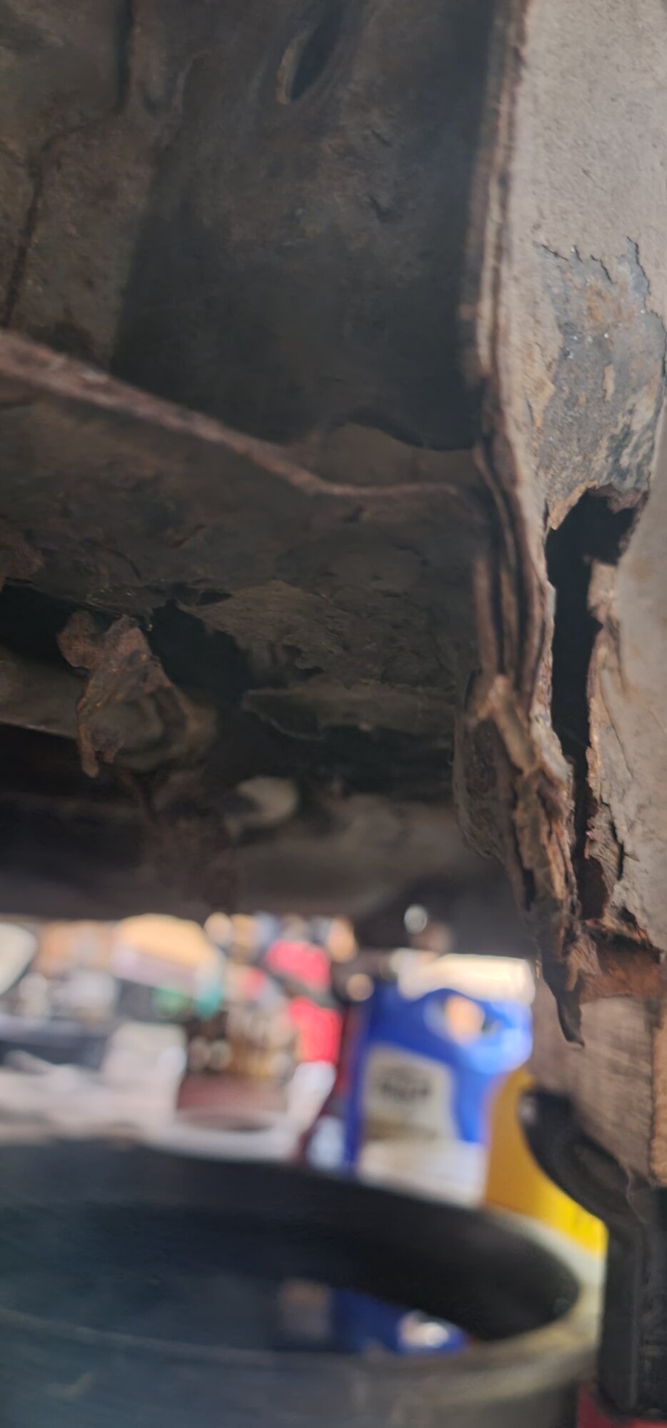

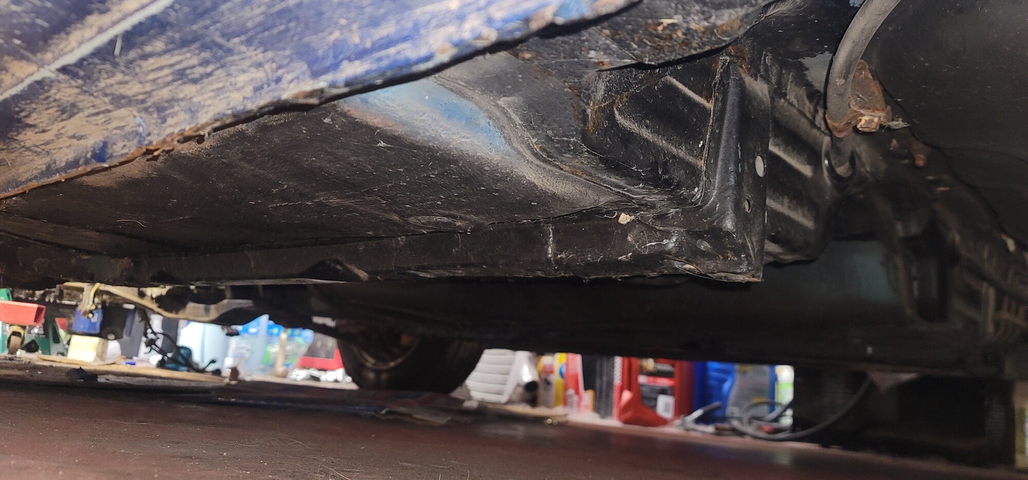

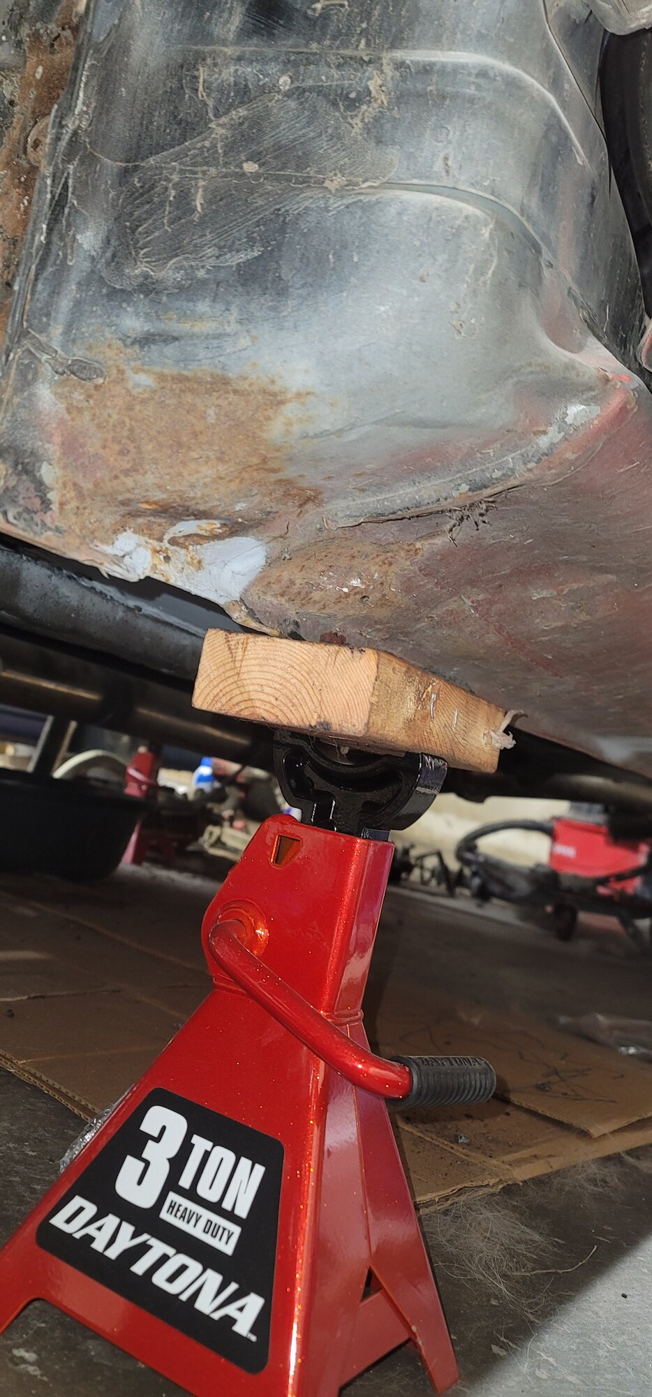

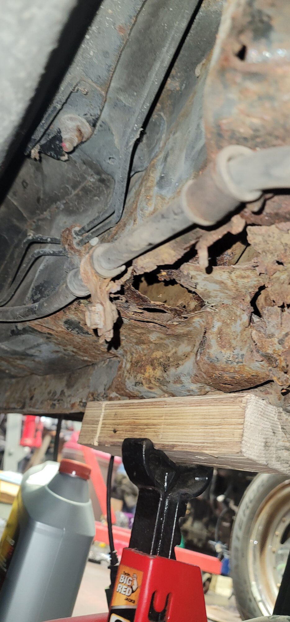

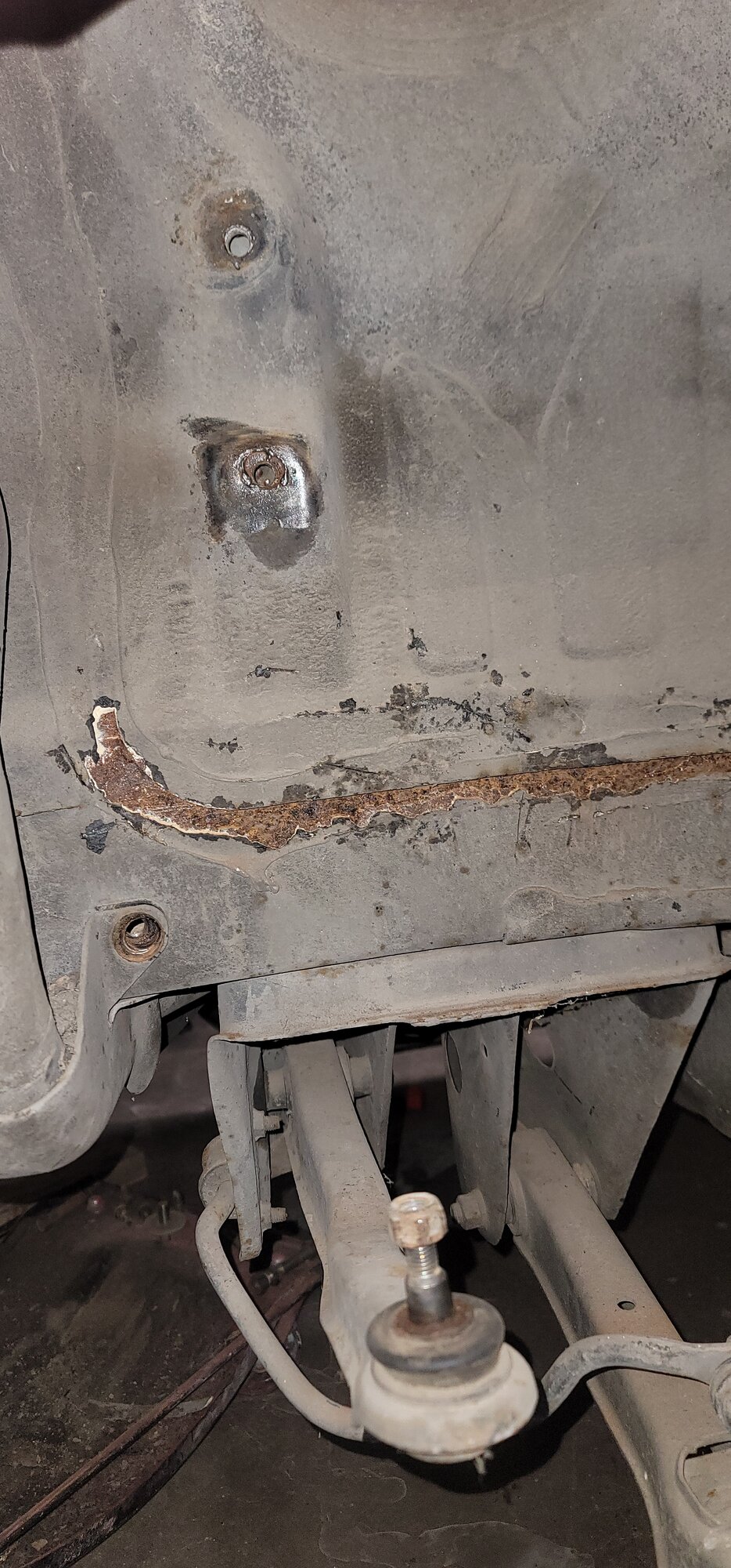

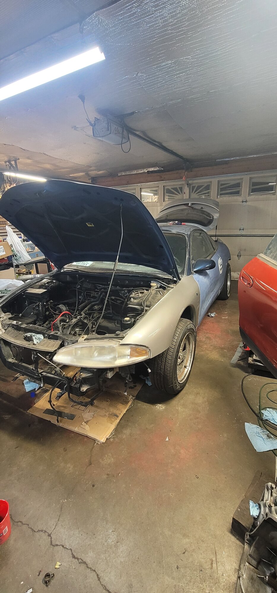

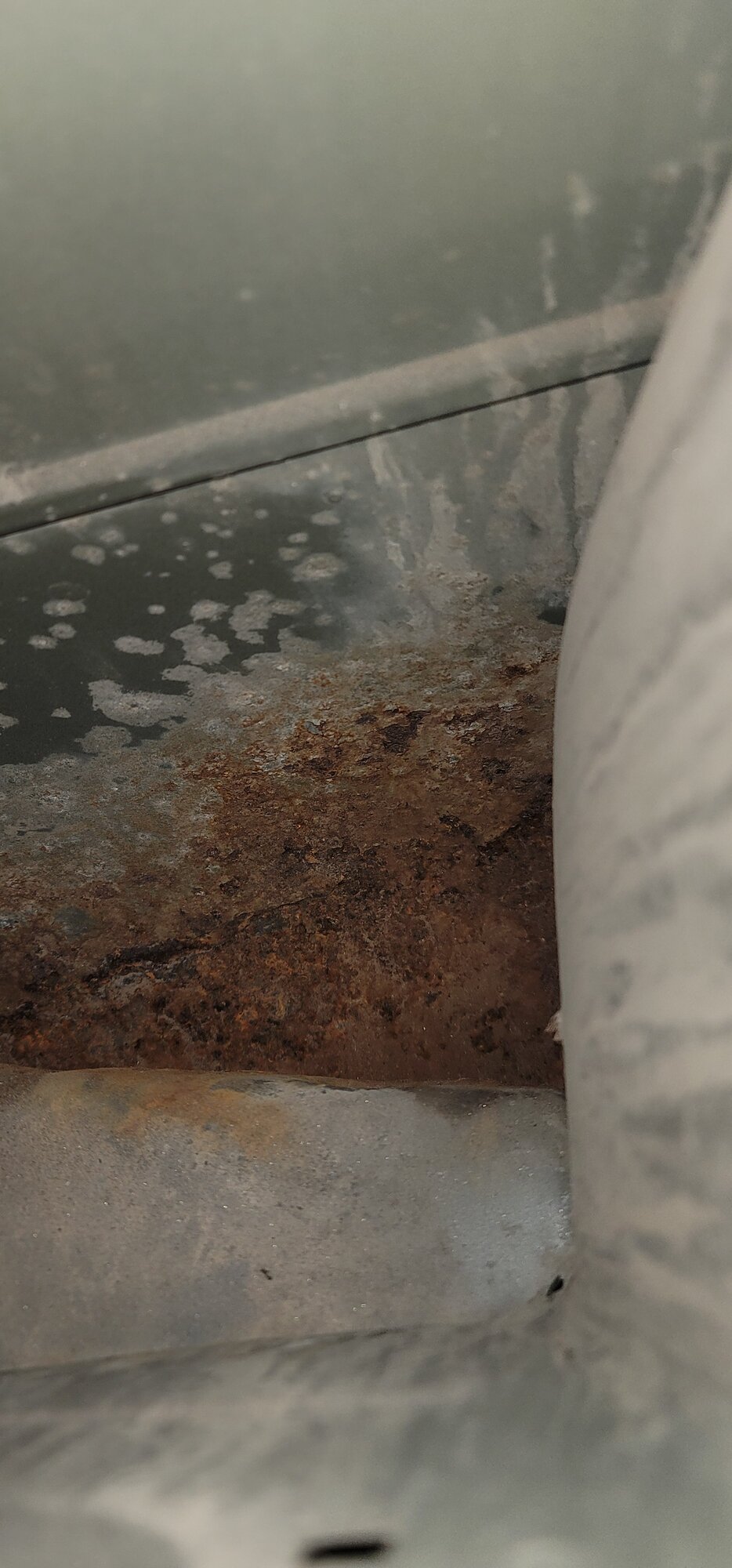

Alright so I finally went and grabbed my Talon that's been sitting for awhile now. I honestly cannot justify cutting it up for parts because of how clean it is but the gears are turning. I'm thinking since my RS is rusty and I keep finding more and more cancer I feel like I'm better off swapping front clips. It sounds stupid but that's about the only good thing the RS has to offer. I still have strut tower rust to fix and the rockers are rusty along with some very weird rust in the trunk. I was going to use the Talon as a donor but what's the point in chopping up a clean car when I can swap everything from the RS like doors and the hatch/hood over. Fixing rust and extracting broken bolts really has drained me.

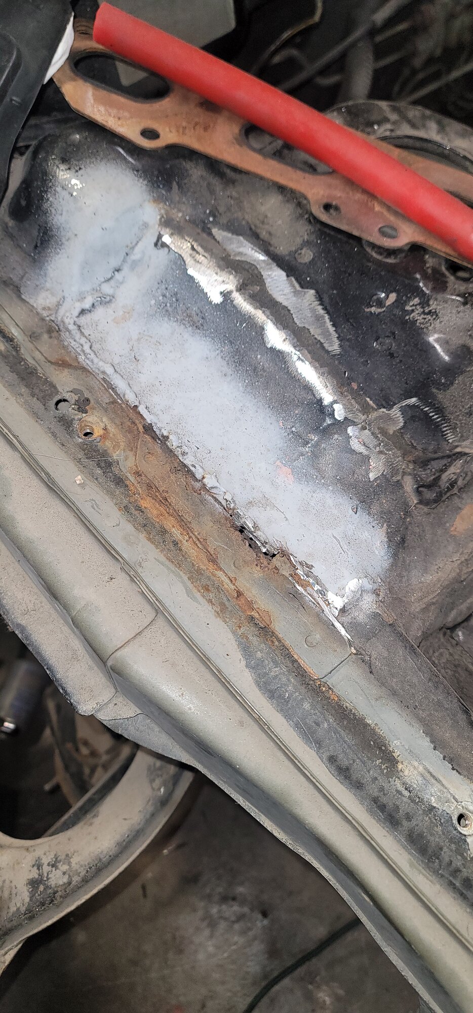

The only reason I'm coming up with this idea is because I attempted to weld the roof on the RS and everything was going great. I kept cold wet rags by and just kept taking my time but eventually things started to warp. I could use bondo and you'd never even know but I really can't stand it. It warped in 2 spots and I was almost finished, so now as I'm annoyed I'm just thinking about swapping front clips and keeping the build moving.
I know alot of people would be wondering why would I want to swap front clips. It's technically a GST now and probably better in a sense for aftermarket parts and what not. Well for one it's a Frankenstein believe it or not. The dash isn't right whether that being it's a 95 dash or a non turbo dash I can't scan the car or anything. The transmission had a weird first gear grind when it got warm. Also when I did swap the front clip it was rusty so I'm not real happy with the custom stuff I had to add to it. The biggest thing being I love the 420a it was my very first car that had that engine so nostalgia hits me hard every time. I'm not looking to make power because I'm building a show car after all.
What's really on my mind right now is I could leave my 95 RS for now and come back to it later and just continue on the Talon. I'd just start building it as it sits and not swap front clips. I'd have to of course do I stock build on it which would be fine but I already have everything to build my 420a. I'm like a squirrel at the moment and I can't really decide what to do, so I'm just typing out my thoughts as of now. No decisions have been made yet I'm just juggling between the 2 right now. I'll throw in some pictures just to show the difference between the cars.
That's exactly my thought process. I know I won't be cutting up the Talon I just dont know if I want to swap front clips or not yet. The rust isn't exactly the worse I've seen on the RS but I'm just super bummed out from it at the moment, the roof not going my way just leaves me wanting to fix the Talon right now. I just can't decide whether or not to condemn the RS for the Talon or just fix it later on.
