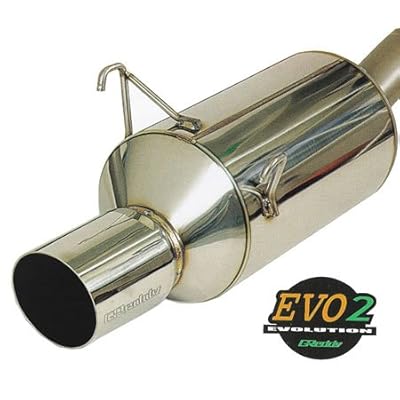

1) Hack off the muffler and source out a GReddy EVO muffler. GReddy used a huge body on them and they offered great flow while reducing the noise better than ANY muffler I've ever heard on a DSM. PIC I used to have one of the GReddy cat-backs back when my '99 was FWD, and I really miss it. If fact, if you can find one of these cat-backs, scoop it up! I know you'll love the way it sounds as well as the lack of interior drone. I couldn't find a muffler like this when I was looking to quiet down my Talon, so I opted for my option #2.
