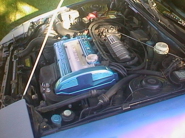

So after this long parts list, the fun part comes.
I started with this build 4 years ago, it started out by one day after being on tuners and other forums all night, looking at previews builds; I thought to myself I can do this I think I can do it on my own.
Thinking about this all night I went out in the morning and got a portable car garage.
And it started; first off, I dropped the engine, then started by taking off body parts along with interior, got the car on jack stands and got it as high as possible.
Dropped the front and rear sub frames along with the gas tank and suspension, cleaned the engine bay and under the car, took me around 2 weeks to get all the gunk /paint out.
I prepped the underbody and engine bay for paint, I rubberized the underbody, and painted engine bay pearl white, it wasn’t the best but I have never painted a car before and it was outside, engine bay got some fisheyes and the underbody was wet for a longtime, and all is perfect for my first time.
I pressed out the bushings from the sub frames and took the frames to a local shop for paint, got them when i got them back i pressed the new bushings in, also at the same time I did the prothane kit all around.
After the rubber was dry I had, 99gst _racer weld fittings on my fuel sending unit for the braded 6an lines, (amazing job by him).
Fuel tank was cleaned in and out and put back along with the fuel tank cover painted black, new fuel lines from the neck to tank, fuel sending unit and pump was dropped in.
Rear dif cover was powder coated red, was sealed and bolted up to the rear sub frame , with the metal bushings, rear sway bar ”rm in red”, all the lower control arms and the new end links. I rebuilt the steering rack, with new tie rods and sway bar installed.
Ran all the fuel lines under the car and secured them with the cushion braces from summit, the feed goes along the passenger side where the old one did and the return goes on the driver’s side, Bothe lines are along the tow underbody rails, fuel filter was installed as well.
Befor I picked up the motor and transmission from dogbox, I had all my brackets and everything that was bolted to the fire wall and engine bay powder coated, anything that wasn’t able to be coated I had it painted by the local shop.
When I had everything back from paint and coated, I installed everything, from abs unit, power steering reservoir, brake reservoir, fpr, vacuum block and cleaned up the wiring harness.
Got the motor home and I started to install
Manifolds, turbo, cooling lines for turbo, oil feed for turbo, water pipe, power steering, and alternator,
Fuel rail, injectors, knock sensor, unorthodox alternator, power steering and water pump pulley.
I had bought the gates racing alternator and power steering belts but I had a really hard time getting them on, I ended up ordering new oem ones, they went on like a glove.
I bolted the transmission and the engine together, picked it up with a cherry picker, and after 1 hour the motor was in.
And that’s how the car is now, I will be working on tomorrow I will take more images and as I work on it I will update it. All off this till now as taken 4 years from the car on jacks till the motor being dropped in.
