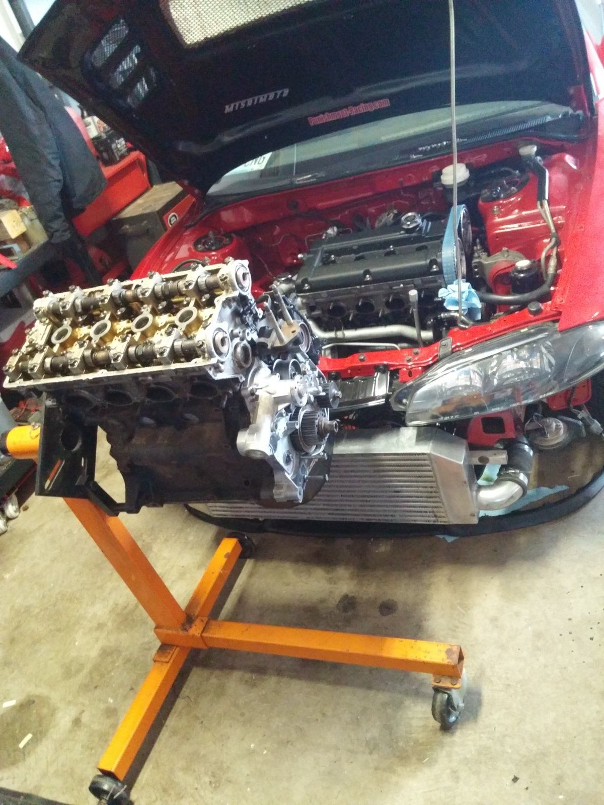

Got the new 6 bolt about ready to start the tear down. From this motor i picked up i am basically going to just be using parts off of it. Ill take pretty much everything but the block considering i already have a good block lined up.
gm maft or speed density? either way this build will be nice. gotta post a video for dyno and frag strip

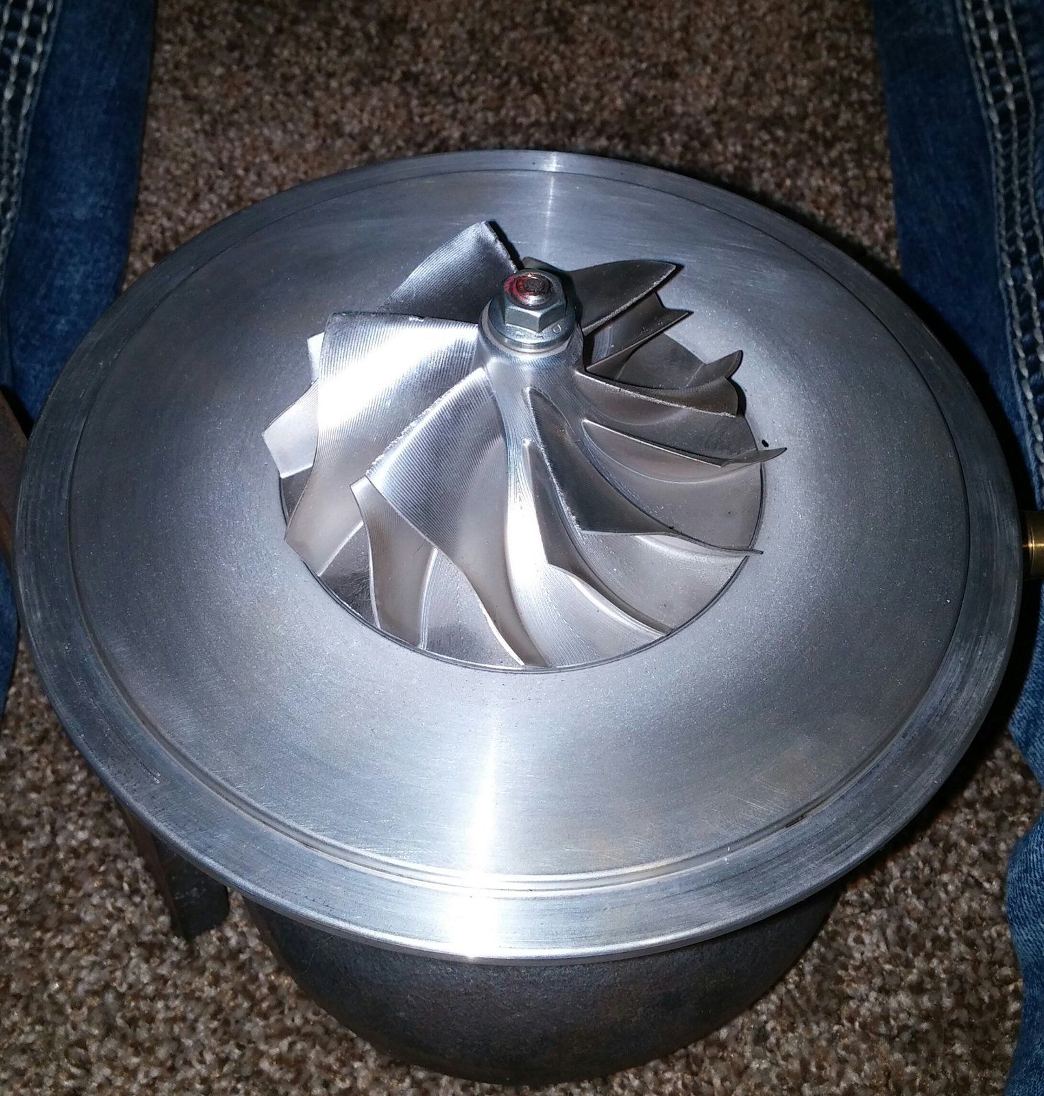

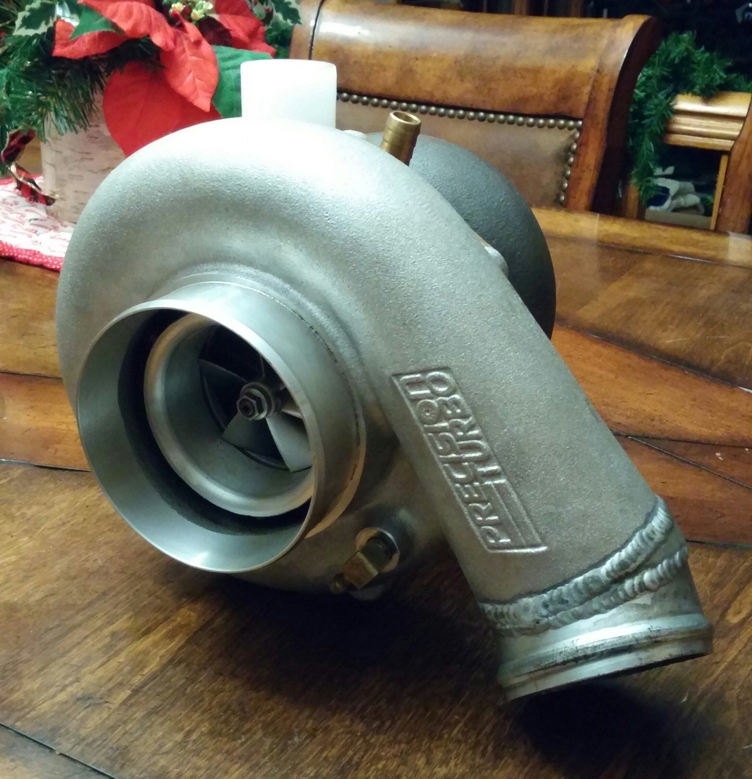

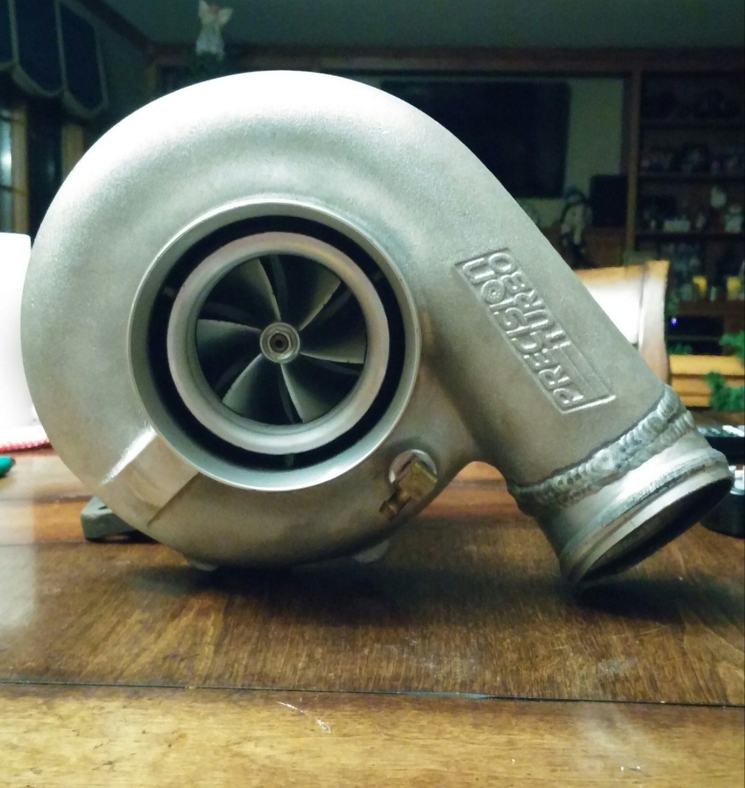

No reason really to tell you the truth. 6466 is close to the same turbo but just spools a little faster i guess you could say.
Well it has a different aero design and one more blade, i would have picked a 6766 if it had gen2 aero.
I chose the 1.15 t4 divided shpuld be fun and spool quick with endless top end
Is the turbo compressor wheel cast? If so I think it's a 6765 non cea. It will still make great power.
