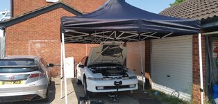

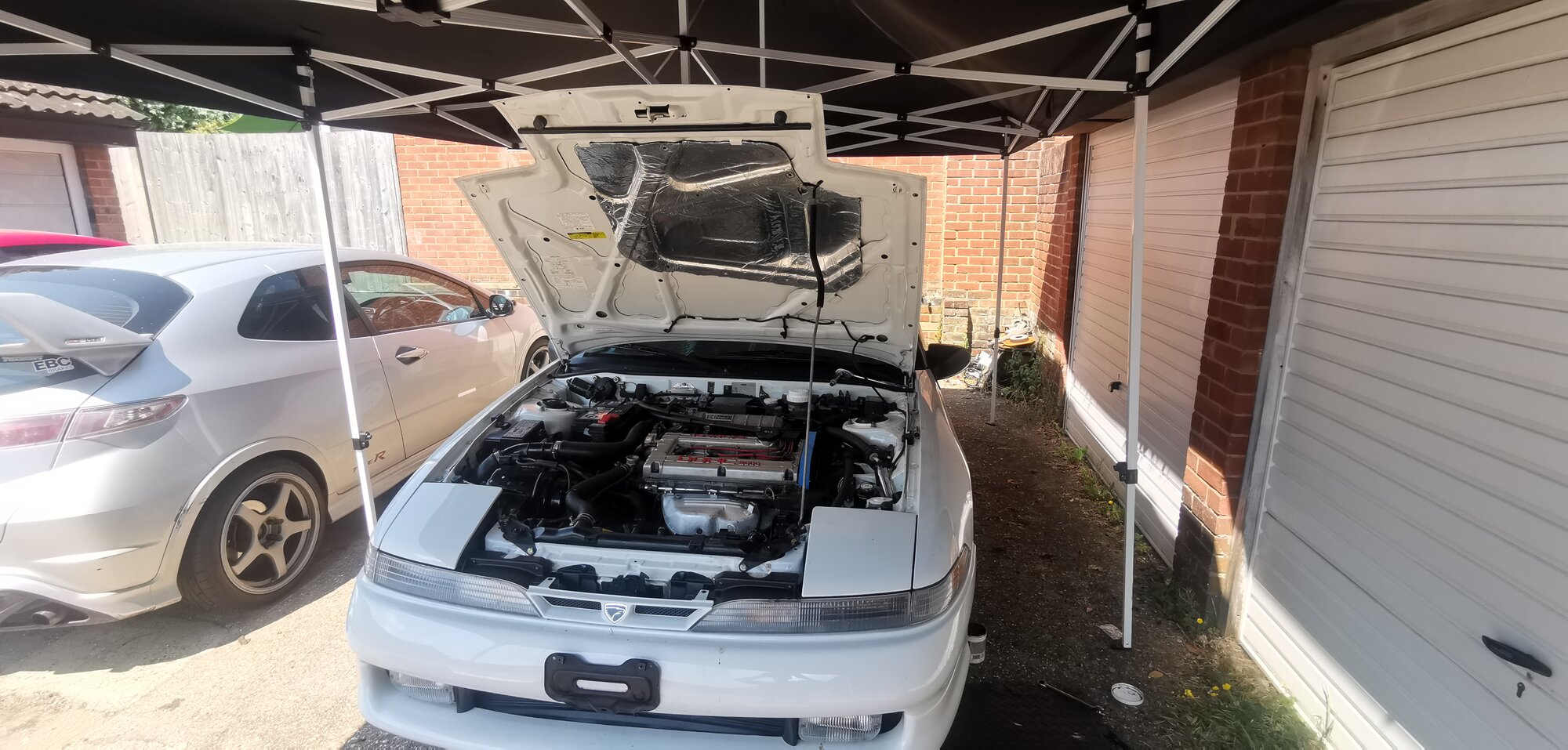

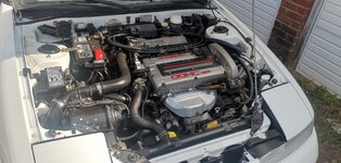

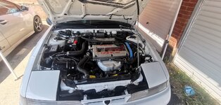

Panda Restoration (1 owner car) **customers**
This is my customers car who I go to shows with and also look after his DSM. Its been a huge job with this chassis restoration to bring it back to an amazing condition once again! but I am the only one he trusts with his DSM anymore.
