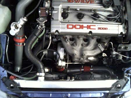

I know most people usually mount the trans cooler vertically, but the stock SMIC duct covers more area if the cooler is horizontal. I made my own mounting bracket out of 1"x1/4" aluminum bar. It's a tight fit, but it does fit.
After getting the trans cooler finally mounted, I figured I'd try an easier project. I pulled the battery tray and charcoal canister. It wasn't much easier, but at least it's out of there. I may keep all my vacuum lines hooked up where they tuck behind the intake manifold then cap them off there so it looks like I still have the emissions stuff.
I might try to stick the cruise control stuff down there in that hole on a custom bracket. Not sure yet. I want to keep the cruise control, but I hate the mess.
