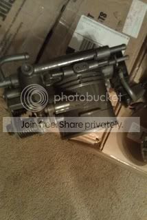

Manual shift box

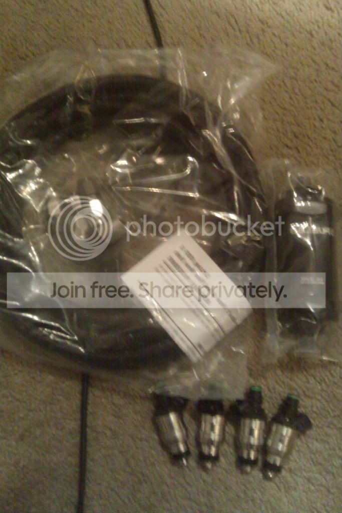

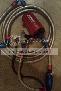

Old fuel system (Pro-classic lines, fuel lab filter, and 1200cc injectors that got sold for my new -10an setup, with 1600cc injectors)

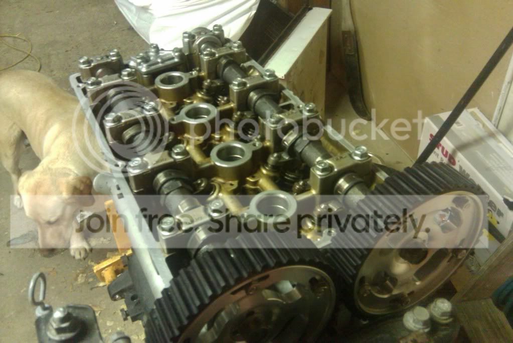

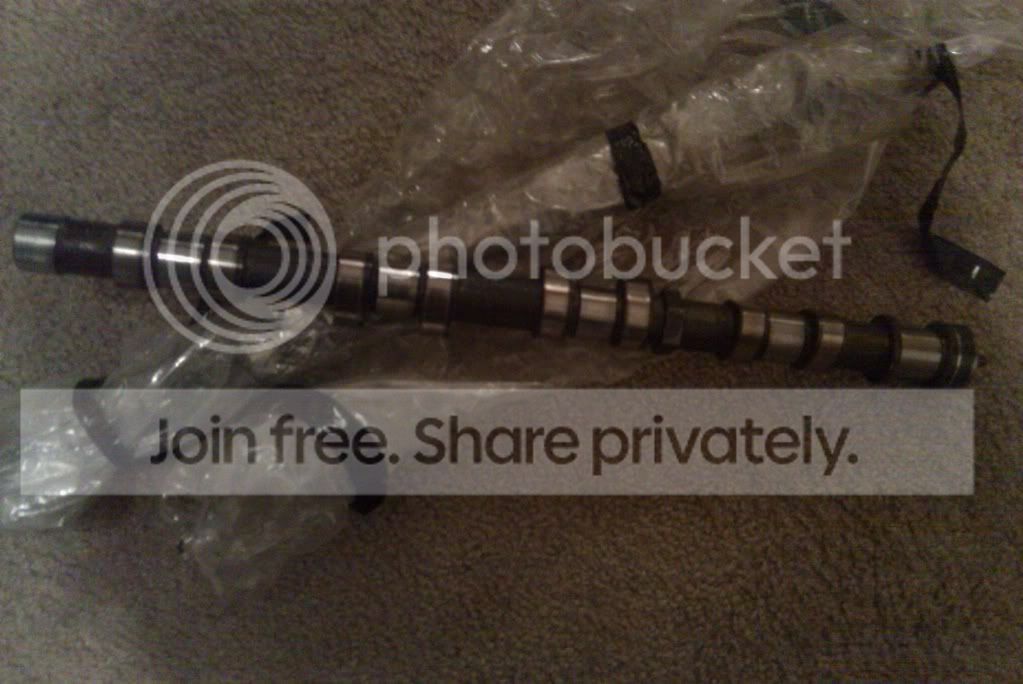

Web Camshafts

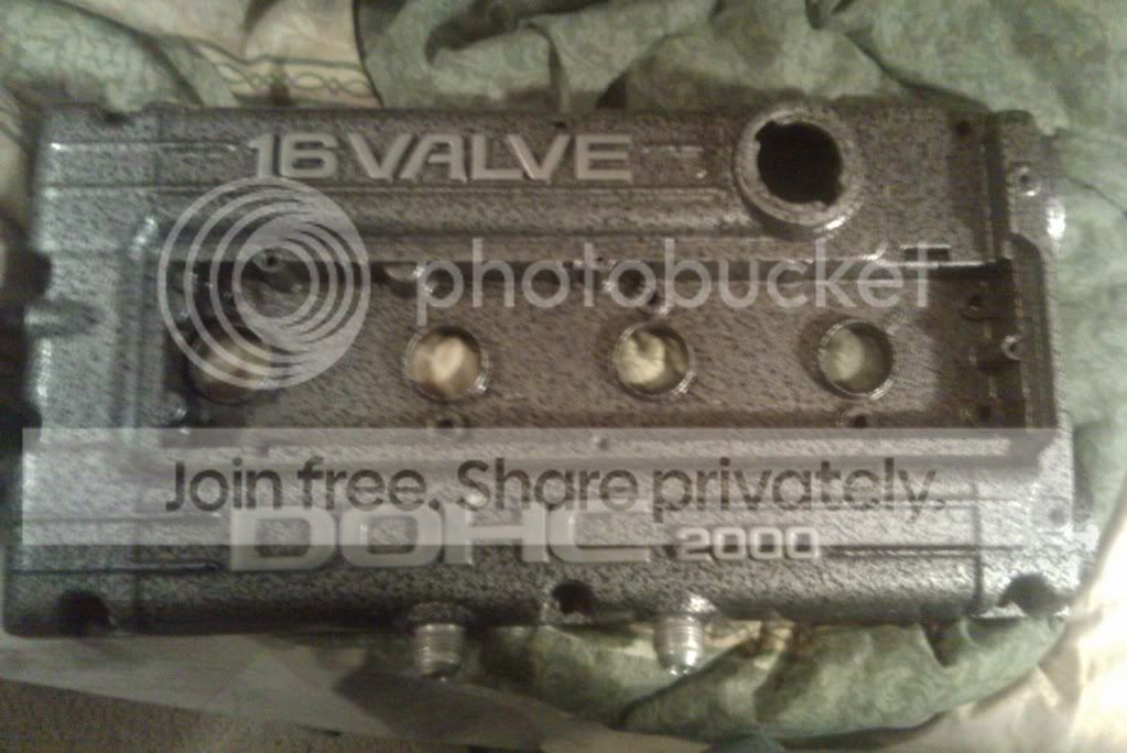

Valve cover, fittings welded for catch can

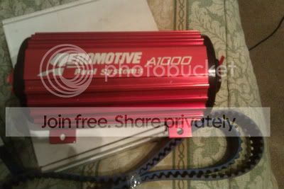

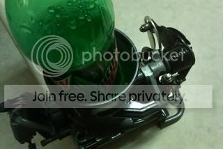

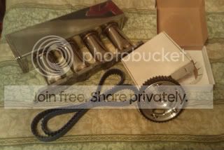

My SMIM, fidanza cam gears, and kevlar t-belt
Little A1000 fuel pump

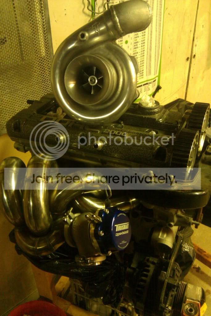

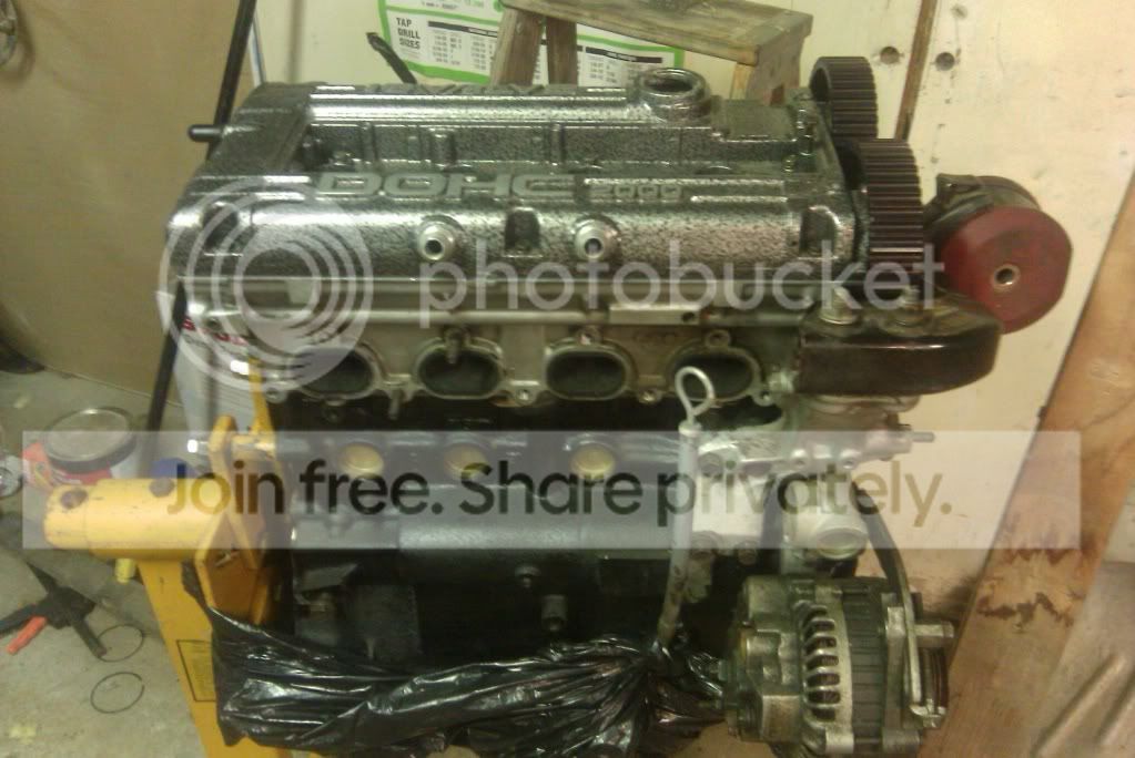

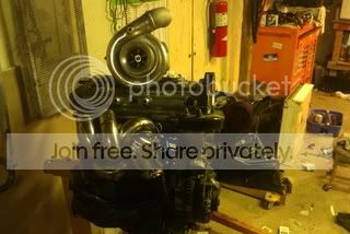

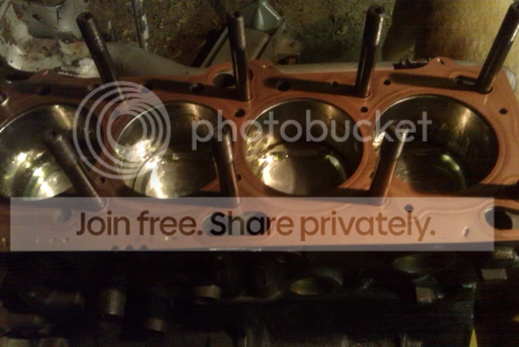

Couple pics of the engine almost finished... Gotta cut the motor mount bracket and remove the rest of the front bracket. Along with the t-belt of course.

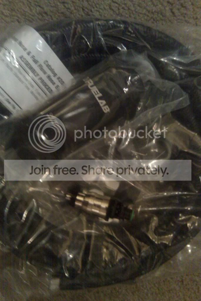

Well, new fuel system is here... Along with a couple other parts.

It seems like your exhaust would really get those catch can lines HOT. Nice though. Looks like it will be a beast.
I think the person who did it or had it done put them infront by mistake. I sure you wouldnt really have a problem but if they were on the back or pass side of the VC would be better.
There's plenty of room and the lines aren't really going to get that hot. There was a reason he placed them there, I'm sure. I'm not going to take the time to get into a theoretical explanation though.

Well, looks like I'm about to be selling the WEBs for a set of Kelford's. I haven't decided if I want to go with their 272's or 280's yet, but I'm sure I'll figure it out soon enough.

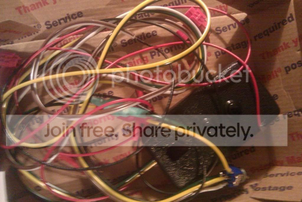

And a little update, my SparkTech COP setup came in. It's such an awesome piece, I can't wait to actually use it :)
