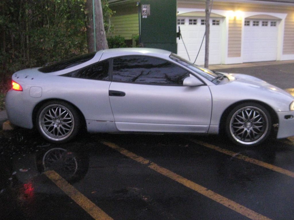

Got my first DSM on a trade in 2010-11 I had a 03 explorer and I was curious bout this turbo eclipse gst for sale, I checked it out while I had a for sale sign in the window. we went for a drive and I was hooked. I didn't want to offer to trade because he looked like a guy who did not want an explorer. well the very next day he calls me asking if I wanted to trade. I lit up. the whole time I left I was thinking how can I sell this right now to get that car. well my wishes were answered. drove it home the next day. Boy was I in for a surprise...when I got it it had the stock t-25, mishimoto radiator, narrowband gauge, some random exhaust, tokicko rear struts and springs I think, lowering springs on the front, and I believe that was it.
Heres after I test drove it.

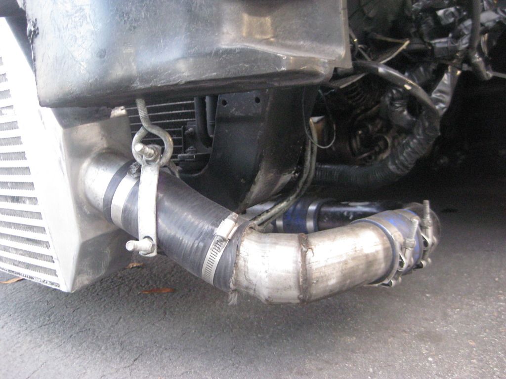

also had an evo intercooler and some intake pipe. and a greddy bov (vented)
I didn't know anything about these cars. I didn't know what I was getting into, Car was awesome for a while, didn't have A/C told it needed charging, I was like yeah whatever.
brough her home and gave her a wash.
i forgot to add, the seller also had an awd that needed to be completed came with tons of extra parts, but wasnt offered to me at the time.

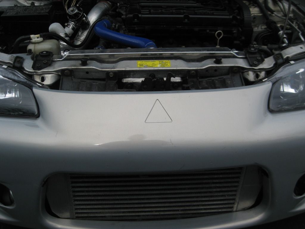

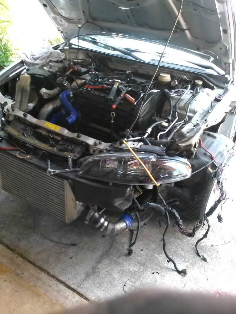

my car had tons of problems. First if you haven't already noticed the right radiator support rail , part of it is missing..yep, I didn't either. didn't seem like a huge deal to me yet. My first thing was to change the oil, coolant etc. basic maintenance..found the valve cover to be leaking so I replaced the gasket

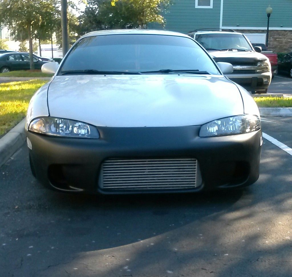

cleaned it up and kept it as a daily for work

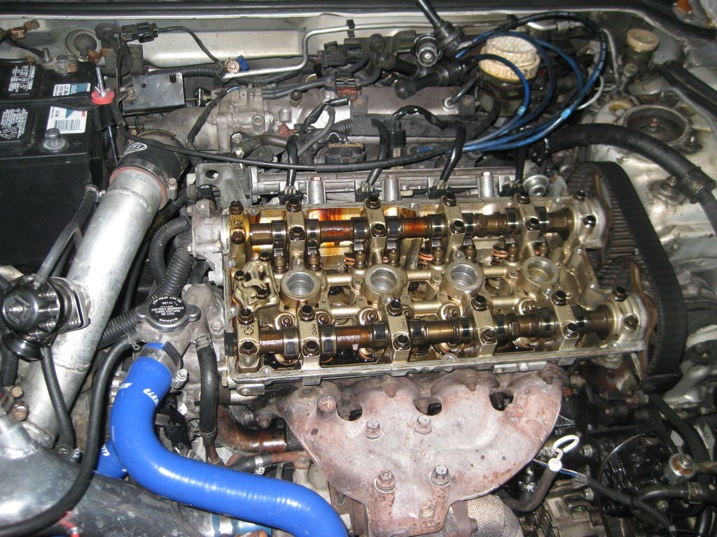

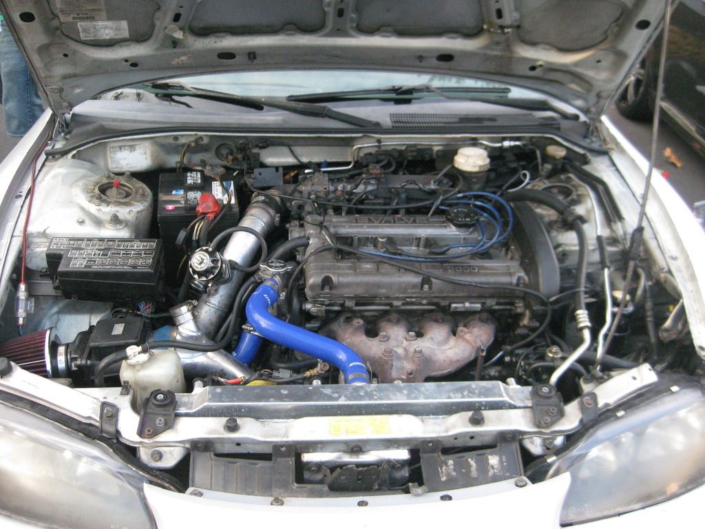

first few things I did was turn to here, dsmtuners and google. buddy told me to recirculate my bov and after research I did. ran tons better. found a guy local in Jax selling parts gor a 2g, my valve cover ended up having a crack (weird right?) and i met up with him. went to his house..

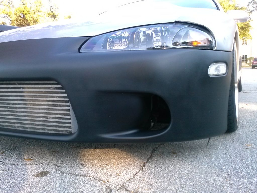

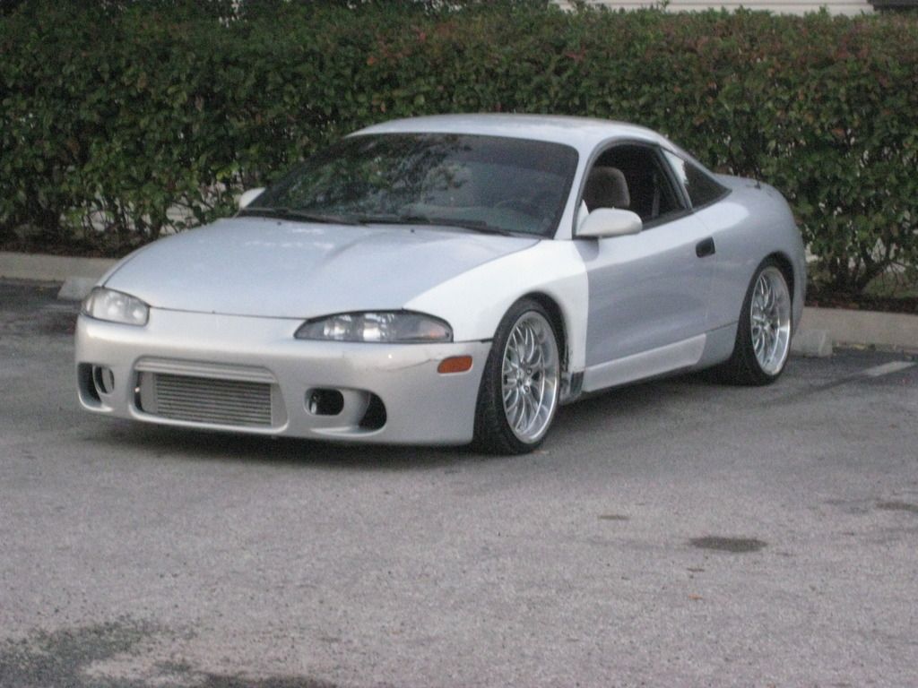

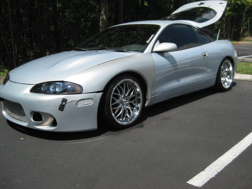

damn thing looks pretty good.

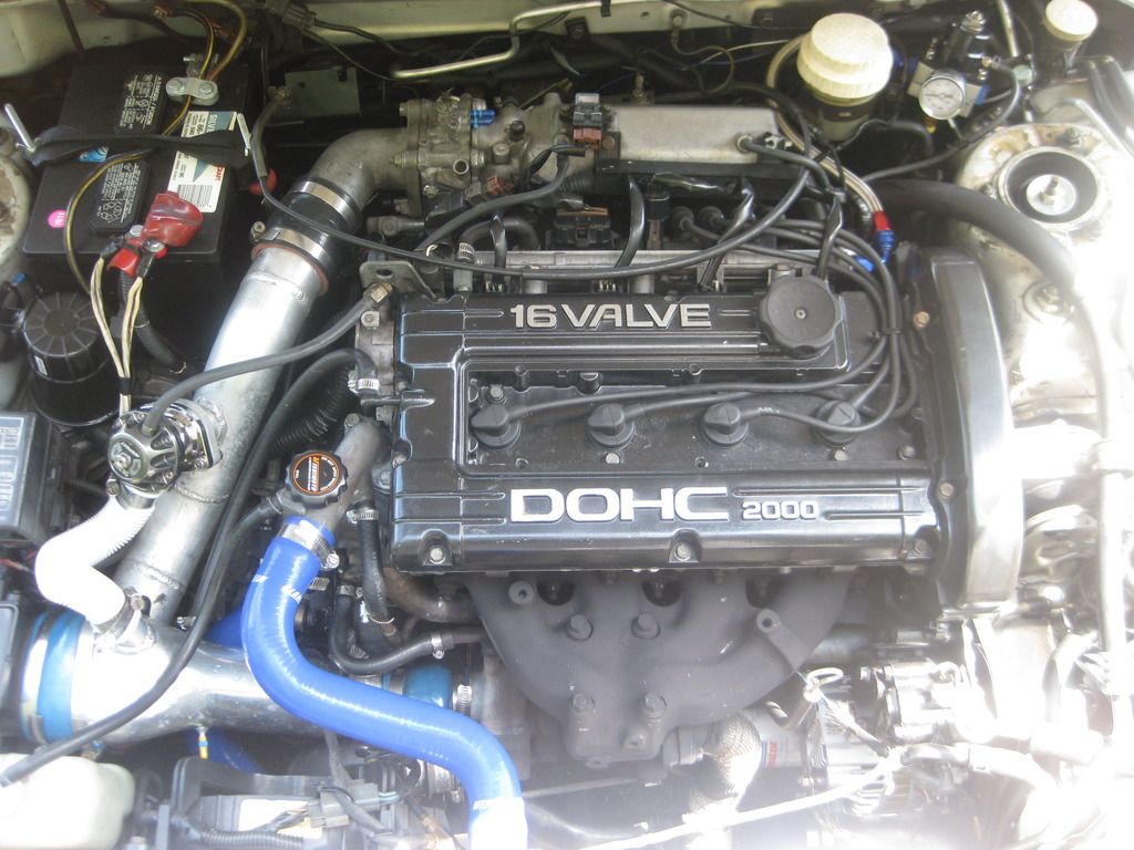

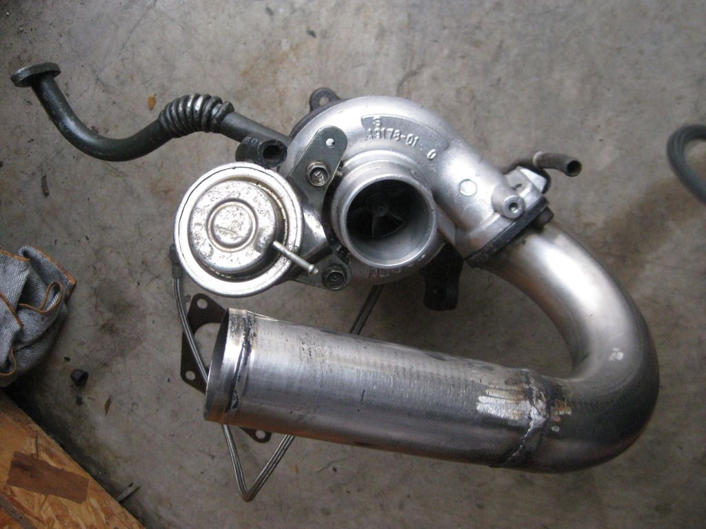

picked up a evo16g from a guy parting his car out.

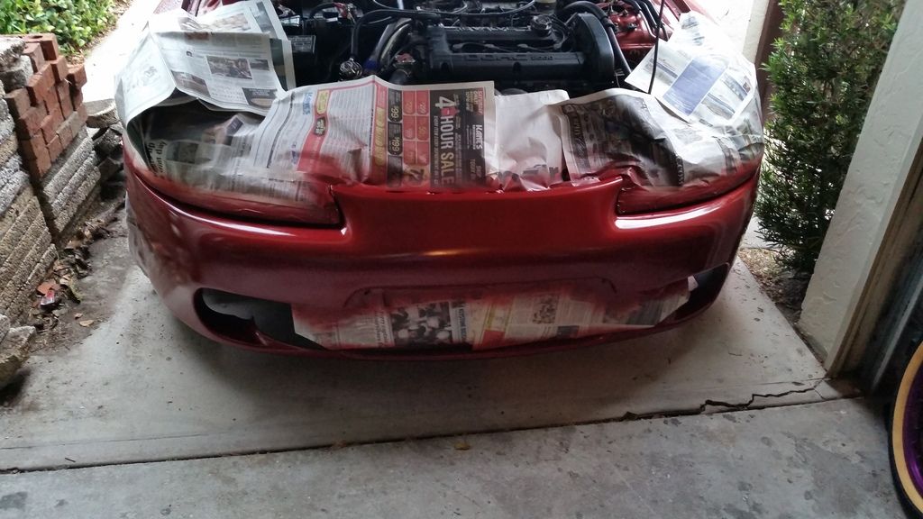

shaved the stash off

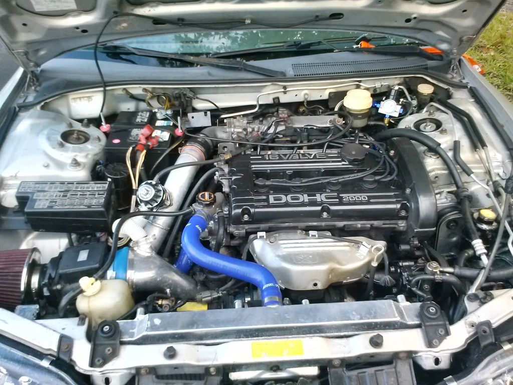

installed and rewired a walbro 255 and installed afpr IMG_2627_zpsqqefosfx.jpg

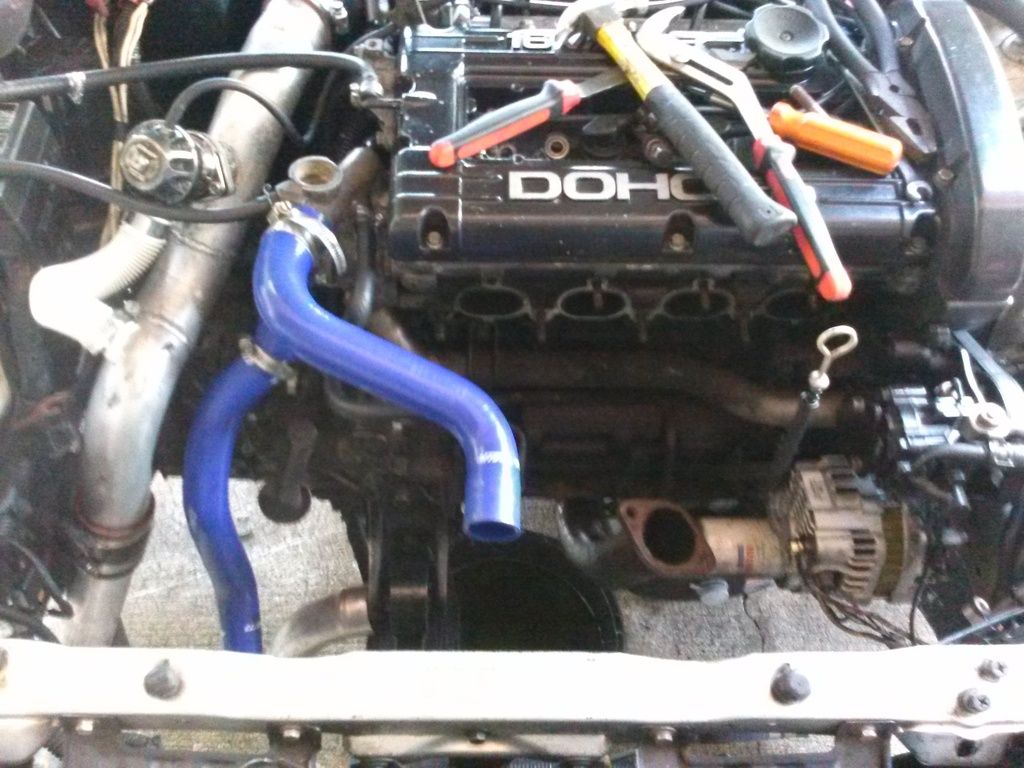

took a 2 hour trip and had to have the heater on so the temps stayed down.. not smart but it worked..on my way back the alternator gave out and I stayed at a hotel..plus it was running very hot.. so I decided to get the 16g on, hell why not

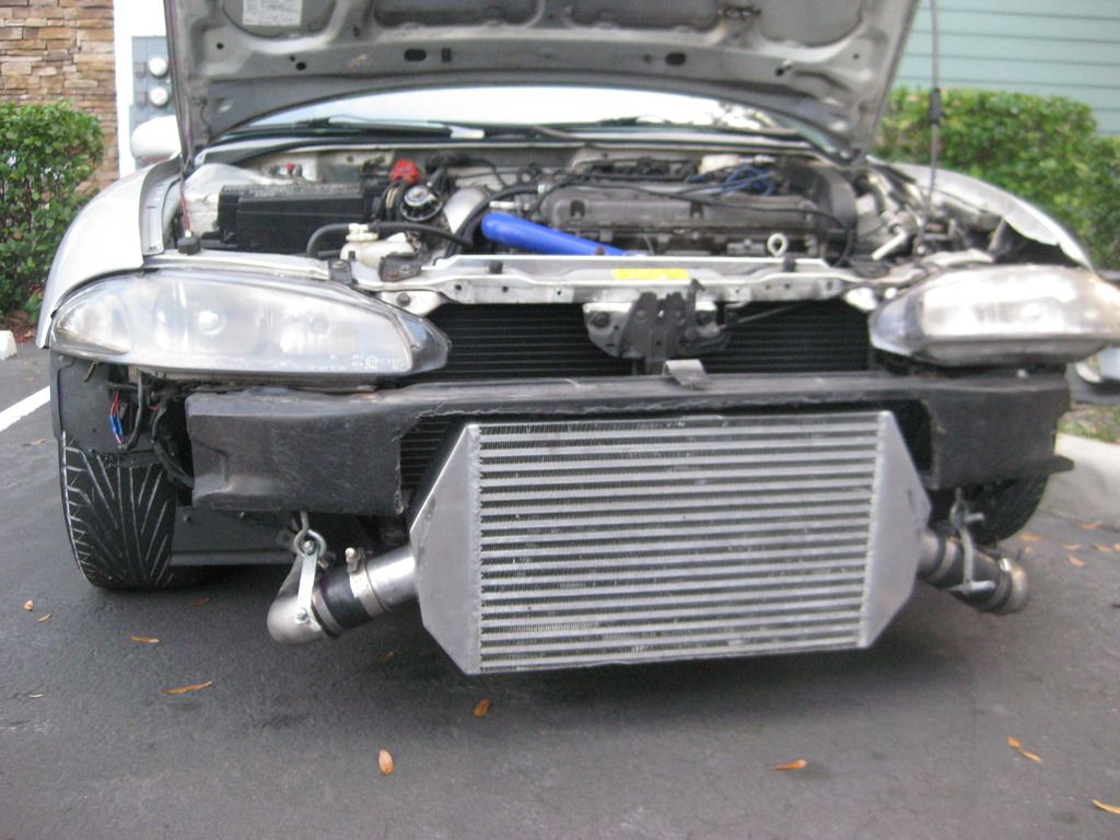

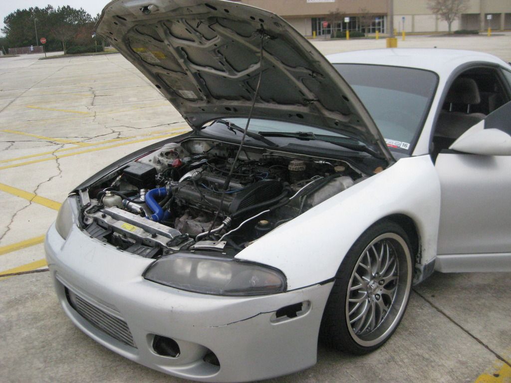

I met the original owner at a meet and he said he fell asleep and crashed his car, which is why the damage on the radiator support.
It appeared to have some sort of drain issue resulting in the replacement of 3 alternators. Couldn't find the source... still, didn't have ac but when I turned the switch on the car would die. And the alt. Would be dead.. still it ran slightly hot. But now where near as bad. Could have been a leat tune pinhole somewhere l. We did multiple BLT, went over the car numerous times but ended up doing what we could and let it be. I was very careful with it until the day I sold it.it still ran good but had its demons.

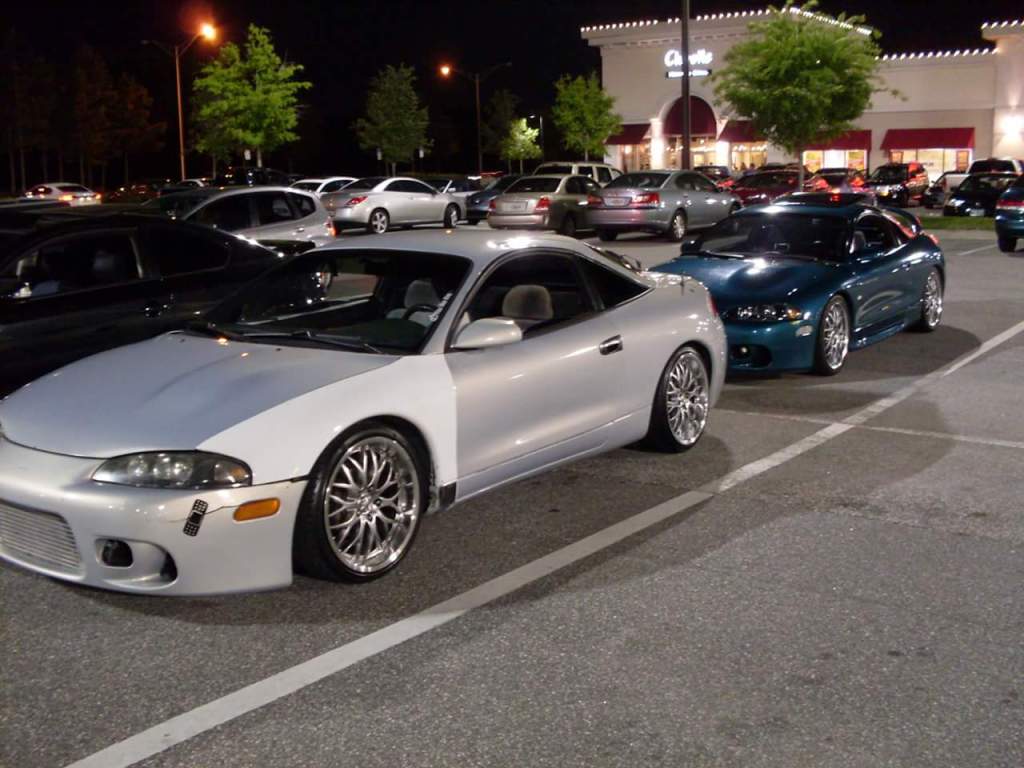

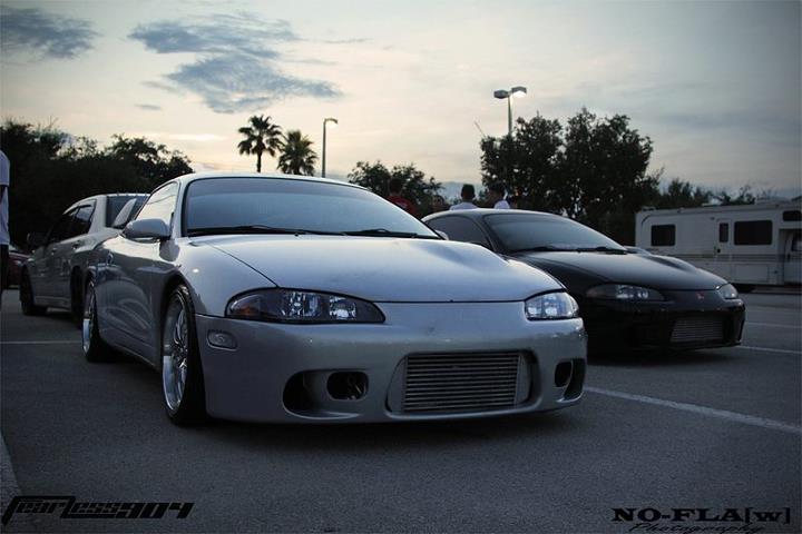

went to a bunch of meets, and the car ran pretty good, 90amp alt, 16g and it ran way better..

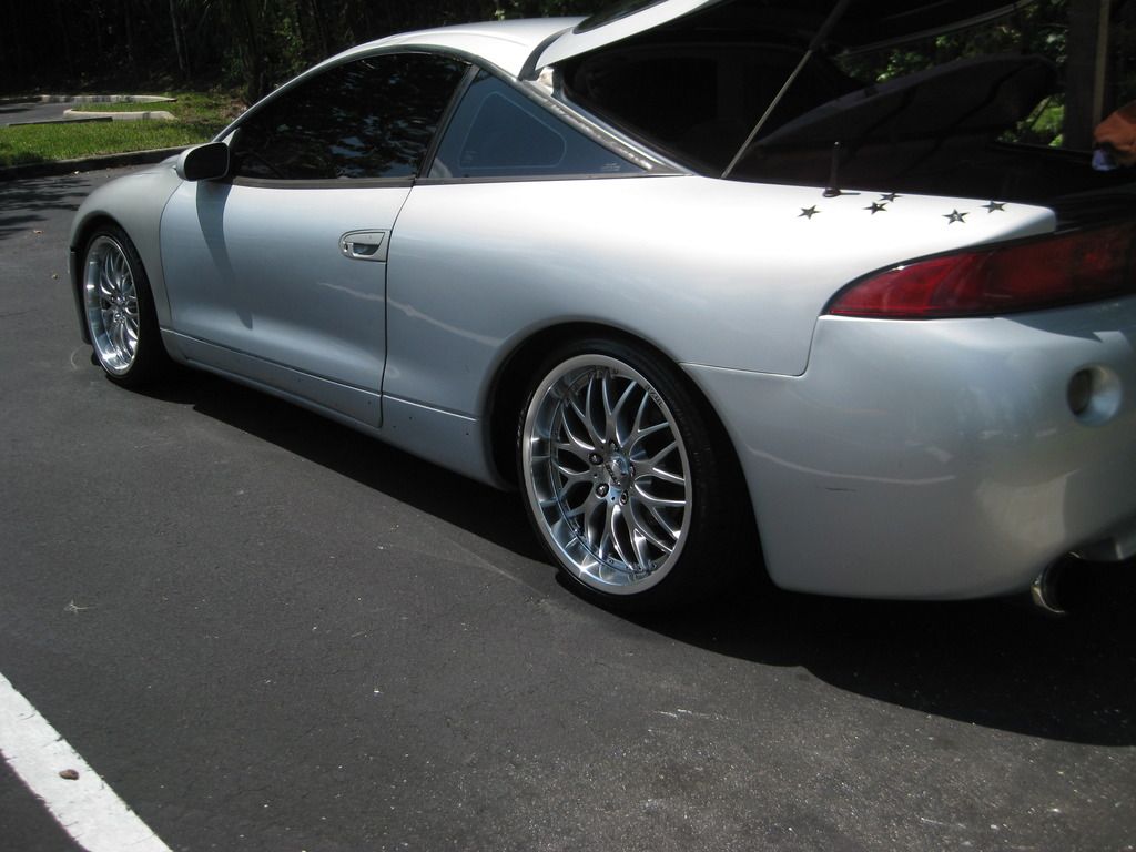

I also picked up a 3" Tanabe exhaust for the car

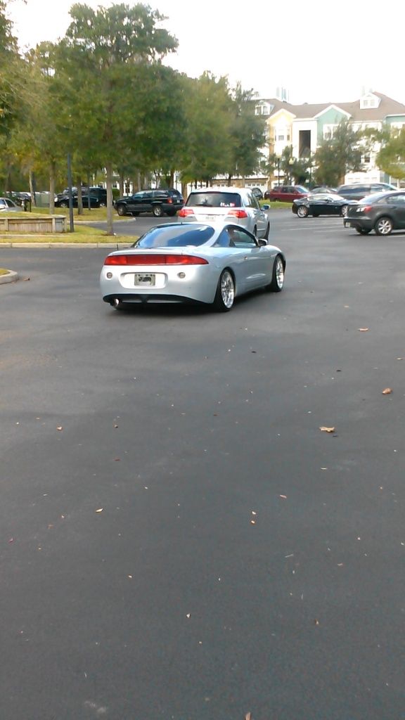

well came the time to let it go, it was actually running the best ive had but needed to part ways. been through tons with this
so I said bye Felicia

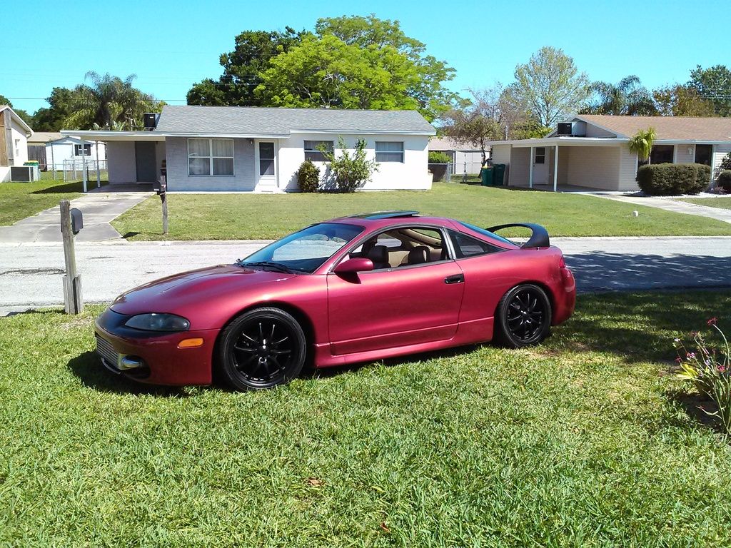

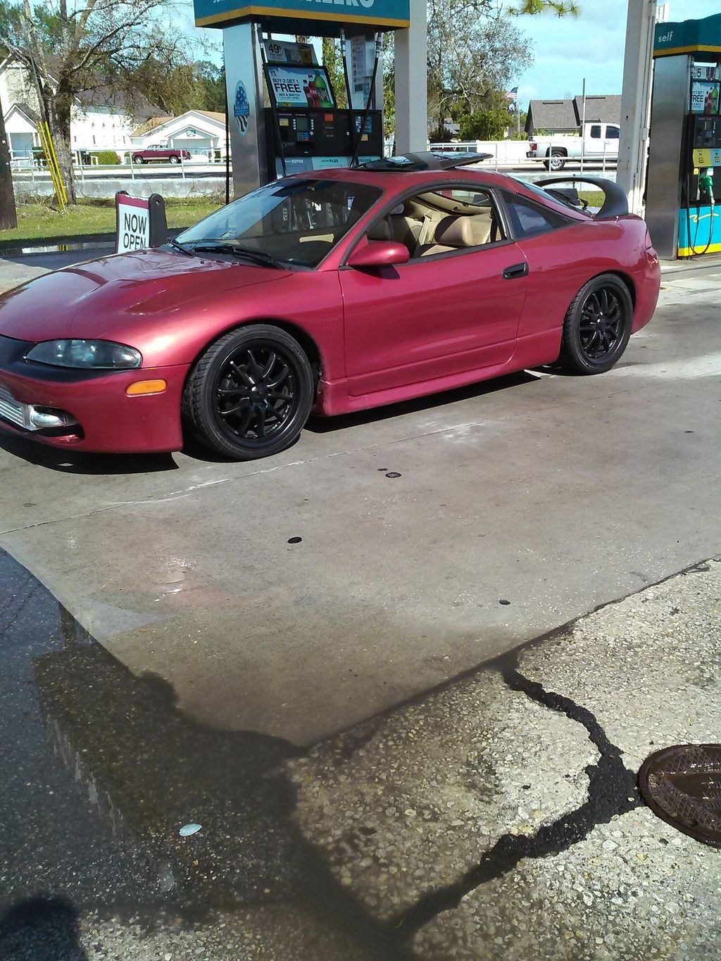

few years later, joined the military and I came back, with a smarter mind..which brings me to my current car 97 gst.
car sat in a garage, had a 16g, tubular manifold, random 2.5 in exhaust, vrsf front mount, greddy bov. lowering springs (unknown brand ) tan leather in good shape. 18in wheels good tires.. said ac needed to be charged. well bought it and the test was put to it.. driving 2 hours home... considering my last long trip in a dsm i was very very nervous. but it did amazing... without a/c

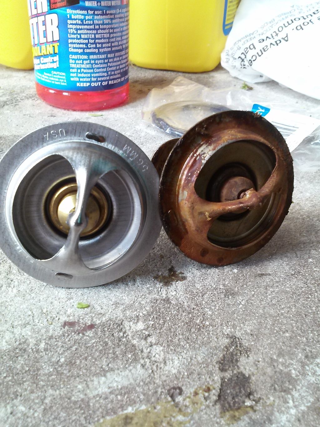

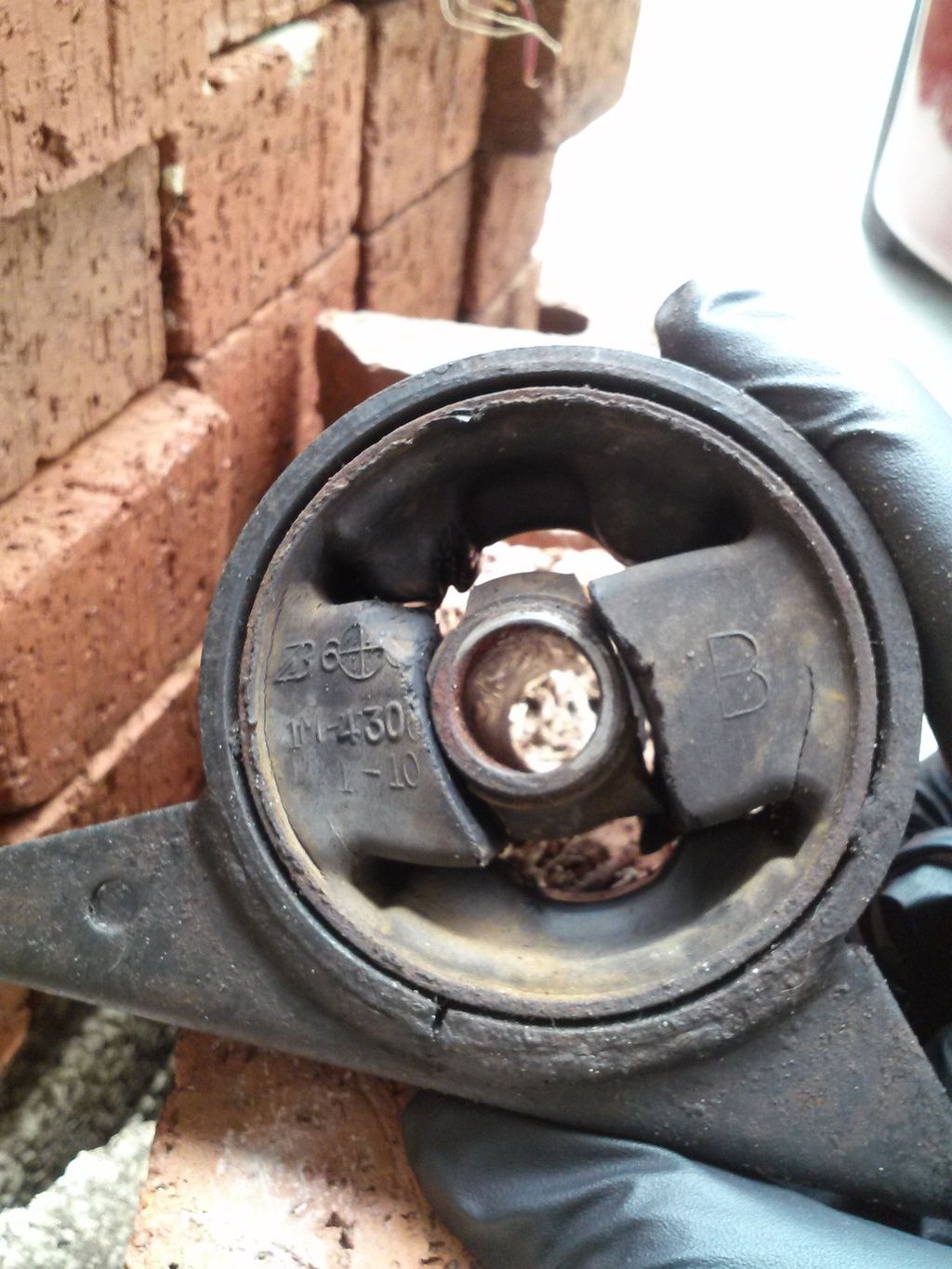

when I got home I did the some maintenance immedietaly, I replace front motor mount, the thermostat, an ran royal purple oil in it. The first modification I did was ran a walbro 255 fuel pump, rewired. and a AFPR

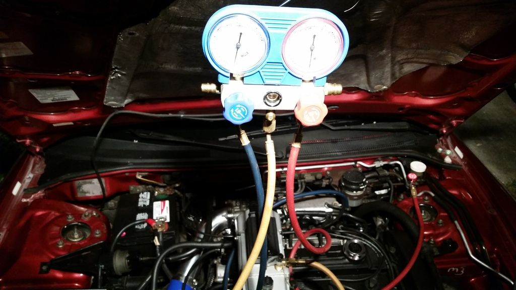

decided to dive into the A/C .. got a belt and found it to be too big....couldn't really find a smaller one, because I also found out I did not have there tensioner pulley..contacted a guy in Orlando with parts and bam he had one. , grabbed a few other things from him too... i'd eventually go back to him but that's later on.20140520_153717_zps38tv4k8k.jpg

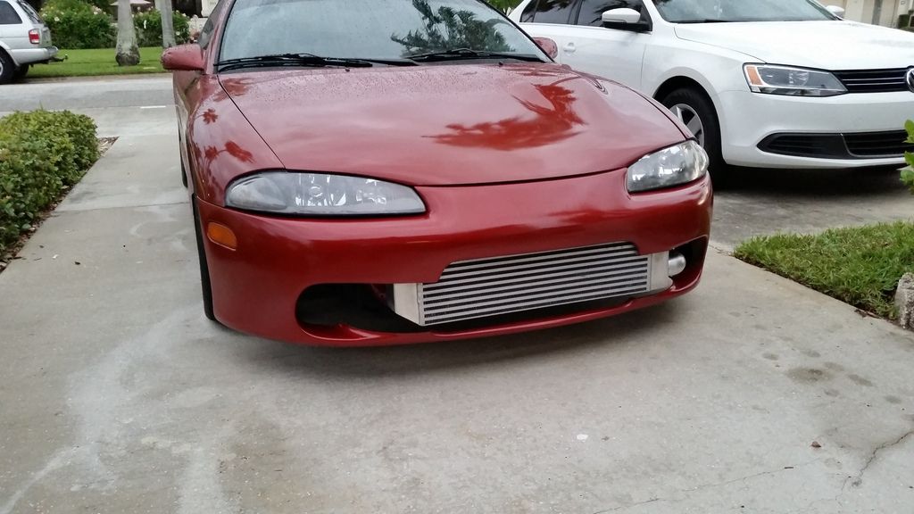

picked up some FIC 660CC injectors. and installed a VC I got from Orlando.

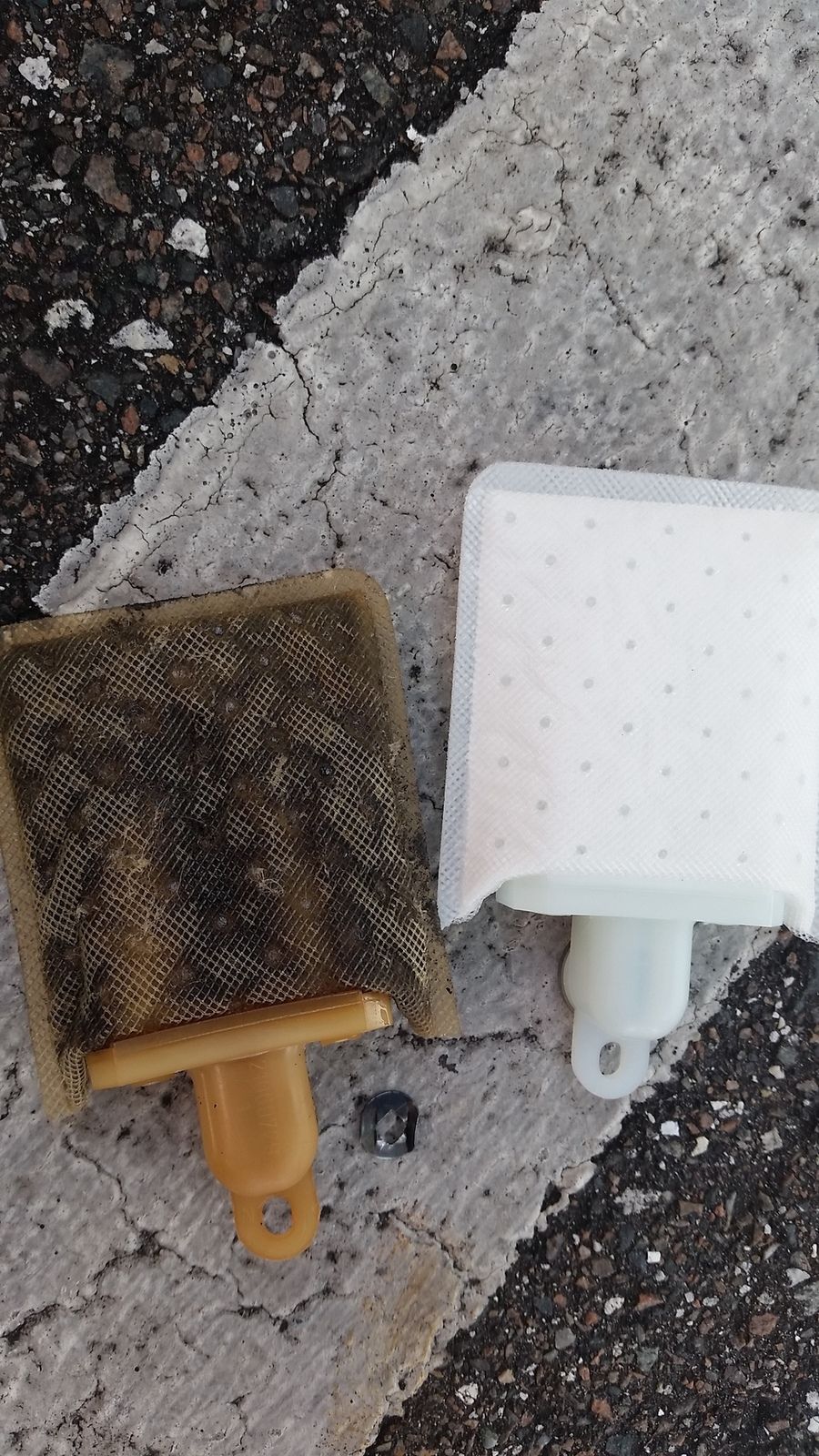

now, the suck and had me going crazy.. the walbro was a little bit louder then normal the last few days and then one day the car was suddenly sputtering, the fuel pump was screaming louder then walbros usually do ..i had loss of power like it was choking.. researched symptoms and checked the plugs, still good, NGK bprs and ngk wires all in good shape.. I saw coil packs could do it... so 200$ later still same issue, noticed FP not right so looked into that and saw a bad fuel filter could be it.. bingo.. kind of. replaced it and the walbro calmed down and it was good to go, bad gas I thought well then shit it happened again I did everything I could find and think of except pull the fuel pump... damn the strainer didn't look good. Overnighted one and replaced it. were back baby! well for a little while20140902_1450520_zpssijrngji.jpg

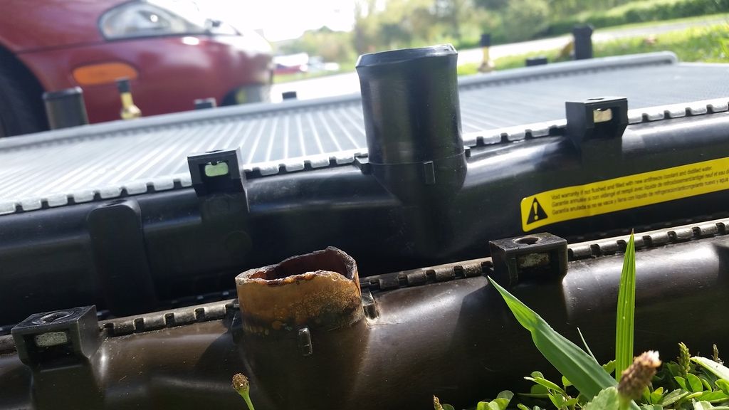

Happened a few more times and I kept pulling the strainer out and cleaning it the best I could while on the road..I mean I literally had to pull off the highway and clean it the best I could, multiple times I did.. even with new strainers it happened, then while all of this going on, I smelled coolant, saw a small puddle and though...im burning this car. well I replaced the upper hose drove off and smelled it still and pulled the hose off and found that I broke part of the kneck off..got the hose back on gently and went to a hotel.. called advance and the had one in stock WHEW!!! well couldn't have happened at a better time, the hose shot off.... sweet...oh yeah im also 2 hours across the state right now..1410205486837_zps8qlcm1lr.jpg
Well after I got the radiator replaced I knew I still have the mystery fuel issues. Still, constantly cleaning the strainer.. well then somehow I never thought of it.. why don't I replace the tank. Because after a few fill ups I realized it wasn't bad gas anymore.. I was at auto zone again and the car didn't want to start. Still 2 hours away and now it started to rain.. holy crap if I never experienced bad luck I would have thought the devil himself previously owned this car and was still lingering. Messed with it over a at least 2 hours.. not knowing what to do. In and out that pump came, I noticed that the pump wasn't even turning on. I thought I was dead. Tried pushing the car to maybe give it that jump. Nothing.. well after I cussed evert word I knew and decided to sell it, it started. I straight drove home. With a close ear on the pump for any sound change.
