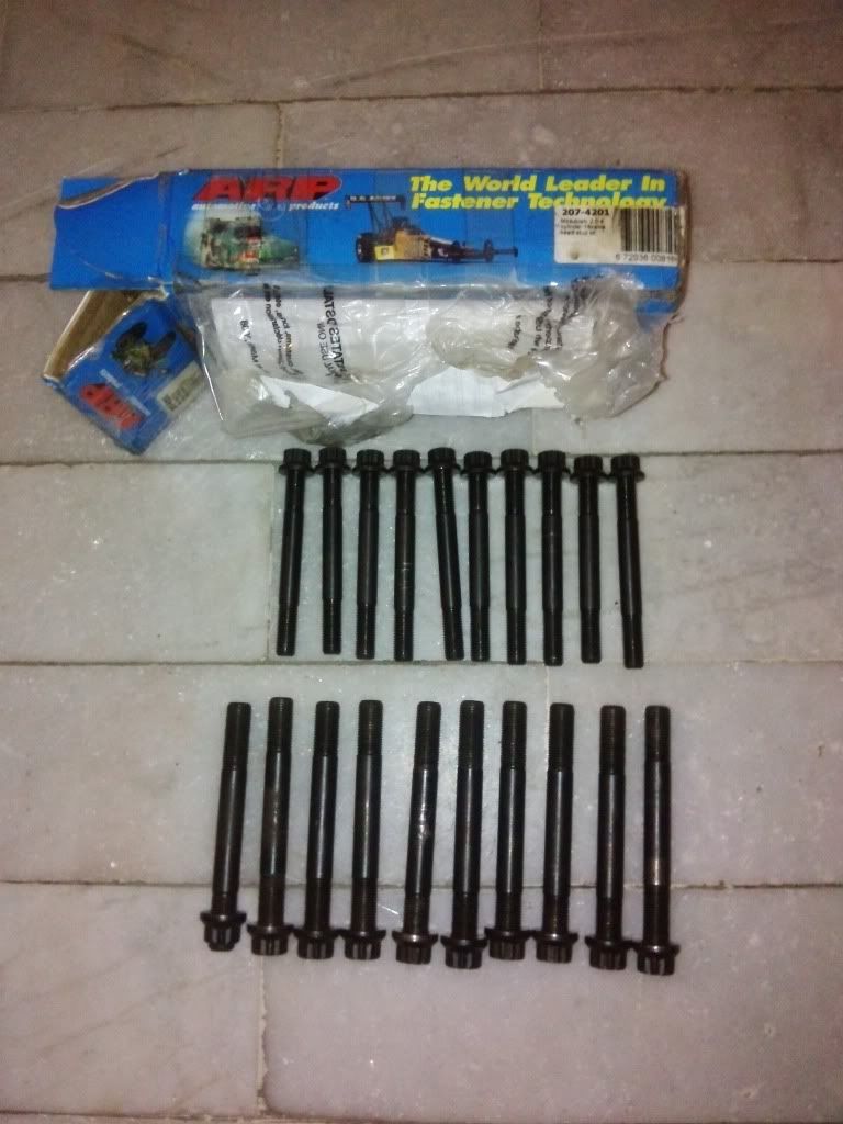

I am using ARP (headstuds, main studs, main, rod, flywheel bolts and crankshaft bolt) I have no moly lube, What else I can use?

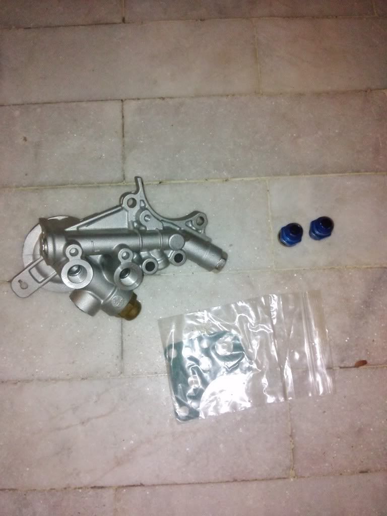

7 bolts OEM oil pump

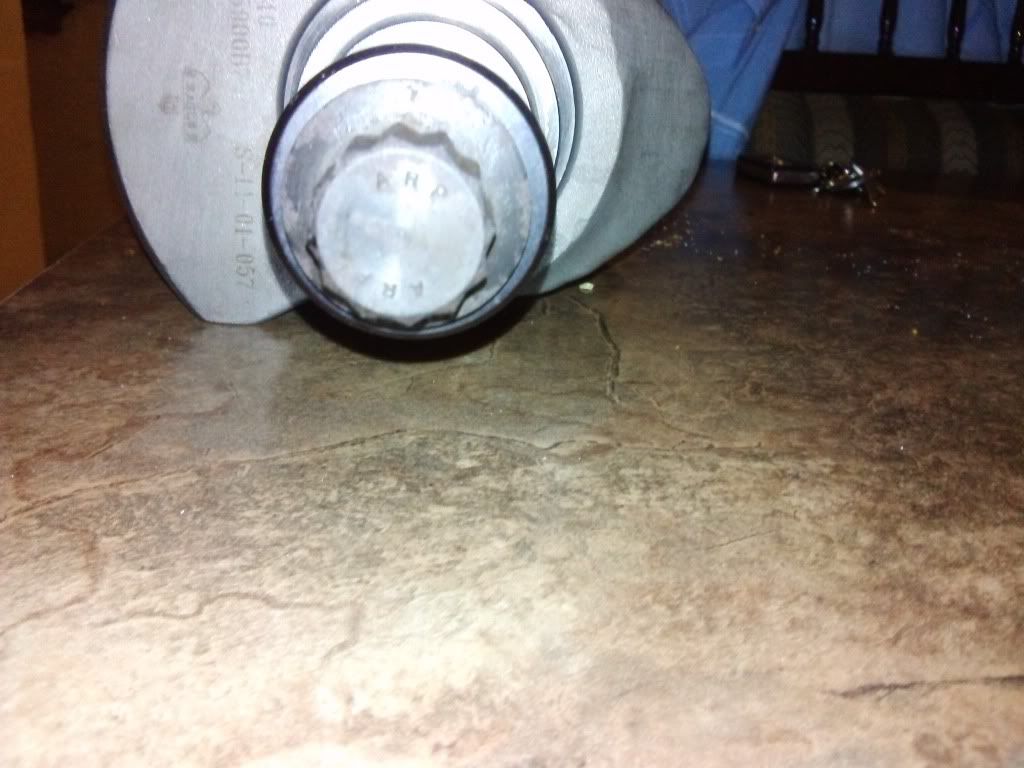

ARP crankshaft bolt

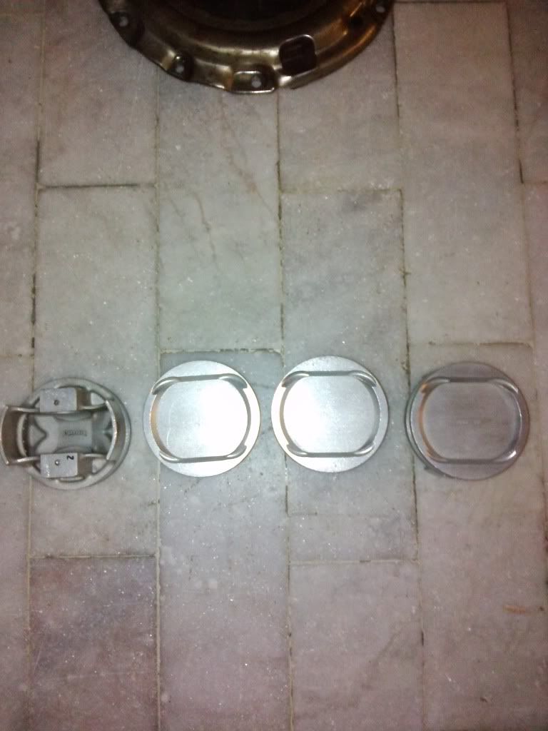

forged probe industries pistons

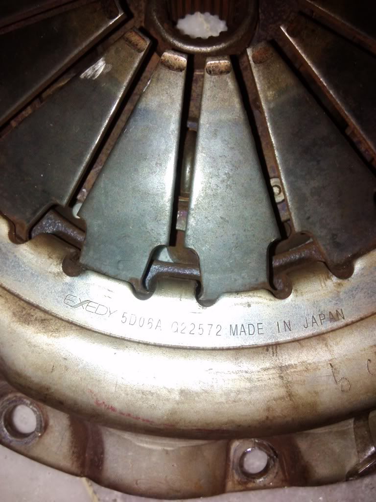

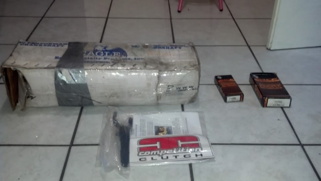

exeddy clutch

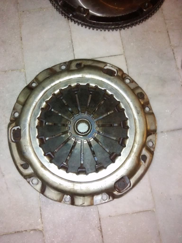

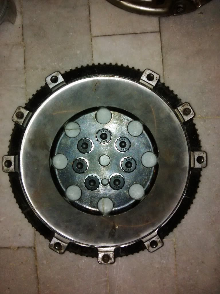

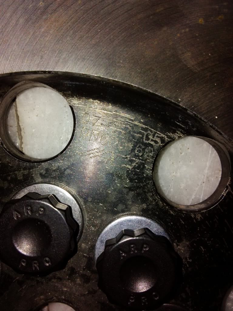

ACT streetlite flywheel with ARP

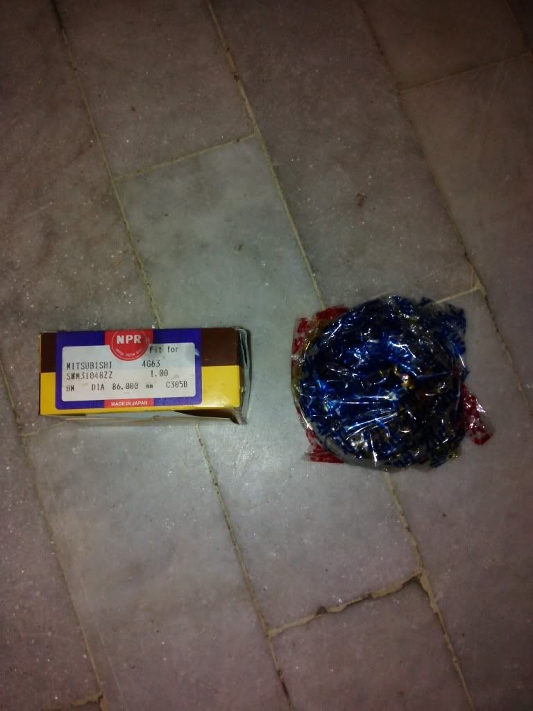

NPR piston rings

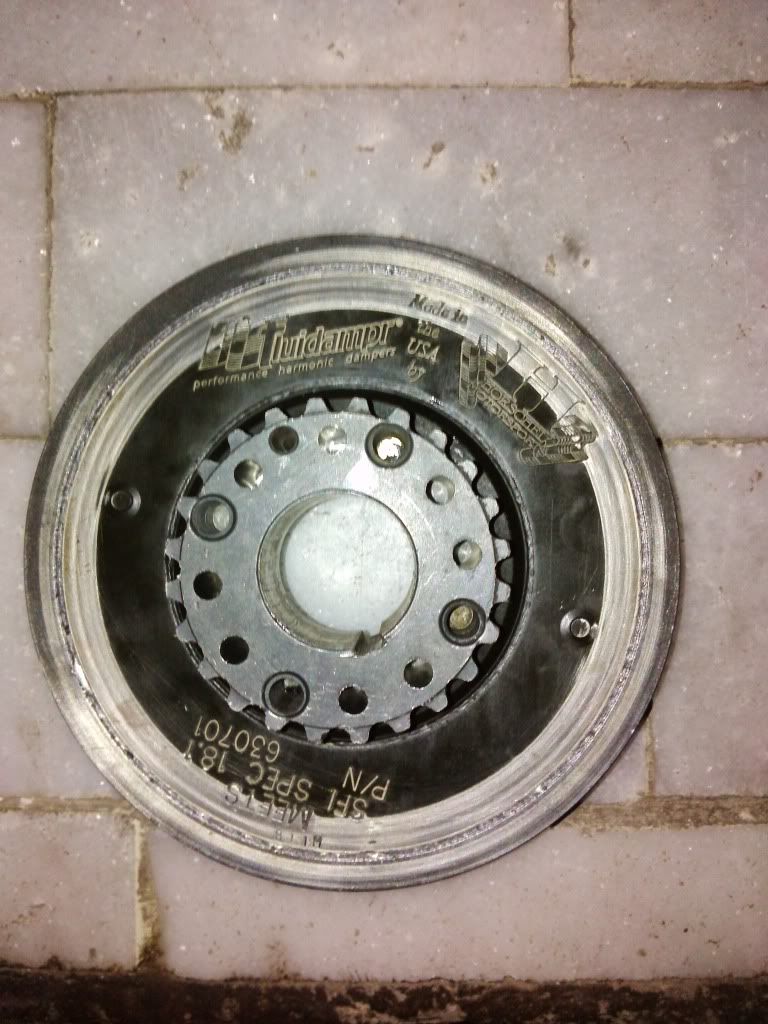

fluidampr

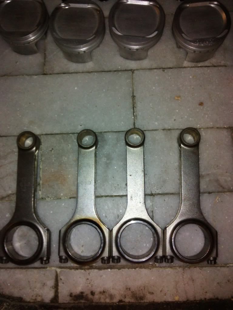

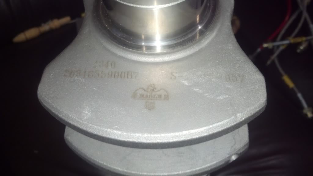

EAGLE H-BEAM
EAGLE CRANK, MAIN AND ROD BEARINGS AND CC CLUTCH FORK
You can use 30wt oil instead of the ARP molly for the head studs but the torque spec is different than using the molly.

Nice fluidampr pulley, I want one! Oz, you should have told me you needed some moly lube, I had extra I could have sent with the rest of the stuff down there.
jajaja thanks budy, I did not know you had extra-moly lube, if I had known, believe me I would have said to send together with the other things

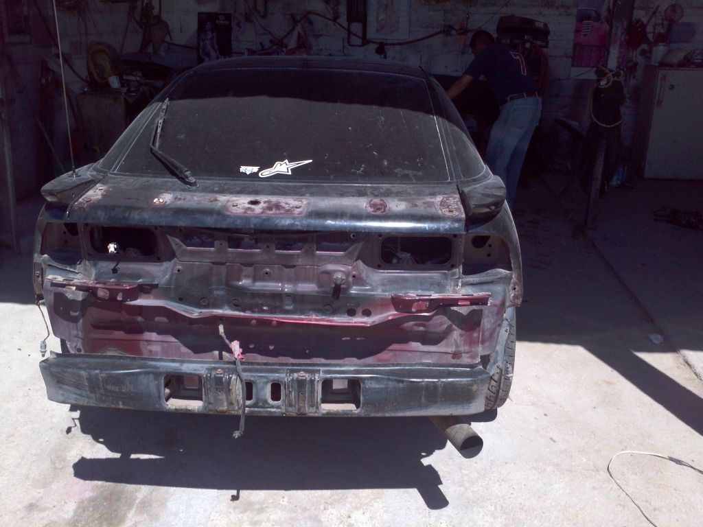

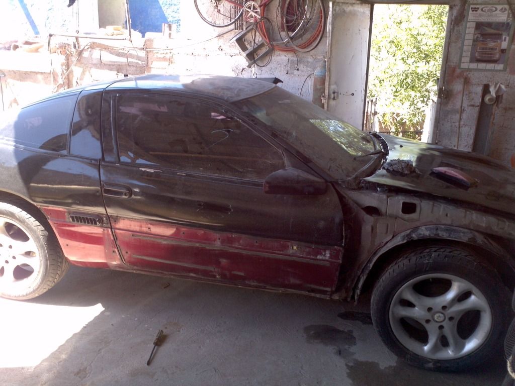

Thanks friend, The car if it was working when I buy it, the problem was he was in bad shape, I paint the car and did a first adjustment, I have some photos of the car before painting ...
Take this opportunity to show that I have other things more for the car
Any questions, criticism or comment is welcome

Orale that's cool you stay in chihuas, I got family in valle de zaragoza and juarez, you should have everything on this site if you haven't looked around yet, those rods I don't know if you got them used but they look used, id get a new set if they are discolored. Good luck with your build, glad to see someone in that area doing a build.
Thank you very much friend, for now these are the parts that I have, because I'm just going to start, when I start to build will show more progress photos, this is just the beginning, and before attempting to assemble the table I would like to get of torque with ARP bolts (crankshaft, connecting rods, flywheel, main studs, and head studs)

If you don't have moly, use white lithium grease. The whole point of moly lube is to provide an even torque curve under tension.

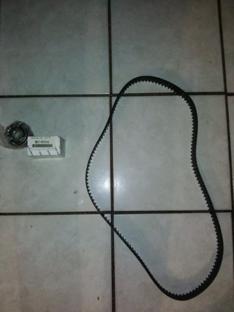

I will not use the timing belt, because that I install it on my other dsm that then I will show you, but my question is the following

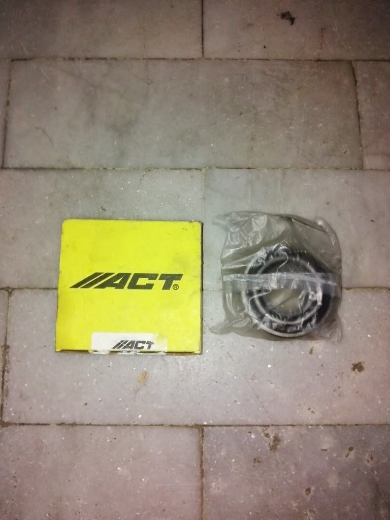

What throwout bearing is most recommended?
ACT or OEM?????
I have both
Greetings
ACT or OEM?????
I have both
Greetings
Like most things with our cars OEM is the way to go.. If you can score a brand new OEM bearing you will be golden

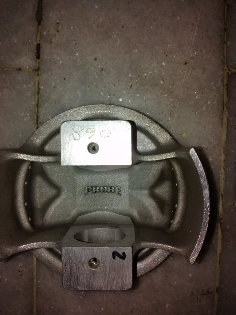

Just a heads up. Probe Pistons need alot of Deburring and Prep Work. If its in the funds, I would buy new pistons. Good Luck with the build
as referred ...

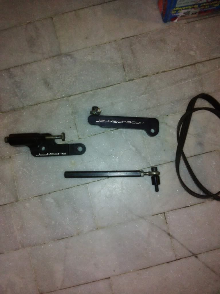

Jay Racing alternator relocation kit

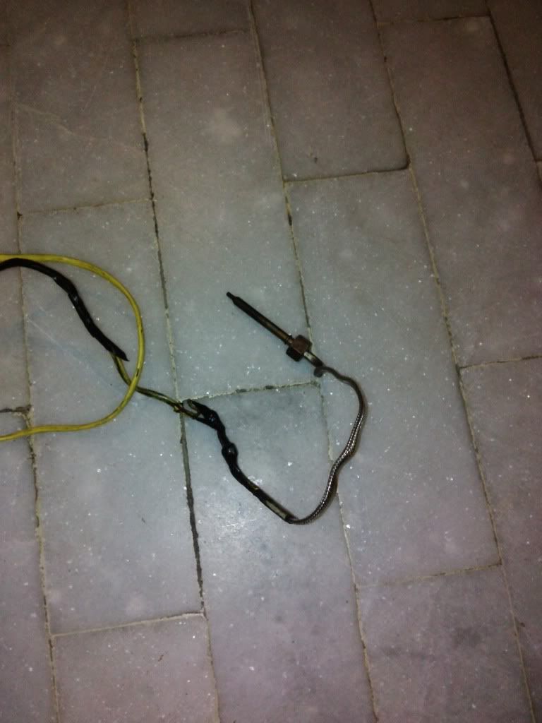

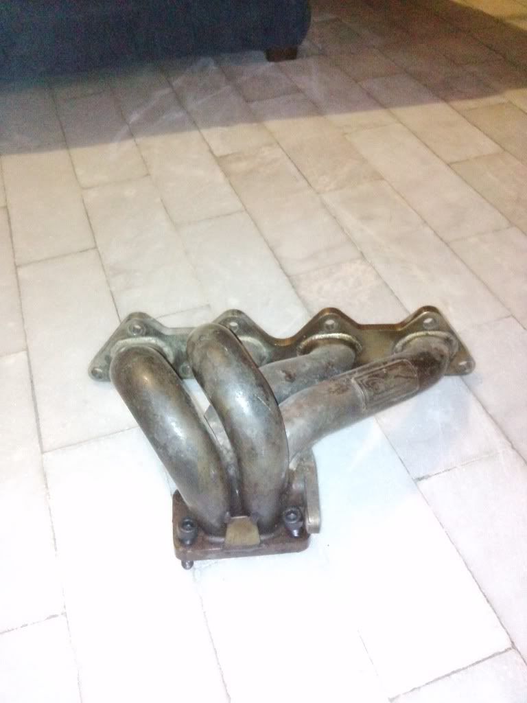

Friends, I have a question ... I
have this exhaust manifuld

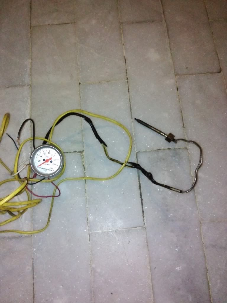

and egt pyrometer, my
question is where do I can
install the egt? My other
question is that I have only
what is in the picture, Where I can get the missing
part in the exhaust manifold?
Greetings
Oswald
For the egt gauge you can get a bung that you weld onto your manifold from one of the supporting vendors. As far as where to install it not too sure.
