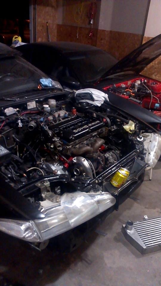

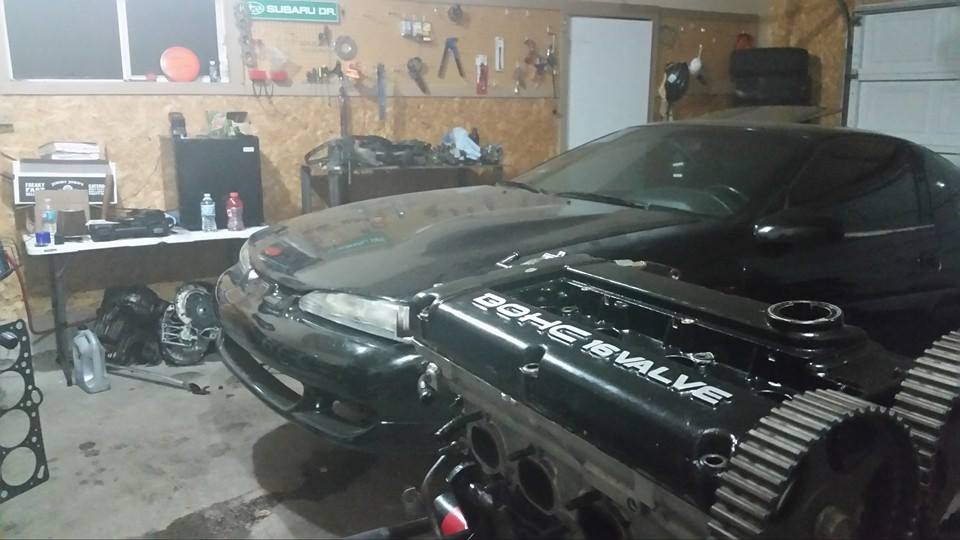

so i bought a nice rust free 1gb shell with a awd trans and didnt really know what i was gonna do with it. I ended up finding a fwd 1gb with a 6 bolt swap but it didn't run very well because the person who owned it was retarded. Any way I bought that and pulled the motor out replaced the hg and put it back together and dropped the motor into my awd 1gb. I put a 16g turbo on it with the fp manifold and 880cc injectors a 255 fuel pump and fpr and the fuel lab metal fuel filter so i could run e85. i also got a ets intercooler for it but i haven't put that on because i cant find the right throttle body elbow. ill be getting ecm link next paycheck so hopefully ill be out on the streets soon.
