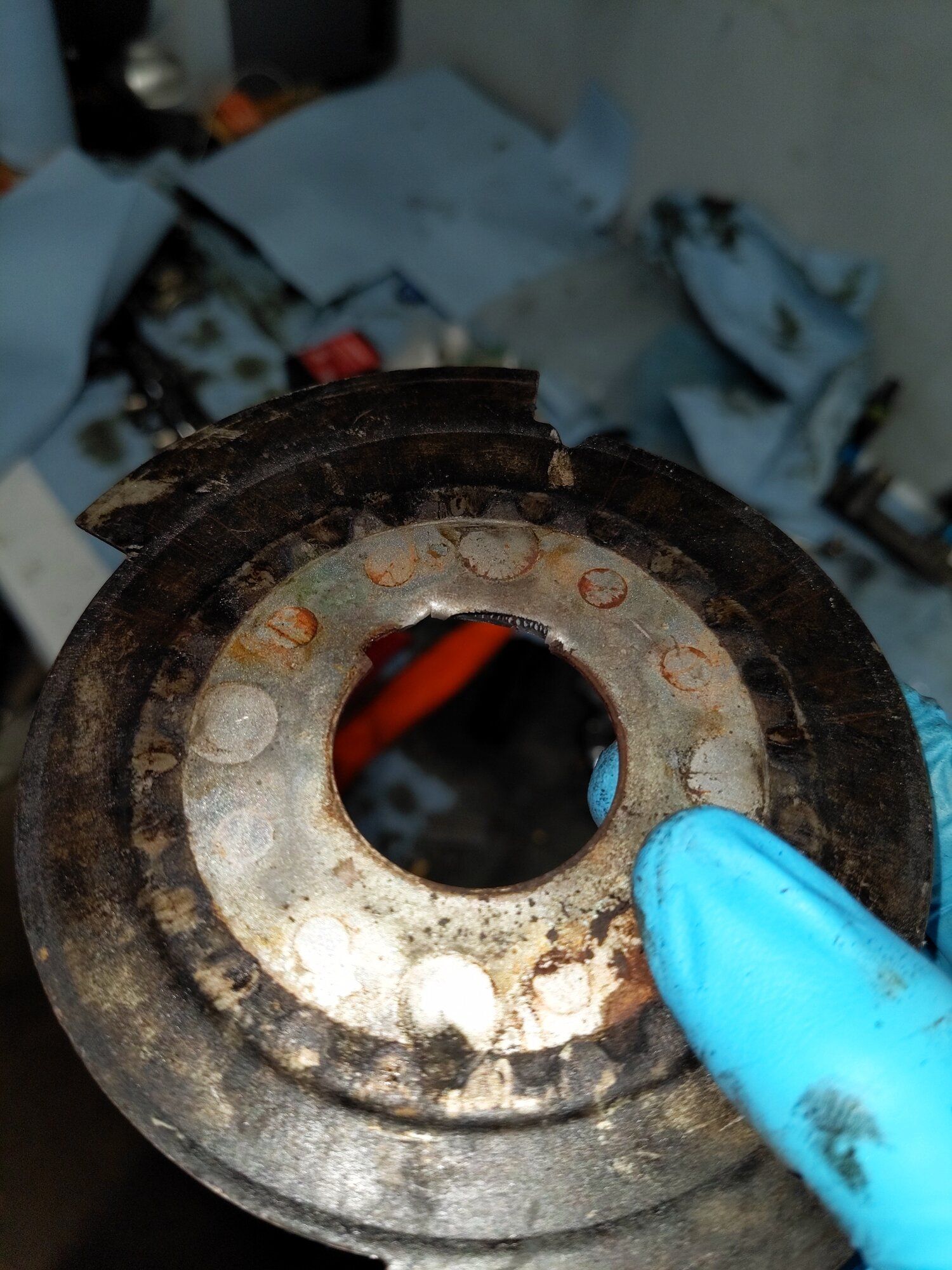

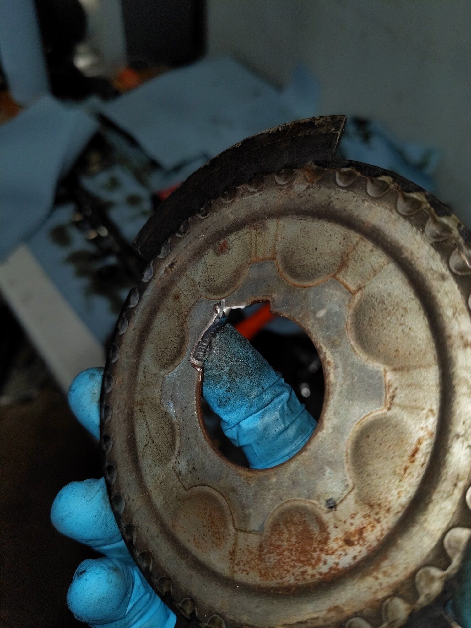

Got some photos from when I installed the GSC cams, when taking off the timing belt I noticed the crank trigger looked a little different
I wasn't the one to do the timing belt last I've had two different shops do it and I think the most recent one is when this happened because when I went to go pick it up they were having trouble starting the car and told me it was "wiring issue to my starter" and it happens all the time with the evos in their shop. I'm pretty sure the crank sprocket just wasn't seated or tightened down all the way and so it backed out and caught on the tensioner and then ripped on the keyway. Needless to say I'm not going back there I can do my own timing belts now that I have a garage thankfully it doesn't appear that there's any lasting damage.

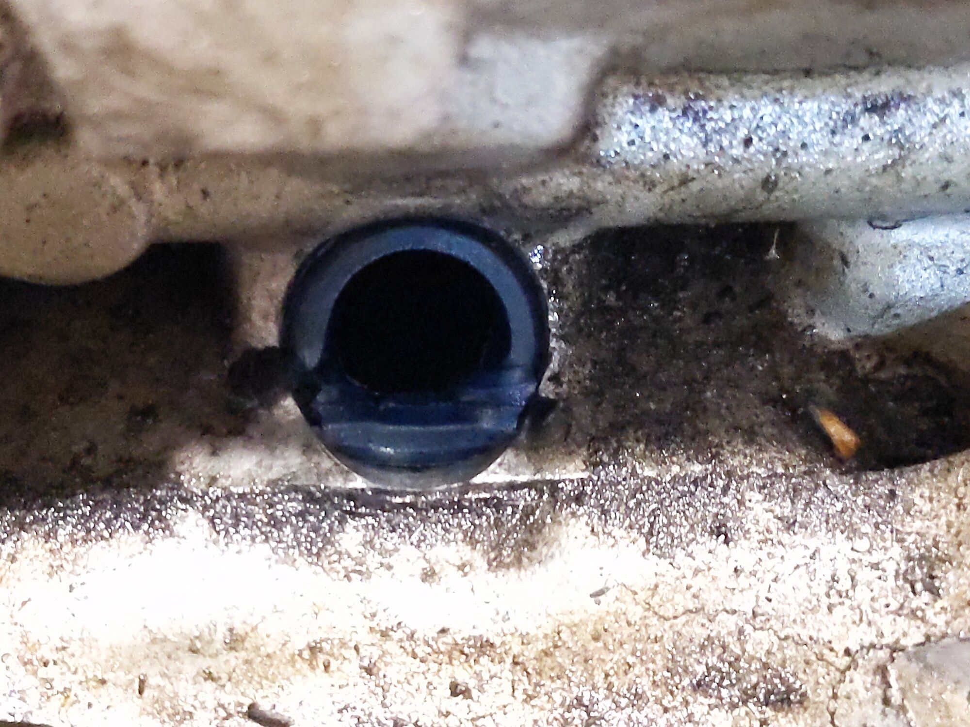

I also think I figured out why my VE table was such a pain to tune I don't know how I missed this I swear I've checked that seal plenty of times the more you know The amount of carbon deposits in that cylinder when I took the head off was insane.
That being said I'm still a novice tuner at best but numbers are making a little bit more sense now.
Yeah, I'm honestly surprised it ran as well as it did worst part is I'm pretty sure I raced with it like this up at our local circuit.https://www.youtube.com/watch?v=FpbQTrjMFmA
