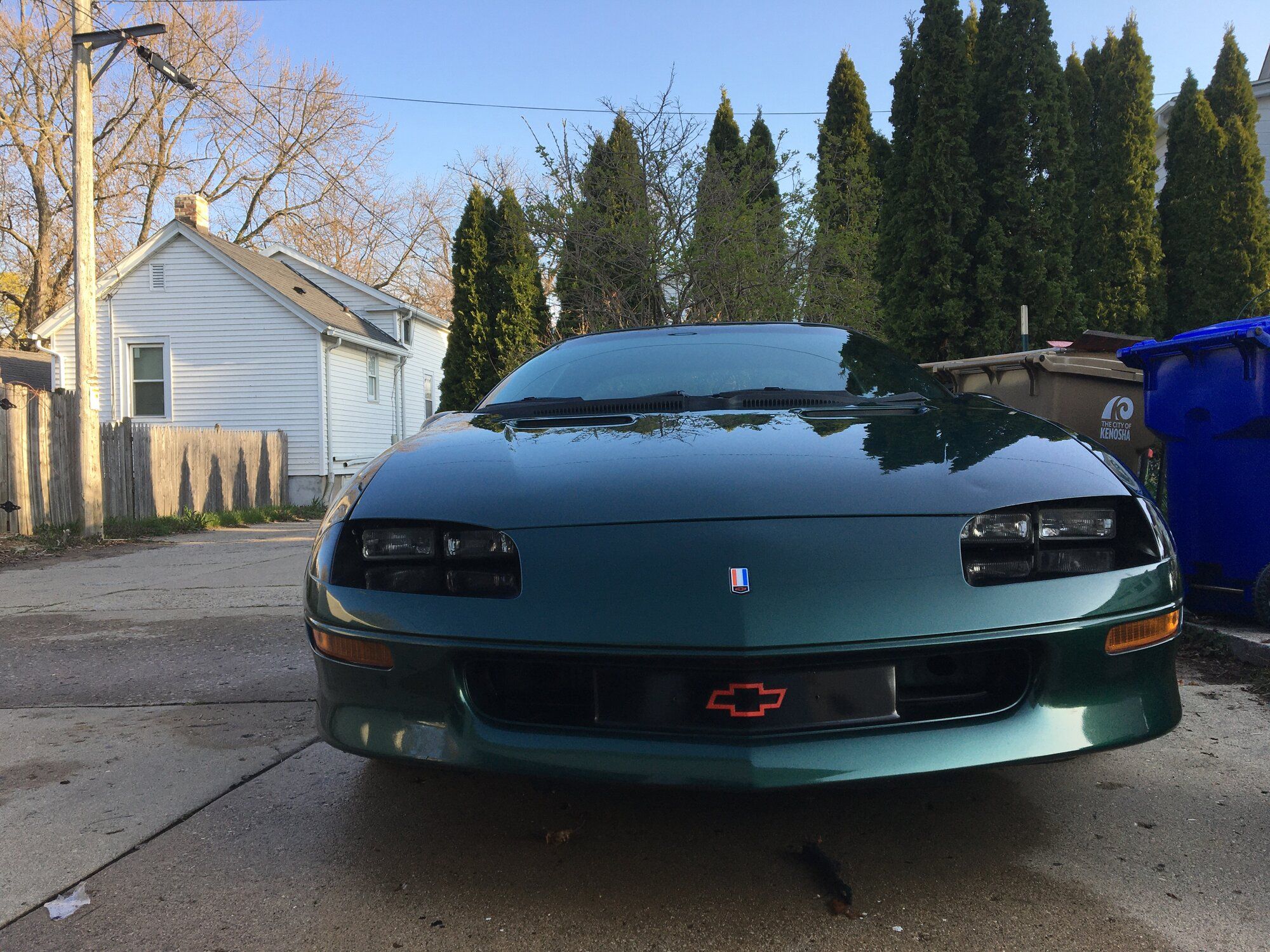

In the past few weeks I have:

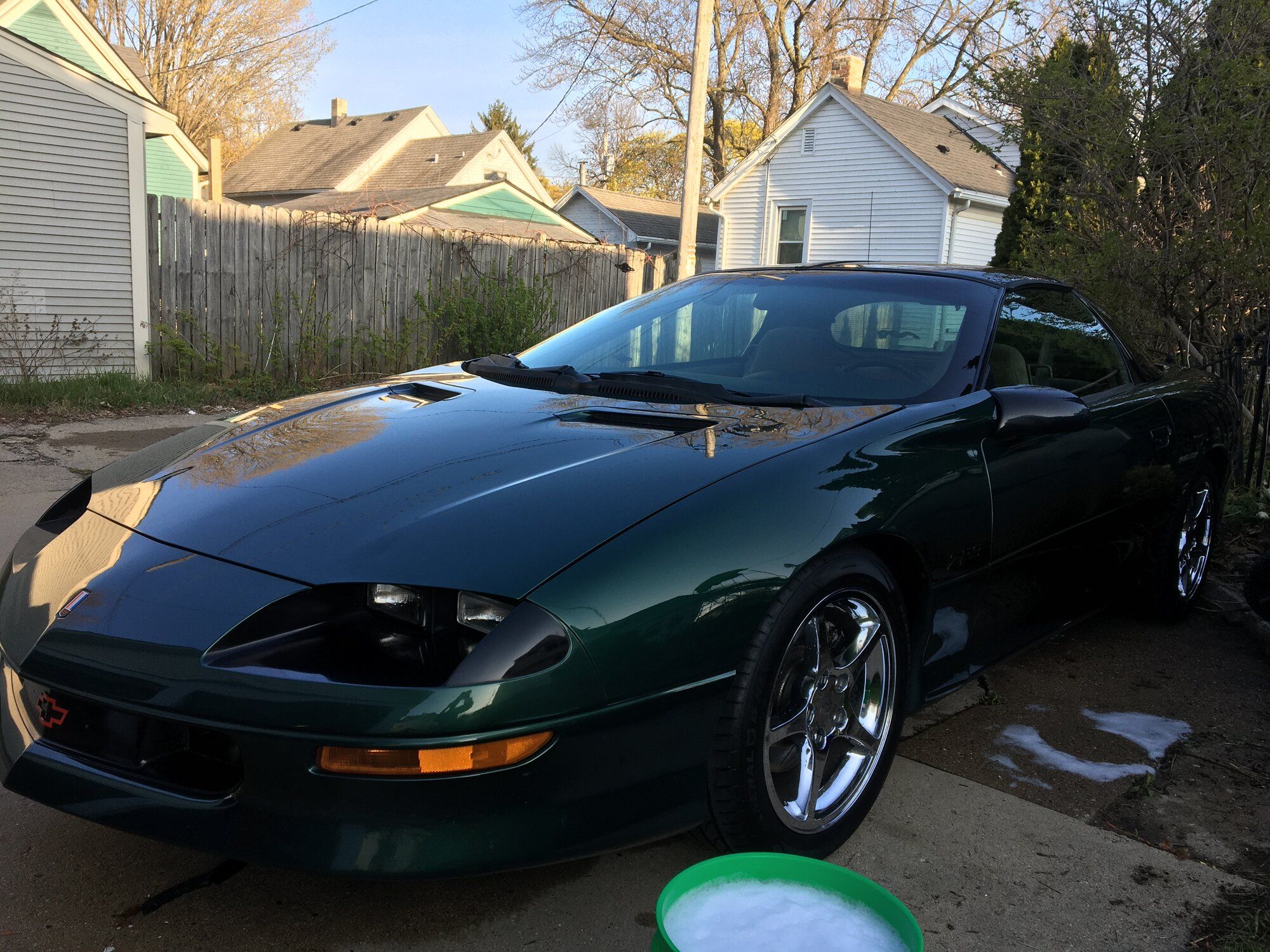

-Done full paint correction followed by ceramic
- full interior and exterior detail
- new battery
- swapped the heavy ass monster single disc for a monster dual disc rated at 1150 rwhp (almost done, waiting on a custom slave cylinder shim because I want to hit dead center of spec)
- degreased and serviced the rear end with Mobil 1

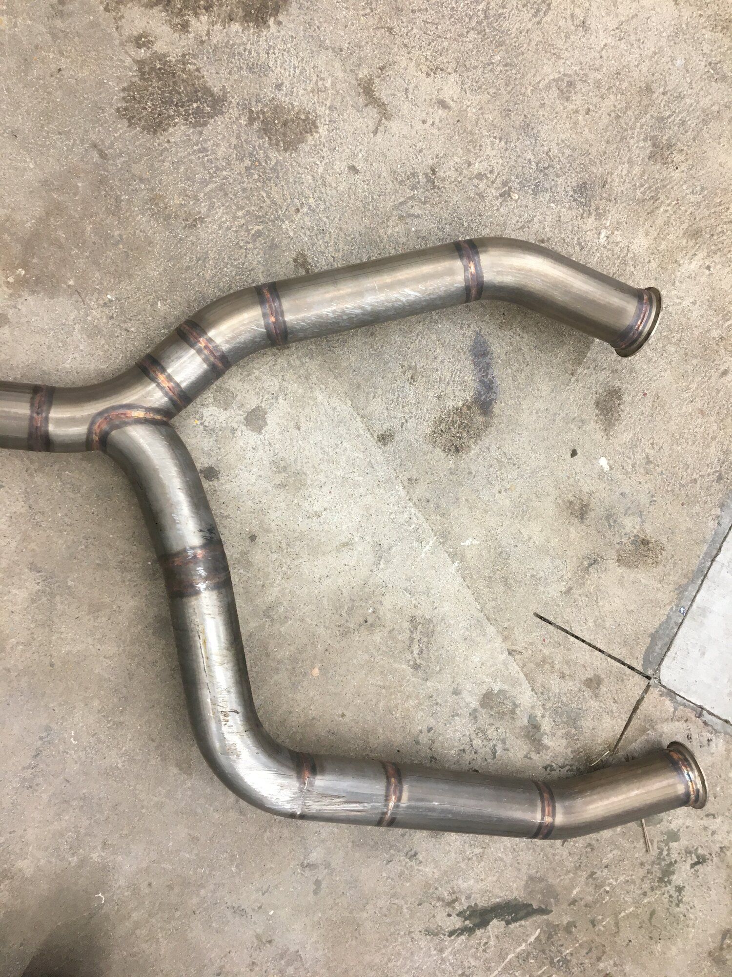

- did a little exhaust rework for better ground clearance (you can see where it hung low)
-rattle proofed the interior and doors

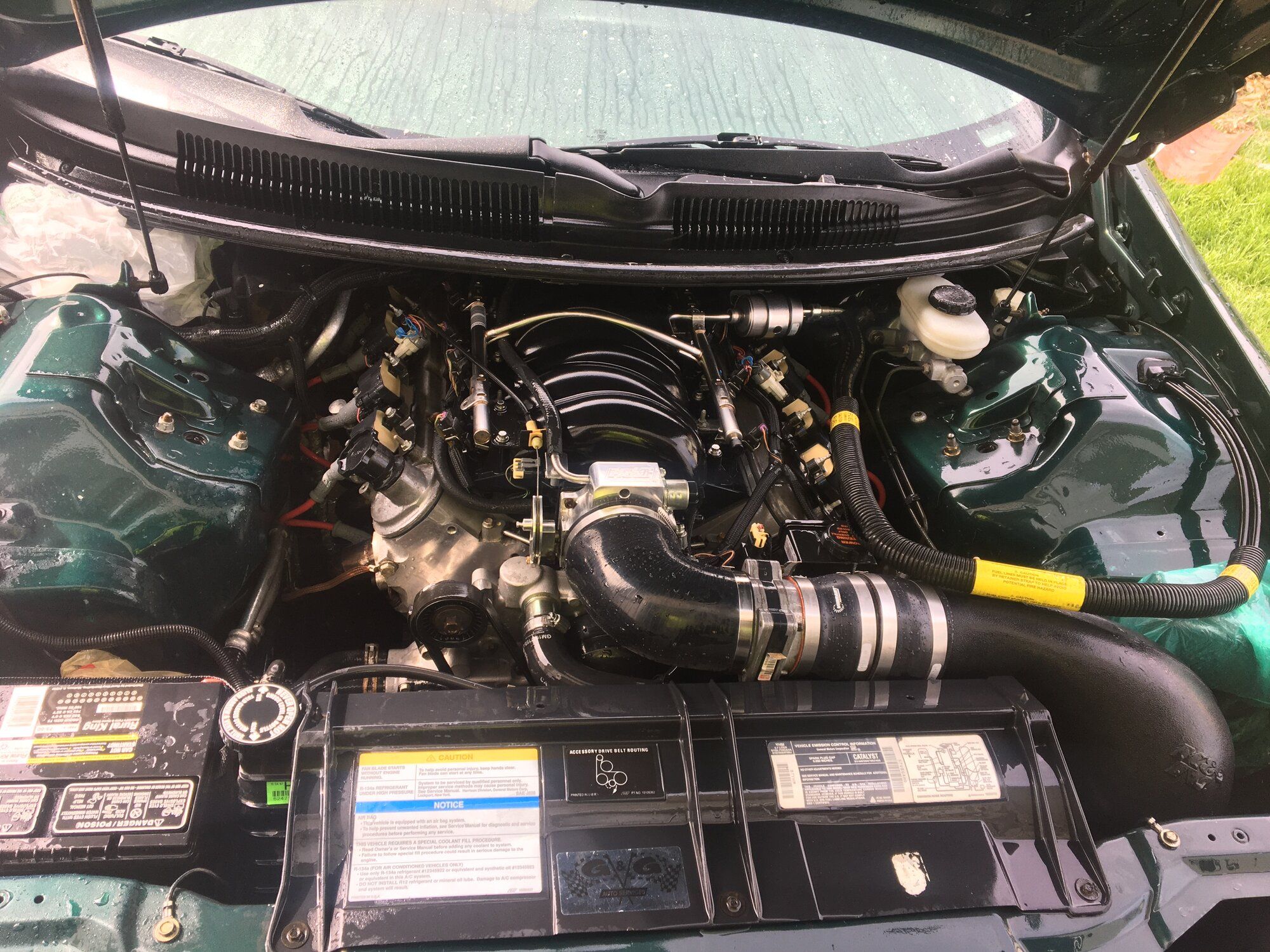

-did a couple rounds of seafoam spray and installed a catch can to clean out the oil gunk and keep it clean, can legitimately feel the difference after seafoaming and installing the catch can

Looks great! Do you do your own paint correction and ceramic work? That’s a craft I would like to learn soon, I just paid a fortune to have my wife’s car detailed last November.
Yup. Just a cheap ebay dual action and the standard mcguires cutting compound and polish. I go slowly and just get it better bit by bit because my paint/body skills are not sufficient to correct any burn through. I have to do it in my ultra cramped garage because the barn doesn’t have running water so I just pop in the headphones, queue up a Dead show or a podcast and chip away at it. Took 3 10-12 hour days to get the finish I was looking for but now the car is super easy to wash and stays clean a lot longer.

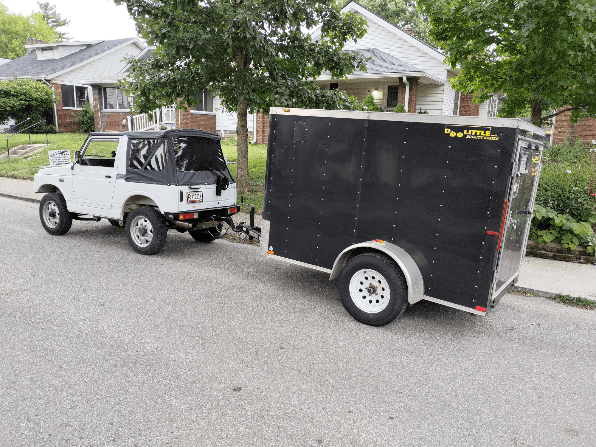

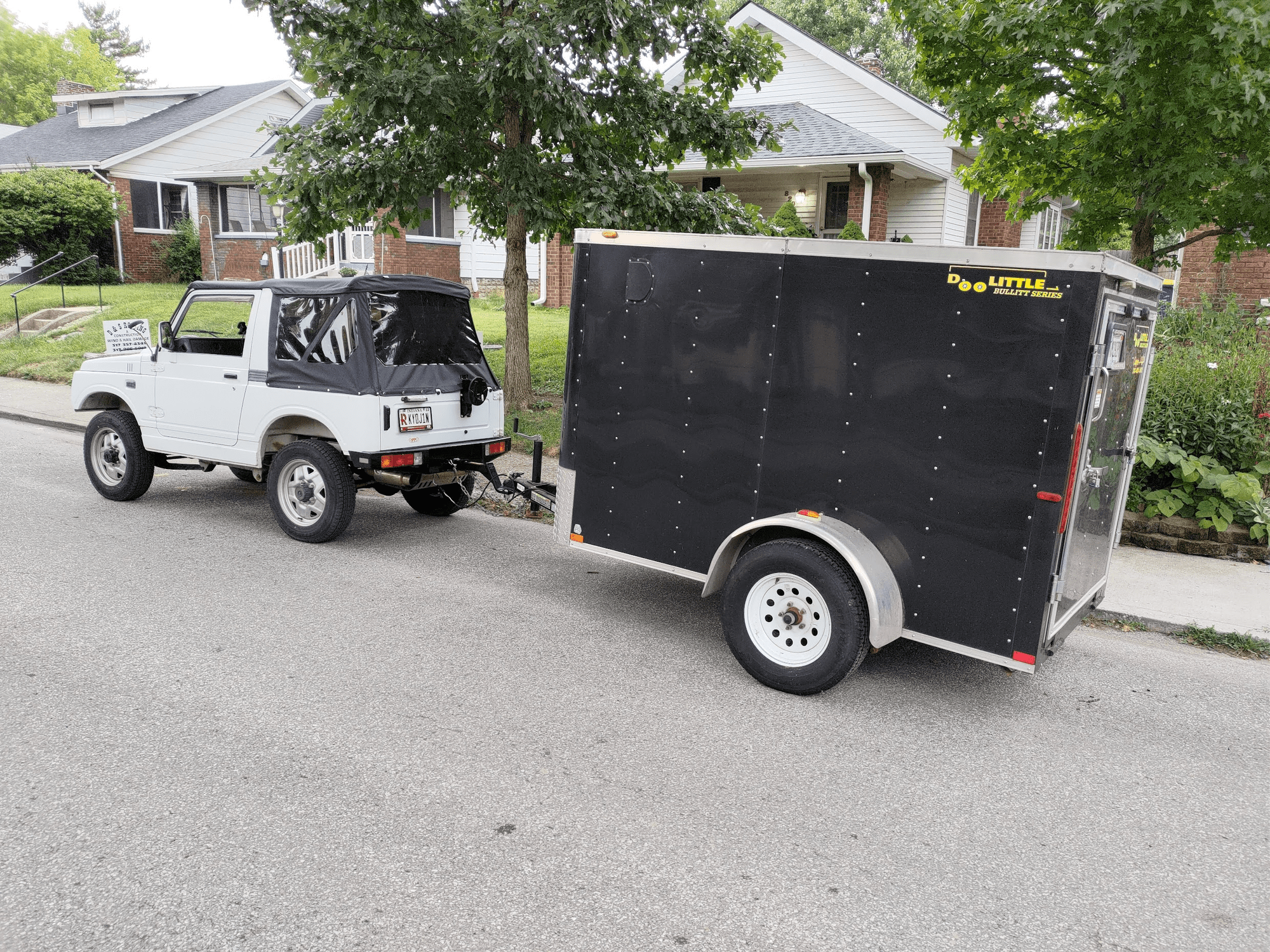

Sidekick/Tracker (two door soft top ONLY) were at the top of my husband's list before we settled on importing another Jimny from Japan. The unibody Sidekick with better road manners would have been a better fit for him, but he wanted the smaller size of the Jimny plus he was SUPER nostalgic for the first one that I imported for him years ago.
Our Jimny is plain white and we're going to paint it, but I absolutely require some tacky 90s side graphics on it. We'll have to see what matches the greens that he's picking out.
