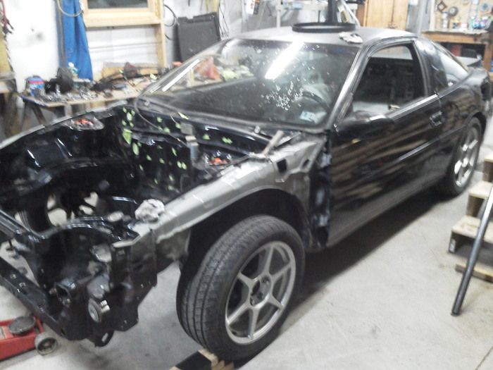

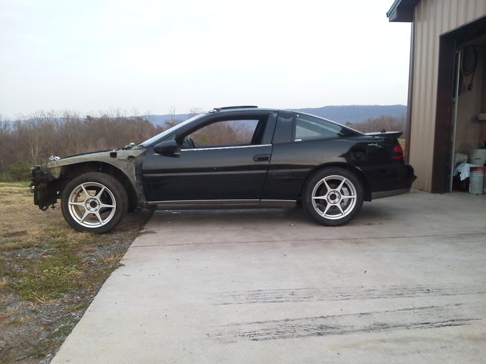

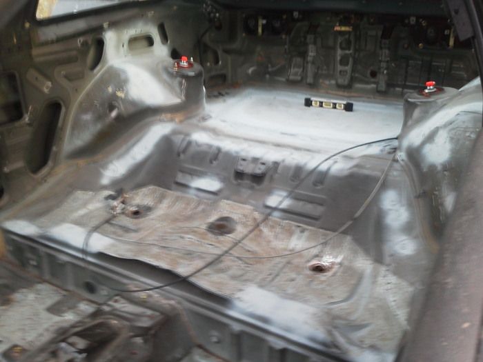

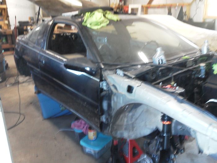

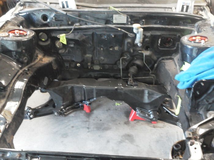

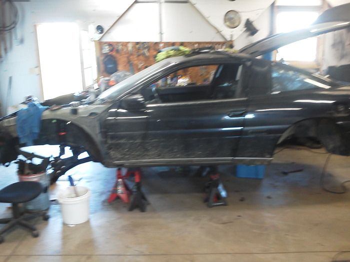

Hey guys, im a little late on starting this and I should have been taking alot more pictures that i did, but better late than never right.
I have a 93 laser and have completly tore it down and started from the ground up. I am looking for low 10's.
Project setup: 6 bolt 2.3L with eagle forged crank, manley I beam rods, and weisco HD 9:1 pistons, BSE, Mitsu MLS, ARP head studs/main stus/rod bolts, kelford 272, kiggly beehives, +1 ferrea valve, 3 angle/ port and polished, Magnus drag SMIM, Q45 TB, 90 OFH, ERL cast aluminum exhaust manifold, Tial MV-R 40mm gate, S259 .70, ETS FMIC, Tial Q bov, Dual walboro in tank, fuel cell, full -8 line, fuel lab afpr, -10 fuel rail, FIC 2150 high impedance injectors, Avid motor mounts, poly front and rear subframe bushings, swadge rear upper and lower control arms, K-sport coilovers, full 10pt cage (have in the garage but not in car yet, ACT street light pressure plate, ACT 2900 with solid 6 puck (going twin dsk once this setup is maxed out), Trans needs sorted out (not sure who i am going with the rebuild yet. Car i going to be set up and tuned with Link-v3. Fuel will most likely be E-85 or c-16 depending on availabilty (also looked into VP Import). alternator relocation, p/s delete, a/c delete, de-powered rack.
There is probably stuff that i am forgetting, but this is going to be a drag car that i would like to keep street legal. So as far a wiring and everything goes, i got rid of absolutly everything that is not needed to be street legal. I am looking to get 550-600 AWHP out of this setup

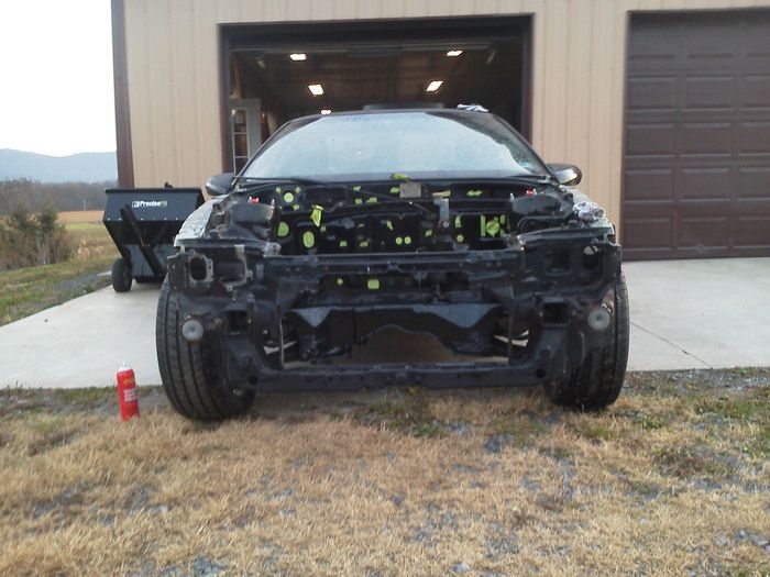

* the pic with all the tap in the engine bay was not to paint, it was just to block off the holes so i could spray the engine bay down and clean it up, engine bay will be painted with partial wire tuck when finished with batt relocated to trunk

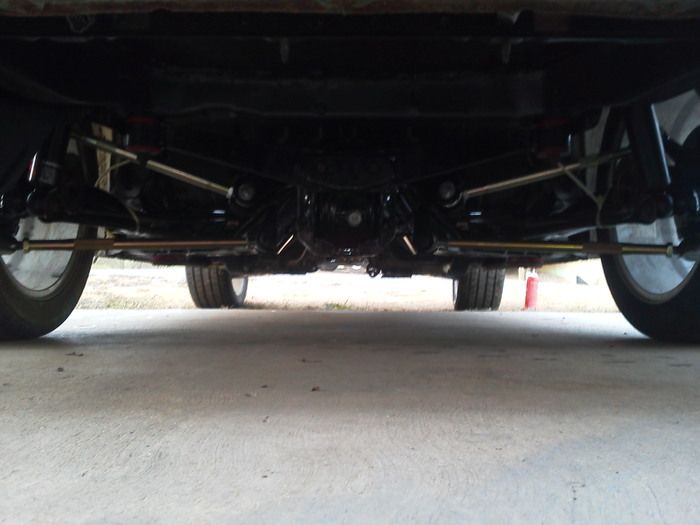

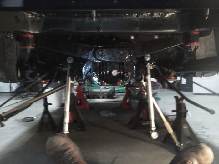

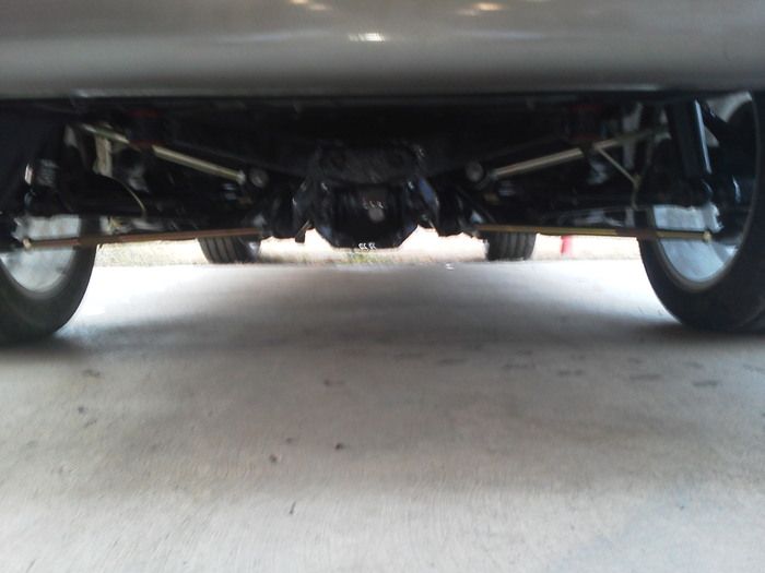

Very nice, shots from certain angles could be mistaken for my car, as its sitting exactly like that. This. Helps me see some light at the end of the tunnel! Who makes those lateral links and tie rods?
I still call b.s... Without pictures I dont believe your gonna have that super light racing seat, massive tial wastegate, or that ceramic coated manifold... And what about those kelford 272's? U have all these parts in a nice neat pile on the floor at home... TAKE SOME PICTURES YOU LAZY NO PICTURE TAKING BASTARD :)
Cleaning your shotgun and playing with your little Weiner isn't busy... At least that's what everybody tells me
made entirely from afco parts.. theres a vfaq on them

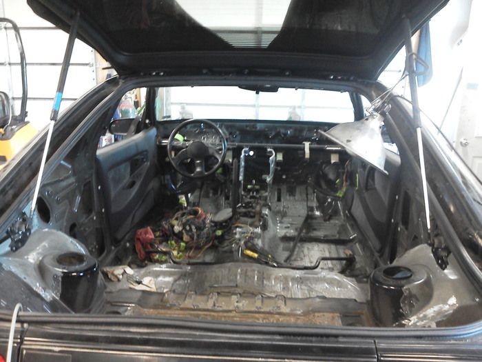

Well sorry for not posting in a long time. I have been slowly chipping away at the car in my spare time. Really busy with school and the house!
Update: Suspension is completely done, both front and rear subframes were coated in por-15. The engine bay is painted black and the seam sealer was shaved down and re-done. The full 10pt cage is in and the seat is mounted. I reconfigured the e-brake so that it is on the passenger side so it gives me more room for the staging brake which will be on the driver side.
