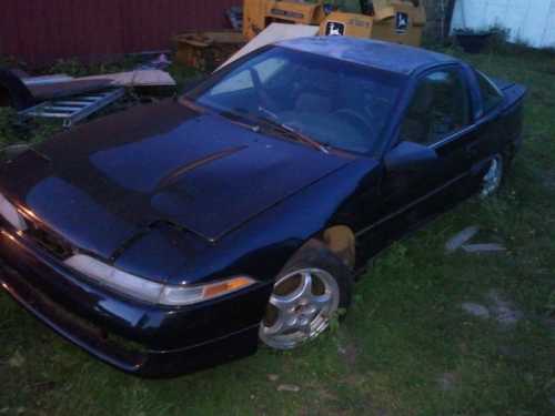

Whats going on all. Since i joined this forum because i recieved a FREE DSM I figure I'd make a journal of the project. the car was a basket case and was missing the trans and as I've tried to get it road worthy I have run accross all sorts of interesting stuff. And so it begins.

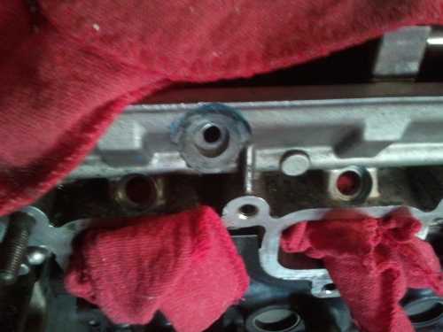

Cars body is "ok" except for the driver rear quarter panel that has some damage. The transmission is out of the car and has a broken bell housing. A/C and PS components are both gone. tire are trashed, misc parts fill the passenger seat. I figured that a good place to start was by pulling the motor out and checking it over. And I'm glad I did. The first thing that I noticed was the fuel rail, there was 5/8 in hex head sticking out where a smaller metric bolt should be, and it didnt even thread into the head, I was able to pull the bolt out by hand, and not to mention that the oversized hole through the rail actually had cracked it. The remedy was that I machined (at work) an insert to go into the hole that had an interference fit and then i used the green bushing locktite to help hold it in place. I purchased an AEM fuel rail to replace the broken stock oneand bolted it up in the other two hole so that i could mark the location for the thread in the new insert. This picture is after the repair is complete

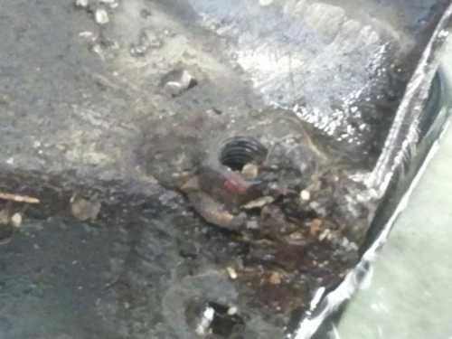

so the second thing I noticed wrong was the engine block ear was busted off. :banghead:. So I machined a piece of steel from work "somewhat" in the shape I needed and the proceeded to very carefully tack weld it in place using a nickel rod (would have done the whole thing but the steel was'nt bonding with the nickel real well) and I then fininshed it off by brazing the rest of the way. (if you want more detail on how I welded on cast iron PM me). The other great thing I discovered was that the previous owners repair was to weld a nut to the engine mount that was right in front of it. It was a nasty looking weld too. Anyway, once I welded the piece on I bolted up the transmission so that I could mark the location for the hole and then I drilled and tapped it.
and the nut
