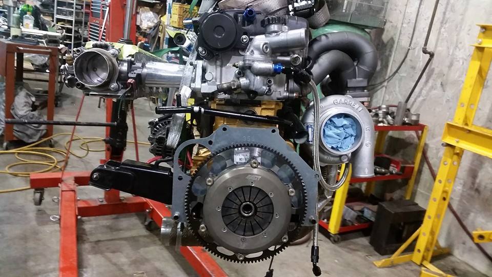

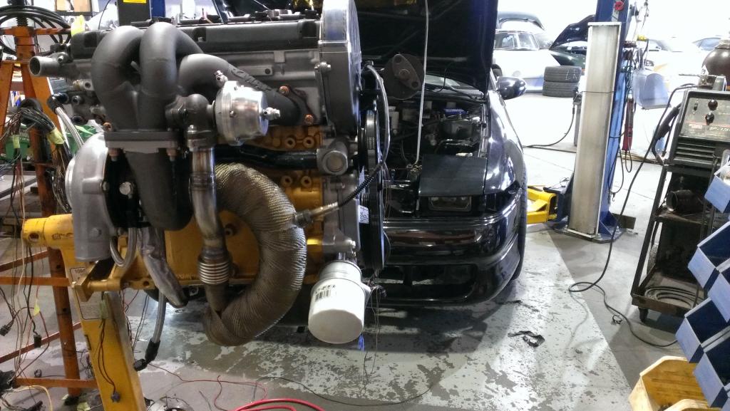

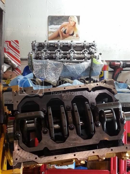

Just before the car went down for surgery I had a 2g transmission built for me with some goodies inside. I went 4spider center diff, and TRE machined internals (detailed gears etc) Fresh synchros, and updated gears (some 1g components used) This should be a great trans for the build :)

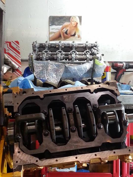

I wanted to start off with a fresh and strong bottom end.
So i had the block machined and I had some new Wiseco pistons and Eagle rods put in. I found a mint OEM 6bolt crank and that went in aswell. I went with a 8.3 compression setup with Clevitte bearings.
- I went new everything for the block, water pump, oil pump/cover, timing components
I decided to go big with the cylinder head too.
It got a full port job, new ss valves and bronze guides, Dual Si springs.
- Got my hands on some FP4r cams
- Brian Crower cam gears
- 3g lifters
- Gates timing belt
- New Cometic hg
Got some other goodies to make this beast breathe even better yet.
- New Maperformance dsm t3 exhaust manifold (beautiful piece)
- Jm Fab Race intake manifold w/ 65mm tb.
- Thermal Barrier gasket
I also Decided that it was time for a slightly bigger turbo. I was totally fine with my GT3071R but I wanted to guarentee myself an easy 450awhp. I think I have bought the right turbo to get the job done.
I went with a Garrett GT3076R turbo w/ .60 a/r antisurge compressor cover and Garrett T3 .82 a/r 3"Vband
The GT3071R was a super fun turbo. I look forward to see what the GT3076R is capable of in a .82 housing.
I have the alternator relocated with jays racing relocation kit and I also incorporated the mighty max front facing oil filter housing into my build.
This would allow me to run a nice custom Vband downpipe with lots of clearance.
- I got my hands on a Dynatek ARC2
- Complete engine grounding kit
As it stands. Im just getting everything together now and its all going in.
The car will be a beast. My goal is to run 10's at the local dragstrip here.
I cant see that being a problem. I figure this setup should yield 450+ awhp.
Heres the pics of some of the upgrades ive got lined up to go into this thing ;)
And finally.. As she sits right now
I will post more up as I get the motor in and tuned.
The dyno sheet will also get uploaded once I have it :)
Thanks for checking out my thread!

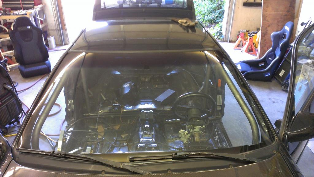

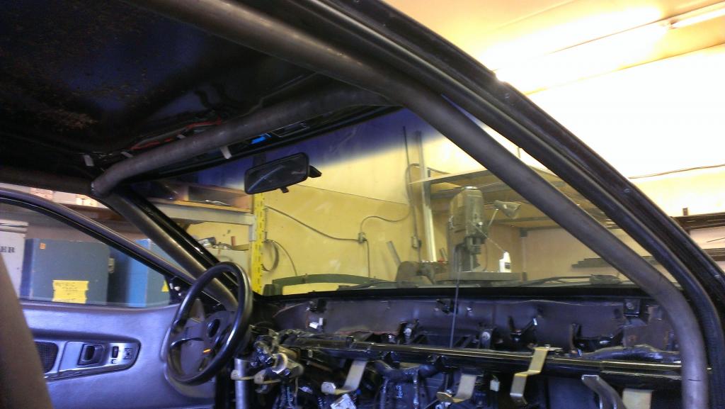

I have a way nicer shell now, and the car is about to get a 6 point cage.
I picked up the shell off a friend (traded a turbo) :)
Rust free, every panel lines up perfect, way better paint, and rolled front fenders.
Even came with a 4bolt rear and dual piston brakes!
Im upgrading to cobra brakes right away though :p
Im swapping everything over from my old shell, and then dropping in the built motor.

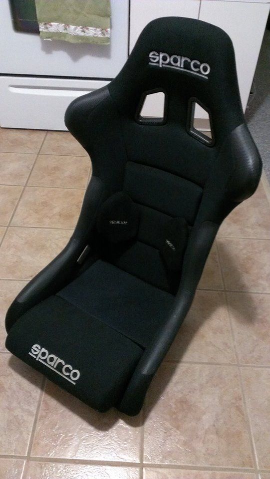

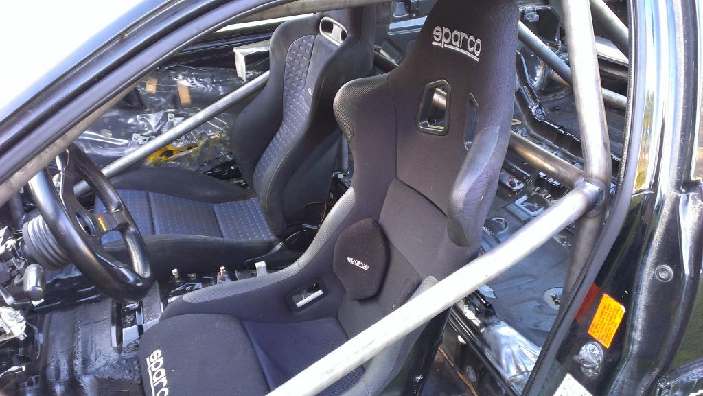

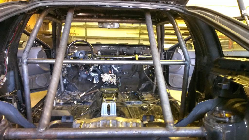

The car is currently getting a cage put in it over the next couple days. I went with a 10 point NHRA cage.
Also having seat brackets made to fit my sparco fighter race seat and evo 8 recaro passenger seat.
Ill upload some pics later today

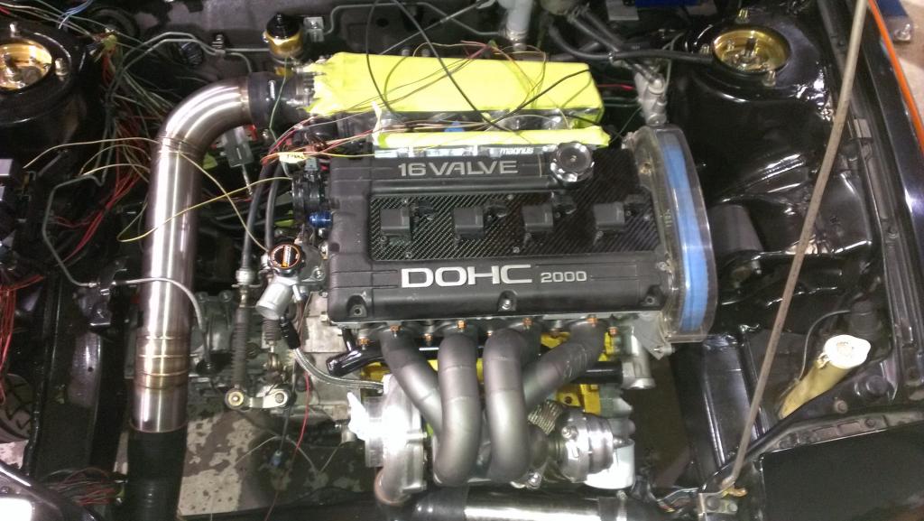

Heres an update on the car
Its almost done and its coming together as planned.
*******************************Engine:
6bolt 8.3:1 .40 over <2L.
-Eagle Rods, arp rod bolts
-Wiseco Pistons
-Stock Crank
-Racing Greed Girdle
-ARP Mains
-Clevite bearings
-Gates racing Tbelt.
-Jays alternator relocation
6bolt Cylinder head
-Aggressive port work done by Lowell @ RG
-Engbldr SS valves
-Engbldr Bronze guides
-SI Dual valve springs
-FP4R Cams
-AEM Cam gears
-Kiggly HLA Regulator
***************************************Turbo:
-GT3071R Converted to GTX3076R by ADP Distributors
-Garrett 3" Vband T3 Turbine housing
-GTX antisurge compressor cover
***********************************Intake and Exhaust:
-Custom 4" intake pipe with meth bung and 9"x6" K&N filter (picks up cold front bumper air)
-Custom 3" Charge piping by Tommy @ Racing Greed
-Custom 4" thick Intercooler with 3" inlet+outlet.
-MAPerformance T3 manifold coated by Sheela Krasnuik of BCDSM
-Custom 3" VBand long radius wg recirc'd downpipe done by Tommy at Racing Greed
-Custom Thinwall stainless 3" Turbo back exhaust done by Lowell @ Racing Greed.
*****************************************Drivetrain + shifter and Clutch:
-TRE detailed stock gears
-double synchro 2nd
-Lowell@RG built this utilizing the best 1g and 2g dsm trans parts from 2 good transmissions I had.
-Brass shift cable bushings
-Solid Shifter base bushings
-RTM Racing Short shifter
-Urethane filled Driveshaft carrier bushings
-Aluminum carrier bearings mount bushings
-ACT Twin disk clutch with lightweight Flywheel
-braided clutch line.
********************************************Brakes:
-Wilwood 4 piston with slotted drilled vented 2 piece rotors
-Braided brake lines on all corners
-stock rear calipers with greenstuff pads and slotted rotors

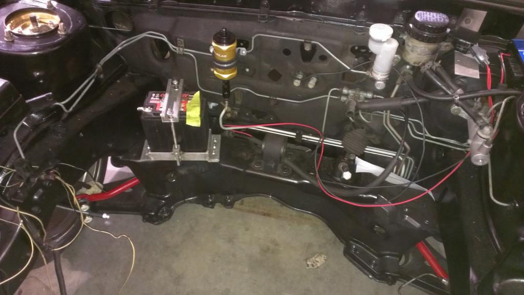

********************************Fuel and Ignition + ECU:
-Walbro 400 Ethanol pump
-Teflon lines
-Fuel Lab Filter
-Magnus fuel rail
-ID1000 injectors
-PC625 battery with custom tray
-Dynatec Ignition
-Coil on plug setup
-Speed Density tuned with (SWD - as soon as ethanol compatibility is finalized)
-Custom engine bay wiring harness done by Lowell@RG
-Methanol Injection - dual solenoid setup.
-1pre turbo nozzle, 1throttle body nozzle
-200psi recirc AEM methanol pump.

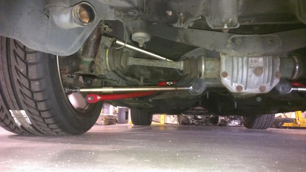

**************************************Suspension and Chassis + Driver mods:
-Front RM sway bar
-Rear RM sway bar
-Tein SS Coilovers with Camber plates
-Rear Tow Elimination kit
-Rear upper adj. Control Arms
-Rear lower adj. Control Arms

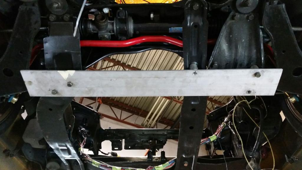

-Custom Lower front subframe support designed by Lowell@ RG
-Custom Aluminum front control arm bushings for control arm mounts, by Lowell@RG
-Custom Rear sway bar mounting brackets to trailing arms done by Lowell@RG
-Custom Roll cage done by Dan @ Pro Gas Engineering.
-soon to be custom extended steering wheel hub for road racing purposes.
-MOMO race steering wheel
-Sparco Fighter race seat
-5 point race harness
-Gutted interior heater and dash remaining. haha
- VIS Carbon fiber hood with sparco hood pins
-17x9 MB weapon bronze wheels with BFgoodrich sport comp II's

&&&&&&&&&&&&&&&&&&&&&&&&&&&&&&&&&&&& HERE ARE SOME BUILD PICTURES
20141128_184714_zps9135862f.jpe
Looks like a very solid build. Except, the Cometic head gasket. Years ago I was reading a thread where someone took some very expensive paper that showed pressure, and compared several head gaskets. Cometic was by far the worse, much worse than OEM. In fact the only one that was better than OEM I think was an HKS HG.
