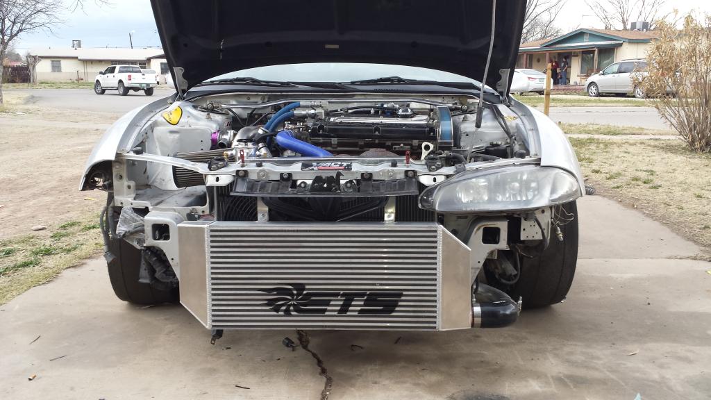

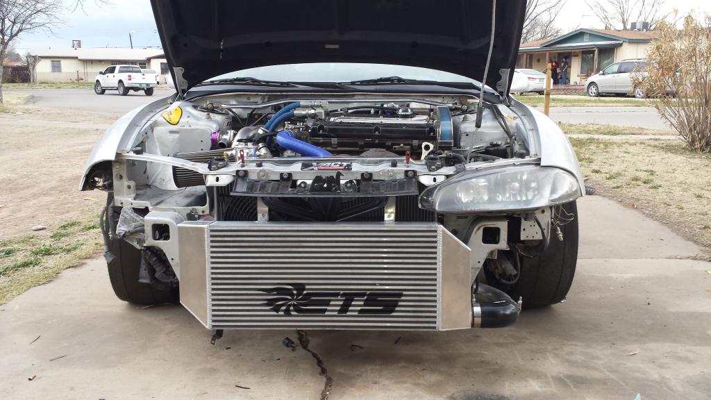

I had a custom agp with a 3 inch wide core section that was a inch a so shy of almost being too big to be behind a bumper with a precision 42mm turbo. intercooler and bov should really be determined by the turbo being used in my opinion cuz the air is.gonna need space to go.somewhere to prevent backpressure detonation
