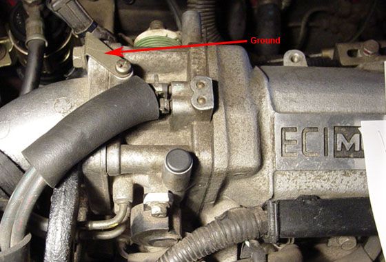

Like this one.
http://www.dsmtuners.com/attachments/90tbground-jpg.110548/
that strap allows a ground to the sensors on the throttle body. Remember, it is sandwiched between two gaskets, and might not have a good ground. That little switch tells the code if the throttle is open or closed. With out a ground, it appears open to the ecu, and you get unexpected throttling. Also check out the wire to the switch. Iirc, it's green. It has a habit of breaking, especially on older cars like ours.
