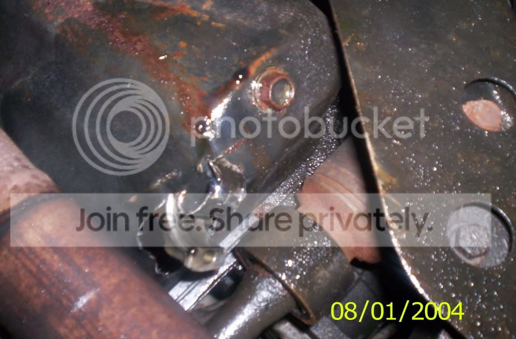

Identifying the problem isn't going to be a hard one. The car got stuck in 1st gear while someone tried to race it and 'Manual shift' an automatic, the end result is this:

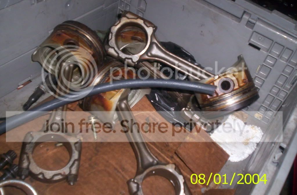

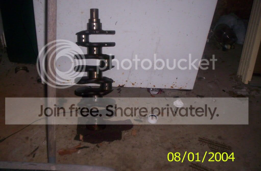

But before I begin surgery I'd like to do a little prep work, I also received some more free goodies (i.e. an extra engine) so I can use the rods and crankshaft from it.

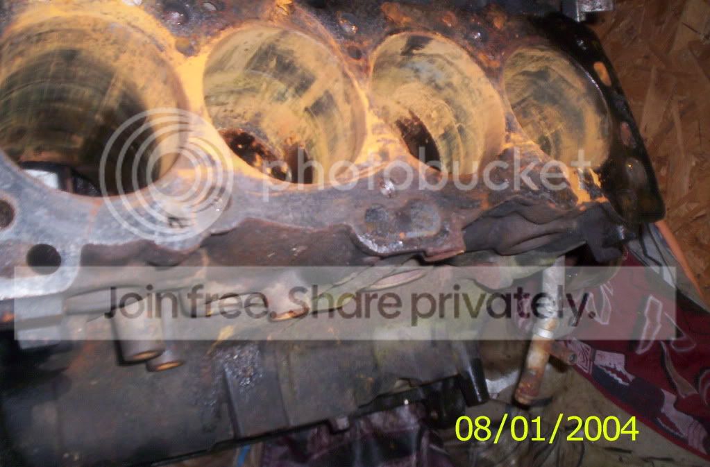

Tomorrow (1/25/2010) all this goes into the machine shop:
I am using stock 2g pistons for this one (assuming stock bore will be usable).
