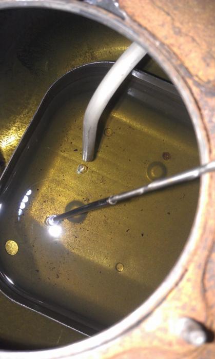

We also have this little swirl pot thing to deal with, So i'll probably empty/drop the tank and cut out a 3.25"x1/2" slot toward the base of it & make sure the edges are super smooth with no sharpness to them and slide the mat through it, keeping the swirl pot mostly intact.
http://www.dsmtuners.com/attachments/imag0381-jpg.142262/
