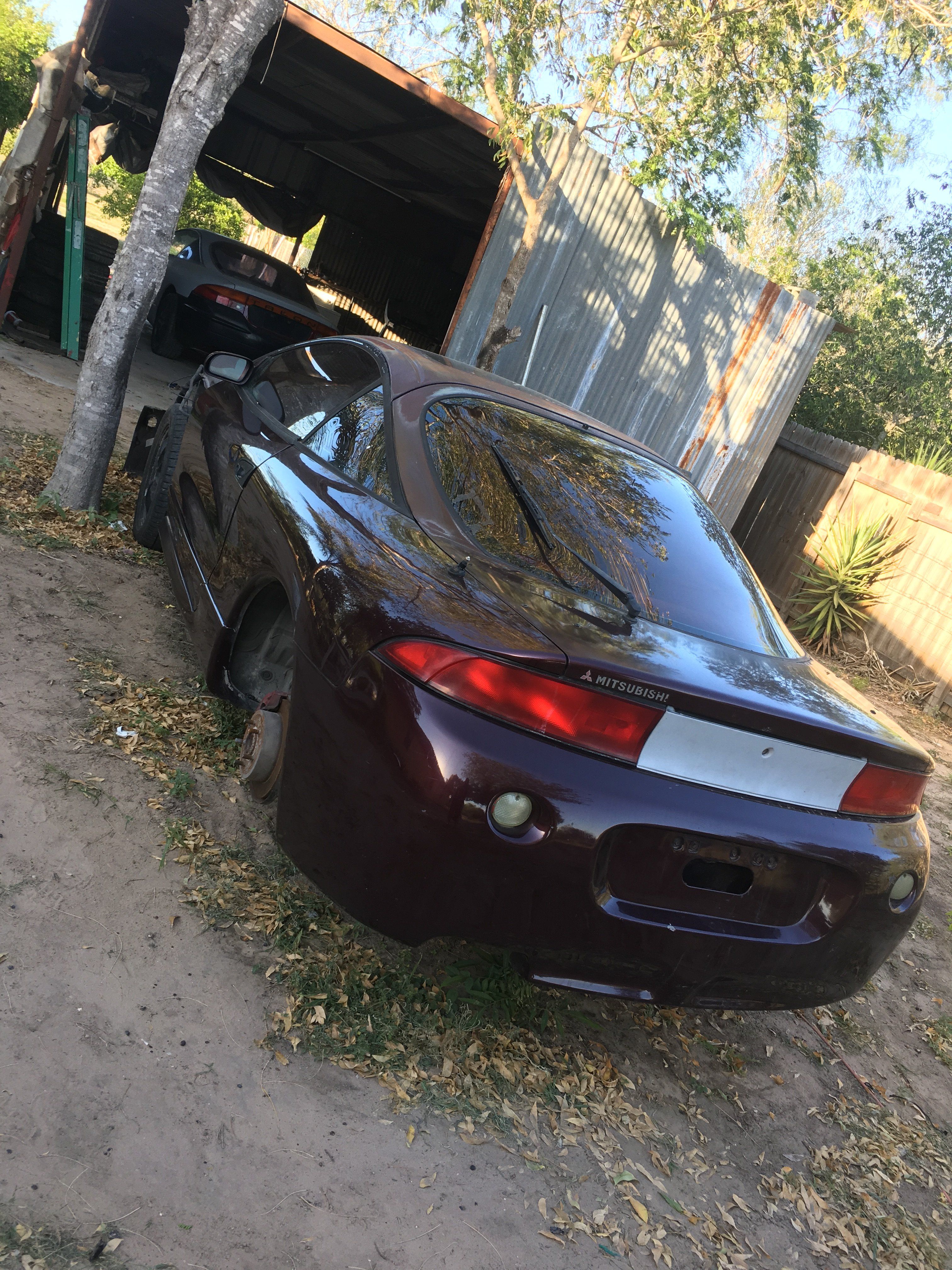

It was supposed to be a parts car and sold as a shell or junked. But decided to give it life.

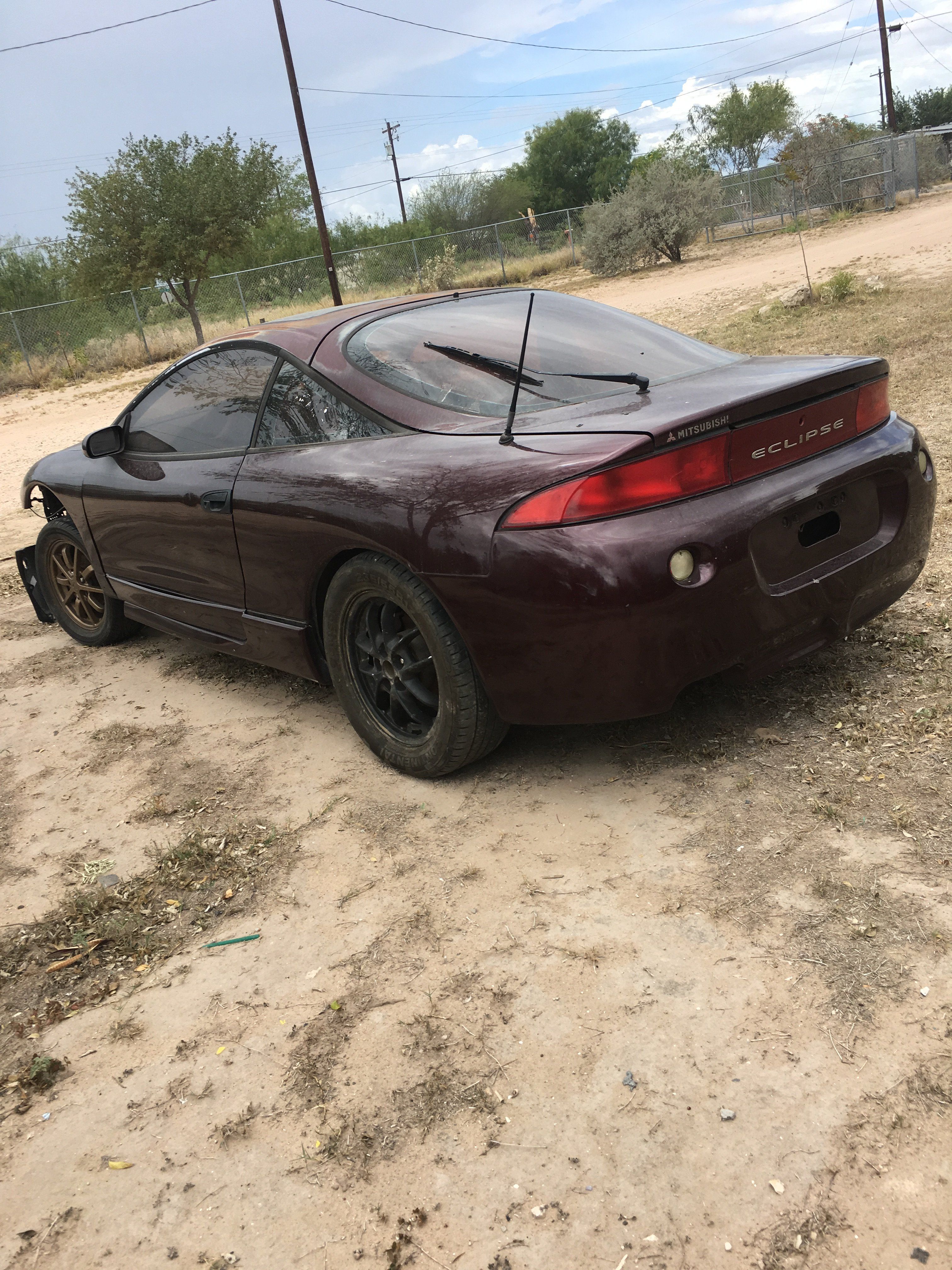

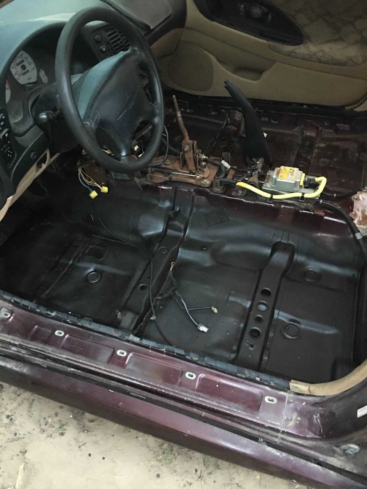

Well long story short i got a parts car/shell for $100 bucks so i could get some parts off of it a scrap it. But decided to make it a street reliable car as it was in good shape and no rust. Just needed cleaning. Like carpet washed. And some suspension work as some of the bushings on the front did not have nuts so everything was loose. So heres the list of stuff i need.

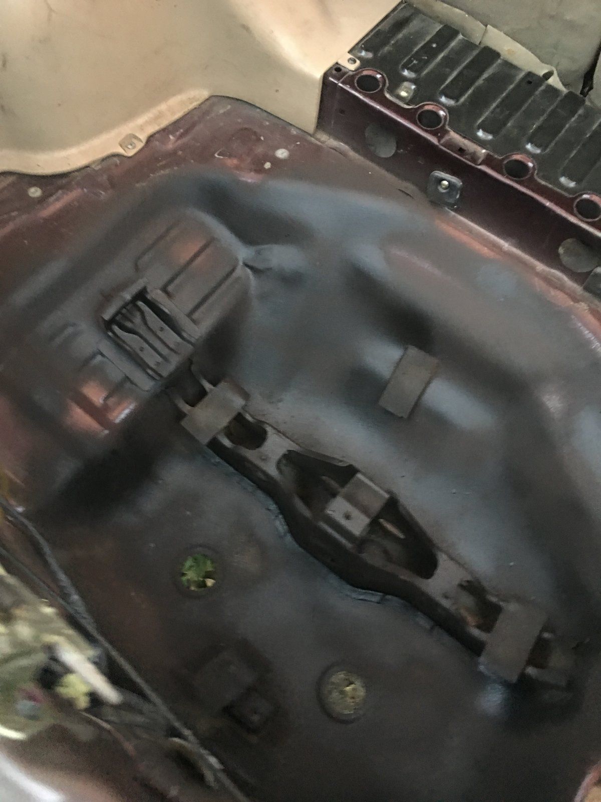

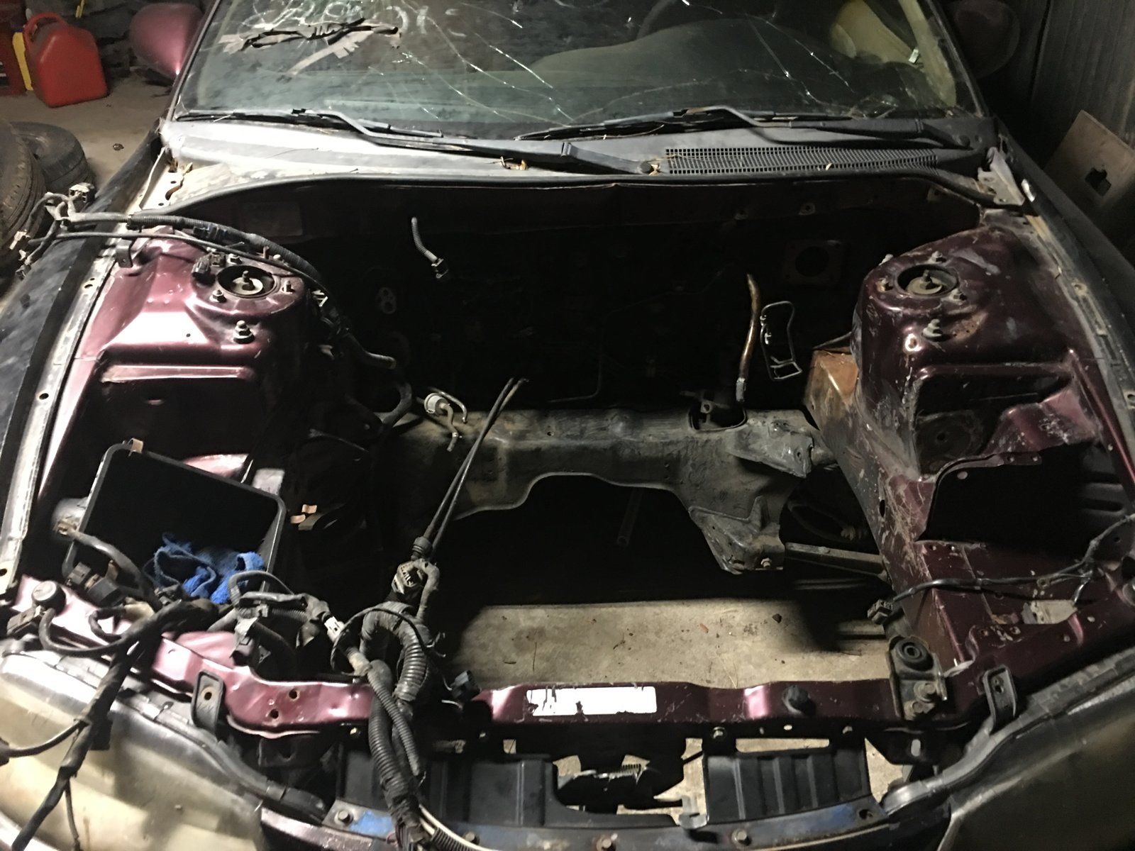

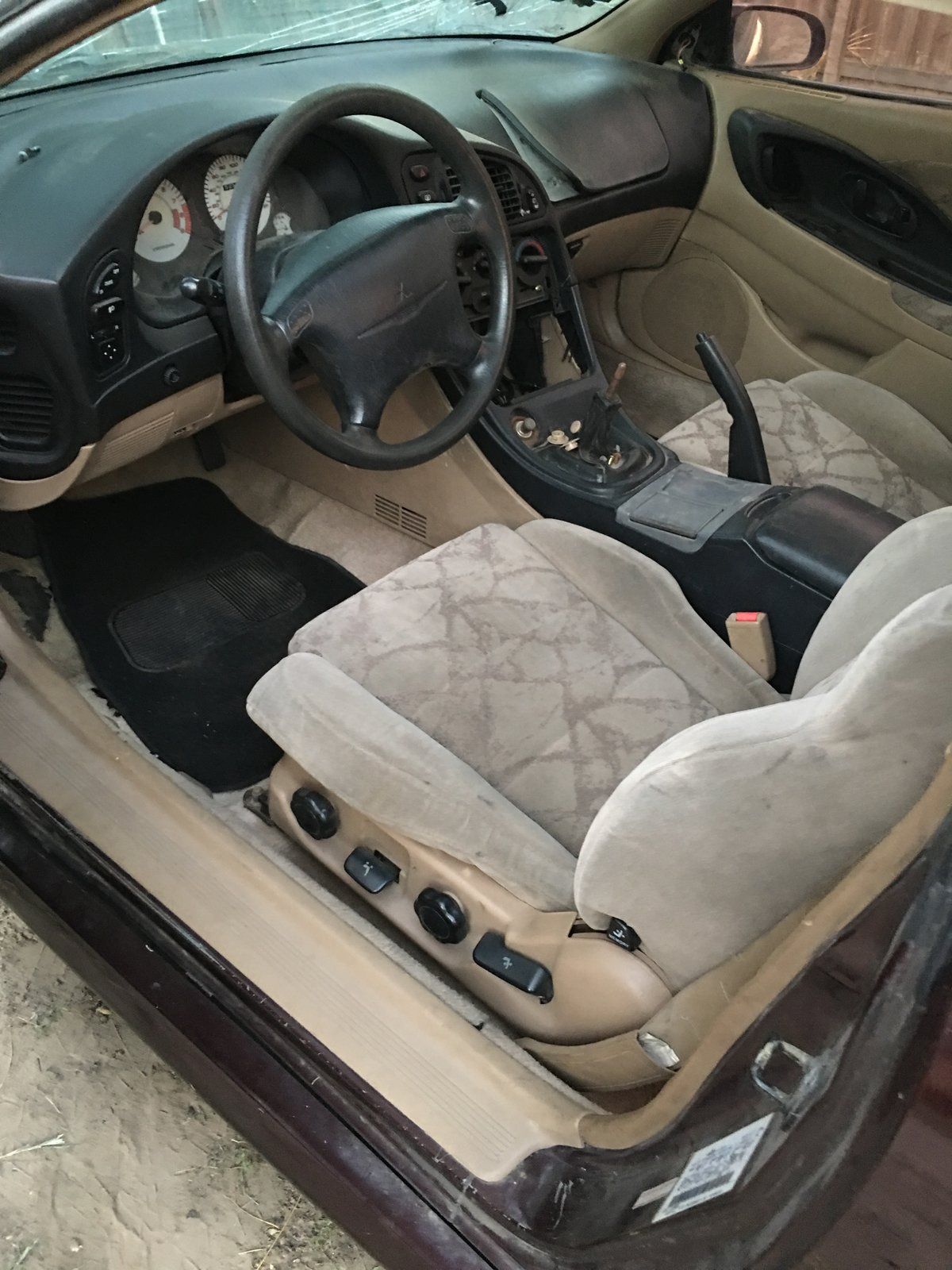

Well i forgot to take pictures of the carpet when i took it off and cleaned it. And the surface rust on the bottom of it for being soaked in water for days. But oh well. Here is when i was done cleaning and sprayed with undercoating just in case.
This is how it sat while getting cleaned

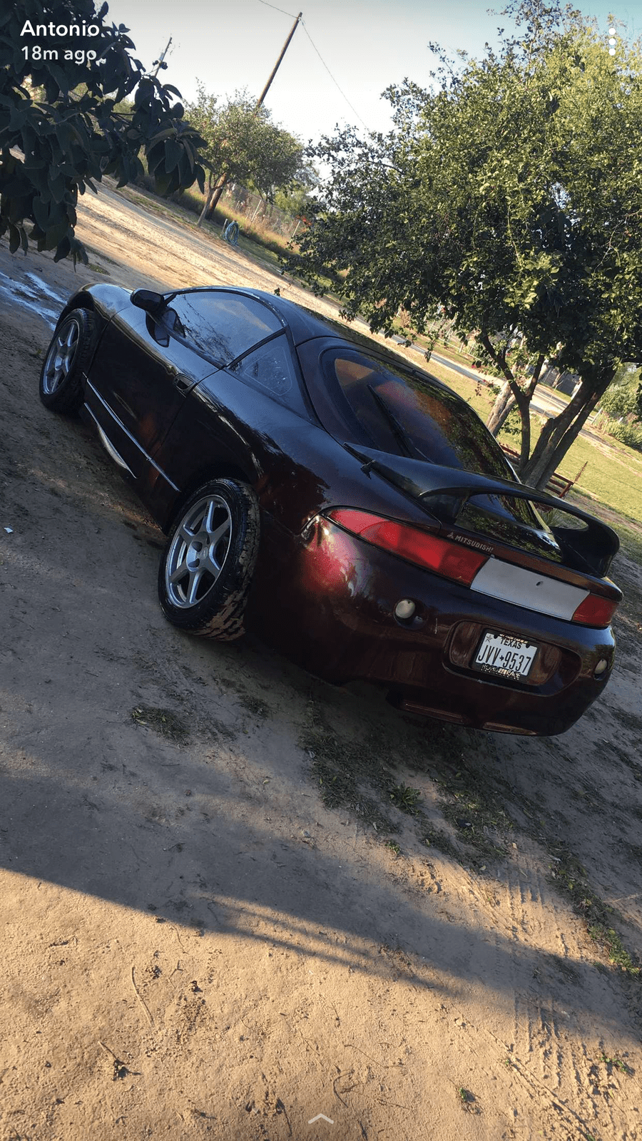

And now the finish product. How it came out with the carpet cleaned out.

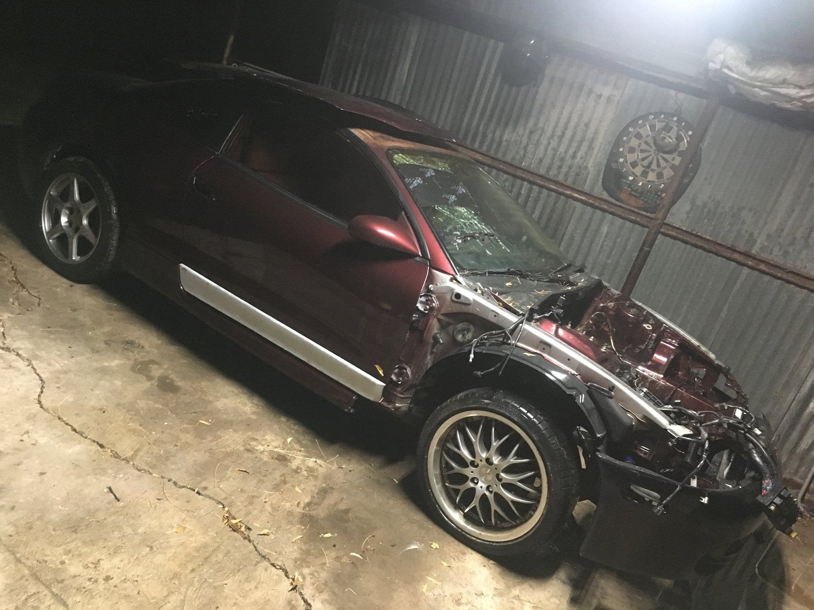

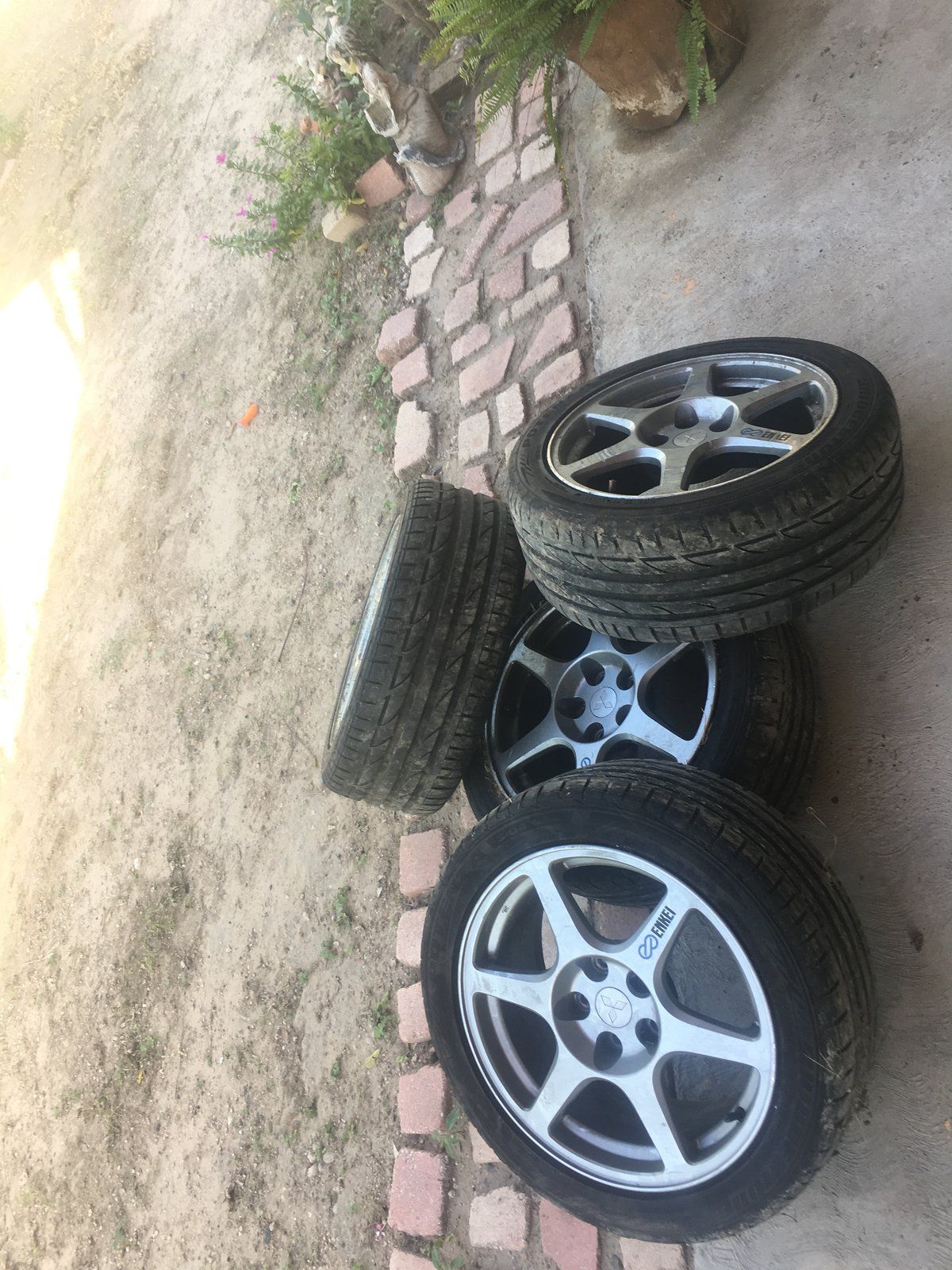

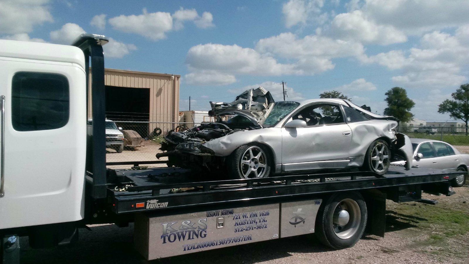

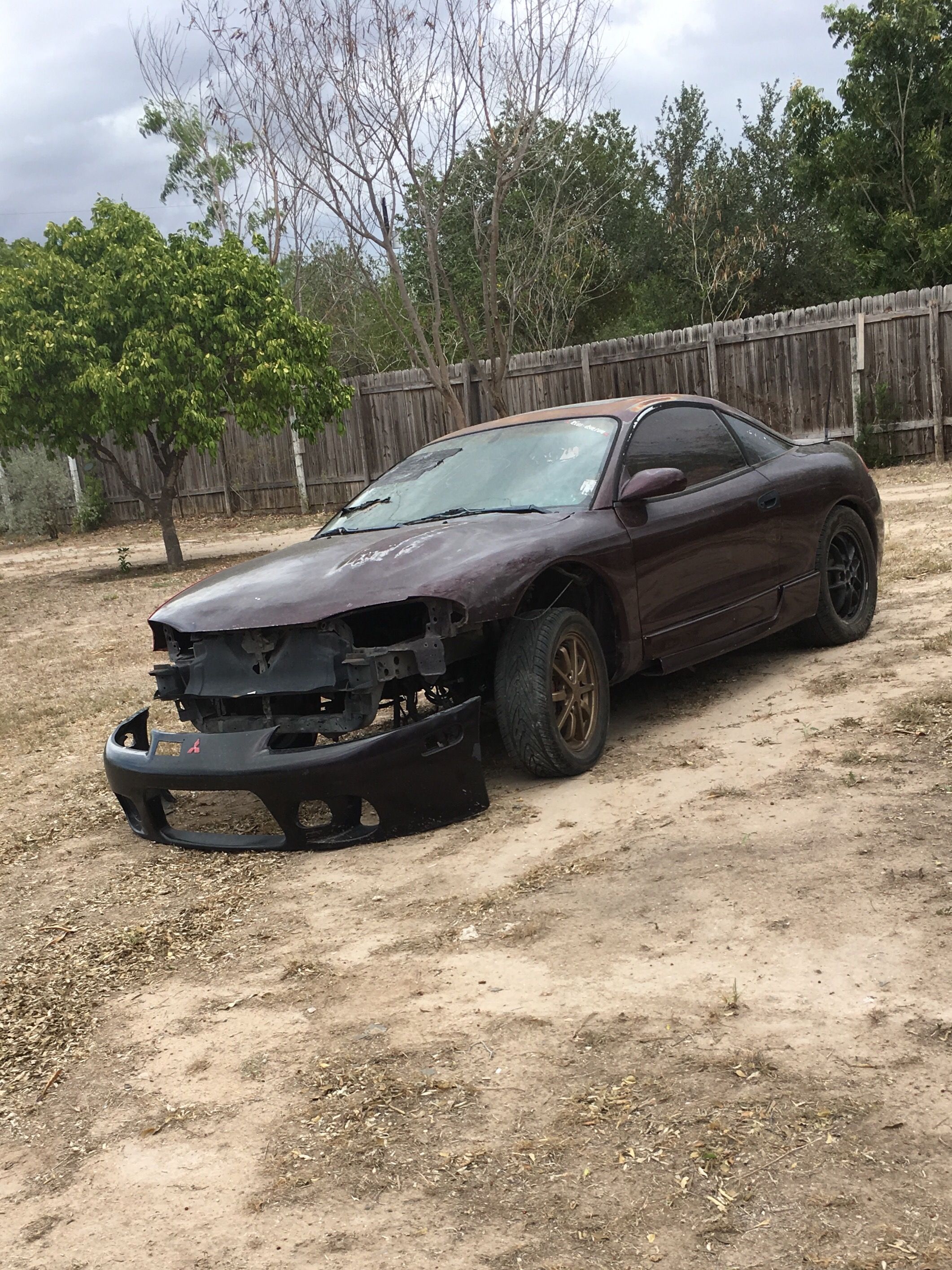

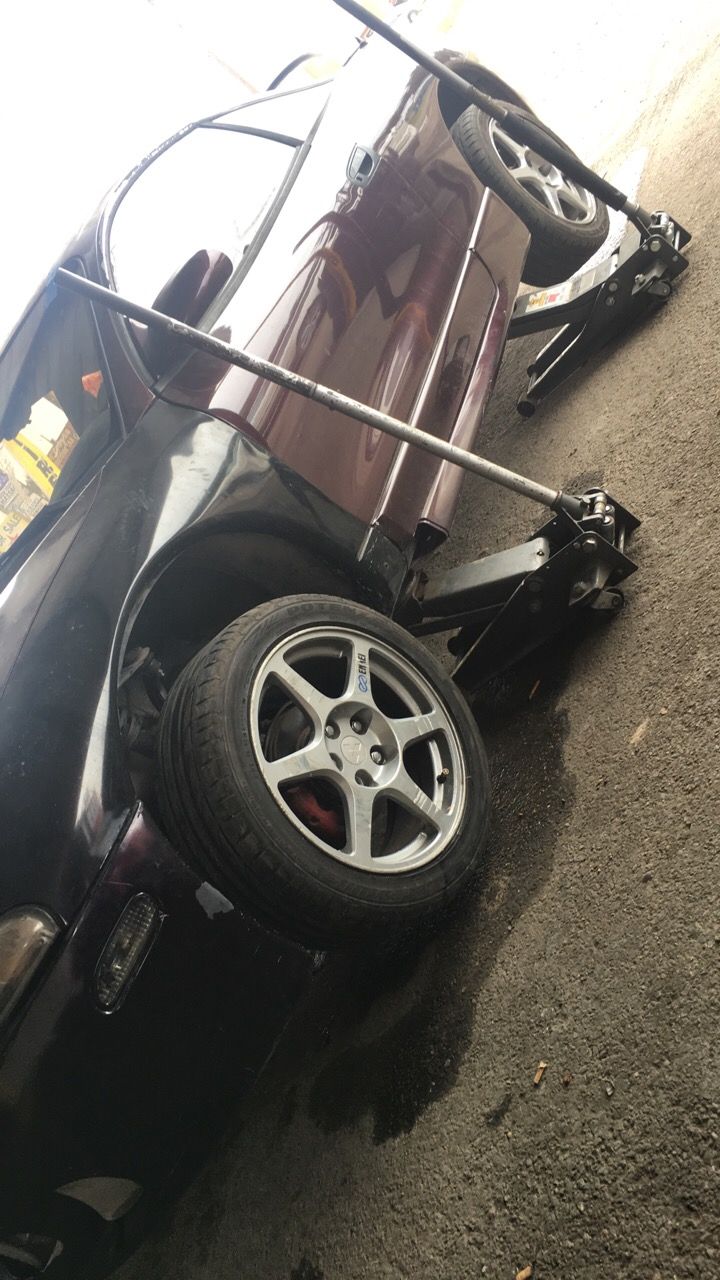

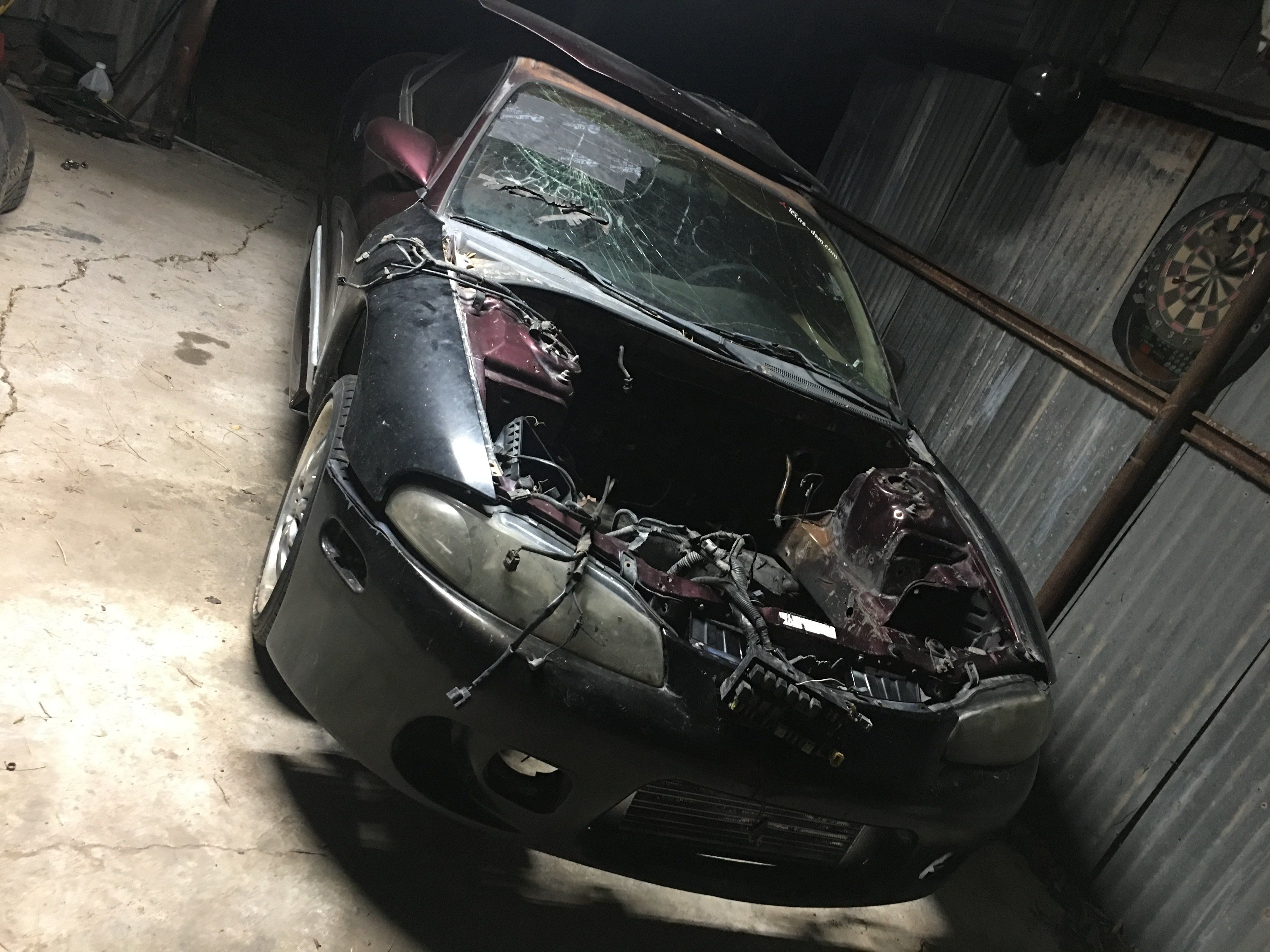

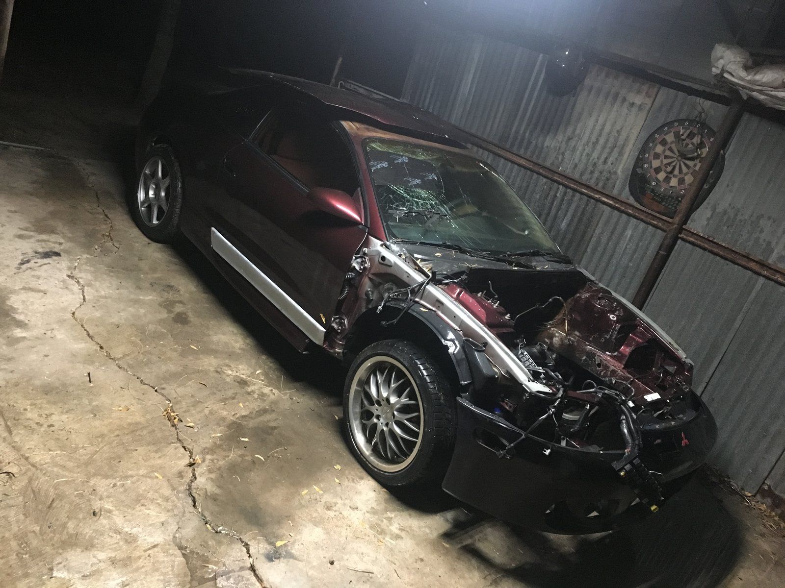

A friend of mine crashed his car near buda tx some old lady cut him off. Well thats what i heard. It was a nice clean gsx. And well he sold me his evo wheels for a good price that I couldn’t pass. $150 with 90% tread Bridgestone Potenza S-04 Poletires

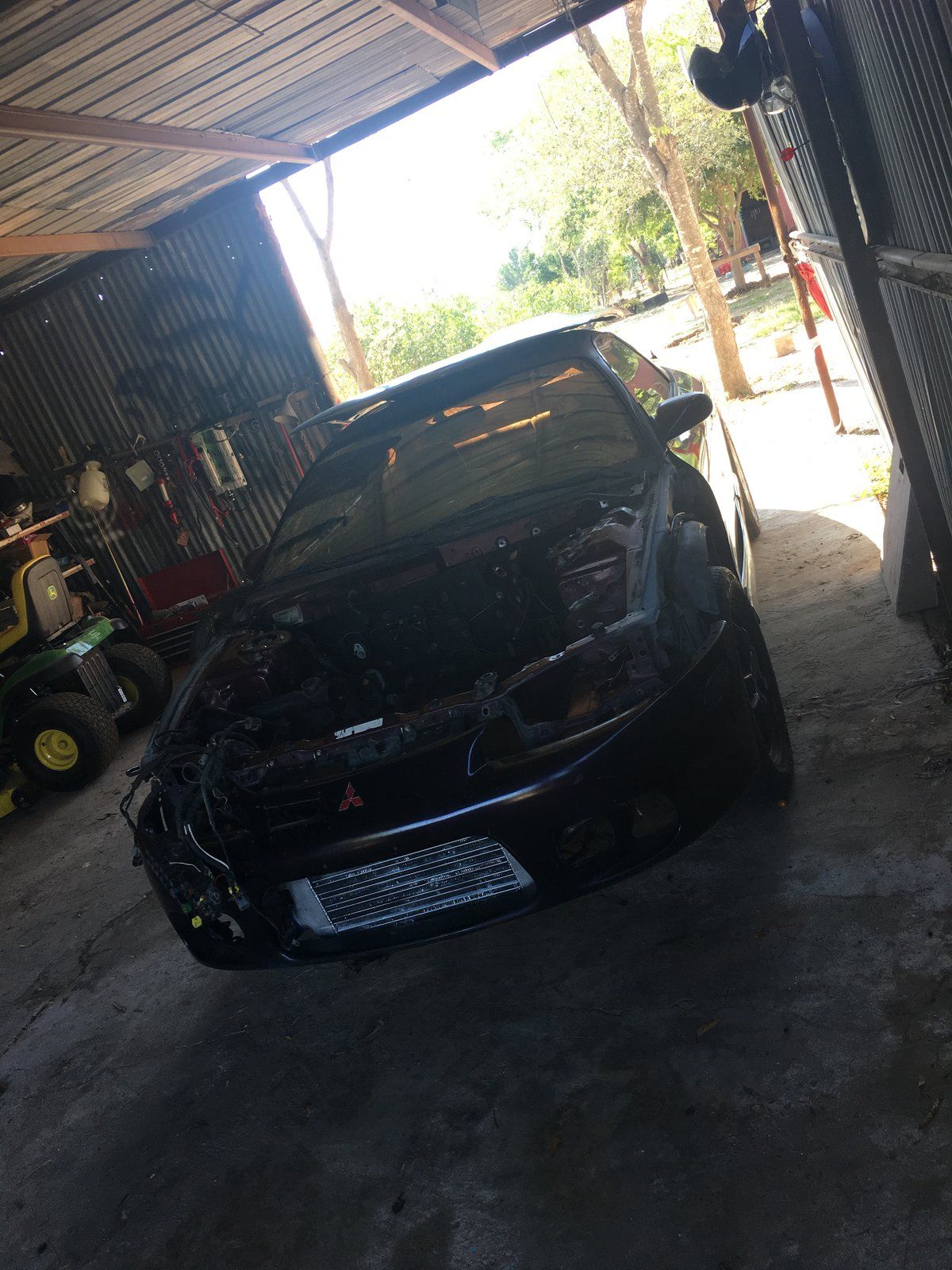

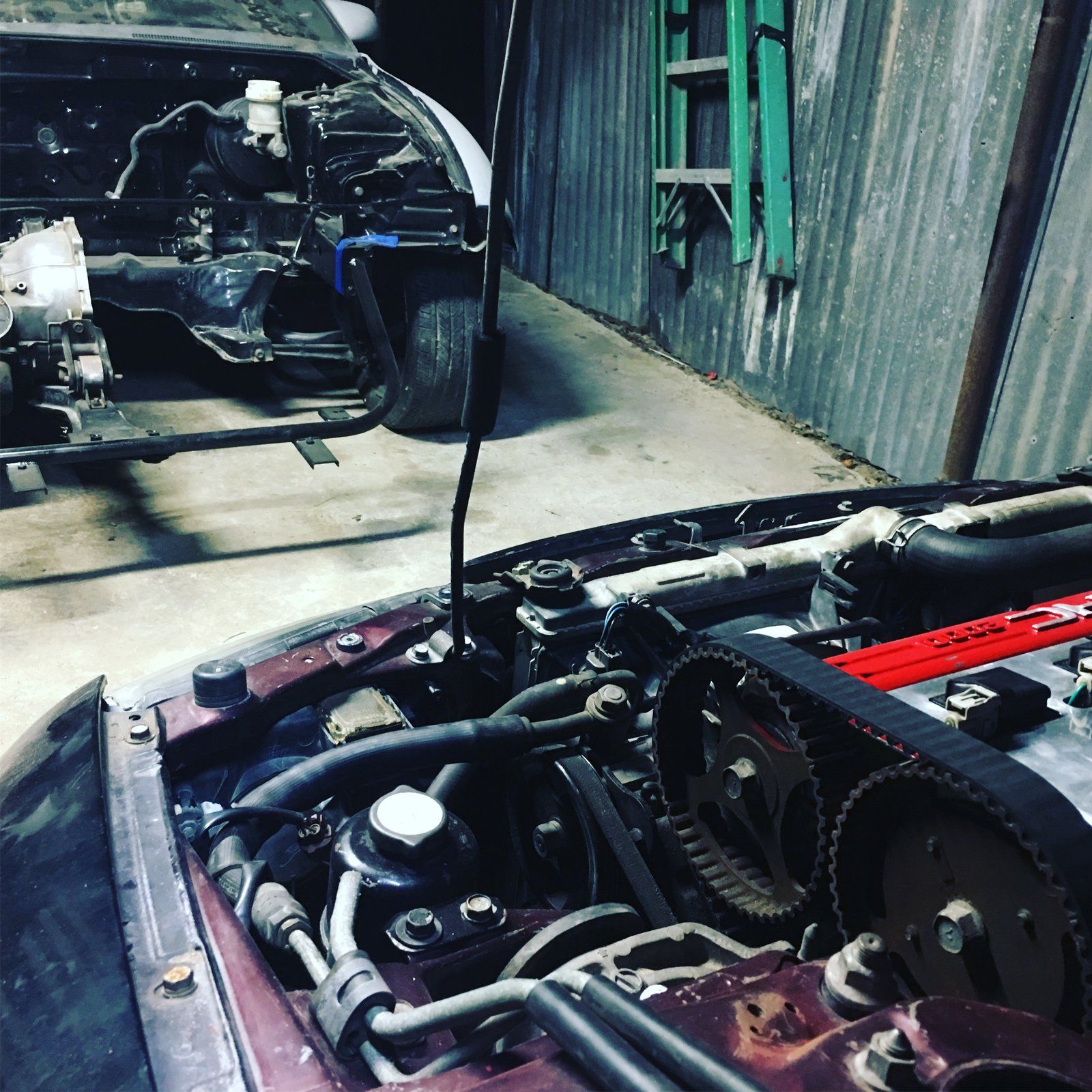

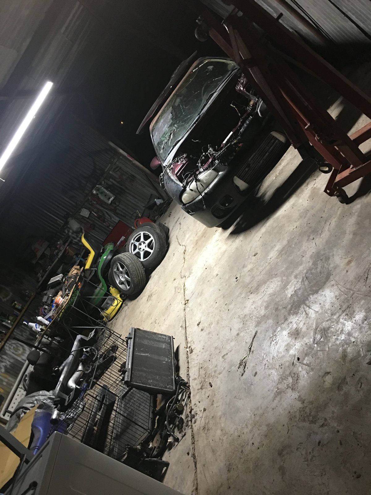

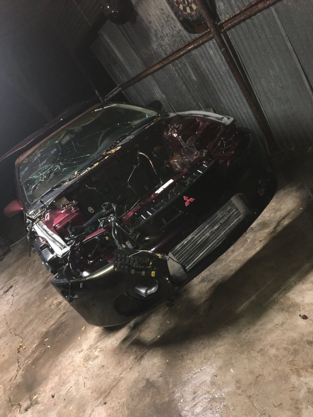

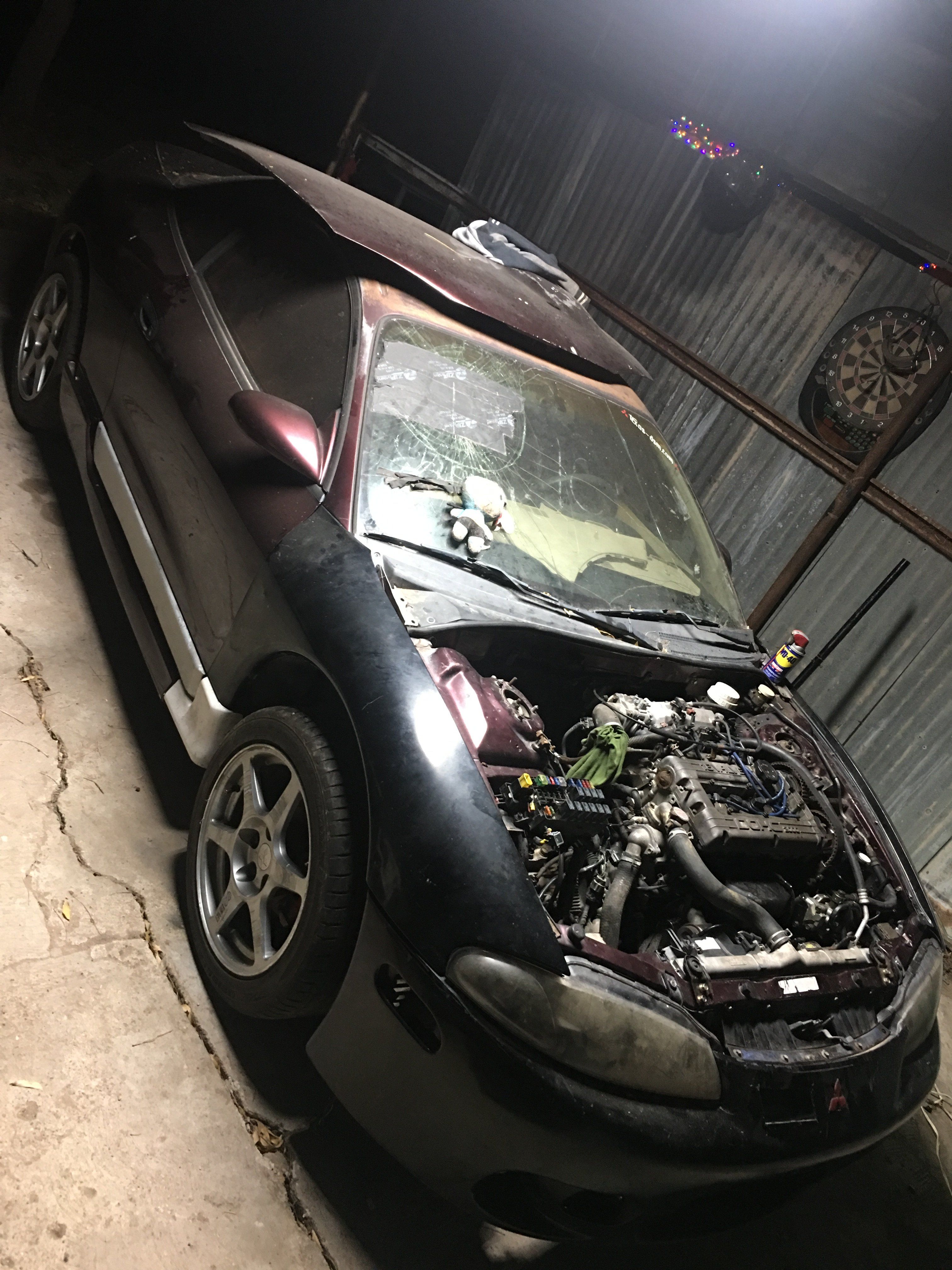

This is how it sits while im putting it back together. Piece by piece LOL its getting there
As you can see i got a hold of a radiator, some fenders, a decent pair of headlights, a fuel pump, power steering lines, shifter cables with shifter base, some pedals, brake master cylinder with booster, clutch reservoir with masters, some side skirts pieces. A pair of axles.

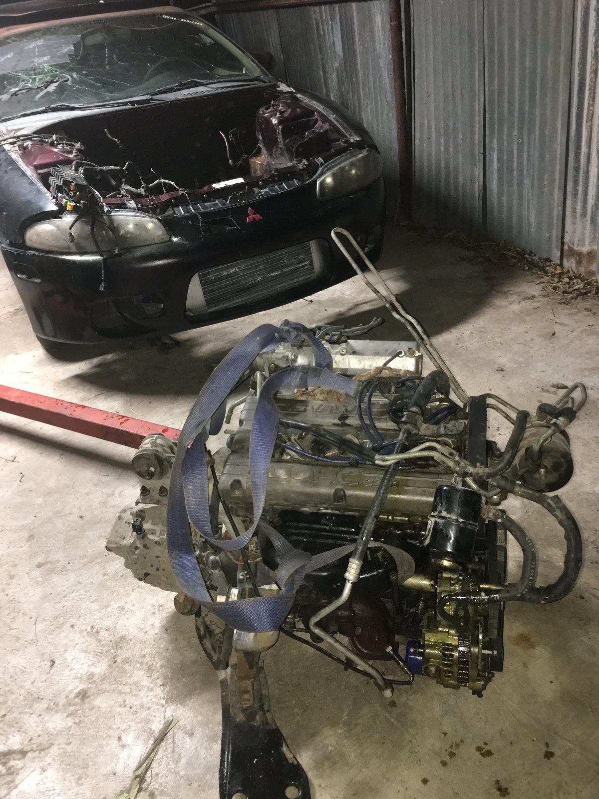

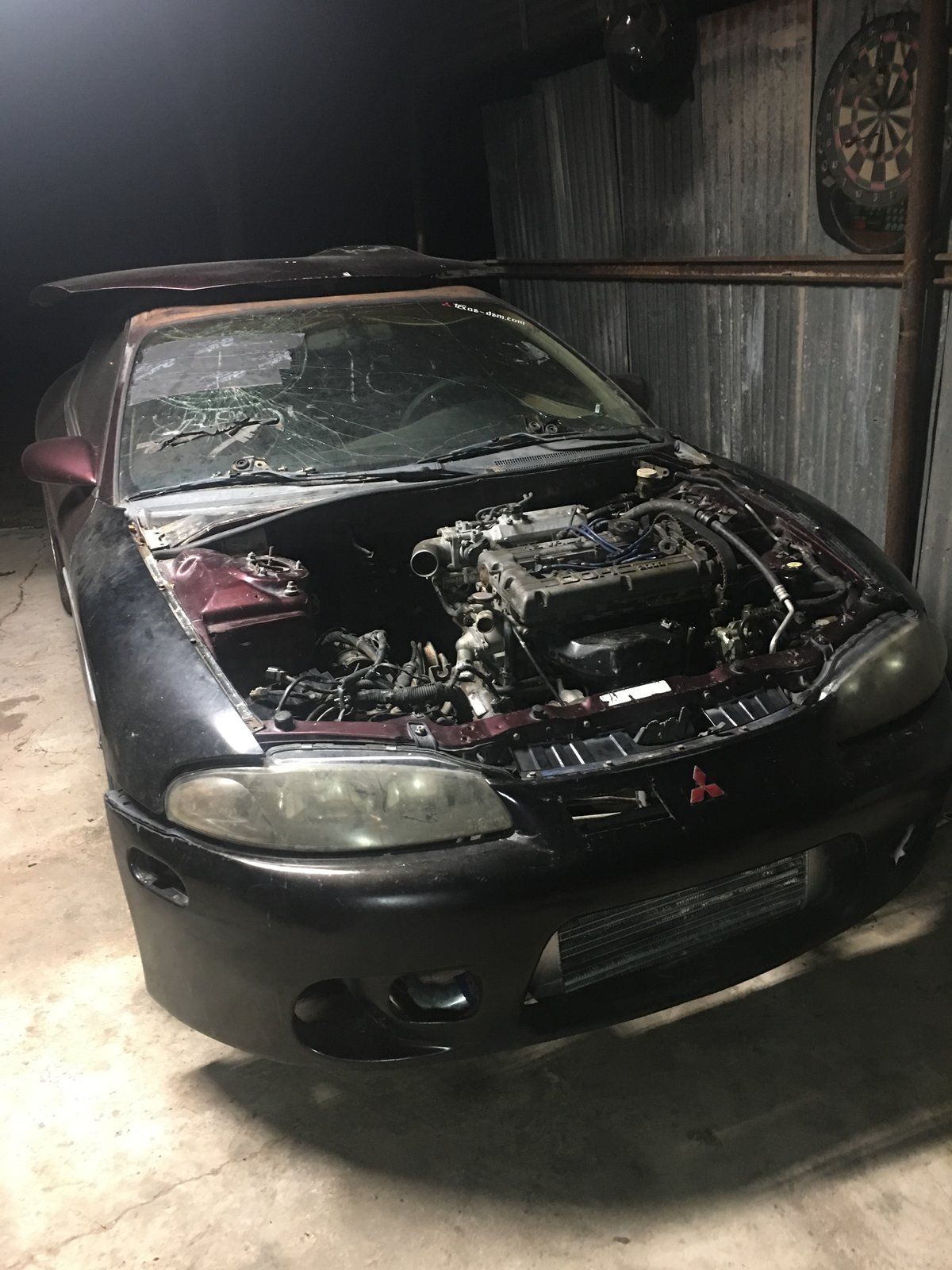

Guess what i bought!!!

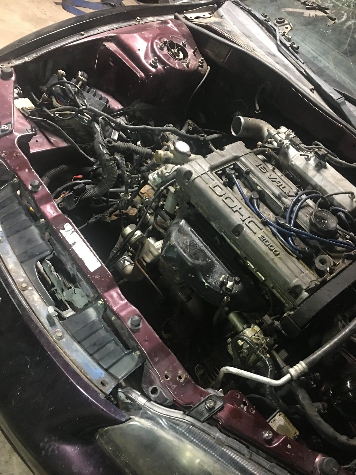

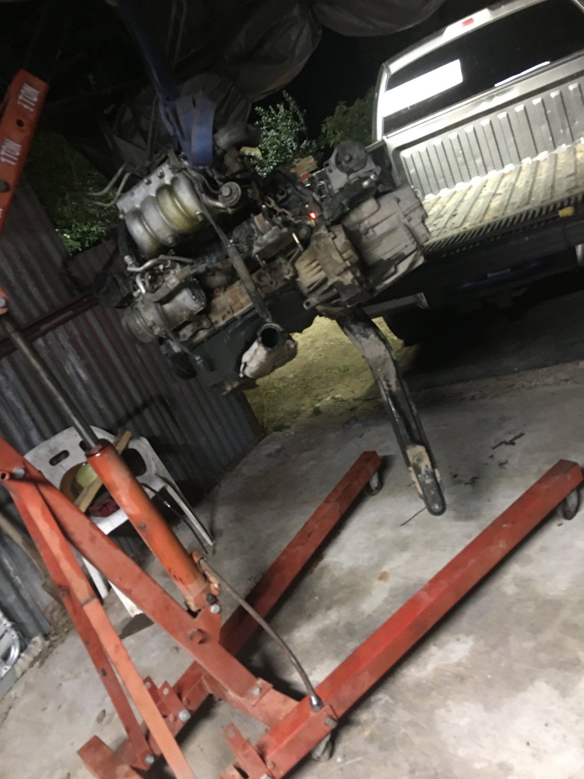

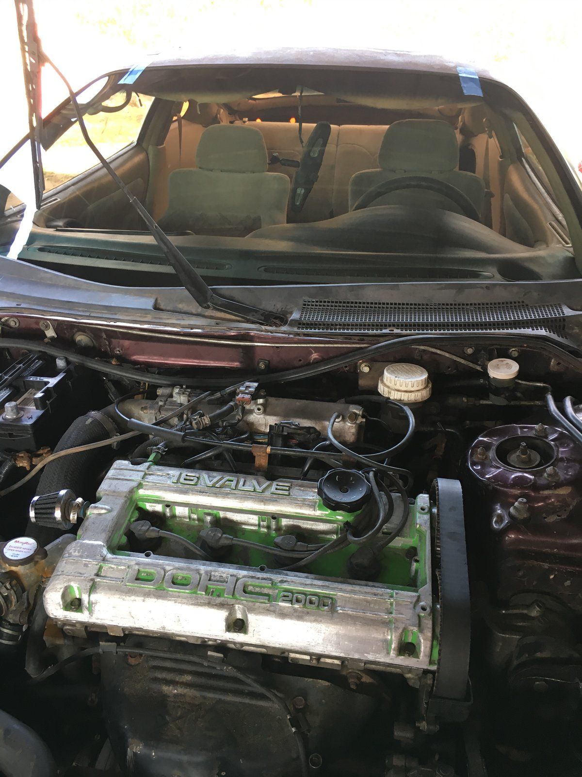

Thats right a 7 bolt complete engine. It was running good then a sound was coming from the tranny so i pulled it apart to see what it was and then to install it and send it.
I dont know if i can upload a video here but wow!! Just wow. The noice coming from the tranny was the flywheel bolts!!! My friend i bought it from said it was the throw out bearing because when he pressed the clutch it went away. But damn all the bolts were loose. I didn’t get to take a pic as i was surprised at what i saw. But oh well this engine was sitting on a car for 9 years without turning it on so id figured.

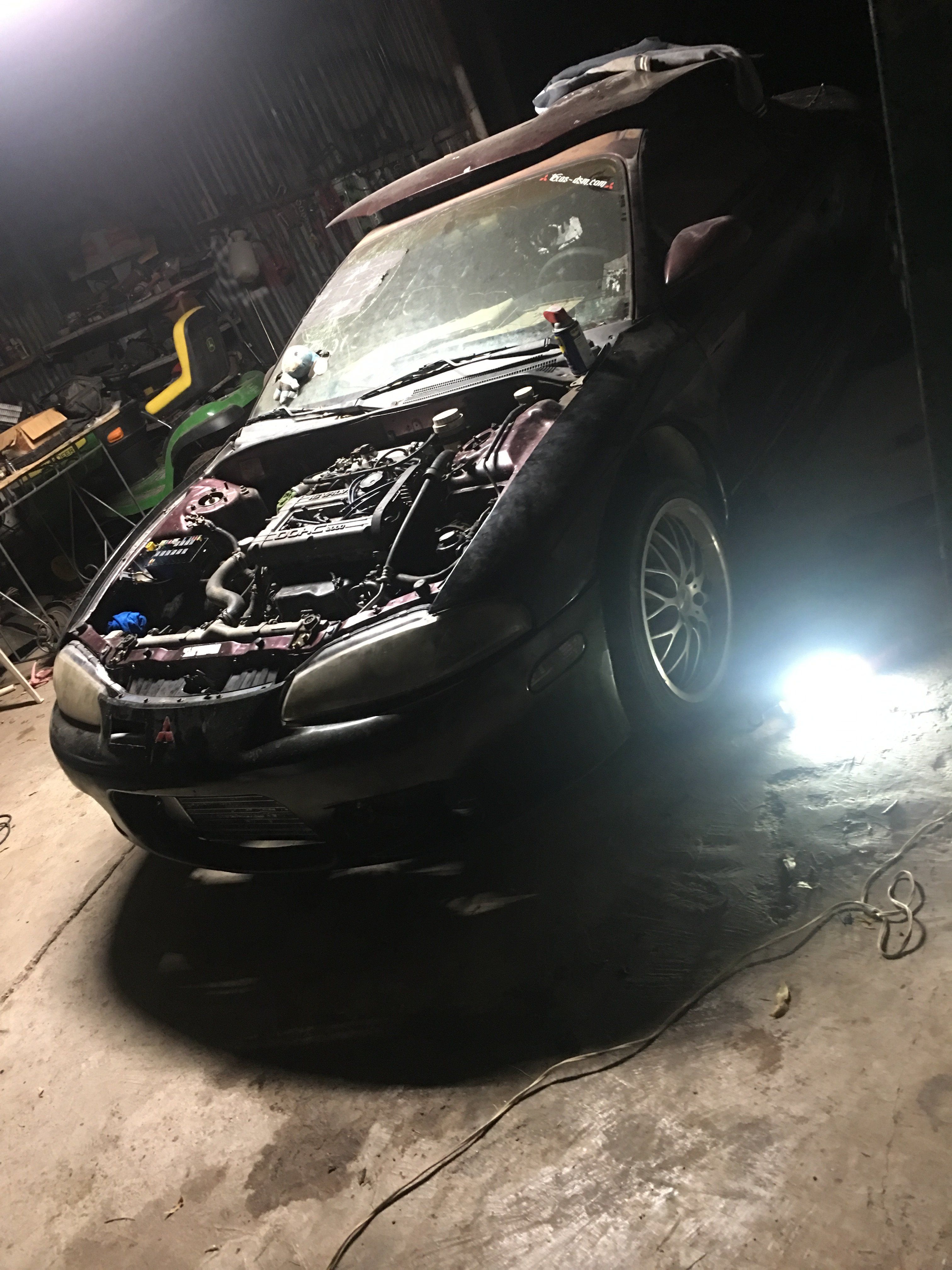

And oh well in it went and to call it a night.
Axles and suspention bushings all nice and tight. And installed a new engine harness because the one that came with this gst was wired for the 1g cas. So i saved it for the other project. Radiator with fans installed and all the innercooler pipes and upper installed aswell.

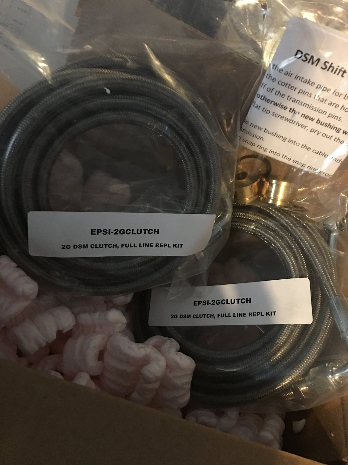

And look what i got in the mail today yess!!!

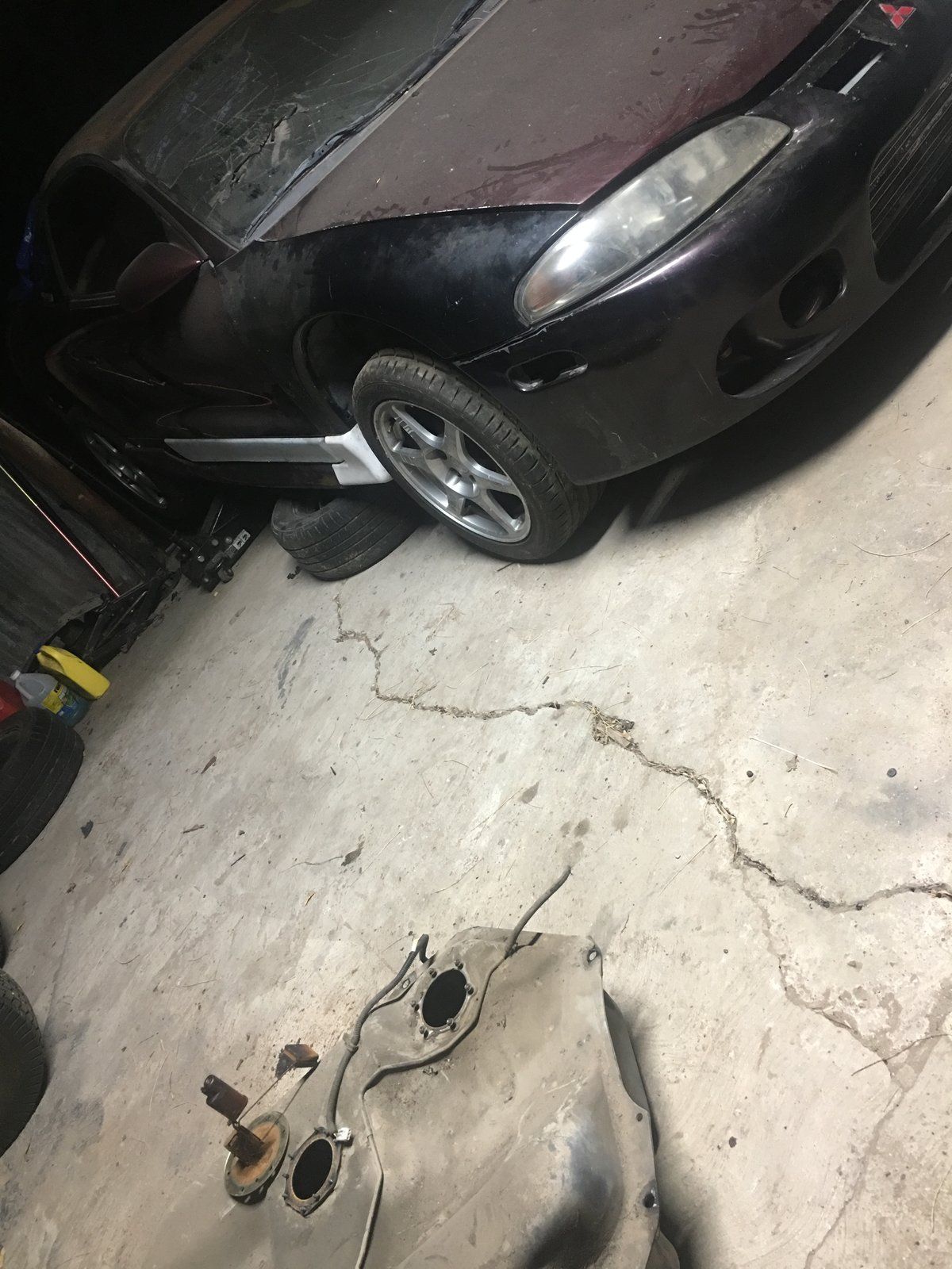

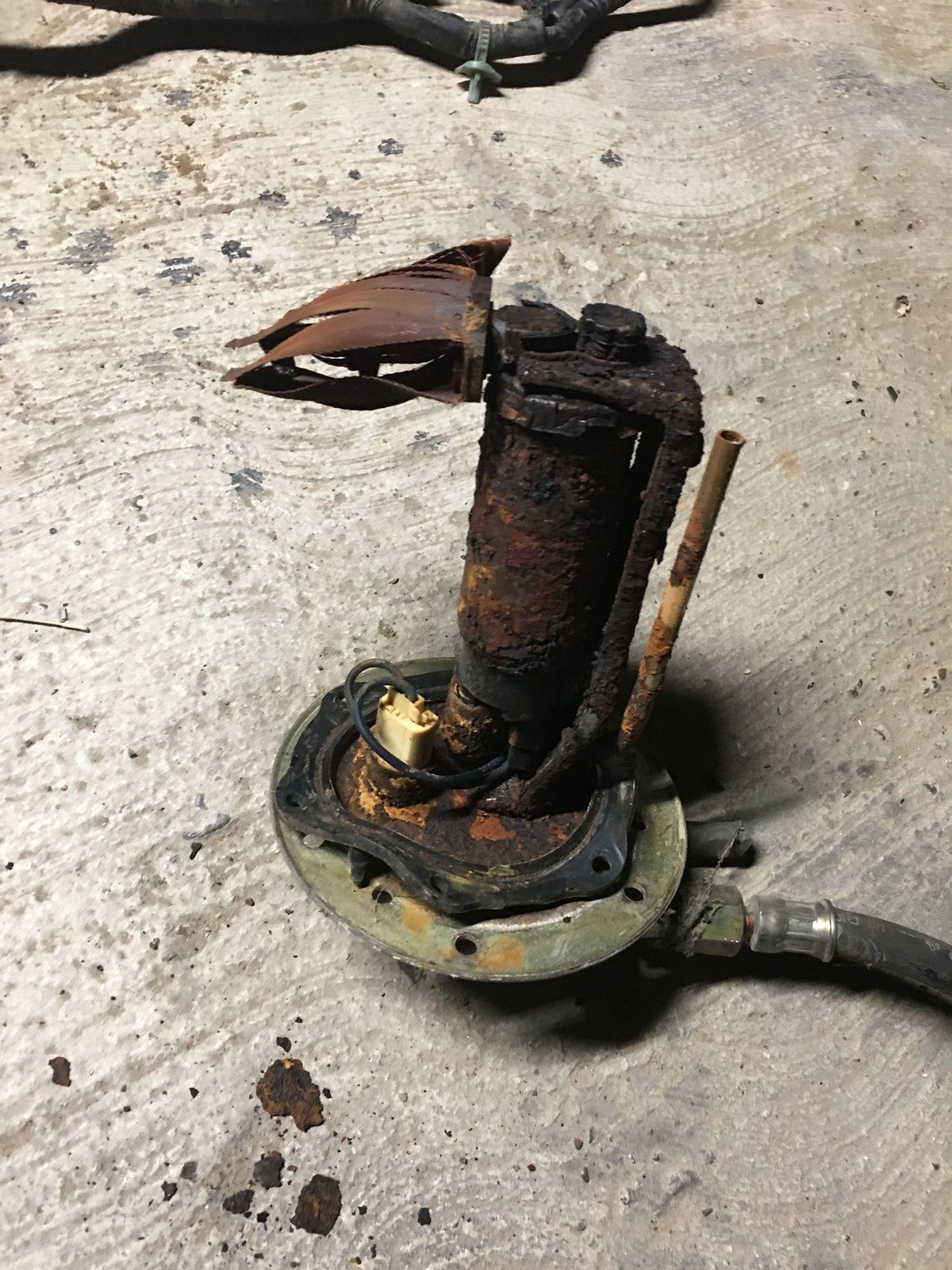

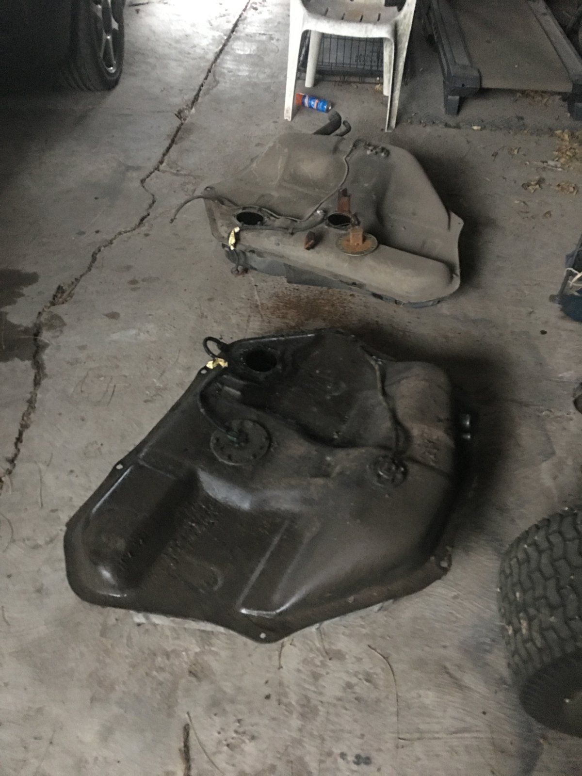

So fuel tank came off and wow just wow the whole tank is rusted and gas looks like jello. So nope this is trash. Good think theres a dsmer near by with a bunch of dsm cars for parts.
I got a tank the next day he even took it out for me and the fuel lines also. When i got there it was already aside waiting for me he is awesome. So i brought it home and waiting for tonight to put it in. (the dark one is the new one).

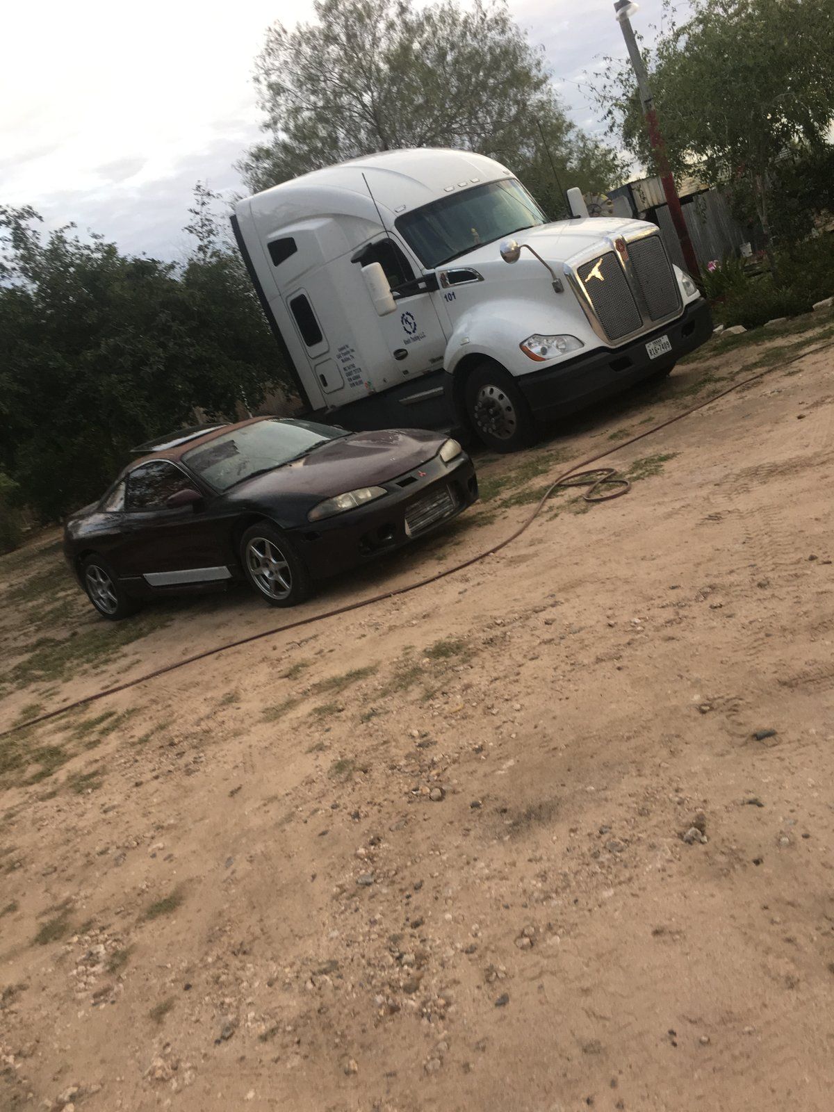

Then i got it to run right so i went to clean the wheels cause tires had a bunch of dirt inside from the accident. Balanced and cleaned.

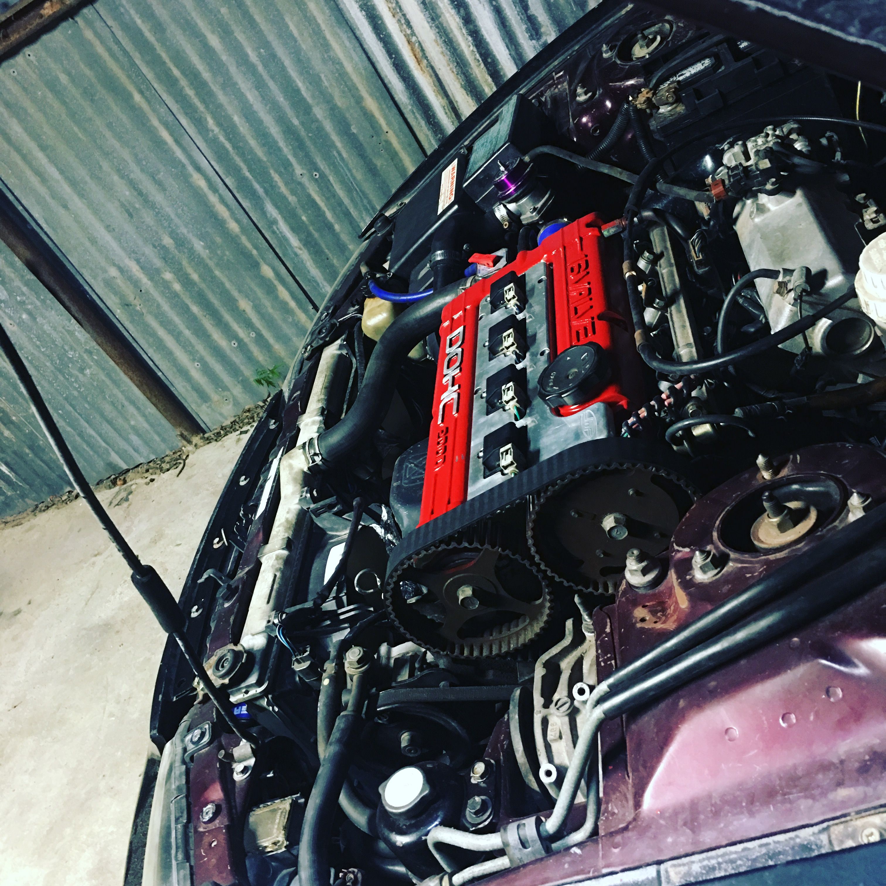

And how it currently sits. But it keeps wanting to overheat on me. Temperature rises while on the freeway. Not when im in city though. Weird. But ill keep checking it.

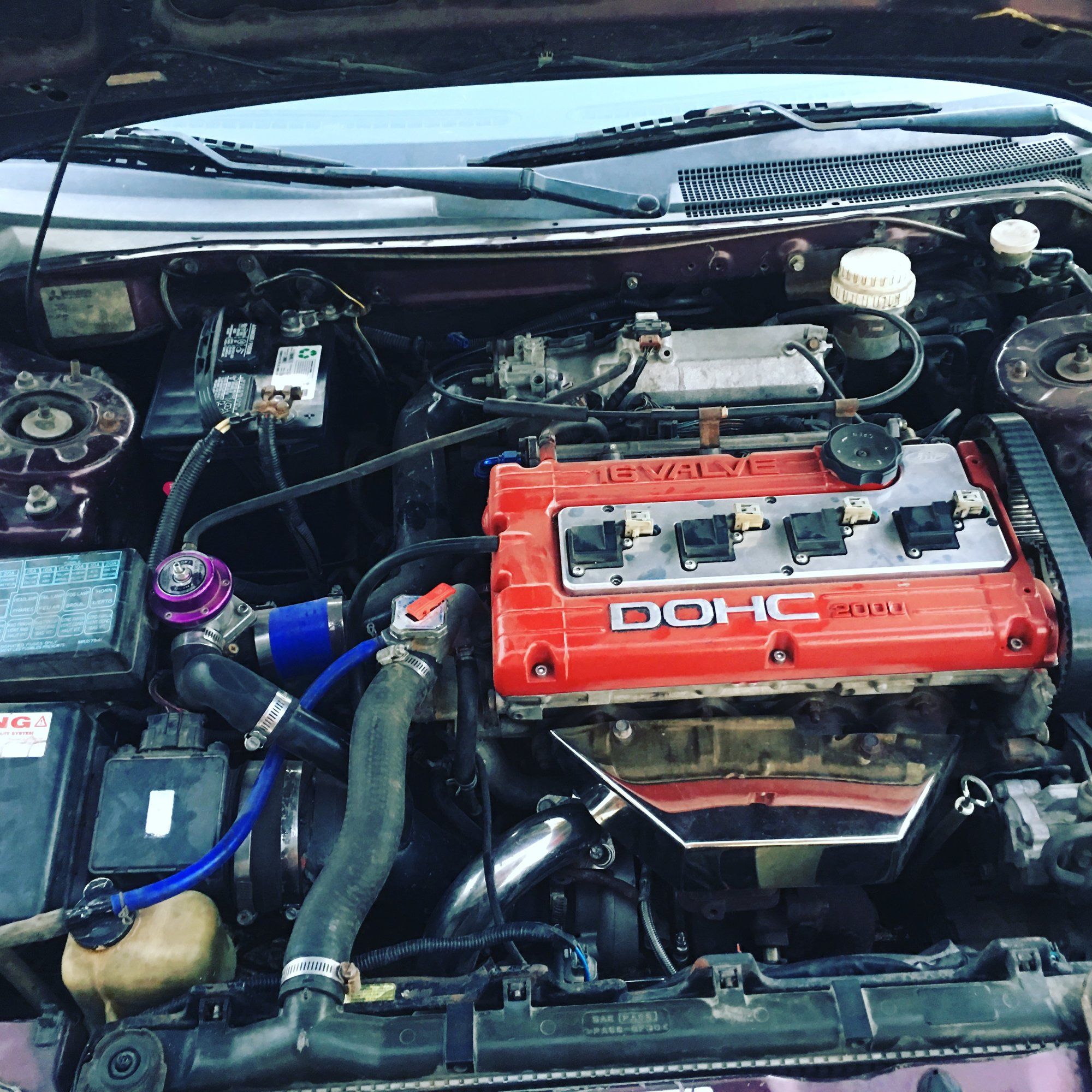

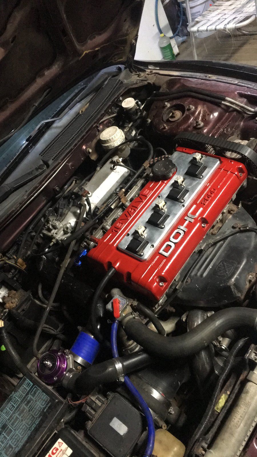

I painted my valve cover just so it wont look to messy and added a jmf cop plate. Just so it looks clean.

All late LOL and no I haven’t but it may be the water pump idk and running a gay ebay 16g i found laying around the shop
That stock brown radiator looks pretty suspect
I just noticed you are running a stock air box with an aftermarket intake with a stock 2g mass air flow sensor.
Would you be willing to sell that intake?
Nomore temp issues thanks @chrystler kid
It was the radiator i did a swap with the spyder i got for parts and nomore issues at all especially in these texas 100 plus heat. And bought a heat shield for 40 bucks shipped and sold my stock one for 35 shipped so i guess i got a good deal.
