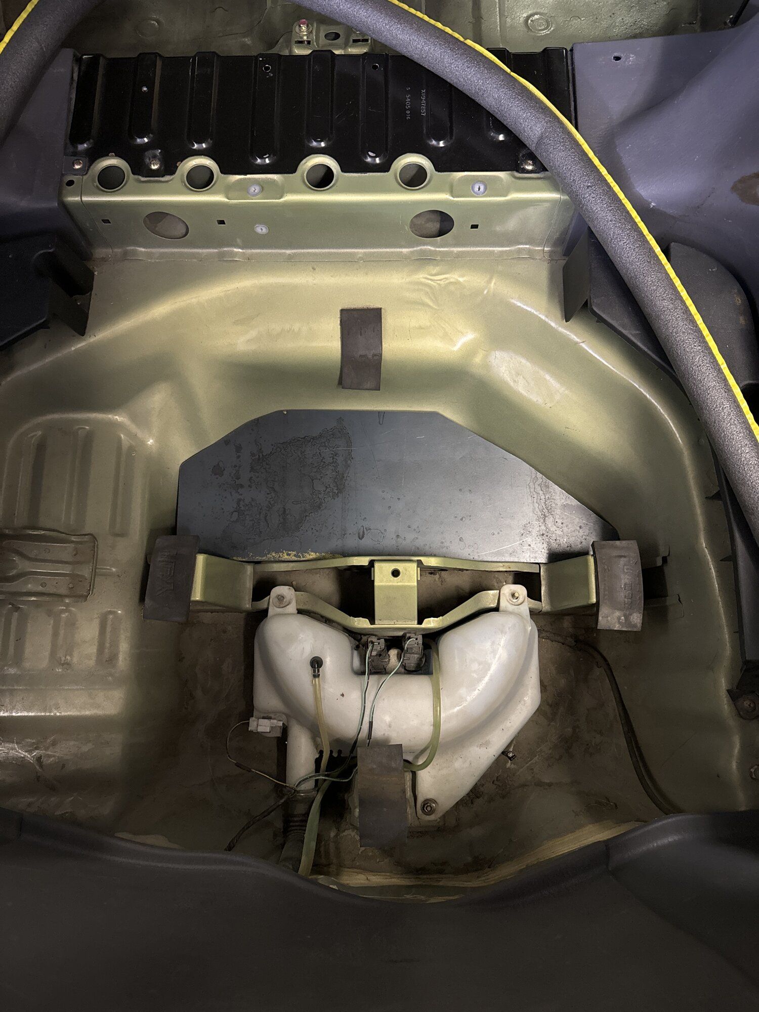

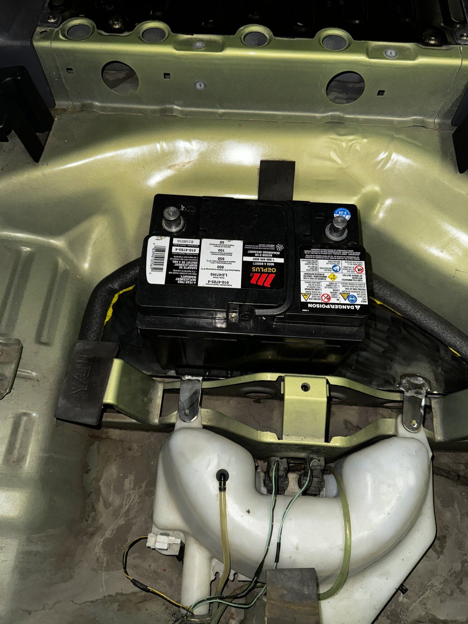

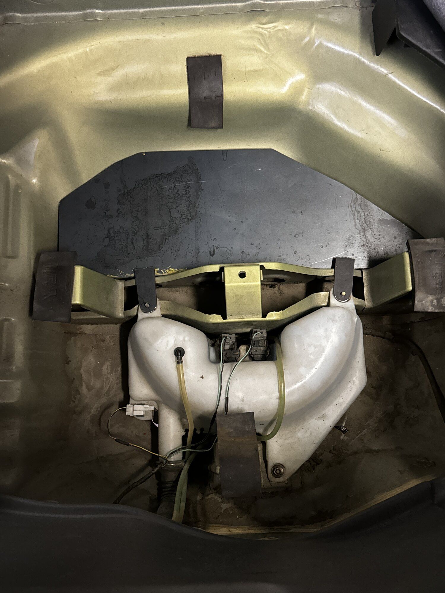

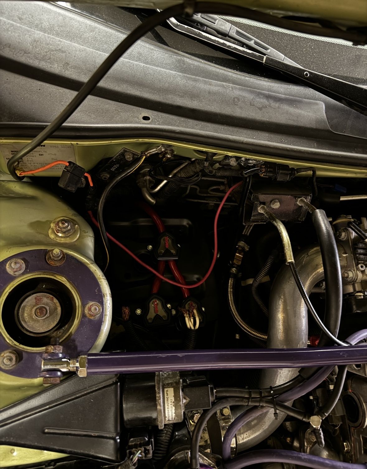

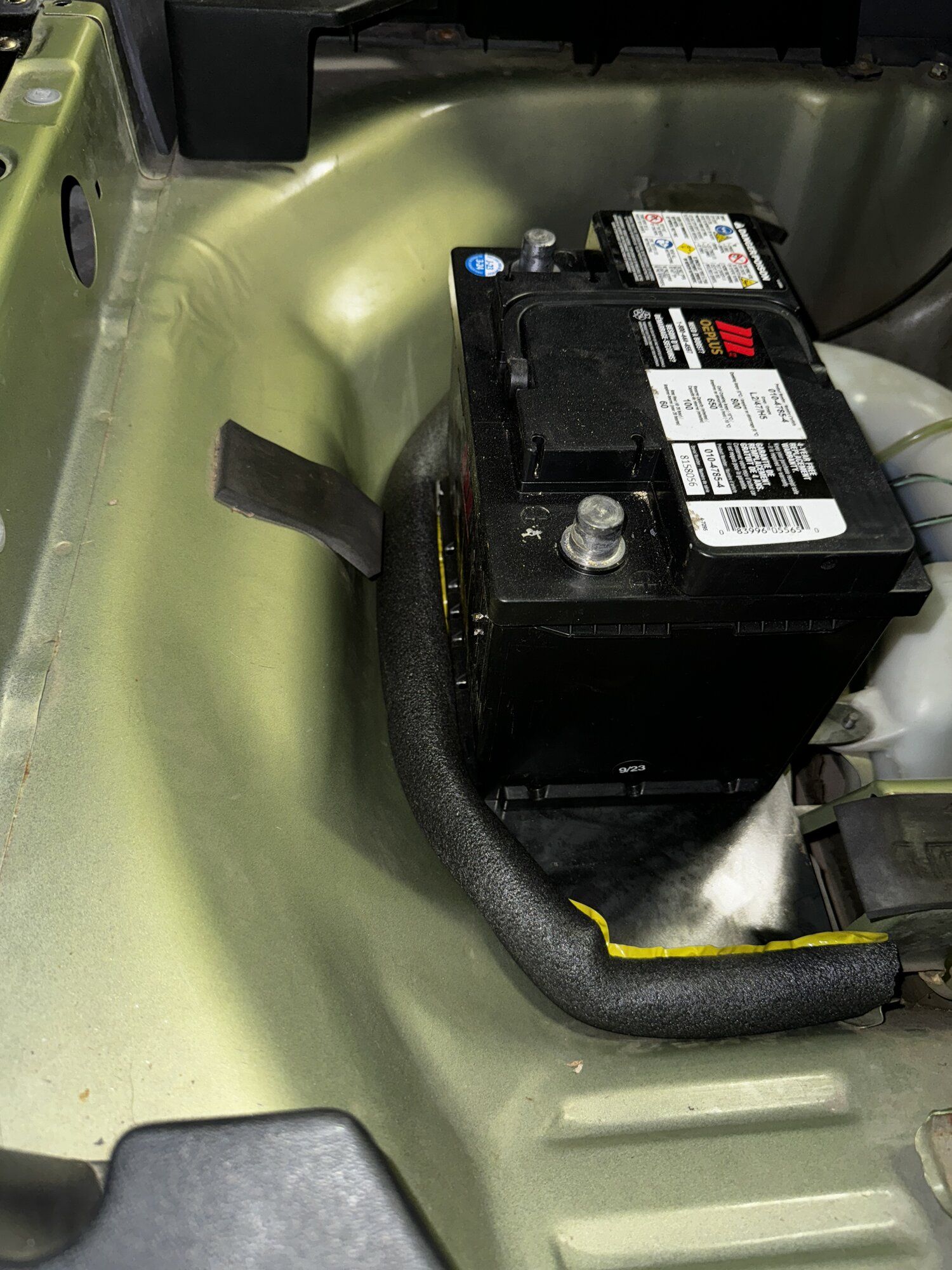

Fabricating a panel for a battery move to the trunk.
The battery will sit under the new false floor on top of this tray with 2 J-style battery hold downs.
I was hoping for 14 gauge metal but I ended up using 11 gauge as it was most available. Overall weight is 5lbs and it is very rigid.
No extra holes will have to be drilled and the spare tire well will be kept stock.

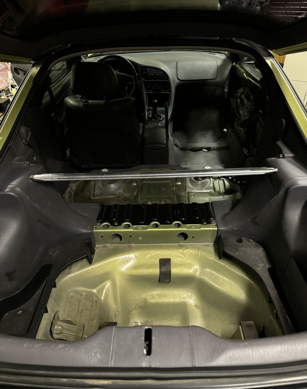

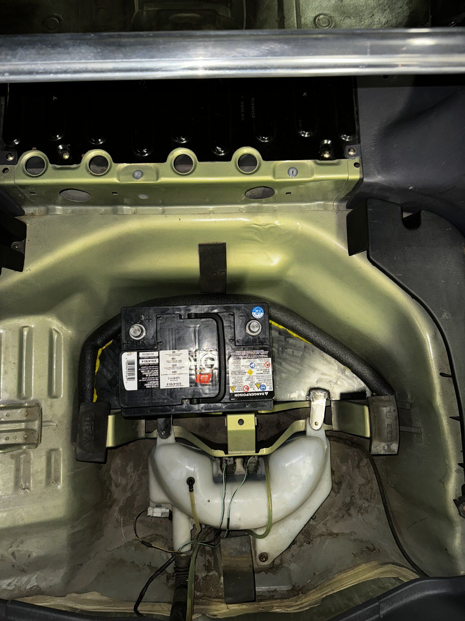

Gonna weld these two tabs to support some of the weight... The posts for the wiper fluid reservoir are only for alignment.

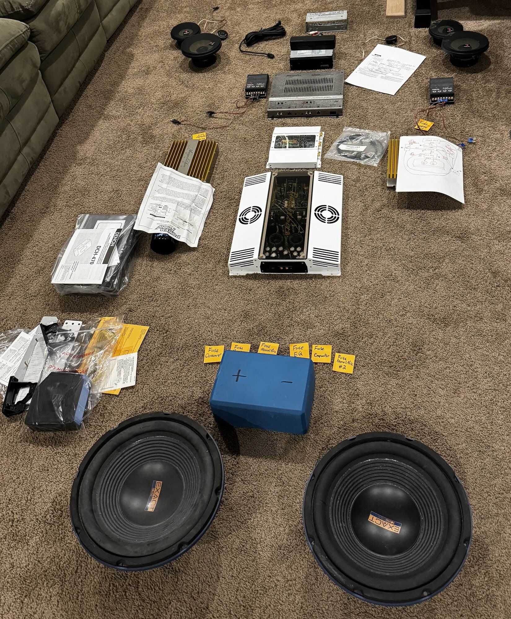

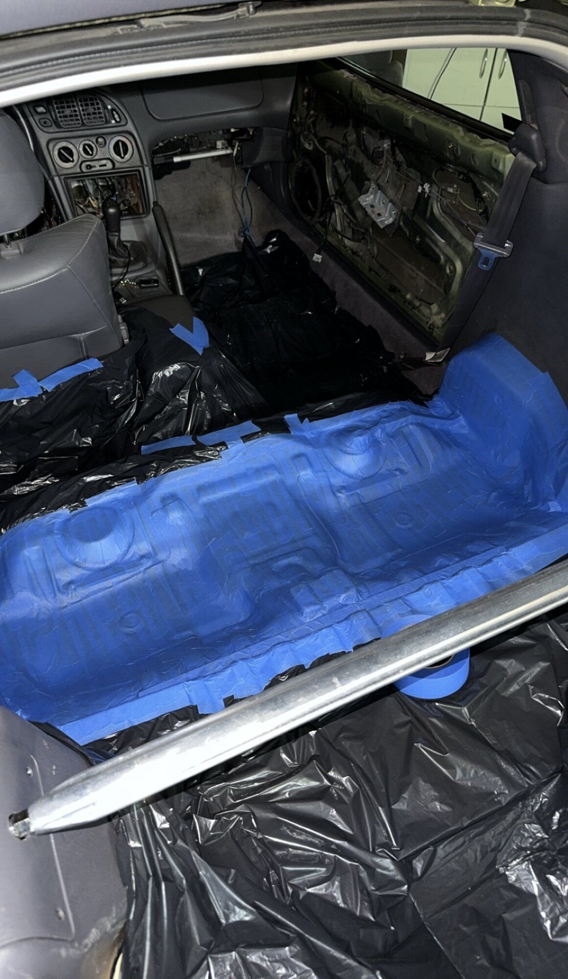

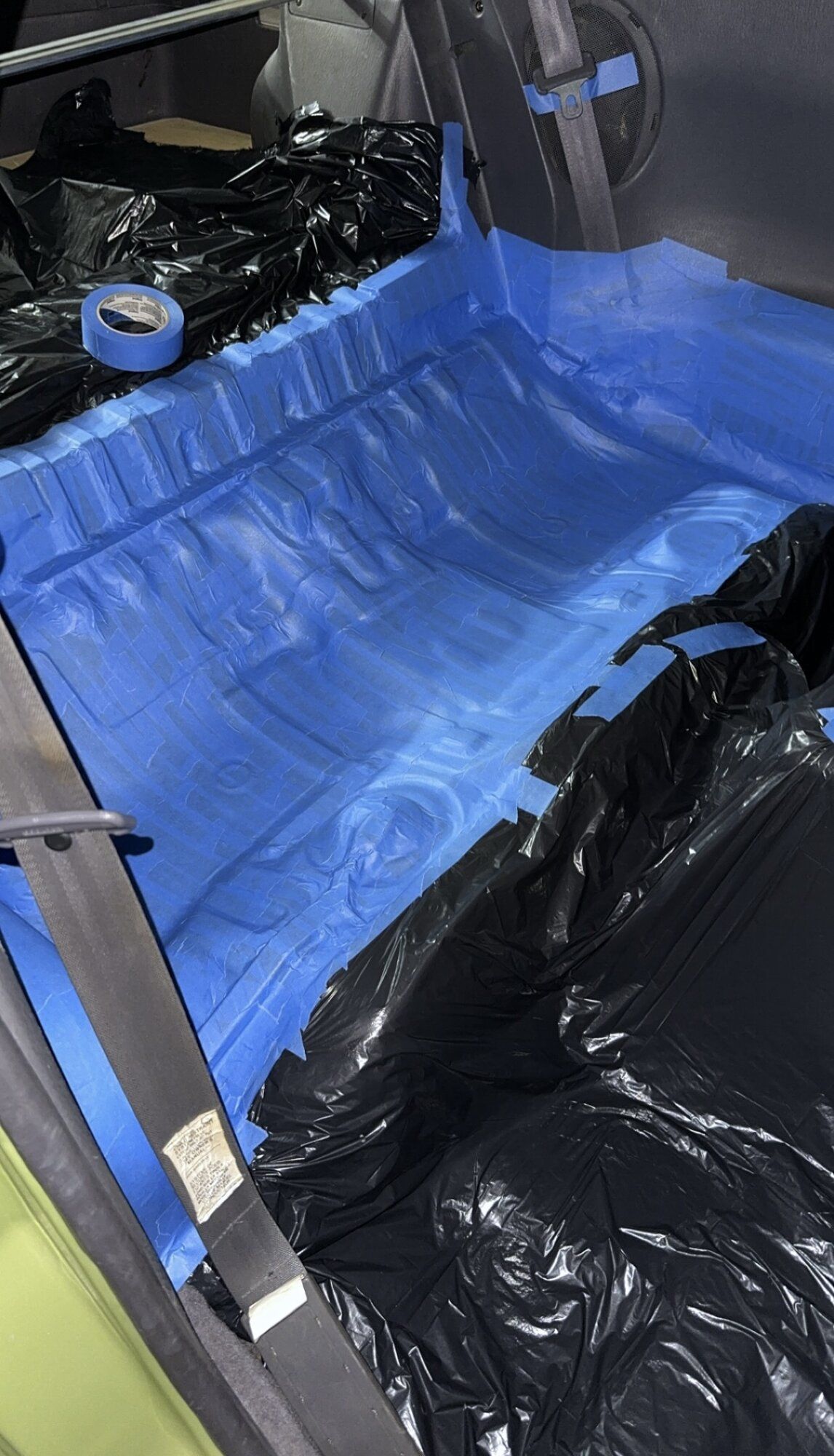

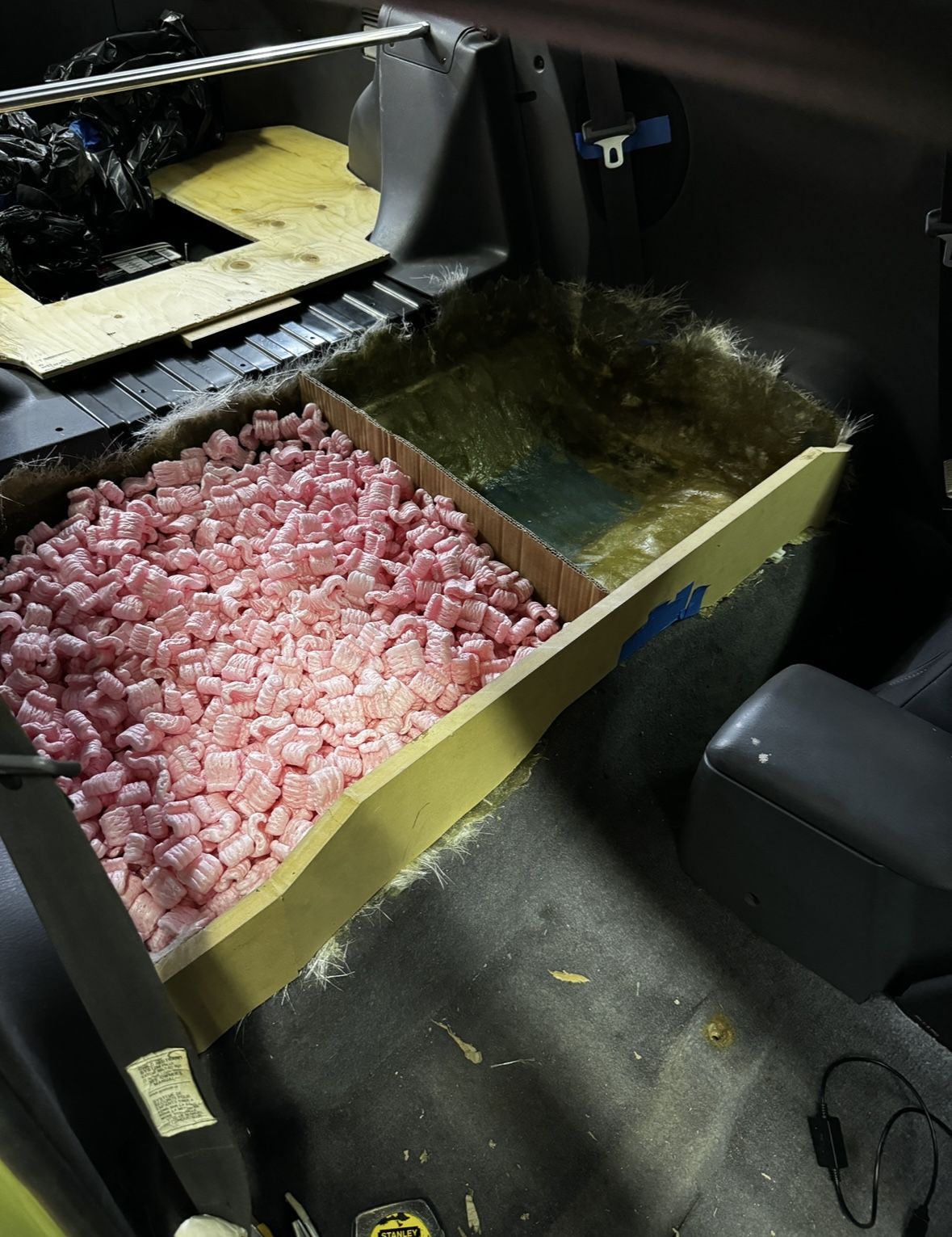

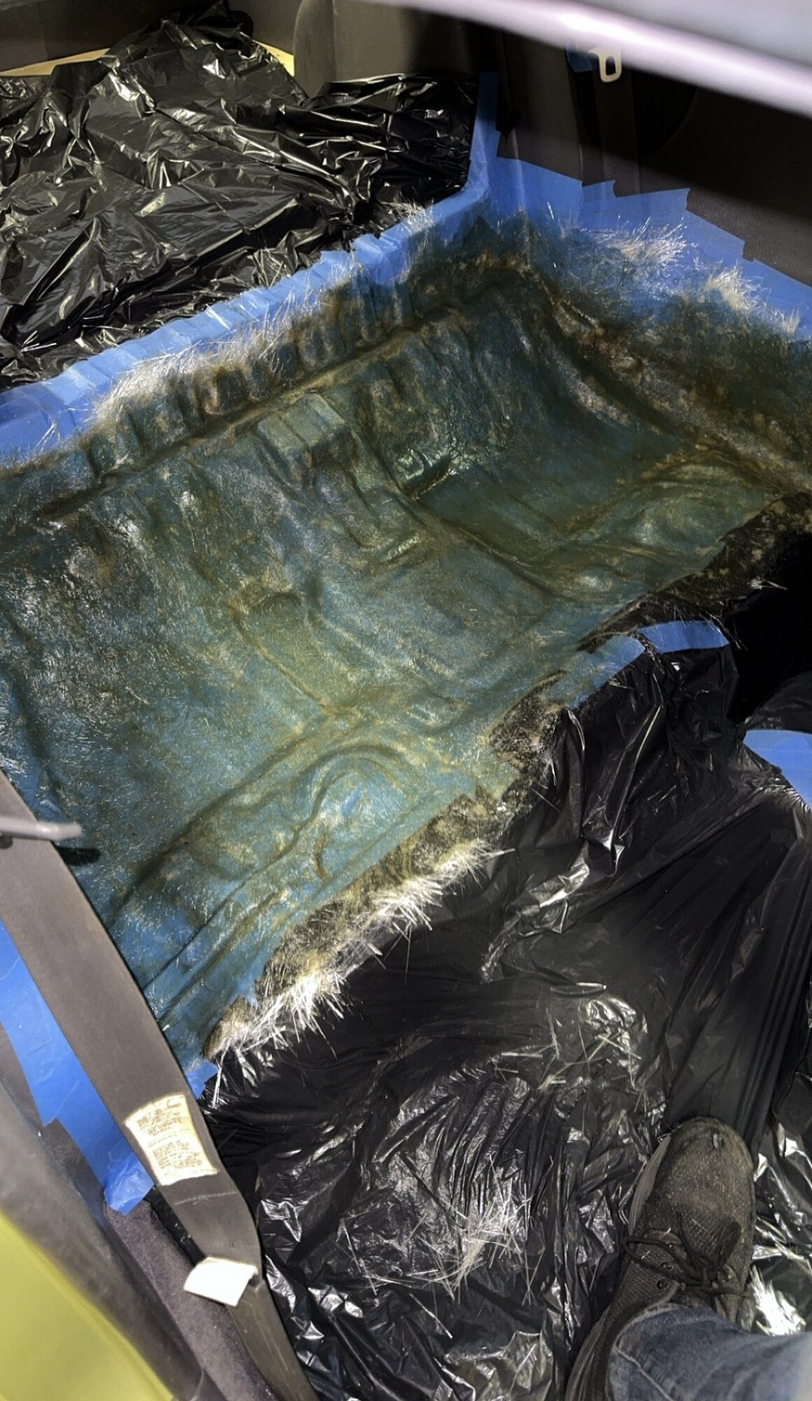

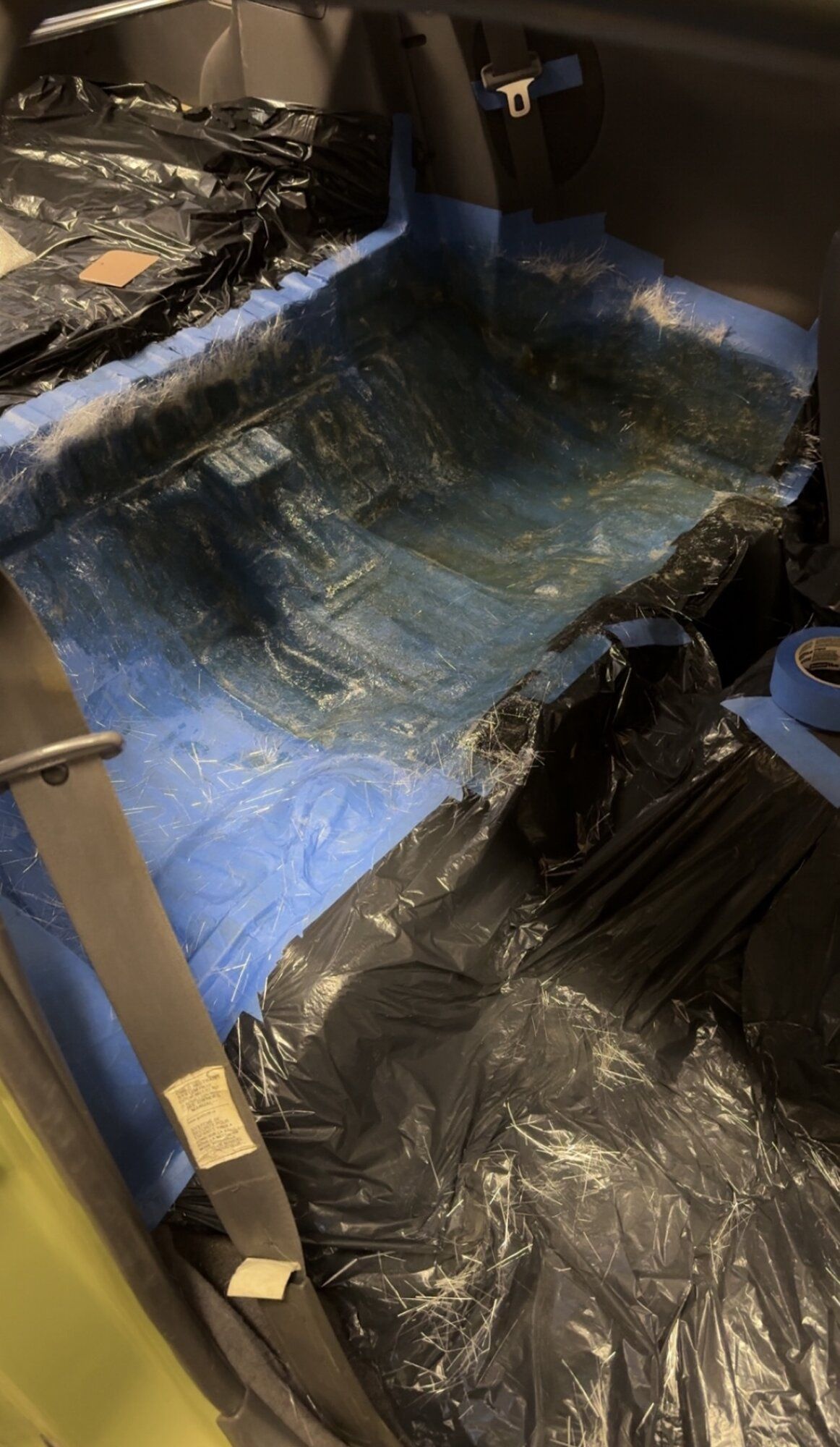

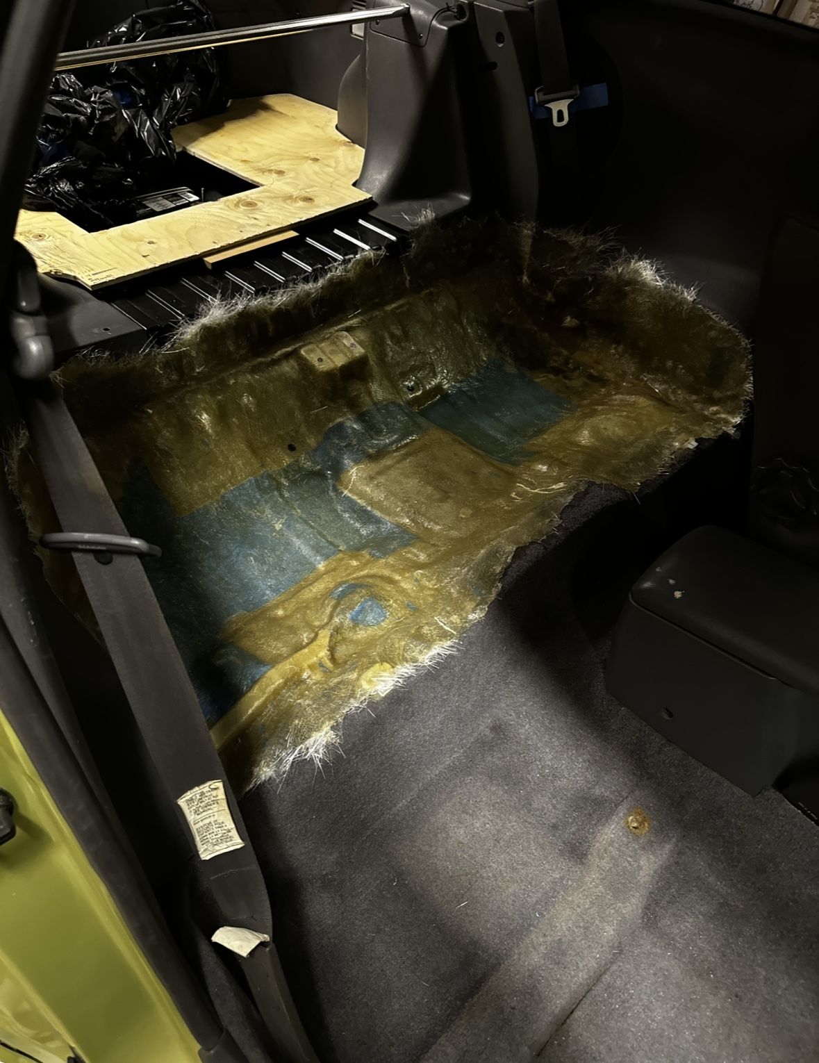

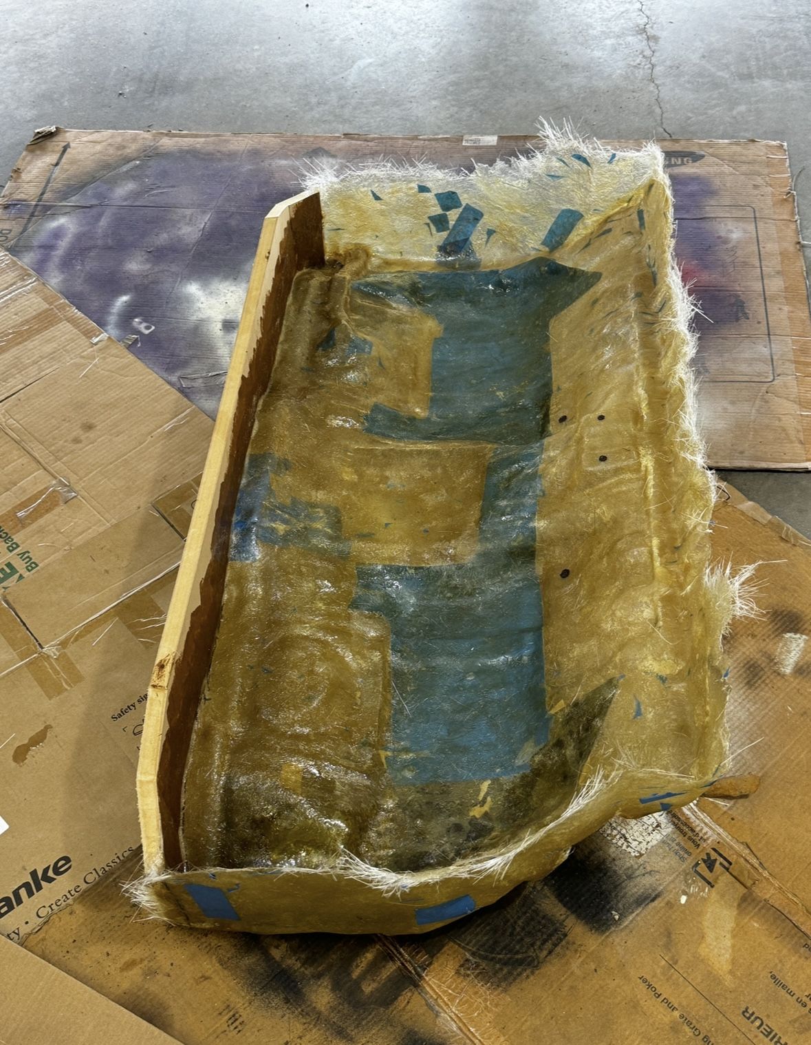

Also the beginnings of the sound system, back seat delete subwoofer box.
Almost 10 gallons per side.
Each 12" sub requires 9.725 gallons. The subs are going to be reverse mounted because it's a little bit over that amount, so perfect amount of airspace.
Pretty small profile for something so large in volume ;)
