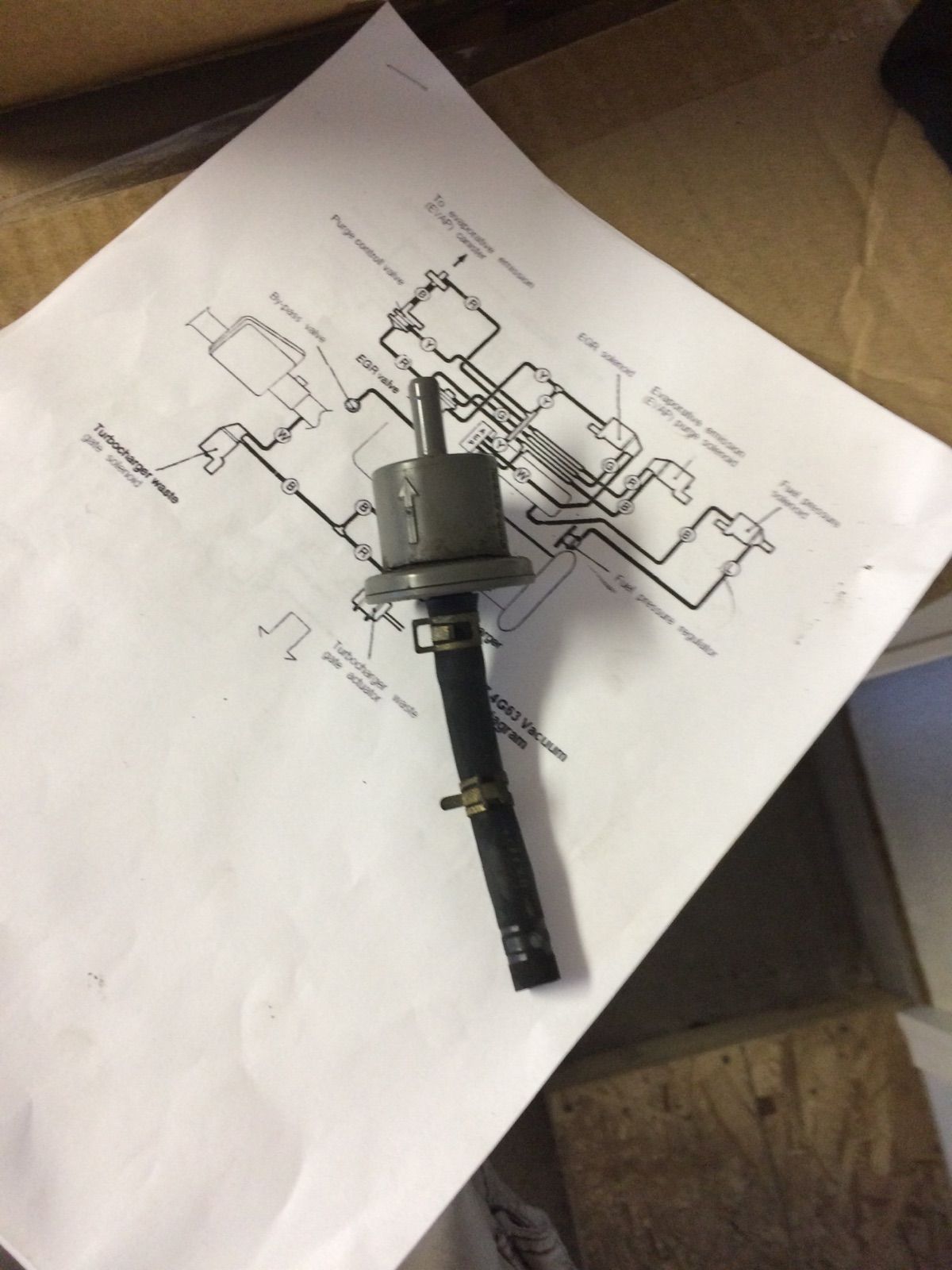

I have to raise this old thread, I took my charcoal canister off, and found this plastic valve on my fuel tank vent line, however mine is old, dryed and cracked. Has anyone replaced this with a parts store check valve? Or is it something special? I have a picture of it, if that helps.
I am going to try and finish my custom fuel line this weekend, but would really like to get a new "check valve" or "pressure valve"-I don't know what this valve is? I don't live to close to any dealerships to order this stock "whatever valve". Anyone have experience with the gas tank vent "valve"?
Here is the valve, anyone know if I can replace this with a generic one way check valve, something like how a pcv valve flows? This is what I have read while searching information on this valve, just trying to make sure its not something else. It is cracked and I would like to get a properly functioning replacement, maybe I will run it to Shucks and see if they get anything with the OEM part number.

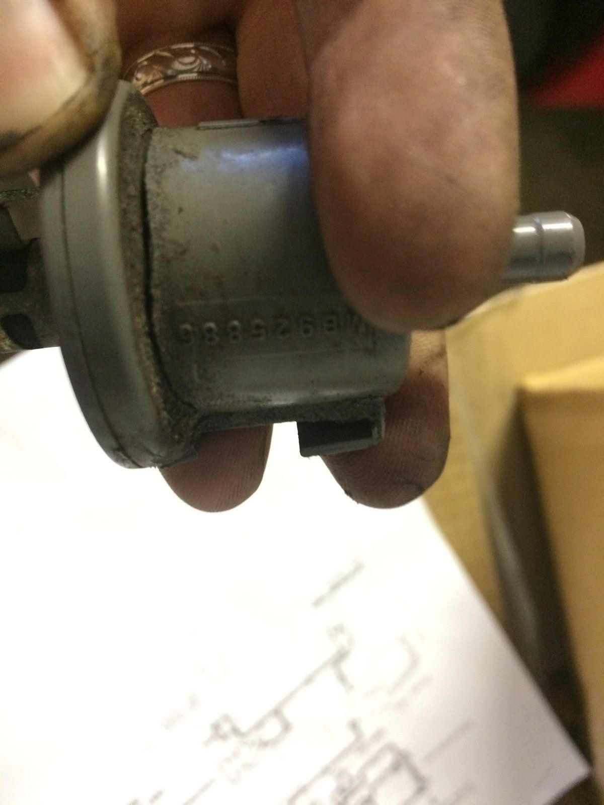

371 KB
Hope that works.
Part number is right on the side of the valve can read it in the picture above.
MB925886
http://www.mitsubishidirectparts.com/oe-mitsubishi/mb925886
Yeah, I can order it, however I was wondering if I can use a generic check valve. Over the counter from any auto parts store? If not, I will go threw that website, that's not a bad price. Would like to use a generic if that's all the valve is though ( a simple one way valve?). Thanks!
After a bit more reading, it appears as though it is set to vent at a certain PSI. I better stick to oem... thanks
