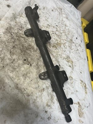

The engine is from a 95 I’m finishing up a swap.this is the other side of the fuel rail,my dad said there should be a shrader valve here(idk if this is or not)
Yeah, that’s the stock 95 fuel pressure regulator. Since you’re putting a 95 engine in a 99 body I would just get a 96-99 non-turbo fuel rail. That will have the inlet at one end and the shader valve at the other.
