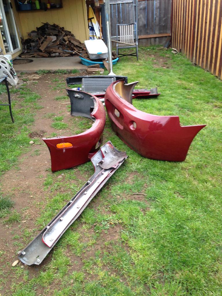

Big parts day today :) only paid 120$ for all of it
Will be installing everything next weekend
Had a lot of time away from the project, divorce is expensive LOL

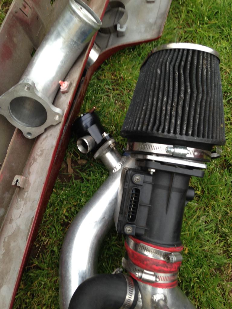

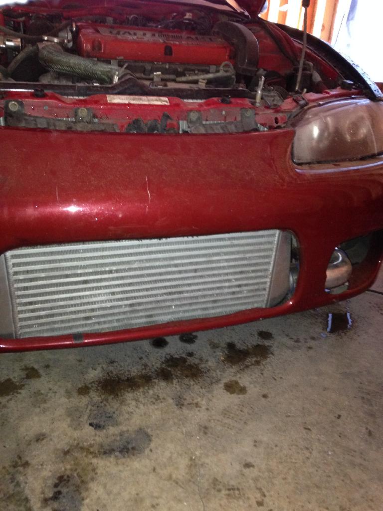

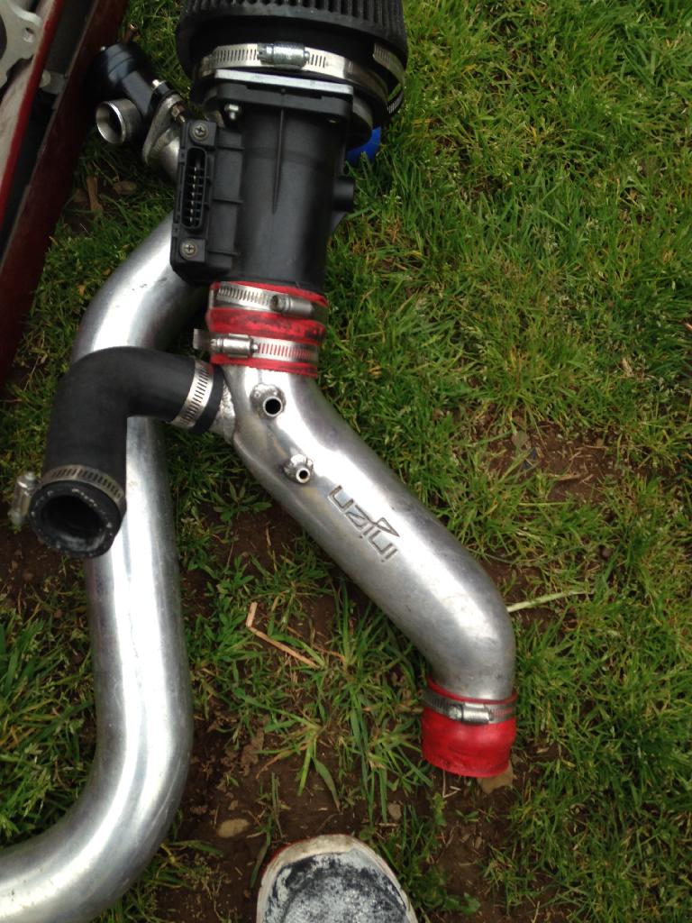

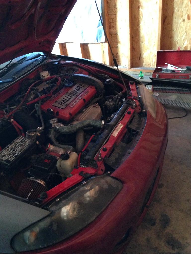

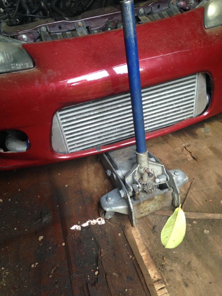

Full front and rear covers, front bumper, full front mount and piping, blow off valve, I ken intake, Evo rally art maf

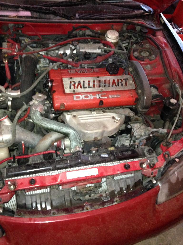

As someone who currently owned both a turbo and non-turbo eclipse I do not see how this was swapped. Unless I am missing something from the pictures I do not see how the swap was made. Could you show a better picture of the engine bay and more importantly the frame rails?
I am not 100% doubting this but I just do not see it. It would be easy to swap a dash to make it appear legit. Look on the drivers side inside where the door shuts and on the bulk head on the firewall theres a tag in the engine bay. If that tag says 420a you have a legit swapped car.
As stated on Paige 1, all 3 vin# locations pan out, I'm aware a 420a to 4g63 swap takes some work but I do believe this is a legit swap, I even took it to the police station when I bought it and they said it all checks out.

Thx man, yeah I'm missing the piping that goes connects to the turbo.

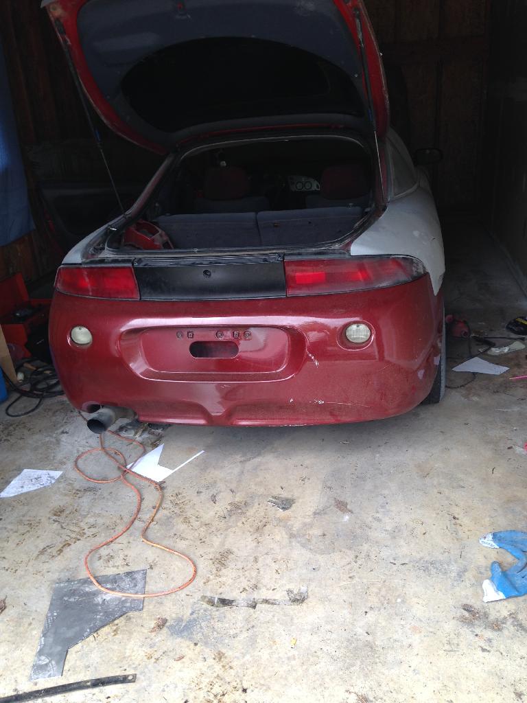

Well. The rear bumper is not their

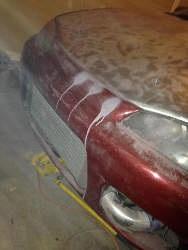

Did some figment and I'm really excited
And some bay pics and the new front mount
Did the fuel filter and she is still sputtering, going to pull the plugs and make sure their good and gapped properly next

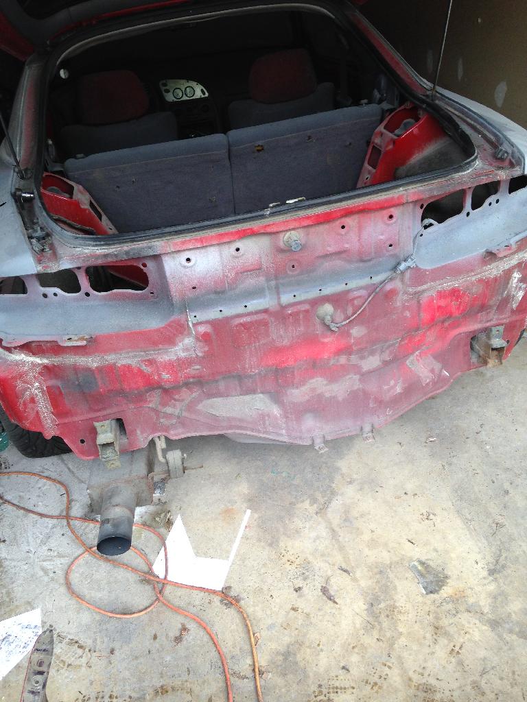

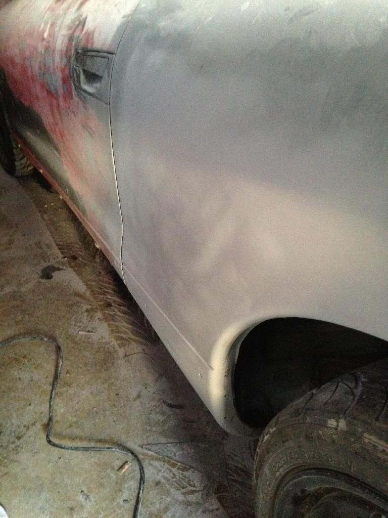

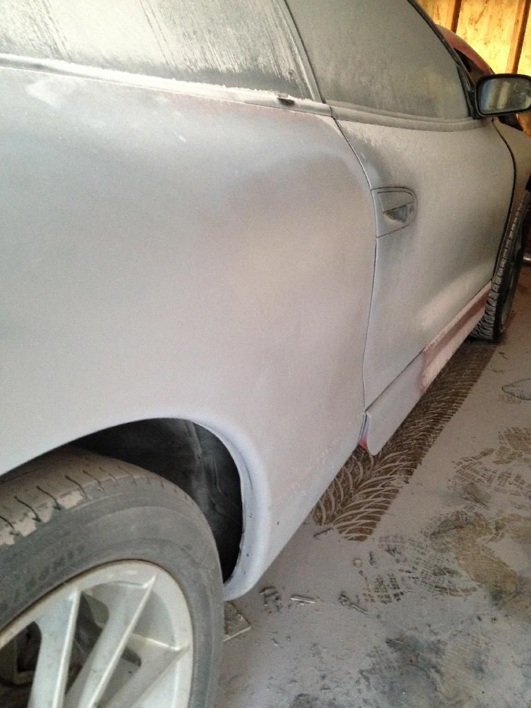

Muddling and getting ready to sand my patch panels :)
One side done on the initial mud and sand, drivers side is being problematic and will need more mud work
Looking much better but not perfect yet, probably one more build up with mud on the drivers side and a ton of high build primer and sand on both sides after
Calling it for the day, very happy with the progress this week and can wait to get at it 3 days straight in my bday next weekend :)

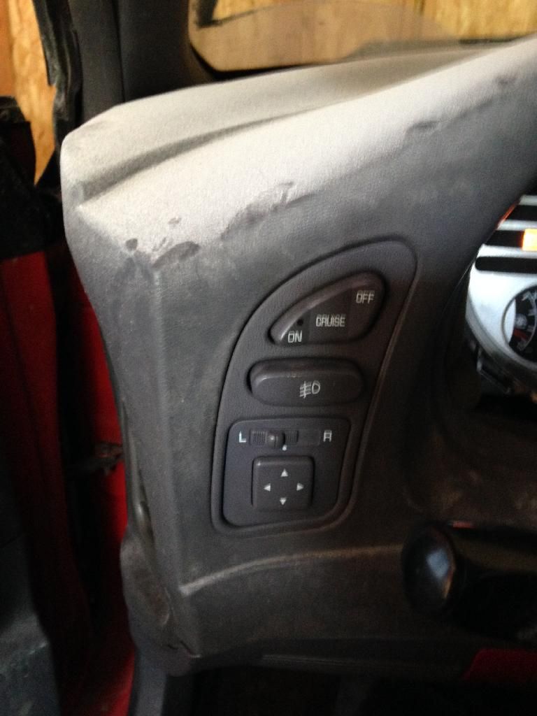

Standards don't have cruise control right?

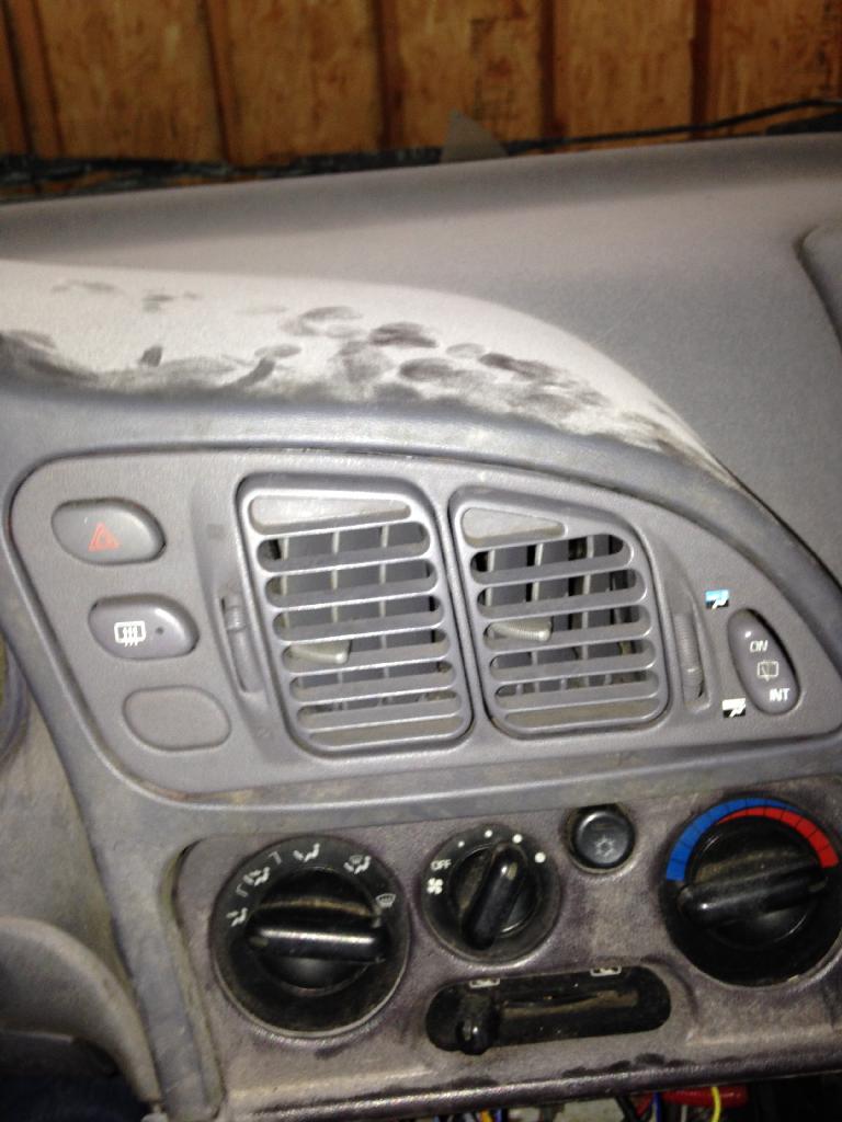

And I got the air vents and stock stuff installed today too
But I think this car was an automatic now because of the cruise control buttons? And answers guys and gals?

I guess I'm part of the club, both of my standard DSM's had cruise and it didn't work as well...

Standards did in fact come with cruise. Matter of fact, that is one of the first things people remove to clean up the bay.
And what do they normally put their?

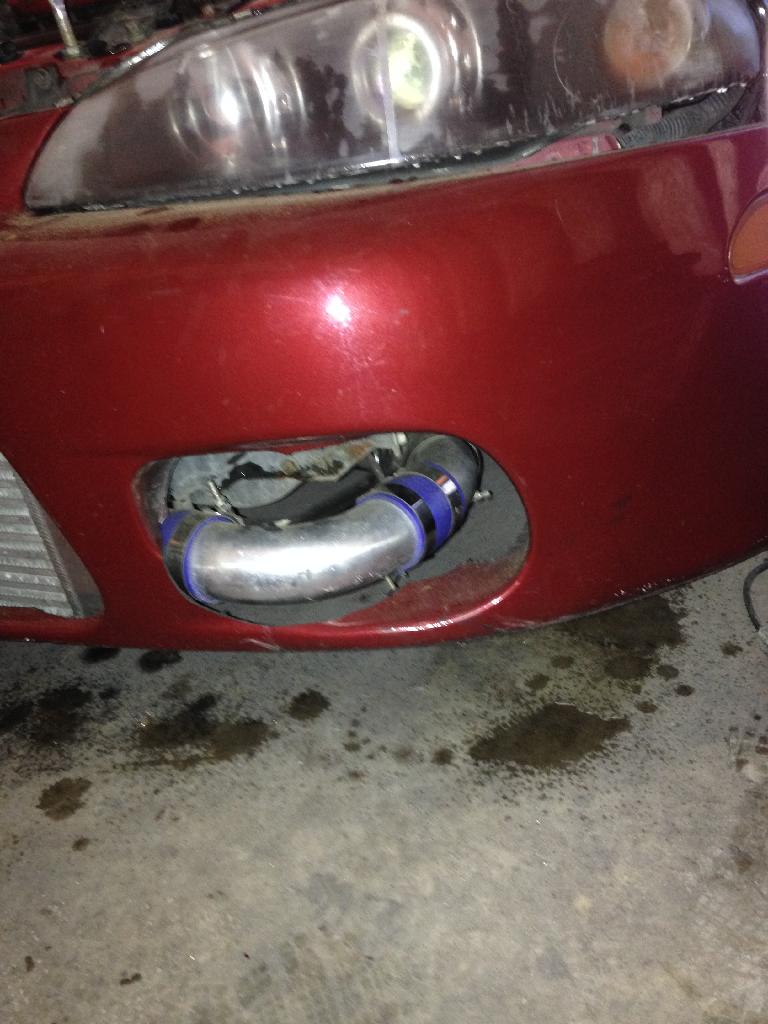

Next segment will be to install all the fmic and piping and making sure the new nfl plugs and wires are gapped and installed, then fully install the bumper covers, and finish the major body work on the car, and get the high build primer sprayed on, that way Sunday is all about sanding and getting ready for glaze and final sand before paint and clear coat. Then 800-1000-1500 wet sand and...

Not sure if you're asking about what people do after replacing the cruise control. A lot of people simply remove the cable from box on the firewall and scrap the cruise control. When I installed my JMF intake manifold there was now way I could keep the cruise control/throttle cable box. So I swapped it out with a non-cruise control cable out of a spyder (i believe it was out of a spyder. just ordered the oem part, correct me if i'm wrong). That comes out of the fire wall and directly to the throttle body rather than wrapping around the intake manifold and clipping to the valve cover. As for the interior I think most people leave the buttons and steering column controls.

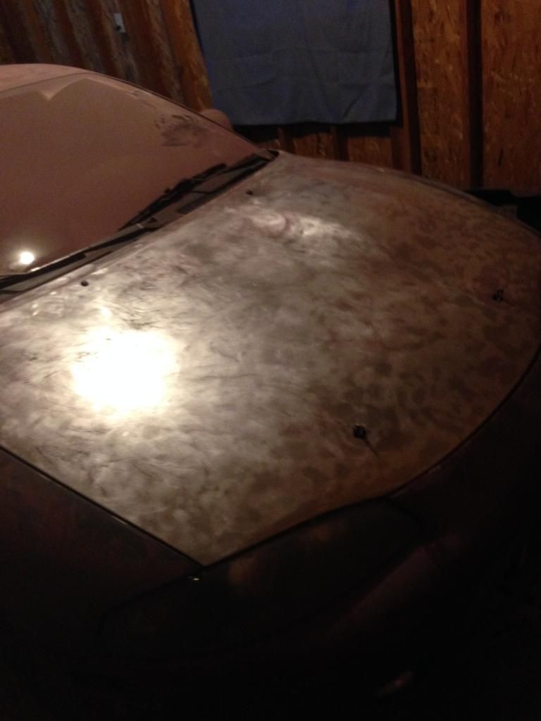

I did how ever get the entire hood back to bare metal, that ####er had four layers if paint in it. Right now the plan is to paint the car white and just clear coat the hood showing the metal, and get carbon fiber hood latches, with bright comp orange wheels
I think it will give it a unique and aggressive look
And the radiator fans where all ####ed up and not working, and the 30 amp fuse was blown, I had an open wire so I pulled the loom apart and cleaned everything up, all the sudden all the lights work in the dash and even the cigarette lighter too :)
