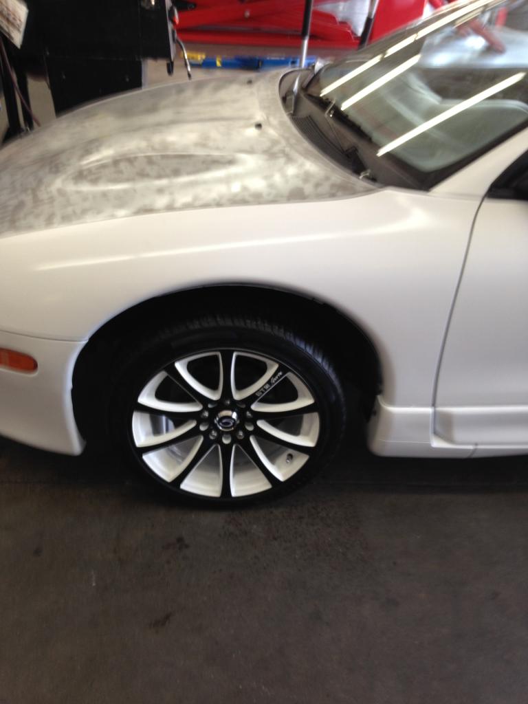

Woah! Thats a crazy difference! that paint really brings it back to life! That's really good looking work. Cant wait to see it with the rims. hopefully they fit. DSM from the grave

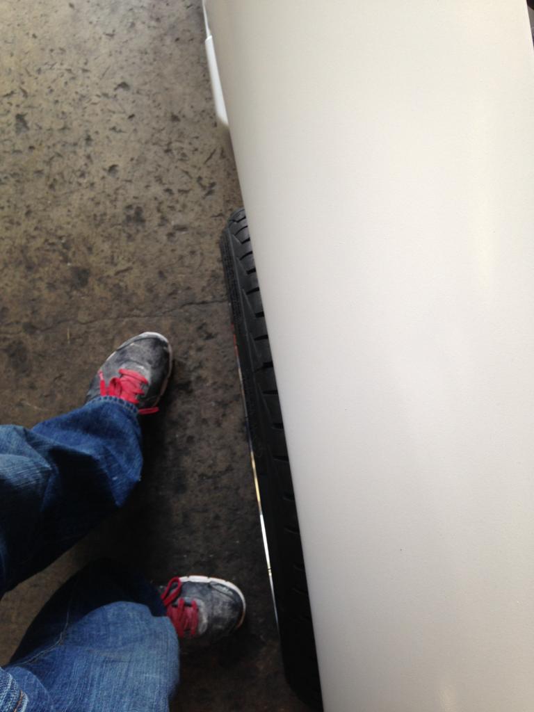

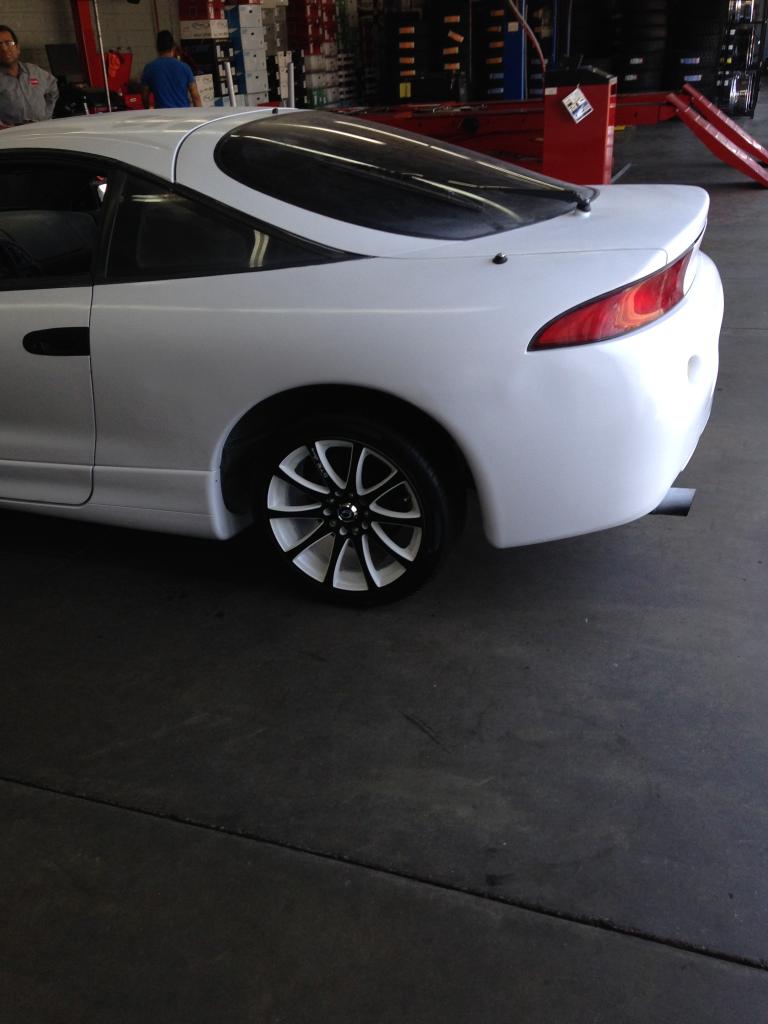

They don't fit right, their is about a half inch of wheel poke
Their really isn't any getting around the wheel poke, they just don't fit right
I went with a set of black and white gtr sport rims 18"

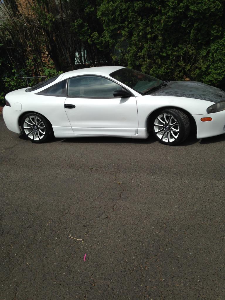

Still waiting in my coilovers to arrive so I can get a nice stance and better handling, looks like I need new tie rod ends also

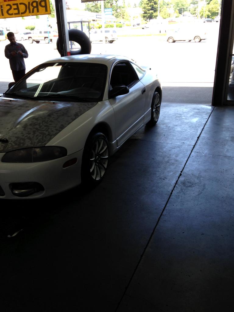

The car didn't pass deq, I'm being told that is has a ton of codes, I need some help from you guys to get this thing legal, Anyone know of an honest shop in portland or can anyone come over and give me a hand? Or can I come to u?
The codes are over boost, o2 sensor. And their is no catback exhaust.
Replaced the outflo o2 sensor, but I can't get the inflo 02 to break lose, sprayed her down with some on blaster, will try again tomorrow

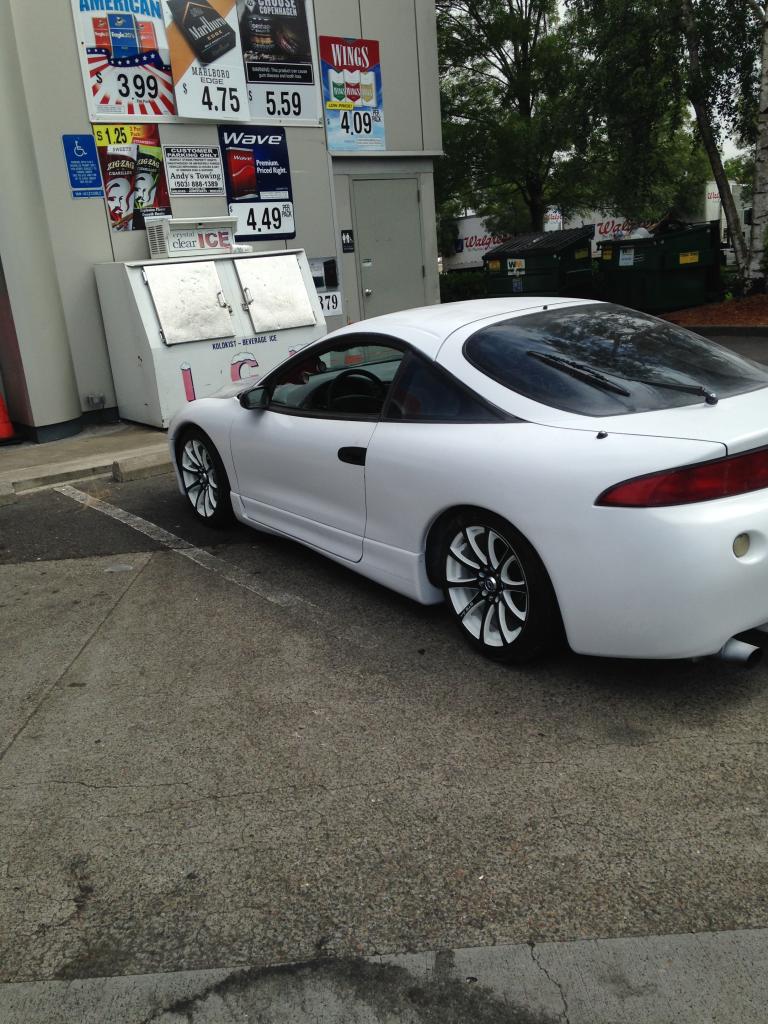

On a lighter note, I installed and level tuned the new coilovers set up, looks awesome.

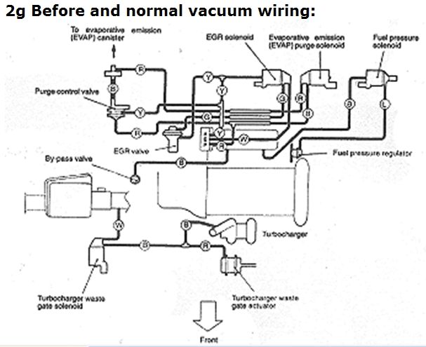

heres a vacuum line diagram for the eclipse:
As i see it there are a few things that could be causing our issue: bad BOV (bypass valve), bad wastegate / solenoid or bad vacuum tubing. Now to test these things:
BOV: Boost pressure keeps this shut when the car is under pressure. when you let off the throttle, the throttle body closes and there is then no longer pressure holding this shut, so the left over pressure in the IC piping pushes this open and lets the pressure equalize. To test: take of the BOV and make sure the diaphragm isn't stuck shut. You could also check the vacuum line to the intake.
Wastegate: Similar to the BOV in function. The wastegate solenoid activates when there is too much boost in the system which opens up the wastegate to allow some of the exhaust to divert around the turbo and thus decreasing boost created by the turbo.
The Solenoid is most likely your issue. If you bypass the solenoid, the wastegate should be open all the time and you shouldn't build boost. So, take a male to male nipple and connect the two hoses connected to the solenoid together (you could do the same by supply 12-15psi from your air compressor to the waste gate and seeing if it actuates). If you can still build boost like this, then either A have a malfunctioning wastegate or B a hole in the vacuum line to the wastegate.
I think that should answer your question. Sorry if i'm treating you like a noob (like me haha), just providing some back information.
