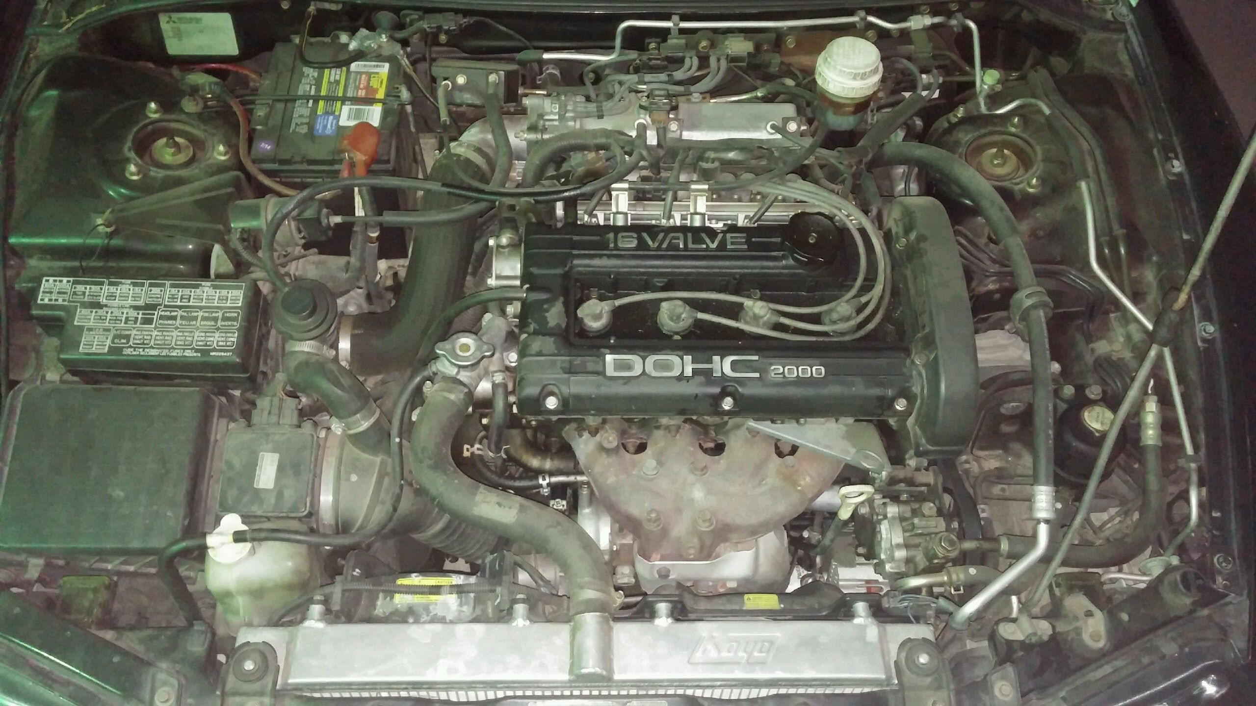

So today I picked up a 97 auto GSX, It has 210,000 miles on this GSX and it is COMPLETELY UNMODIFIED. The original components are perfect, the wiring is perfect, there are NO aftermarket mods done to this vehicle. The motor was rebuilt at 190,000 and it still runs great. I have yet to see a DSM over 200k that still drives this flawlessly!
