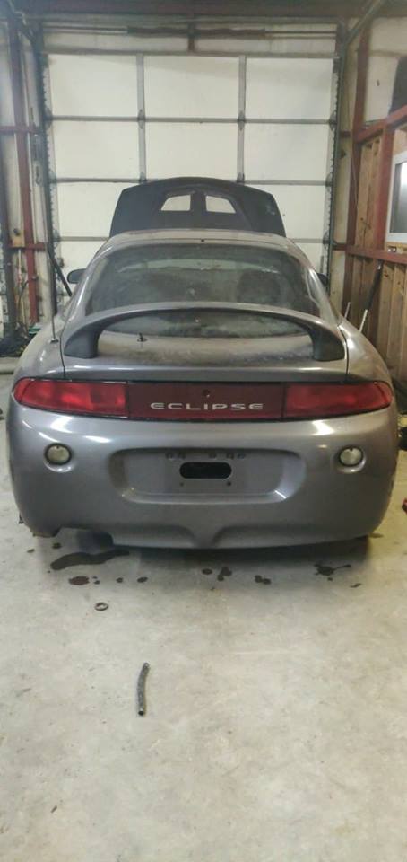

$1500 buy off of local FB market place.
After a good cleaning this morning, and a quick look over I found some rotted vacuum lines. I decided to pull a spark plug to see how it looked. 1,3,&4 looked fantastic. But #2 looked burnt. If I get time tomorrow after work I’m going to pull the rest and do a pressure test.
