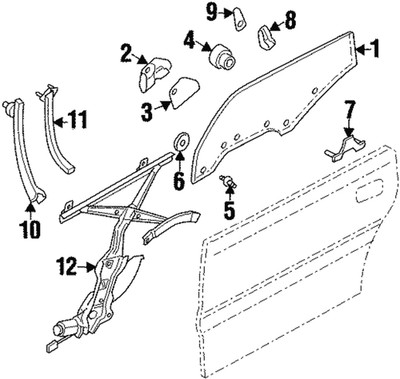

If anyone starts 3d printing the door window support plastic deals I'd buy. Every one is broken on all my cars. It seems to be a common problem.
I literally just bought that one and for 12 shipped isn't bad. The other guy selling them on ebay has 3 left but for 25 shipped, they know what they can get for them. I only need 7 more now.
By the way thanks for searching that up I'm being extra lazy today.
