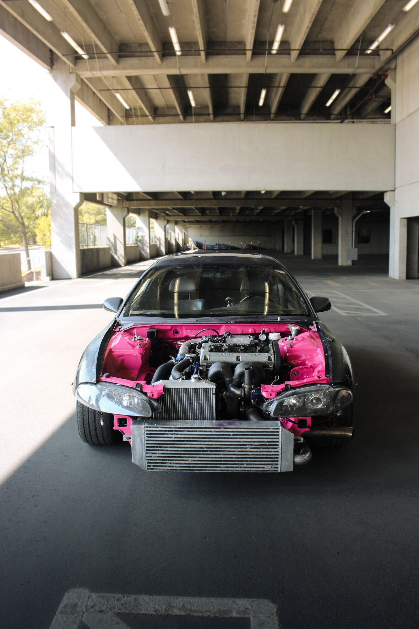

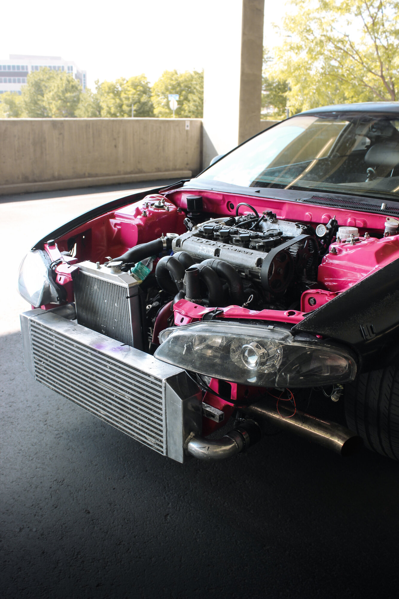

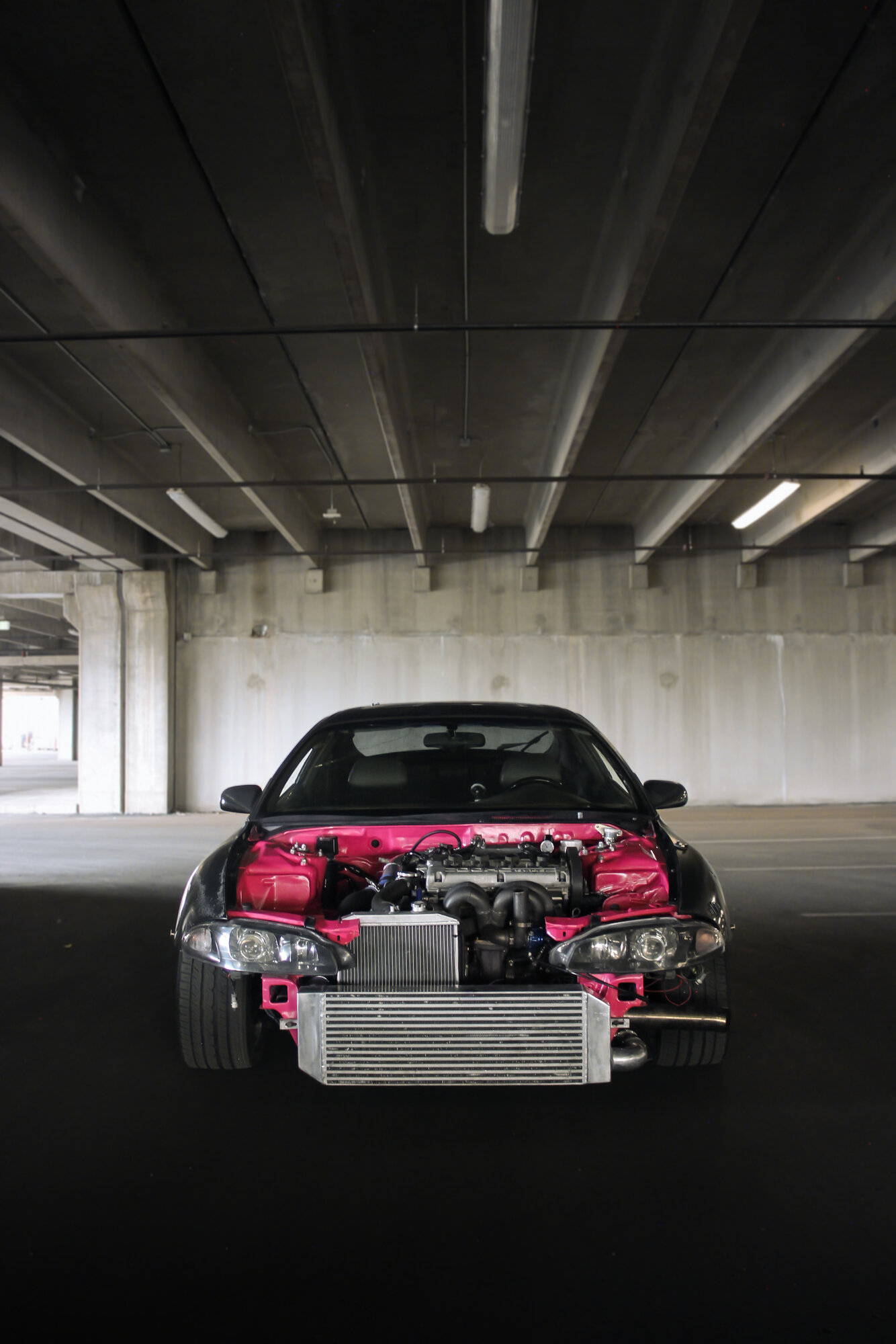

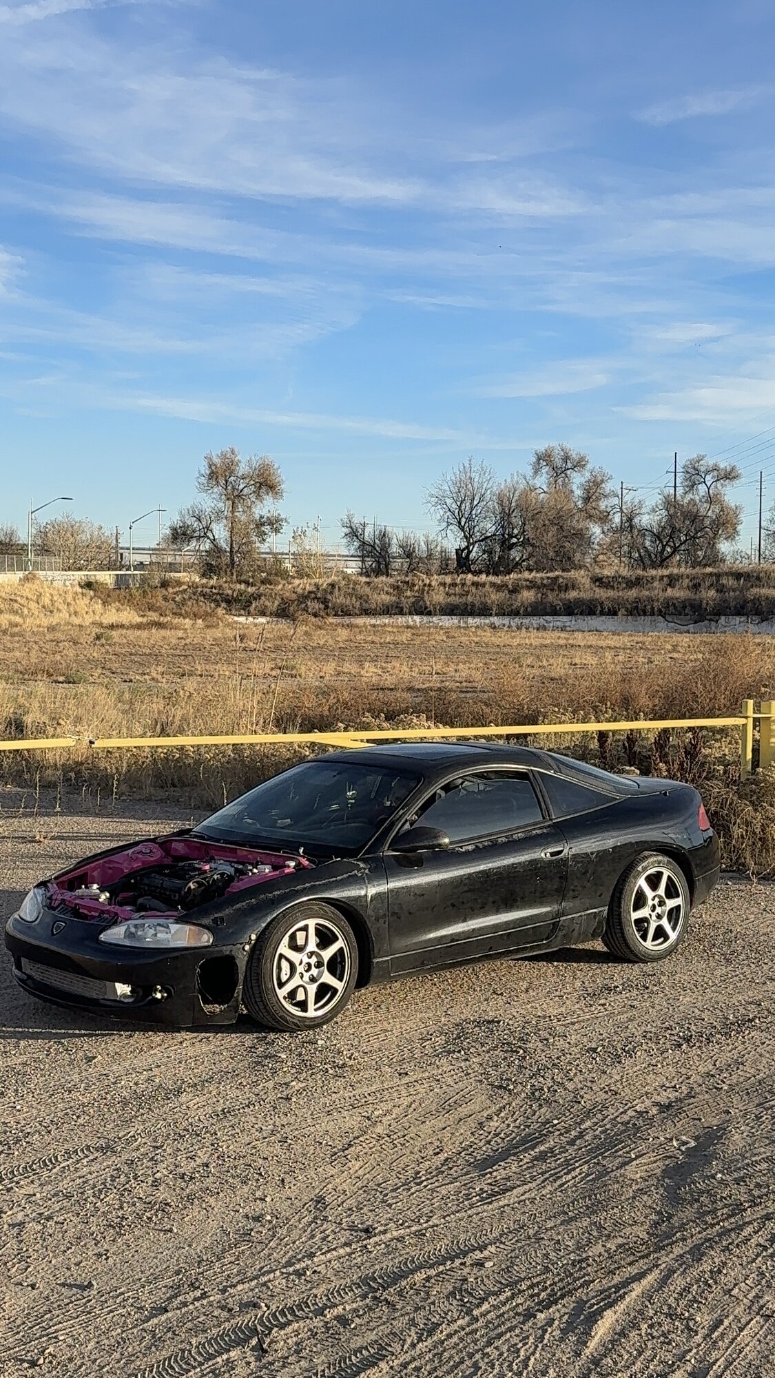

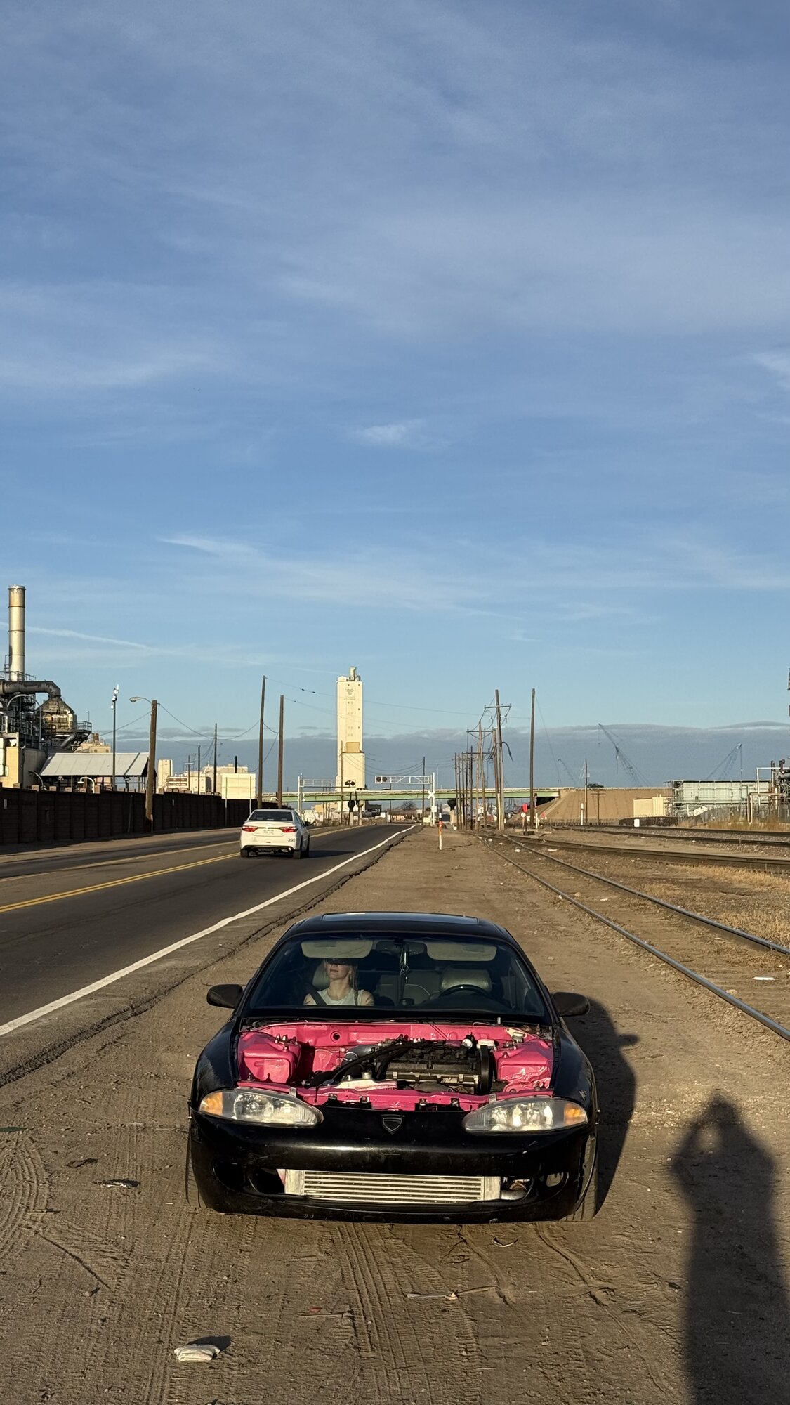

Wow oh wow has it been a wild few years. I believe the last time I left this thread off I was planning on throwing a stock bottom end in with some cams, springs, and a HX35 in until the motor decided it had enough. Well fast forward a year and a half, up to a 6262 and the bottom end still held through! I had some fuel issues with my pump, and the wiring for the pump cutting fuel at 17psi. Which I was not happy with. On top of that my EBC stopped working on me. I chased wires for weeks, swapped a new EBC into the car, got my ECU checked over and I could never find out why it stopped working. After the car kept fuel cutting I decided to do the only logical next step! Pull the motor and trans, delete everything not needed in the engine bay, sand the bay down to bare metal, skin the bay of seam sealer, weld all the non needed holes in the bay shut and body fill parts that were uneven in the bay, primer, seam seal, and paint the engine bay BRIGHT PINK!
That sounds reasonable right?
Wrong.
Lets also move the harness to where the Pass airbag lived, delete all unnecessary wiring from the harness and extend the harness to each side of the bay. Delete all unnecessary wires from the engine harness and tuck the harness to a more "Race style" flying lead harness. While were at it, lets convert to a Haltech 1500 and wire in the ECU so we don't need an adapter. Then you finally end up with a build you can kinda call unique haha!
WHILE WE'RE IN THERE
Lets also decide to build the motor! Callies I beam rods, Wiseco HD pistons, Main studs for the crank, L19s and an Athena Cut ring headgasket. Throw some GSC S2s eventually in it with some kiggly springs and call it fully built! This 6262 is going to make some jam and juice here shortly!
I don't know where to stop with this build haha! Next is the drivetrain, subframe bushings, and rear brembo brakes to match the CTSV calipers up front. Maybe paint or wrap the car. I don't know. All I know is I became a glutton for power and am hunting for a fun power number.
