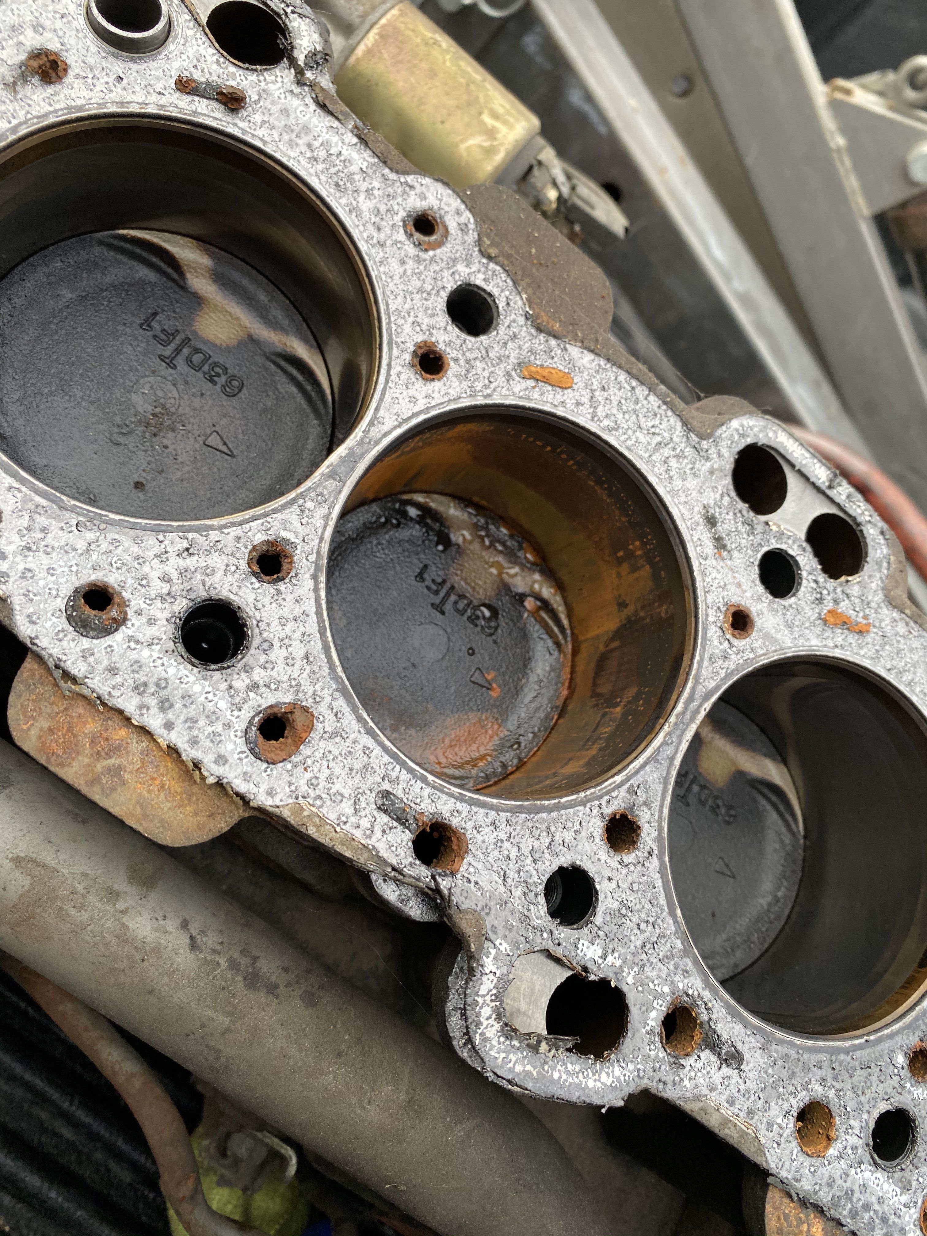

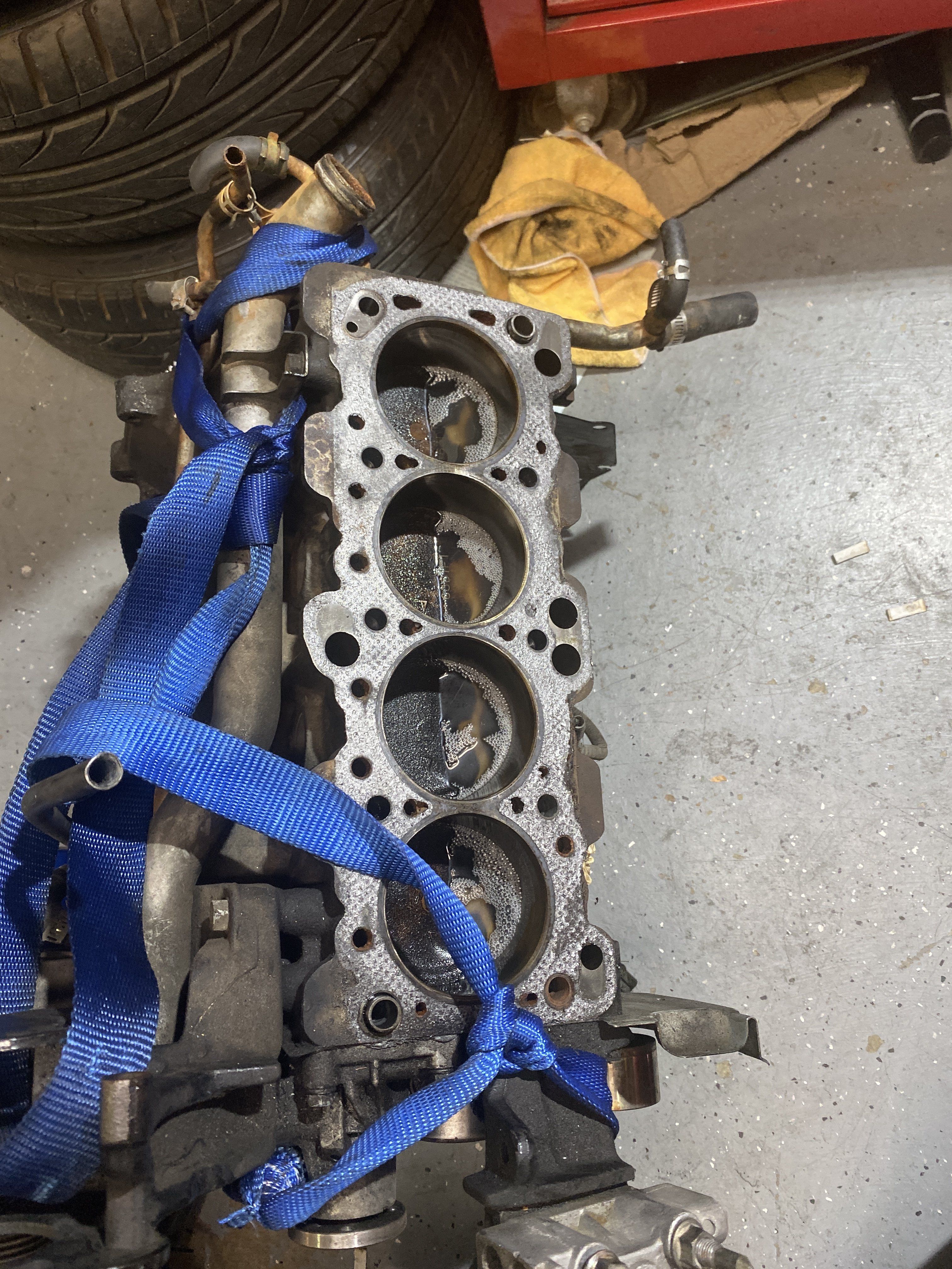

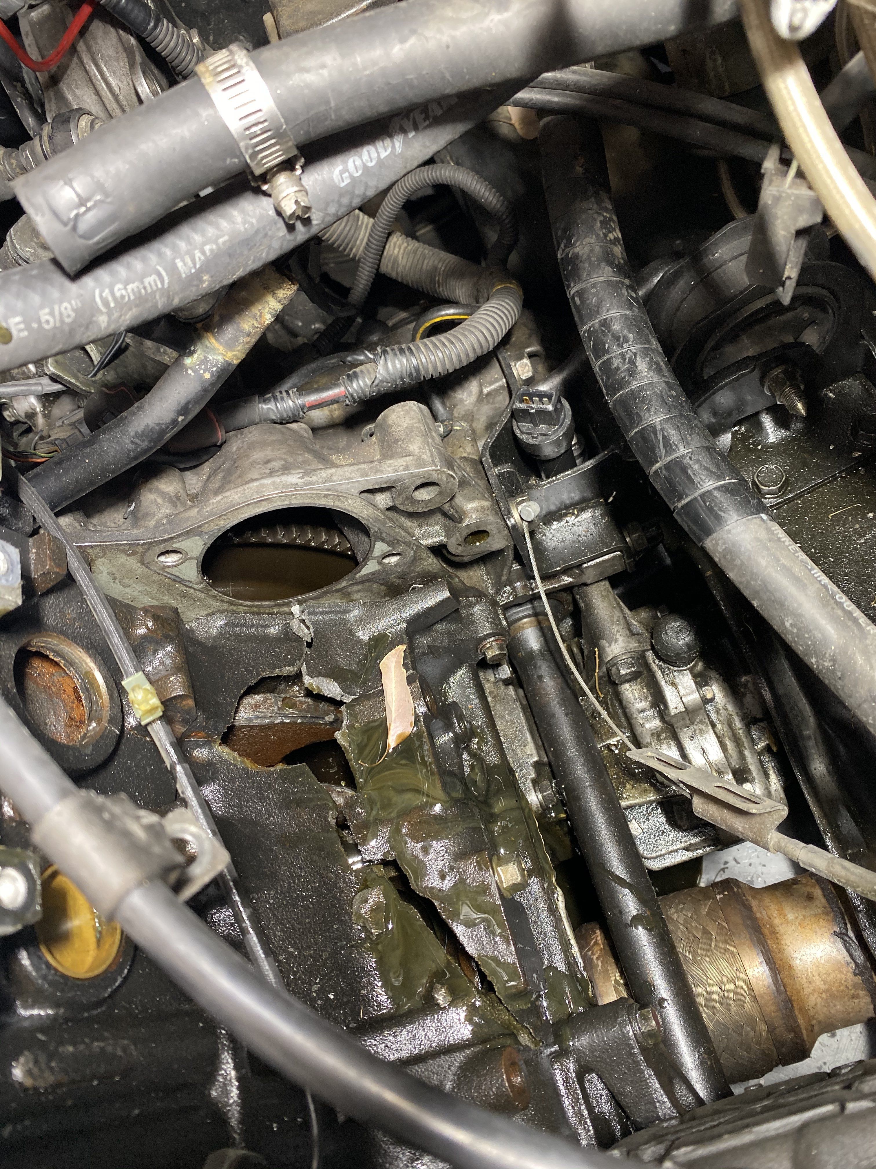

It’s was tuned on e85 on a t28 with no boost control
Max boost spike to 32 go down to 25 felt very good for a year
fuel mods : require pump Evo 9 1200 cc injectors

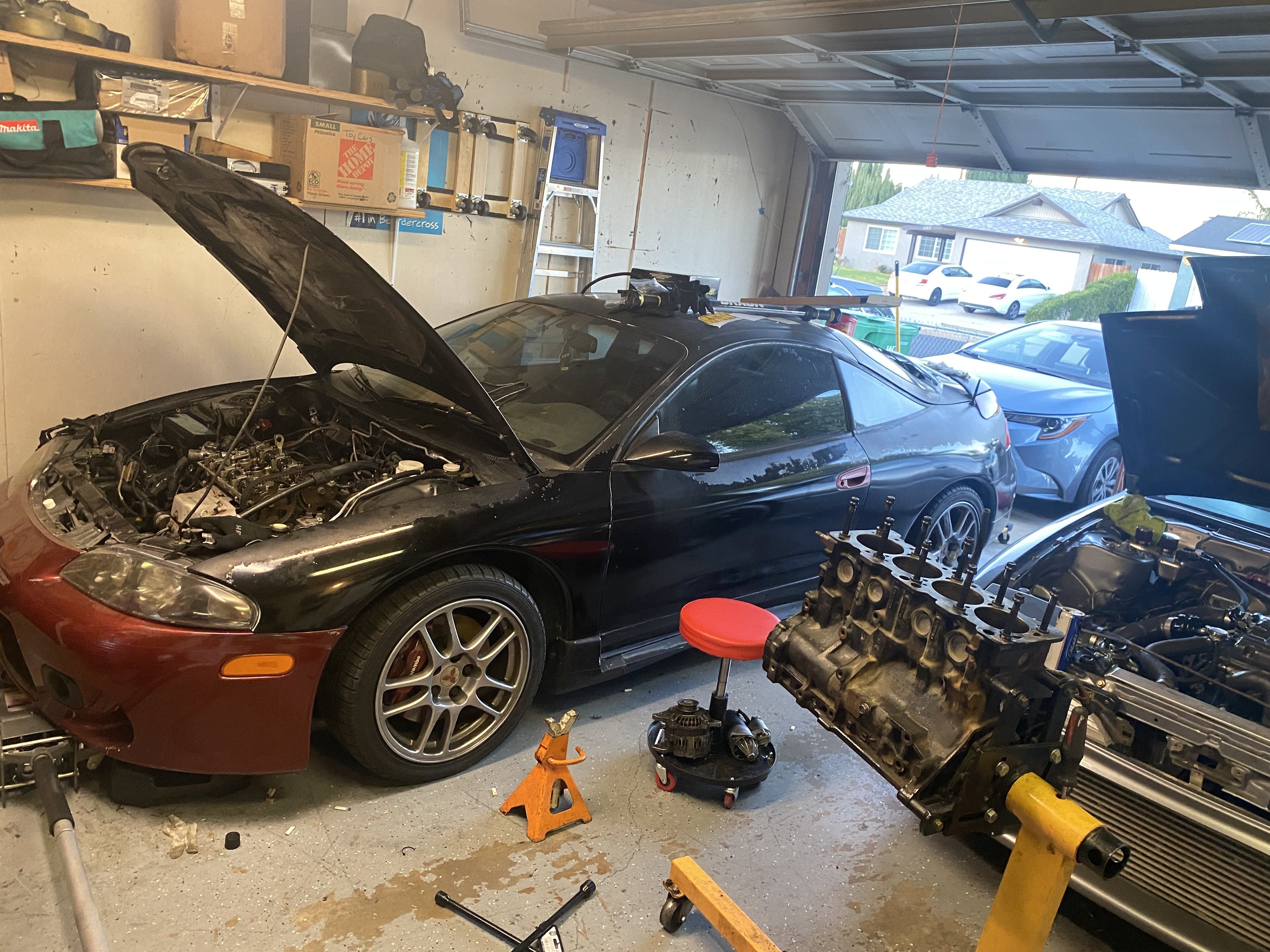

but 6 weeks of go it blew up

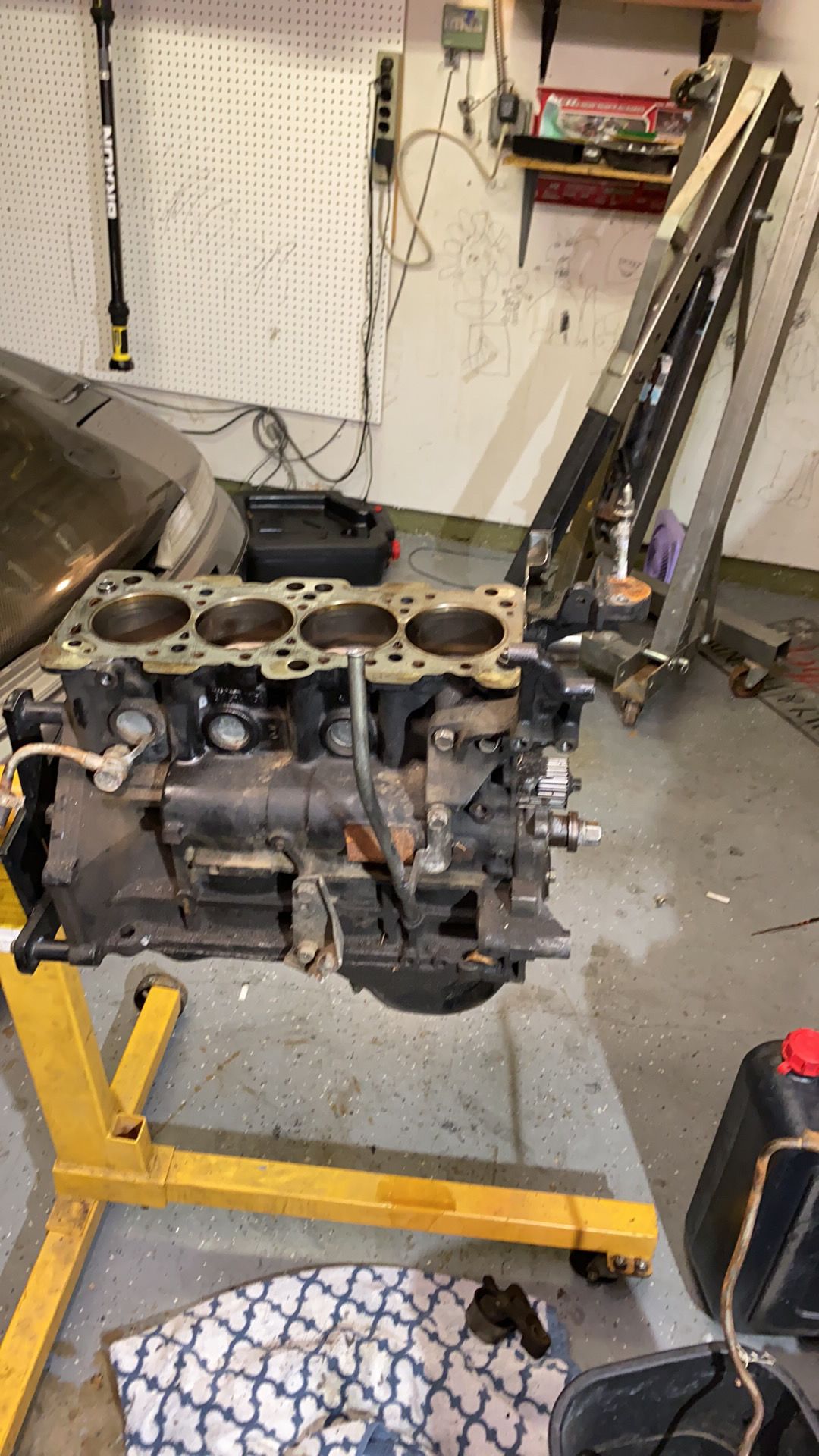

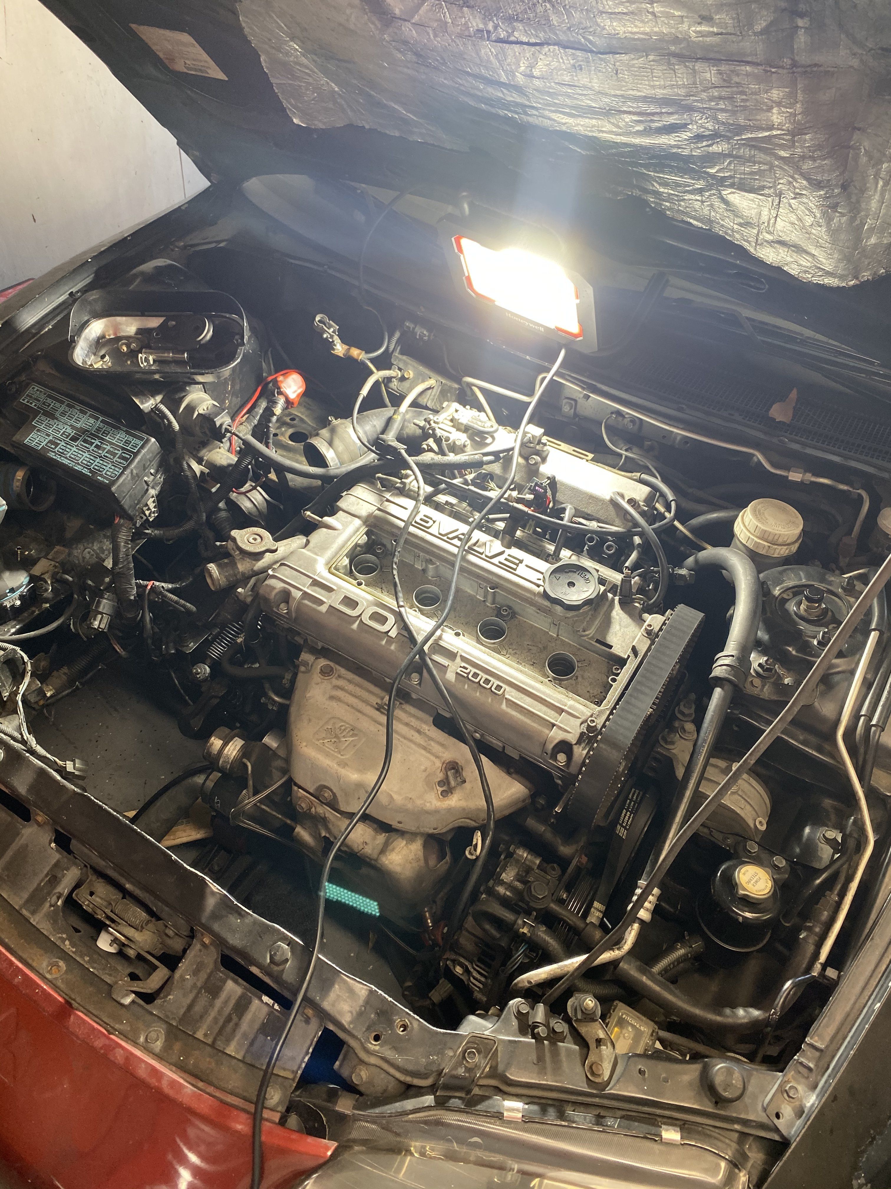

With the engine blown i had to

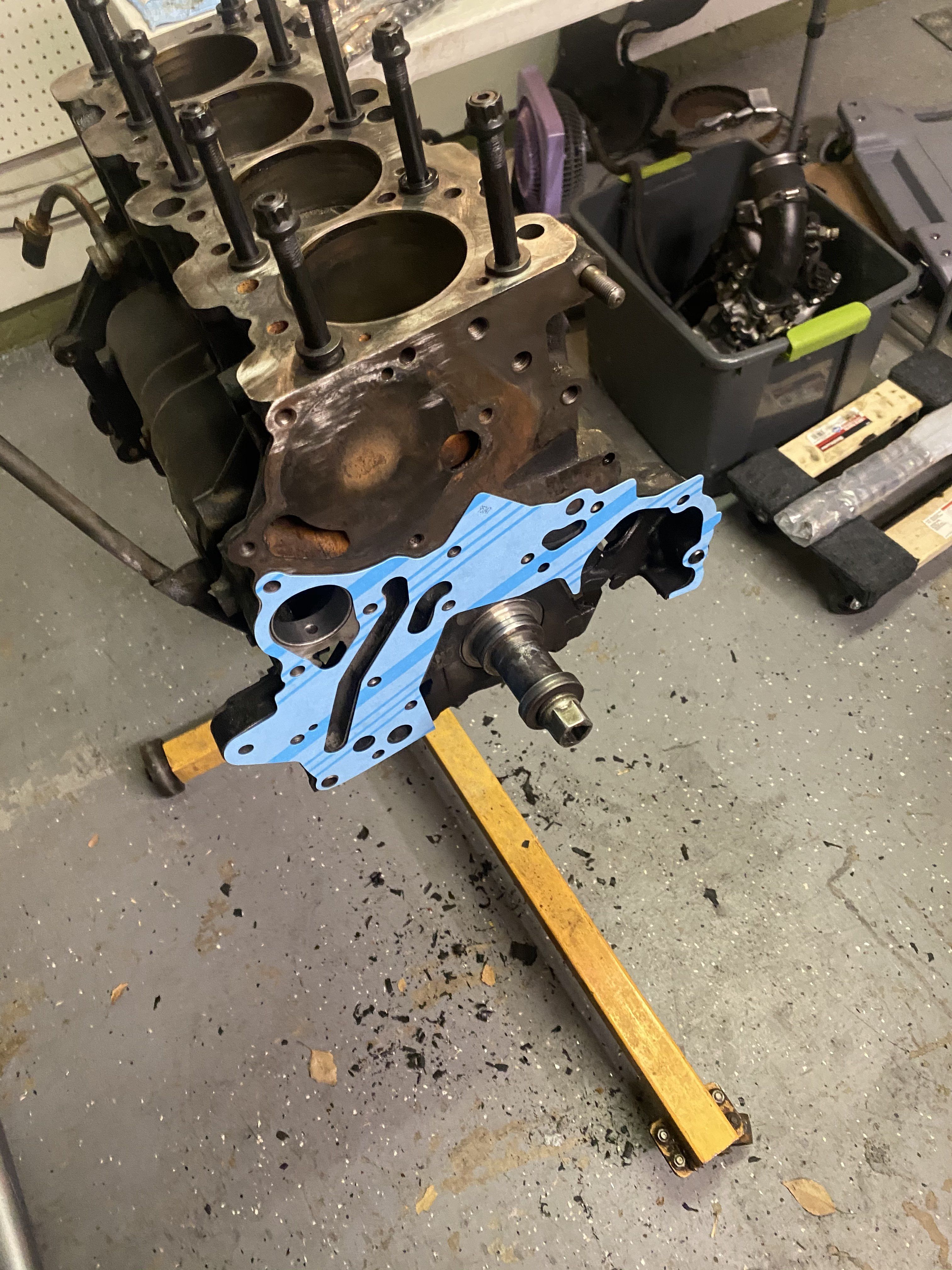

Keep a budget in mind I followed Gofer build with HTA figure it can work in my case got a donated engine had some surface rust but it cleans up well

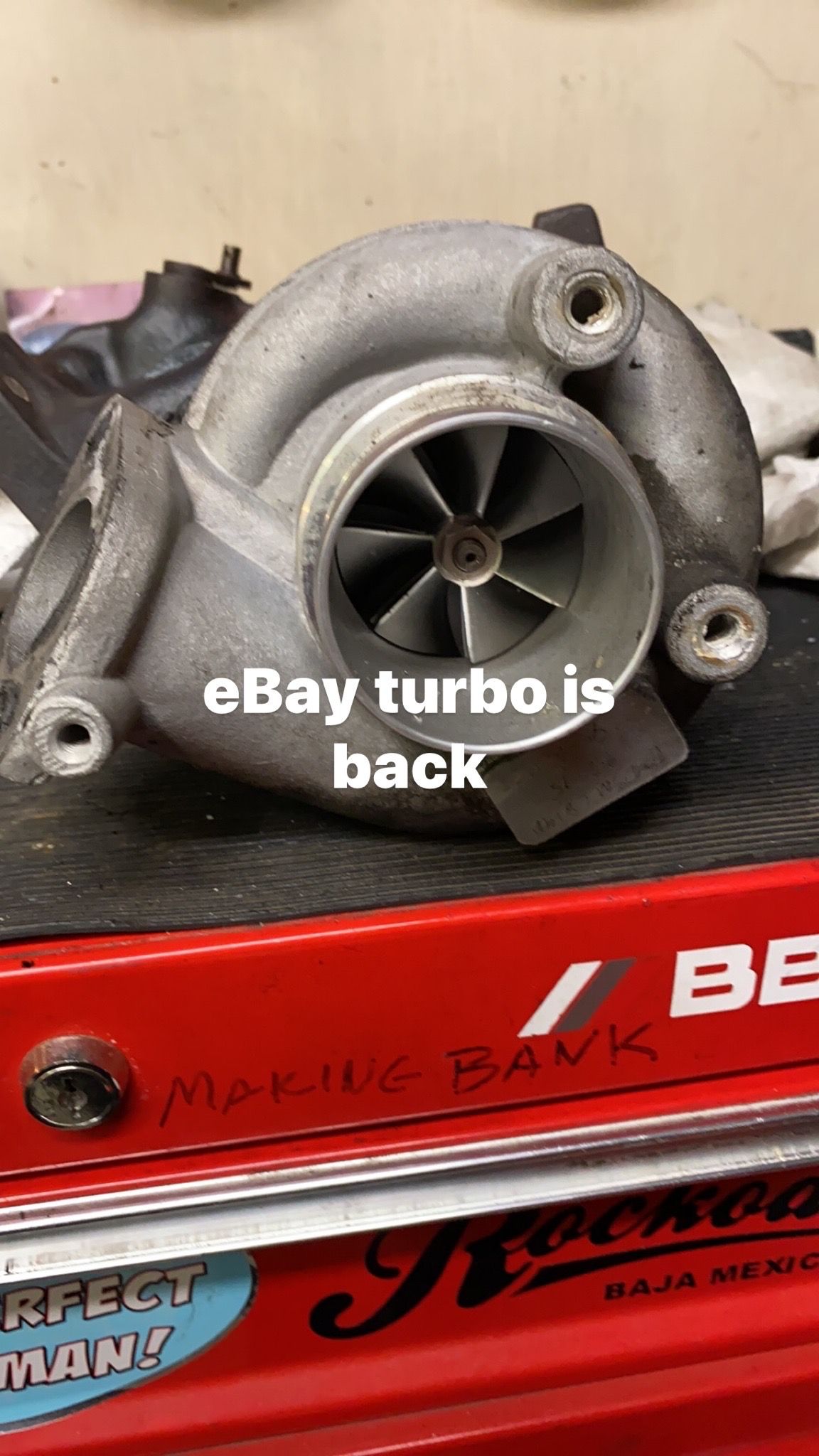

picked up HTA 68 FP manifold
the turbo was a trade for other parts I had so it worked out
Fp manifold was cracked and it’s getting repaired it was free
head as of not getting Evo 9 springs whole valve train
will post more updates

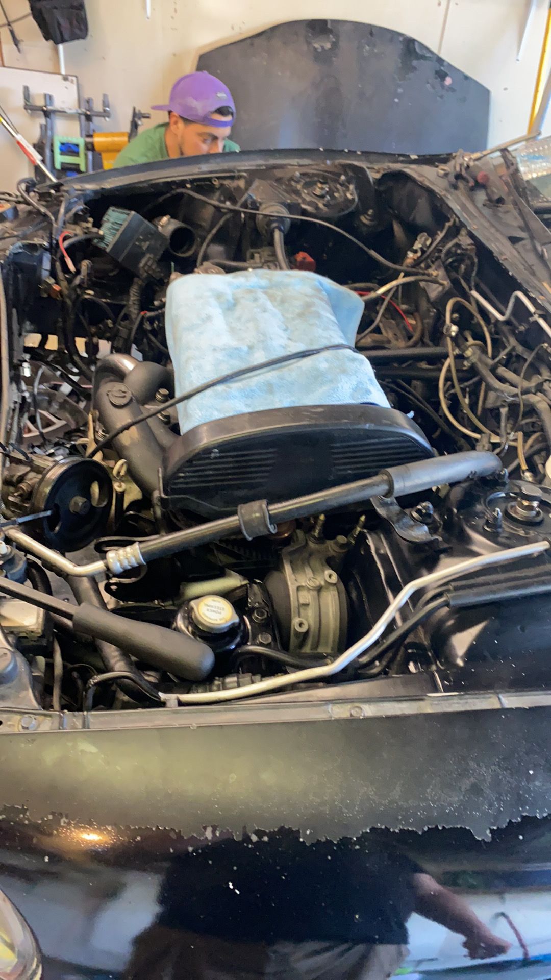

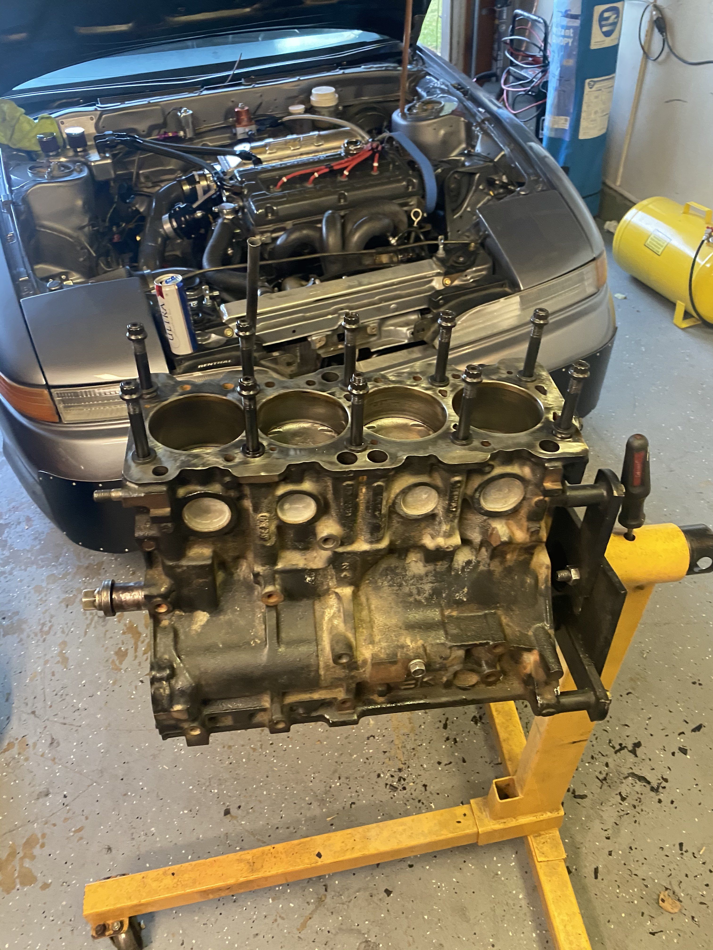

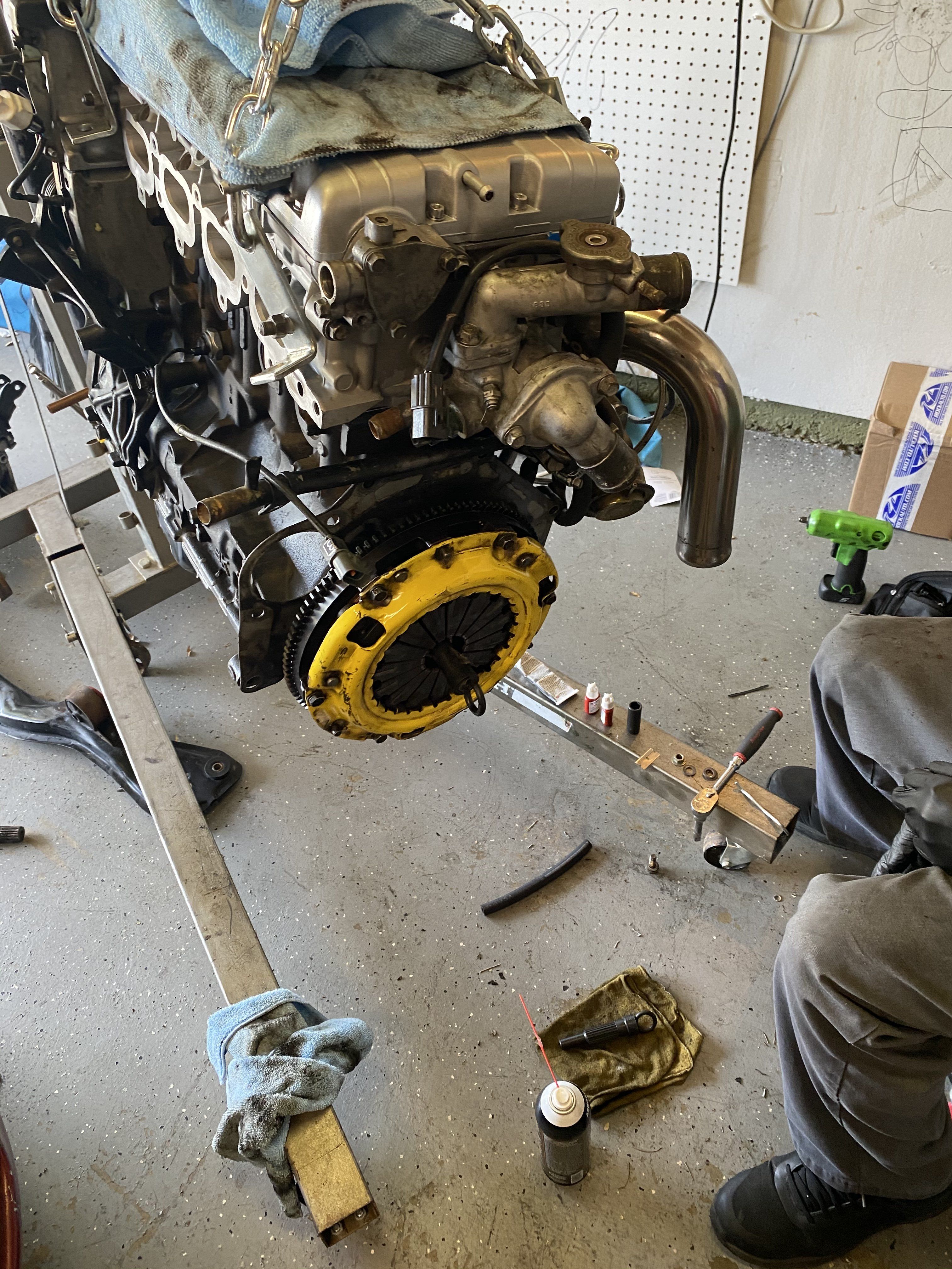

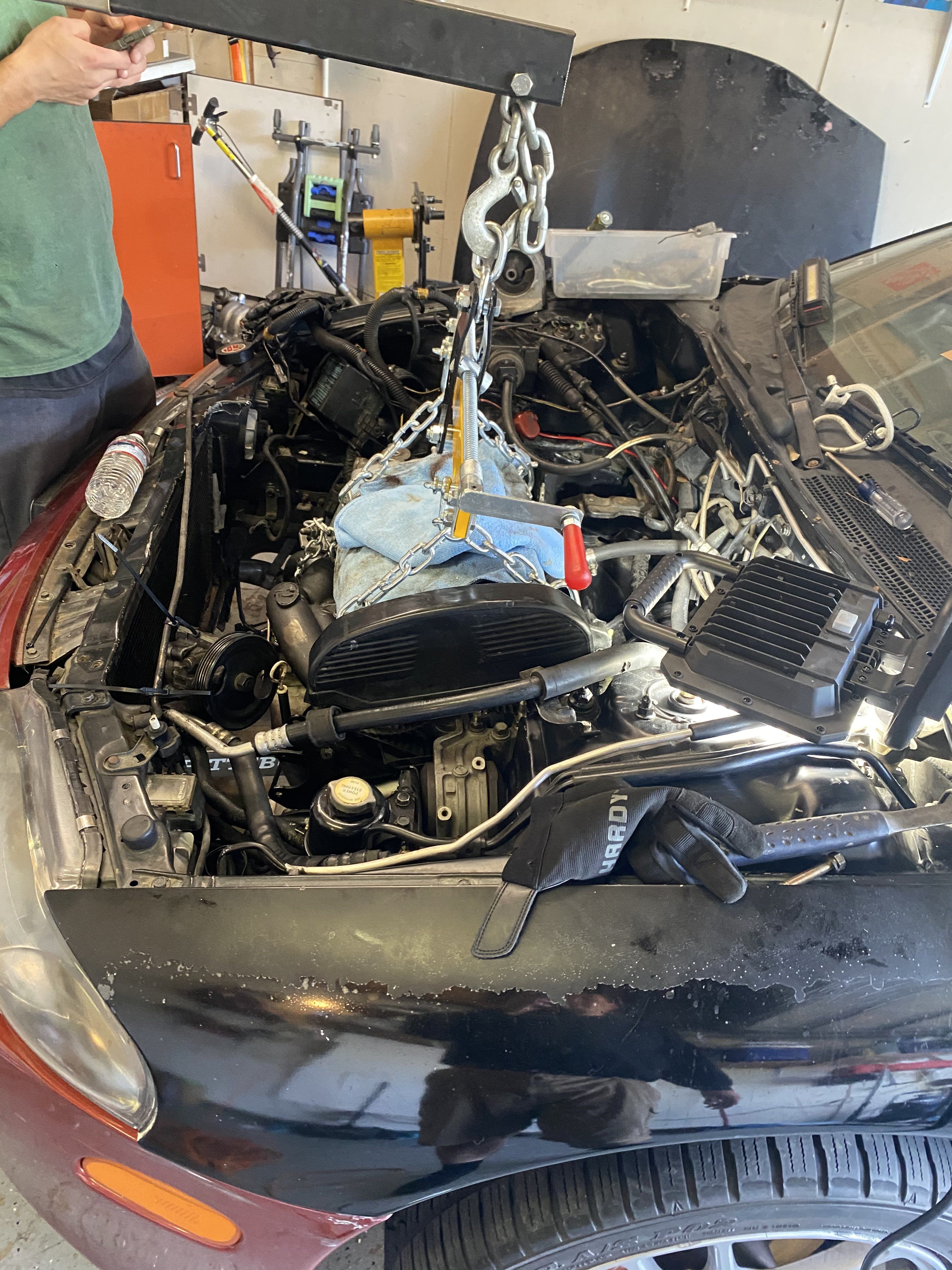

It’s been a while since my last update

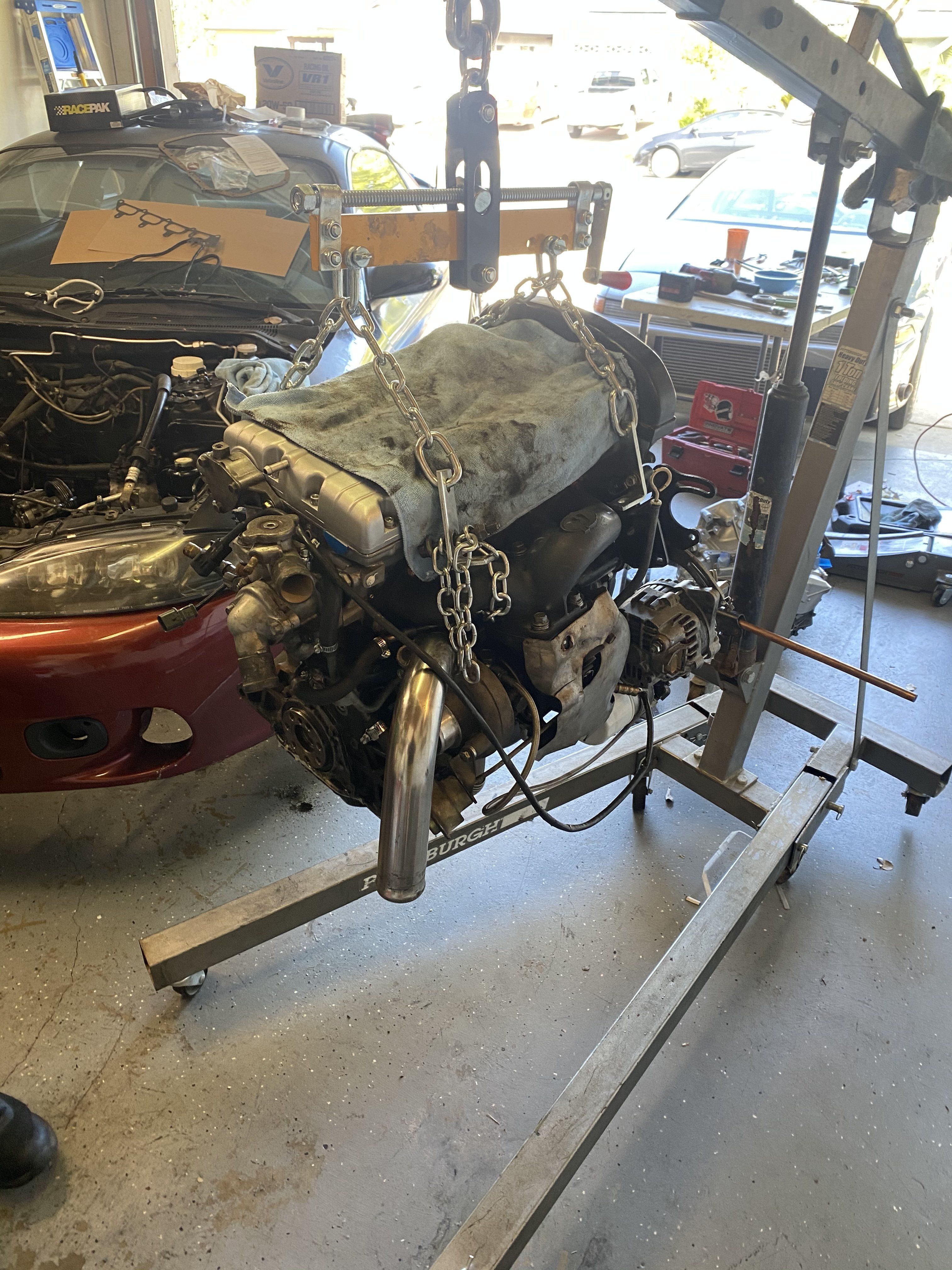

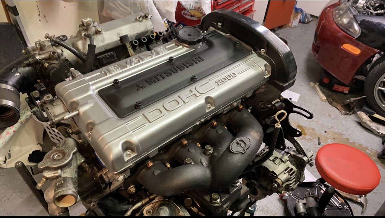

Finally got the engine in after doing the following.
The head was reworked with Evo 9 valve train
ARP studs, GSC S1 cams
Fp intake manifold
Rc1200
Hta 68

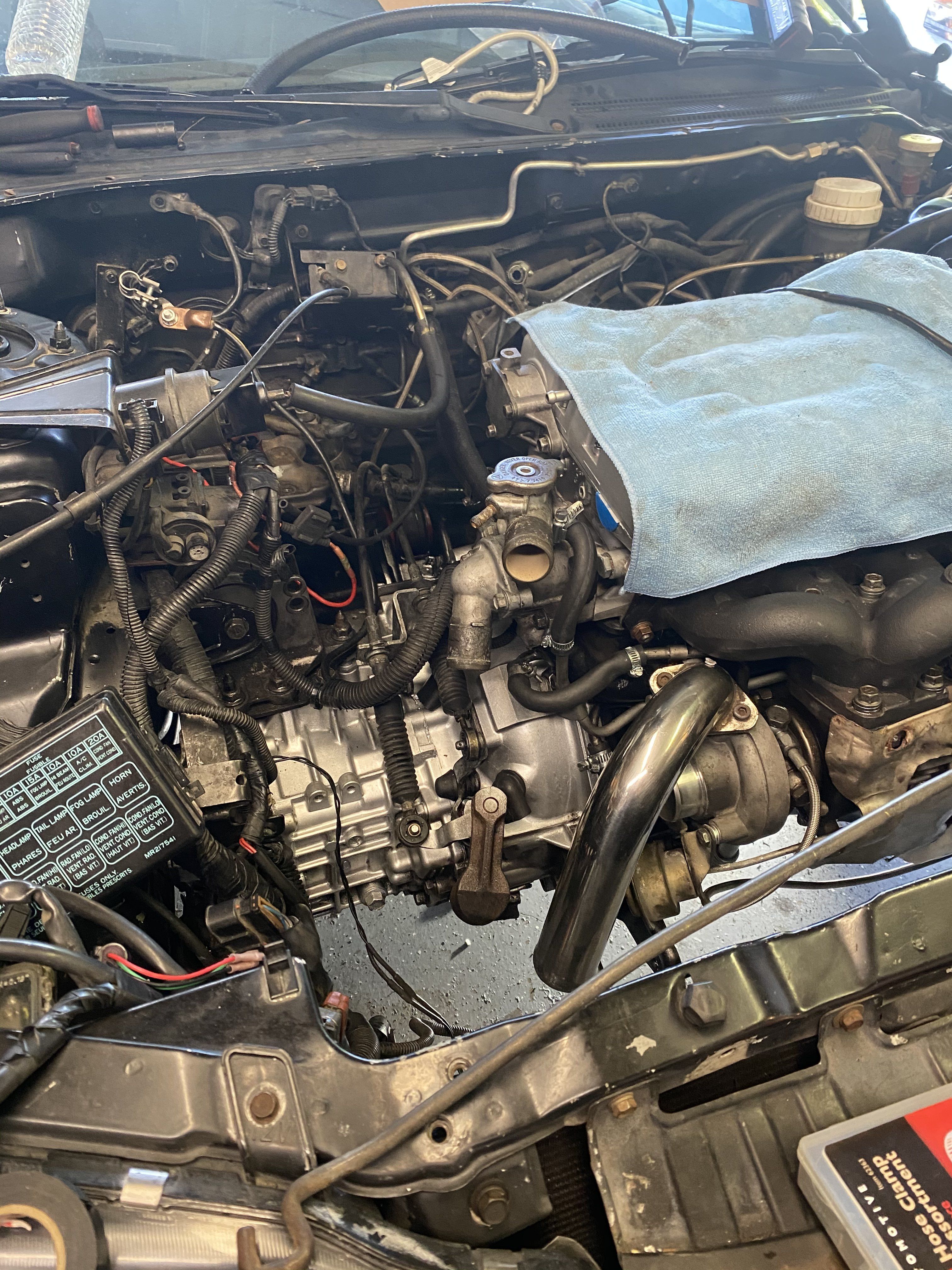

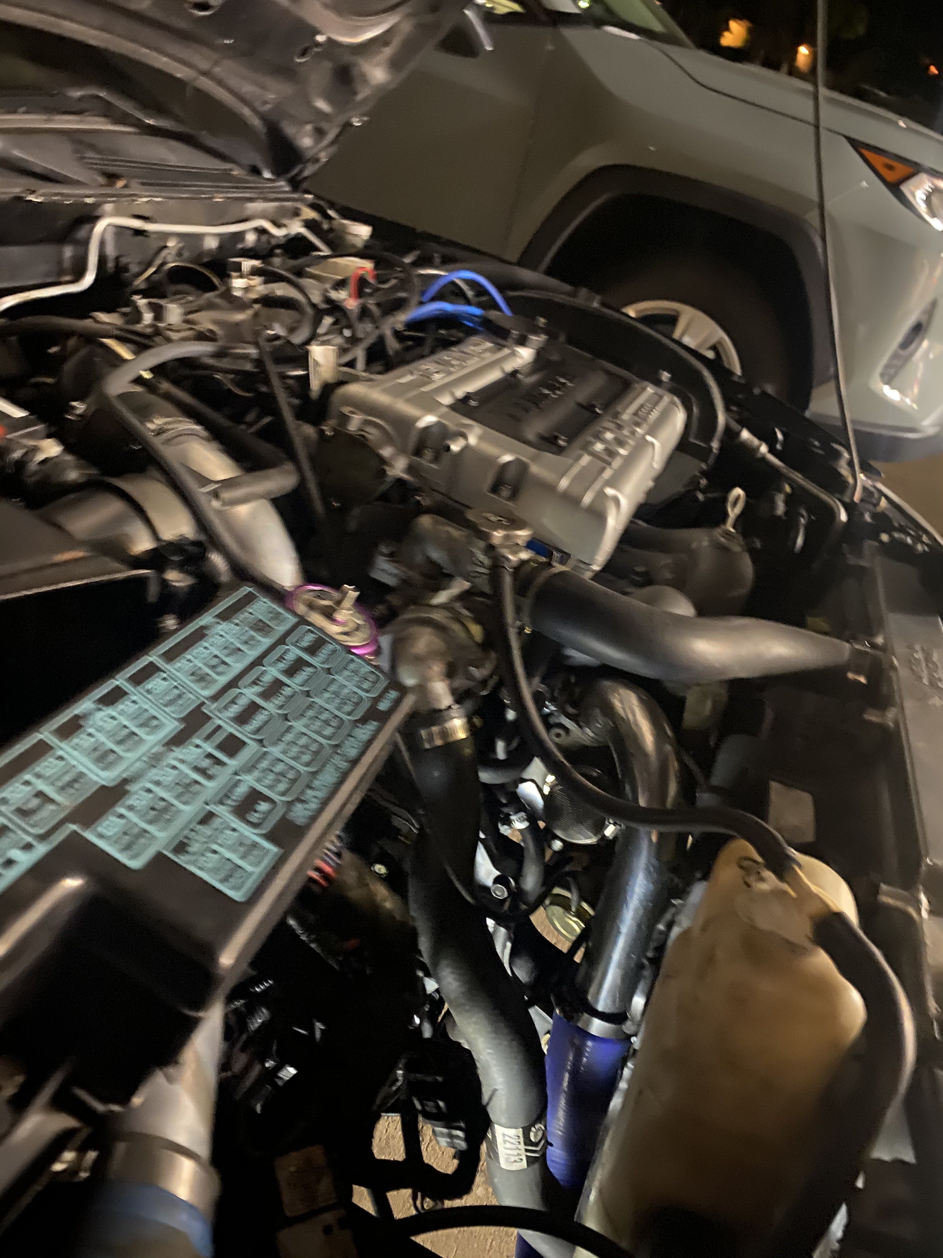

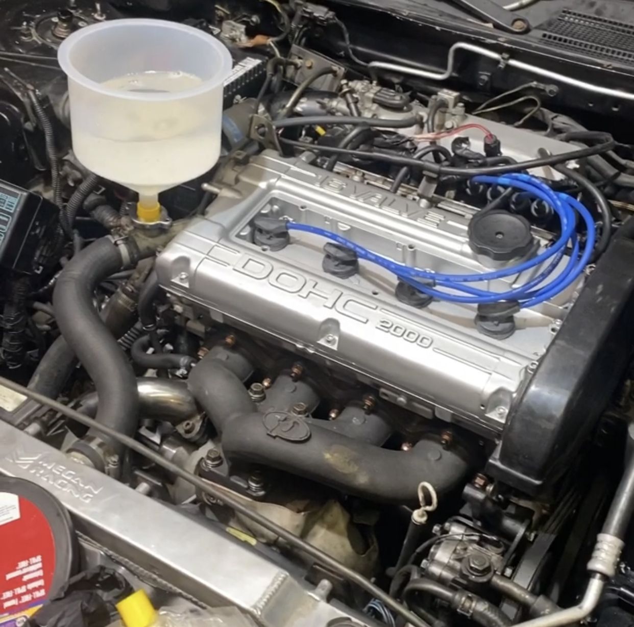

It runs found a few fuel leaks but all fixed just need to fix the intercooler and start tuning on the hta 68
Hopefully the engine holds 400 hp. After all it’s a 7 bolt
Update !

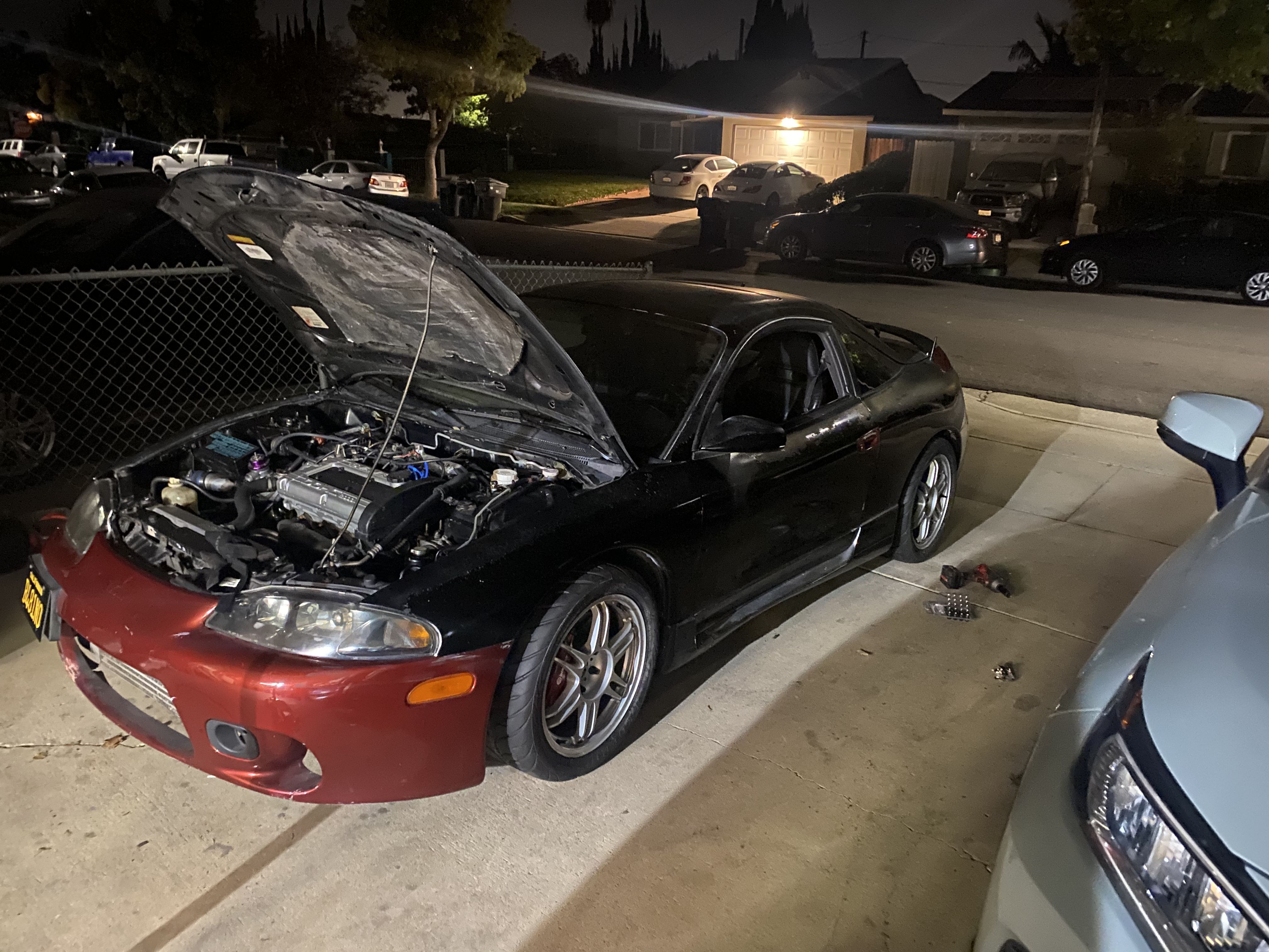

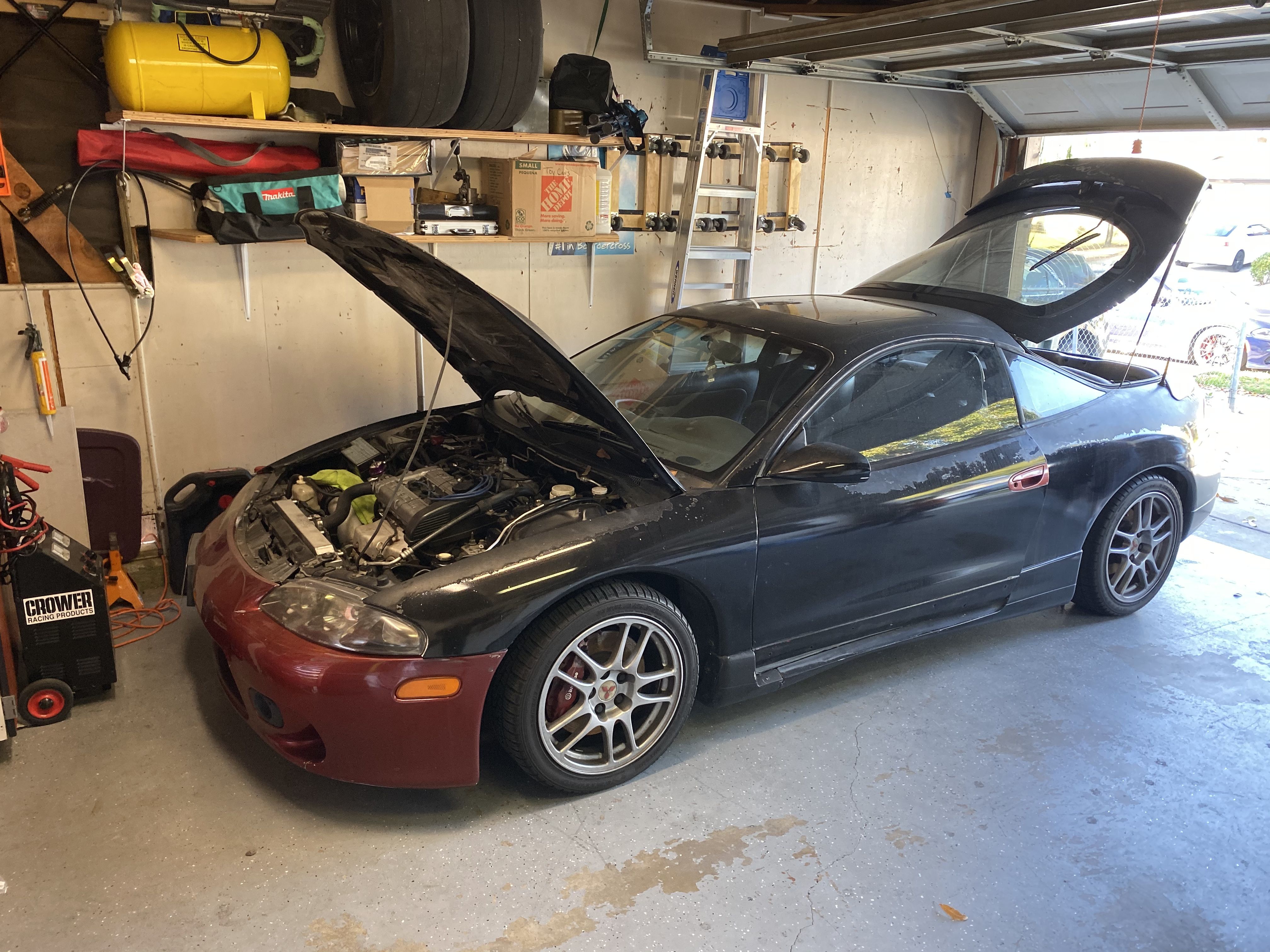

Got new tires and wheels federal RSR R 255 40 r17

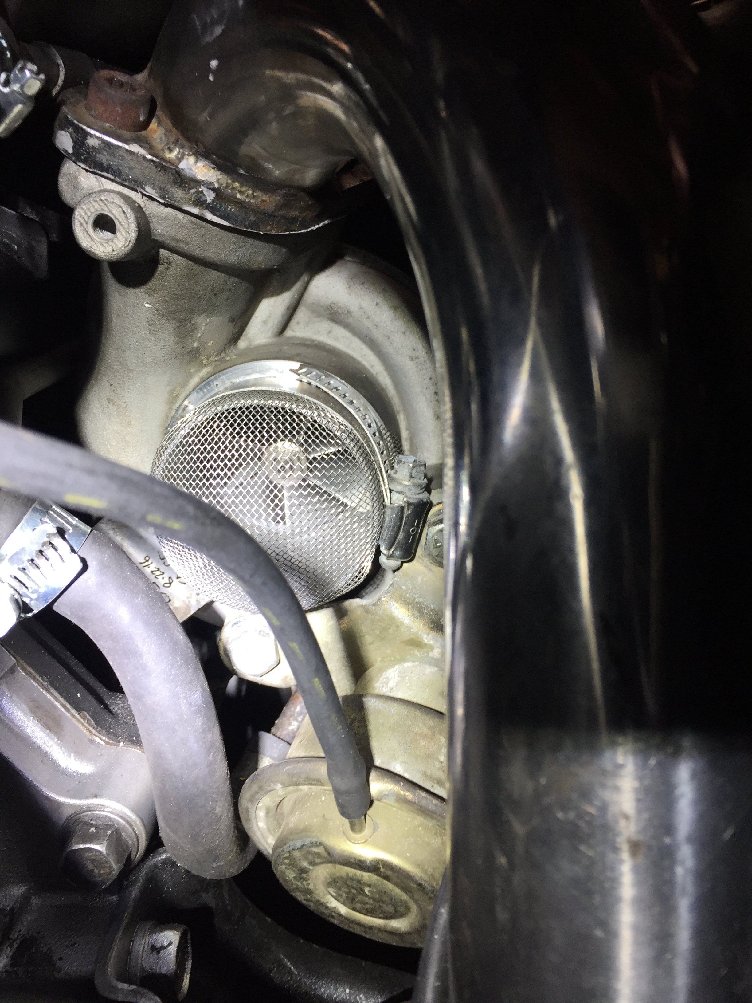

Finally took it for a ride now just waiting on the ETS intercooler and fab up a and intake pipe for now I installed a wire mesh to protected from any debris.
