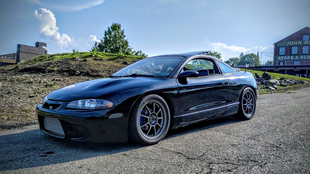

Eagle Talon TSi
Future 20g fwd road car, restore and build

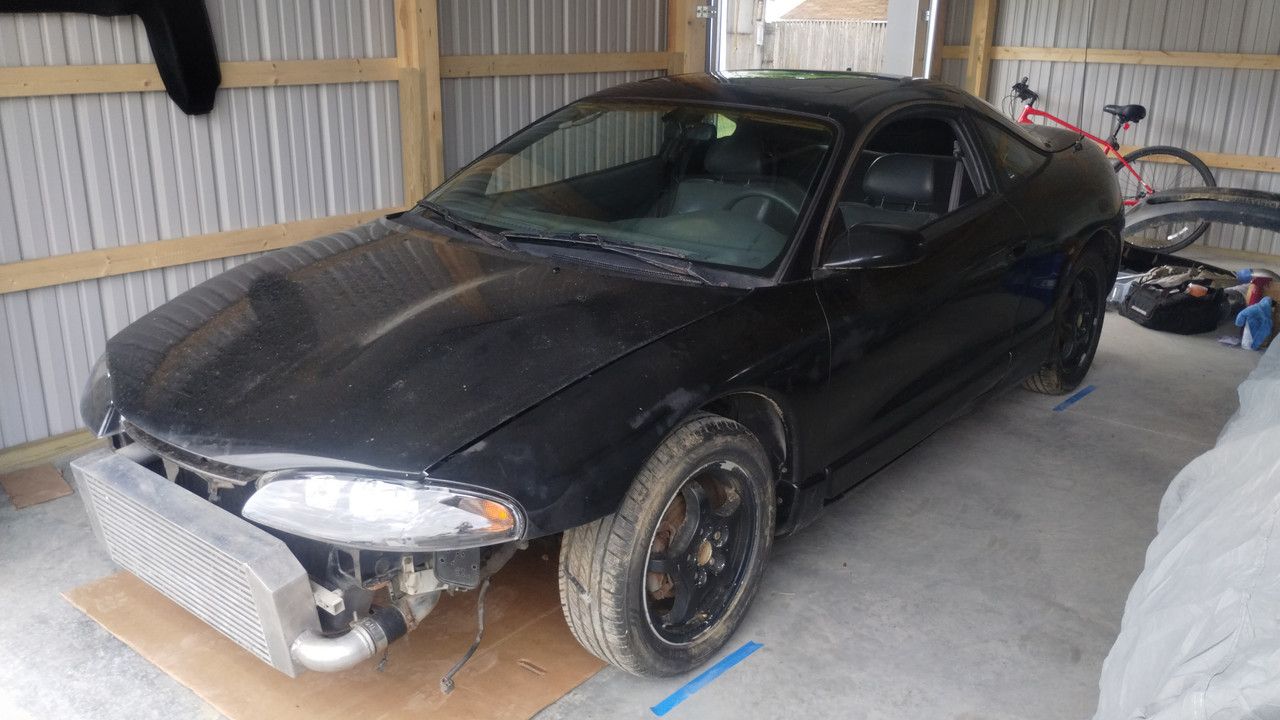

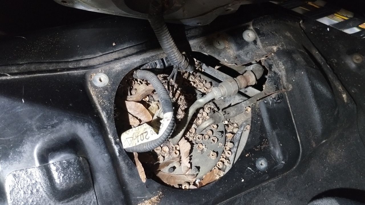

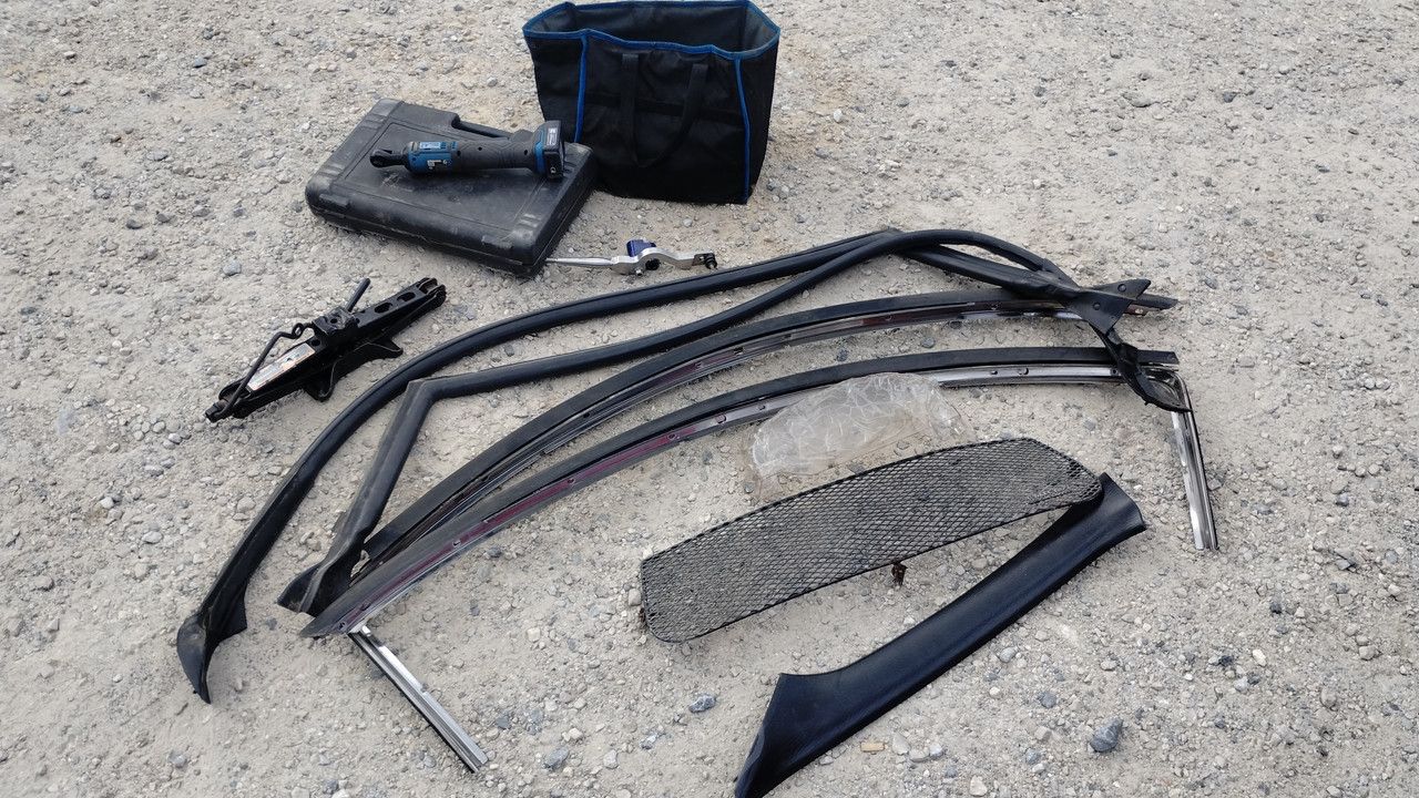

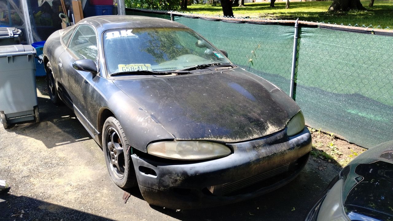

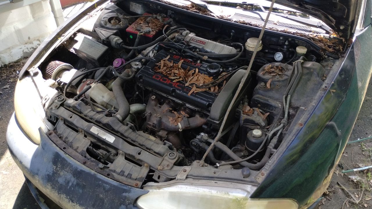

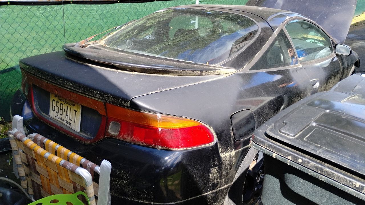

Junkyard haul! $14 :)

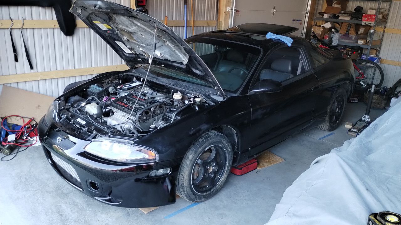

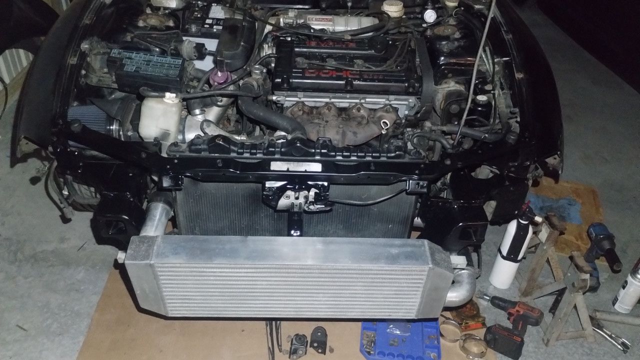

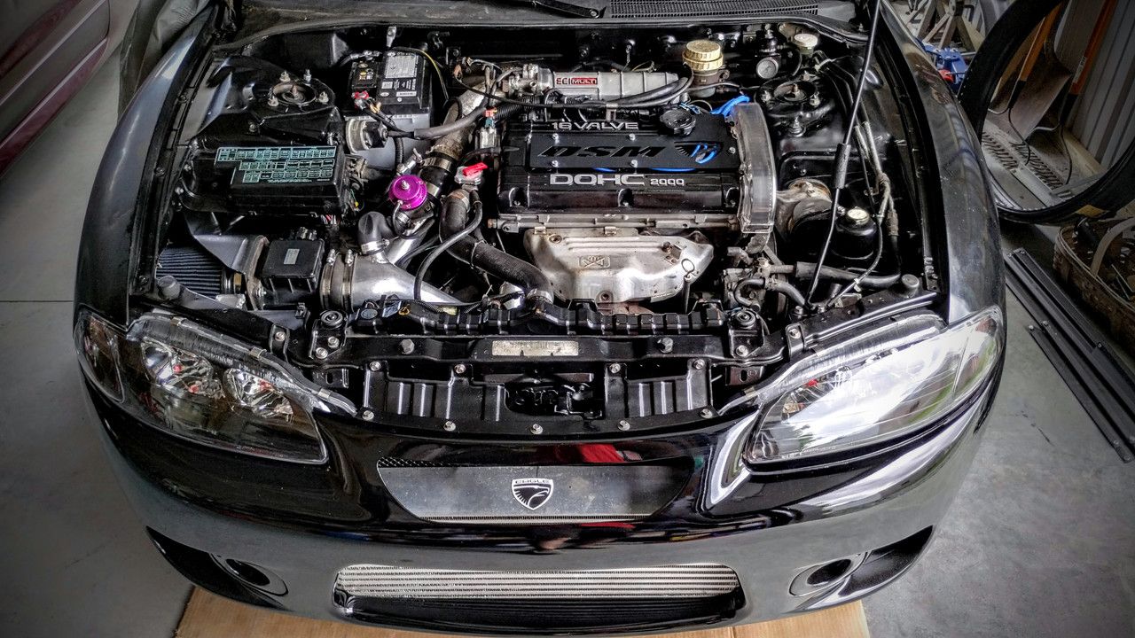

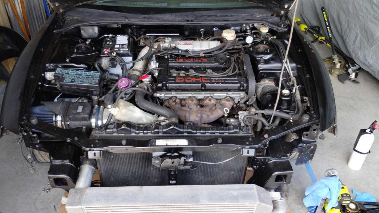

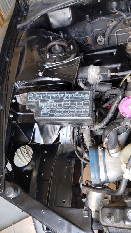

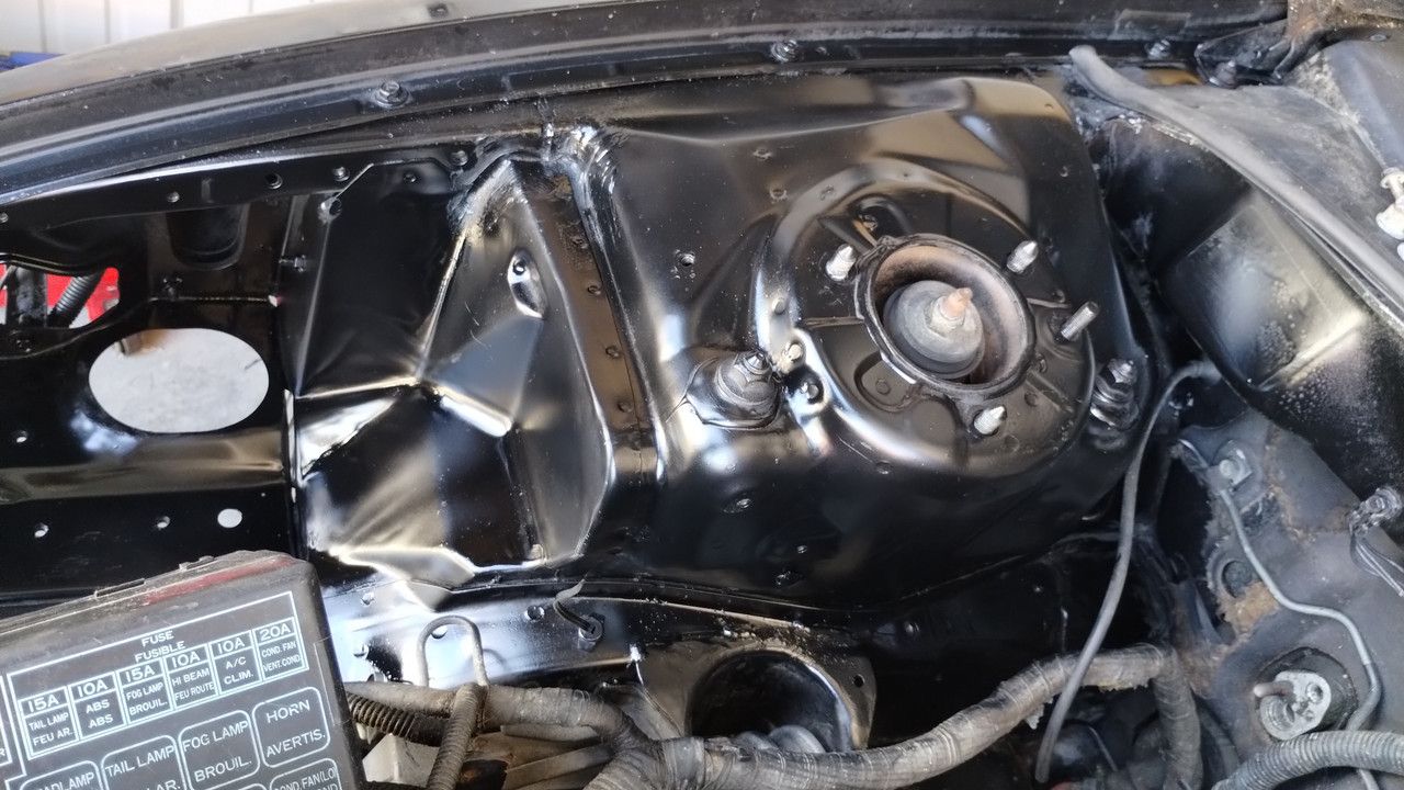

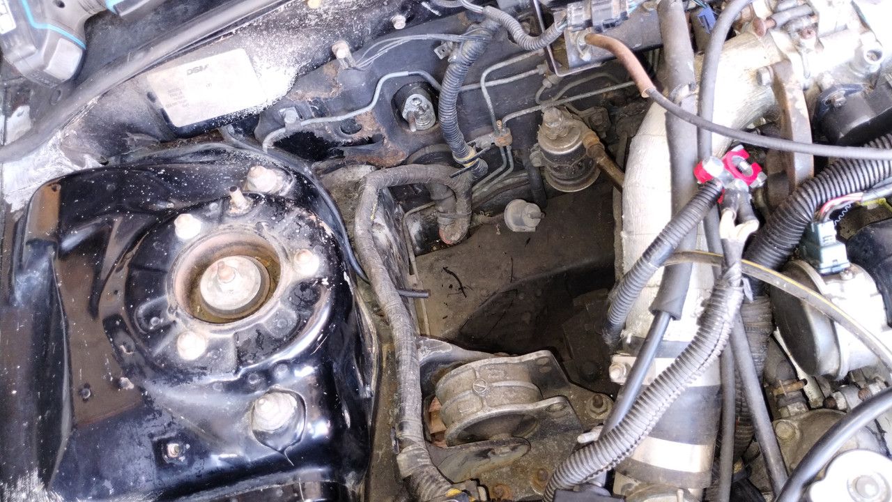

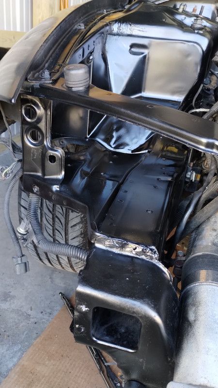

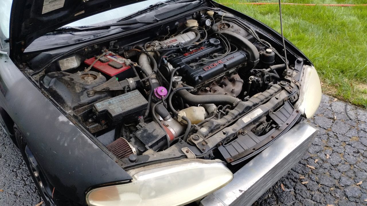

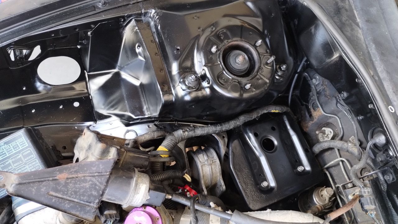

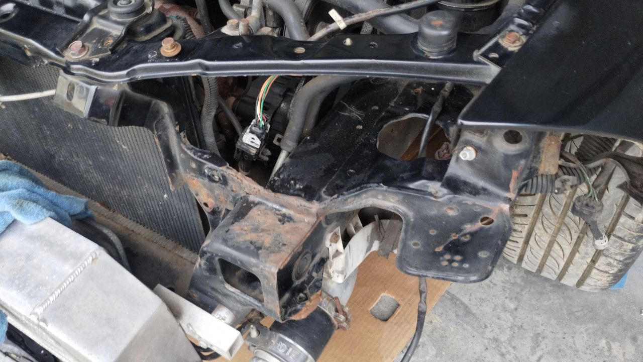

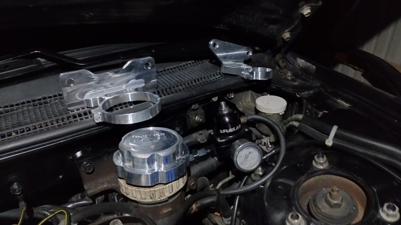

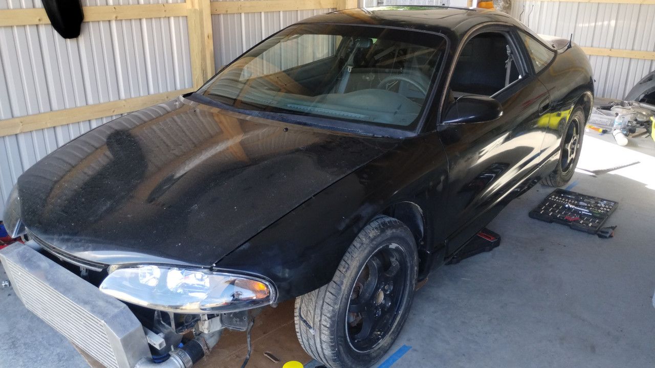

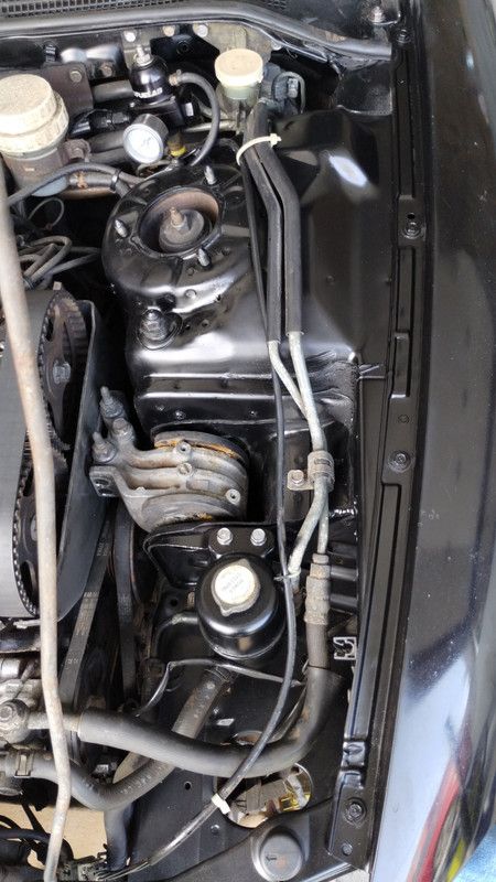

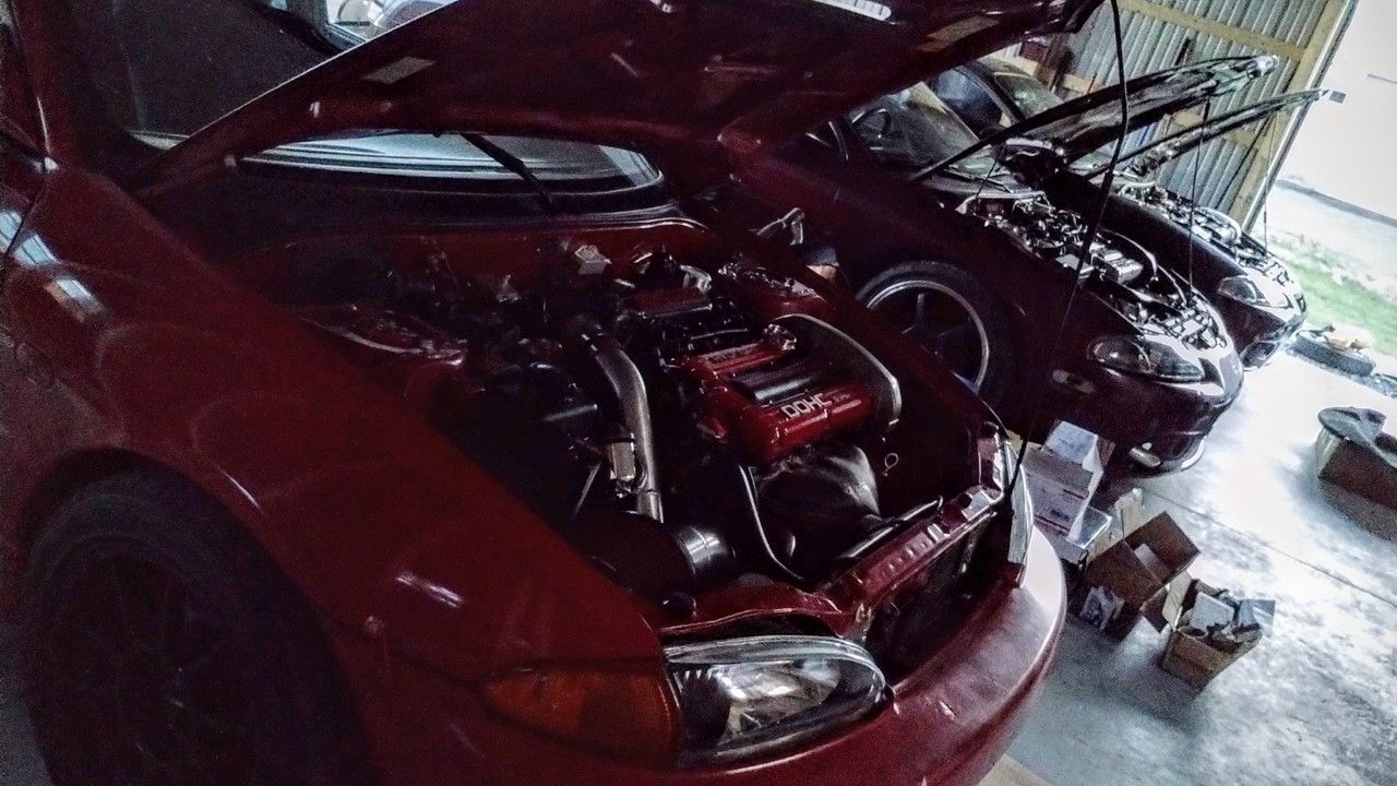

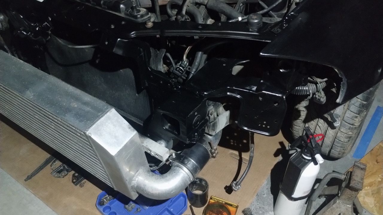

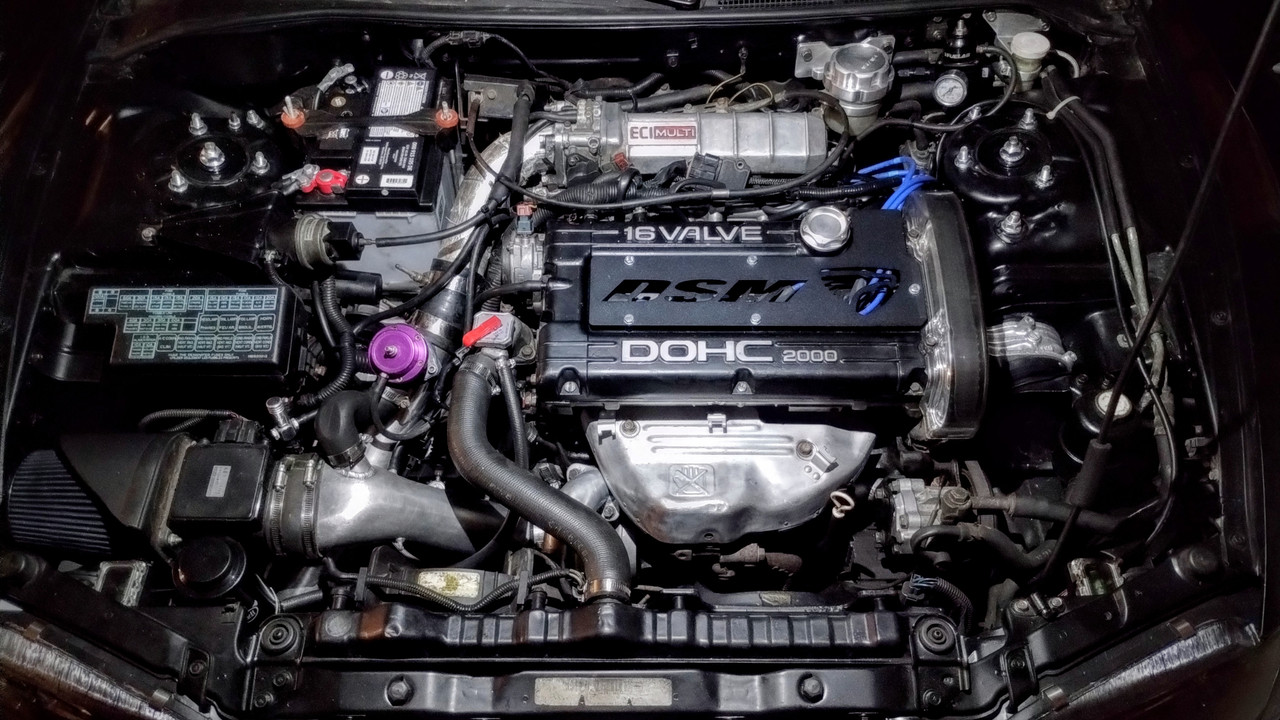

Cleaned up the front of the bay

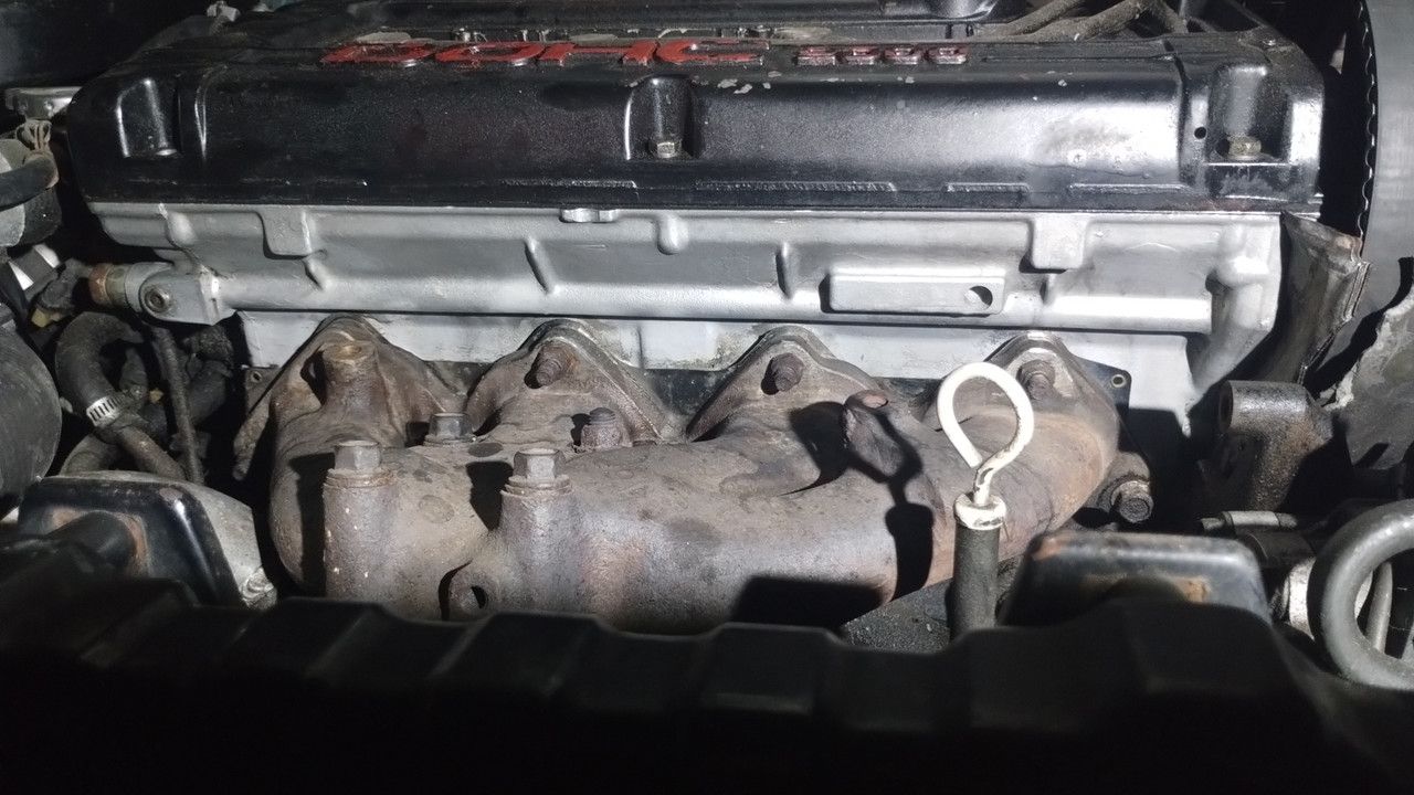

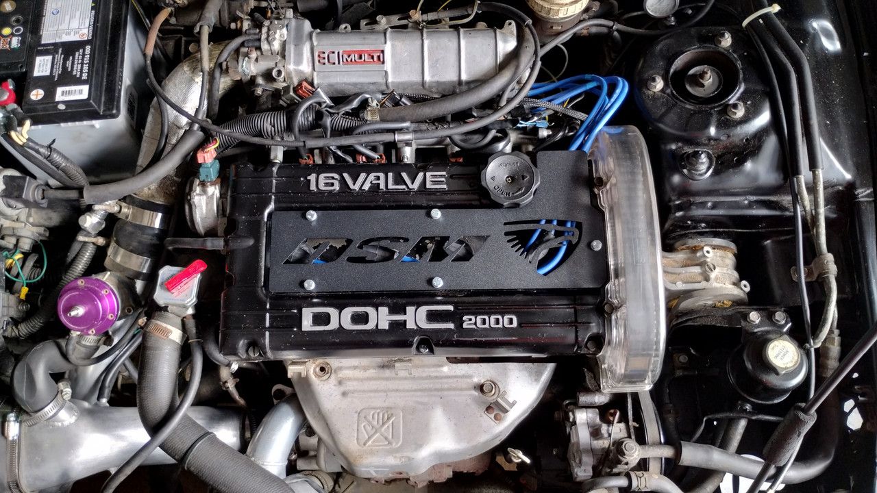

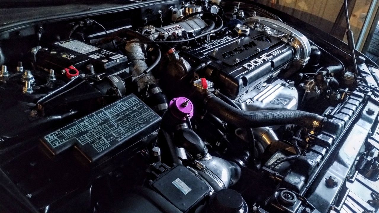

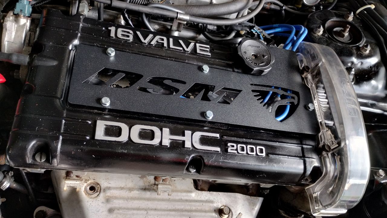

Cleaned up the head

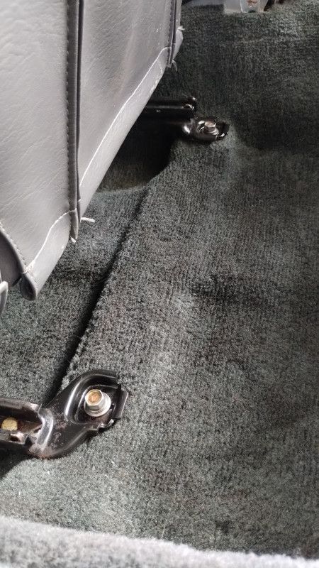

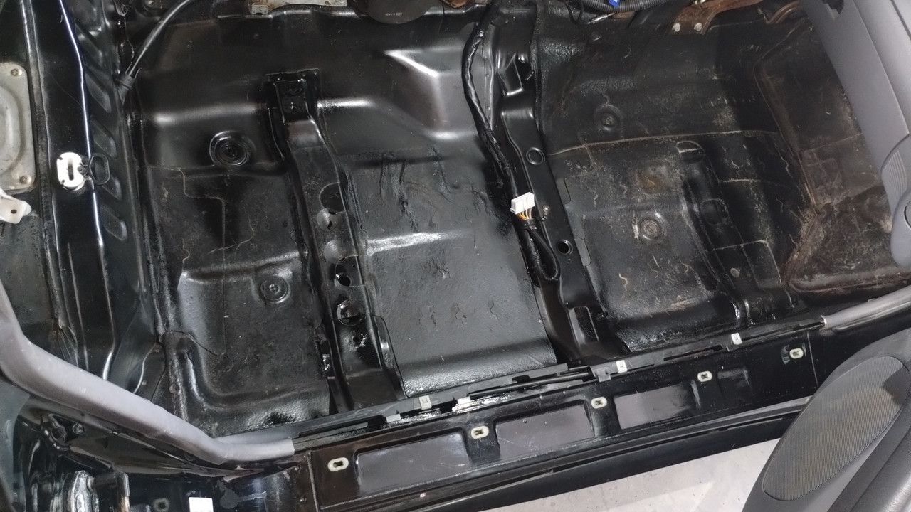

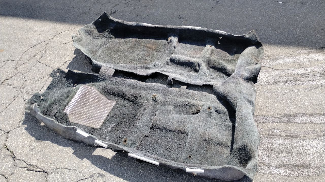

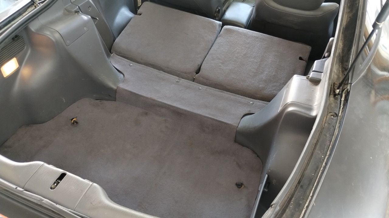

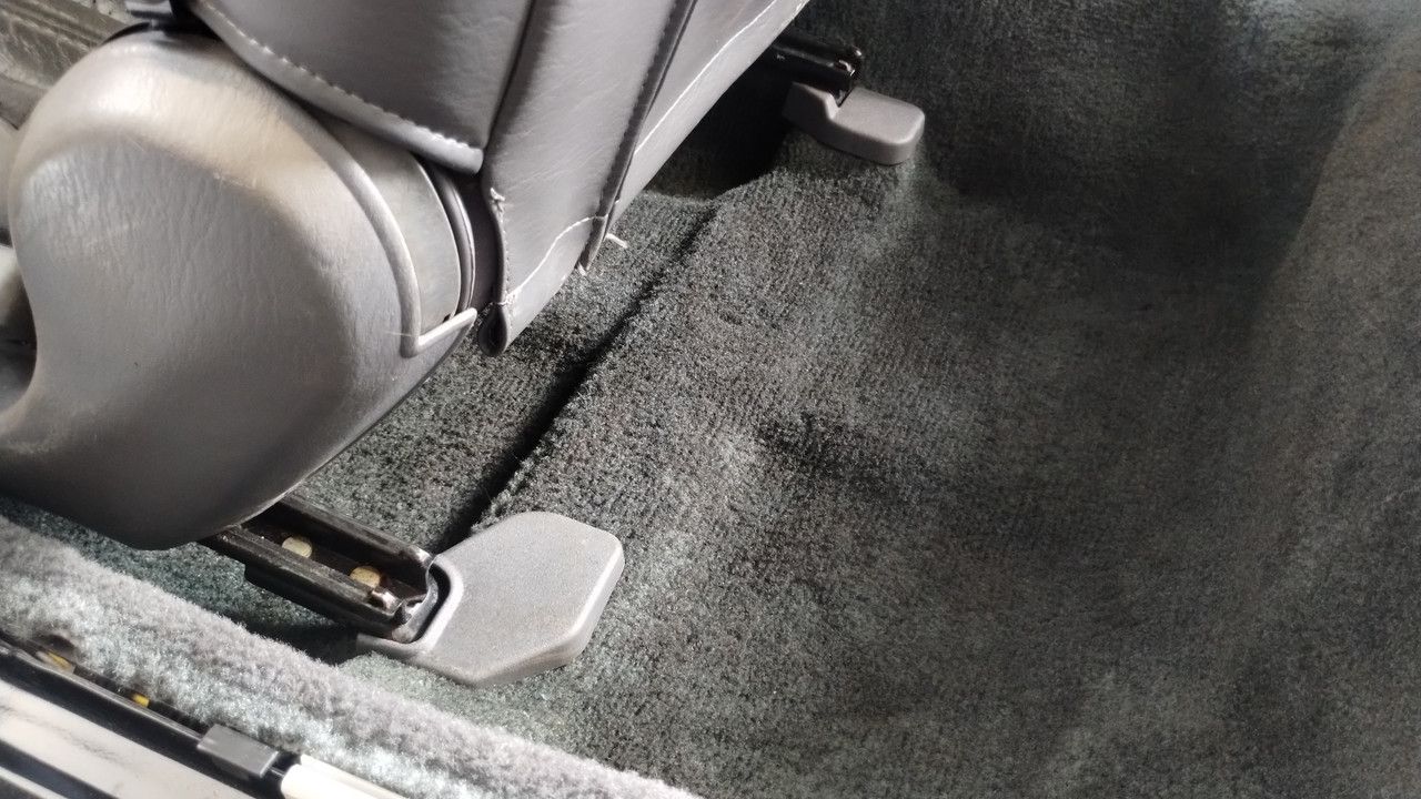

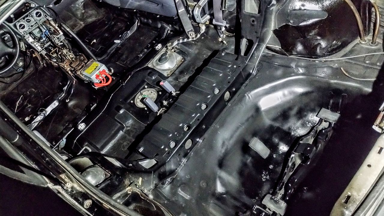

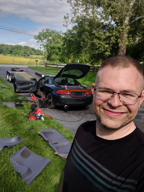

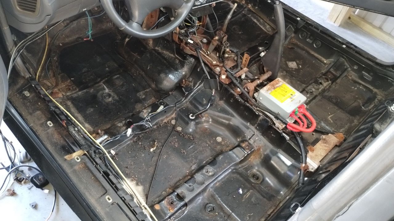

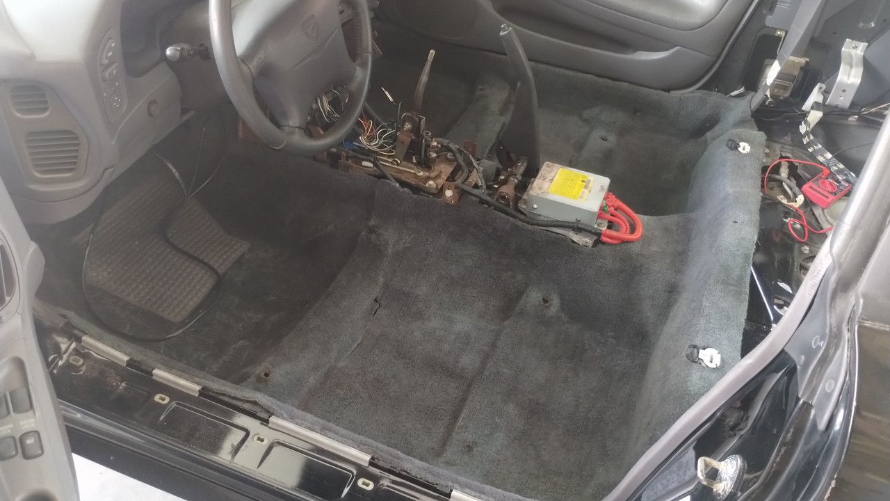

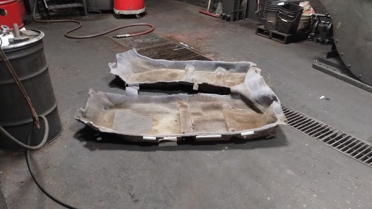

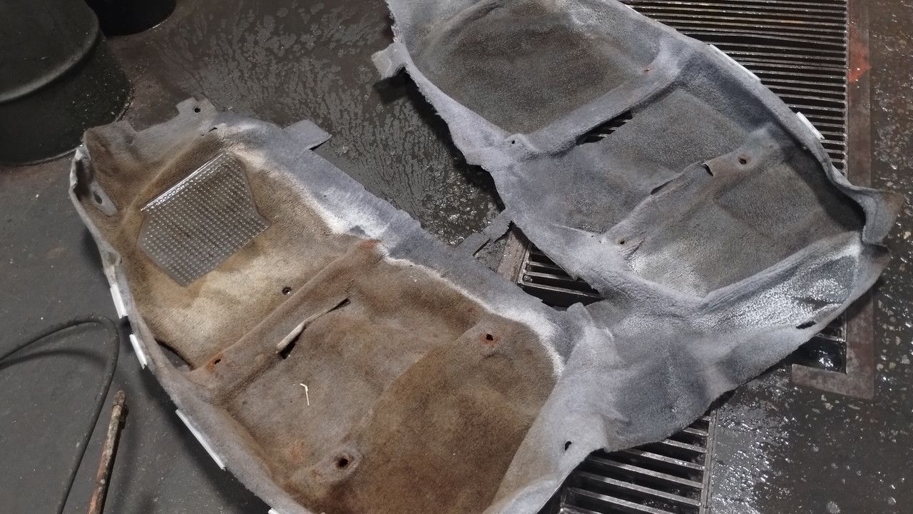

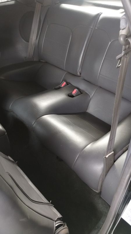

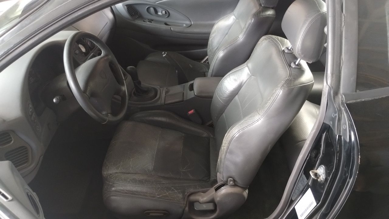

Carpet and seats back in, all clean

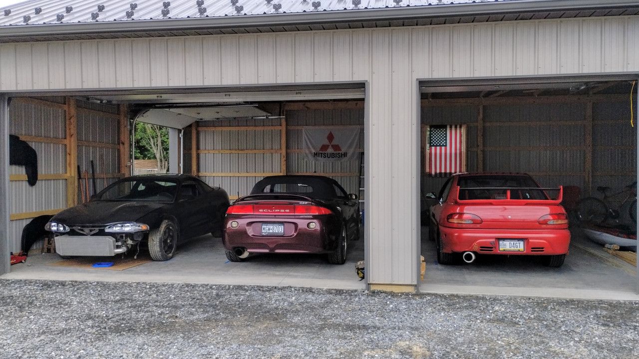

I also built a new DSM Garage :)

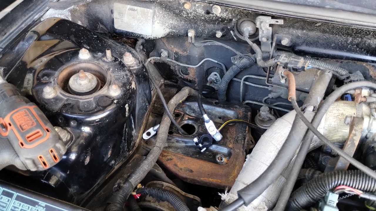

Dead Wally 255 out, cleaned all that up

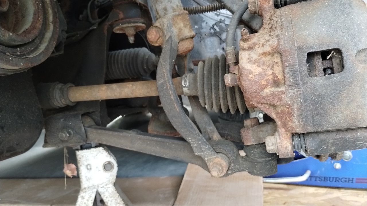

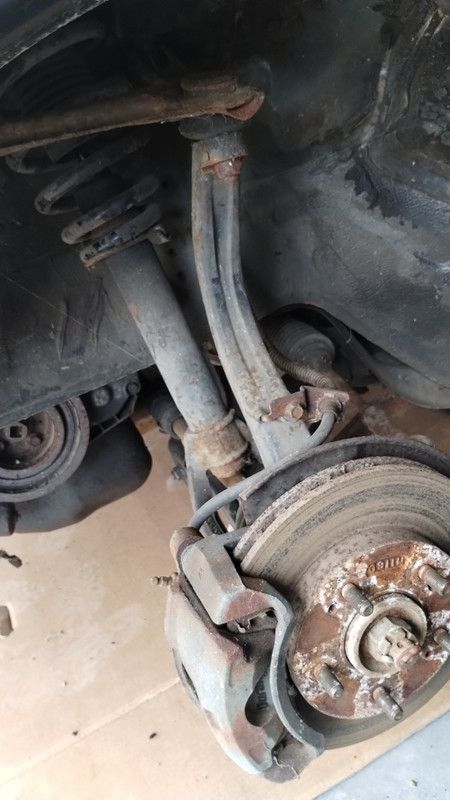

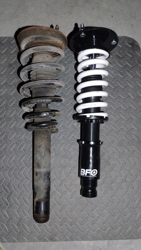

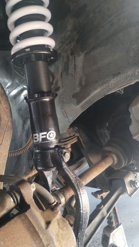

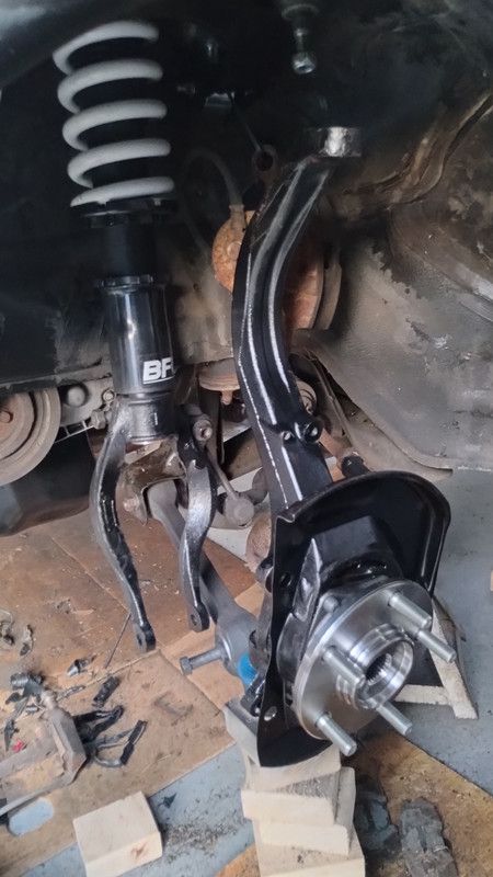

Susp check for rock auto order

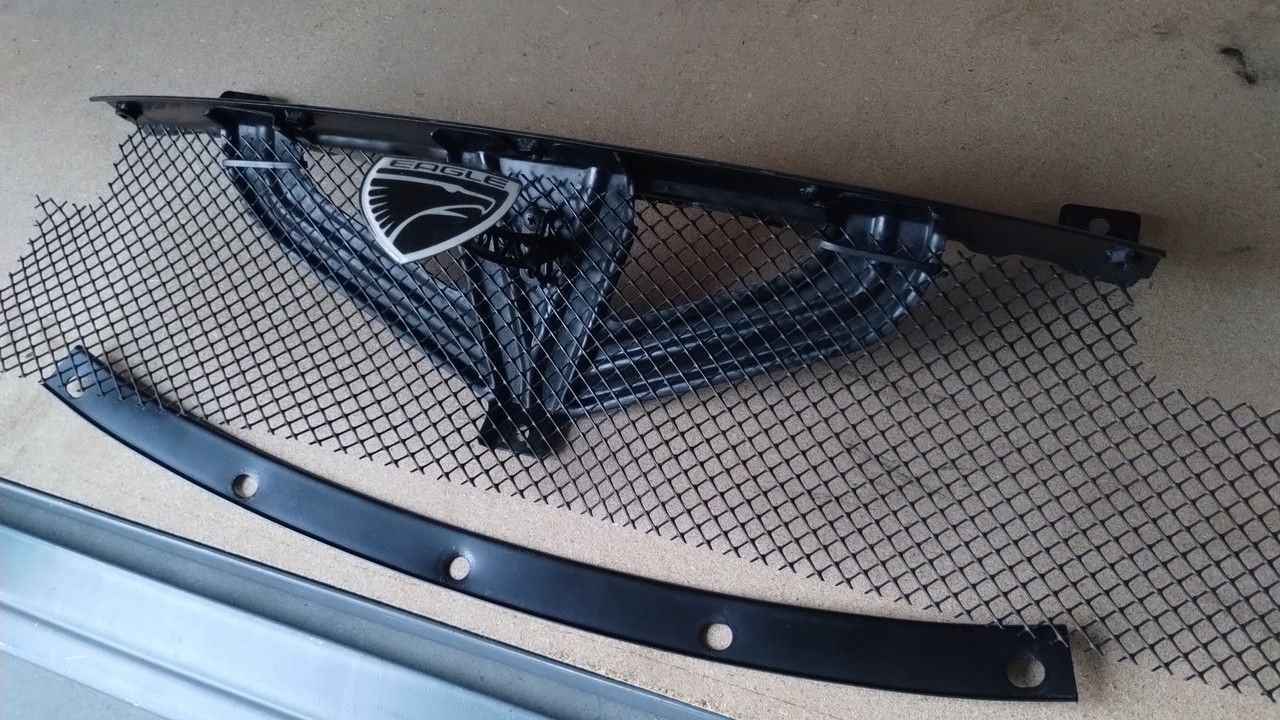

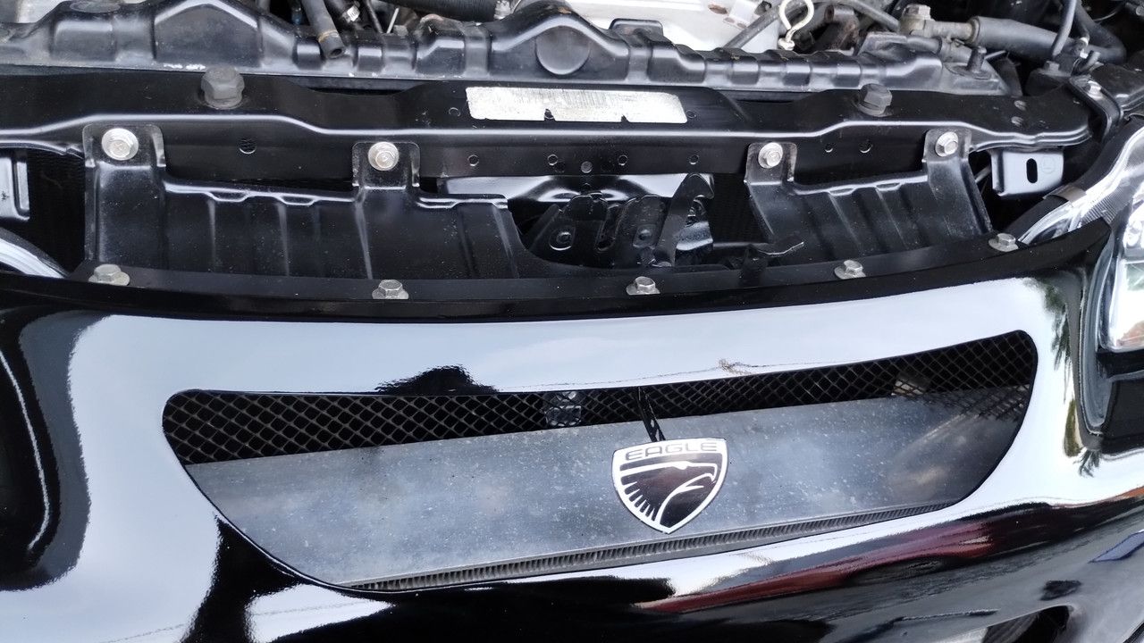

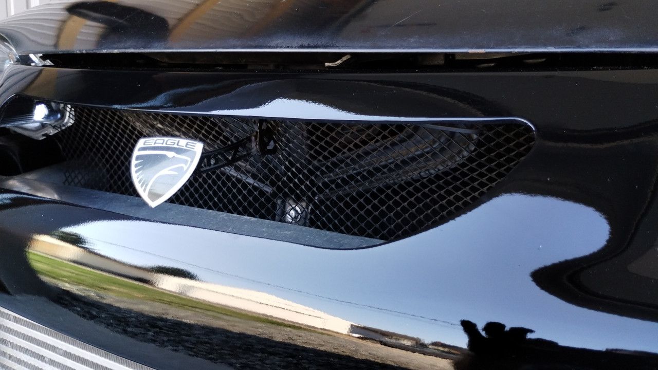

Fresh front grille and badge to keep it eagle, from my oldddd talon :)

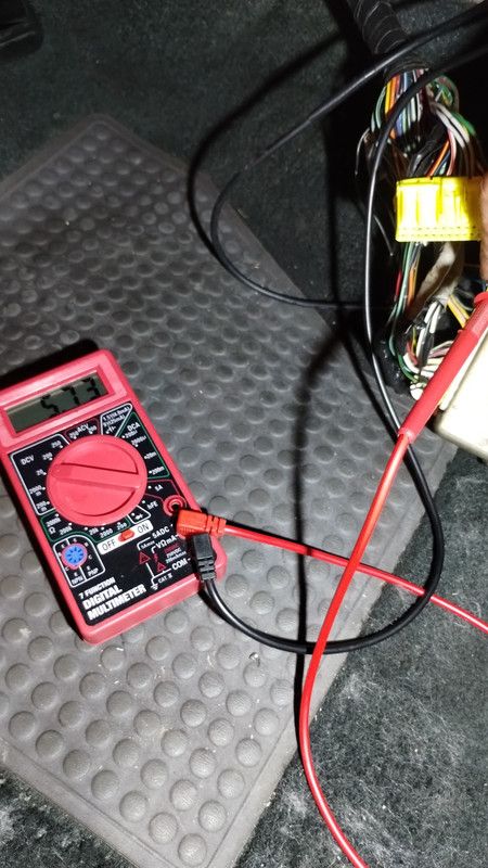

Car is STILL has a crank, no start condition. Has been since I got it. It ran and drove when parked. I have driven the car myself before. It's fully tuned on link V3. I've already begun yelling at it and punching it. I hit my funny bone on the E-Brake last night really bad and now today my arm still feels pins and needles. This is NOT going well. This is why people get rid of a DSM.

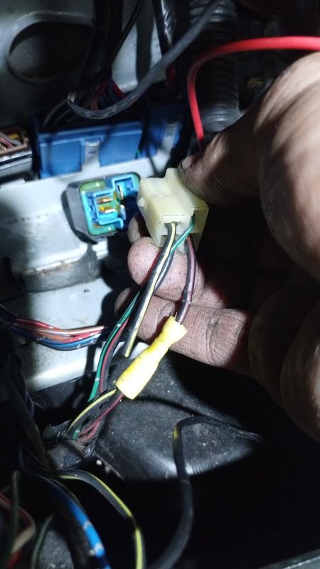

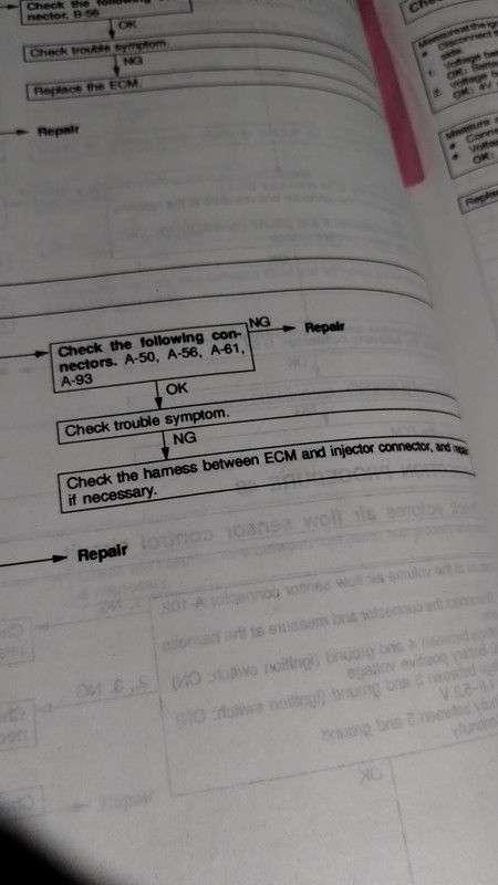

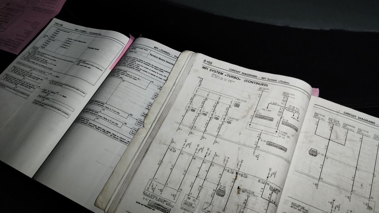

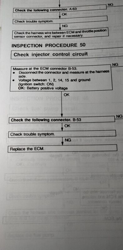

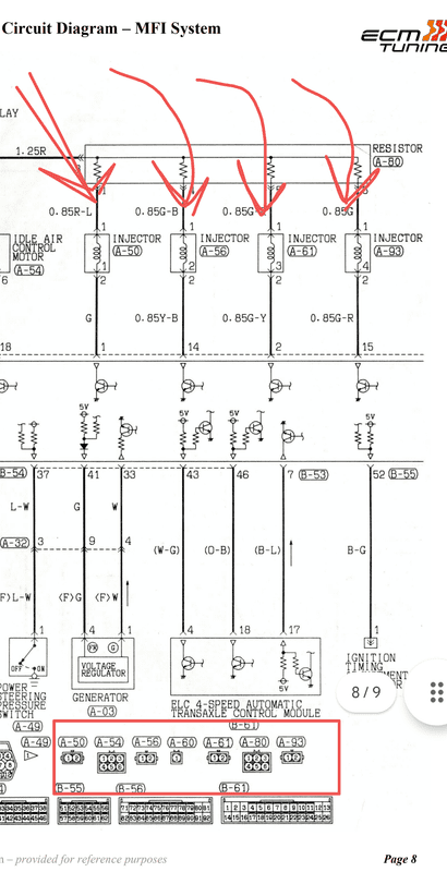

I have spark on at least #1 inj. I have no fuel. At all. Inj refuse to pulse. I had to learn wiring diagrams and how to diagnose with my 1995 talon FSMs.
It failed Diag testing @ required 12v (battery power) reading @ key on, ECU connector off, pin 1,2,14,15 and ground. It's 5.7ish volts, at EVERY ecu pin
Voltage at the inj pins is 12.2v on the same color wires, and 11.2v on the other end.
I'm stumped and now will have to pull out the entire harness and rip it apart and replace all the inj wires, or put in my spare 2ga harness that I don't want to wast on this car.
Prolly gonna close the car up, cover it, and forget about it. I have 2 other 4g cars and this one isn't needed. Absolutely NOT HAPPY ABOUT THIS.

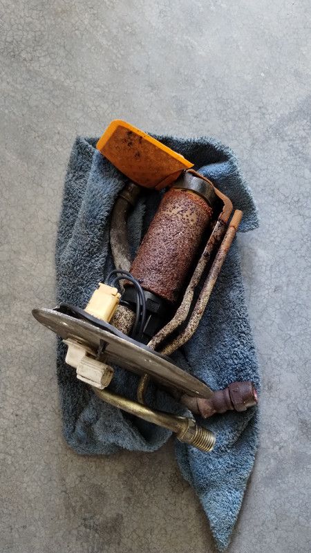

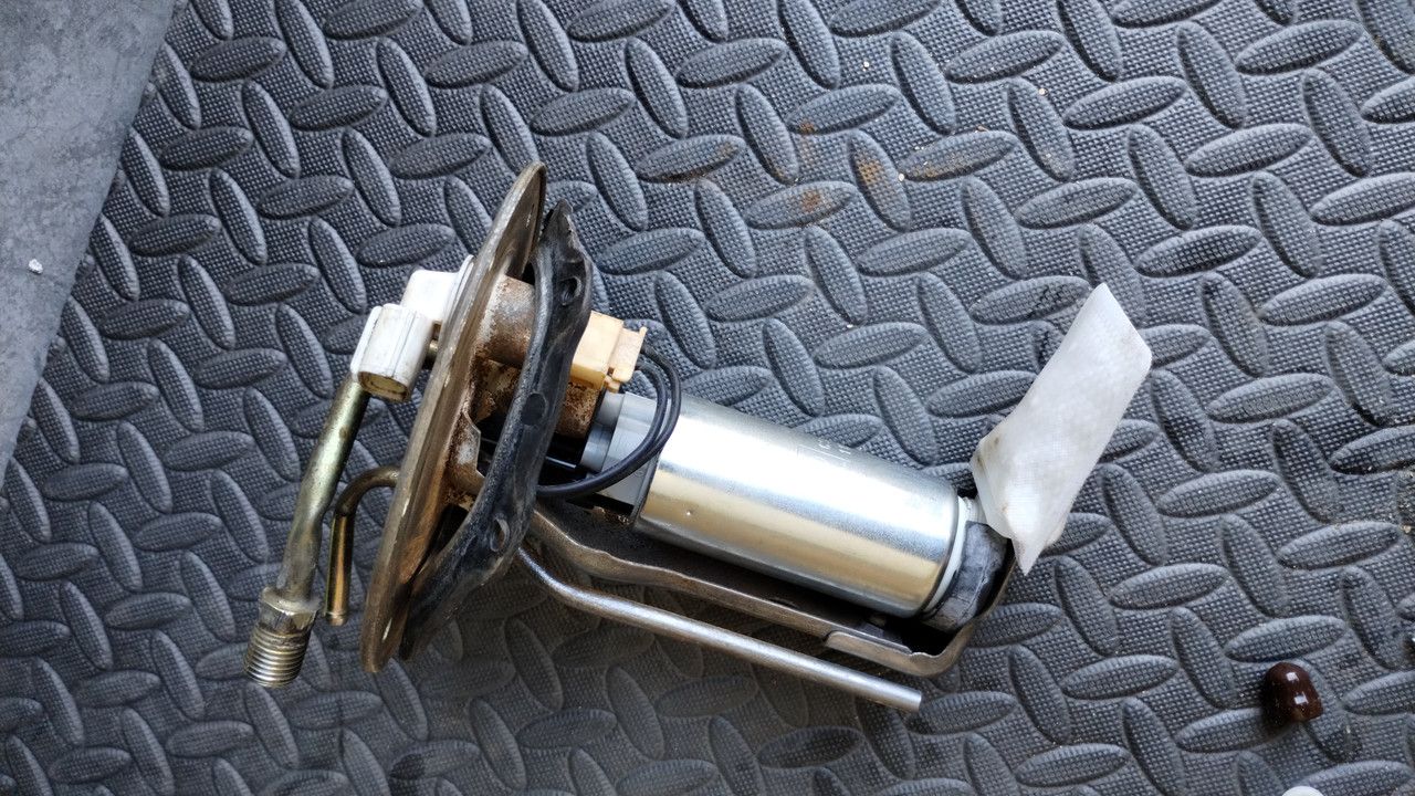

Injectors were clogged. I redid the rail and swapped injectors and the car fired and runs and idles now.

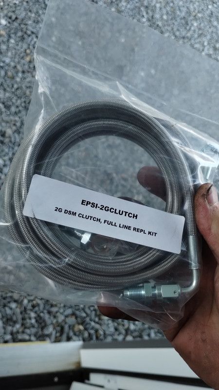

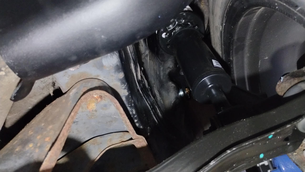

Slave cyl appears shot so I'm doing one of them as well

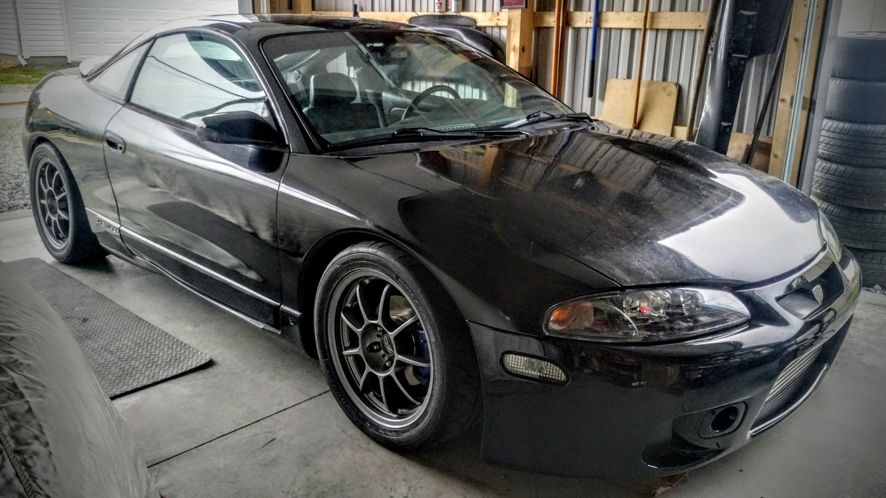

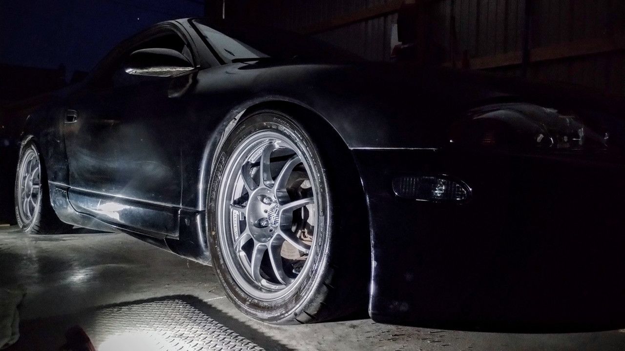

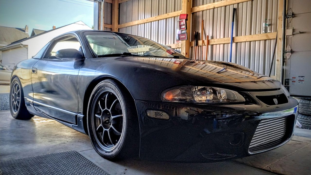

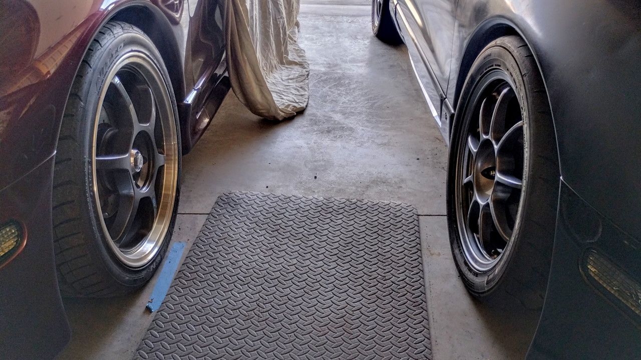

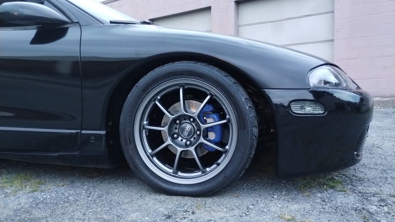

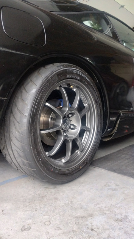

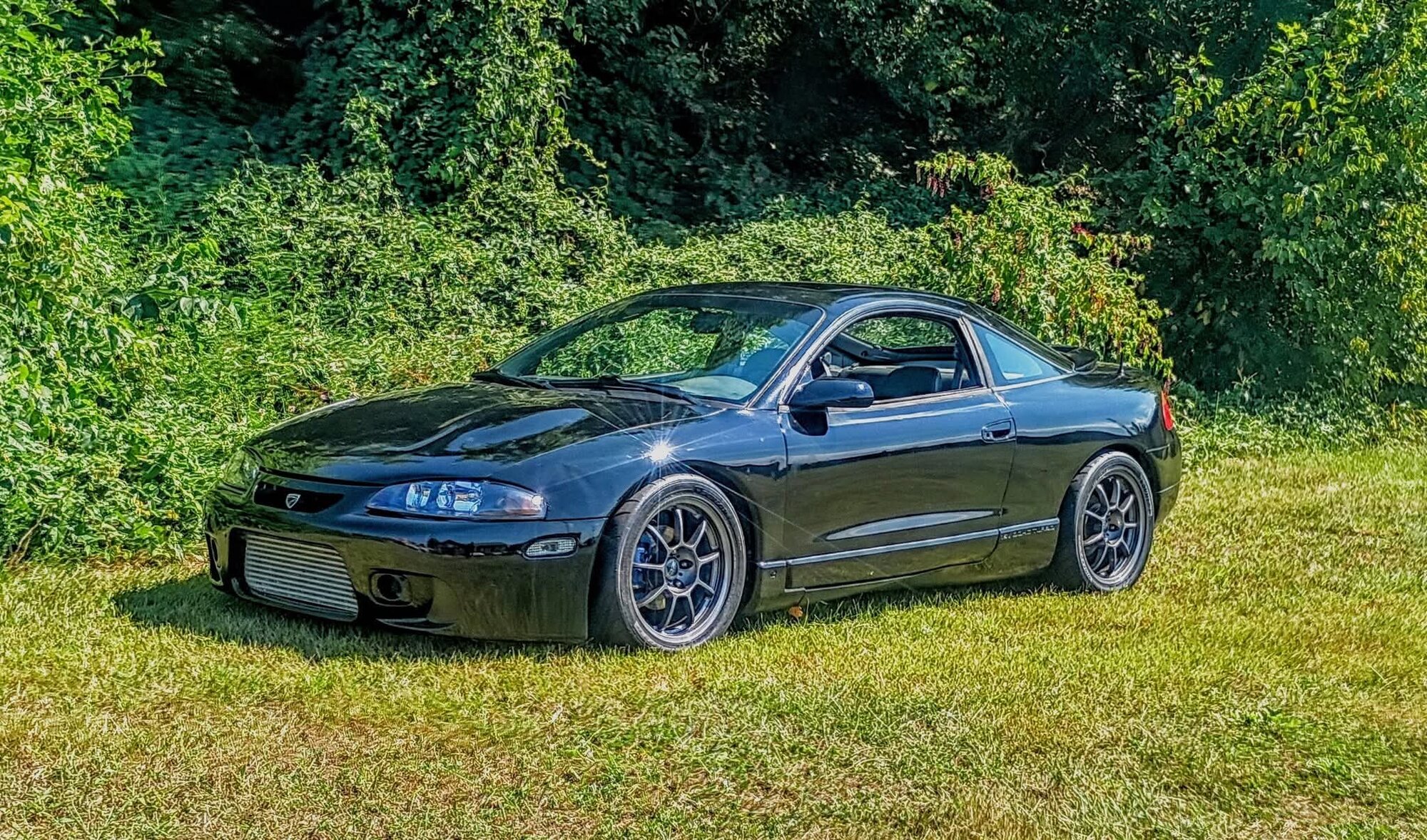

255/40R17 et35
OZ Aleggerita HLT (Flow formed) Italian made wheels.
No camber adjust. No rolling. Just dropped down to get fitment started.

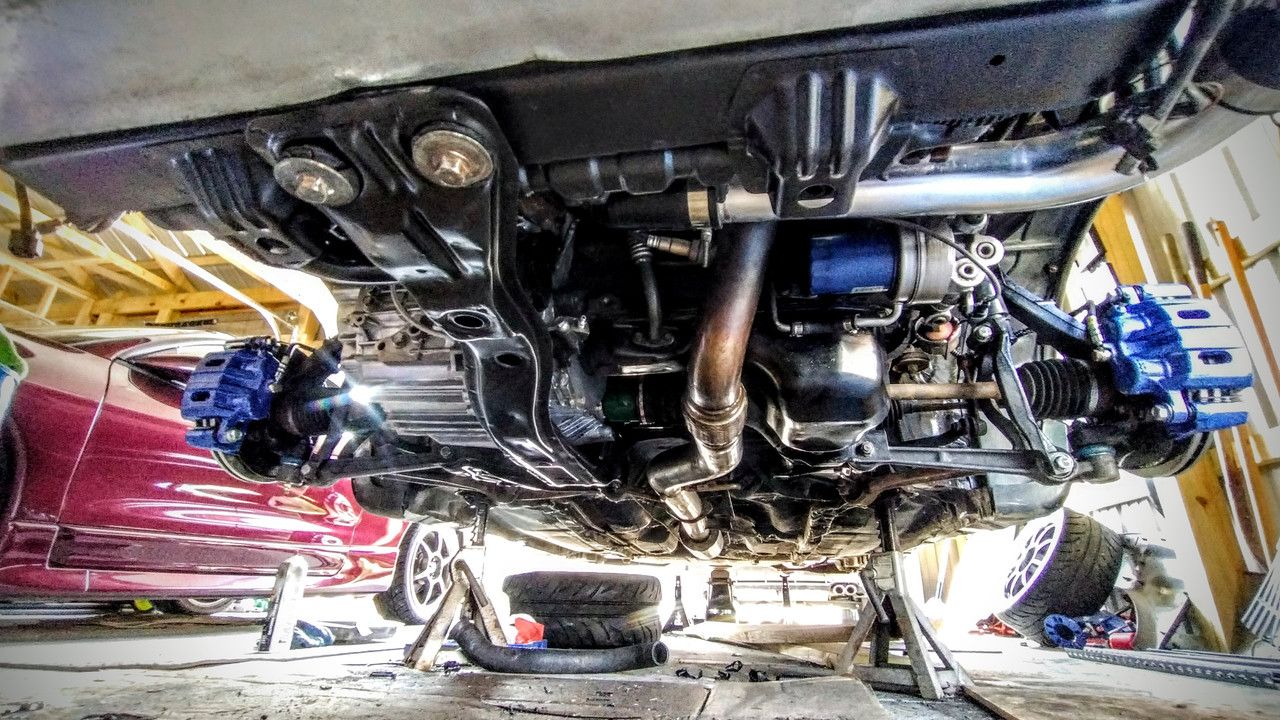

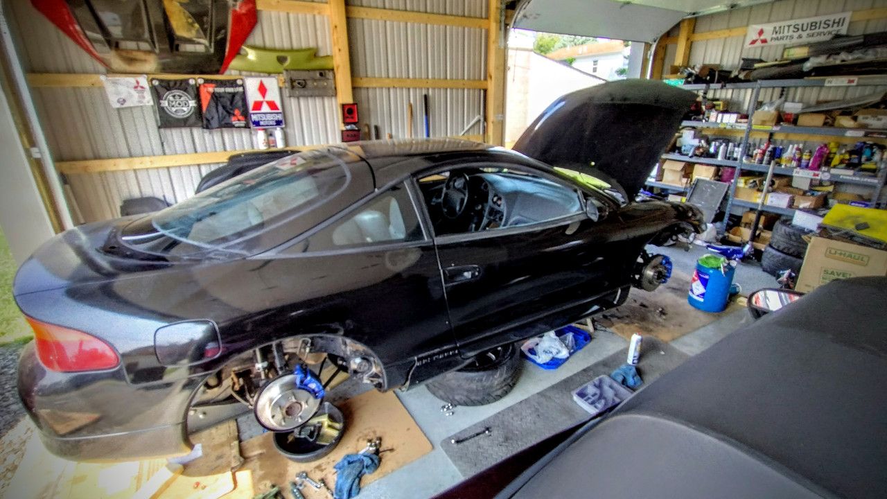

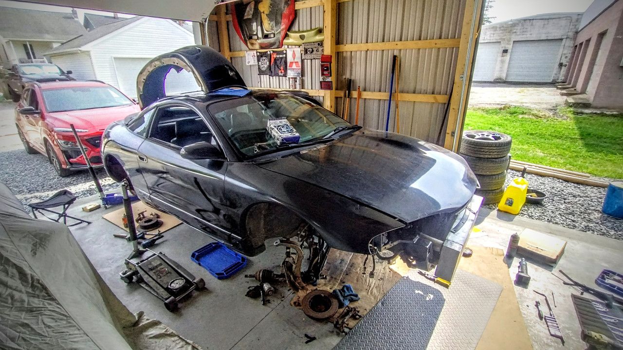

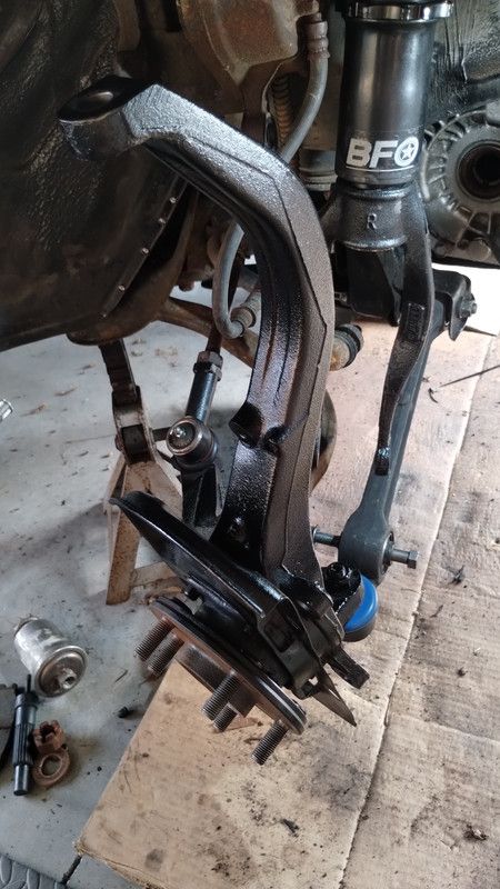

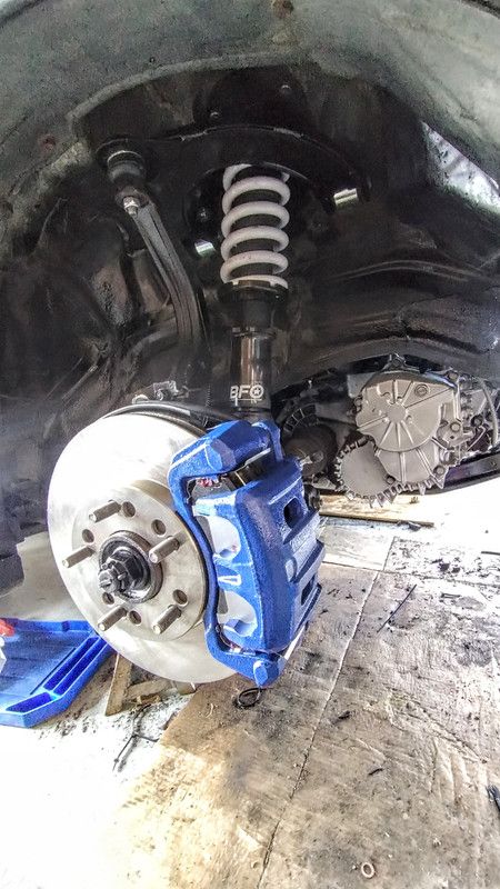

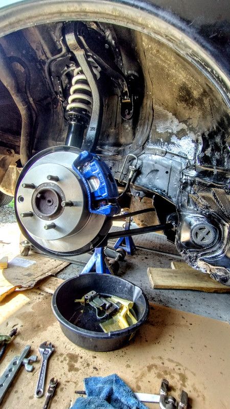

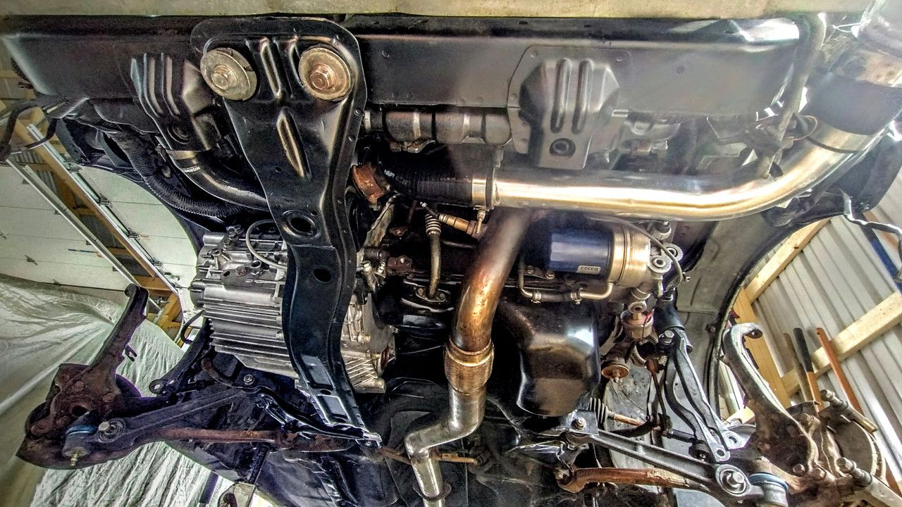

Lot more work been done, here some updated pics. Brake work this weekend then back down. I had to drop the trans, PP was collapsed, so I just redid it all

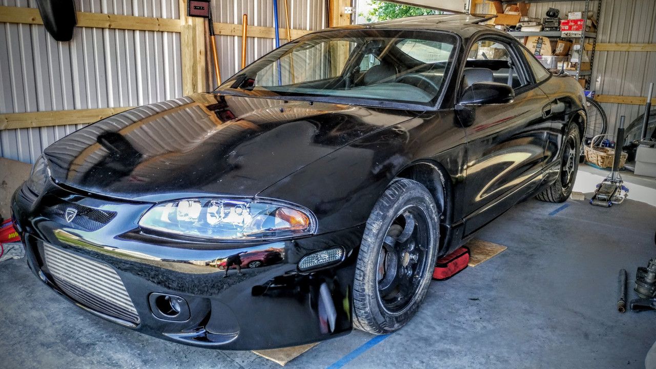

Took some pics. I can finally sleep at night.

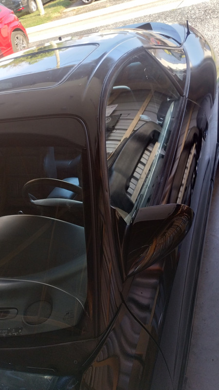

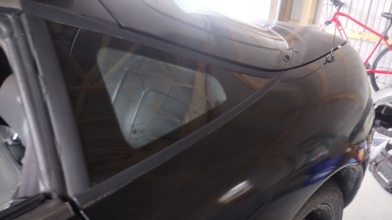

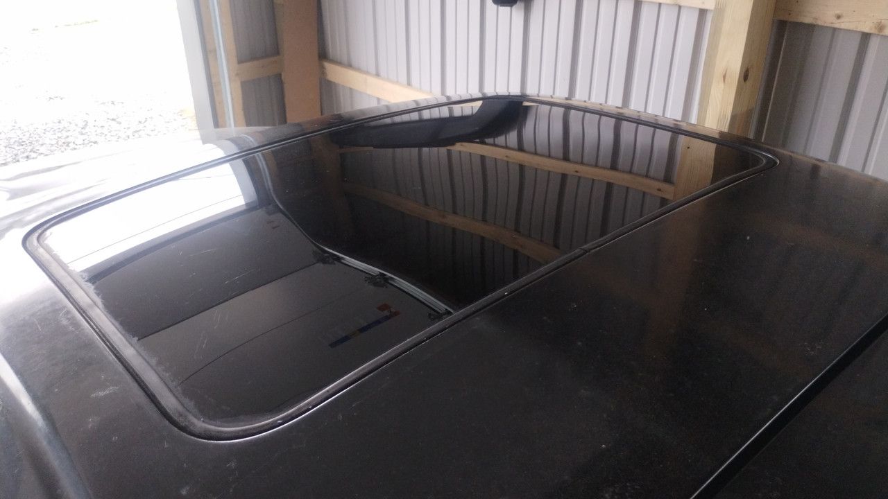

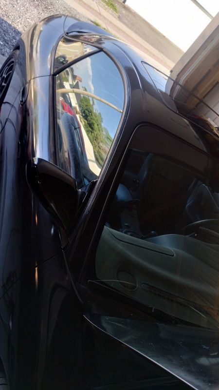

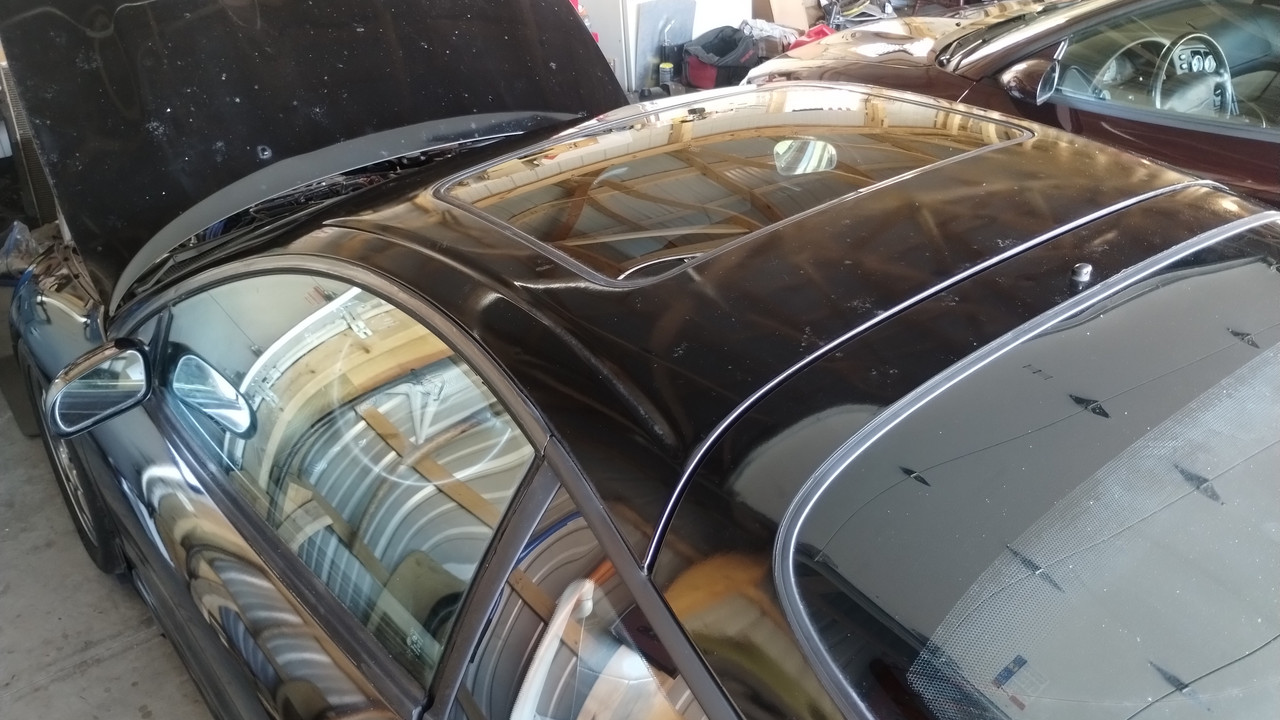

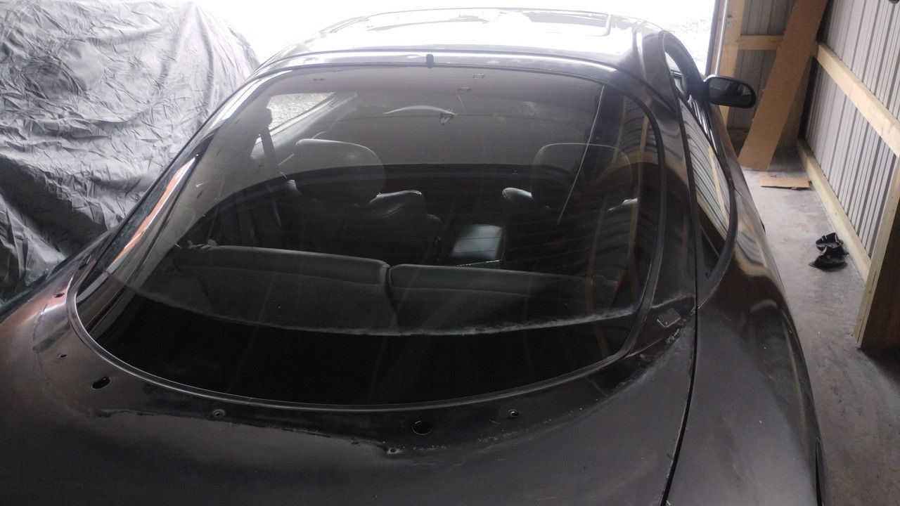

Got the top side buffed up. Just hitting other spots....there's spray paint, brush on paint......it's an entire whole mess, and I never used a buffer before :hellyeah:
It's fun.

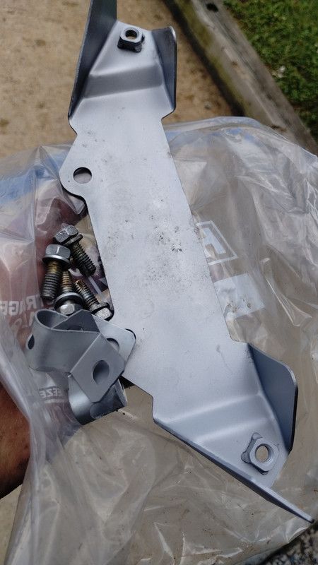

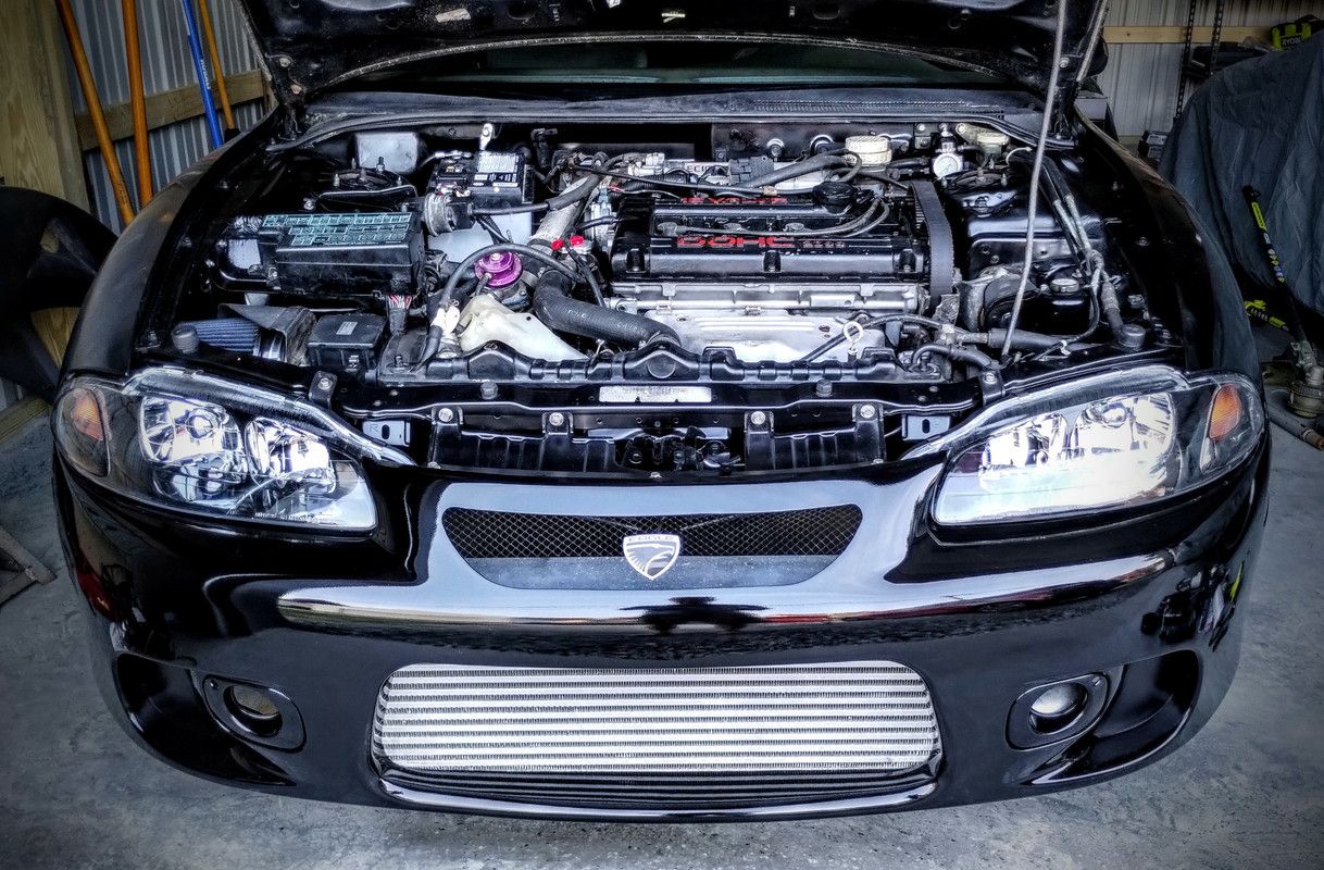

I ordered more BLT prep things. I also have a fitment issue with the TB elbow that I need fixed. I hate the VRSF uicp routing with the flange bolts. I'll have my welder guy make me something way better than this junk.

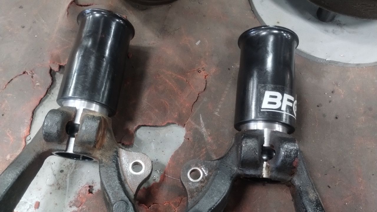

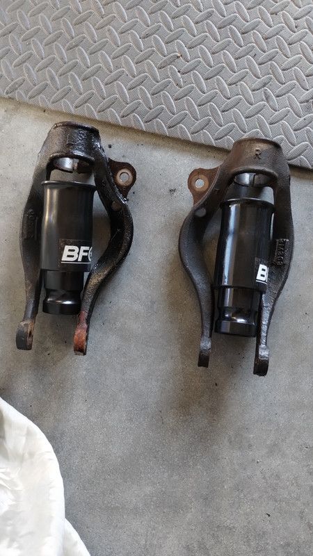

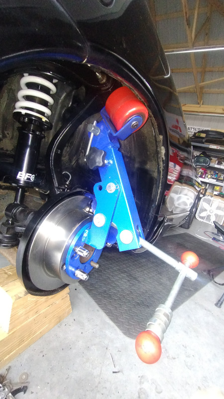

Ok so I was able to get some M10x1.25x30mm doorman flange bolts and I bought a box of thicker style m10 washer (100 pack, Hillman) to do the camber adjust on the rear. That went well.

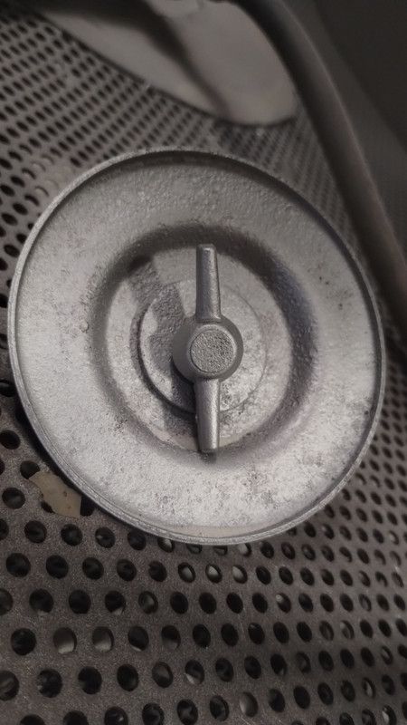

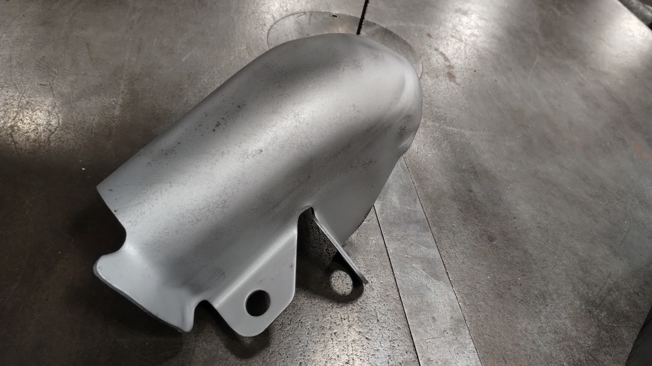

I rolled the DS and blasted and painted the filler neck cover as well.

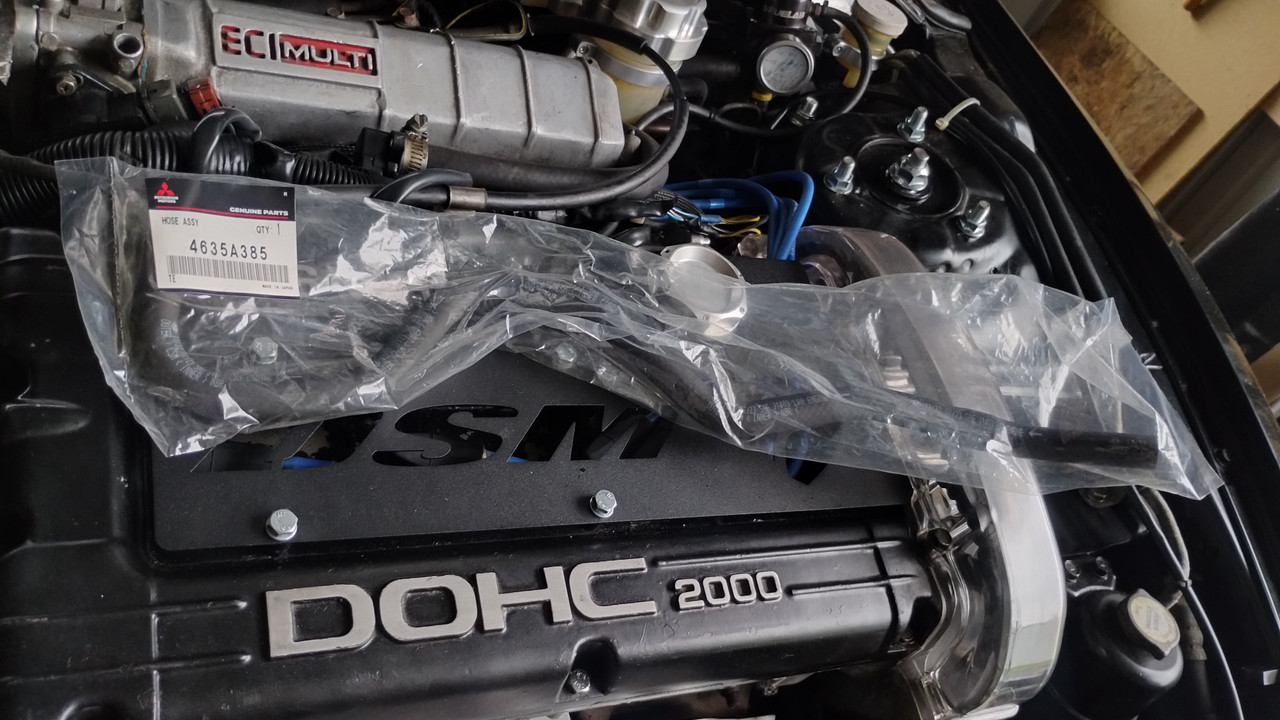

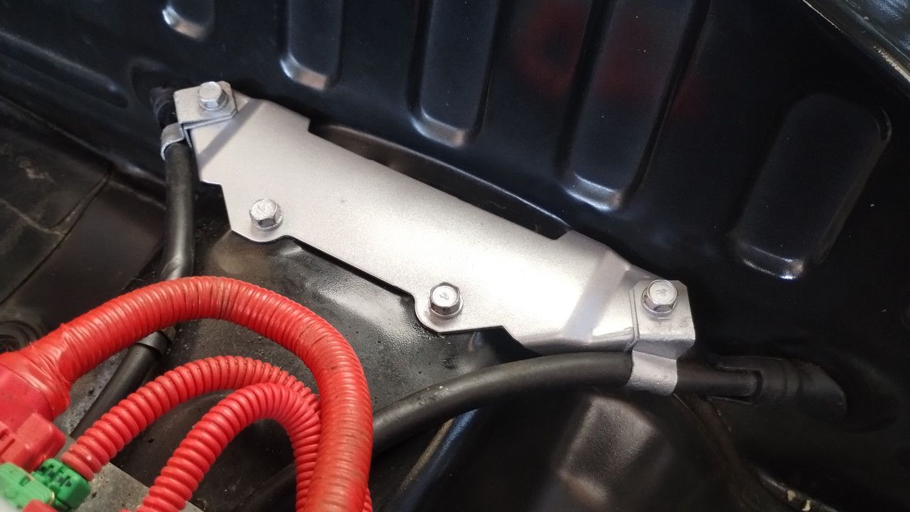

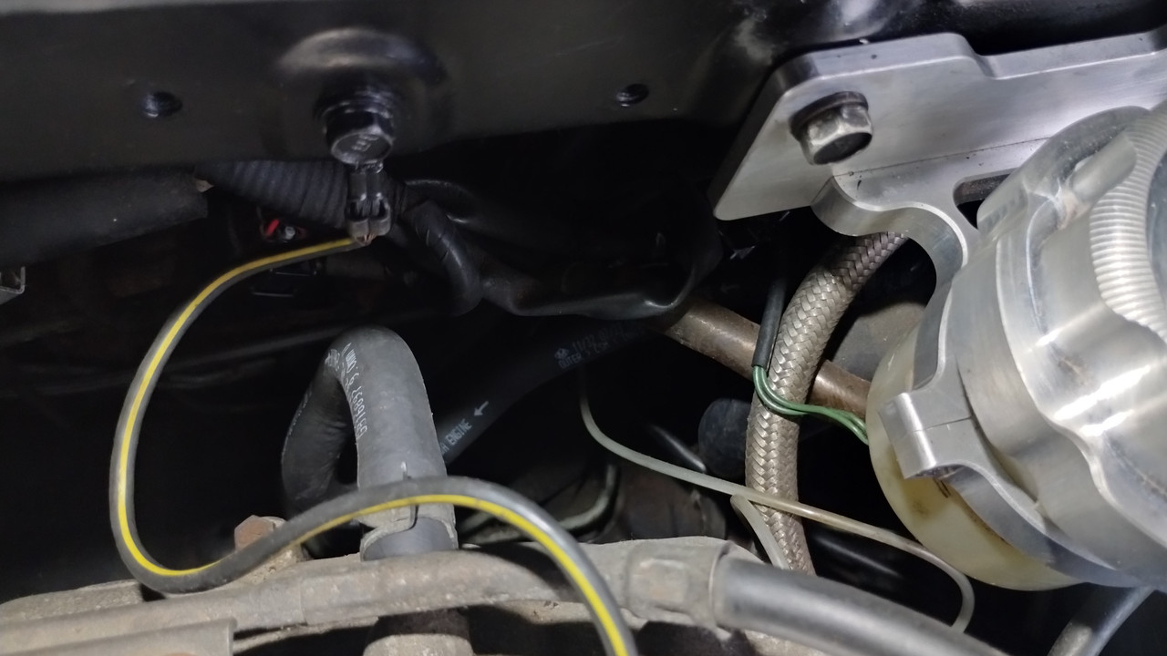

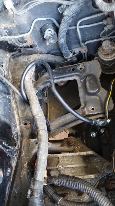

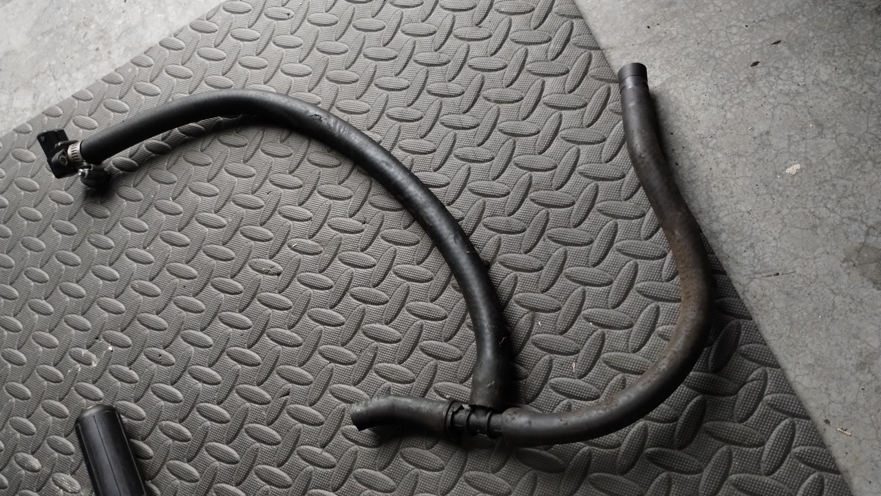

I yanked out the old brake booster vac line because someone T'd into it for the MAP SENSOR WTF. I bought a new OEM Evo I line and cut to fit. Cleaned that up nicely. I went out and got a reducer and shortened the hose on the map and ran that to the TB like my summit is. Soon I'll order the proper Extreme PSI adapter. I forgot to get that this time
I have a heat barrier TB gasket and new TB seals and a new BISS to go on as well.

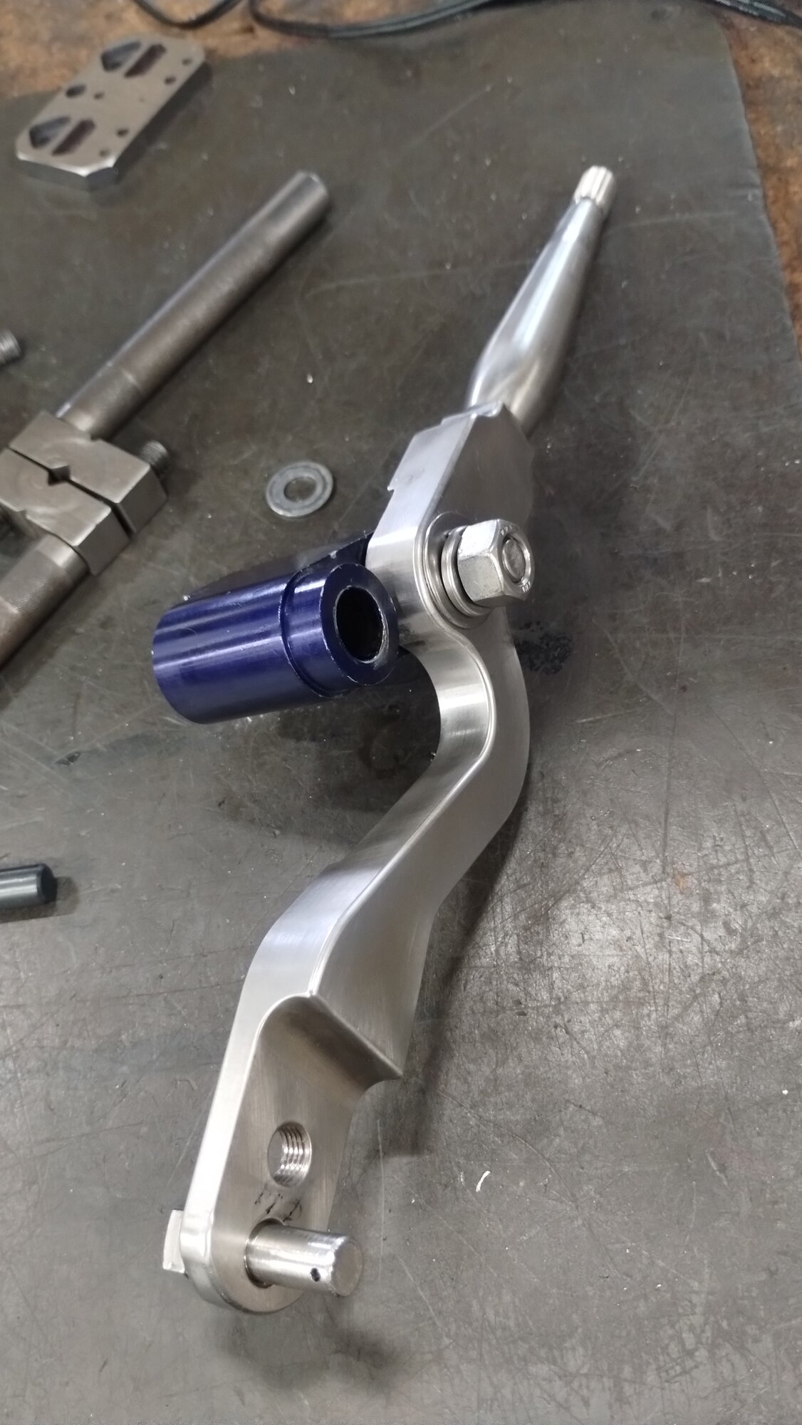

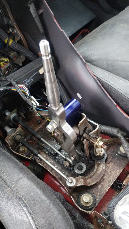

Had to rebuild the junkyard shifter, it was toast. Rigged up pretty bad, missing stuff, bad.
