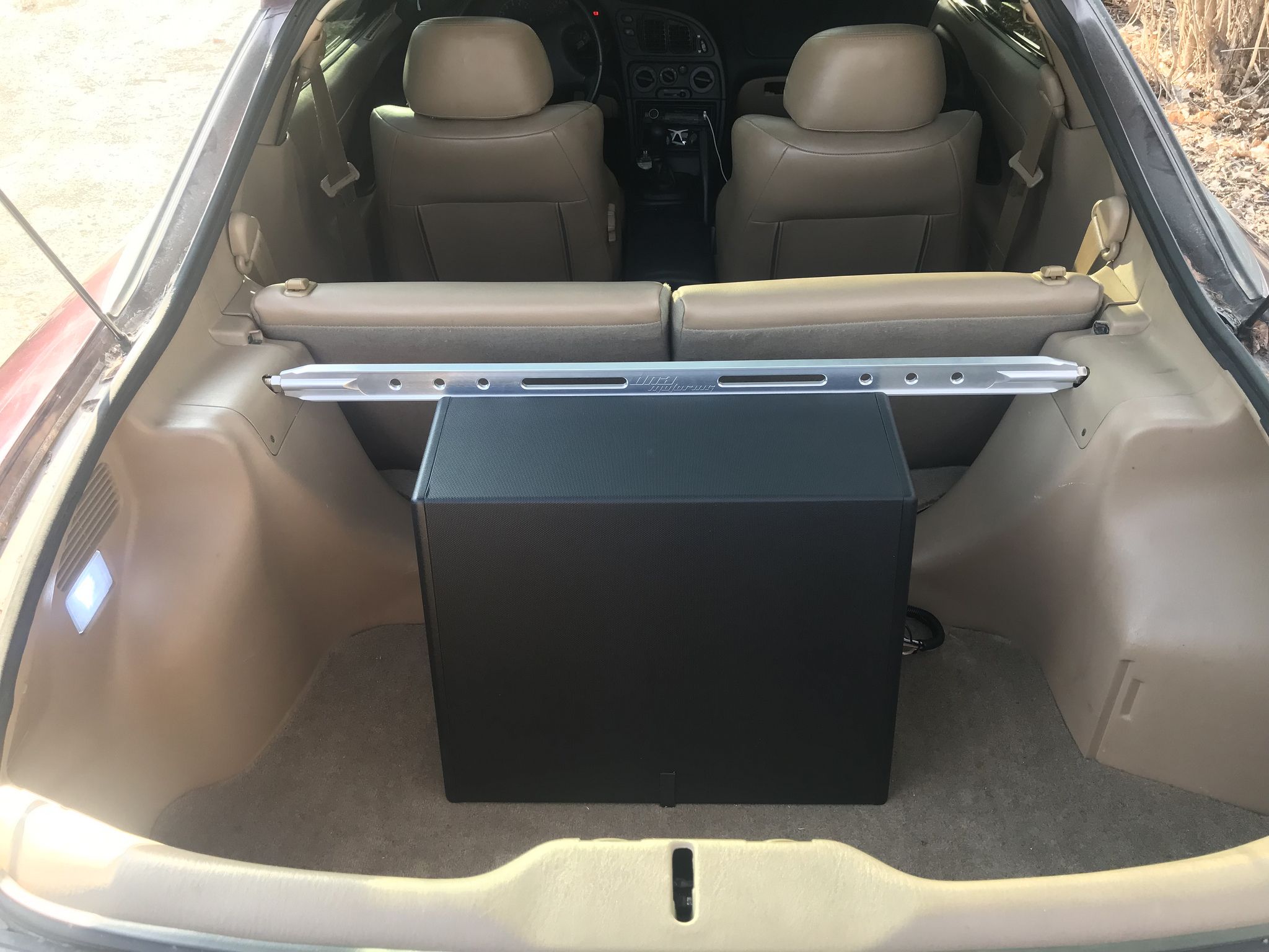

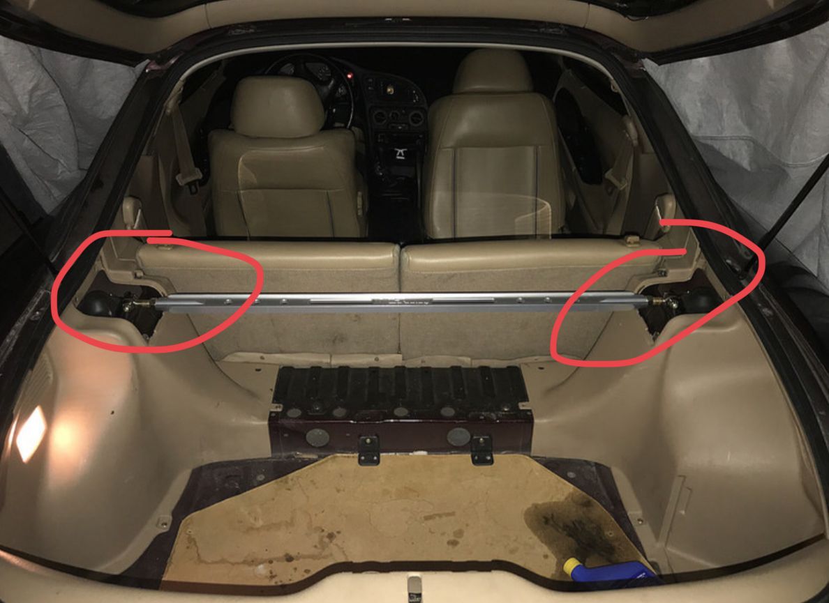

Anyone have some of the tan covers that go over the rear strut towers, or know where I can get them? All of the websites I have gone to send me a message right back saying that they are out of stock, understandably so since these cars are old. Picture attached of the pieces I’m talking about.
Performance Partout just brought in a 99 GST with a tan interior. Give them a call.. might have the panels for you.
Good to know, thanks for the tip! I'll have to give them a call!
EDIT: They had some and they are on the way!

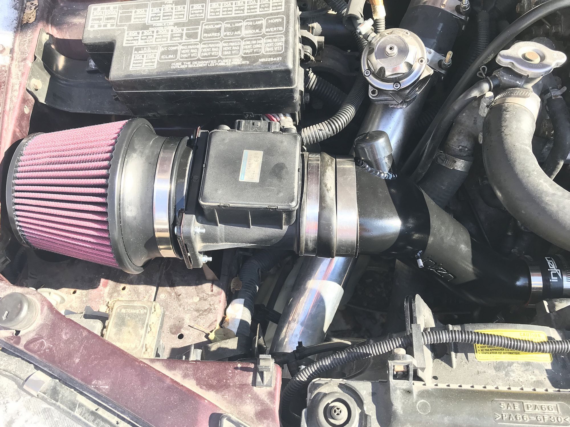

This is how the intake will sit in the engine bay, props it up nicely so it wont rub on anything and there is still plenty of clearance from the hood. I admit, hood clearance is less than I anticipated but there is still more than adequate space. Can't wait to really start cleaning the engine bay, its driving me nuts that has gotten this bad.. Luckily I will have a garage by the end of June so the car in general should stay much cleaner!
Injen Intake Final Position.

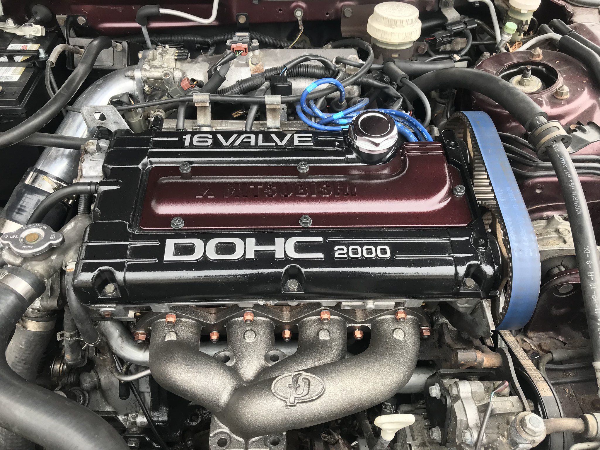

Small update, I color matched the spark plug cover. It turned out well but it made me realize how badly the rest of the paint under the hood is.. Oh well, repaint in the future.

Also finally got around to installing the final trim pieces in the rear hatch; what a PITA to do around a strut brace!!! But I got it, after a long time of struggling, and it looks good.

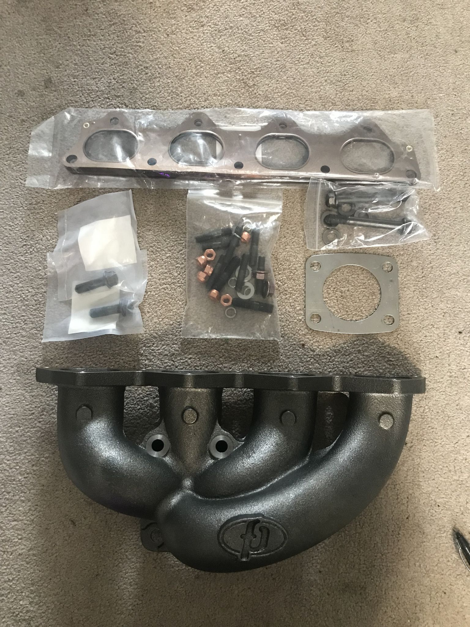

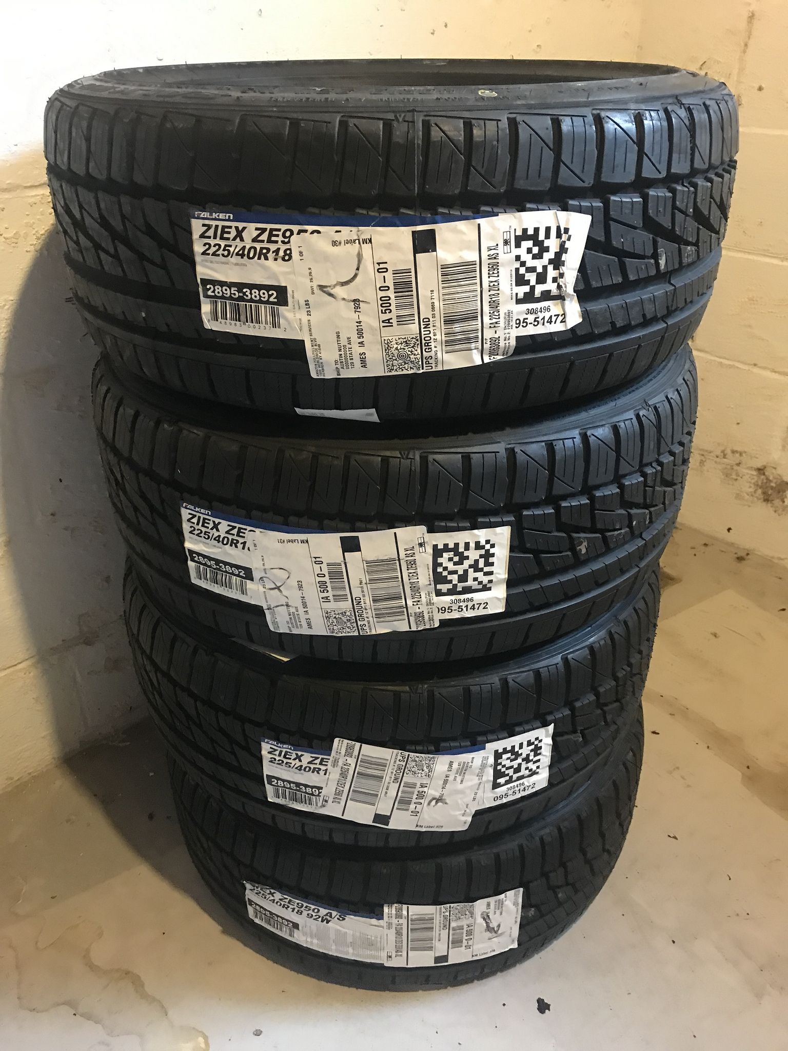

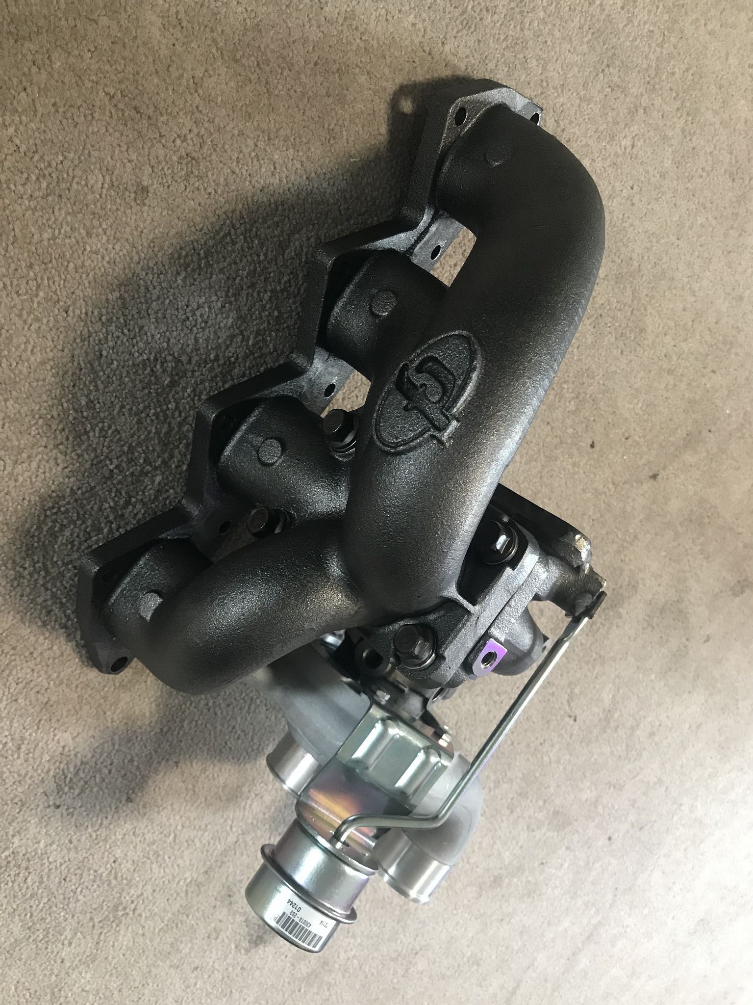

Exciting delivery today and a couple more expected soon!! New gaskets, studs, FP manifold and some Falken tires for the wheels I have coming. Man the manifold pairs beautifully with the T28, I can't wait to get it mocked up this weekend and transfer vacuum/coolant fittings. The Kiddie fire extinguisher also came, it fits under the passenger seat nicely.
Parts pile is building.. Everyone I talked to seemed happy with theirs and the price was right so I pulled the trigger. For cruising around town these should be perfect.

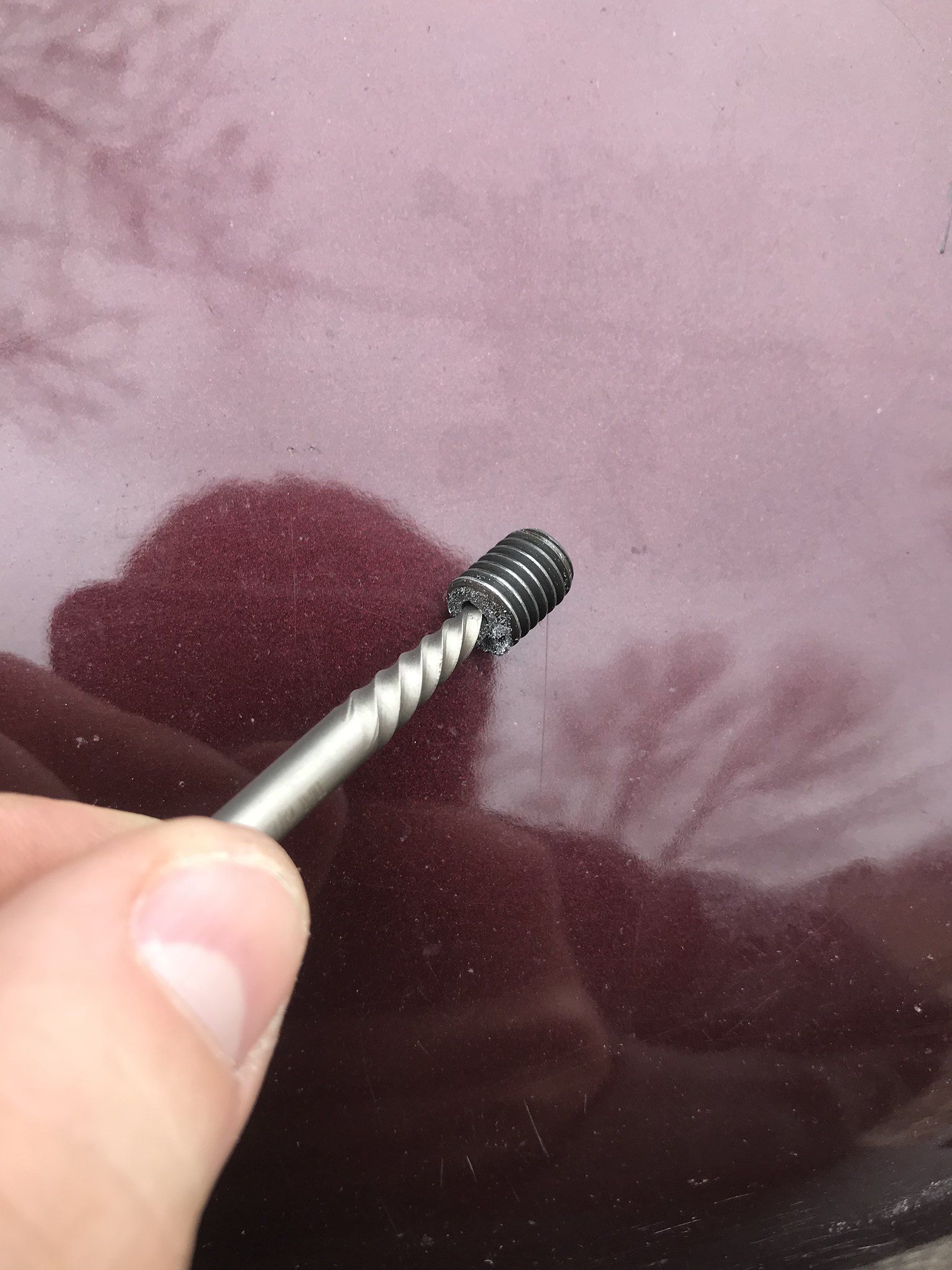

Installing the FP exhaust manifold was easy until I broke a stud.. Borrowed an extractor set and was able to get it out, wasn't fun though.

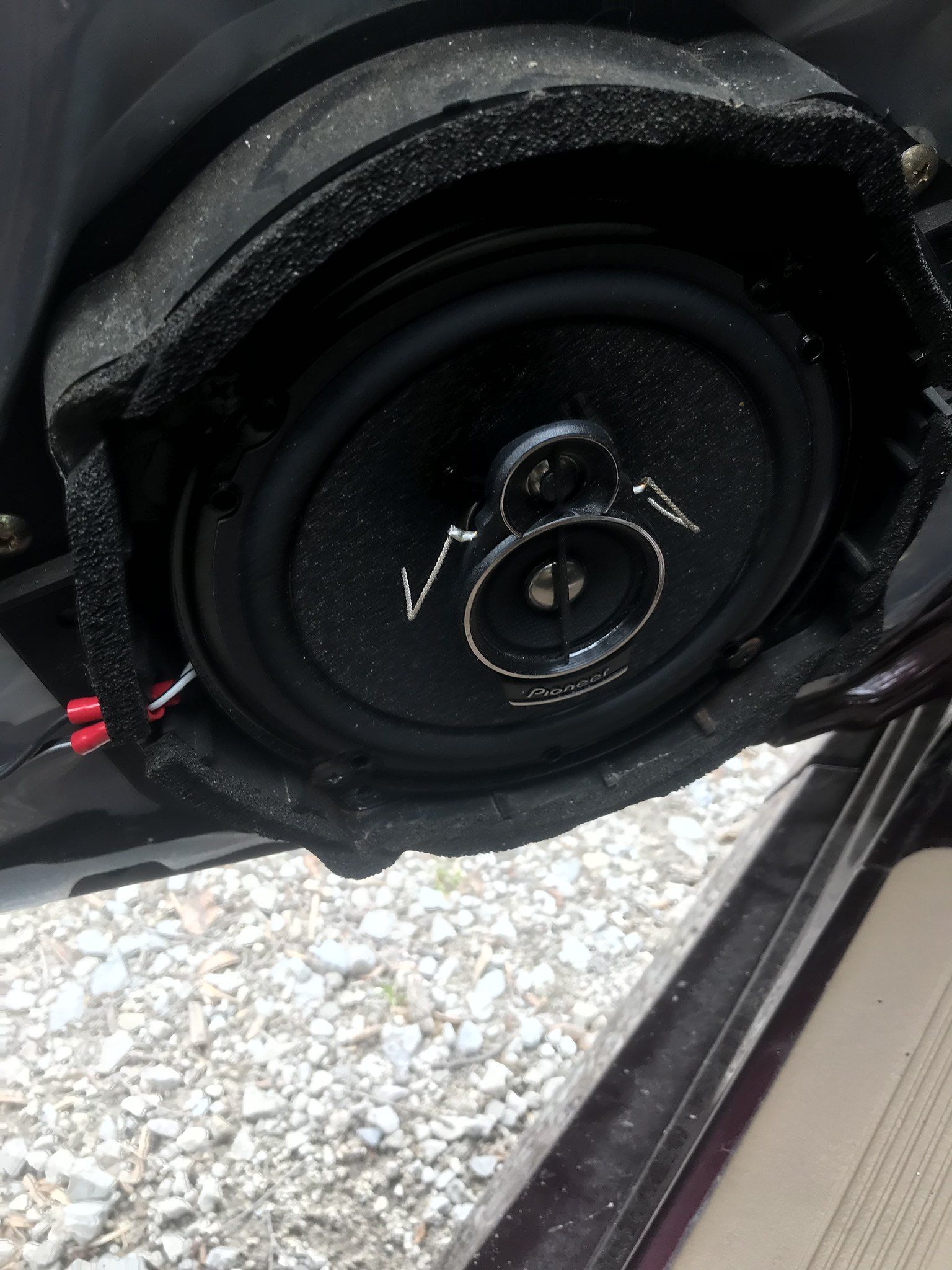

Went to mess with the driver side door handle to try and adjust it and discovered aftermarket speakers, that was a nice find. The door adjustment definitely helped, but I didn't have enough room to do the bolt in the mechanism mod so I am questioning how long it'll work.

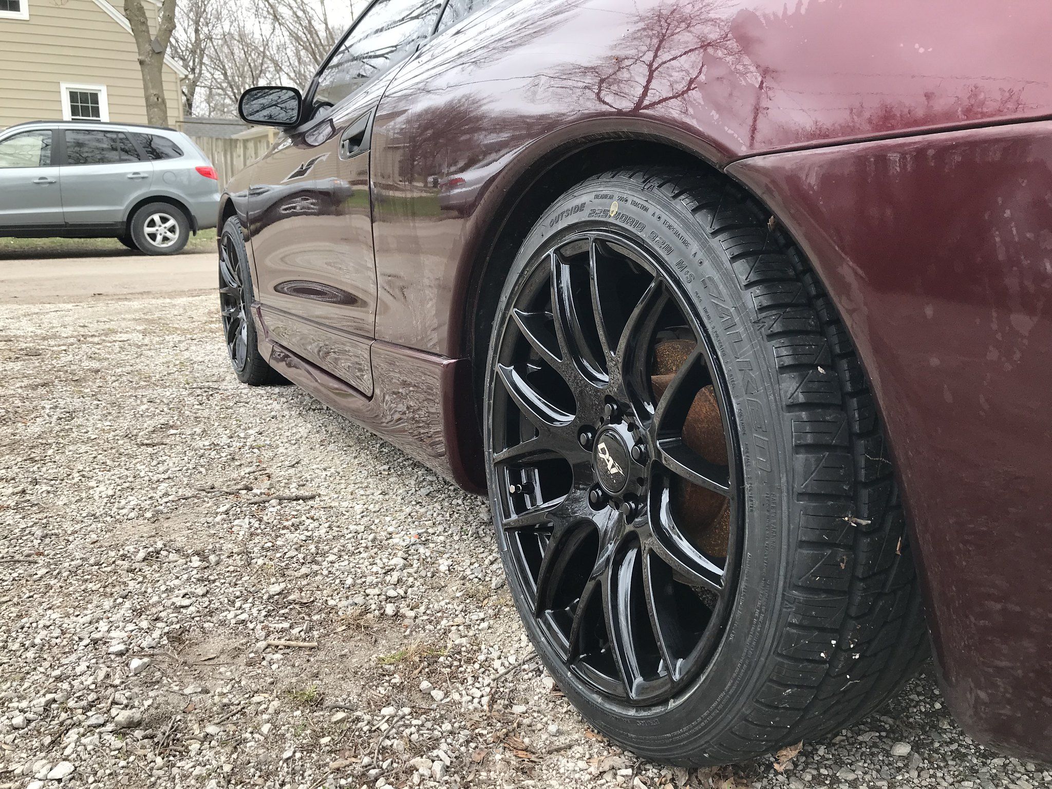

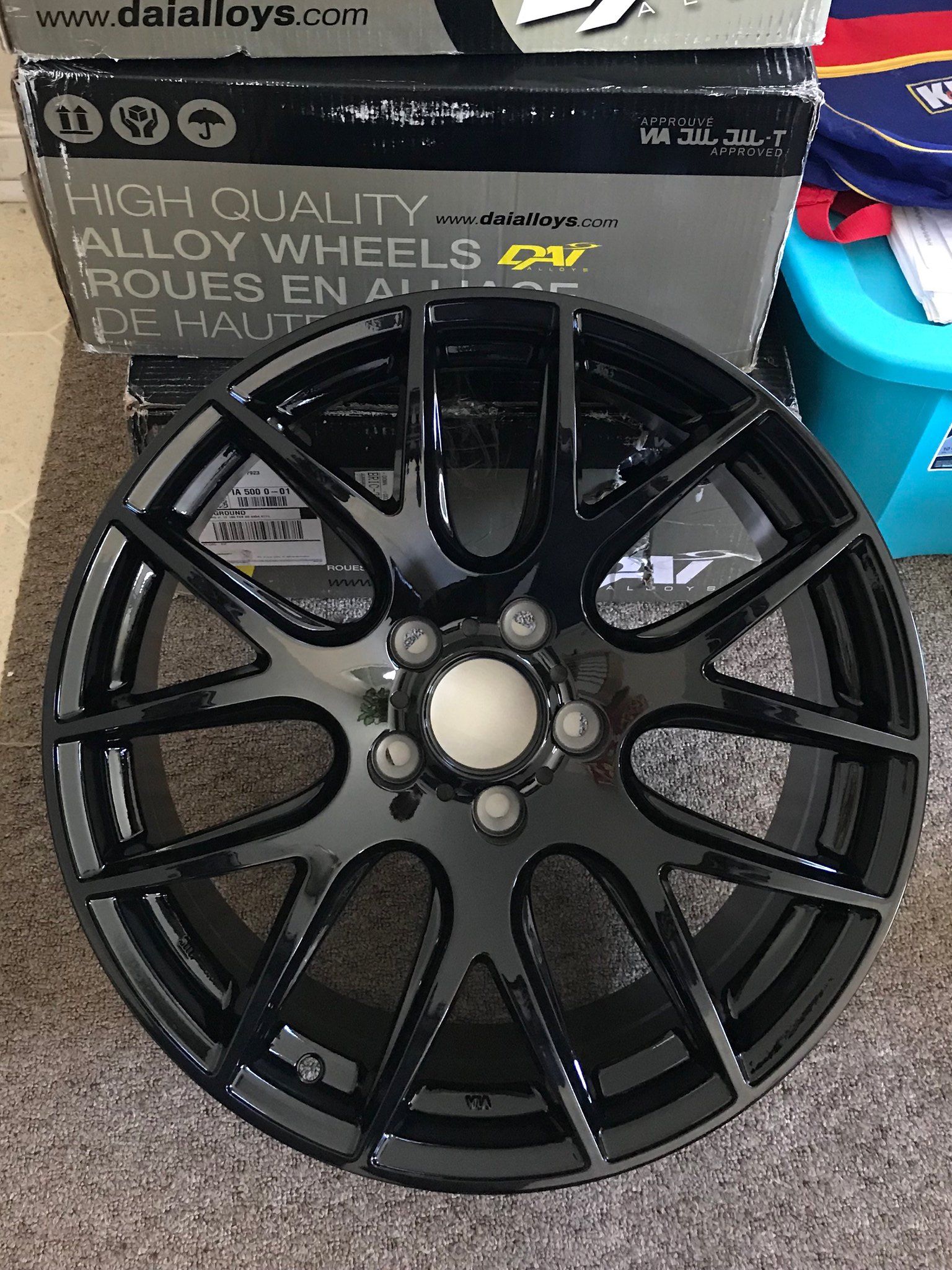

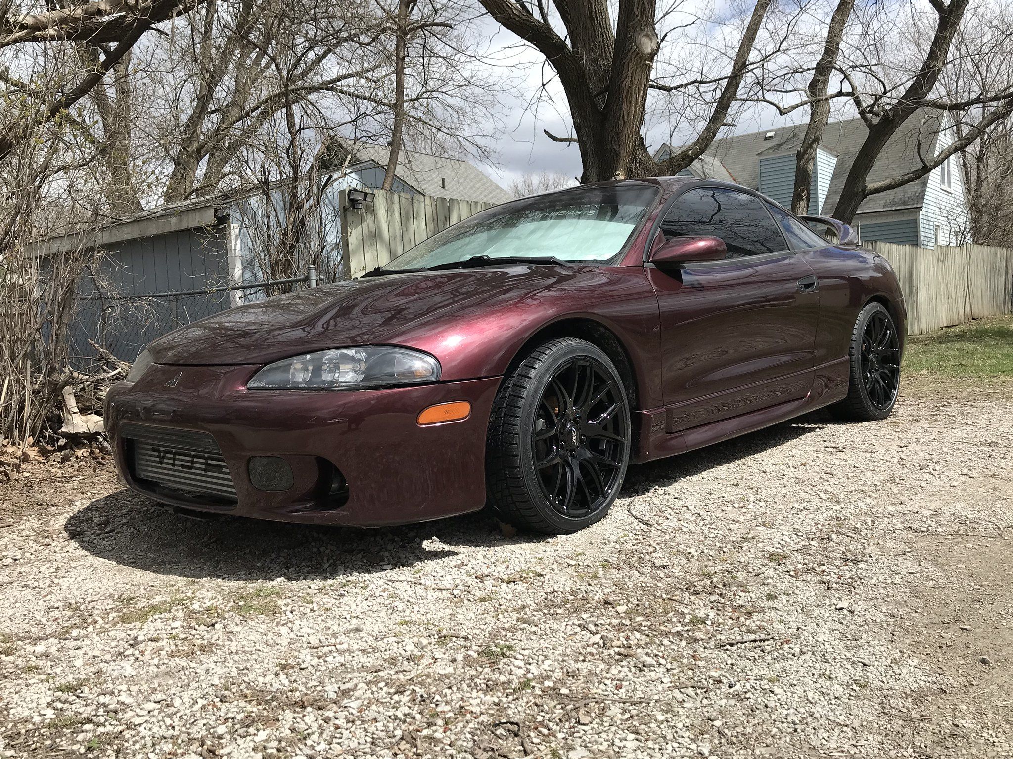

My wheels finally came, they are all I hoped they'd be.

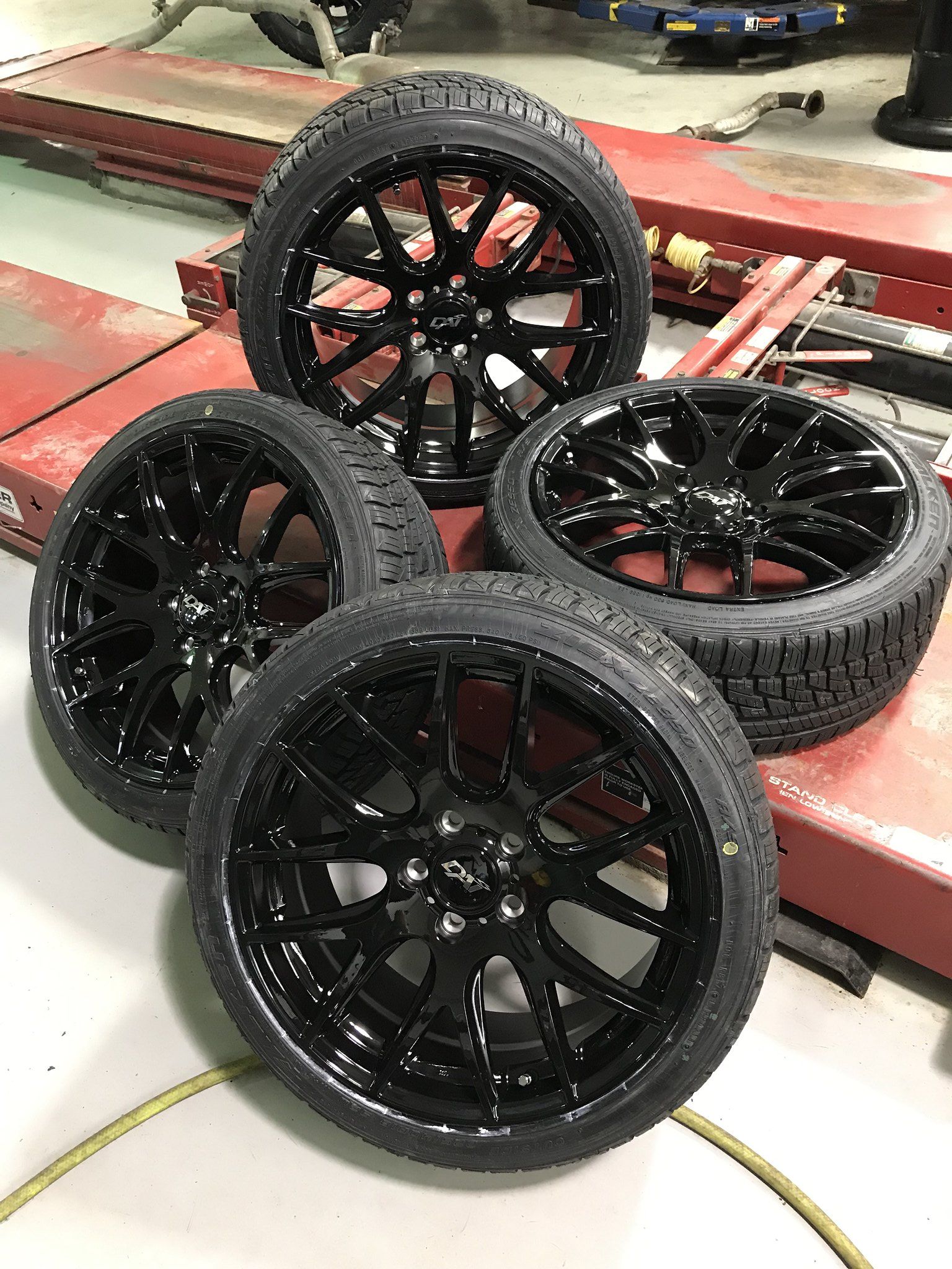

If anyone wants the info they are Dai Alloy Autobahns with a gloss black finish. They are 18x8+42. I mounted some Falken 225/40R18 and they fit the wheel perfect, virtually no stretch at all. After doing some research they should fit without any modifications to the vehicle, but that's before I lower it. We shall see on Friday, I am hoping to get them on the car by then.
Here they are on the car, I love them! I can't wait to get the coilovers on now..

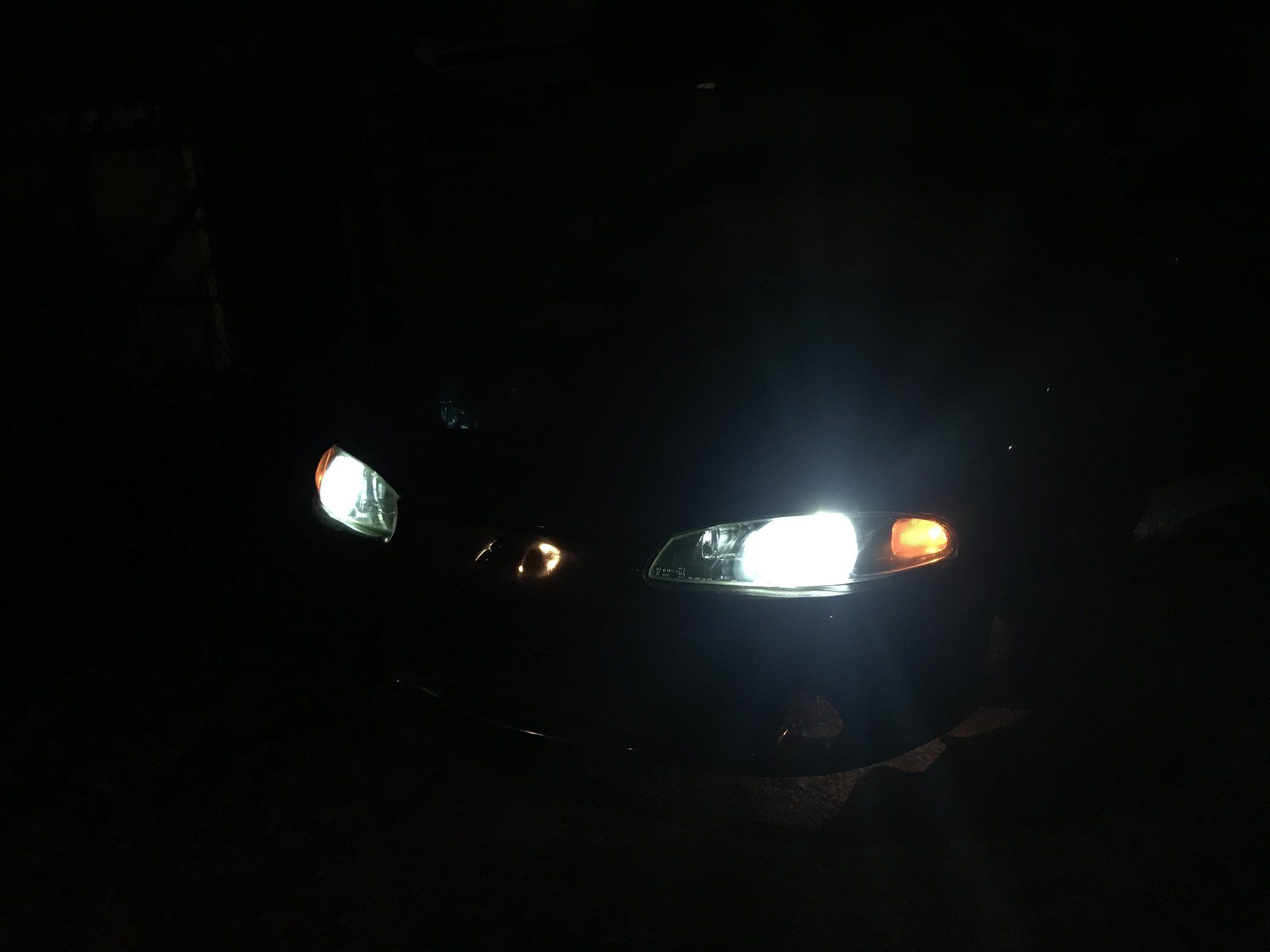

Oh and installed some DDM Tuning HIDs, 5500K so the color is just right. White with just a hint of blue. Of course the camera didn't pick that up at all.

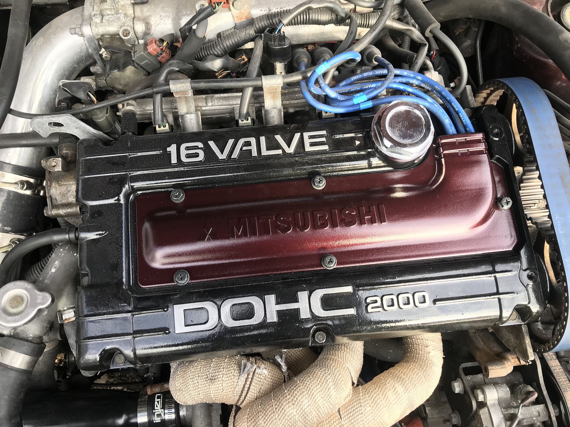

5/22/18. Replaced all brake pads, rotors, and tires. Also fixed the exhaust rattle by heat wrapping the piping where it was hitting the rear subframe.

11/5/18. Painted the valve cover and installed a new valve cover gasket with the half moon gasket. Also upgraded the oil cap to a Mr. Gasket Co one.
12/3/18. Cleaned and painted the Injen intake, replaced worn rubber end caps, adjusted clamp positions, and installed a new Injen cone air filter.

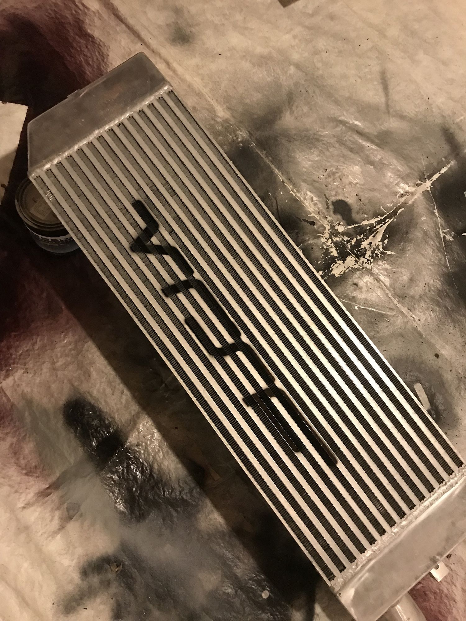

3/22/19. Replaced intercooler bushings and painted “VRSF” on the intercooler. Color matched the spark plug cover. Replaced the battery in the car as well as the negative battery terminal. Replaced the oil drain plug and crush washer.

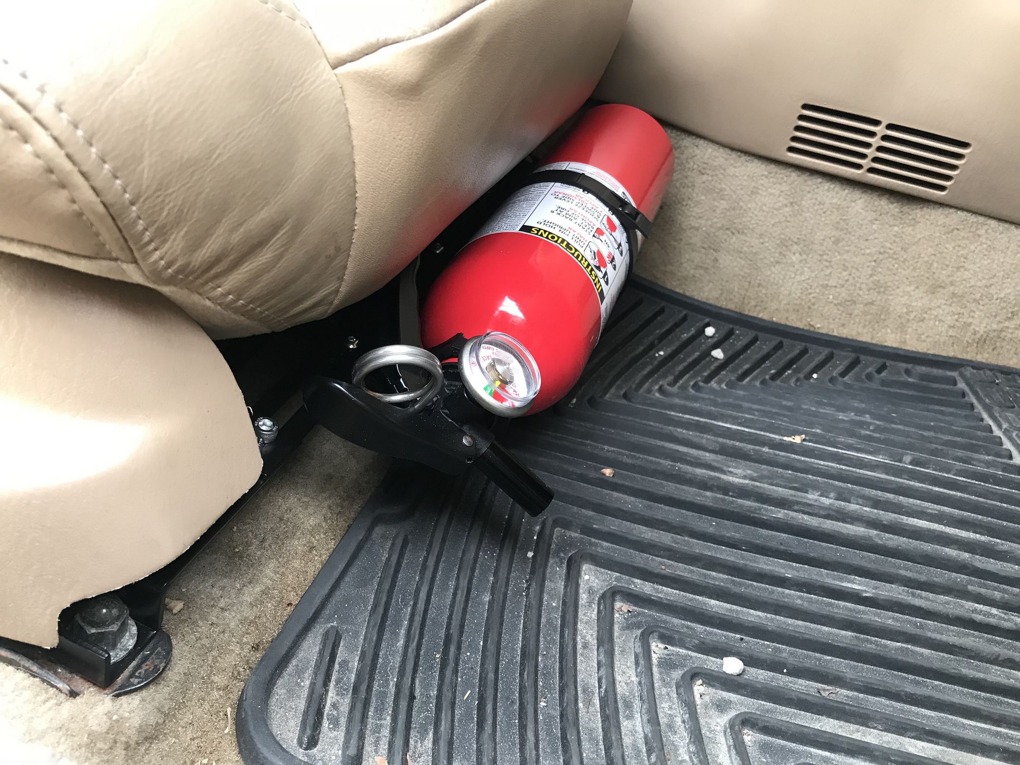

3/27/19. Installed The Bracketeer and a Kiddie fire extinguisher under thepassenger seat. Installed the rear interior strut trim pieces after cutting holes in them to allow the strut brace to still fit.
4/5/19. Installed an OEM exhaust manifold gasket, exhaust manifold studs, and a Forced Performance Racing exhaust manifold. Also Started cleaning the engine block/head of old oil/grossness build up.

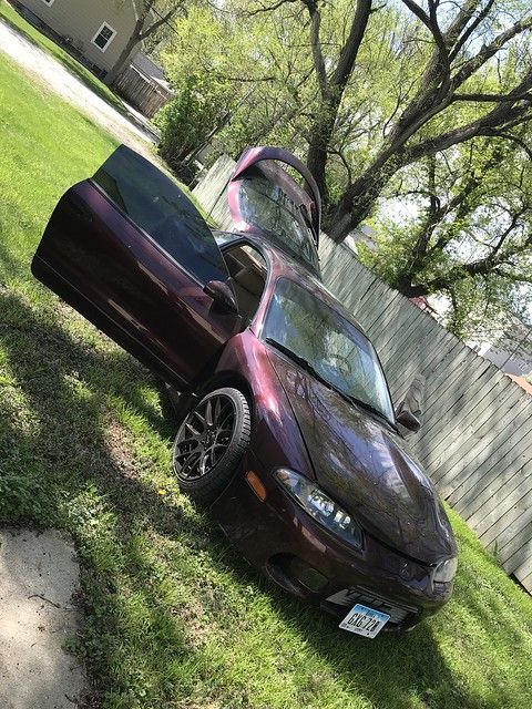

4/12/19. Installed Dai Alloy Autobahn 18x8+42 rims with Falken 225/40R18 tires. Also replaced the lug nuts with black “tuner” style ones that came with the wheels. Not sure if they will stay or not, but they were free. Also installed a stainless steel oil feed line for the turbo from the oil filter. Replaced the headlight bulb plastic covers on the back of the low beams. Installed DDM Tuning 5500K 35W HIDs in the low beams as well.
Well that took longer than expected, but it was more fun than studying. Here's to many more headaches, bloody knuckles, and fun memories with the car.

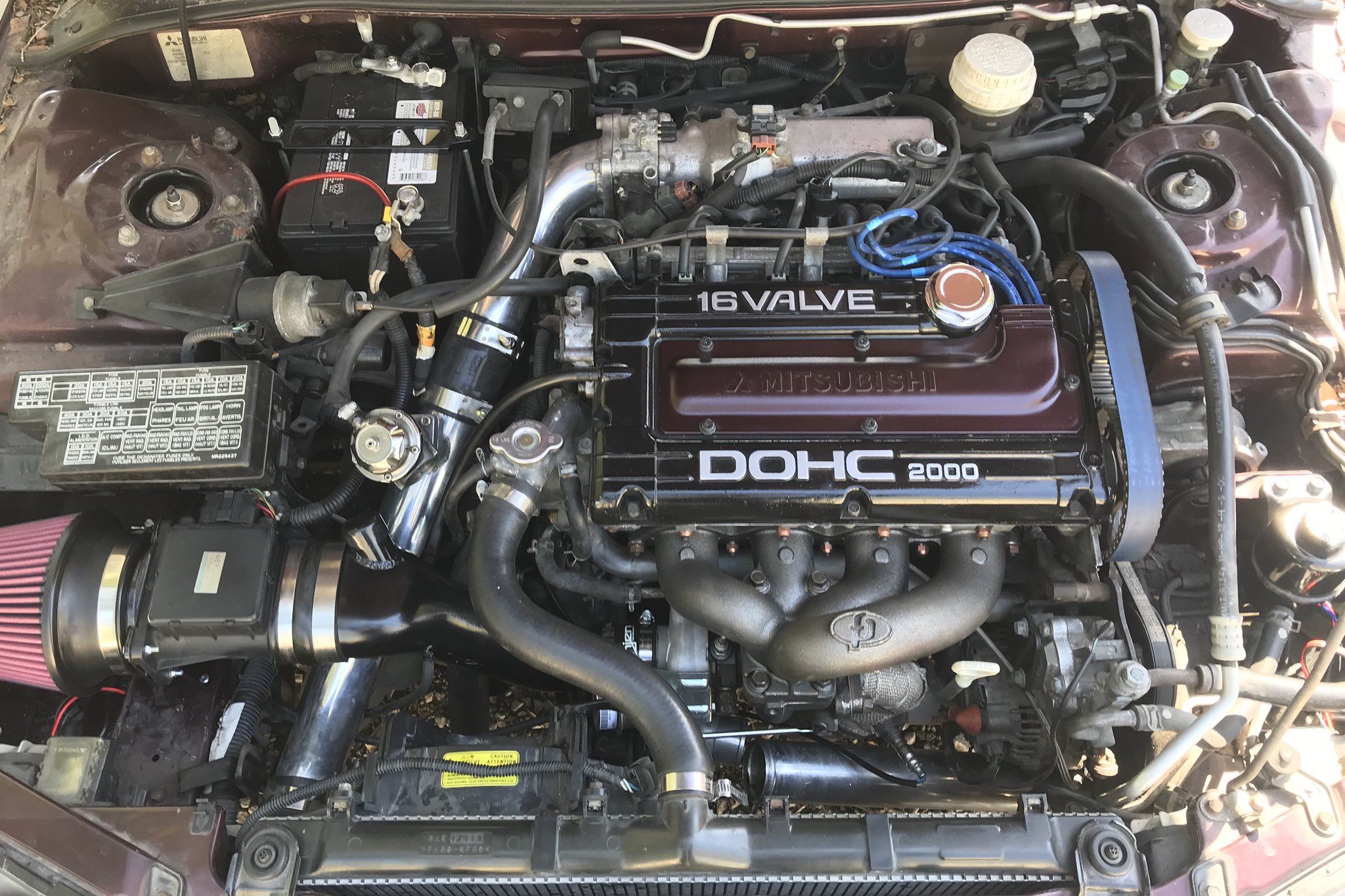

After 7 months and a plethora of new parts it is finally running! I got the intercooler piping re-routed much better than it was, and used a lot less sketchy pieces of piping clamped together. I could have had the car running last week but I was waiting for the 2" to 2.5" coupler to come in (you can see it missing in the picture). So far it ran well, couple more things to get sorted out though. Have a tow truck coming tomorrow morning to take it to have the transmission worked on. So close to driving it again, and boy am I itching to do so!

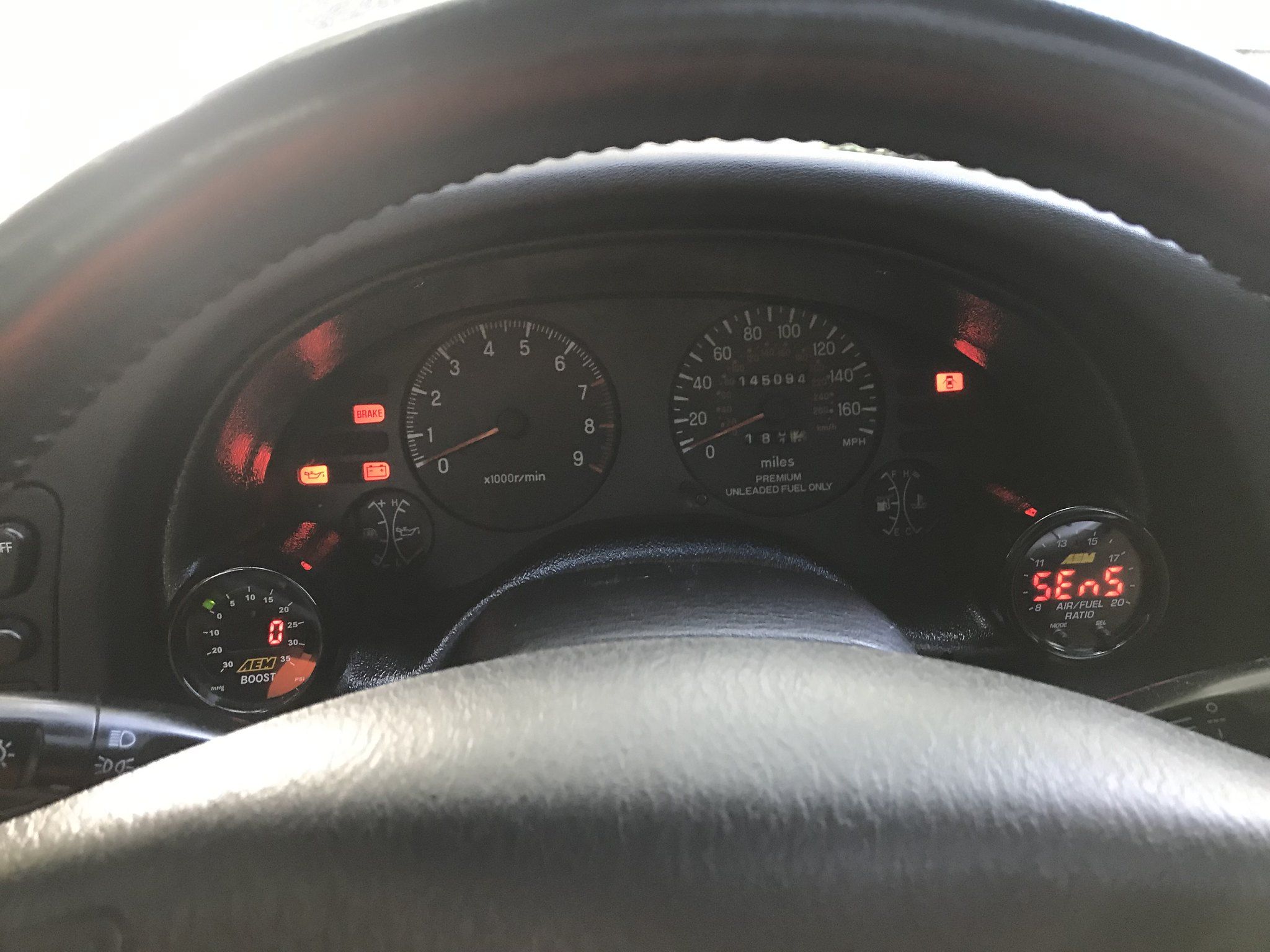

I also wanted to add and AFR gauge to the car, and move the boost gauge to somewhere easier to look at under boost. Installed a Glowshift cluster bezel and while I was at it I cleaned behind the gauge cluster lense and buffed some of the scratches out of it.
For those wanting to do the same thing, the Glowshift bezel is way more texture and glossy than the OEM one, but it matches the trim around the HVAC controls pretty well.

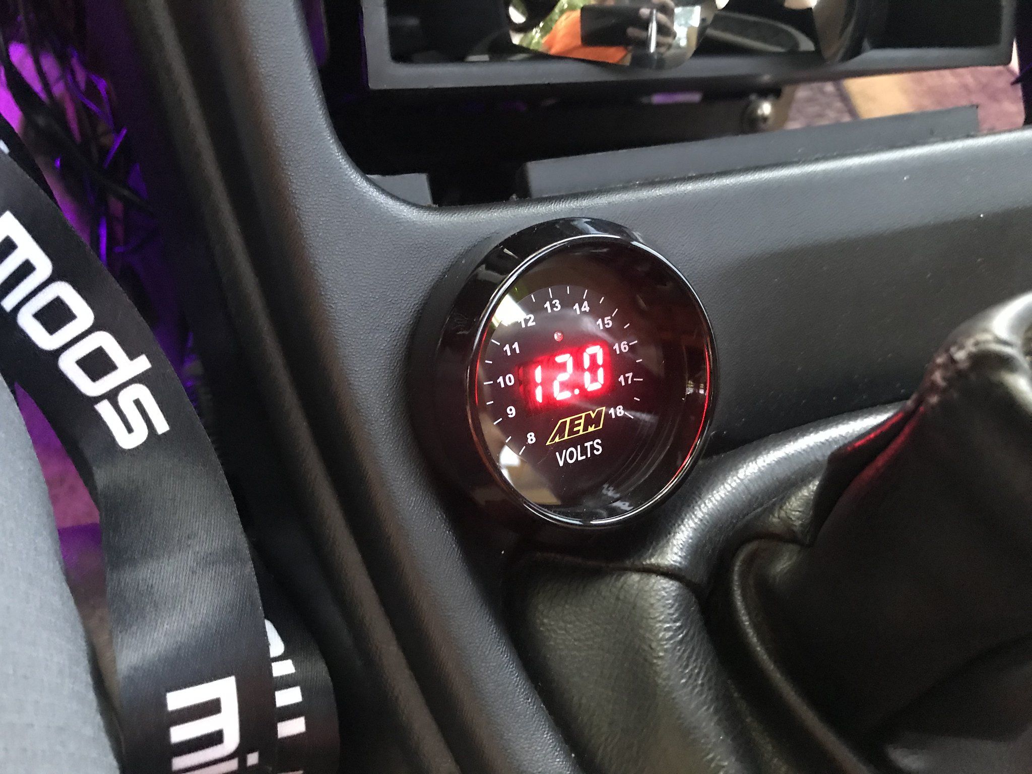

I bought a voltmeter too, mainly just to fill in the hole left by moving the boost gauge but I quite like having the volt meter by the headhunt.
